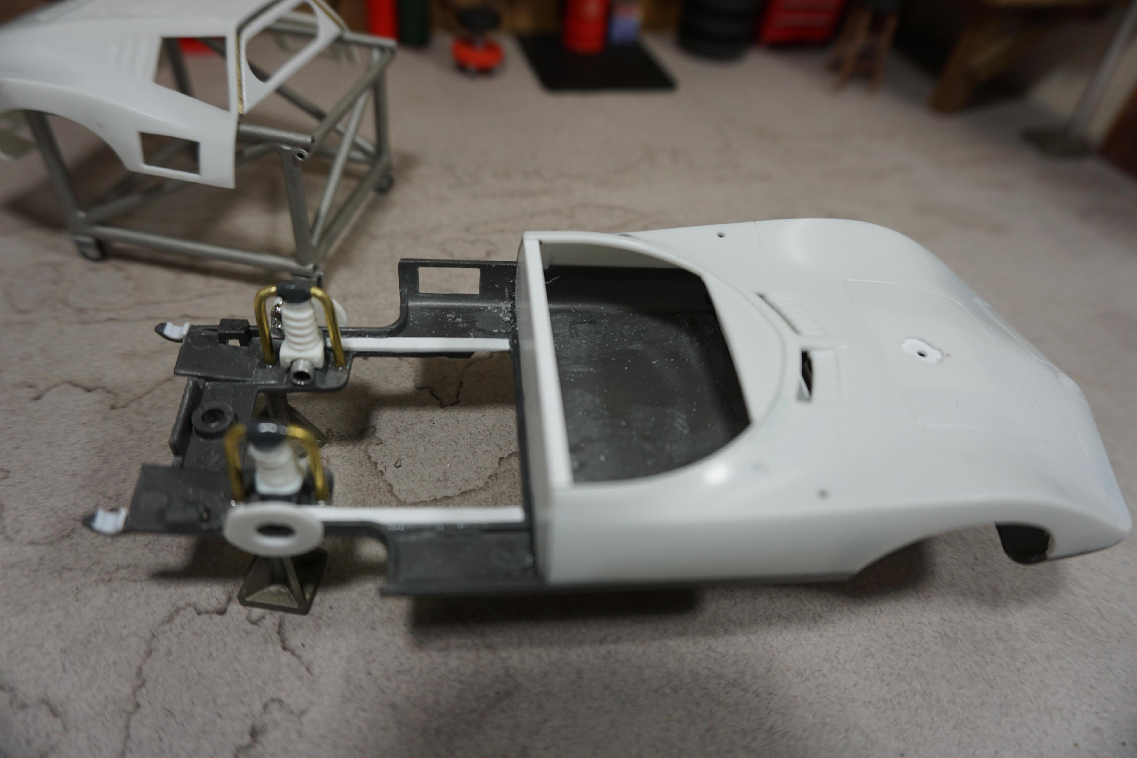

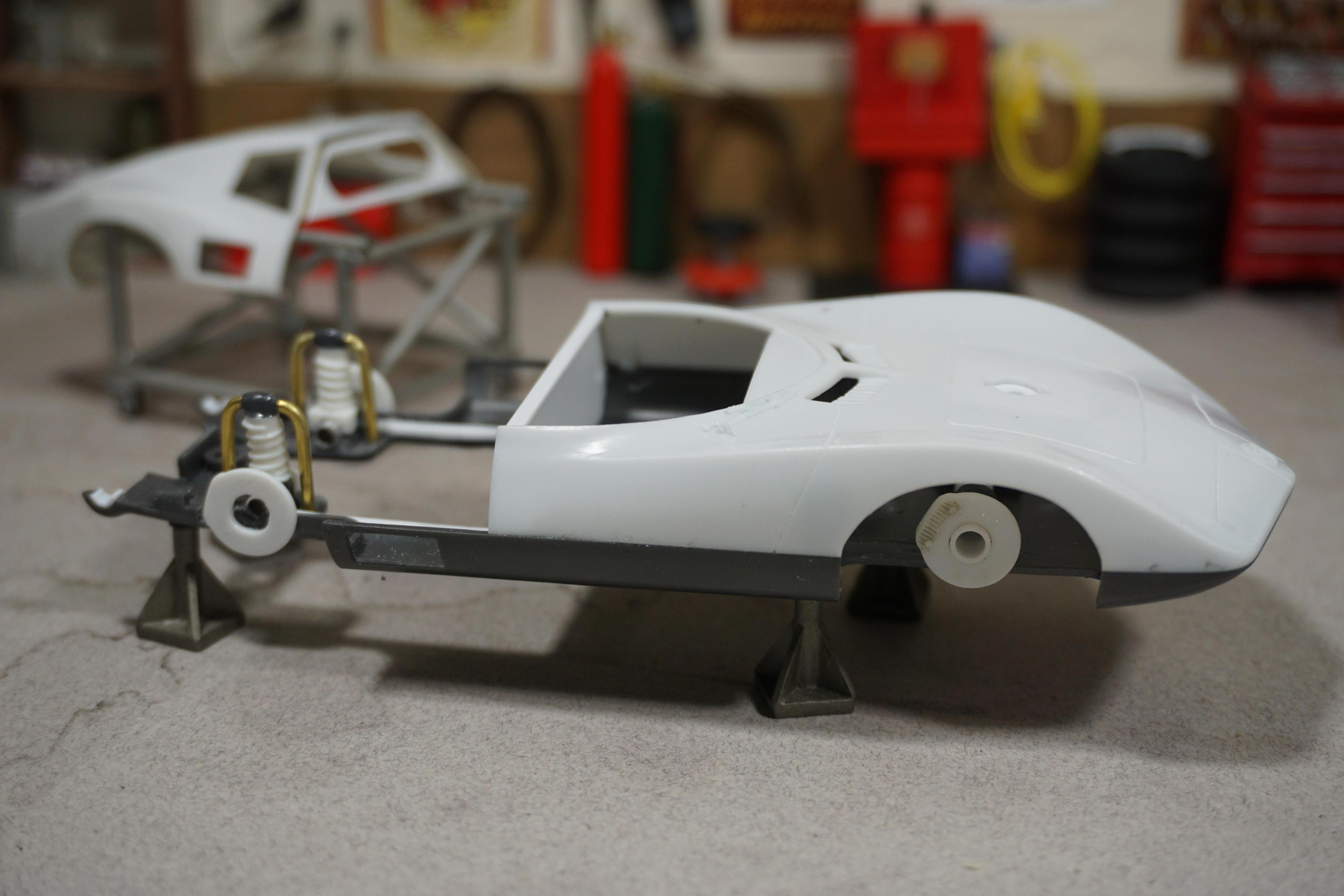

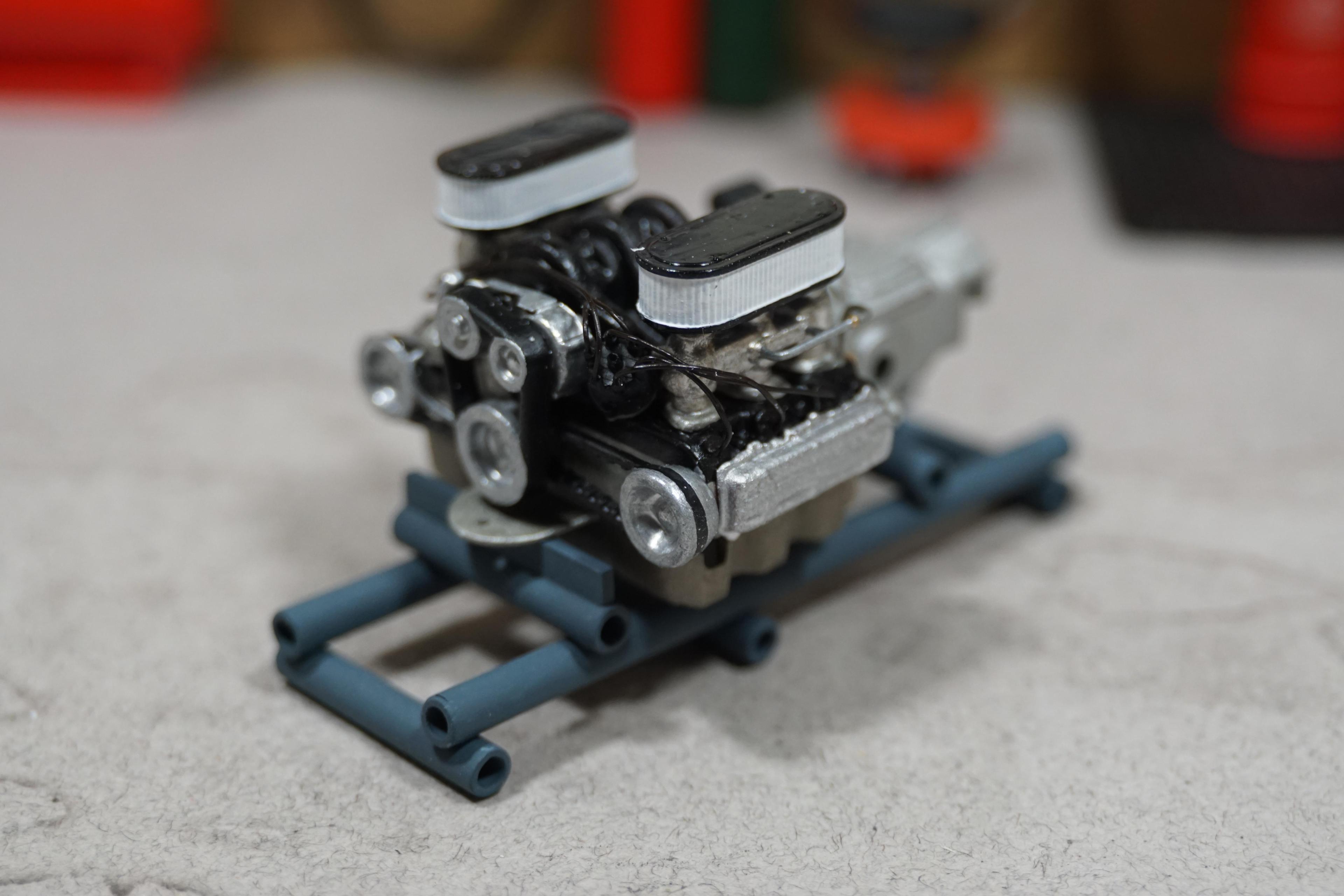

Joe Lange Posted January 15, 2022 Posted January 15, 2022 Greetings All, This model has been a project of mine, (on and off), for about 2 years. It started its life as an Entex kit with that little nasty electric motor and battery box where the motor should have been. A 'glue bomb' AMT Chevrolet Astro II Show Car donated its Corvair OHC 'prototype' engine for the cause. After a bit of engine detailing, it is ready. Then the fun began on building a descent chassis. There are hardly any photos on the engine compartment of this car, and the real show car had several versions of Corvair engines, so I just used a bit of imagination and a lot of scratch building. 3

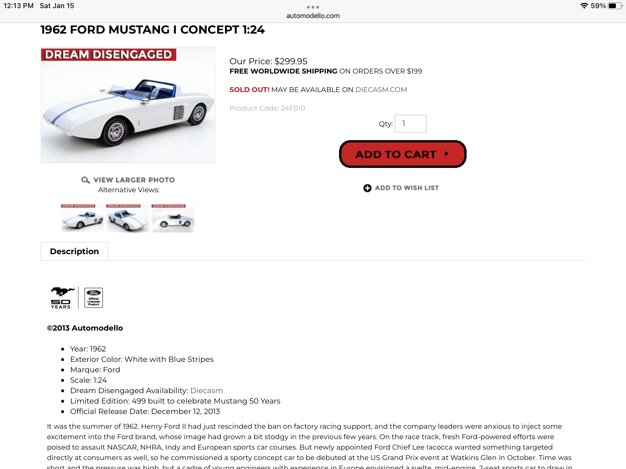

vamach1 Posted January 15, 2022 Posted January 15, 2022 1 minute ago, rightrudder said: A great subject that will test your fabrication skills. Subscribed! I wish someone kitted the original Mustang prototype with the mid-mounted V-4 engine. Maybe someone did? I have never seen a kit but perhaps there was a slot car in the 60’s. Automodelllo made a diecast one.

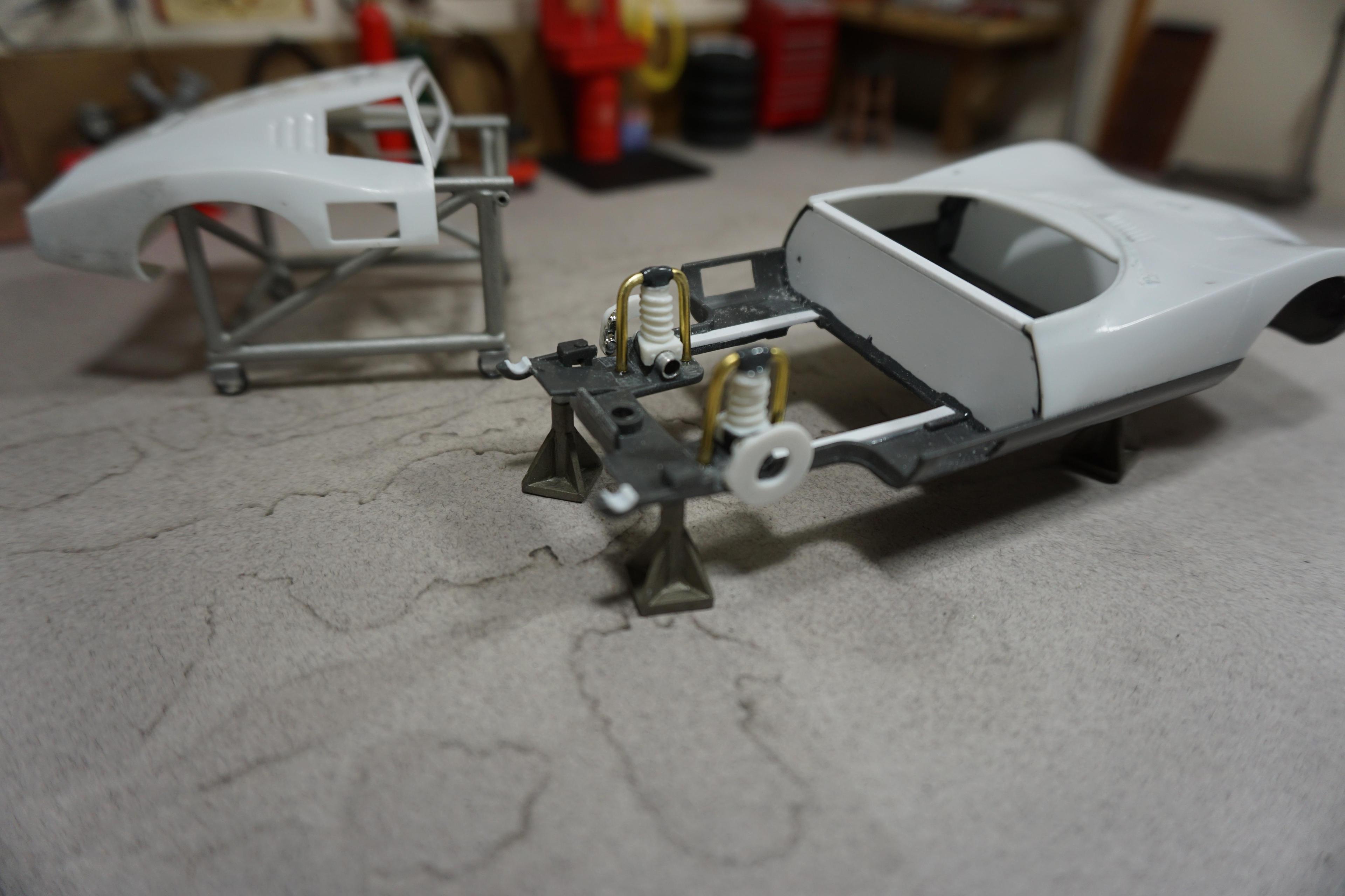

Ace-Garageguy Posted January 15, 2022 Posted January 15, 2022 22 minutes ago, Daddyfink said: Found a few decent shots of it! https://www.conceptcarz.com/vehicle/z13357/chevrolet-corvair-monza-gt-concept.aspx Interesting. Looks like it used production stamped steel front control arms (from who knows what) in the rear. Also note the forged steering arm coming from the spindle. Makes me think hubs / uprights may have been sourced from 4WD front pieces.
Joe Lange Posted January 15, 2022 Author Posted January 15, 2022 Thanks guys, for your comments. Jack, as far as scale, I can only go by what the box stated. However, the 13-inch Corvair tires l sourced from Modelhaus Tires look spot on and the Corvair engine from another 1/24 kit, looks to be just the right size. I had doubts about scale also but, I think it's a little too big to be 1/32. Jesse, Bill: Thanks for the photos. As you can see, there is a whole lot of steel chassis surrounding, (and hiding), the engine. I wanted to avoid that so, watch for later photos and see what you think. Also, that is not the original engine as it is turbocharged. Apparently, this show car had a very busy life and a few engines. I have several B&W photos of the car in 1963 at Watkins Glen and the '63 Turin Salon in Italy where the first motor was a stock unit with a single, center mounted carb, and air cleaner. I also had no desire to replicate that strange exhaust system! I'll send a photo of the underside.

Joe Lange Posted January 17, 2022 Author Posted January 17, 2022 Hey Bill, enjoy the conversation from you and Dennis about the Monza and 'scale'. However, it is for that reason I stayed away from the 1/20 version. I really hoped the 1/20 Monza had a 'real' engine because I would have gladly paid the bigger bucks on Ebay and bought it! But, because it had the same stupid electric motor, I could not see spending all that time scratch building an engine when there is so much in 1/24,1/25 parts out there.

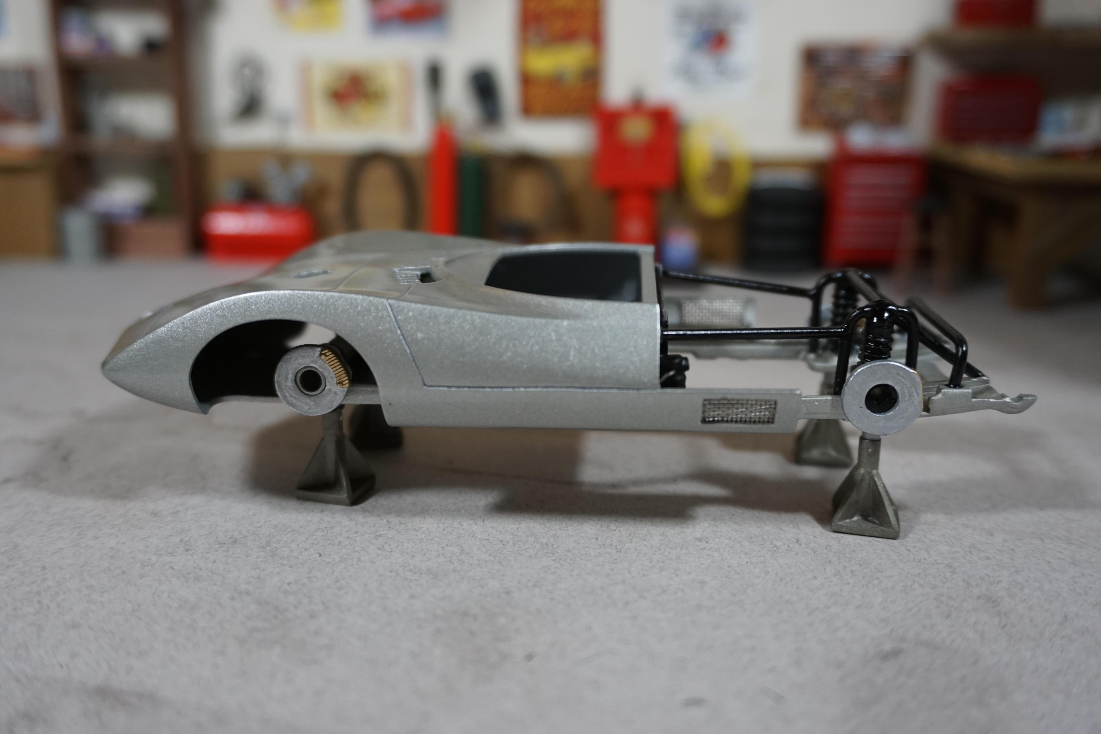

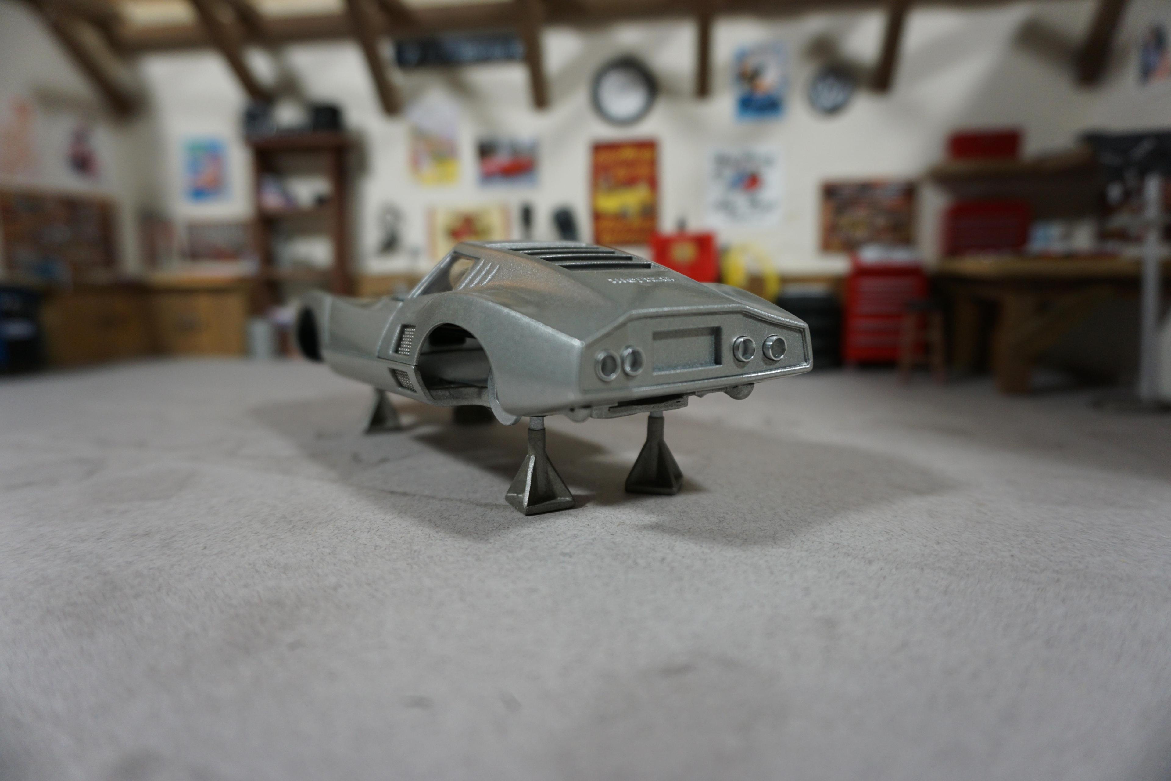

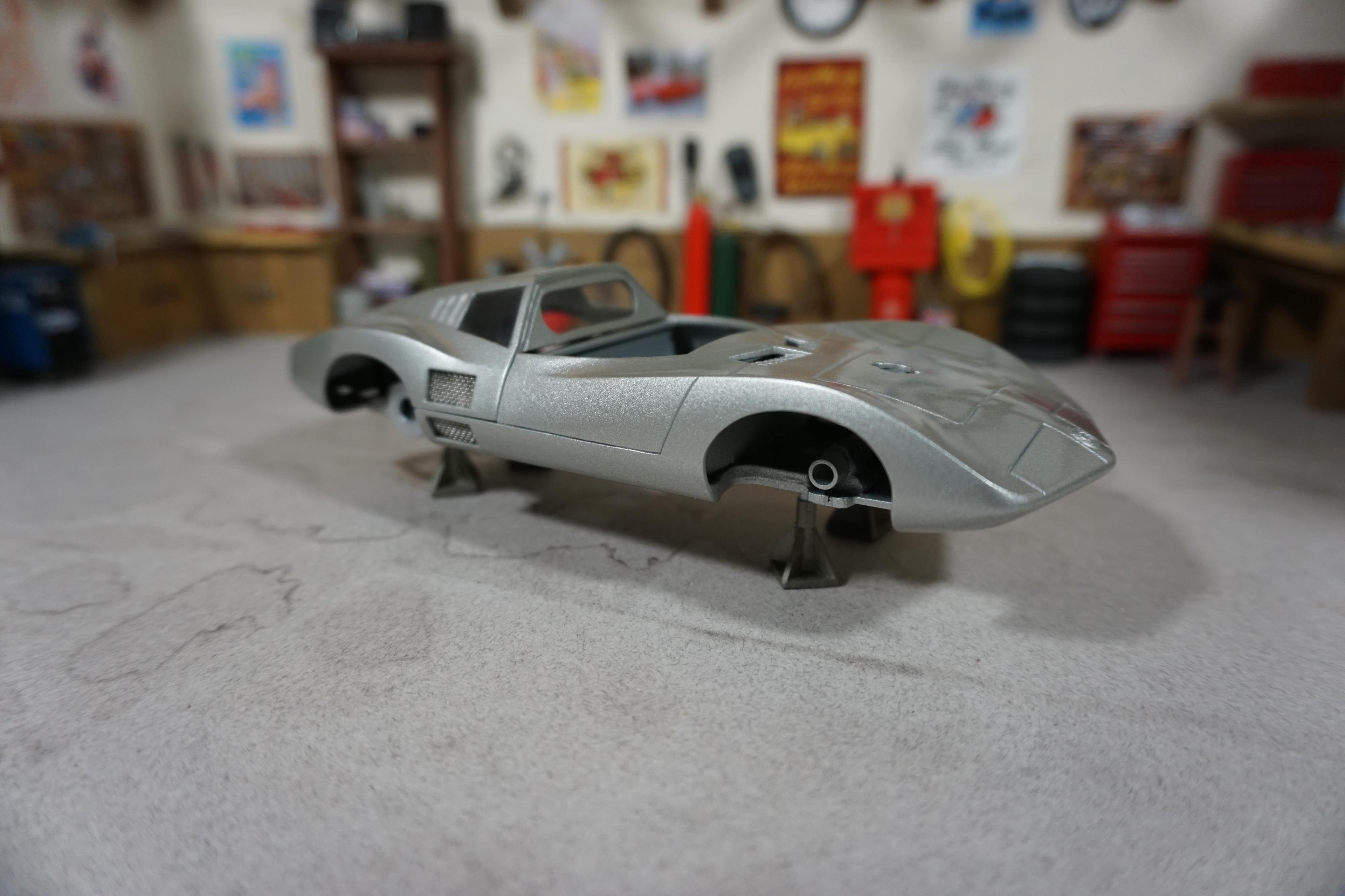

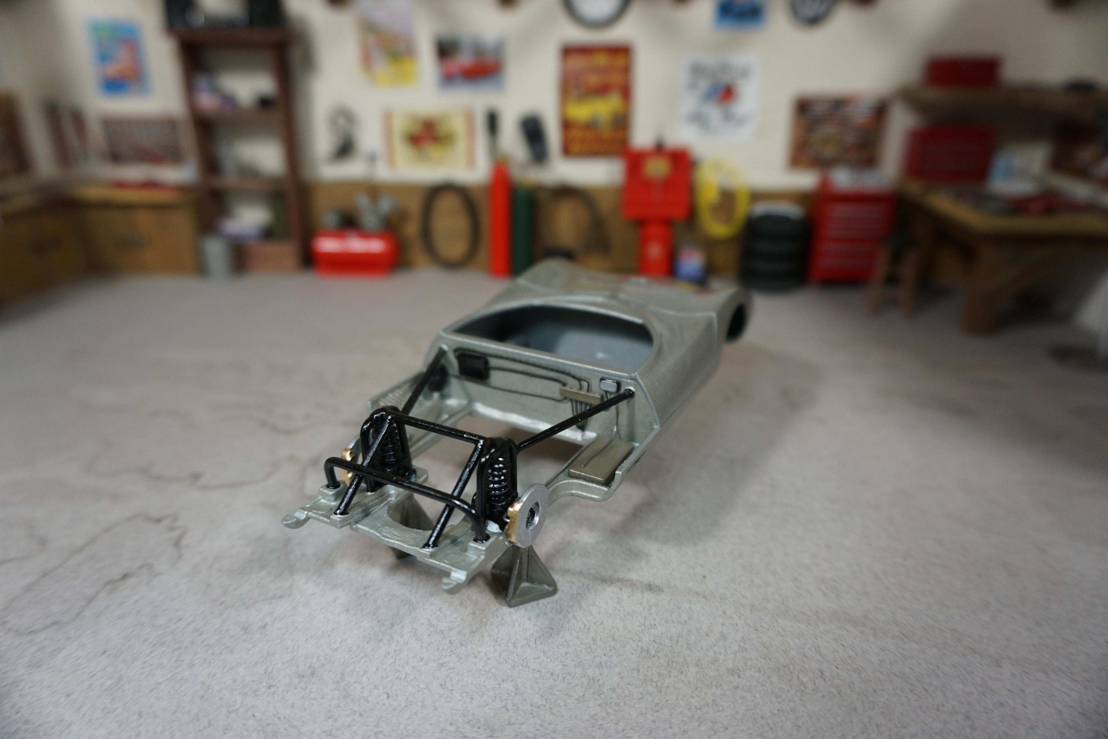

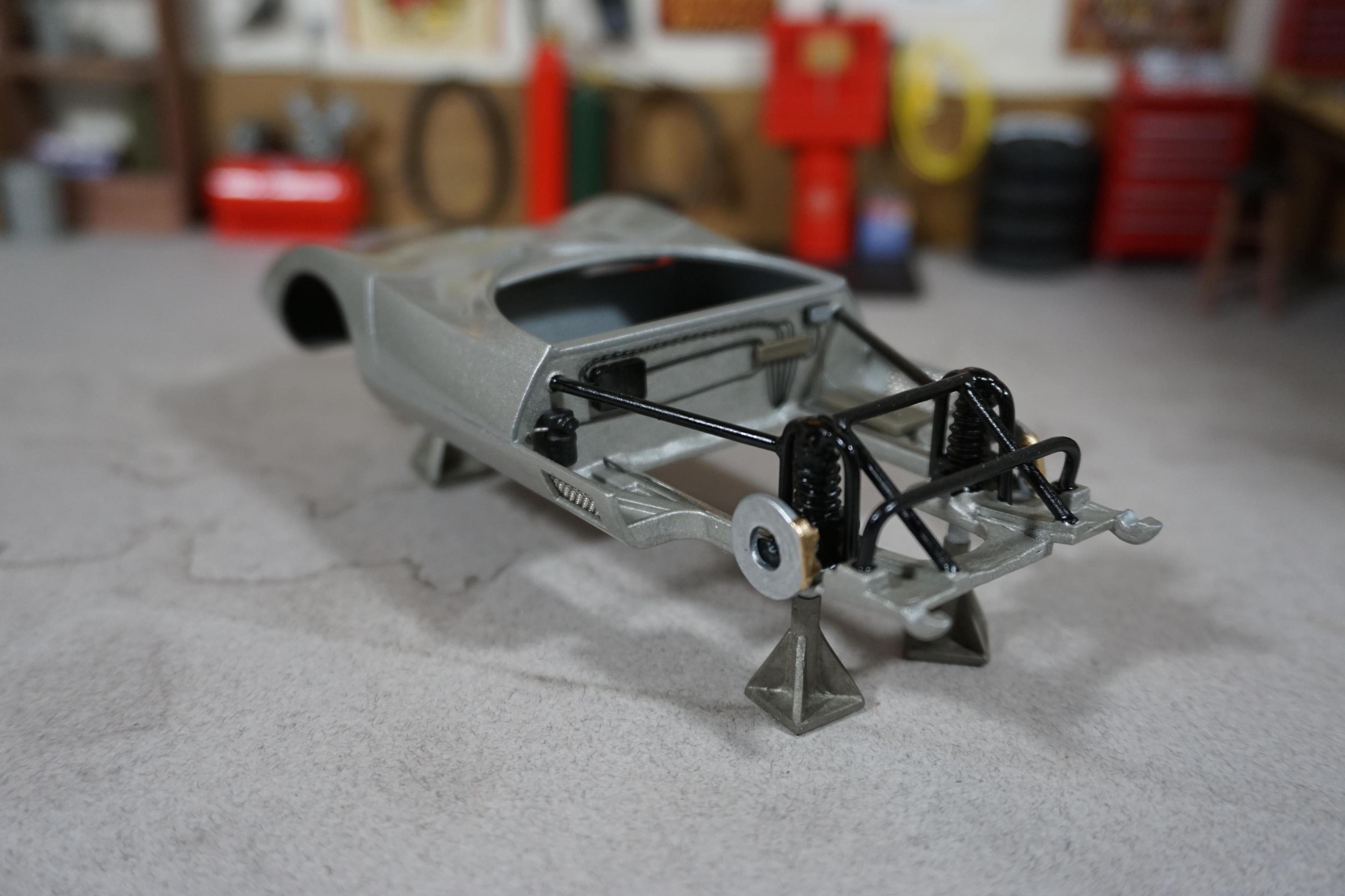

Joe Lange Posted January 23, 2022 Author Posted January 23, 2022 Greetings all, Another week and a little more progress. Duplicolor 'aluminum' and clear coat. Detailing firewall, more rear framework, alignment of rear cover. 1
rightrudder Posted January 23, 2022 Posted January 23, 2022 Excellent finish! Mesh in the vent openings looks super cool.
Joe Lange Posted January 24, 2022 Author Posted January 24, 2022 Thanks Doug, The screen is from a company called Franklin Models. They are a supplier of model train parts. The screen comes in 3 different 'Mesh' sizes, for different train scales. You see the stuff for sale on Ebay and model train part websites. There are also other folks on Ebay that sell aluminum mesh screen that looks interesting.
