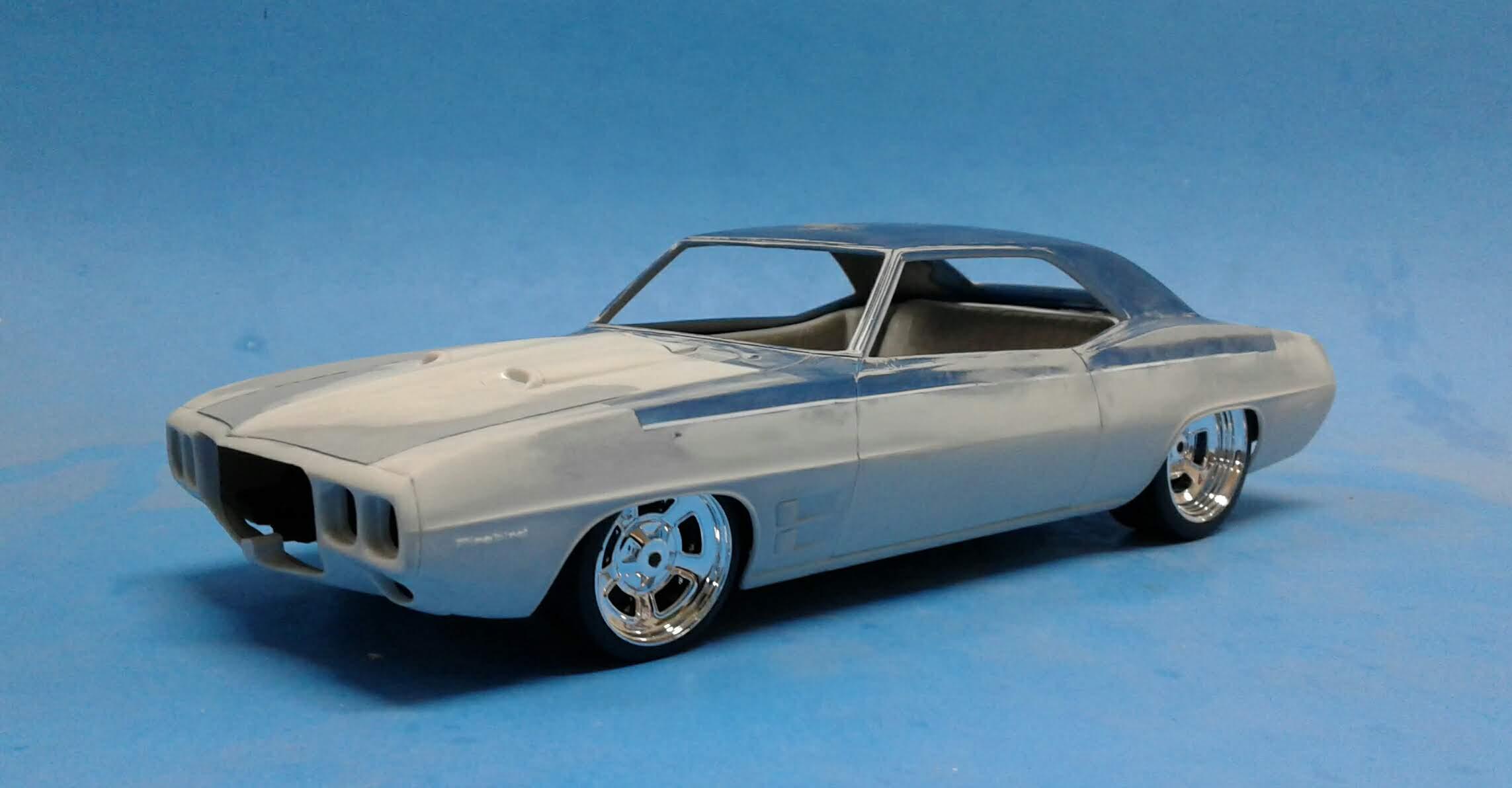

Plowboy Posted January 18, 2022 Posted January 18, 2022 I've done it both ways. Either a tiny drop of crazy glue or barely hit it with Tamiya Extra Thin. You're right about crazy glue being fairly easy to get apart and clean up. But, the Extra Thin works well also. It is a bit easier to get the panels back apart with the Extra Thin as long as you don't over do it. I had to glue the hood on this Firebird. I temp glued it with Tamiya Extra Thin on each corner. 1 1

GlueSniffer Posted January 18, 2022 Author Posted January 18, 2022 1 hour ago, Plowboy said: I've done it both ways. Either a tiny drop of crazy glue or barely hit it with Tamiya Extra Thin. You're right about crazy glue being fairly easy to get apart and clean up. But, the Extra Thin works well also. It is a bit easier to get the panels back apart with the Extra Thin as long as you don't over do it. I had to glue the hood on this Firebird. I temp glued it with Tamiya Extra Thin on each corner. Glad to know that either works! I have plenty of BSI CA glues but USPS seems to have been holding my Tamiya extra thin 45 minutes from my house for 4 days now ?♂️ So you had to graft the roof on? Guessing it was a Camaro roof on a Firebird Convertible? Either was that looks like one precise fit!

Plowboy Posted January 18, 2022 Posted January 18, 2022 10 hours ago, GlueSniffer said: Glad to know that either works! I have plenty of BSI CA glues but USPS seems to have been holding my Tamiya extra thin 45 minutes from my house for 4 days now ?♂️ So you had to graft the roof on? Guessing it was a Camaro roof on a Firebird Convertible? Either was that looks like one precise fit! Thanx! It was actually a Firebird coupe. But, out of the box, it has a wonky looking roof and quarter panels. It started out as an experiment to see if I could fix the body. But, I ended up building it.
