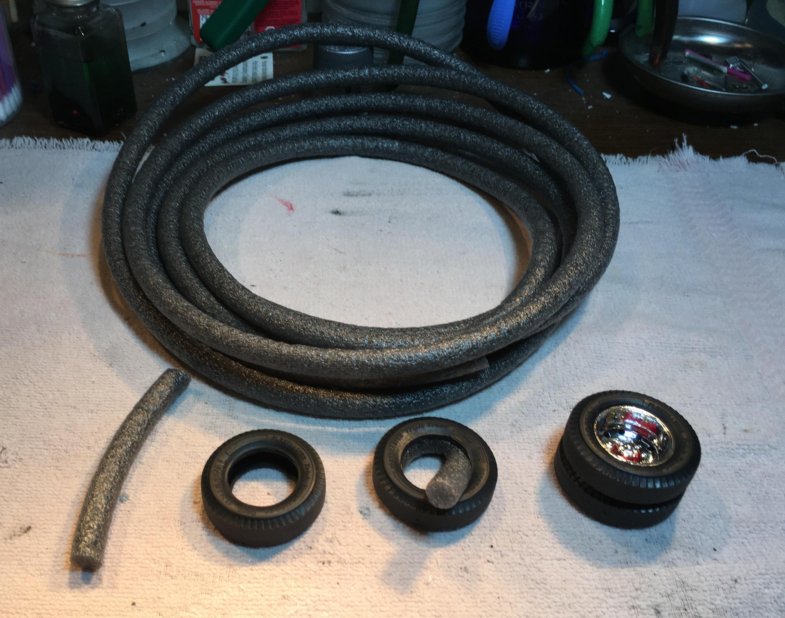

OldTrucker Posted January 19, 2022 Posted January 19, 2022 The tires in my GMC Astro kit are terrible. Kit is dated 2004. The wheels just drop loosely through the side that didn't have the spider. Stuffed the tires with tissue to spread them a bit but they slide in over the raised center. Are the tire sets Round 2 are selling any better? I hate to go that way as I would have to order them and with shipping it would be north of 20 bucks for them!
Bills72sj Posted January 19, 2022 Posted January 19, 2022 23 minutes ago, OldTrucker said: The tires in my GMC Astro kit are terrible. Kit is dated 2004. The wheels just drop loosely through the side that didn't have the spider. Stuffed the tires with tissue to spread them a bit but they slide in over the raised center. Are the tire sets Round 2 are selling any better? I hate to go that way as I would have to order them and with shipping it would be north of 20 bucks for them! I have two tricks for you. Get some 3/8" foam backer rod to hold the sidewalls against the rim lips. Or get some Moebius replacements.

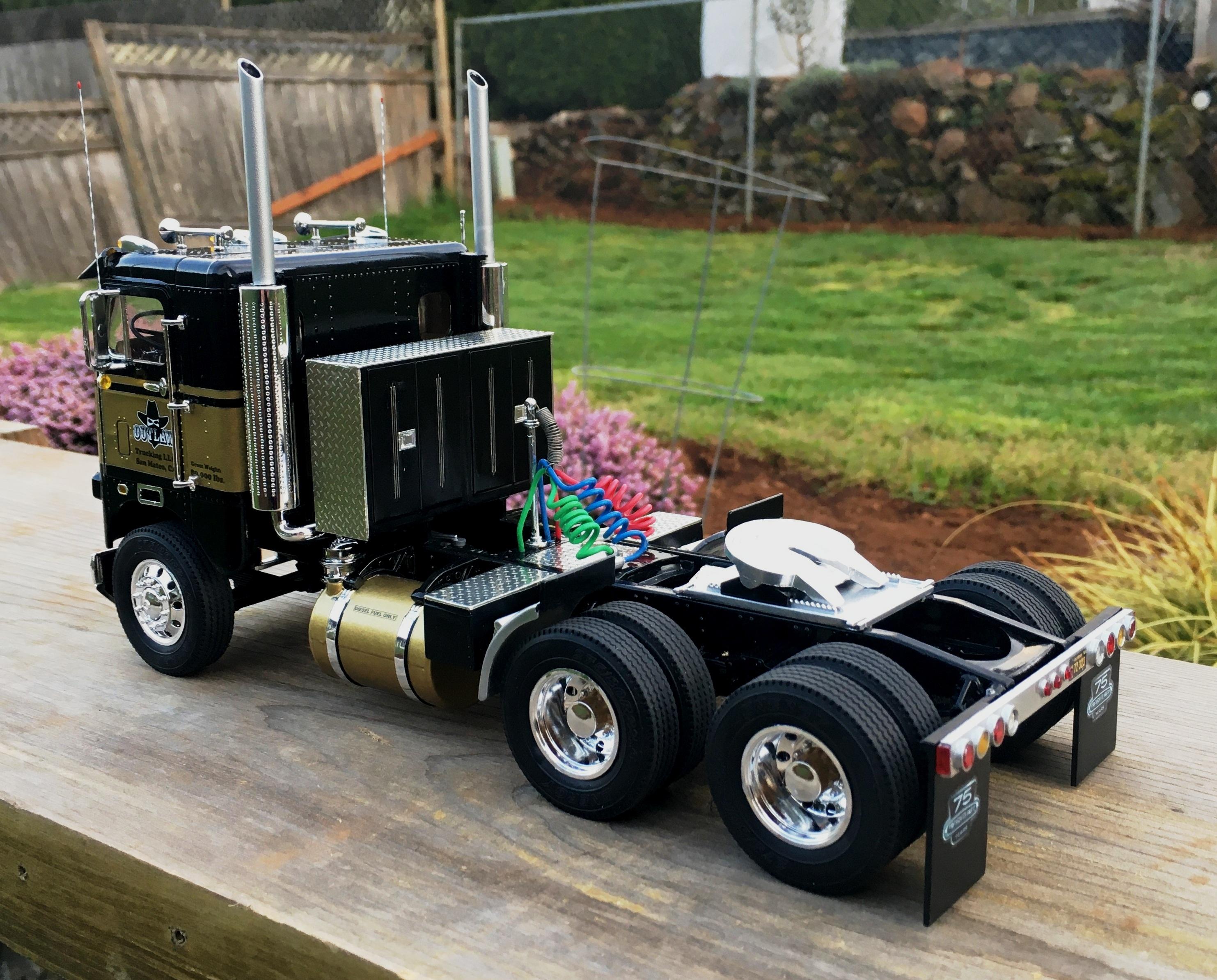

Goodwrench3 Posted January 19, 2022 Author Posted January 19, 2022 The Moebius tires (and wheels) are really nice. I used the AMT tires in the parts pack they produced on the IH Transtar 4300 and they fit really well.
tbill Posted January 20, 2022 Posted January 20, 2022 I’ve been using aftermarket tires on my AMT kits, kit tires are just horrible, sadly, I’m getting low on good tires though…., and KJ isn’t making tires anymore……
