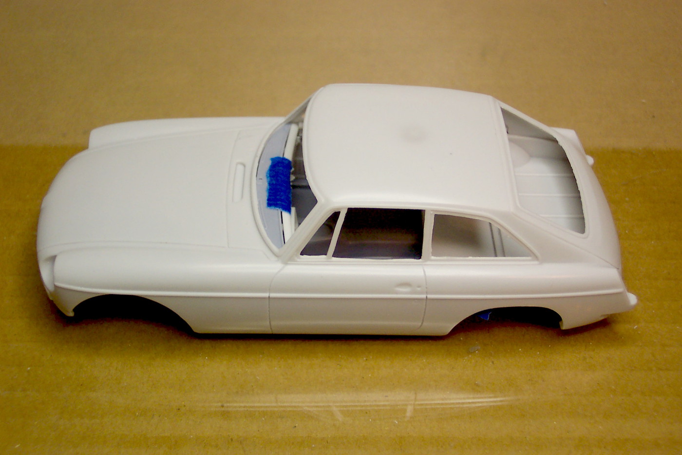

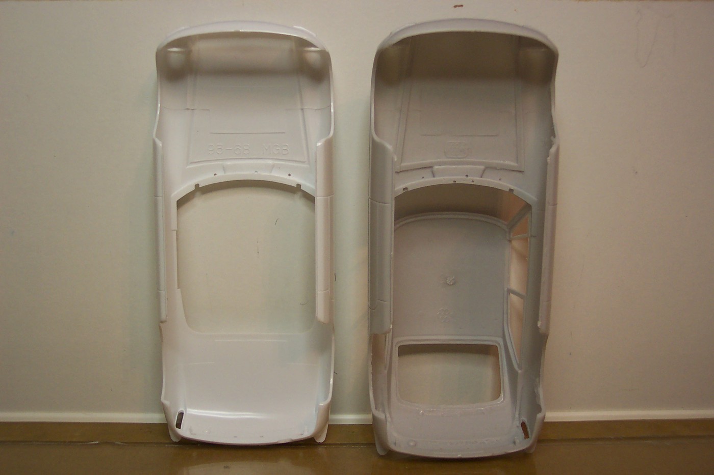

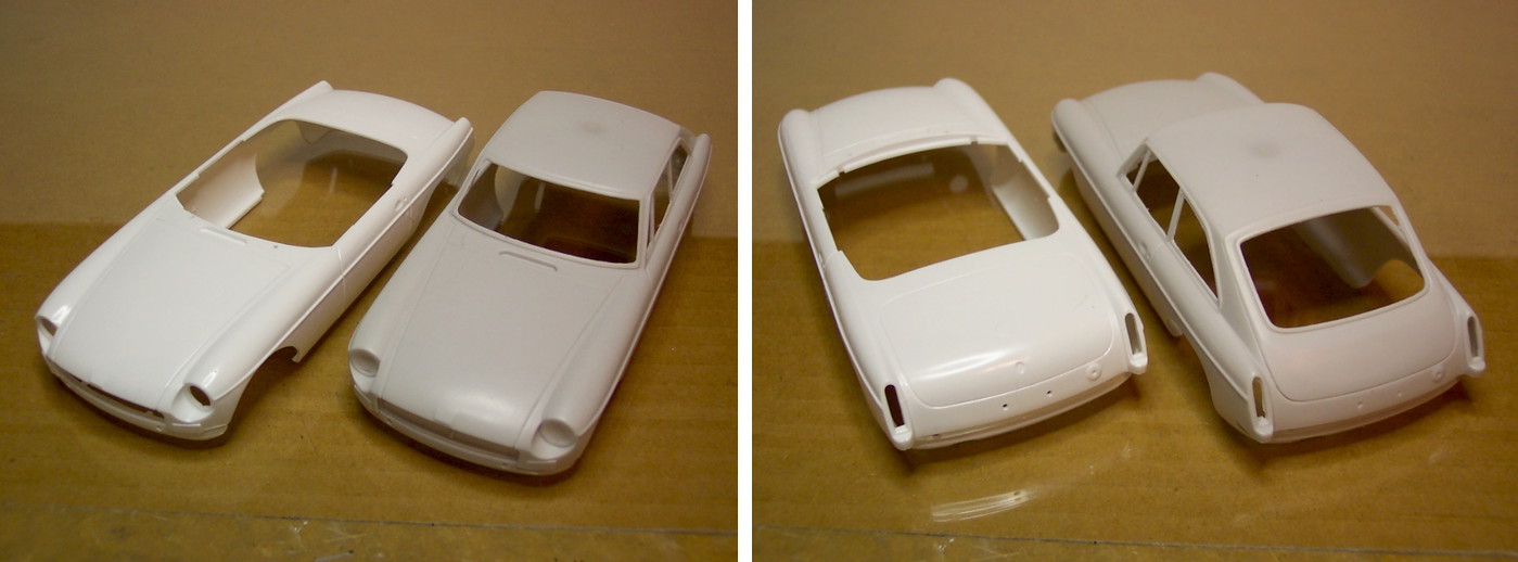

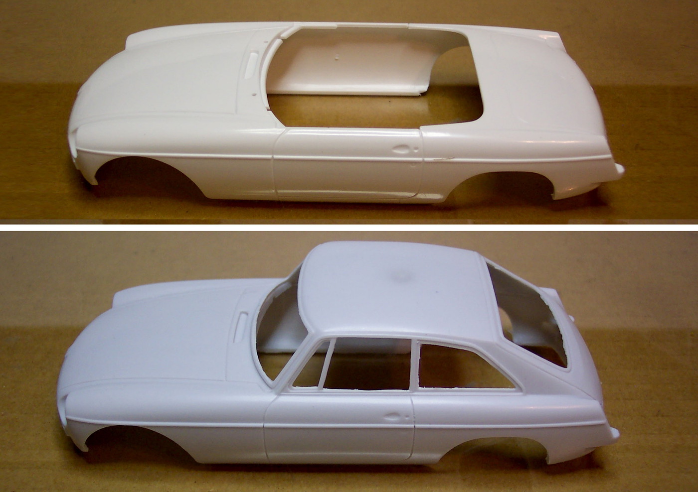

TooOld Posted January 22, 2022 Posted January 22, 2022 Time to get started on this C1 Models MGB-GT Trans Kit , I've already seen quite a few built and am looking forward to this one ! I'll be using the Aoshima '74 MG kit for this build . I'll also be building it with the chrome bumpers instead of the urethane ones . The '68 and '74 Roadster kits have both been reissued with different box art a few times but they are actually identical inside the box , with just a couple of exceptions . They both have the chrome bumpers but the '74 kit has two extra parts trees to include the urethane bumpers and tonneau cover , and a set of Rallye Wheels plus mirrors and gas cap . If your shopping for a kit buy the '74 , it's usually cheaper than the '68 kit . Before I begin here's a few photos to compare the C1 body to the Aoshima body . C1 has done an excellent job and their body looks like it will need little if any work other than prepping for paint . Looking at the inside note the molded in recesses around the windshield and windows . C1 includes some clear sheet and templates to cut the windshield and windows . They also duplicated these chassis mounting tabs . I didn't pay much attention to these at first but you'll see later that it's important they be used correctly . First thing I want to do is test fit the chassis and interior , and check the ride height . I used some Detail Tack to assemble the suspension . Here's the assembled chassis , the interior was just taped together for now . After modifying the interior with the C1 parts I'll check the fit in the body again . To fit the body gently spread it at the rocker panels and lower it over the interior . Insert the rear of the chassis first then while still spreading the body lower the chassis and insert the front into the body . It takes some fiddling around to get the chassis into the body so be patient and it will seem to just pop into place . This is where those mounting tabs become important . I had the chassis in and out a couple times fiddling with it and each time I just had it resting against those tabs , it fit okay and the interior seemed okay but the ride height was too high . I figured okay I'll have to modify the suspension to lower the stance where I want it . That's when I realized that the chassis fits "into" those tabs not just against them . Doing it the correct way not only made the interior fit perfectly , it lowered the stance about 2mm to where I had hoped it would be ! The color I'm planning to use is called Bronze Yellow . I also purchased the Mini Lites that C1 sells but I really like the look of those Rallye Wheels ! Interior modification is next . . . stay tuned !

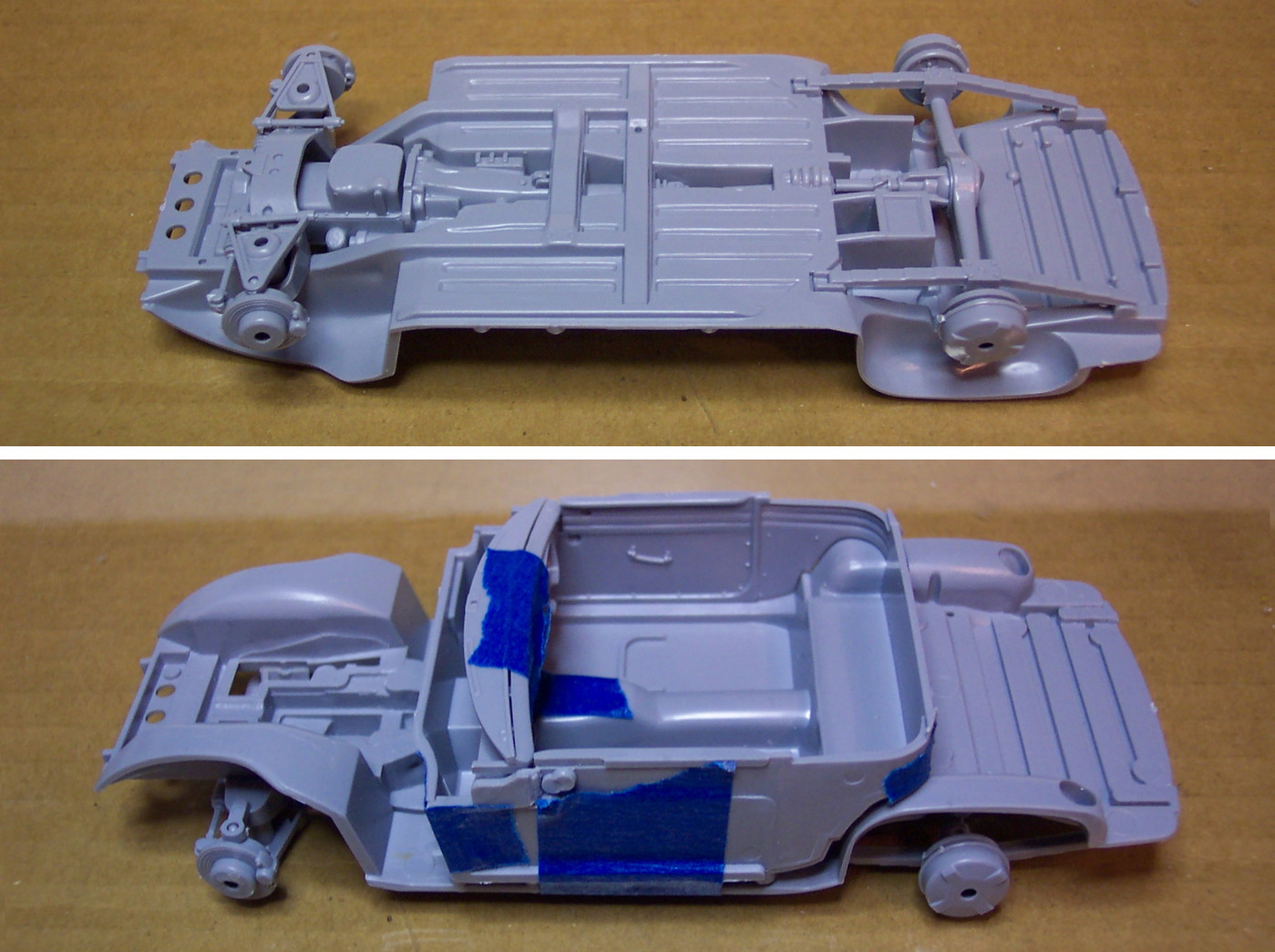

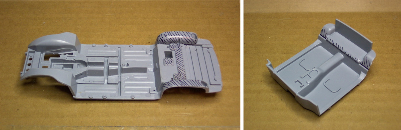

TooOld Posted January 24, 2022 Author Posted January 24, 2022 Working on the interior this morning . Here's the parts from C1 , all very cleanly molded with no clean up required . Also included is a left-hand dashboard , correct mirrors , and a nice PE set . Note the folding rear seat . The modification to the Aoshima parts require the removal of the shaded areas on the chassis plate and removing the rear portion of the interior . I started to use a razor saw but switched to my Dremel , more clean up but it's so much quicker . Here's the interior taped together and sitting on the chassis . I slipped everything into the body and it fits beautifully ! Other than cutting the windows out of the supplied sheet that's all there is to the conversion . . . very very simple ! 1

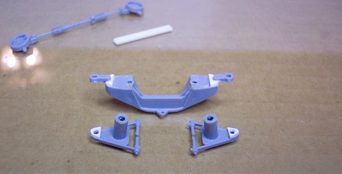

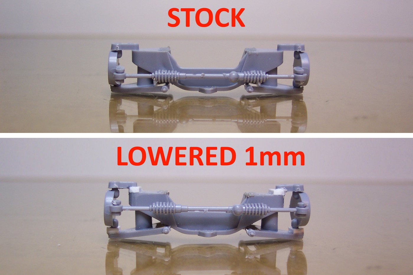

TooOld Posted January 25, 2022 Author Posted January 25, 2022 (edited) I saw this done in a video on youtube and it seemed easy enough so I decided to lower the front ride height a little using 1mm strip . Here's a before and after . And a photo with the front lowered . Edited January 25, 2022 by TooOld
gbtr6 Posted January 25, 2022 Posted January 25, 2022 That looks much better. I'd like to do one of those too. I would put the Rover (BOP) V8 in one. I also do 1/43 scale so there are a lot more LBC's available in that scale. Perry
Blueprint Posted January 25, 2022 Posted January 25, 2022 5 hours ago, TooOld said: That's a real beauty Perry ! Hard to believe there's no kit of such a beautiful sports car , I'd sure buy one ! My '75 is also Mimosa, with the same oem luggage rack as yours!
dbostream Posted January 25, 2022 Posted January 25, 2022 Based on the photos you posted earlier of the 1:1 car I think the front was already good. But I agree with gbtr6 it looks even better now. When I build mine I will keep it as it is because when I do modifications more often than not it gets worse.
