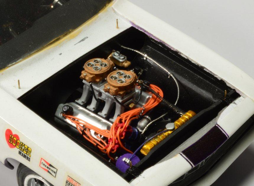

Straightliner59 Posted February 12, 2022 Posted February 12, 2022 I used Floquil Crystal Cote, on this 'Cuda, almost 40 years ago. The epoxy I used to glue the windows has yellowed, but, the clear is still clear! I wish they still made that stuff, too. 2
