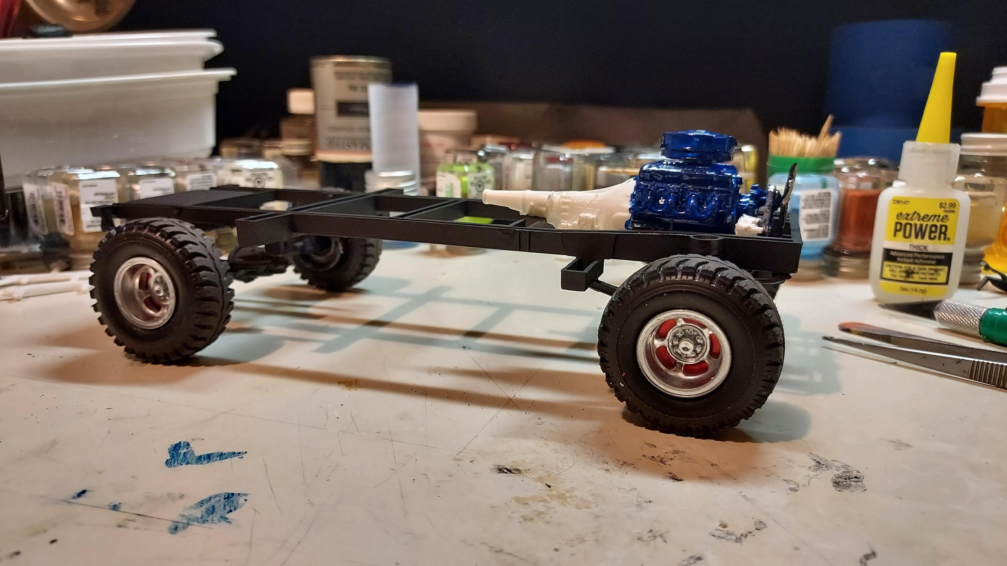

Mike C. Posted February 13, 2022 Author Posted February 13, 2022 I've been using that stuff on the right. I got it the last time I was at Hobby Lobby. I'm pretty happy with it but I learned not to use it on clear stuff . not pretty.
