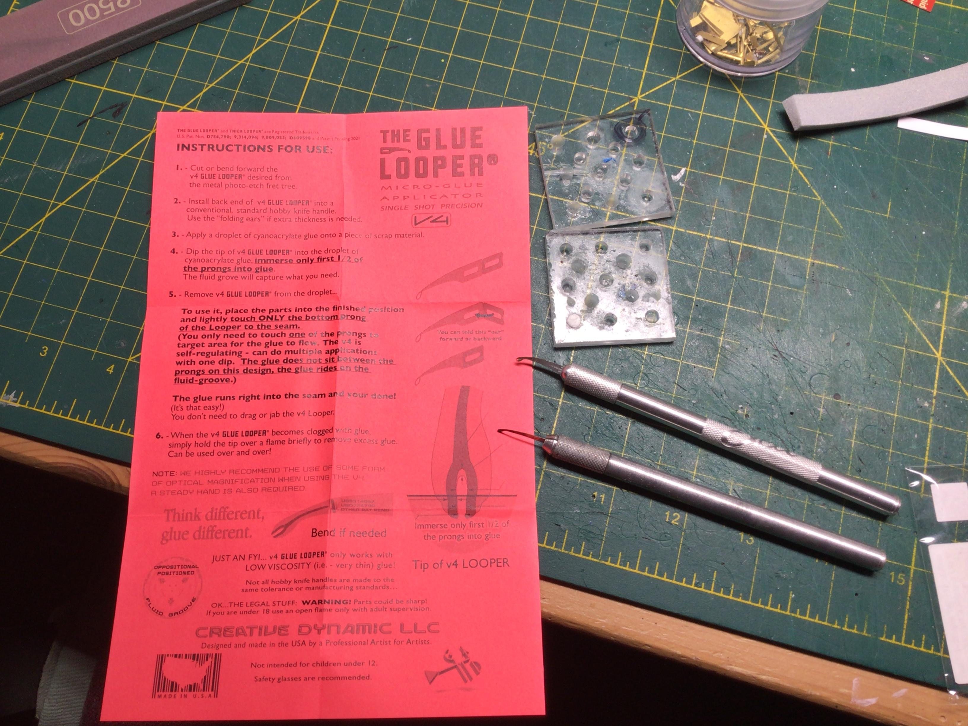

afx Posted February 14, 2022 Author Posted February 14, 2022 (edited) Anyone tried these? Edited February 14, 2022 by afx
NOBLNG Posted February 14, 2022 Posted February 14, 2022 (edited) 18 minutes ago, afx said: Anyone tried these? I use something similar, and they work great. They do have three versions depending on how thick your glue is, but I only use the ones for thin glue. I also made some glue wells from some thick plastic that will hold a few drops of glue that I can dip into. Edit: I actually never read these instructions until just now when I took the photo. I’ve been dipping it deeper than the instructions say and it works for me.?♂️ Edited February 14, 2022 by NOBLNG
