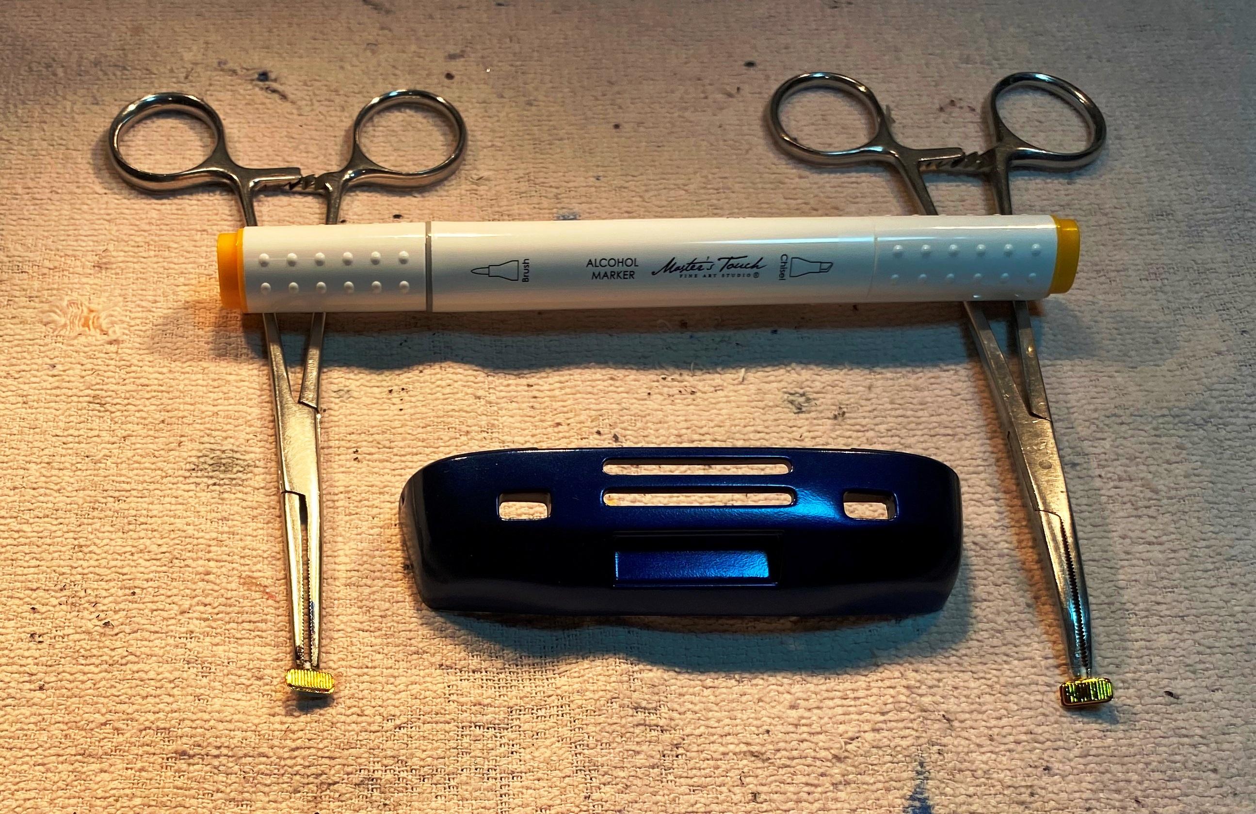

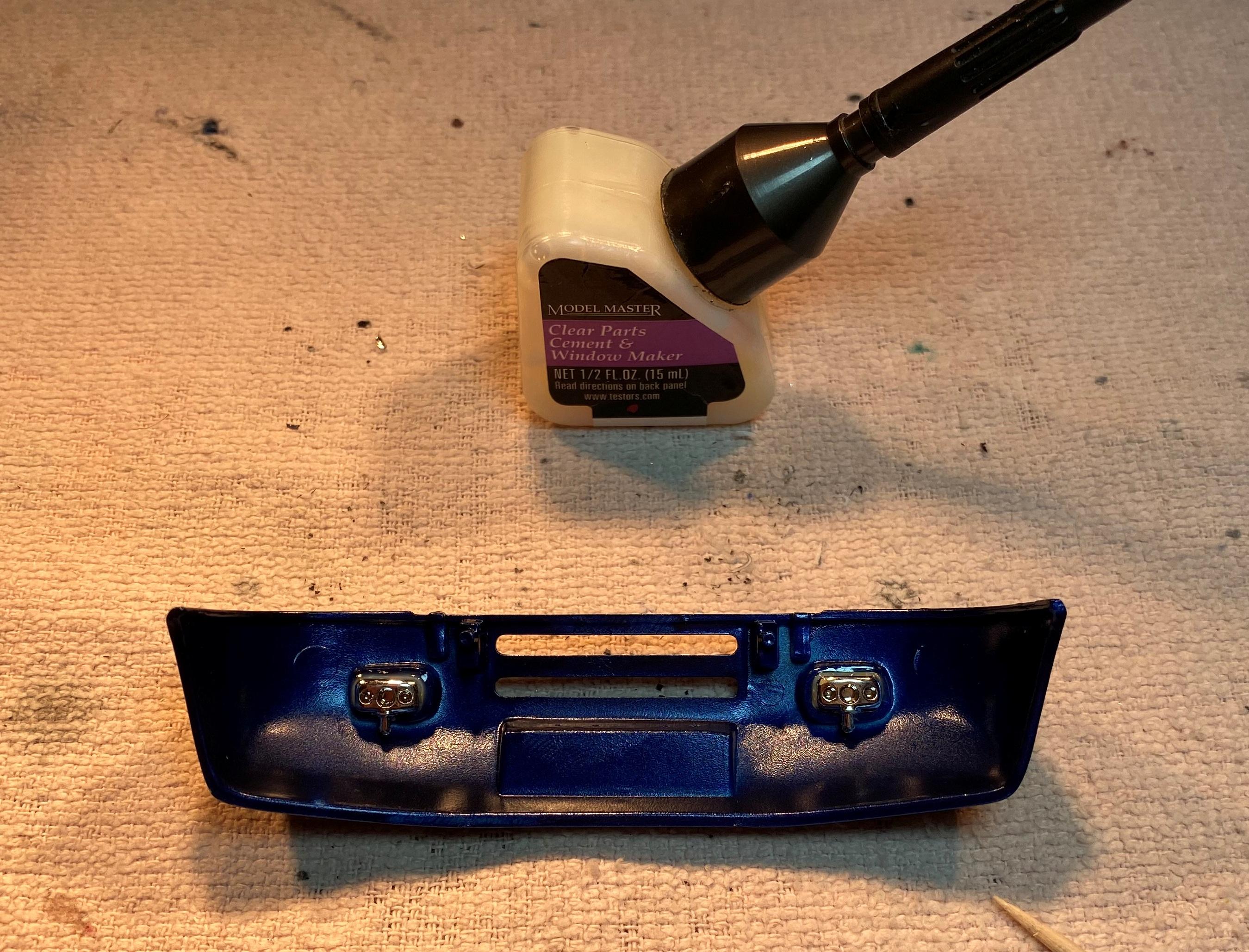

Bills72sj Posted February 16, 2022 Posted February 16, 2022 I like to have my amber lights stand out in contrast to the paint. I just used 3 different techniques for some running lights and fog lights on an ongoing build. I thought I would share them here in case they may work for you. #1a and 1b Chrome fog lights: These mount from the rear. I applied an alcohol based artist pen to change the kit chrome to amber. The fit and/retention location on these is very poor. I used Testors window maker to retain them as it wicks around the perimeter and dries crystal clear. #2 Cab visor running lights: These are each supposed to sit into an individual well. This really dulls/darkens the lenses. I opened up the back of each well and used BMF on the back side of the visor to add reflectivity. Once in place and lightly held by the BMF, I used Future floor polish to be the "adhesive" and gloss the lenses and the visor. #3 Side skirt running lights: Again drilled out the back side of the recess and retained the amber lenses. However, this time the reflectivity is provided by some Molotow applied to the back of the lens as BMF would be to far away due to the thickness of the part.

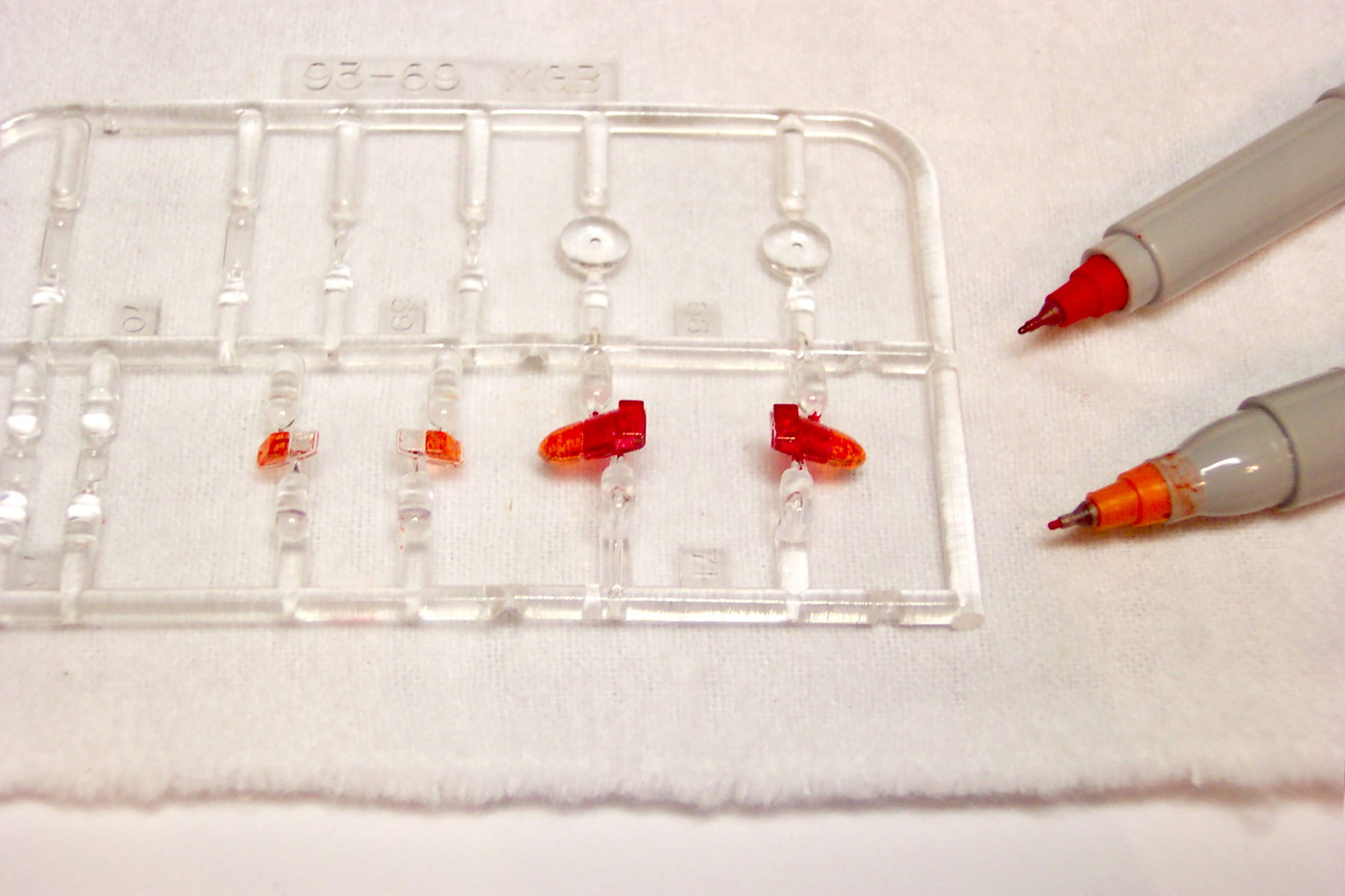

TooOld Posted February 17, 2022 Posted February 17, 2022 Red and Orange Sharpies , much thinner and easier to control than paint . Along with your choice of chrome or silver on the back if needed . 1

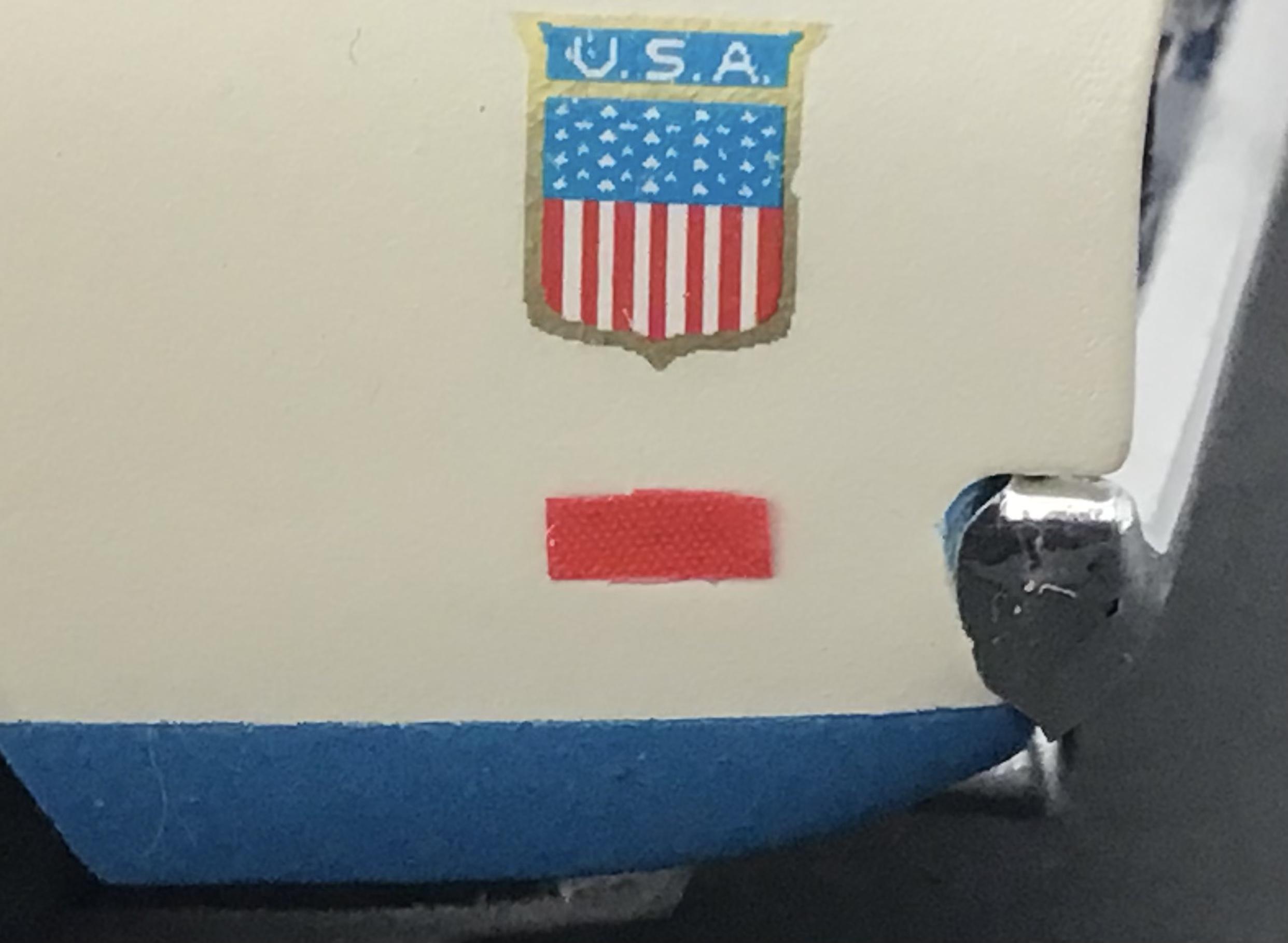

vamach1 Posted February 17, 2022 Posted February 17, 2022 When there is no part and where typically I would just paint the area using the yellow or red Testors colors, I found some reflective bicycle tape and cut out the size to fit the recessed area and glued it in. The cool thing is the material has a nice pattern and is truly reflective just like a rear car.

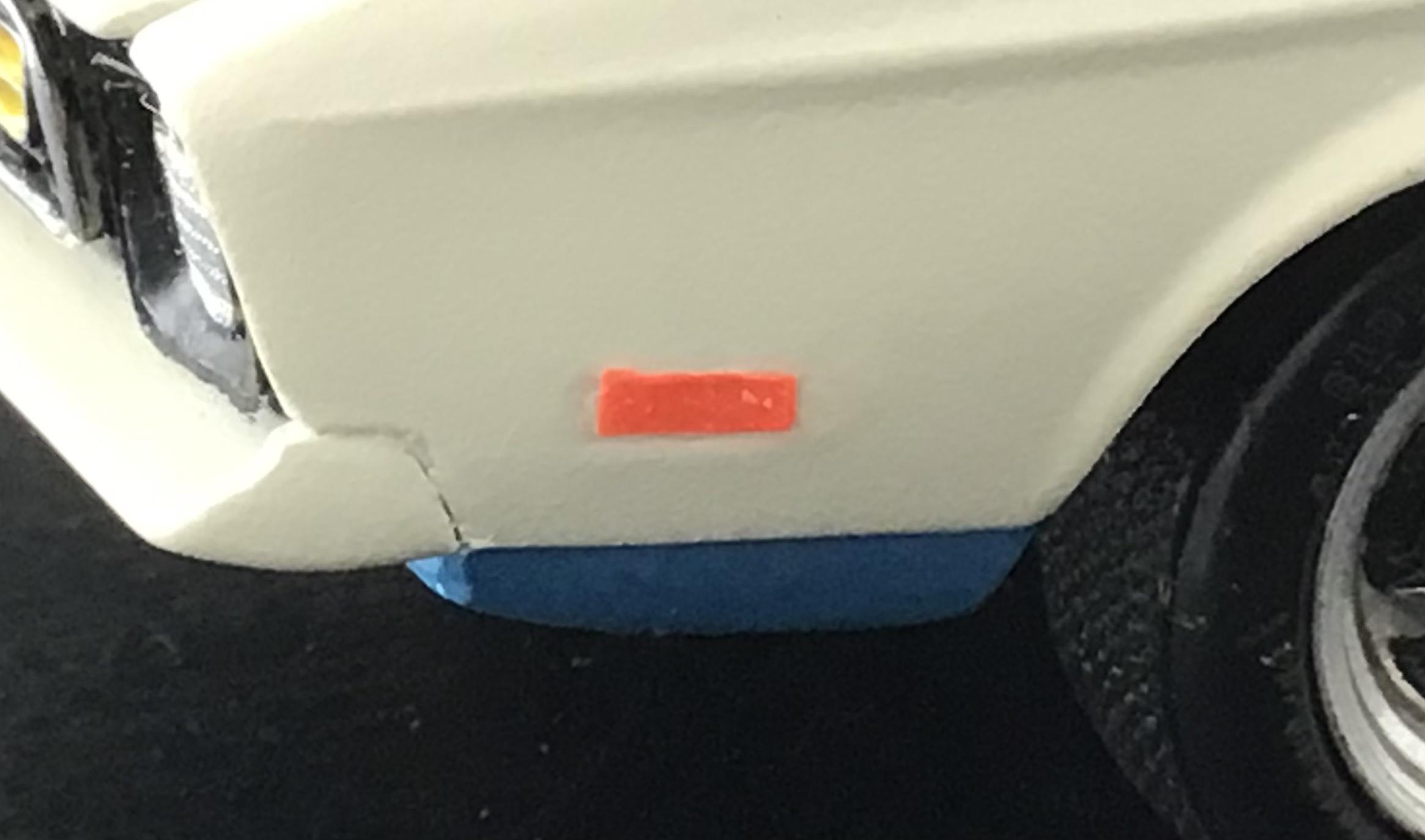

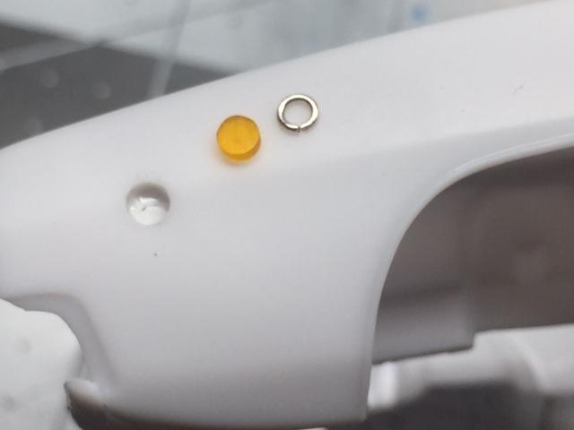

W Humble Posted April 8, 2022 Posted April 8, 2022 I have a footlocker full of 'Scotchcal' (and other brand) sign-makers vinyl, sticky-backed and press-on; works pretty well for lights, and other stuff. Larger circles can be neatly cut by using gasket-die cutters from Harbor Freight. BTW, cutting shirt-box plastic for big headlight lenses with the cutters comes out very nice if backed with a couple of layers of file-folder manilla card; it imparts a domed/convex effect! 3M: All scraps, including residue from sprint-car wing graphics, ctc. Metalflake and all. I'd share... but it would be complex, I suppose. I keep all my broken/replaced 1/1 car light plastic; a lot like tooth-brush material for making lights. Lite-Brite pegs are great, too, for customs/rods. I like the shiny 'jump-rings' from the craft store jewelry wall; lots more there for car modelers, of course! Gees, lots of great ideas!!
