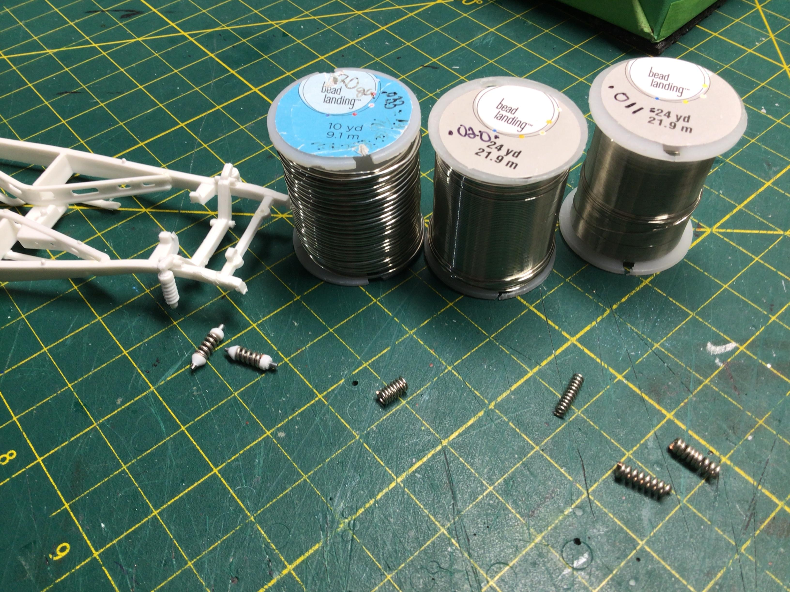

NOBLNG Posted February 17, 2022 Posted February 17, 2022 (edited) I have used this wire from Michaels. It is soft and has very little spring back to it. I have a large set of numbered drill bits and wrap it around the appropriate sized bit. Edited February 17, 2022 by NOBLNG 1

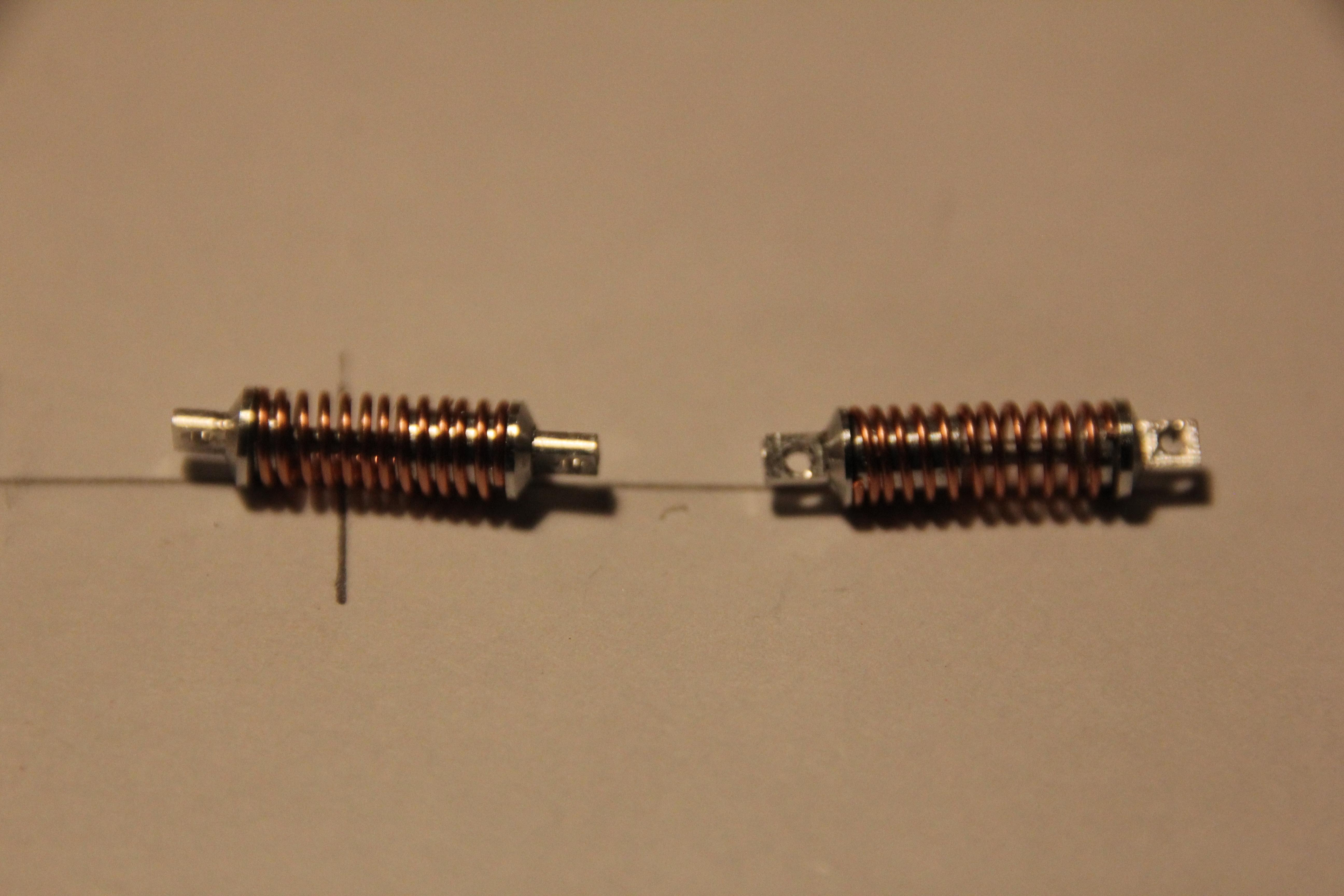

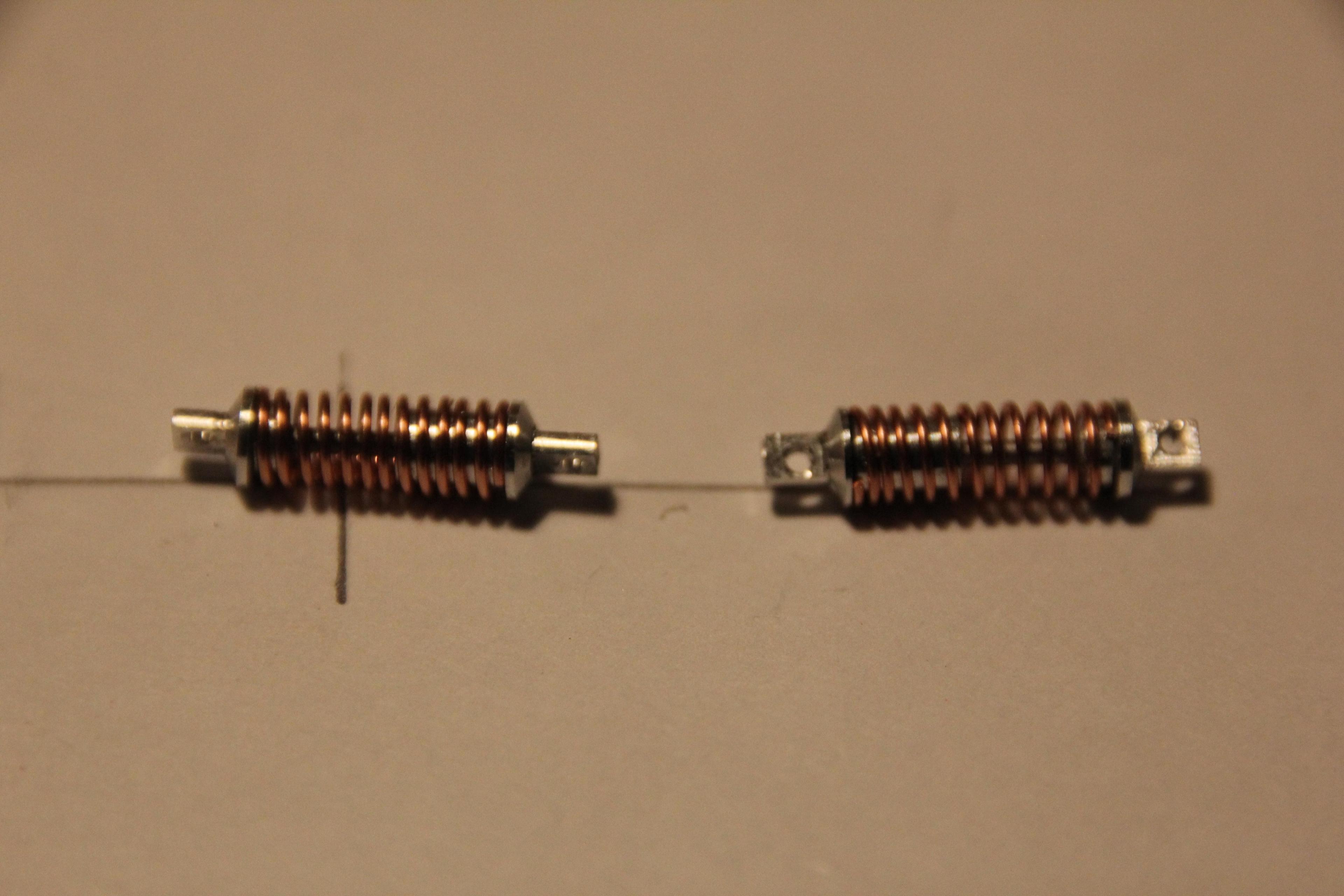

bill-e-boy Posted February 17, 2022 Posted February 17, 2022 I use something similar to @NOBLNG that I got from a craft store. It is silver plated and soft I wrap it around a metal thread screw to get even spacing of the coils I also use coper wire strands from power cables as in pix 1

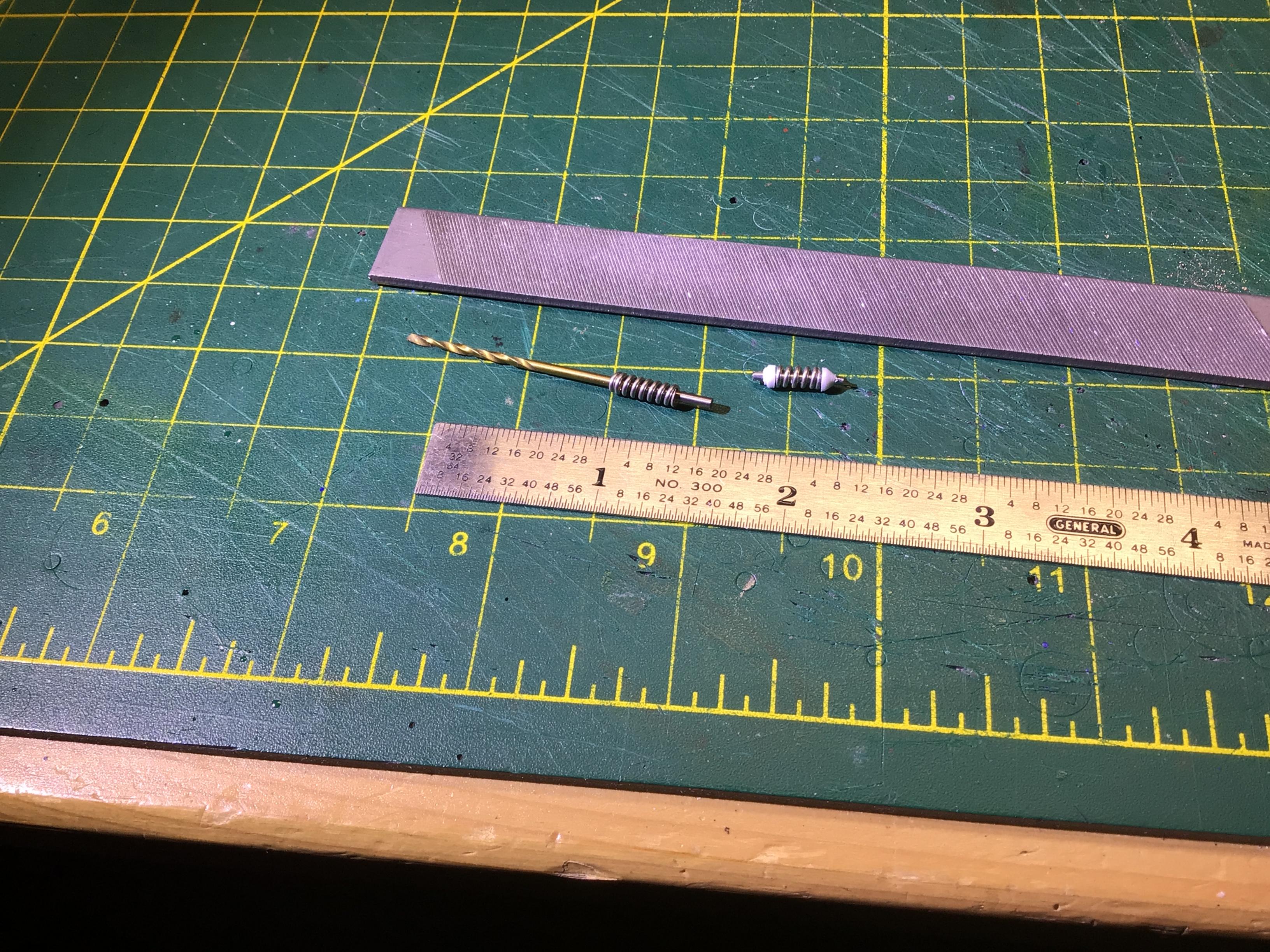

NOBLNG Posted February 17, 2022 Posted February 17, 2022 (edited) 10 hours ago, CabDriver said: Nice job on those! What’s your technique? Just wrap ‘em around a round thing? Yes. I use the butt end of a drill bit because I can get exactly the O.D. that I want due to the incremental sizes of the bits. Once I have it wrapped tightly, I roll a straight edge (usually my little 6” steel ruler) between the wraps while still on the drill bit to set the gaps evenly. Then slide the coil to the end of the bit and file the end square. The amount of gap could be adjusted by using a thicker or thinner straight edge. Edited February 17, 2022 by NOBLNG 1

OldNYJim Posted February 17, 2022 Posted February 17, 2022 3 hours ago, NOBLNG said: Yes. I use the butt end of a drill bit because I can get exactly the O.D. that I want due to the incremental sizes of the bits. Once I have it wrapped tightly, I roll a straight edge (usually my little 6” steel ruler) between the wraps while still on the drill bit to set the gaps evenly. Then slide the coil to the end of the bit and file the end square. The amount of gap could be adjusted by using a thicker or thinner straight edge. Those even gaps were what impressed me - nice job! Thanks for sharing your process Greg!
NOBLNG Posted February 17, 2022 Posted February 17, 2022 (edited) 2 hours ago, CabDriver said: Those even gaps were what impressed me - nice job! Thanks for sharing your process Greg! I do get some rejects.? The winding it around a screw idea might be easier…if you can get the right sized screw. One thing the drill bit method allows is the ability to wind left and right hand springs. Edited February 17, 2022 by NOBLNG 2
