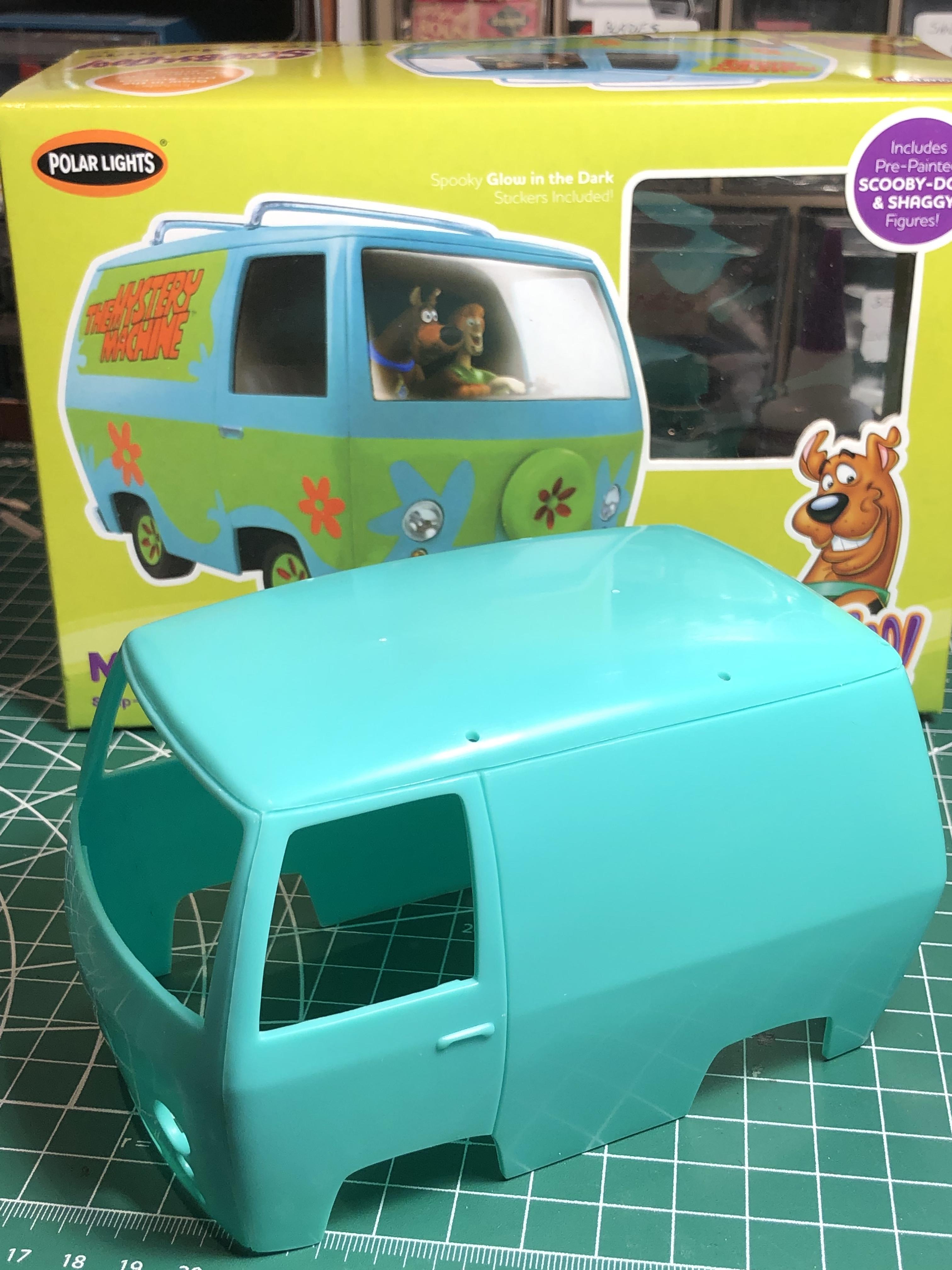

I bought this many years ago to build with my daughter. We built a pink Hummer, but never got to Scooby and Shaggy’s ride. Time to remove it from the stash…

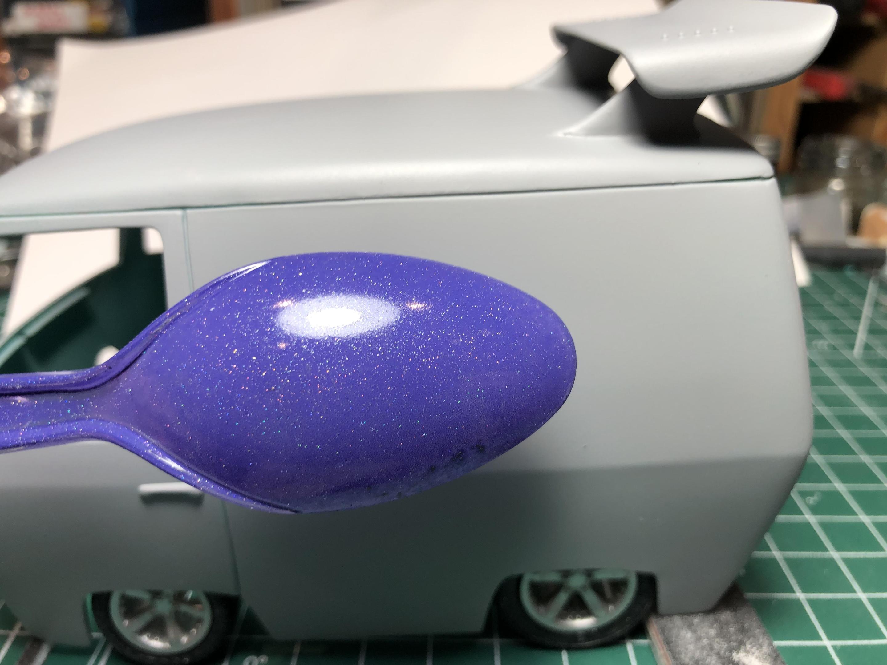

The plan is to keep it very cartoony looking. Slammer, with no interior. I have a handful of paint ideas to spoon test for this one.

I gotta be honest guys, I wasn’t expecting ANY interest for this one. Thanks for having a look and commenting. I painted a bunch (12) spoons today, should have it narrowed down to 2-3 tomorrow.

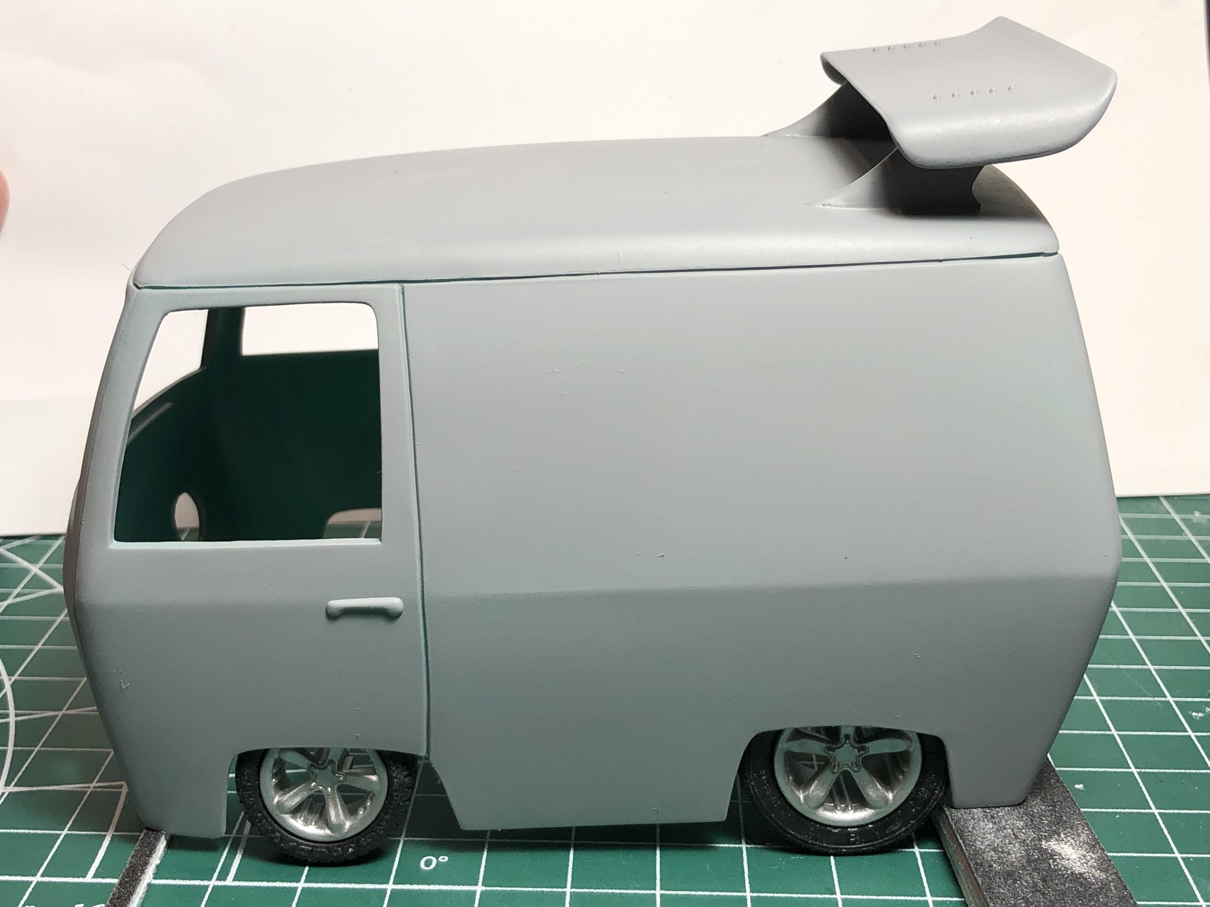

Hi all, still haven’t had much desk time. Just enough done to throw a quick mock up together. This will give you a flavour of where this is going. I had a fun dive into the parts bins and decal box the other night. Saving some of my finds for later.
Added the wing from “fast buck”
Colour will be Tamiya TS 24 purple, with Tamiya  “lame flake” for some sparkle.
I plan on going heavy with the lame flake to keep it “cartoony”. Found some fun graphics in the decal box, they are really old though. I’m hoping a coat of decal bonder will keep them from falling apart. I spent some time today messing around with what will be one of the key features of the build. No photos yet, I have some more to do before I share.

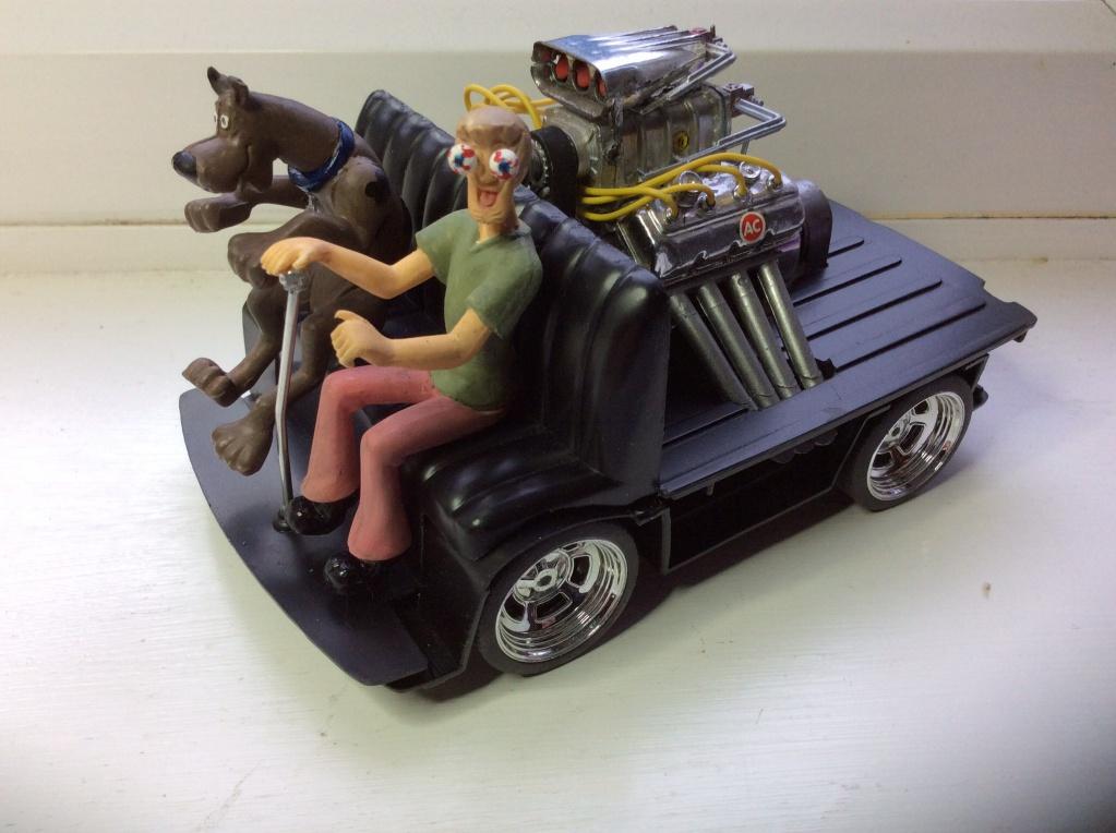

CE828894-DA67-41B4-8B3C-E9E4538DC508.jpeg.c38621681520d9b9fd9b41d1bc0ef741.jpeg12B4DA93-8920-4B63-9FBC-0F56C8FE57E3.thumb.jpeg.bd307b86676bd1edb75e5bb4eba83db2.jpegE68B1F0F-A750-4A60-ABEE-C4905304B979.thumb.jpeg.29693f6dbe635e9ed742aefe7bea2f33.jpeg36DC7E78-5302-4D21-8D6F-0C94055C7C18.thumb.jpeg.8f4574aaac510cc263e7e141cddc1b43.jpegI carried out a fun build on this kit several years ago and ended with this.
Haha !!! I saw this build. Stuart, this thing is awesome! It made me laugh when I saw it, Shaggy’s eyes tell the whole story. I actually considered doing a  VERY similar build, but have decided to take an easier route. Thanks for sharing that

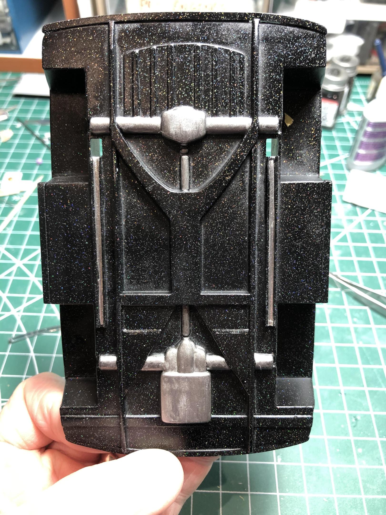

Well, I finally had a bit of bench time. I know, I said this was going to be quick…

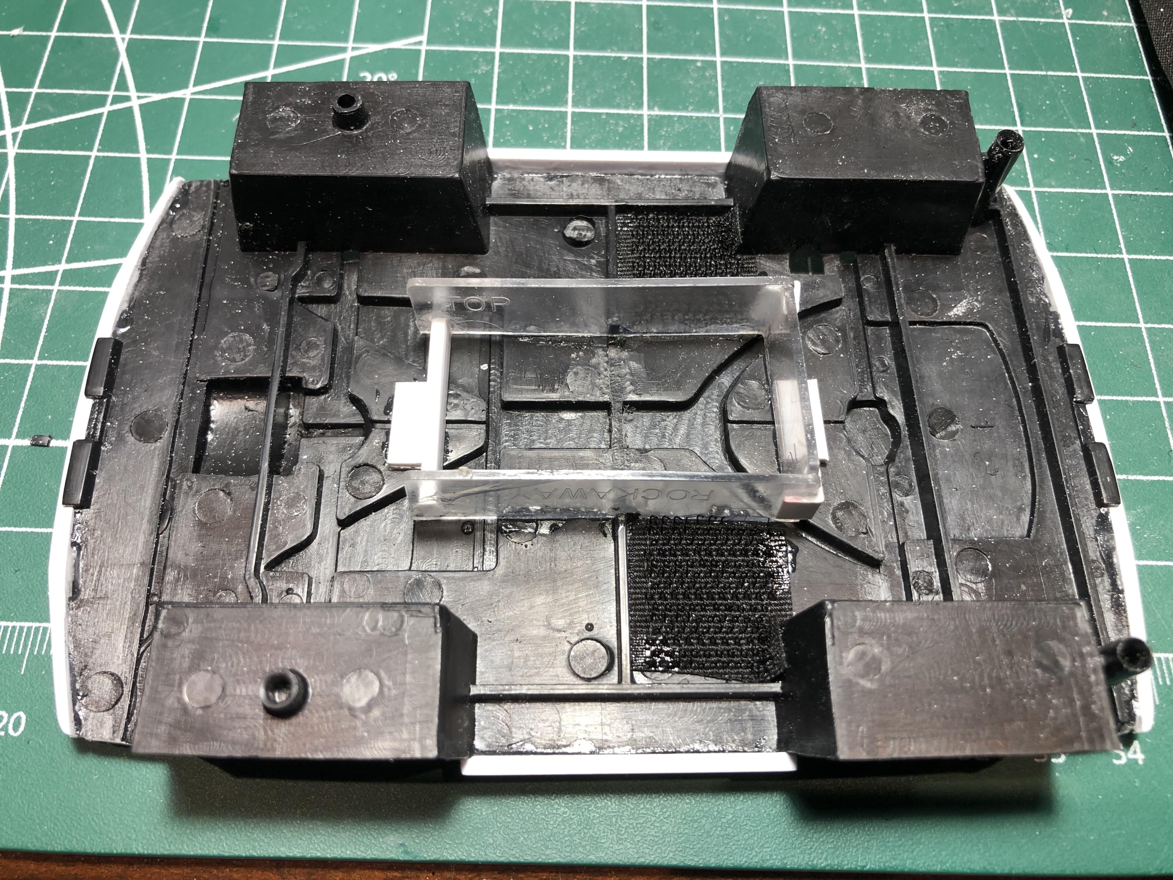

Here we go…. To get the ride height I want, (low), I’m tucking the chassis up in the body a bit. I needed to add some length and width to the chassis for a better fit.A3A8F3B6-8992-44E3-839F-4DC7B9217984.thumb.jpeg.9c7fdc8e8b6515da5f8fa464a74c4bf3.jpeg

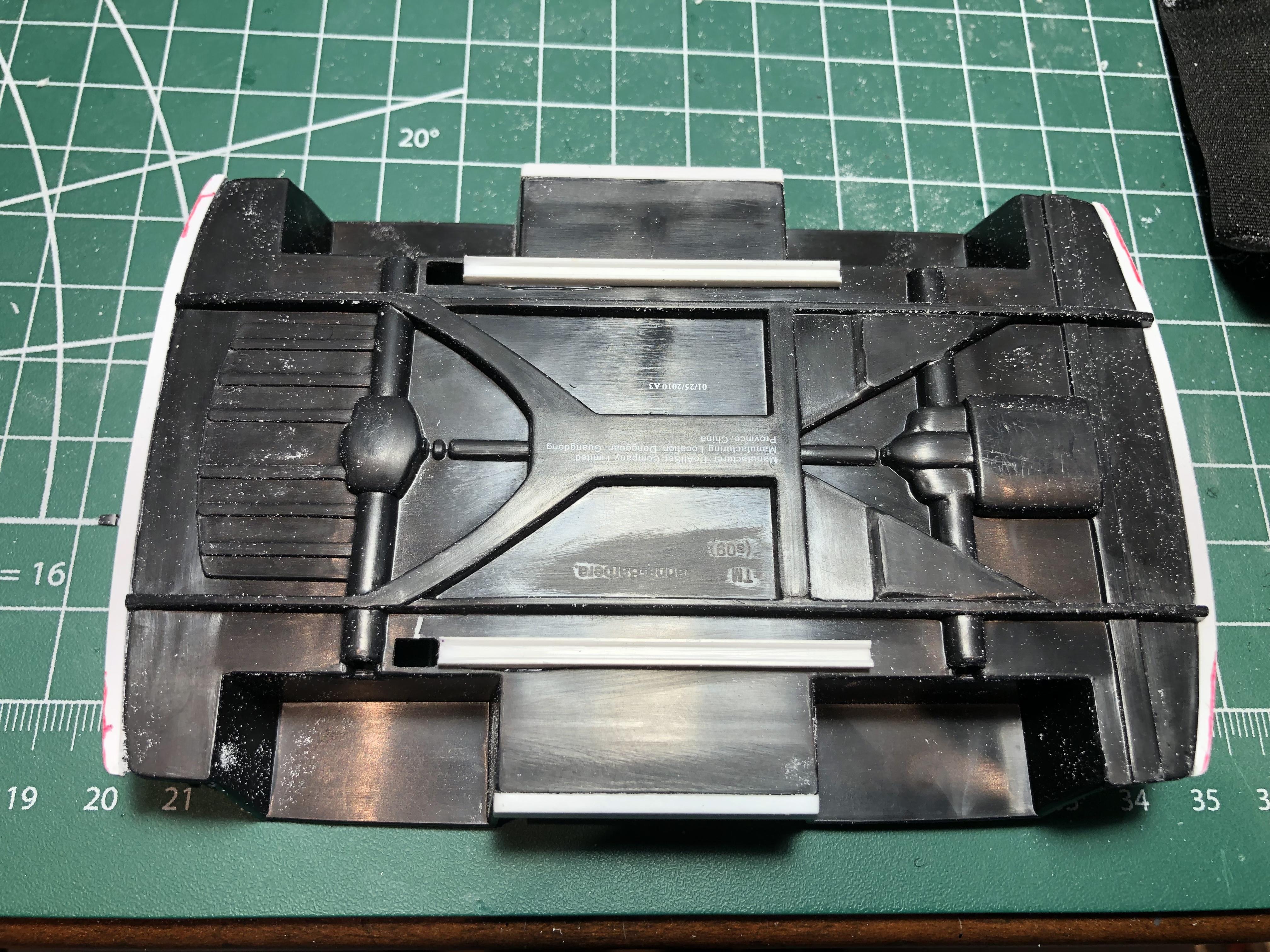

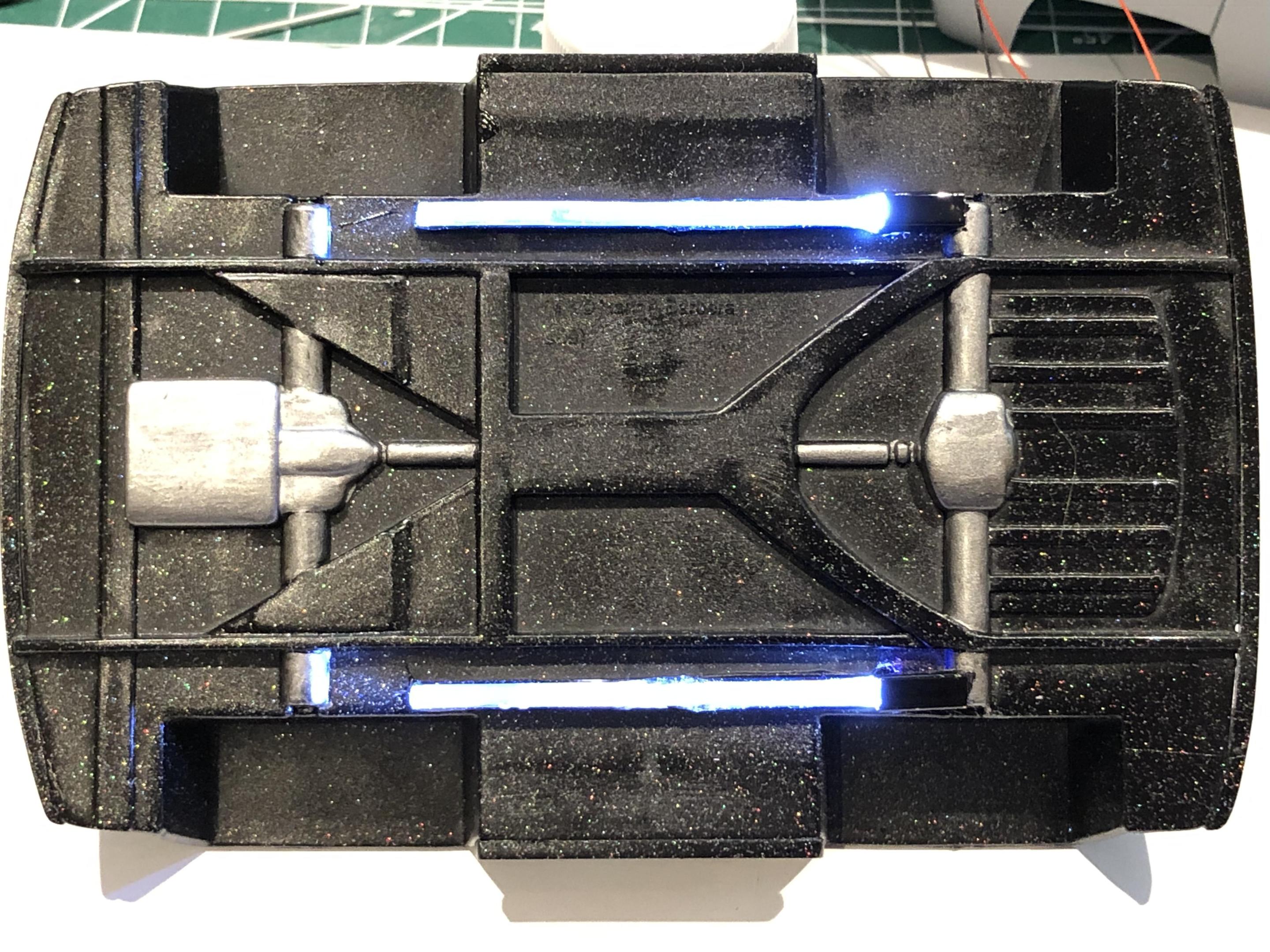

chassis painted, obviously I did not spend much time here… I spayed some of the Tamiya “lame flake” on the chassis, then a bit of brush painting. The 2 channels running between the front and rear axles with holes near the rear axle will make sense in a minute.

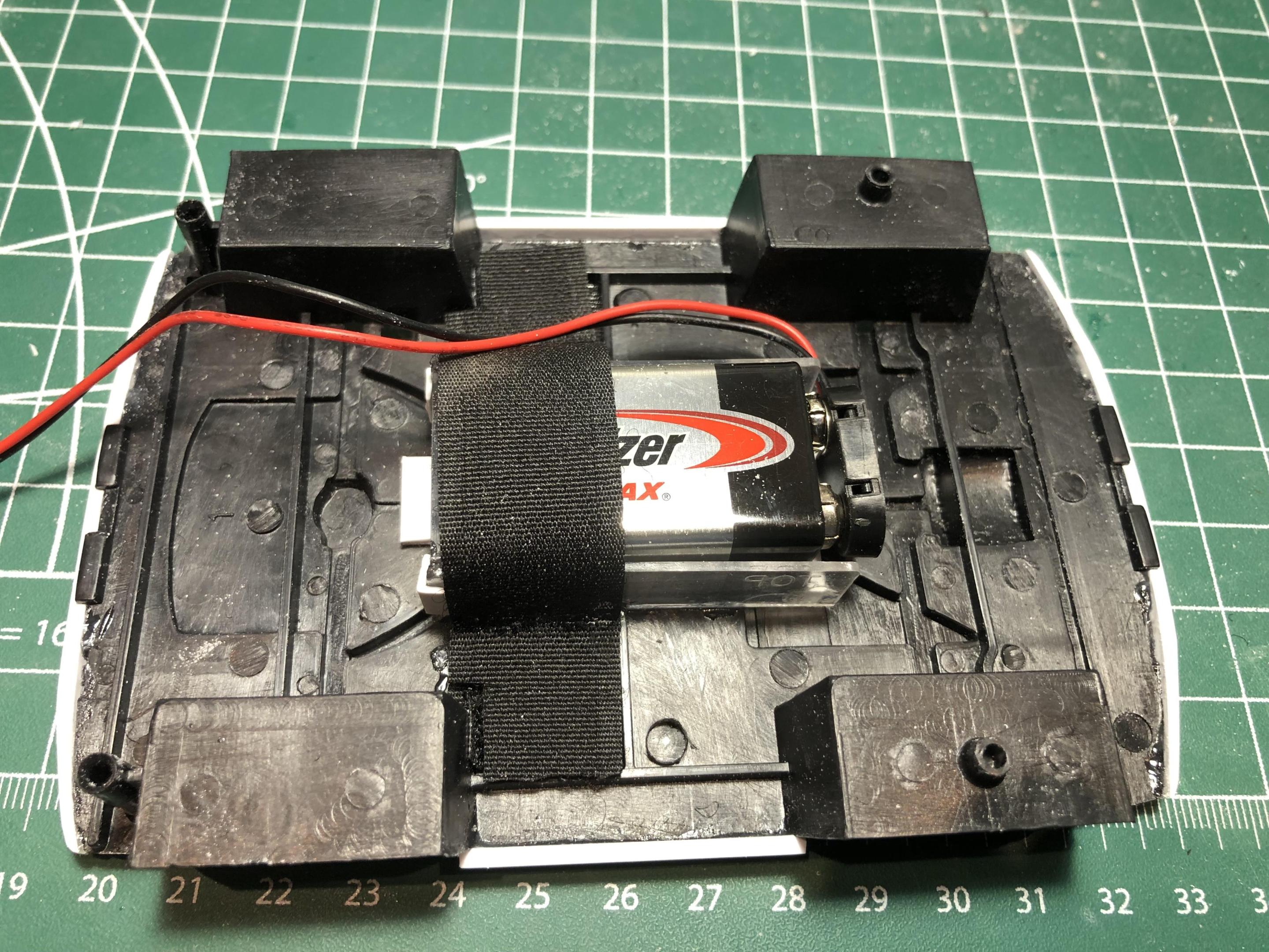

On the top side of the chassis, I added a fairly crude, but functional battery holder complete with Velcro strap.
So the channels on the underside have some BMF for reflectivity. The holes are for lights. The plan is to make some “tubes”. I’m not sure how many of you remember the neon tube trend from 20-25 years ago. The tubes gave an illusion of the car “floating. Evans Designs makes a product called side glow fibre optics.
If anyone here has interest in doing lights on a car, or diorama, I highly recommend this company. I have no affiliation with them other than being a happy customer. Great products, website, service, and fast shipping.  So after tinting a couple of lights with clear purple and attaching them to the tubes, you get this…
Not the best photo, but hopefully you get the idea. They look pretty good!!

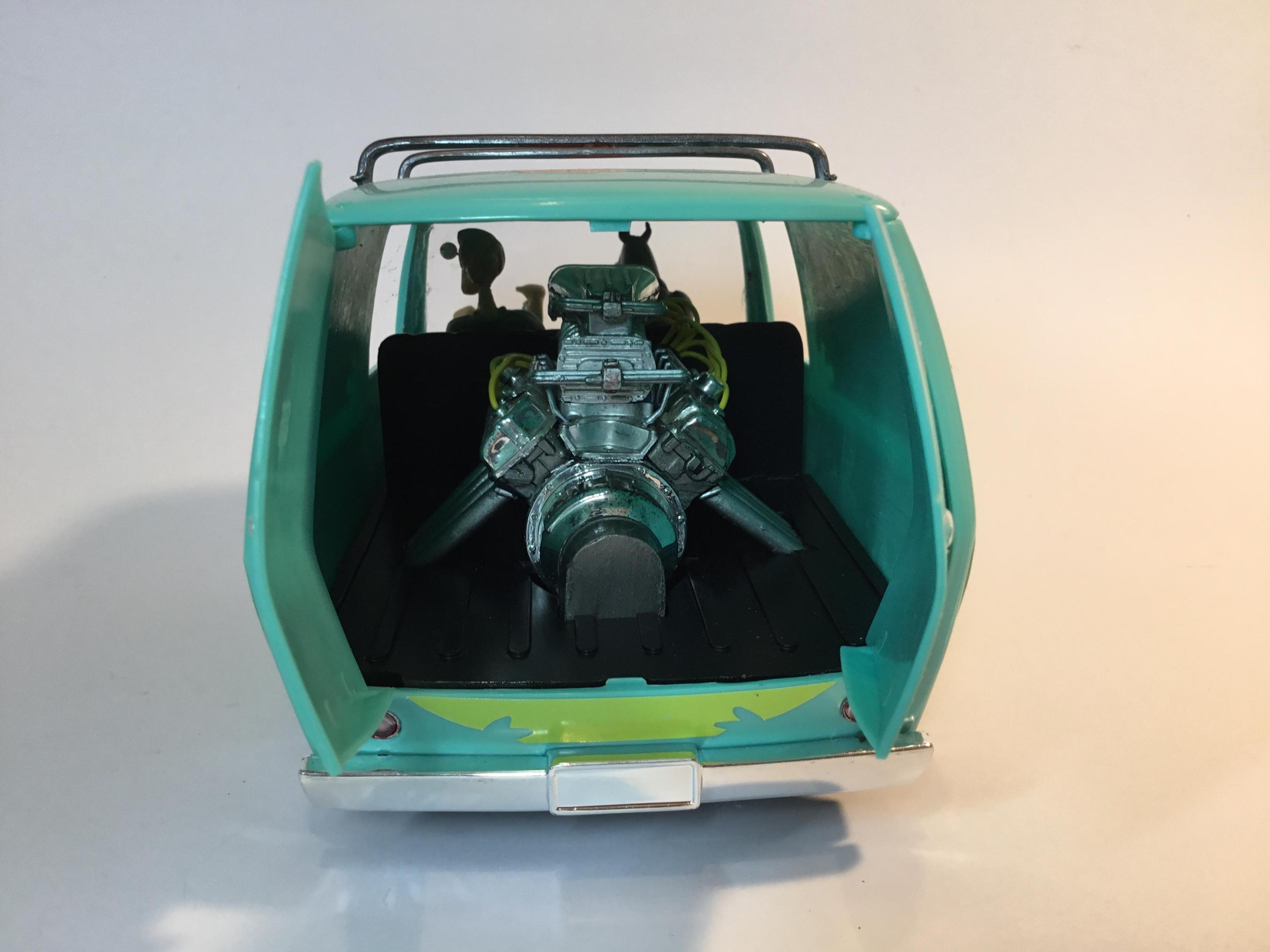

The front needed “something”, so after playing with several options, I decided on the Peterbuilt grill. This keeps with the cartoony look
You may have noticed a bunch of holes in the body, here a few of the items to fill those. Airhorn from the parts bin was hollowed out for “realism”
Here we have roof rack hoops made from wire, search light, ornament for grill, air horn, antennae made from wire with ball from a pin, the alligator clip is holding the base of the antennae which is some styrene rod and aluminum tube, the big “bolt” will be the gas cap.

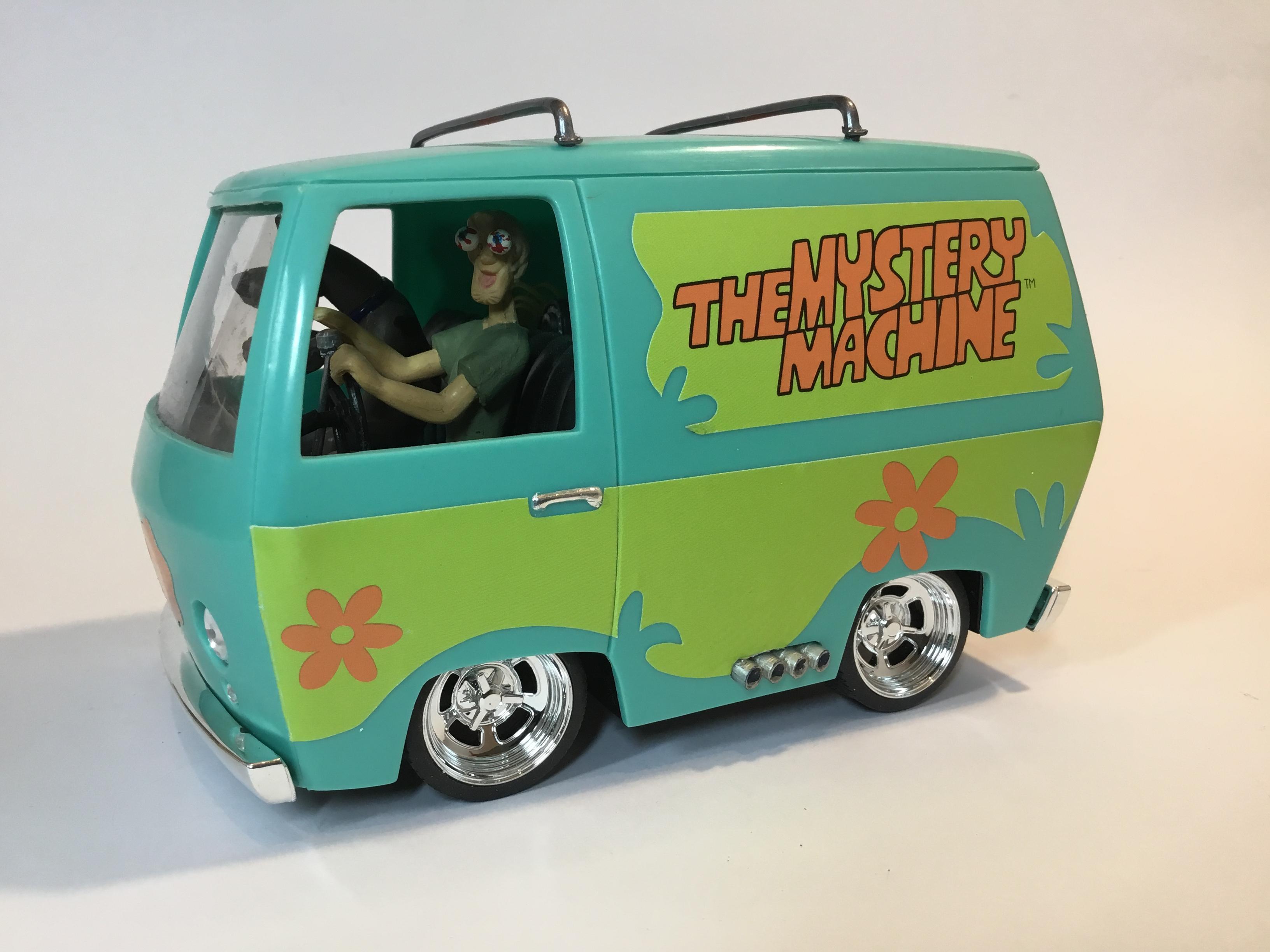

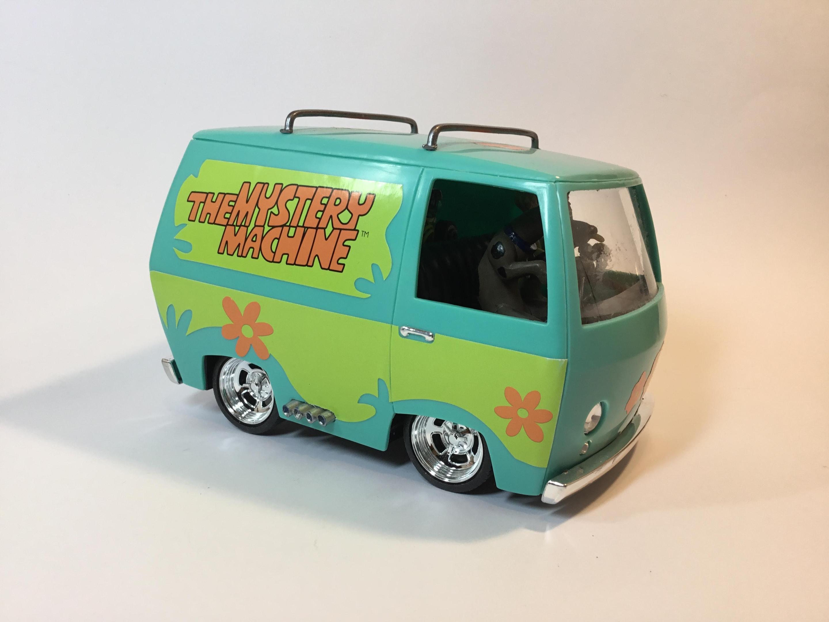

And here’s the Mystery Machine in purple.

So with the Tamiya TS 24 purple dry, it was time for the Tamiya “lame flake” (I would call it speed boat metallic). The pictures don’t really capture the prism effect of the paint. There is a fairly dramatic rainbow sparkle to it. Maybe I’ll try a video when it’s done.
The good news is the paint creates look I want, the bad news is the finish is like sandpaper due to the size of the flakes. After that it was time to start applying the decals. I had fun digging thru the decal box for this one. The multi coloured graphics are OLD, my guess is 35 years, just a guess tho. They were fragile, and there is a couple of places the decals came apart, but the decal binder seemed to hold them together fairly well.
The roof rack will have a surf board, so I used a bunch of surf related decals. Scooby’s door has K-9 unit decals, Shaggy has Dare unit.  The idea here was just to have some fun. After the decals “cured” I applied a mist coat of Mr Hobby clear, then 2 light coats of Tamiya pearl clear, then 2 medium coats of Mr Hobby clear. I was optimistic that after all that, the “sand paper” finish would be something I could polish. It’s still a bit “chunky”, ya… chunky. Not exactly what I wanted. So I’m on the fence, I could add another few coats of clear so I can shine it up,  or just call it good.
As I was doing my parts box dive for bits, I came across some old running lights (I think from the 1/20 scale Highjacker van). They were a bit rough, but definitely usable for this. The lenses came out in one piece, so I cleaned up the glue schmeeb on the back of the lenses. Sanded the styrene post off, then made longer posts from aluminum tube, they intentionally too long to keep things cartoon like. Paint is Tamiya pearl light red, molotow chrome reflector, Lenses got a coat of clear yellow on the back.
