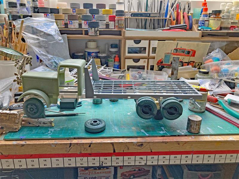

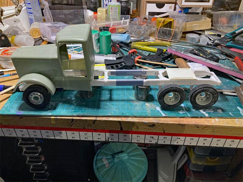

carsntrucks4you Posted February 21, 2022 Author Posted February 21, 2022 (edited) Here three different options for my 351. I had added 1.772" to the frame Option 1: Sleeper (from Movin On KW) Option 2: Day cab Option 3: Flatbed (Kit from The Modelfactory - No longer in business) My preference is option 3, although the Page & Page suspension is then not visible. Other wise I could use a Hendrikson Rubber Block suspension with some Rockwell Worm drive axles. instead. Let me think about Edited February 21, 2022 by carsntrucks4you

carsntrucks4you Posted February 22, 2022 Author Posted February 22, 2022 (edited) 2 hours ago, leafsprings said: You are building one of my favorites, appears to be an early 60's version. Most of these resins are curbside, but it would be nice if the hood panels opened up. A Cummins would be a much more common site in this type of vehicle. Great choice on lengthening the frame, IMO, most conventional frames in most kits are too short for western trucks. Were you thinking of a flatbed truck with short flatbed trailer behind it? I had not decide yet if I use the DD 6V71 or a Cummins NH250. If I could get a P&H or Scott engine in 1/25 these would be my favorite engines for a truck from the late 50's / early 60's. The longer frame looks better even without a sleeper. But I want to do the Flatbed truck and yes I'm going to build a 2 axle flatbed trailer like in this picture from Tim Ahlborn Edited February 22, 2022 by carsntrucks4you
carsntrucks4you Posted February 22, 2022 Author Posted February 22, 2022 (edited) The Pete will be a flatbed truck. I rear suspension will be a rubber block with Rockwell worm drive axle. Edited February 22, 2022 by carsntrucks4you

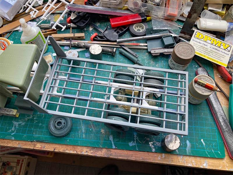

carsntrucks4you Posted February 24, 2022 Author Posted February 24, 2022 Last crossmember has to be relocated it interferes with the last axle. Rear of frame had been extended with 3d printed frame rails like in the middle. The braces in the cab will be removed after painting.

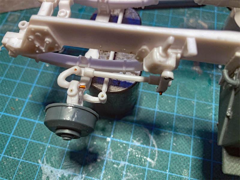

carsntrucks4you Posted February 25, 2022 Author Posted February 25, 2022 Working on the front axle, it is now manoeuvrable.
Gary Chastain Posted February 25, 2022 Posted February 25, 2022 Question, did you use an axle that was molded in pieces, or did you cut apart a fully molded axle? I have heard of guys cutting apart axles to give them the ability to turn.
carsntrucks4you Posted February 25, 2022 Author Posted February 25, 2022 29 minutes ago, Gary Chastain said: Question, did you use an axle that was molded in pieces, or did you cut apart a fully molded axle? I have heard of guys cutting apart axles to give them the ability to turn. The one from the amt Peterbilt trucks are solid. I had to cut it into pieces and reassembly it so that it could move
Gary Chastain Posted February 25, 2022 Posted February 25, 2022 2 minutes ago, carsntrucks4you said: The one from the amt Peterbilt trucks are solid. I had to cut it into pieces and reassembly it so that it could move Sorry for more question, but how did you cut it apart(what tool) and how do you make up for the saw curf (thickness of cut)?

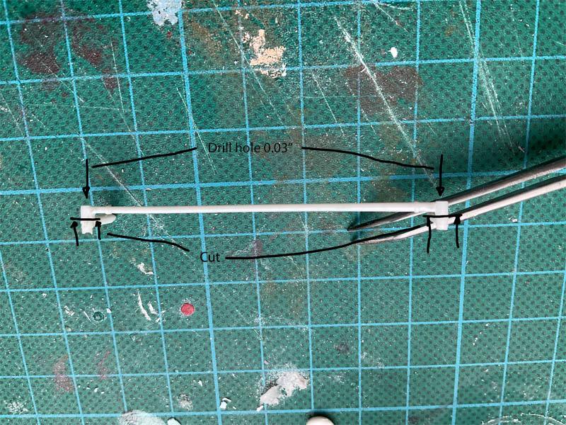

carsntrucks4you Posted February 26, 2022 Author Posted February 26, 2022 (edited) 14 hours ago, Gary Chastain said: Sorry for more question, but how did you cut it apart(what tool) and how do you make up for the saw curf (thickness of cut)? No problem with that. Here a little How-To for a Ford C600 steering. On other truck models the steering setup looks different. They have different drag links, pitman arms or tie-rods, but the principal of drilling and cutting is the same. Tools: fine saw (approx. 0.002" blade, not bigger. Otherwise you had to add some shims to the king pin) 0.03" drill (or 0.04 or 0,02, depending on size of parts) Hand drilling unit t Material: 0,03" copper or brass wire Steps: 1. Drill two 0.03 " holes in the axle where usually the king pin are located 2. Make cut through the king pin area to separate spindle from axle 3. Drill two holes through tie-rod 4. Cut through tie-rod 5. Drill holes through drag link and pitman arm. 6. Make cuts through draglink. Keep in mind that those cuts are nearly in the middle of the part. Check the width 7. Add wire to the holes and check mobility of the system. 8. Installation on truck frame Thats all. I hope this helps a bit. You have to drill first and then do the cutting. If you are lazy and want to spent some money buy movable die-cast axles either from CTM, KFS or Modellers Resource. Unfortunately they are mostly in 1/24 scale, but the Modellers Resource axle work also for 1/25 scale. Edited February 26, 2022 by carsntrucks4you 1

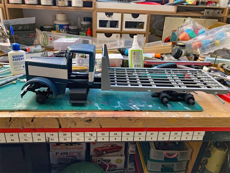

carsntrucks4you Posted March 8, 2022 Author Posted March 8, 2022 (edited) Here the first touch of paint. Flatbed frame will be also painted in US Navy Blue from Zero Paints. Edited March 8, 2022 by carsntrucks4you 1
