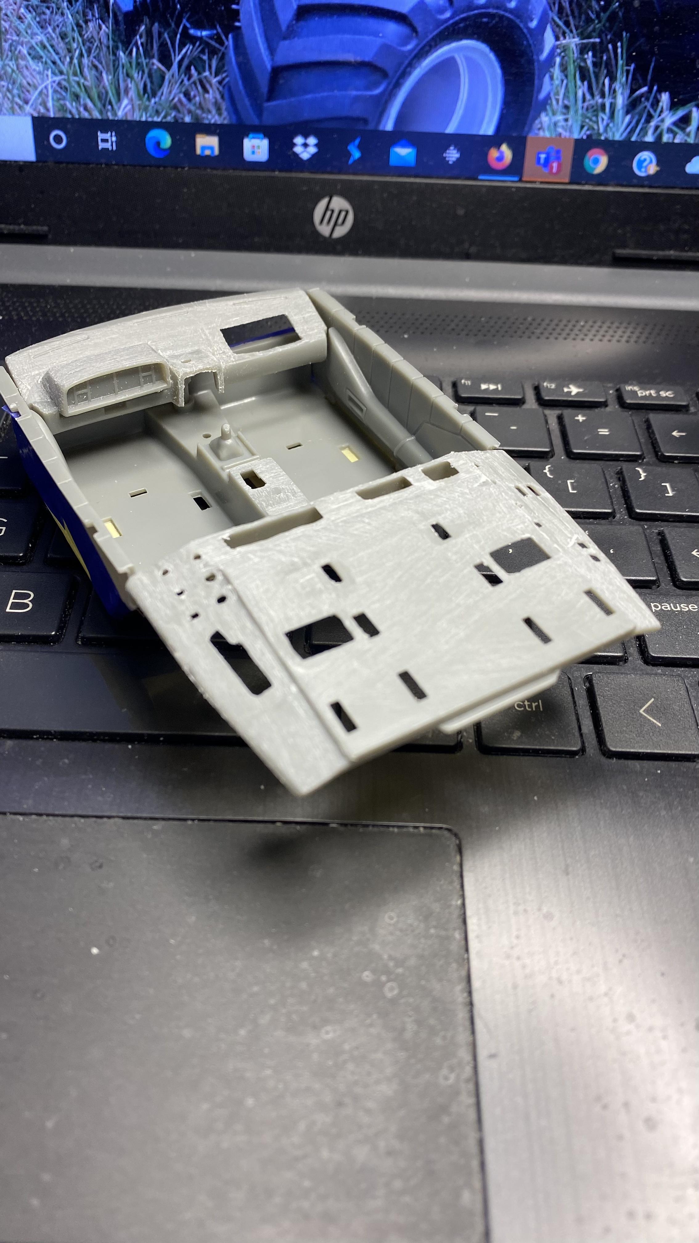

Joe Handley Posted February 24, 2022 Posted February 24, 2022 Ok, I’m getting this Polar Lights Delorean started too now. I wanted to get the time machine stuff removed and and the stance set with the Big and Little Pegasus Hella wheels. Still need to fill in all of the holes for the time machine parts that were to be clipped on as well as molded in place, rebuild the portion of the center stack I cut off, and if anybody has a suggestion on how to get rid of this plating on the body, I’m all ears since the Purple Pond only seems to have removed the matte or semi-gloss clear from the plating I haven’t ground through to remove the molded in external wires. I don’t want to finish filling in those holes in the body until that’s gone. Here’s the box for one of the 2 kits I have. Then here’s my mock up with the Big&Little Hellas from Pegasus. Now how it sits now, after removing most of the molded in time machine stuff then modifying the wheel openings to better clear the tires, though there may be some slight tubbing in the chassis plate’s future. Finally, here’s the semi assembled interior showing off all the holes I need to fill between what won’t be needed and what holes I created cutting molded in things off……..as well as drew a little blood in the process there……..

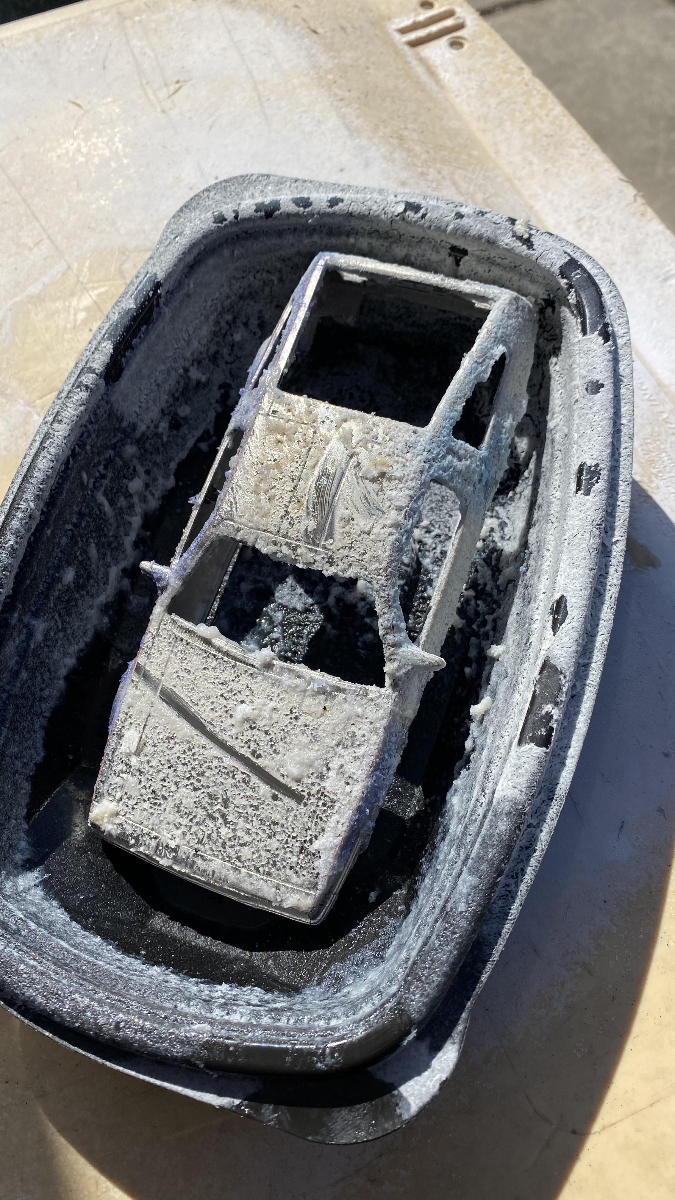

Joe Handley Posted February 28, 2022 Author Posted February 28, 2022 I got some yellow can Easy Off to strip the chrome of this Delorean and all it’s done is waste time an money! It’s been soaking in it for over 20 hours now. I’m about ready to try bleach at this point!

Joe Handley Posted March 6, 2022 Author Posted March 6, 2022 I’ve had no luck with the Easy Off, then had the body blow away yesterday, luckily I found it this morning though! I’m getting connection issues with where I’m at and can’t load the pics right now.
