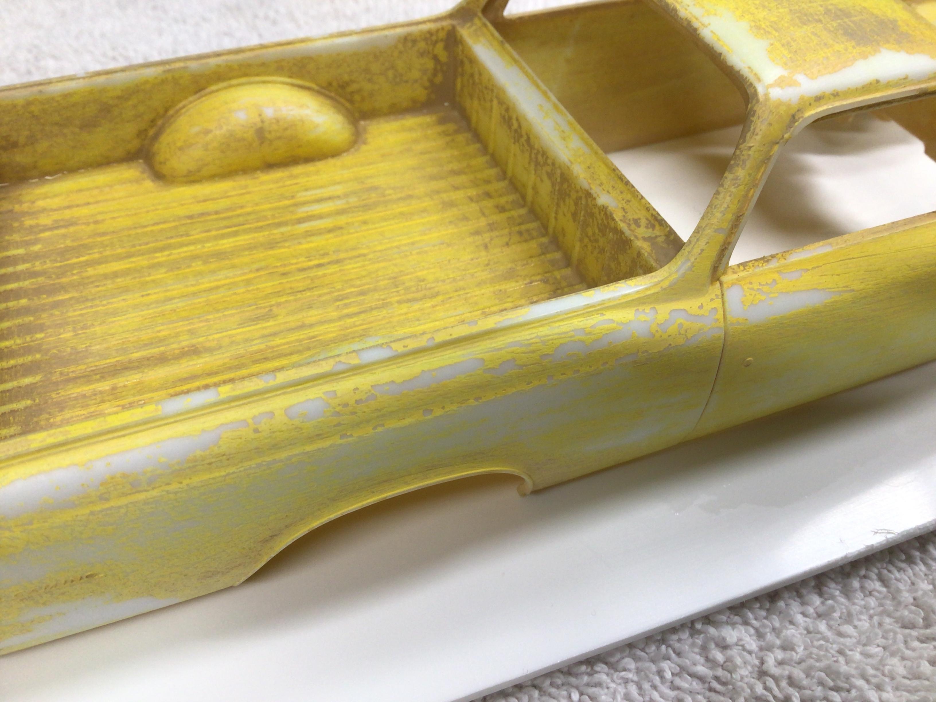

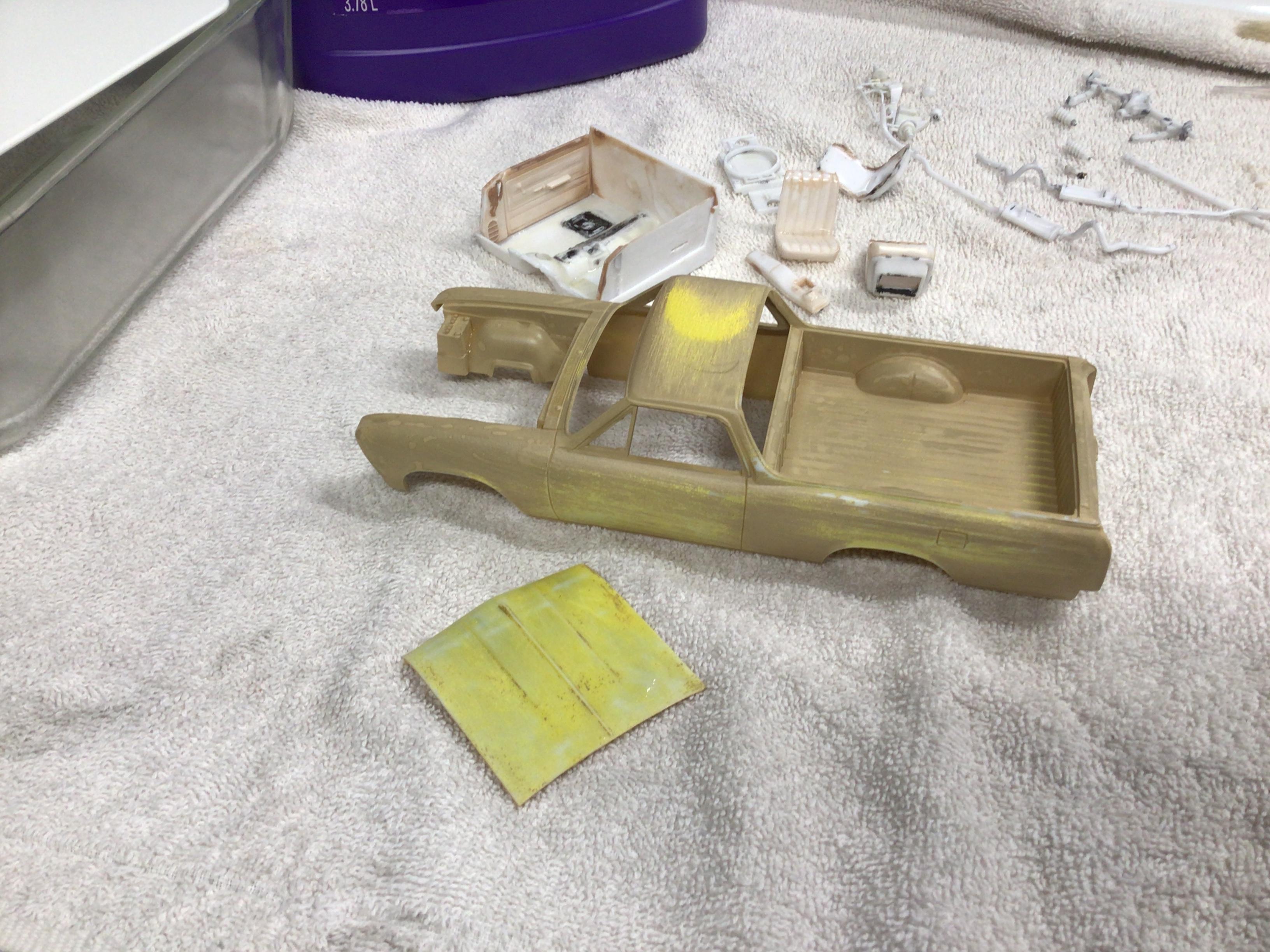

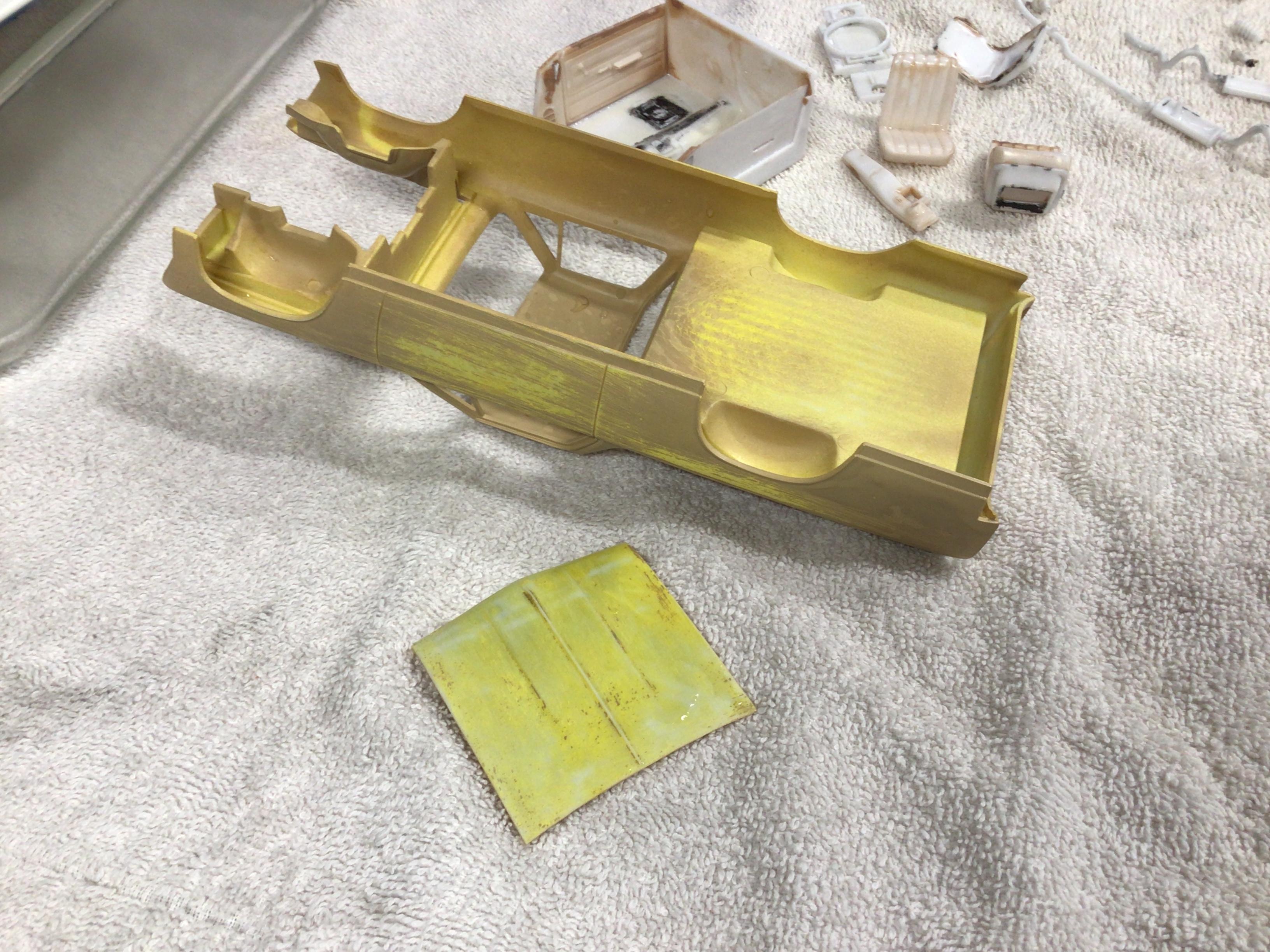

NOBLNG Posted March 2, 2022 Posted March 2, 2022 This has been sitting in the purple pond for 3 days now. The Super Clean barely softened the brown paint that is on top of the yellow stuff. It almost looks like a “zinc chromate” primer? Straight tap water easily took off most of the brown paint on the interior that was not primed at all. Even a brass brush doesn’t easily harm the paint on the body though. Any Ideas? Thanks.

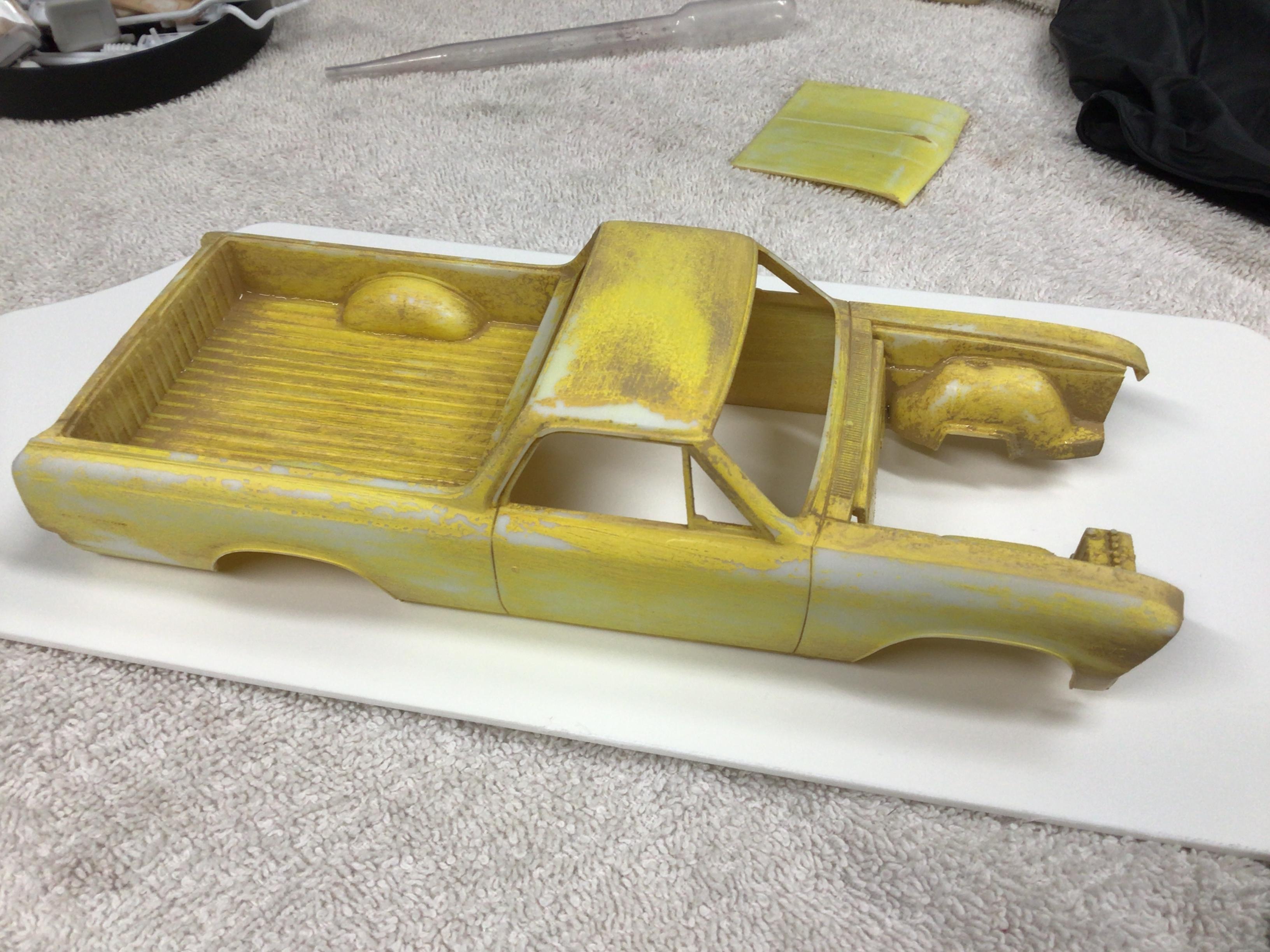

NOBLNG Posted March 3, 2022 Author Posted March 3, 2022 After 4 hours in the alcohol most of the brown scrubbed off easily and some of the yellow. I’m thinking that this is just yellow paint now and not a primer at all.
Bainford Posted March 3, 2022 Posted March 3, 2022 Yeah, clearly some success there. A few more hours.
