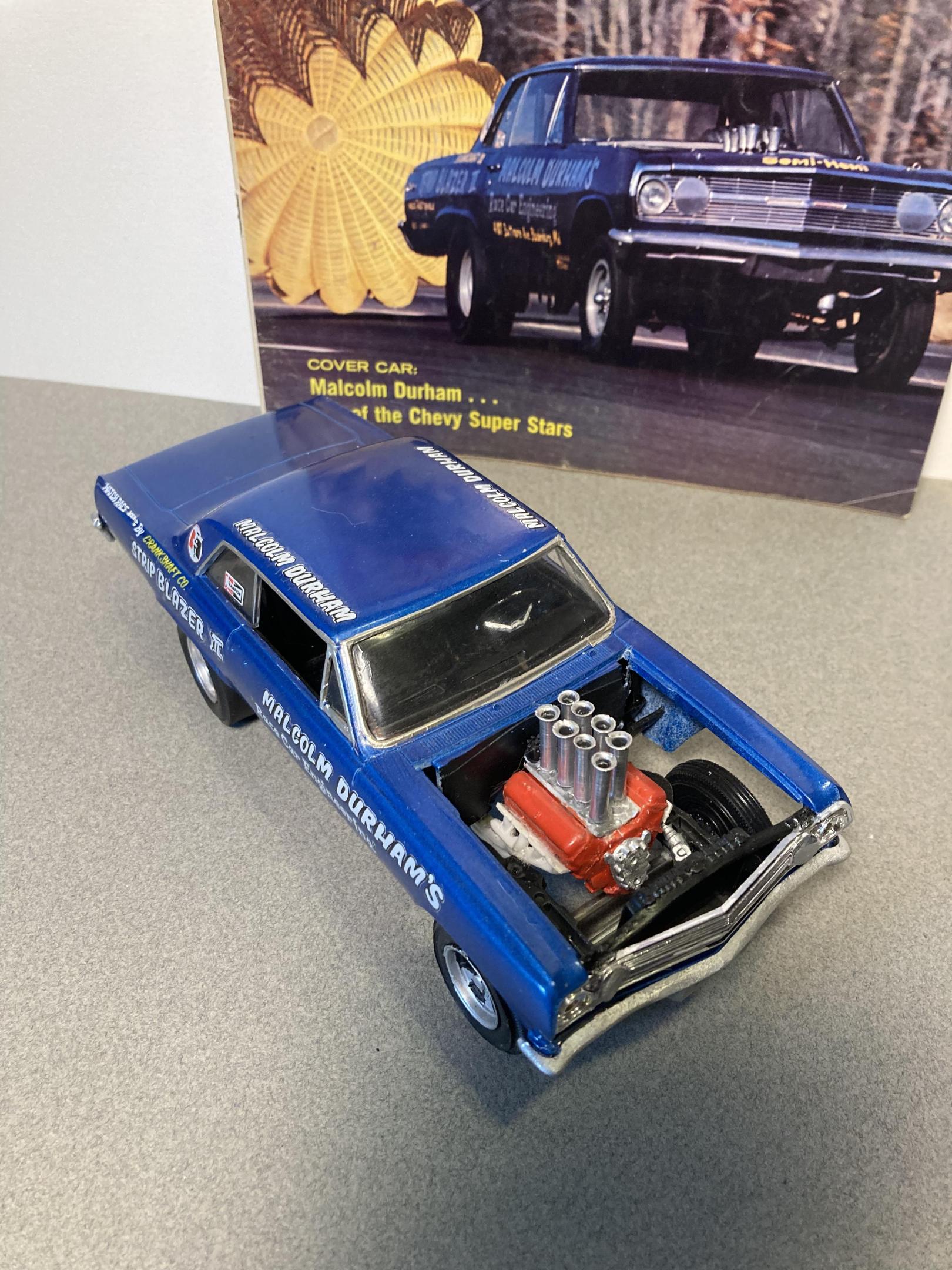

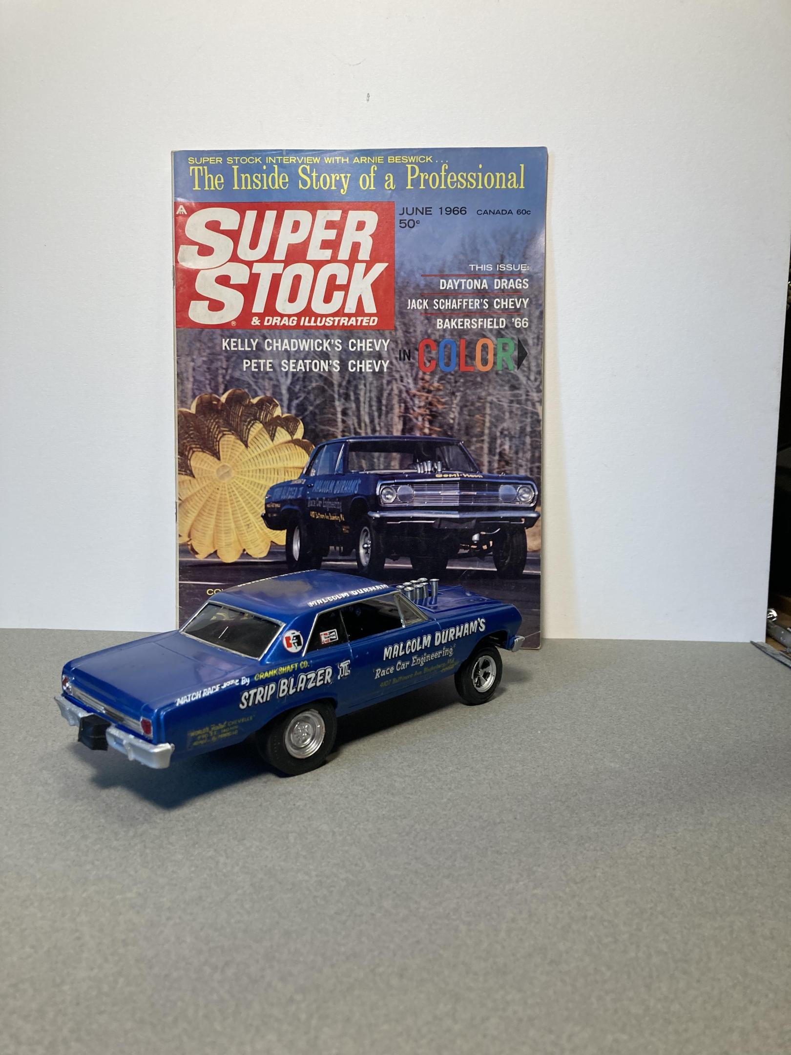

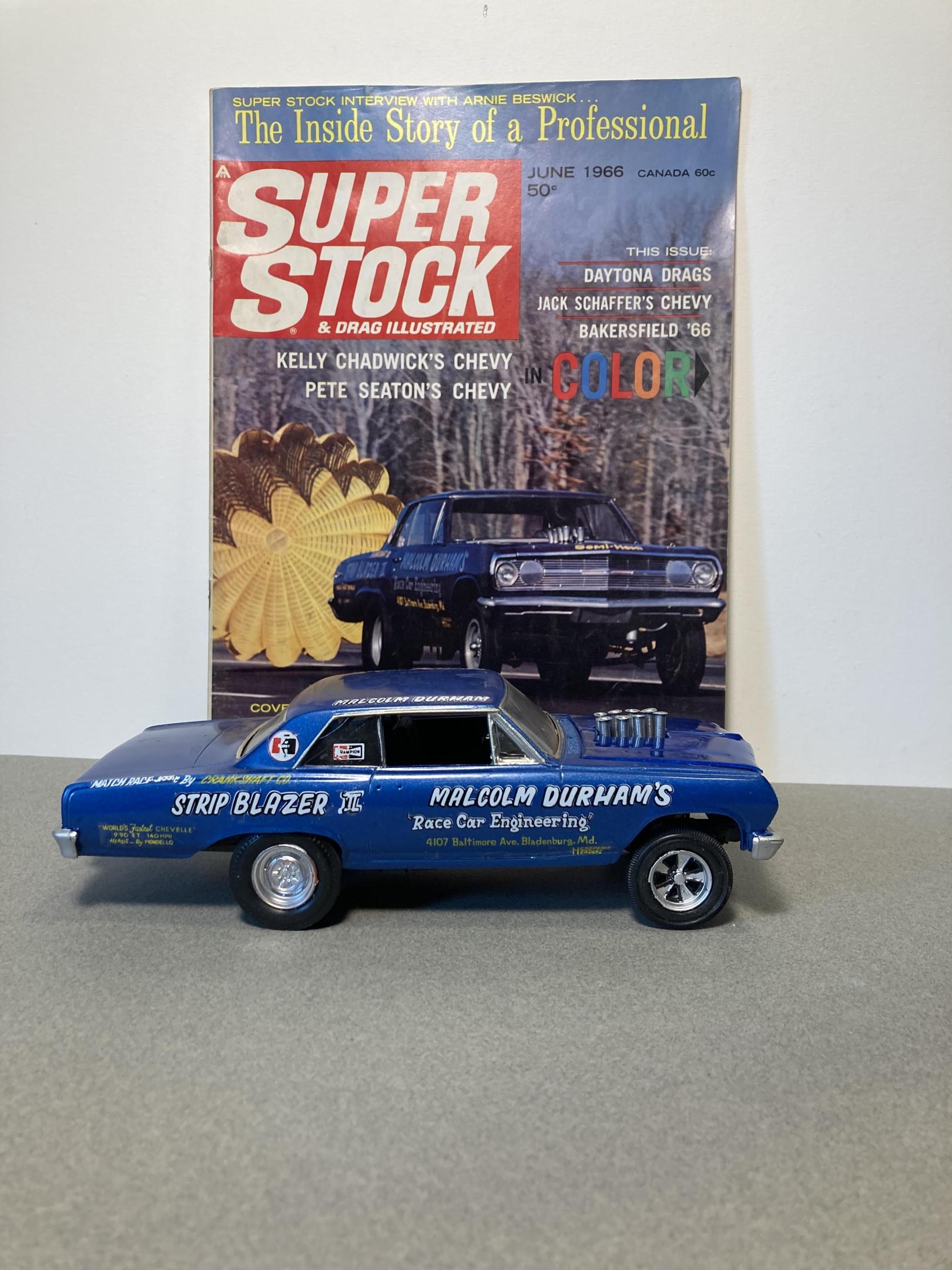

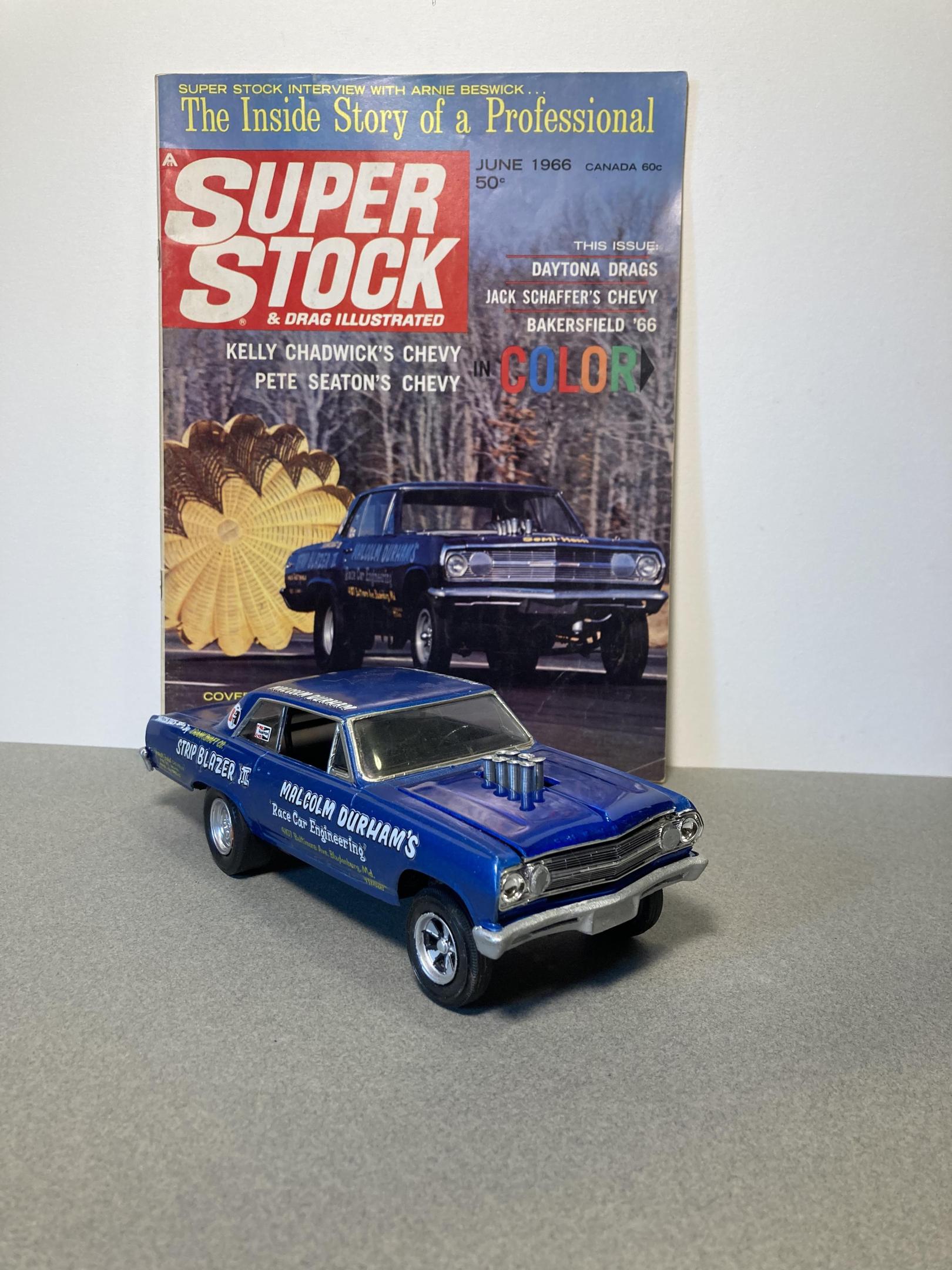

Yes, I know it’s like the third awb chevelle post in a row, but they all have different wheel well relocations. This is my all time favorite Malcolm Durham car. For me the injected altered wheel base cars of the mid 60’s are where it’s at. Until the moebius Plymouth we’ve been on our own to build them.

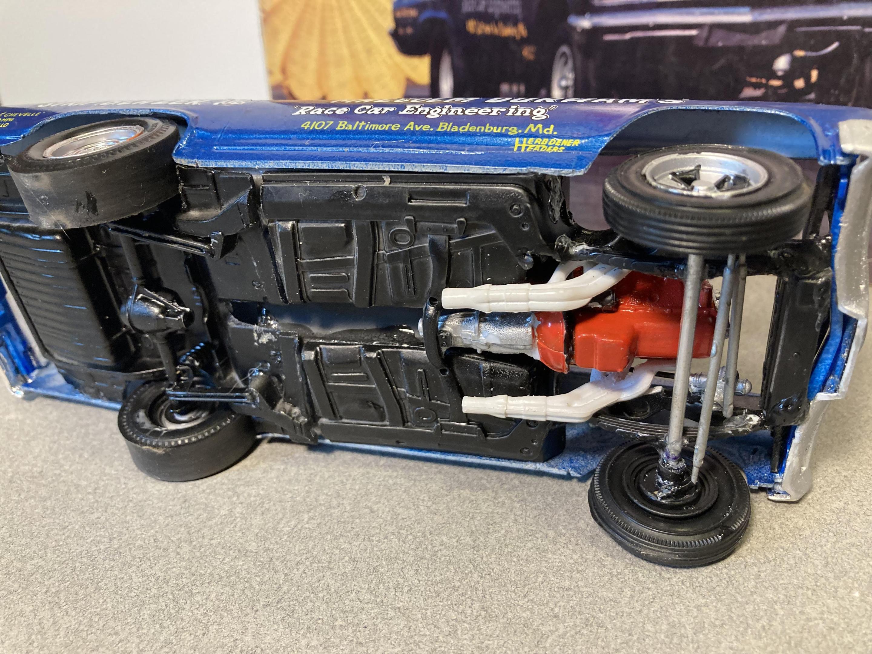

For this one I again started with the revell kit and stretched the rear wheel wells by cutting it in the middle leaving the back edge in the stock location, cutting a piece out ahead of the front edge,and moving the front edge forward. I filled in the gap between the wheel wells with sheet styrene and body filler.
For this one I had to move the front wheel wells forward. I cut them out and moved them to the front bumper.  I filled in the space behind them with sheet styrene and body filler. I then filed and sanded all the joints.
The paint color is testors metallic blue enamel straight from the rattle can.
decals are Fred caddy
rear and front wheels are from the revell 64 thunder bolt
I made the roll bar from.080 rod
I used the kit long block with the manifold and timing cover from the amt 1963 corvette with aluminum tubing
the headers are revell 1968 charger
the front springs are parts box, the axle is aluminum tubing. The tie rod and drag link are mpc’s Ohio George mustang.
the slicks are from the revell thunder bolt. The front tires are amt Firestone supremes.
I just used the stock rear suspension
I really like the stance of this car, and I’m very pleased with the result of how it displays - the hardest part of building these old cars is finding shades of spray paint.
Thanks for looking, mikeB3DC333F-EF76-440F-A1D9-6A45300496ED.thumb.jpeg.9ce26c7a7795987687da61ffe2be4a50.jpeg43E0BD30-8E43-493D-A1BF-DD1BAAC57672.thumb.jpeg.f79840e139e6c5d38cf6dc37d13f0925.jpeg3C080954-3D59-4983-8761-3E67BE6BB8B2.thumb.jpeg.f007694e35d4a870f925e95236137b9c.jpeg48AD2B58-587A-434A-9EF9-21FA60964EC0.thumb.jpeg.3df941bd68d9e9c4a26d58a30de12383.jpegF3448842-630F-4612-93D1-02CA33801D21.thumb.jpeg.1ccb8fe6388de0ae60ed2574e91dcc83.jpeg
