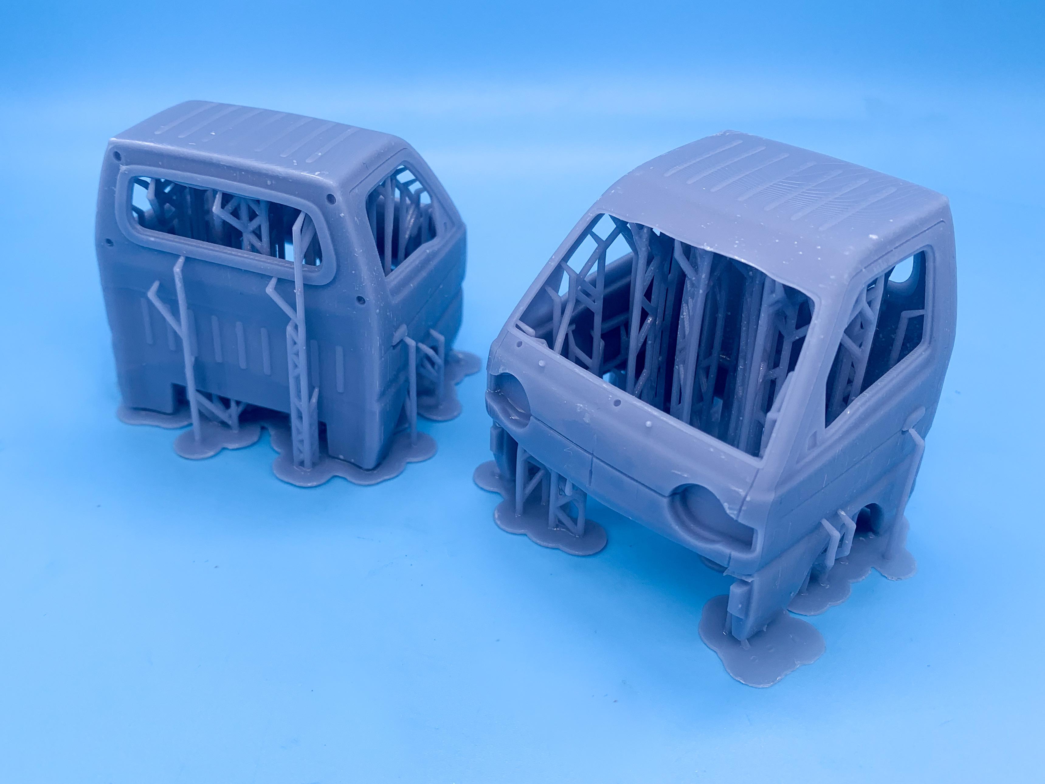

Toughest part of the printing process for this kit is the body, just because of the height and size, so I set the printer running this morning and let it roll for a few hours.  I haven’t really printed much in the way of whole bodies yet, so this is a learning experience…

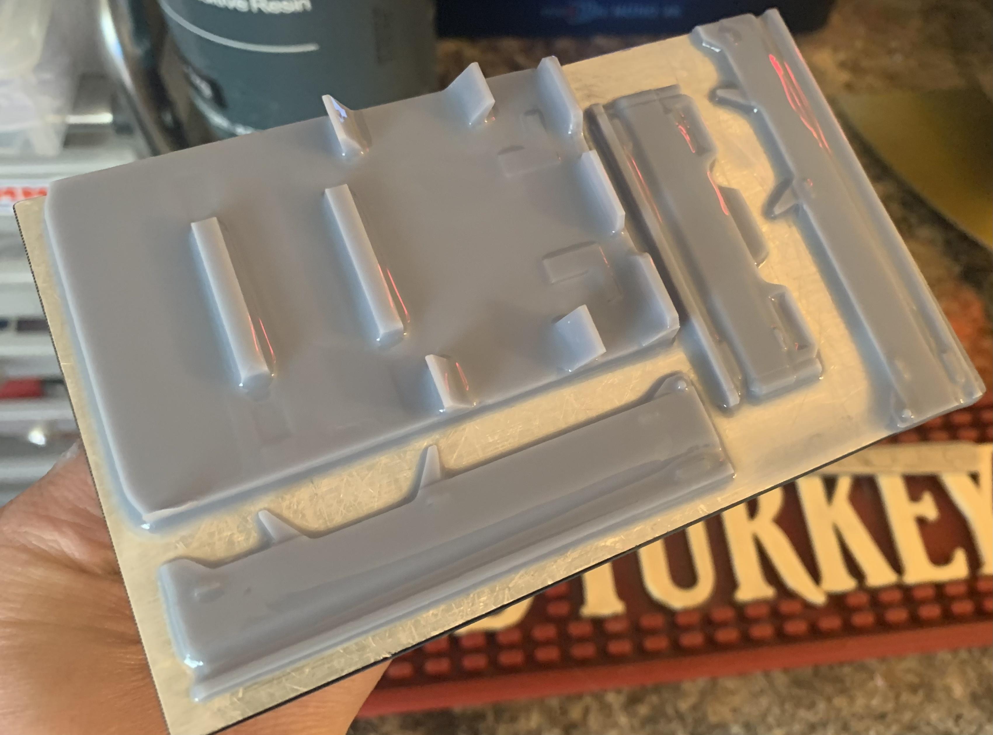

A view of how it looks in the software, with the internal supports to hold it all together whilst the resin prints:

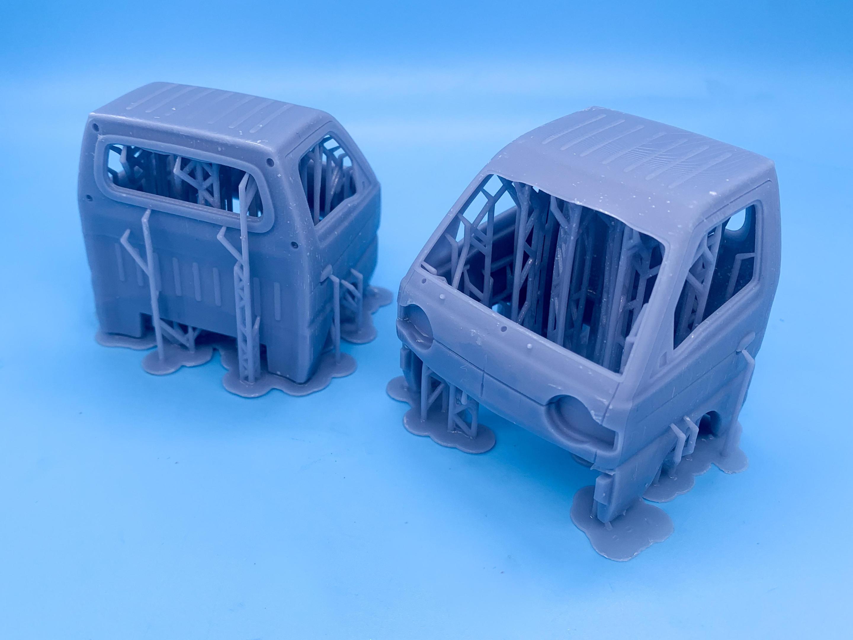

And a couple of them fresh off the machine:
As you can see, I needed some more supports in the very top of that windshield at the front there, but it’s so quick and easy to fix that I’ll make use of these couple of bodies and tweak my print file for future examples (I’ve got SO MANY ideas for these…)

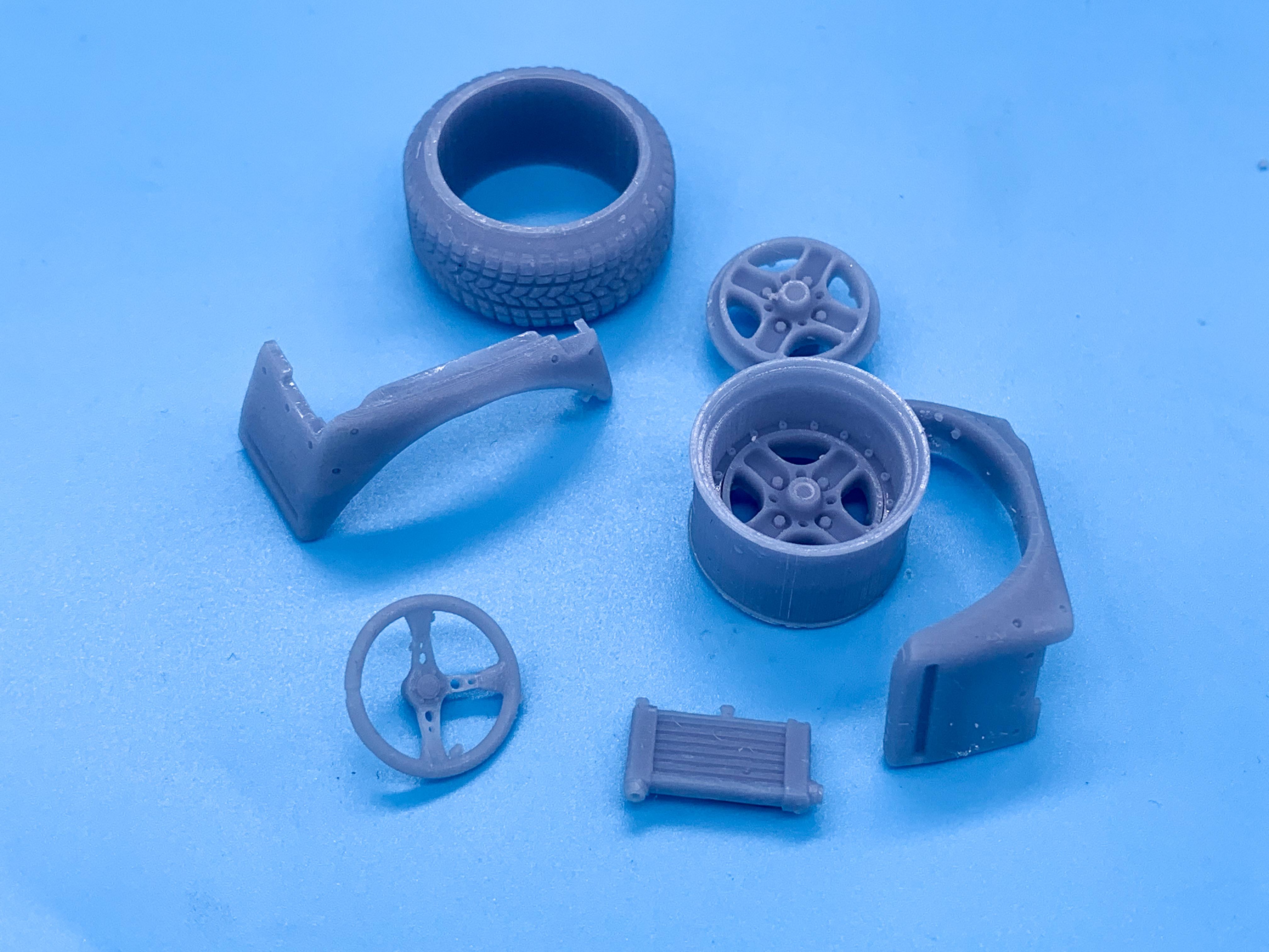

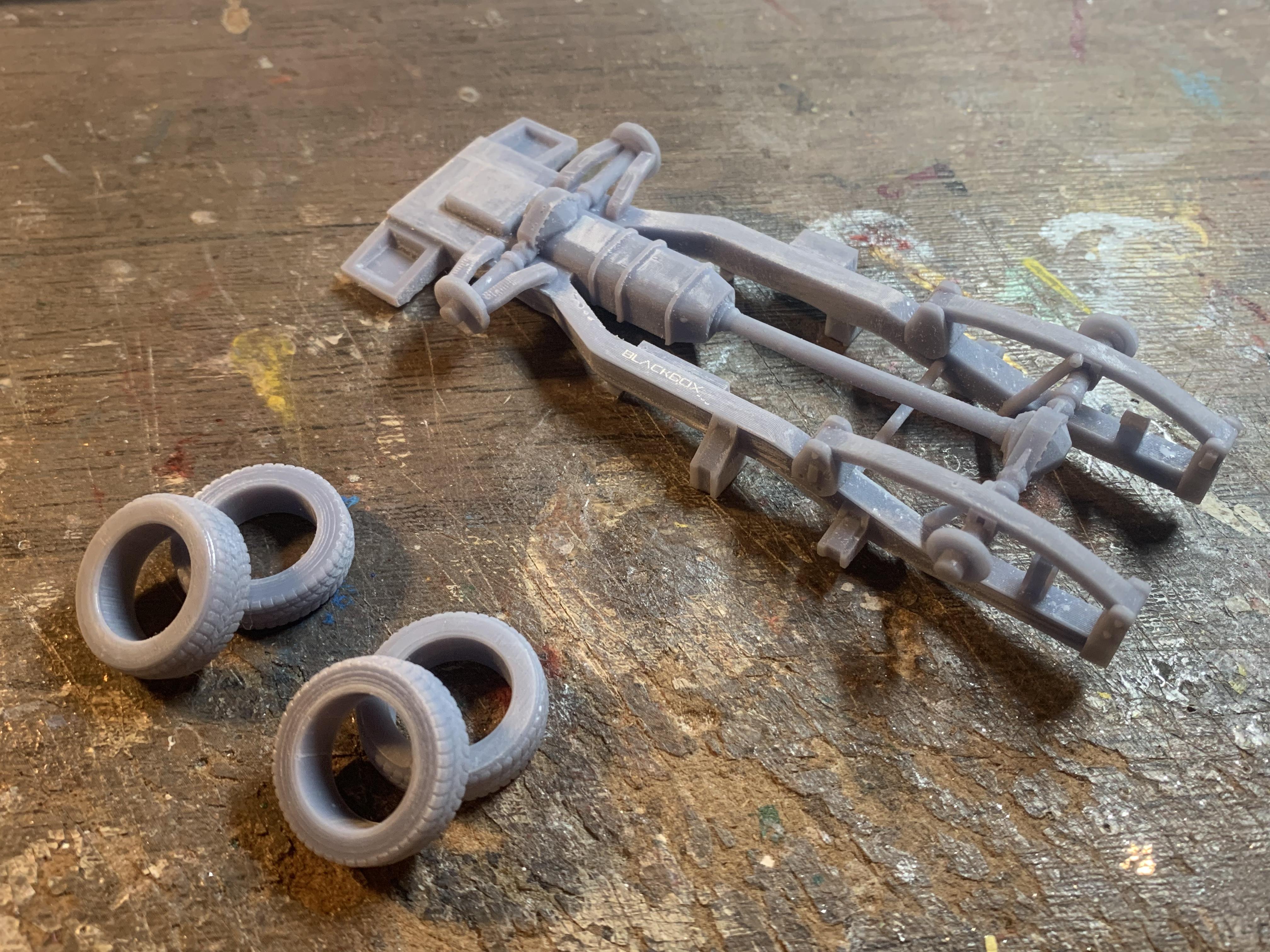

The frame, and the stock tires printed and ready for clean-up and primer:
As you can see, there’s plenty of opportunity to replace some of the ‘moulded in’ detail, but I’m going to TRY and at least build one of these as the designer intended.

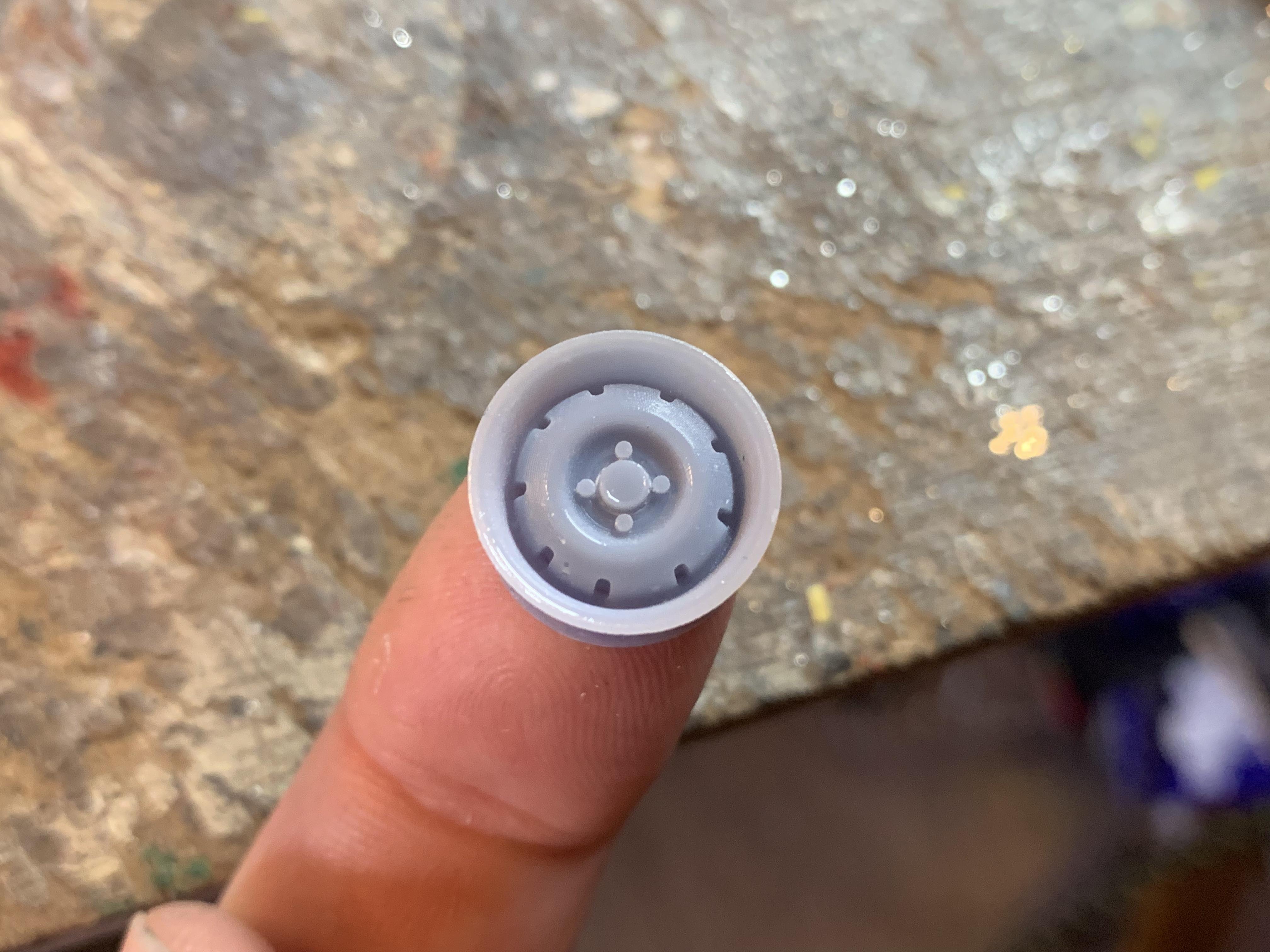

Tiny steelie wheel!
And some of the option parts, that will end up on a future build…

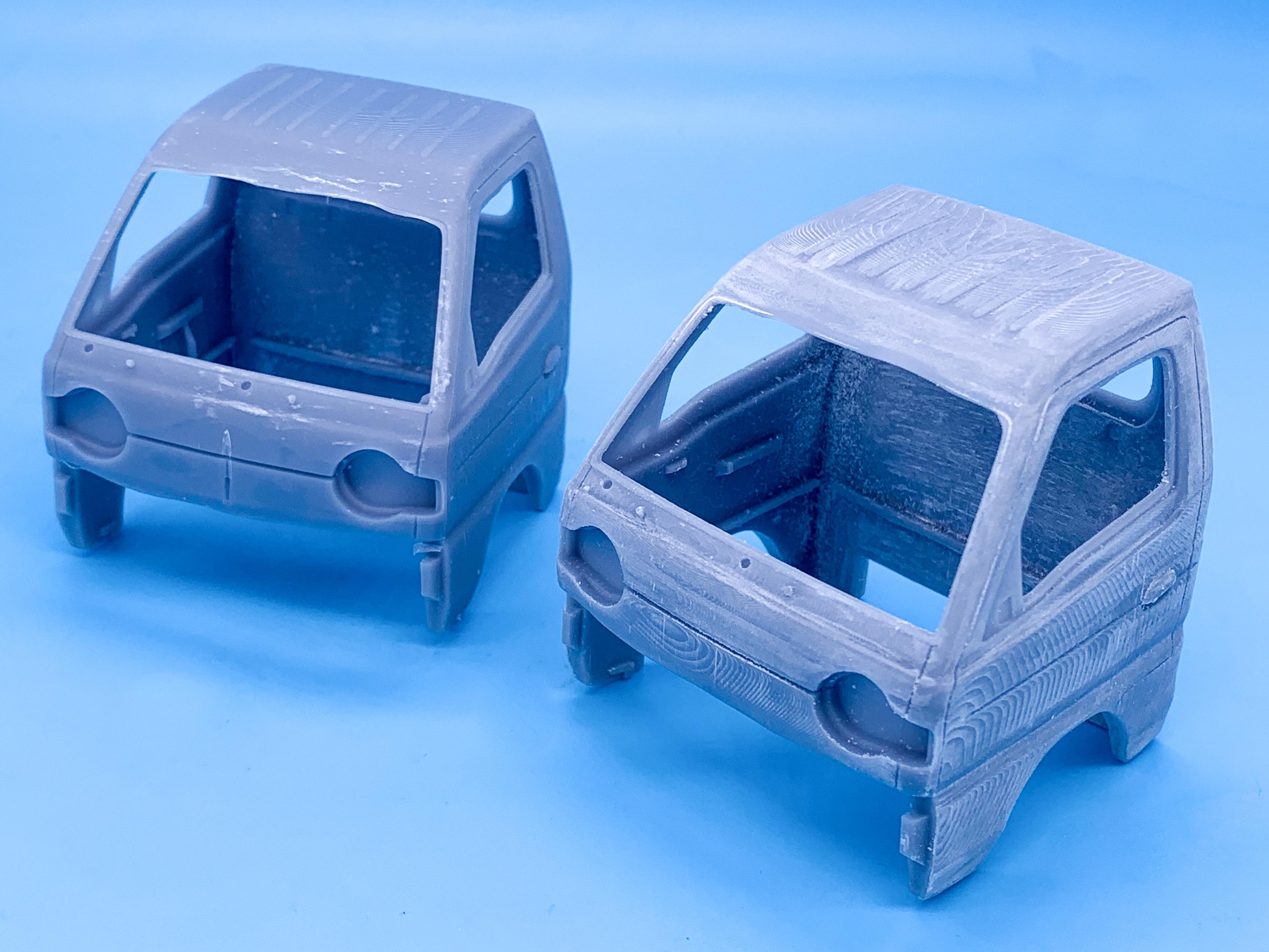

One of the criticisms I see of 3D printed parts is the printing lines, which aren’t super visible on these little pieces, but become more visible on parts with larger gently-curved areas, like hoods and doors.  What I’ve discovered though is that 3D printing resin, at least the AnyCubic stuff I use, responds to light sanding really nicely…it’s more like sanding a coat of filler primer than styrene, and you can clean up parts in a snap and get a nice ready-to-paint surface:
Compare the prepped body on the right to the untouched one on the left and you’ll see that sanding revealed where those lines are pretty clearly, but all the surfaces are smooth to the touch now and ready for primer (once I’ve fixed that windshield, anyway…)

As I am also a bit new to the whole 3D printing thing, I am no expert. However I have found that many times it is better to print your parts/bodies at an angle, even compound angles. If you have a flat surface, the thick resin will flex and move the "Cured" parts and give bad results.
Also, what is the size and resolution of your printer? I have a large 4K printer and I get very very little layer effect.

Some things I've learned along the way...Temp....resin does not like cold temps, you need to print around 20C or higher. Pending on the resin you use, some of them are pretty smelly so make sure to have ventilation. I use Elegoo's ABS like resin and I find it doesn't have too much of an odor, but other brands I tried definitely do. Supports....I tend to over support probably but once you have a 12-14hr print fail on you cause you didn't use enough supports you'll add in more, the cost is a few $$ in wasted resin but alternatively you're not throwing out a huge print file cause part of it failed and is now stuck to your print bed. If you do have a failed print, make sure to drain your tank, clean it and filter the resin to make sure you dont have any floaters in there, I cracked my LCD screen when the plate came down and pushed a failed support threw the FEP......an $80 mistake.
For your body with the layer lines, what layer height are you printing at? I do all my prints at 0.03mm layer height, and yes I get those lines too but they clean up, like you said, very easily, but at 0.03mm look a lot less defined than yours ( I originally started at 0.05mm and they were much more noticable.) For your window frames, add in a line of supports along any large opening to keep the edges from fading, like you have on that little truck, and if it's a bigger truck/car add some rows in the middle as well or the roof can "sag" I've got a couple truck bodies where I hadn't figured that out yet.

You’re absolutely right - angling the bodies gives better results.  In this case though, I could JUST squeeze two bodies on one build plate if I didn’t angle them…so I took a shot and let the machine do two at once, seeing as it was going to take a few hours.  I’ve got the little Anycubic 4k printer - largest print size is about 6” X 5.5” I think.  This kit came from a seller on Instagram: https://instagram.com/blackboxstl?utm_medium=copy_link
@Jhedir6 - good insight, thank you!  I’m printing at 0.05mm layer height right now, which was the default in Lychee for my particular printer.  Question - do you notice a large increase in printing times at that higher resolution?  Although the layers LOOK really noticeable in that pic where I’d been sanding on the body, it’s really not bad at all - just a few minutes work to clean up.

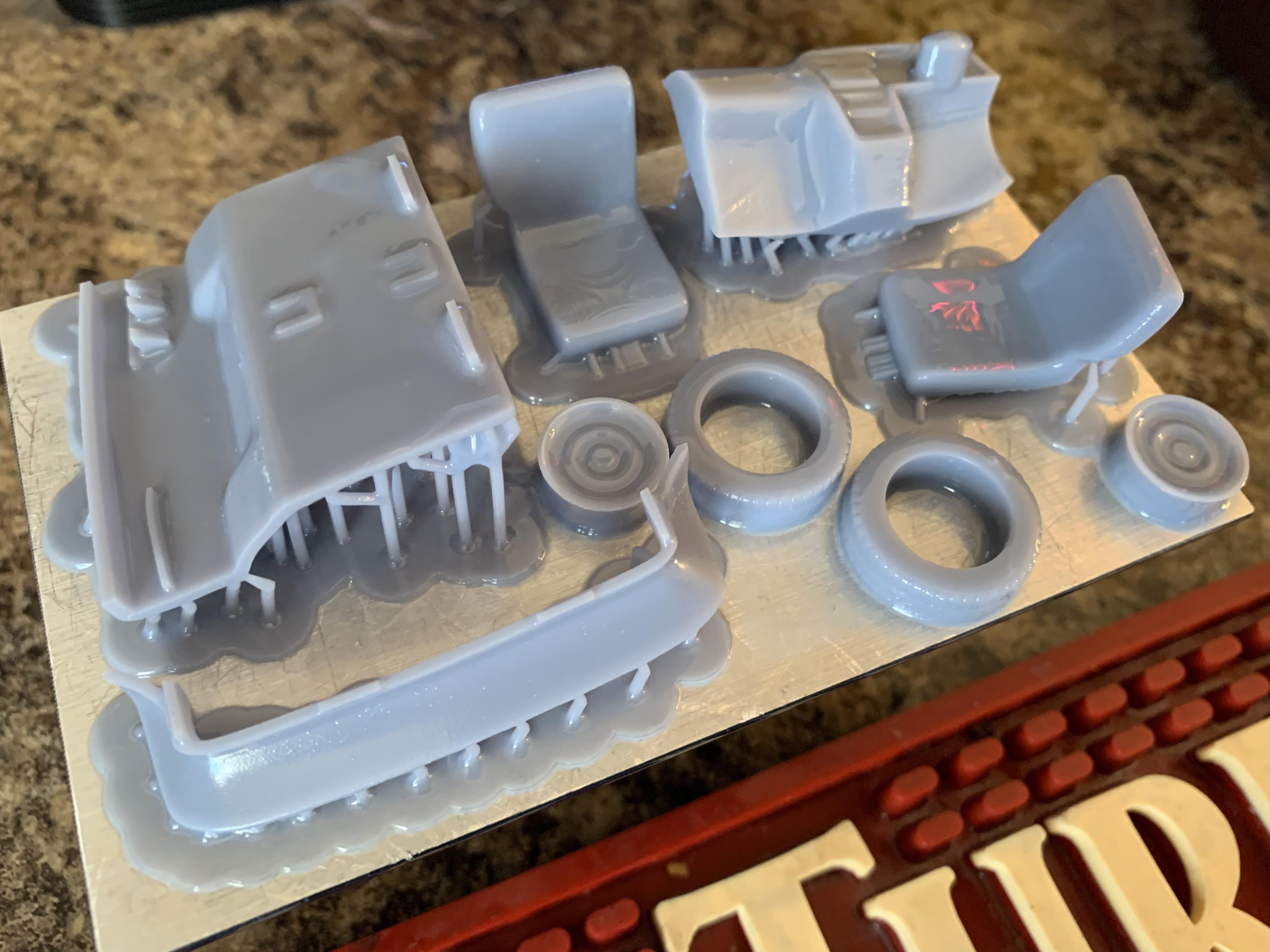

Tiny bit of progress this evening…printed the interior pieces and the last couple of little parts that I needed:
This kit is really well thought out - the parts almost just snap together!
I had been trying to figure out the best way to print the bed, which was modeled as one piece and looked somewhat tricky to print.
Challenges were that it had underhangs (rear fenders, primarily) various underside detail, and details on the outer sides and back that I didn’t want to ruin or obscure with supports.  The most obvious solution would be to invert it and put all the supports on the inside with braces so it printed square and true, but that would make cleanup of the inside of the bed harder; and also printing something taller takes a lot longer than something flatter.
So, I just split the part into five pieces and printed it like so…took 30 minutes to print this way rather than the 3 hours the bed would’ve taken as one piece.  Just gotta glue those five parts together and we’re golden!
(I know there’s only 4 pieces here…I’d already printed the other part on another layout I had done)

Yes, I print at 0.03mm layer height, and while it takes longer..........the resolution is much better as you don't have what can be those wicked layer lines to get rid of. At best, your sanding won't be as intense trying to get rid of them.

And further to the discussions above, my Elegoo printer's default print height was .05. I changed that to .04 and noticed a significant improvement in terms of layer lines. Takes a little longer, but I have much less prep time after printing to fix things. Am going to change it up to .03 and see how that goes.

@CabDriver you're definitely going to get longer printing times with .03mm layer heights cause you're increasing the number of layers. Pending on what your cure times are set at, that determines the time each layer "cures" before lifting to the next. Lift speed will also affect the time but layer height will be the biggest change in time as with that higher level of resolution ( lower number of height in mm) the layer count goes up, but by a guess I'd say we're talking mins overall, again pending on how "tall" your z axis is for each print. A print that uses the full z axis might take 30-40mins longer. For me, I just put my long prints on at night before bed or before I go out to work and let it go while I'm gone.
For your parts on your print bed, if the part has a flat surface, like your interior pan, make sure to angle it about 30 degrees or so, that way resin wont pool on the bottom side (build plate side) and will drain as the print rises, saving your resin when you clean the parts.

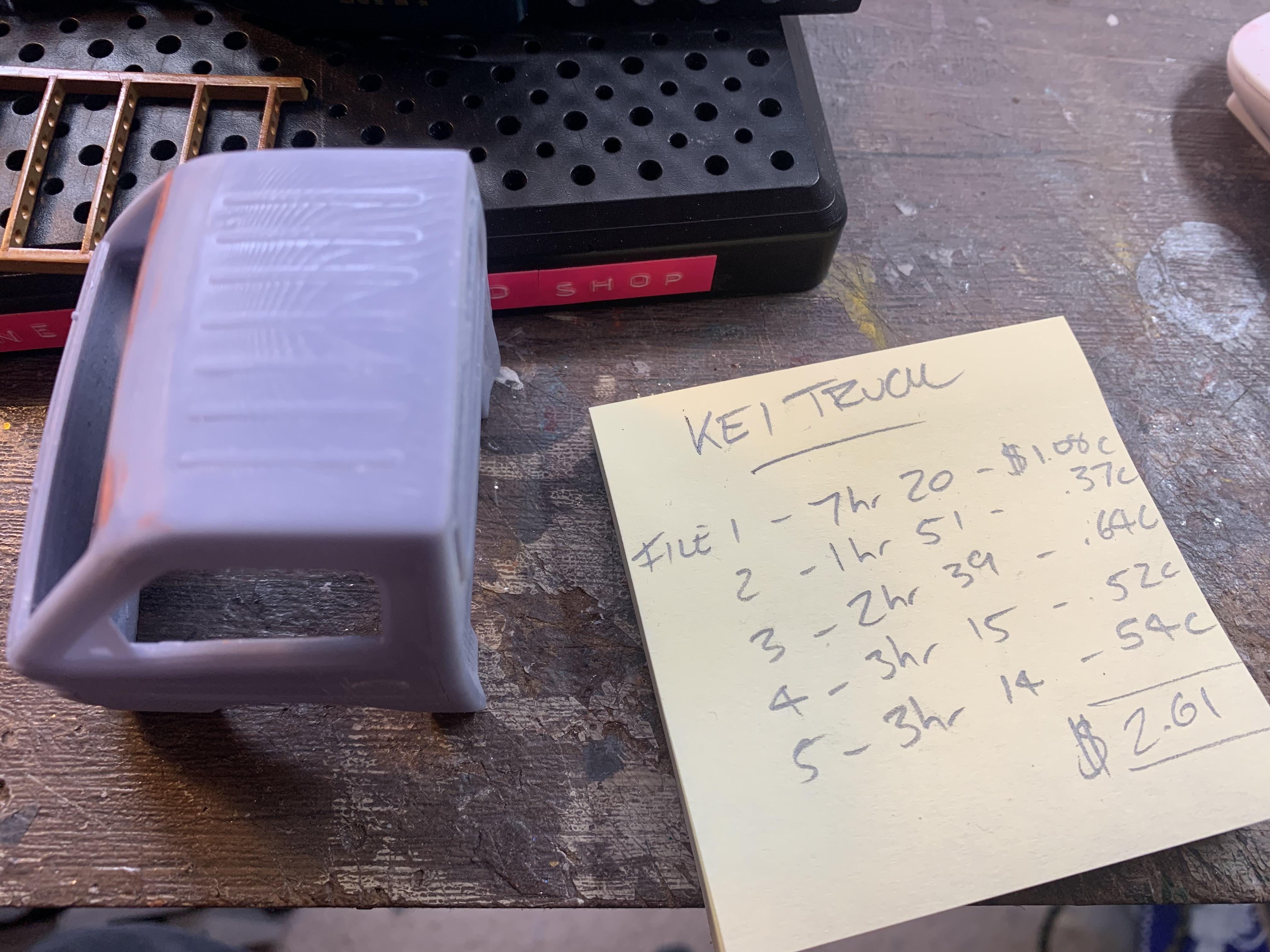

I’m glad someone asked these questions, because I wondered about them myself when I started this project…so, as I was printing, I totaled up the volume of resin used for each set of parts so I could see:
File one was TWO bodies, which cost $1.08 total, then all the subsequent files are everything else (plus some of the option parts, when I had a gap left on the machine’s plate to print them).  Total came to $2.61 for the resin cost, and the kit was $12…so under $15 to print, assuming you get a good print first time around.
Of course, the second version of this truck I make will cost me less than $3, seeing as I have the file already…
(Edit, note: this is based on using standard Any Cubic gray resin, at $25 per 1kg bottle, delivered)

1 hour ago, bobthehobbyguy said:
Thanks for the info. Not a bad cost.
Not a very complicated kit either, so you’d definitely be looking at a lot more for something more involved…but yeah, I was pleasantly surprised at how little MATERIAL you need…but as you can see from my Post-It there, the machine takes a few hours to do it’s thing.

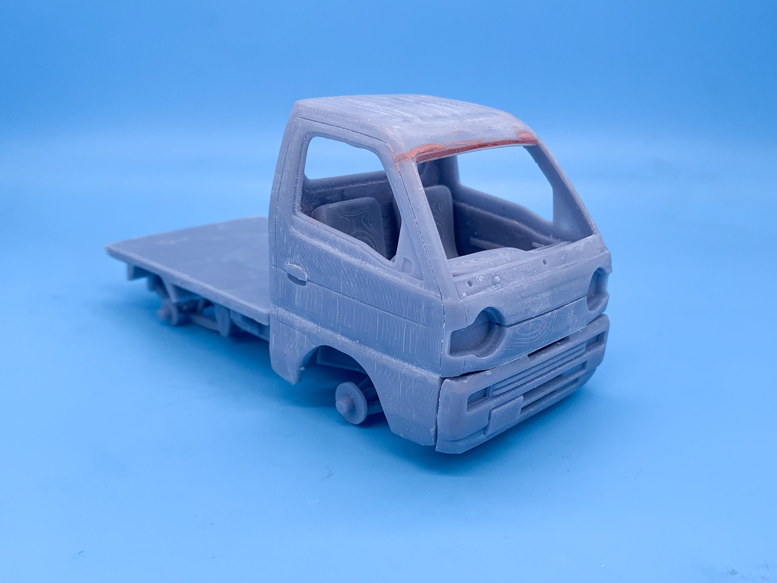

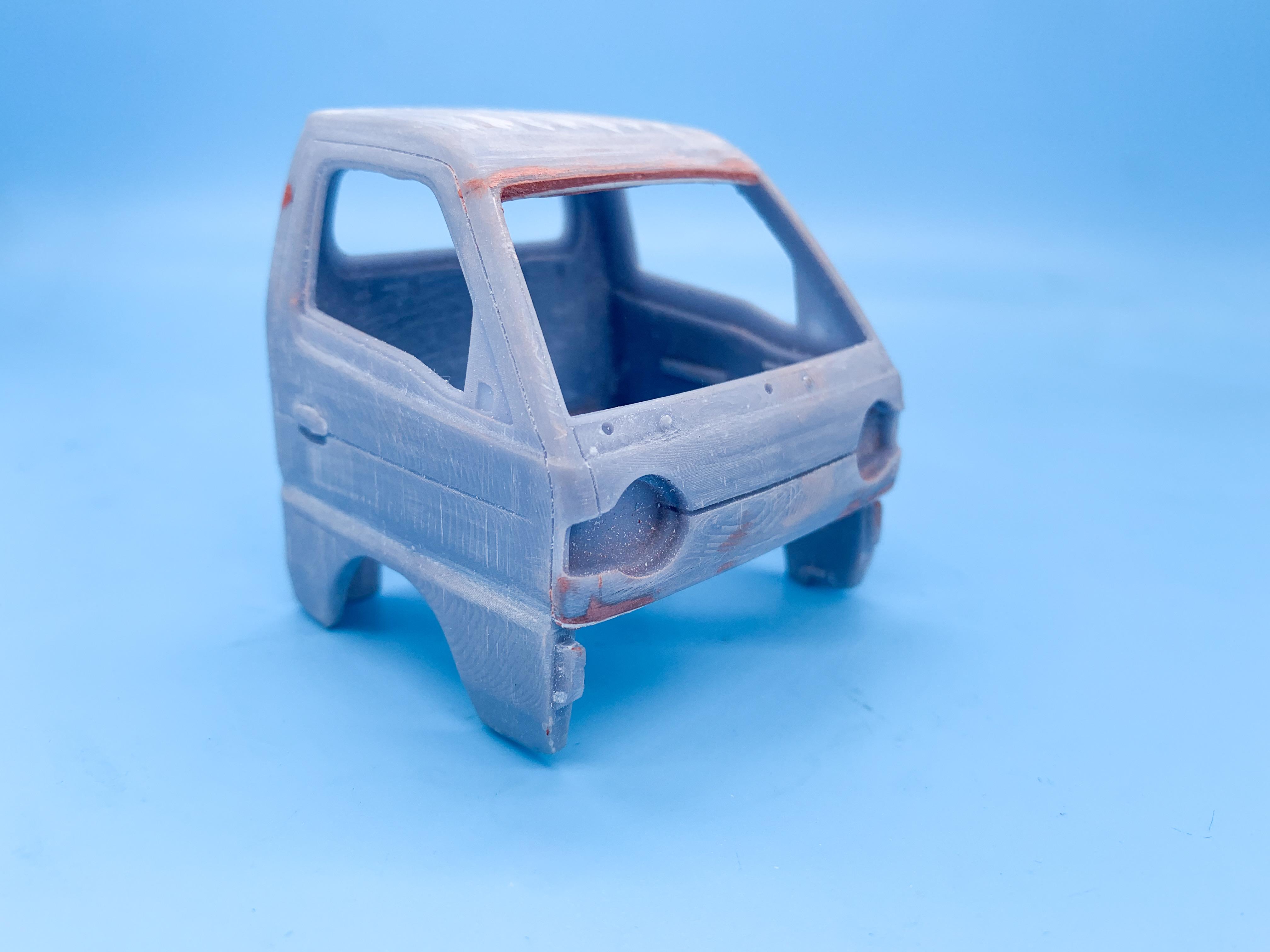

Made some little bits of progress on this thing this week when I had a few minutes, mostly on fixing the flaws on the body that came from it sagging a little where I didn’t give it enough supports.
Lesson learned for the next ones, but also I wouldn’t really say I had to put more effort into this ‘failed’ print than I would any standard kit body - it’s just instead of filling sink holes and sanding parting lines I had to get the surfaces perfectly flat.  I know how to fix that for next time though now so that they’ll print a lot better.  You can see some of the little fixes I had to do, and now this body is about ready for primer:

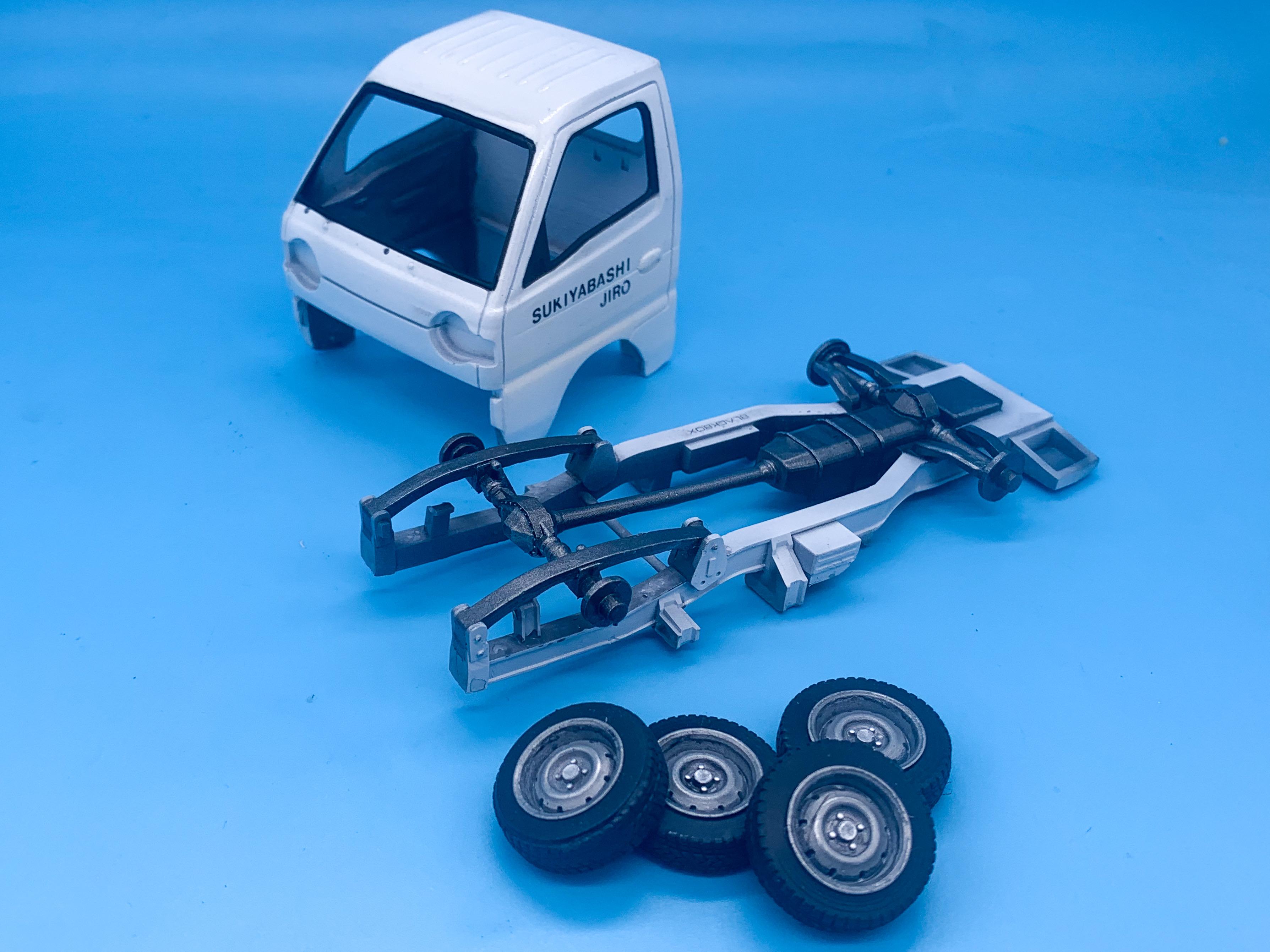

Still tinkering away with this one - realized I hadn’t posted an update so here’s how it sits now…
Got the body painted, and added some lettering:
Shot black to try and generate some shadows under the frame to stop it looking too toy-like, and then overlaid some white to match the body…I’m going for a lightly weathered kind of look here but not totally ruined, so I’m going to use this shading to help build realism (hopefully)…

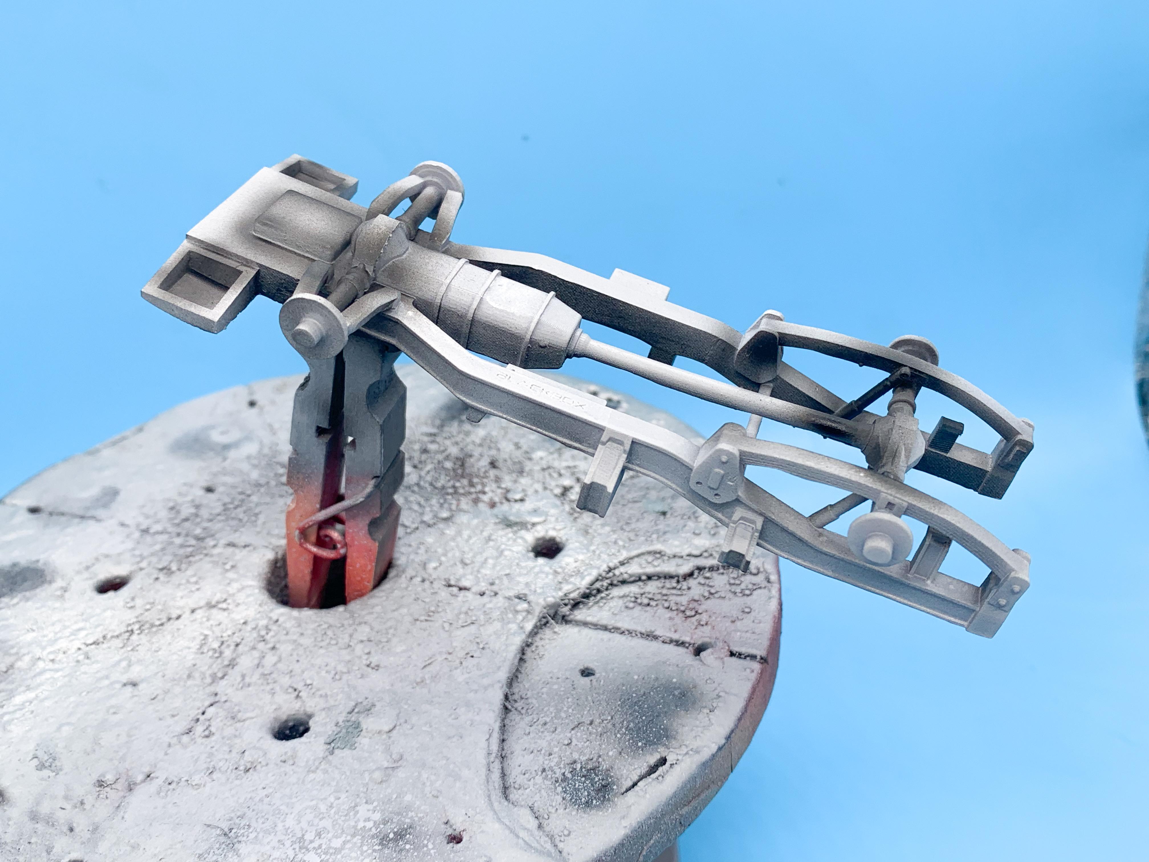

Cleared that, and masked to paint some metal tones under there:
Went with a mix of Vallejo and acrylic craft paints - I’m not going crazy with the underside, but you can see the rear suspension and driveshaft on the 1:1 trucks pretty easily so I’m just trying to capture that…
And finally for this update, shot some metal colors on the steelie wheels and got the tires painted…these will receive some further weathering too:
