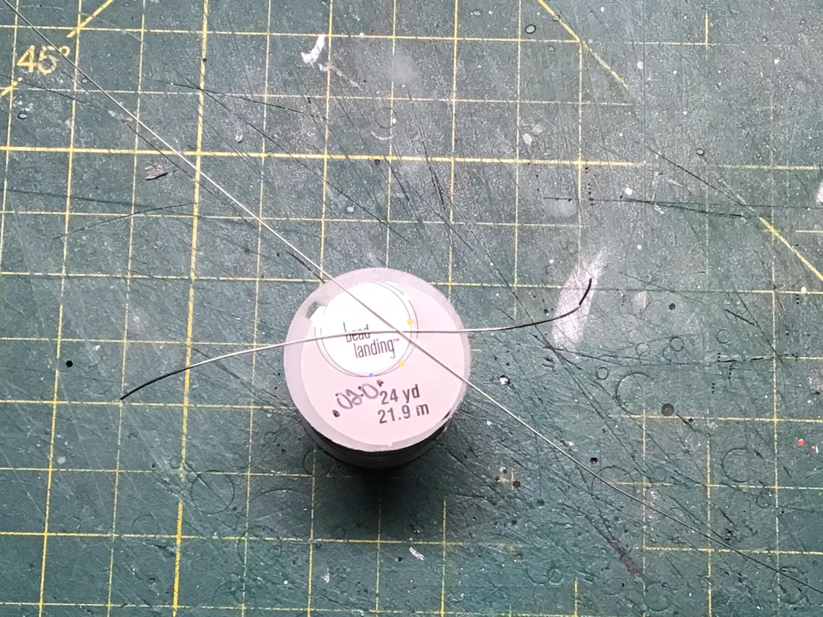

I’m not sure what that will fit into, but you could use either some .020” beading wire or a .014” guitar string inside of it.
If the ID (Inside Diameter) of the tubing is 0.0215" then any wire smaller than 0.0215" in diameter should slide into the tubing.  Greg proposed 0.020" wire - that'll work.

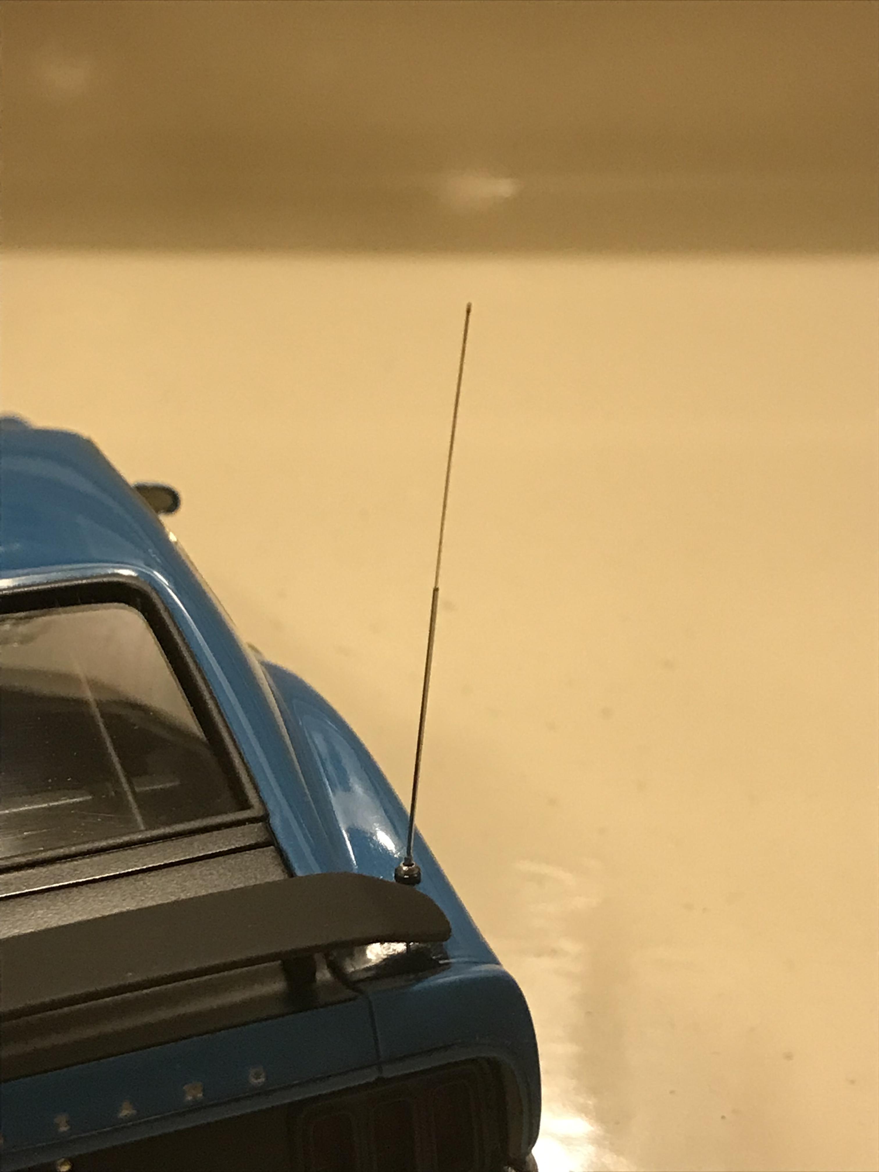

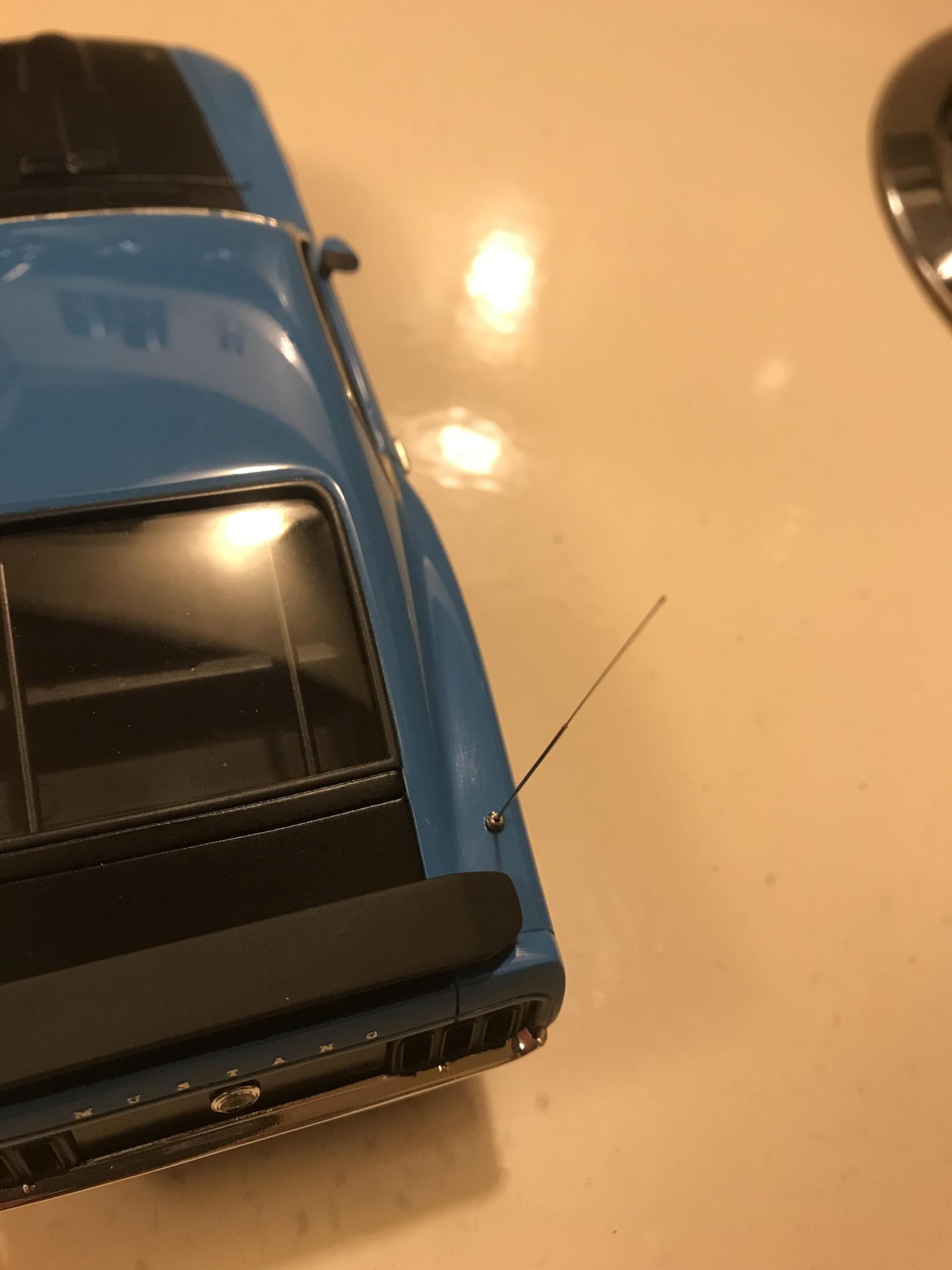

I have used this  technique for making antennas, but I used thinner hypodermic tubing, and thinner stainless steel wire for the top segment.  Here is a 3-piece antenna made this way.  This is on 1:32 scale car.
I don't recall what size tubing I used. I would have to dig that car out of storage and measure it.  I'm pretty sure though that the top segment wire is 0.005".
