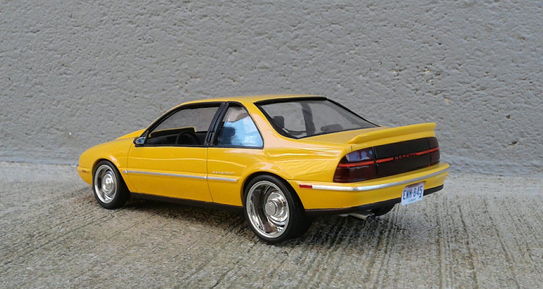

Plowboy Posted April 1, 2022 Posted April 1, 2022 I would try your idea out on a scrap windshield to see what it does. Only other idea I would have is paint the outside red and the inside black. Which Beretta are you building? I built one not long ago that had the tail light molded in clear red. I painted the inside black. It looked pretty convincing. 1

crowe-t Posted April 1, 2022 Author Posted April 1, 2022 (edited) 40 minutes ago, Plowboy said: I would try your idea out on a scrap windshield to see what it does. Only other idea I would have is paint the outside red and the inside black. Which Beretta are you building? I built one not long ago that had the tail light molded in clear red. I painted the inside black. It looked pretty convincing. It's a beautiful build! The tail lights looks like a real Beretta's. When you say you painted the inside black, do you mean the body behind the tail lights or the inside of the actual clear red part? Did you paint the outside of the middle section black? I'm building a Revell Beretta pro Street kit that I'm modifying. The tail light piece is clear. http://www.modelcarsmag.com/forums/topic/168464-revell-beretta-pro-street/ Edited April 1, 2022 by crowe-t

Plowboy Posted April 1, 2022 Posted April 1, 2022 (edited) 9 hours ago, crowe-t said: It's a beautiful build! The tail lights looks like a real Beretta's. When you say you painted the inside black, do you mean the body behind the tail lights or the inside of the actual clear red part? Did you paint the outside of the middle section black? I'm building a Revell Beretta pro Street kit that I'm modifying. The tail light piece is clear. http://www.modelcarsmag.com/forums/topic/168464-revell-beretta-pro-street/ Thanx! I painted the inside of the tail light. I did it with a brush. I went over the whole thing with thinned flat black. Then I went over the center section again to make it darker. Edited April 1, 2022 by Plowboy 1

crowe-t Posted April 1, 2022 Author Posted April 1, 2022 41 minutes ago, Plowboy said: Thanx! I painted the inside of the tail light. I did it with a brush. I went over the whole thing with thinned flat black. Then I went over the center section again to make it darker. The black on the inside isn't totally opaque?

Plowboy Posted April 1, 2022 Posted April 1, 2022 14 minutes ago, crowe-t said: The black on the inside isn't totally opaque? No, the black is very thin. I also foiled the section on the body of the tail light.

Michael jones Posted April 1, 2022 Posted April 1, 2022 (edited) Painted on inside - Tamiya smoke then Tamiya LP clear red which is much more "red" than Tamiya acrylic clear red. Chrome backing on body if i remember correctly. Edited April 1, 2022 by Michael jones 1
crowe-t Posted April 1, 2022 Author Posted April 1, 2022 (edited) 12 minutes ago, Michael jones said: Painted on inside - Tamiya smoke then Tamiya LP clear red which is much more "red" than Tamiya acrylic clear red. Chrome backing on body if i remember correctly. The paint on the body is incredible! Are both the Tamiya Smoke and LP Clear red on the inside of the clear lens? Did you use Tamiya X-19 Acrylic Smoke or Tamiya Smoke in the spray can? Do you have any other pictures showing the tail lights closer? Edited April 1, 2022 by crowe-t
Michael jones Posted April 4, 2022 Posted April 4, 2022 On 4/2/2022 at 11:27 AM, crowe-t said: The paint on the body is incredible! Are both the Tamiya Smoke and LP Clear red on the inside of the clear lens? Did you use Tamiya X-19 Acrylic Smoke or Tamiya Smoke in the spray can? Do you have any other pictures showing the tail lights closer? Yeah see attached photo. It has LED lights on in the photo BTW. If you want it a brighter red, just lightly tint the clear plastic with smoke on the inside. I used the spray can lacquer smoke btw. All paint on the inside as far as I recall. Mike
crowe-t Posted April 4, 2022 Author Posted April 4, 2022 7 hours ago, Michael jones said: Yeah see attached photo. It has LED lights on in the photo BTW. If you want it a brighter red, just lightly tint the clear plastic with smoke on the inside. I used the spray can lacquer smoke btw. All paint on the inside as far as I recall. Mike Thanks for the picture. I suppose the Tamiya LP Smoke is the same as the spray can lacquer Smoke. Have you tried Tamiya LP Smoke or is the spray can lacquer Smoke better?
Michael jones Posted April 5, 2022 Posted April 5, 2022 14 hours ago, crowe-t said: Thanks for the picture. I suppose the Tamiya LP Smoke is the same as the spray can lacquer Smoke. Have you tried Tamiya LP Smoke or is the spray can lacquer Smoke better? I do own the LP smoke but haven't tried it yet. I believe the result would be the same - just down to how dark you want it. 1
