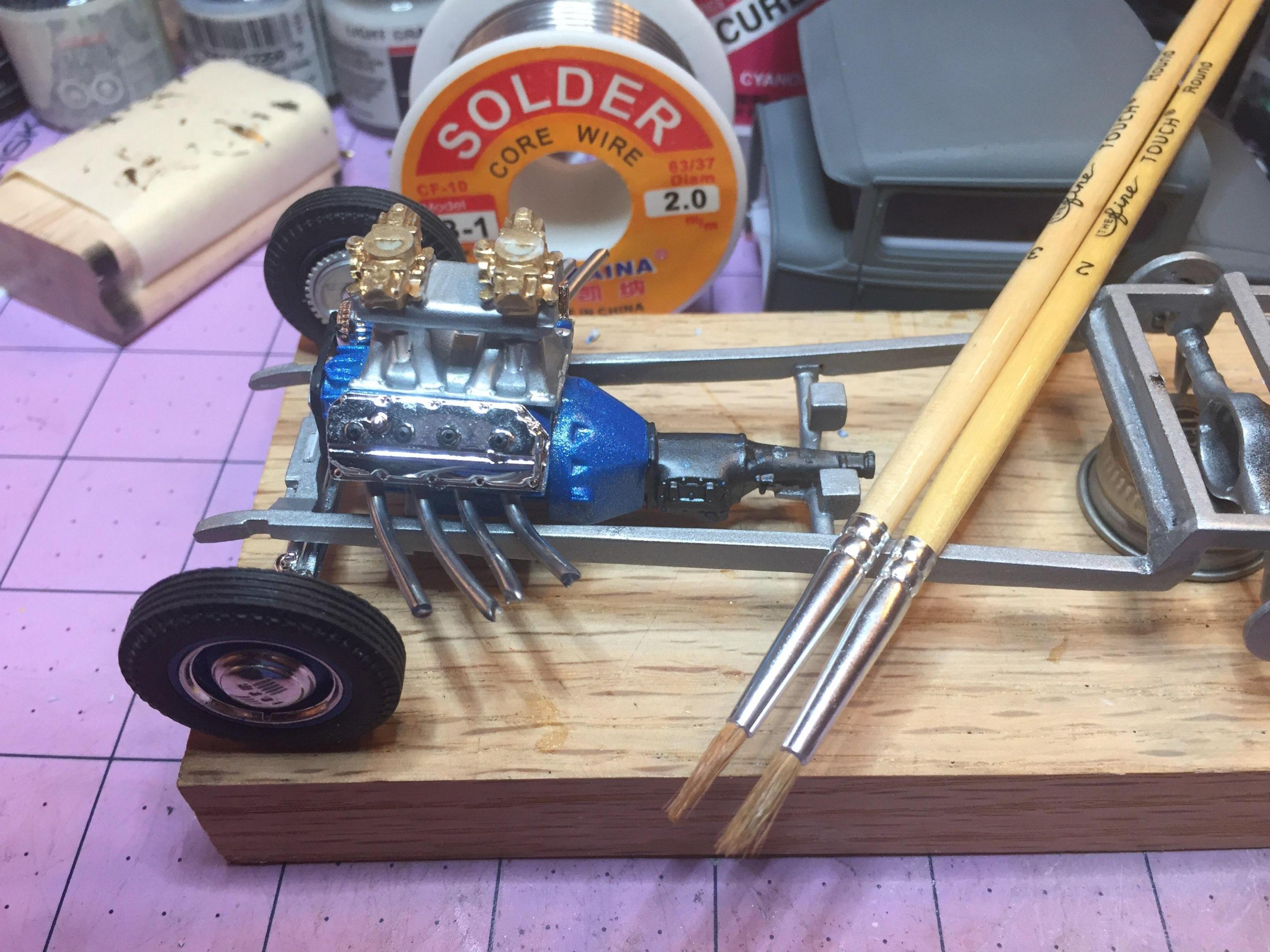

I appreciate that, Carl.  The lesson here is stuffing a 426 hemi into Revell's "B" chassis (the channelled version) has some pitfalls. Also, don't paint till you get those problems sorted. It's one lesson I just won't learn ?.  Yesterday I began the process of creating headers from solder and paint brush ferrules. It's pretty much the only way I can go now. My parts box isn't rich in exhaust headers, but a fairly convincing set can be made this way.  ?.  Thanks for your interest, may we both benefit.
6 hours ago, slusher said:
I am never disappointed in anyones build. I enjoy them and try to.learn things..
Edited by customline
I don't claim my method is the only way to do this, it's just the way I did it today. I'm sure there are modellers here that have a better way so this is not intended as a tutorial.  It's just the easiest way for me. Today.   I started by ripping off the factory cast manifolds that I had glued on previously and drilled holes in the heads to accept the solder. I inserted and glued lengths of solder with thick CA and positioned them in approximate angles.  The hemi heads have exhaust ports angled in an almost overhead attitude ? so the solder is swept up after the CA has cured to clear the frame.
I like to use cheap, wood handle artist brushes for the ferrules. Cut off, drilled out, used Dremel, and filled crimp dimples with thick CA and accelerator and then sanded.
IMG_2306.jpg.9394ef99943dca5d6872cfc7ff65b079.jpgIMG_2297.jpg.3d53252308787473959e3e7e7777313f.jpgIMG_2291.jpg.7ac890d1728ef3cd484acbb59905895d.jpgIMG_2295.jpg.5bc2040df2d6cde493662757afa2fb56.jpgIMG_2299.jpg.f72fc47d30269be3a8ed7841c2dc9784.jpgIMG_2300.jpg.5ebd2f7884c7d9fdf73a5d38081fe51a.jpgall "welded" up and ready for paint, which will be flat or semi black. I don't see a need for flanges because at this point it's too difficult to add them and make it look good. Standing next to it, they can't be seen anyway. Maybe just paint them individually at the ports. Now I need to deal with this mess I made priming the body. ? .  Thanks for your interest and all comments welcome as usual.

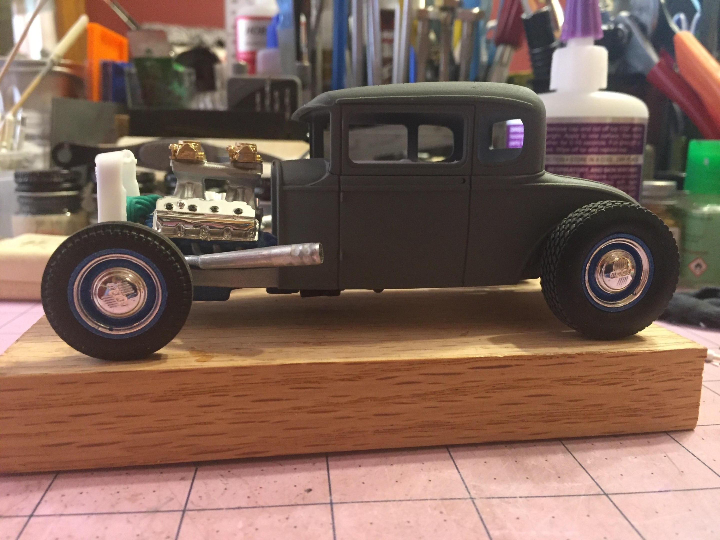

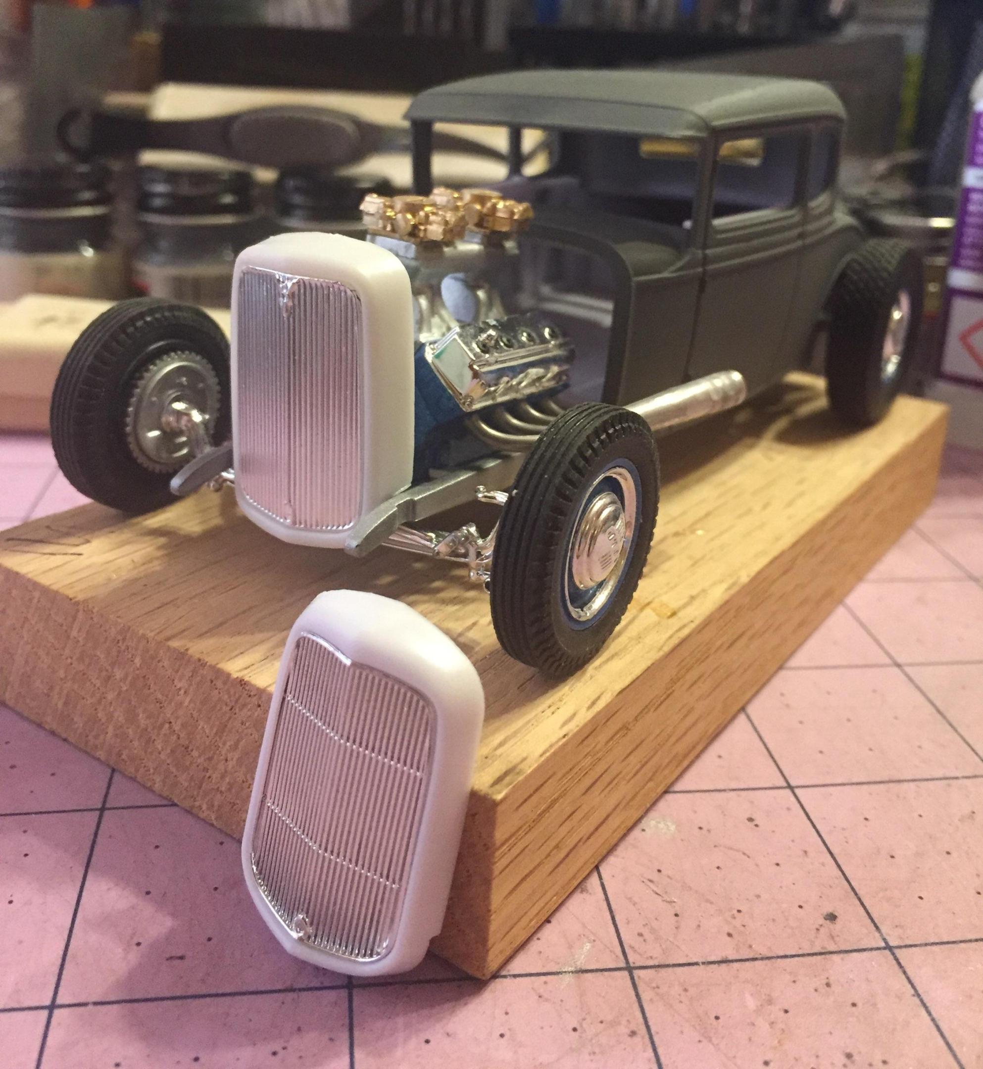

More from today. Back wheels attached (glued - that's how I  roll). Completed right side header. Glued "pumpkin" to axle housing. Experimented with '34 pickup grille- comments welcome! Mock-up time!
IMG_2311.jpg.d2fd8066da7c86e5862ecbc0d3e0cbb1.jpgIMG_2308.thumb.jpg.62079217c2f580e2c659e491b6a072b3.jpgIMG_2307.thumb.jpg.2aa4a00c57a0461685e5f7f3d3ee8590.jpgIMG_2312.jpg.eba6757e88b21d5e8c25f6558c3f1849.jpg
'34 shell will need a little trim on the bottom to drop it about 1/8" and possibly shortening front to back 1/8" because it seems a bit heavy. I'm not liking the tunnel ram, it seems like too much for the rear tires. A single 4 or 2x4 on a "normal" high-rise or maybe the cross-ram would be more appropriate. Six 97s would be great but I haven't got 'em.  I dunno. Thoughts??IMG_2317.jpg.379b40888bb7dd0c0683aec449cef3d9.jpg
Mini update: glued front end to frame and added tie rod. Painted headers.  Temporarily glued dash to make better fitting of inner panels for mockup and creation of firewall. Replaced carbs with different units for a better look (IMHO). Detailed '34 grille (aluminum BMF & flat black wash.)  The truck grille is not a done deal yet but it will get painted along with the deuce shell and a '29.  I'll figure out the winner after all paint work and assembly. '41 Plymouth tail lights are being considered along with the usual suspects. Thanks for looking.?IMG_2334.jpg.61d4bead85b491e844b97f2740ac6c7a.jpgIMG_2330.jpg.fc8b2901726dc06d6685c59b31fdd44c.jpgIMG_2328.jpg.ba42f780875d31721ae2ecef5305eb8b.jpg

I have yet to decide which face ? ? ☺️  to put on this coupe. I will be forced to decide when the paint work is done and it's the only thing left to be done. Thanks for looking and your comments are always appreciated. IMG_2346.jpg.a1045a3943fe5dfae7e55b6281719817.jpgIMG_2341.jpg.b30052b6b7120fffa601a30db109e40a.jpgIMG_2342.jpg.3f4767a19c1ea2731f6f956cd66c5ca5.jpgIMG_2374.jpg.fee5904dd01dab317832363031f91f85.jpgIMG_2343.jpg.ed7218165d713d1dc38a586b60c491be.jpgIMG_2367.jpg.813d4edc23e29252429c106344e62df2.jpgIMG_2372.jpg.2bb59ed6b3e1af475a63a8447b2c505e.jpg
Fixed a typo
Been following this- me likey! Personally, I would go with the Deuce grille- after all, it is one of the most beautiful front ends ever- and I think a low rise 4 bbl manifold would look better. But- build it to please you!
