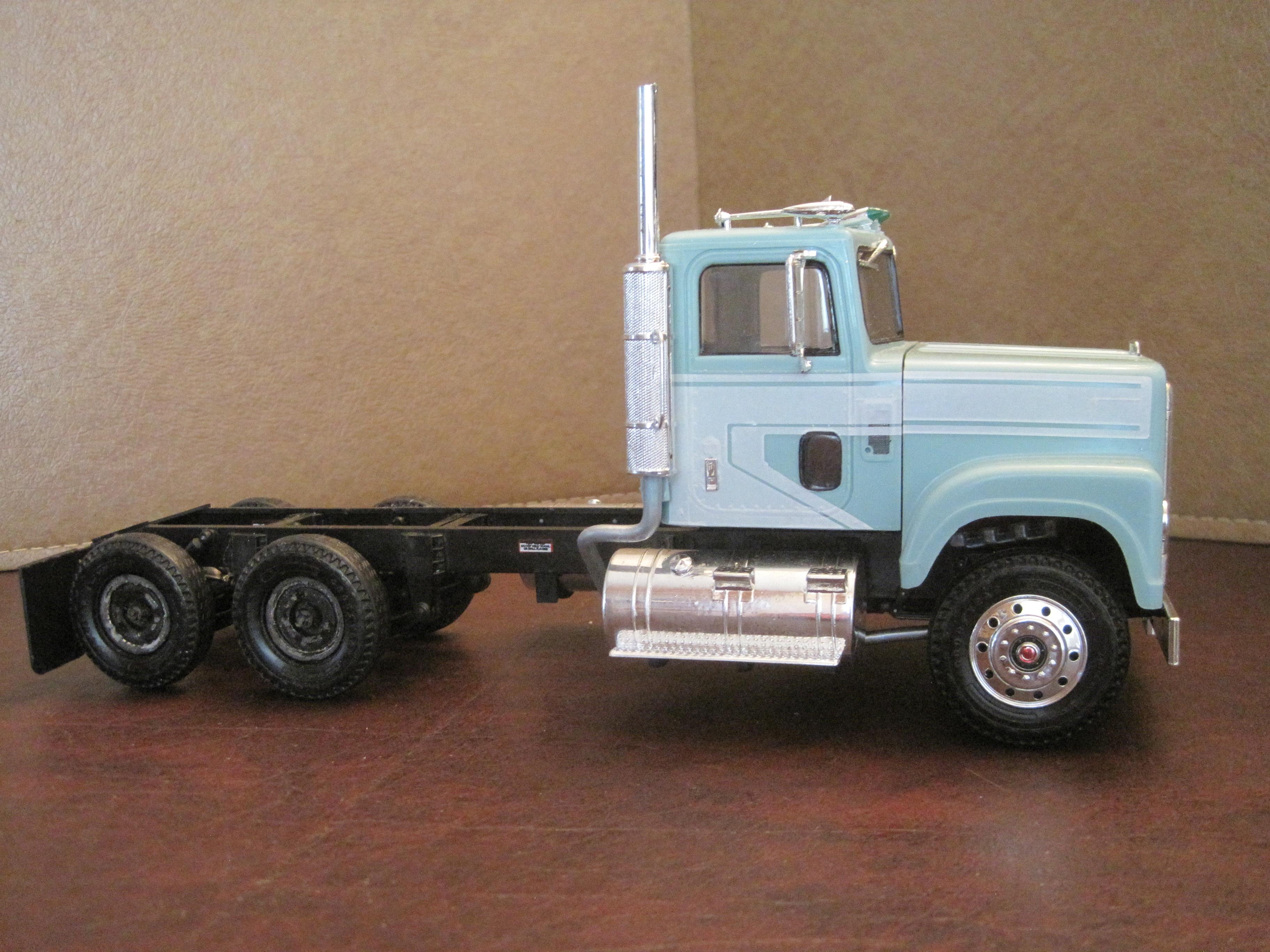

leafsprings Posted May 1, 2022 Posted May 1, 2022 (edited) Good choice for a build. When looking for inspiration, I look at original factory brochures. Seeing a pattern on many 60's and 70's trucks, aluminum front wheels, steel rear wheels. Working on an original issue 4200, used Modeltruckin decals for the IH paint scheme and in the process of converting the spoke wheels to 10 hole aluminum fronts and eventually get 2 hole white steelies for rear. Edited January 9, 2023 by leafsprings

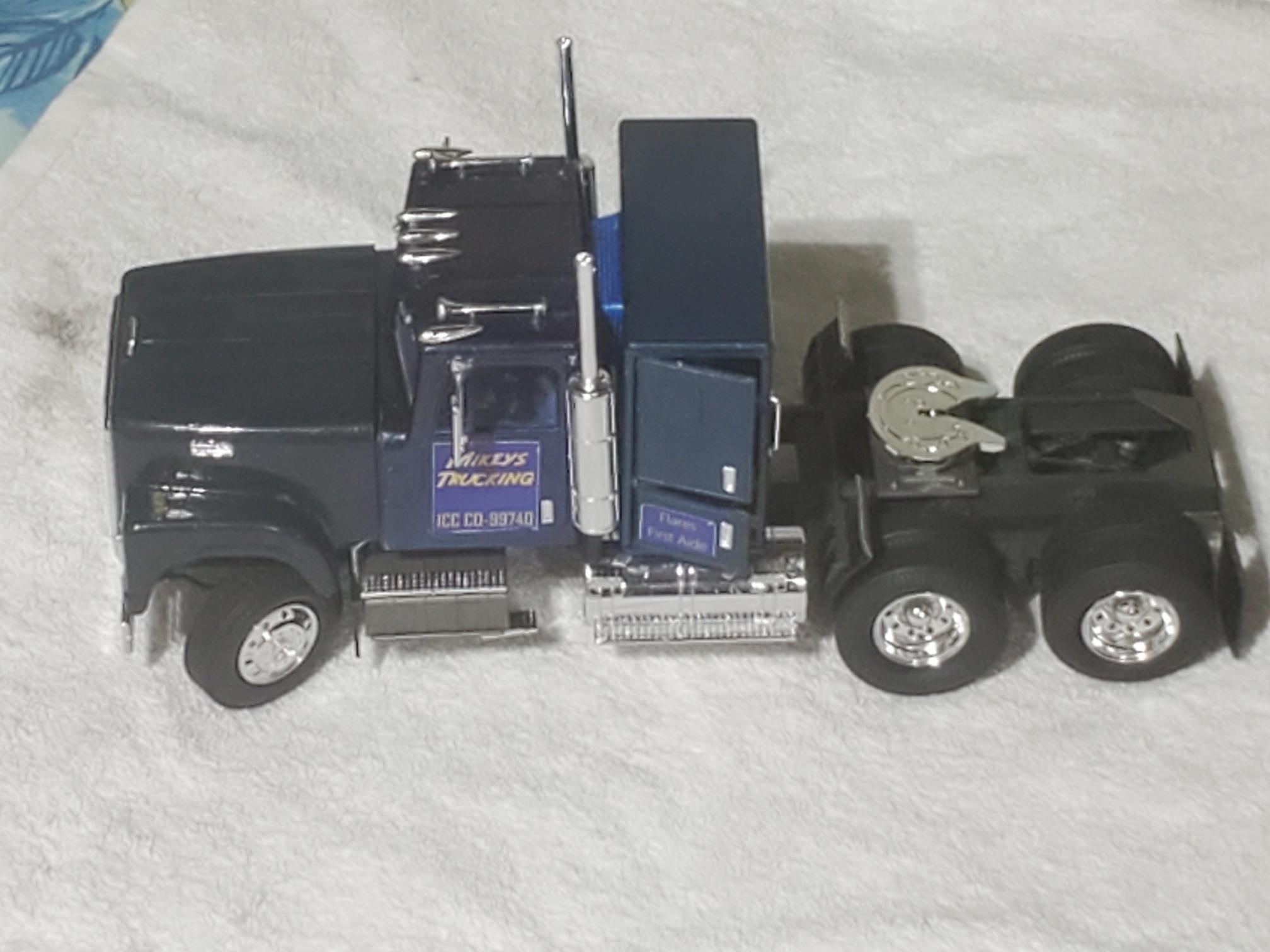

seniorgeek Posted January 9, 2023 Posted January 9, 2023 The chassis went together just fine but the cab, especially the 3 piece interior and the windows, plus the sleeper assemble tried my patience. I am not pleased with the results. One of my worse builds.
Goodwrench3 Posted January 9, 2023 Posted January 9, 2023 RE: "the sleeper assemble tried my patience." Yeah I'd agree with that. I've got mine sitting on a shelf not finished because I'm just not happy with the sleeper. In order to get it to sit straight (vertically), it seems like you need to shim under it. But then the "snorkel" doesn't want to line up with the rear cab window. It seems really to get it to fit right, you'd need to modify the rear cab window so the "snorkel" fits and there are no gaps around it.
Oldmopars Posted January 10, 2023 Posted January 10, 2023 6 hours ago, Goodwrench3 said: RE: "the sleeper assemble tried my patience." Yeah I'd agree with that. I've got mine sitting on a shelf not finished because I'm just not happy with the sleeper. In order to get it to sit straight (vertically), it seems like you need to shim under it. But then the "snorkel" doesn't want to line up with the rear cab window. It seems really to get it to fit right, you'd need to modify the rear cab window so the "snorkel" fits and there are no gaps around it. I glued the sleeper to the cab, made sure they were square, then I attached them to the frame. I may have made a shim, but it has been a while.
