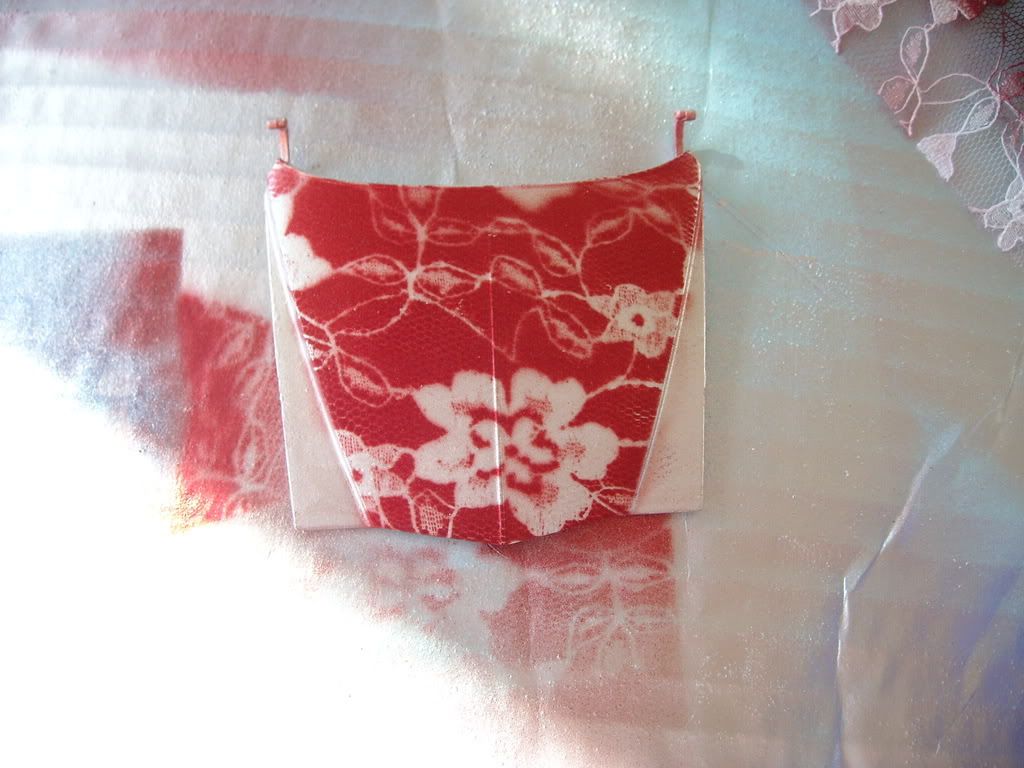

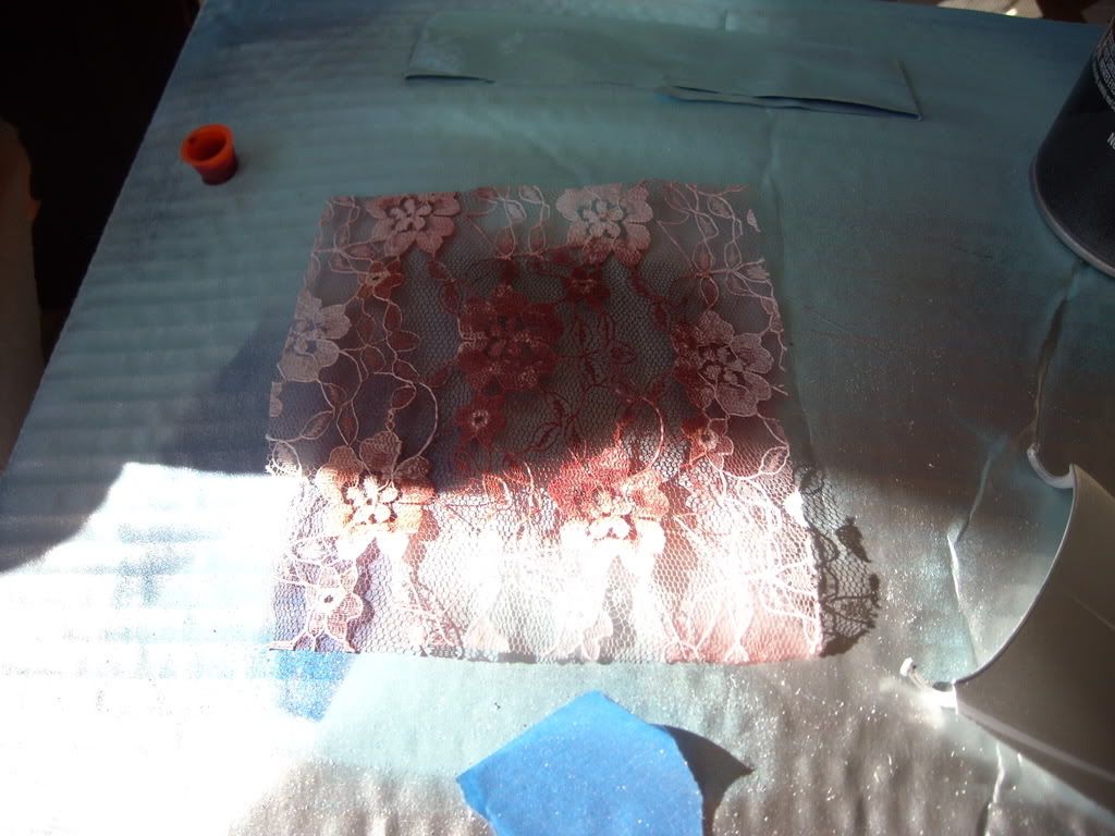

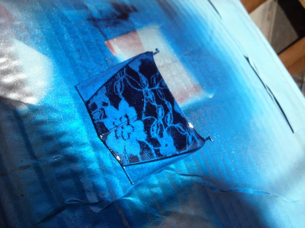

evilone Posted January 8, 2009 Posted January 8, 2009 Yo SDRODDER is a buddy of mine as you all probably know.Anyways he sent me a pm asking me how to lace a build of his.So that got me thinking and i went to the garage to find a good canidate.Well i found one and it is a 90ed caddy donk kit(well ex donk) that will be turned into a LECAB(convertable).I got in the lab today and started shooting paint.Here is my version of a How To Lace a model.Anyone else that have better ways go ahead and post them in here. First:get some lace.I got mine at Wal-Mart 1/2 a yard for $1:50. I already cut mine to what i need for the project. Second:put down a good base coat. While its still kinda tacky(enough to see you finger print on the surrounding box) put the lace down. Third:spray an darker color to make it pop later in the paint job. I sprayed the darker color then took off the lace for you guys to see. Fourth:spray the final color over everything. Mine will be blue as you can see.I added flake to the darker color to give it the added personal touch. Fifth:Clear it. Remember to keep the lace touching the area you want it to appear so you will get all of the detail. If all goes right your part/parts will look like these. Also keep your eyes open for my metallic blue 90ed cadillac lecab in the workbench section real soon .

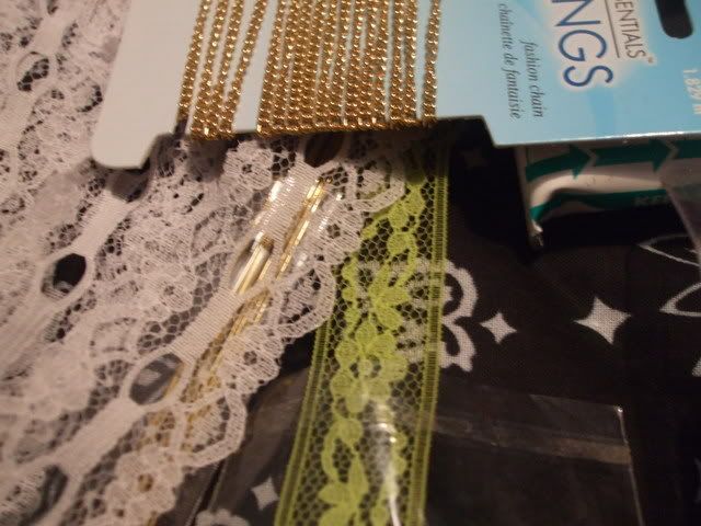

Guest Davkin Posted January 8, 2009 Posted January 8, 2009 Is there any lace out there that would be fine enough to actually be scale? I'm starting a late 50's style custom and would like to do two "laced" stripes on the roof if I can find lace fine enough. David
MADmodelDOCTOR Posted January 8, 2009 Posted January 8, 2009 Is there any lace out there that would be fine enough to actually be scale? I'm starting a late 50's style custom and would like to do two "laced" stripes on the roof if I can find lace fine enough. David This is a good question. Anybody have any ideas ?
gasserfreak Posted January 8, 2009 Posted January 8, 2009 wow, I like the idea of some scale lace on an early 60s style custom. how about this stuff: http://cgi.ebay.com/2-1-2-w-L-Cream-Lace-D...8QQcmdZViewItem
LDO Posted January 8, 2009 Posted January 8, 2009 This may sound heretical, but why not have someone make a custom decal? It would have clean edges and be in scale.
Guest Davkin Posted January 8, 2009 Posted January 8, 2009 how about this stuff: Whatever our minds are they think alike I looked up dollhouse lace on ebay myself and found that exact listing. It still seems large, (and a bit plain) for my purposes. This may sound heretical, but why not have someone make a custom decal? It would have clean edges and be in scale. A decal would be fine if you don't need to color match and on my project I want the lace color to match the body color. The main body on my project will be candy green over metalflake gold and the roof will just be metalflake gold and I was thinking a couple stripes of candy green lace would look good on the roof. David
Dragon7665 Posted January 9, 2009 Posted January 9, 2009 Is there any lace out there that would be fine enough to actually be scale? I'm starting a late 50's style custom and would like to do two "laced" stripes on the roof if I can find lace fine enough. David Yes most of the well stocked fabric stores will have the smaller stuff, mainly for doll clothing & etc, but it can also be easily found on 1:1 scale Dept Store Clothing.... Just make sure you don't raid your Spouse's Underwear Drawer, or She may have alot of questions for ya You could also check the clothing dept. clearence sections, but again be prepared for the weird looks or comments(It can be less of a Nerve Ordeal, if you actually tell the small clerk that you need help finding something in a Lacy Top, for a Wife/GF/Etc that is about her size )

mademan Posted January 13, 2009 Posted January 13, 2009 yes there is some.... somewhat to scale lace. this green one in particular is PERFECT for the side of a 63 impala im doing. I only got a few yards of it, just gotta keep your eyes open.
