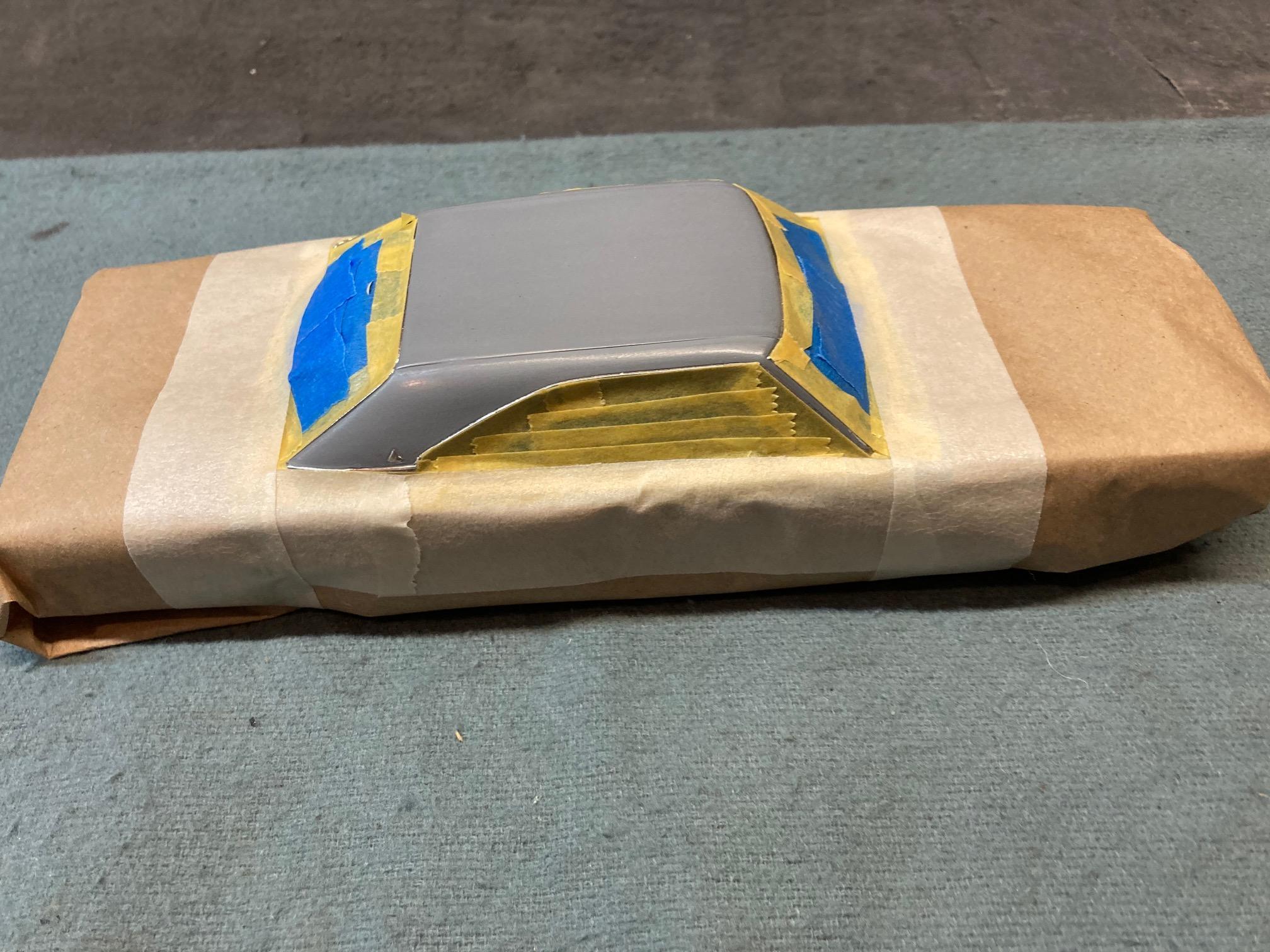

69NovaYenko Posted April 13, 2022 Posted April 13, 2022 (edited) I was wondering what type of "PAPER" do you guys & gals use to mask off your projects. Dollar wise it isn't practical to wrap the ENTIRE body in Tamiya tape. Edited April 17, 2022 by 69NovaYenko

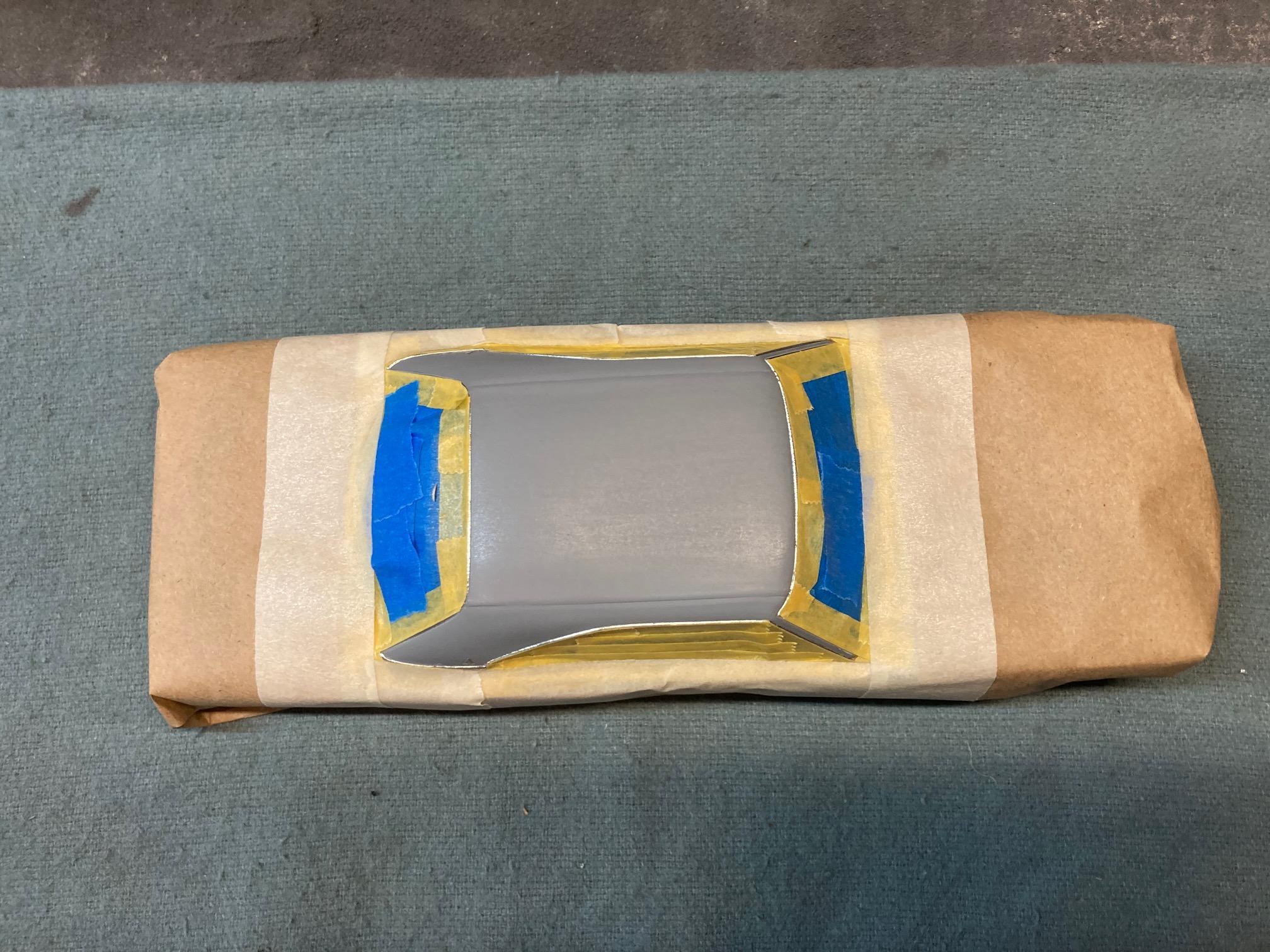

StevenGuthmiller Posted April 14, 2022 Posted April 14, 2022 On 4/13/2022 at 7:19 AM, 69NovaYenko said: I was wondering what type of "PAPER" do you guys & gals use to mask off your projects. Dollar wise it isn't practical to wrap the ENTIRE body in Tamiya tape. The paper pictured is painters "Masking Paper" available in the paint section of any home improvement or hardware store, or online of course. It comes in all different widths and lengths, but a standard size roll of 9" x 180 feet will cost you somewhere in the neighborhood of $2.00 or $3.00. Very inexpensive, and enough to last you a very long time. Steve 1

69NovaYenko Posted April 15, 2022 Author Posted April 15, 2022 14 minutes ago, StevenGuthmiller said: Just lurking. Came across this post using some photos of one of my projects, so I thought the OP might want my 2 cents. Steve By all means please give us your 2 cents . I like the way you masked off the body.
StevenGuthmiller Posted April 15, 2022 Posted April 15, 2022 15 minutes ago, 69NovaYenko said: By all means please give us your 2 cents . I like the way you masked off the body. I mask the paint edges with Tamiya tape first. Then I use the masking paper to to cover as much of the remainder of the body as possible. Finally, I tape the edges of the paper down with blue painter’s tape and regular masking tape, but I do my best to do it in a way so that there is as little of those tapes touching the painted surface as possible. I do this to avoid any of the problems that can occur with garden variety masking tapes, such as pulling up paint or leaving adhesive or tape imprints behind. I use masking paper not because I want to save money on tape, but because I’ve had way too many bad outcomes with using it on my painted surfaces and I want as little tape touching the paint as possible. Steve 1
