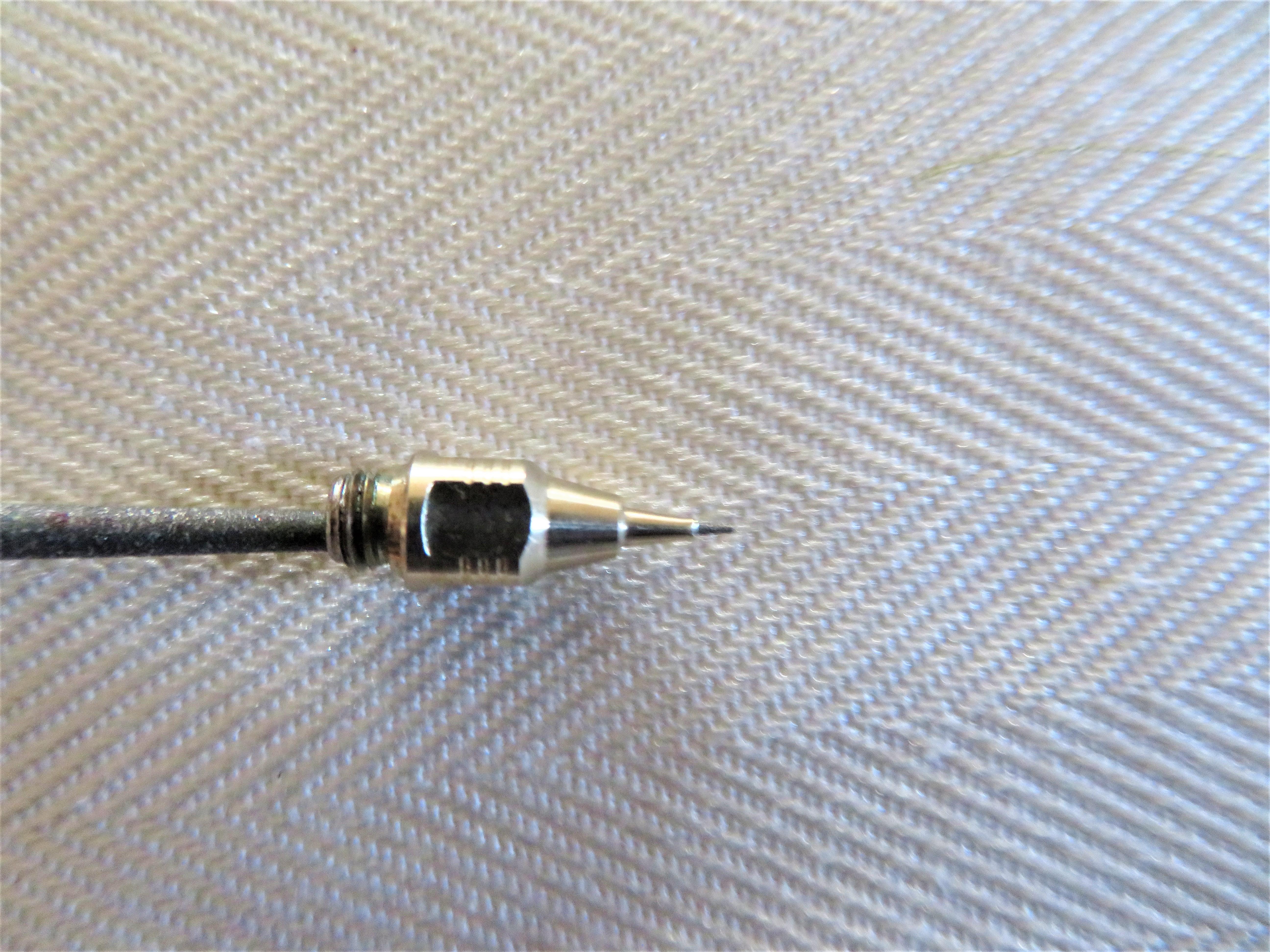

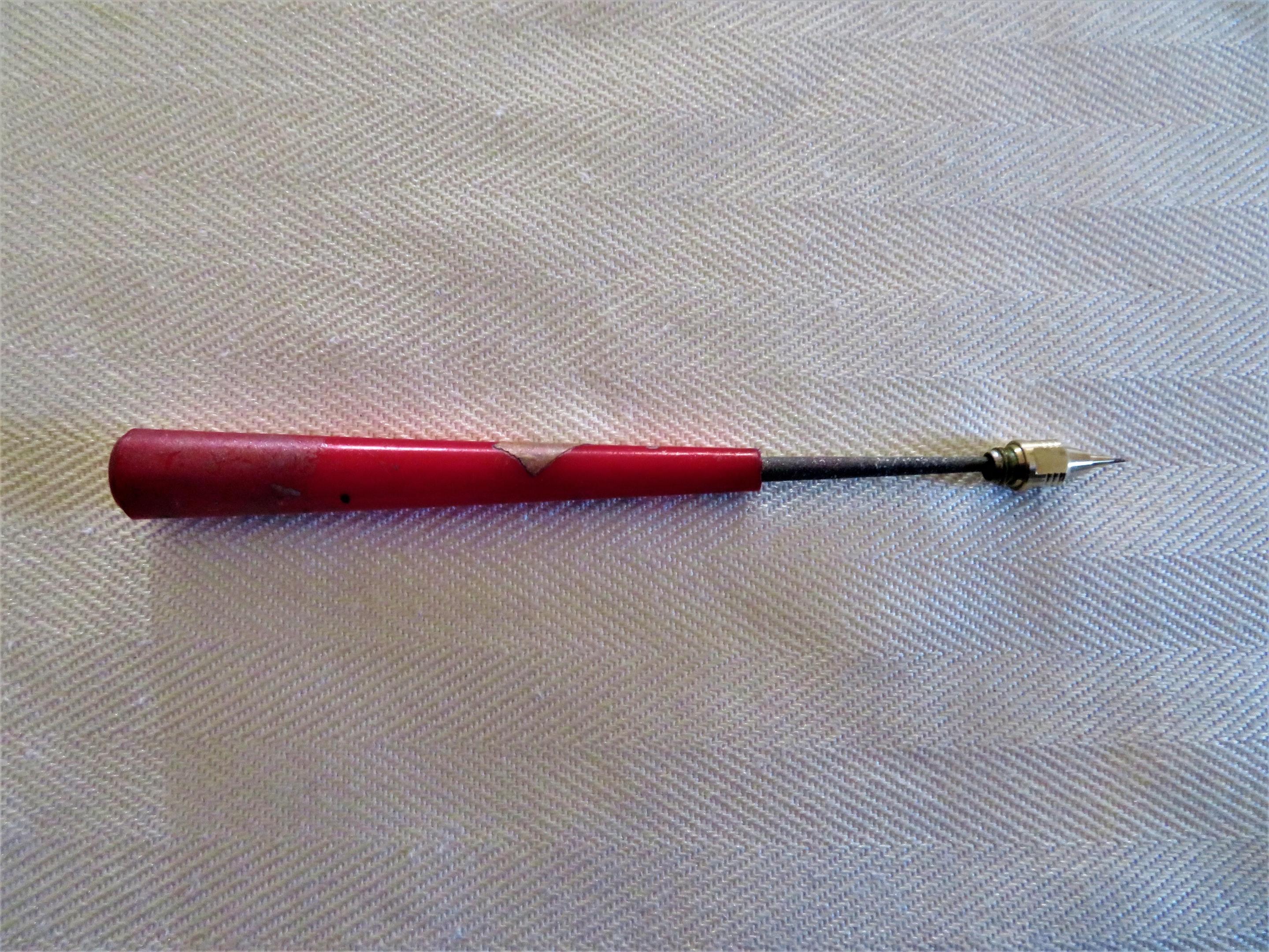

Mike 1017 Posted April 18, 2022 Posted April 18, 2022 19 hours ago, peteski said: 30 minutes in solvent in an ultrasonic cleaner?!?!? Holy crapolla! How long did the airbrush sit uncleaned? 10 years?!? I don't get it. I said it earlier, like Mike, I give my airbrush a good flushing (lacquer thinner) after ever paint job. I have not timed myself, but it has to be less than 7 minutes. Probably more like 3. That gets the airbrush really clean. But I on;t use "stinky" paints. I have no experience with water-based paints, but I have heard that they can clog up airbrushes. Lets have an Airbrush cleaning shoot out at the OK Coral. I left out a couple of steps. I use jewelry bead reamer to smooth out the inside of the tip, the part that the needle slides through, and the trigger. Anything that I can clean with a micro brush or old paint brush. A drop of oil where the trigger hits the air release valve. I use the 6,000 8,000 and 12,000 polishing sheets on the needle. It sprays better than new. Mike 1017
peteski Posted April 19, 2022 Posted April 19, 2022 10 hours ago, Mike 1017 said: I use jewelry bead reamer to smooth out the inside of the tip, the part that the needle slides through, and the trigger. Anything that I can clean with a micro brush or old paint brush. I would NEVER, NEVER, NEVER, NEVER insert any hard objects into the very delicate brass tip!!!! Microbrush - yes. Reamer - NOOOOOOOO!! Besides, since I flush the airbrush with lacquer thinner after every paint job (right after painting, not few hours or days later), the tip of my airbrush (Badger model 200) doesn't clog. Plus, the needle itself (when closed) fits tightly into the nozzle and shouldn't allow paint to accumulate. I am still cringing about what you mentioned!

Mike 1017 Posted April 19, 2022 Posted April 19, 2022 11 hours ago, peteski said: I would NEVER, NEVER, NEVER, NEVER insert any hard objects into the very delicate brass tip!!!! Microbrush - yes. Reamer - NOOOOOOOO!! Besides, since I flush the airbrush with lacquer thinner after every paint job (right after painting, not few hours or days later), the tip of my airbrush (Badger model 200) doesn't clog. Plus, the needle itself (when closed) fits tightly into the nozzle and shouldn't allow paint to accumulate. I am still cringing about what you mentioned! The reamer is very fine and narrow. Sometimes it will push dried paint through the tip. I don't put any pressure on the reamer just lightly spin the tip on top. Until it feels smooth The first time I did this I could really feel the imperfections in the tip. There is a U Tube video about tuning up an airbrush Mike 1017
peteski Posted April 20, 2022 Posted April 20, 2022 Well Mike, that is just not something I would do to the nozzle. Besides, I never had paint clogging the tip enough that it would require reaming. I will repeat what I said few more times: I flush the airbrush immediately after every paint session. No paint remains in the passages. It is all clean. However I only shoot "stinky" paints through my airbrush. But even with water-based acrylics, I would think that if you flush the airbrush right after a painting session, you should be able to prevent any paint clots.
