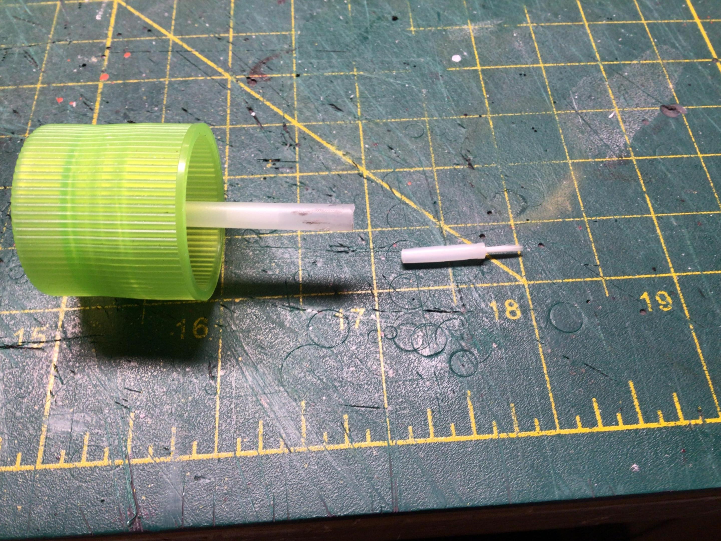

bluestringer Posted May 13, 2022 Posted May 13, 2022 8 hours ago, NOBLNG said: The regular Tamiya thin has a lot stronger smell than the Quick Setting stuff. Also, once the bottle is about half empty, the brush will not pick up near as much since the reservoir stem is not submerged. I have poured two half bottles together to get a full one. I just started using it and found out the stem is adjustable. You can pull it out a little further to let it reach further into the bottle. I like it, and I also started using their regular cement for larger parts, works well. 3 1
NOBLNG Posted May 13, 2022 Posted May 13, 2022 2 hours ago, bluestringer said: I just started using it and found out the stem is adjustable. You can pull it out a little further to let it reach further into the bottle. I like it, and I also started using their regular cement for larger parts, works well. Well how about that…you learn something new every day!? As said this stuff will make a very strong joint on any size of parts since it “welds” the pieces together…but they have to fit with little to no gap. 2

Mr. Metallic Posted May 17, 2022 Posted May 17, 2022 On 5/13/2022 at 6:45 AM, bluestringer said: I just started using it and found out the stem is adjustable. You can pull it out a little further to let it reach further into the bottle. I like it, and I also started using their regular cement for larger parts, works well. I noticed that the brush seemed short. My bottle was starting to get to the point where I almost couldn't reach the glue. You just saved me from throwing away a half bottle of glue. Not that's it's expensive, just the principal of it. ? 2
