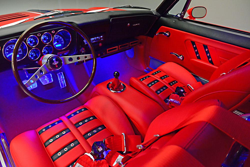

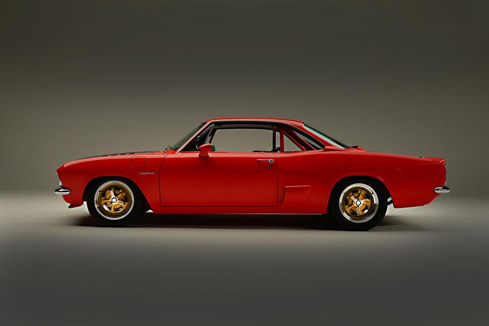

At SEMA 2021, I ran across a beautiful custom Corvair at the Meguiar's booth named "Rare Vair" completed by a gentleman named Lonnie Gilbertson. I took a few pictures and decided it would have to be a future model build.

This may not be all that difficult to accomplish Emre as back in the day a conversion kit was marketed by Crower that allowed placing a V8 into the back seat by flipping the transaxle 180. Considering that the kit interior can be built without a rear seat and the basic pan chassis has enough material to cutaway, it can be done I believe. The stock kit may already include similar side scoops as shown on that gorgeous red Corvair. (My first car was a 2nd Gen Corvair and I poured over articles to enhance the “poor man’s Porsche)
