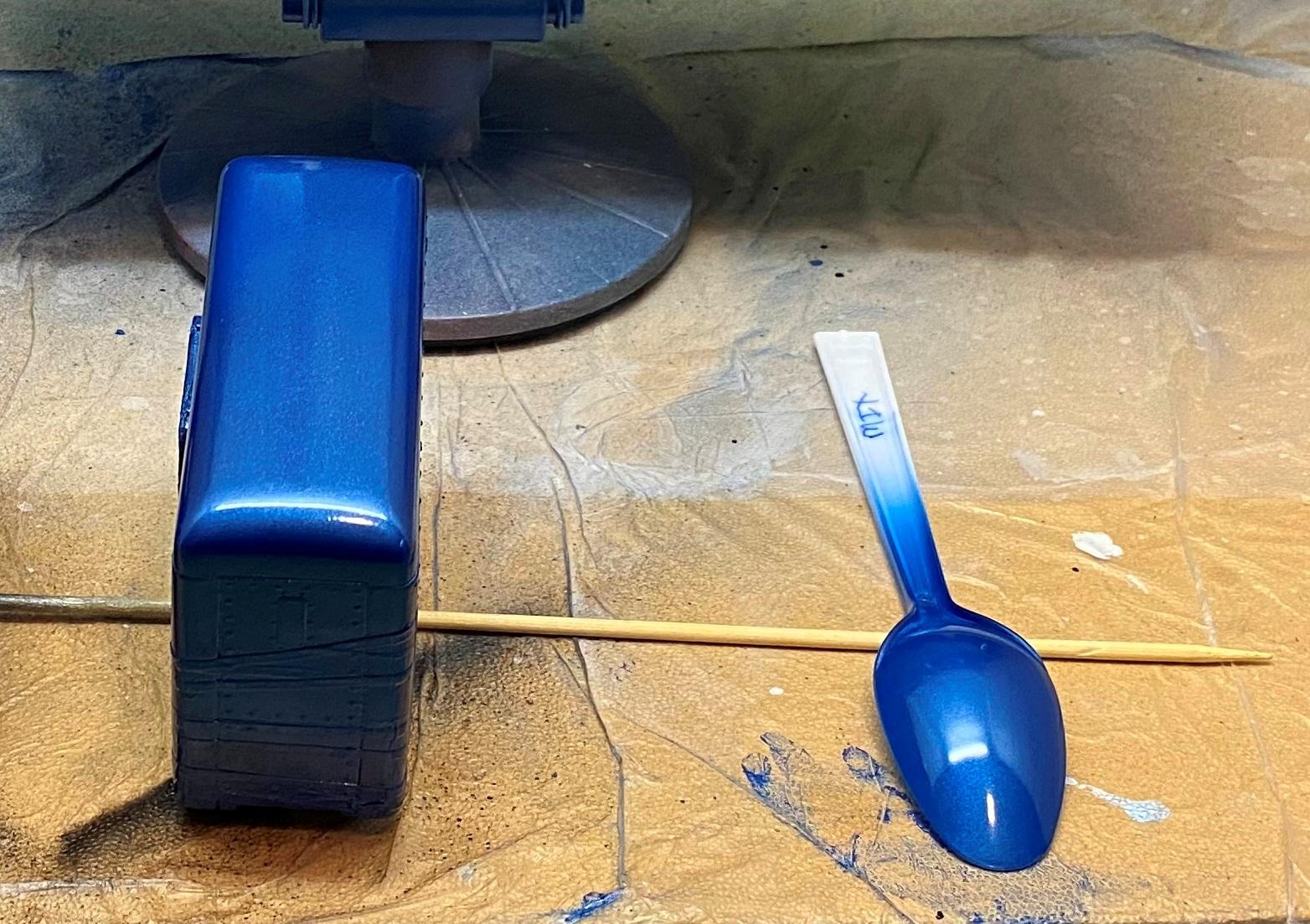

Bills72sj Posted May 17, 2022 Posted May 17, 2022 I just painted these last week. i used two different colors of Testors metallic blue enamel mixed together. Then filled the just emptied bottles of with hardware store lacquer thinner. (To extract every last bit of color) All of it was dumped into a larger clean/new jar. This yielded 1 full fluid ounce of thinned paint. It was prayed at 20 psi through a 0.5mm airbrush. The spoon is bare plastic with no primer whatsoever. The sleeper is over Future (used to seal the masking to prevent bleed under). The gloss is amazing. I may likely not clear coat it. Though I am going to be patient and let it cure for quite a few days before handling. The fact that it is Testors enamel means, it will be pretty tough one it does cure fully.
