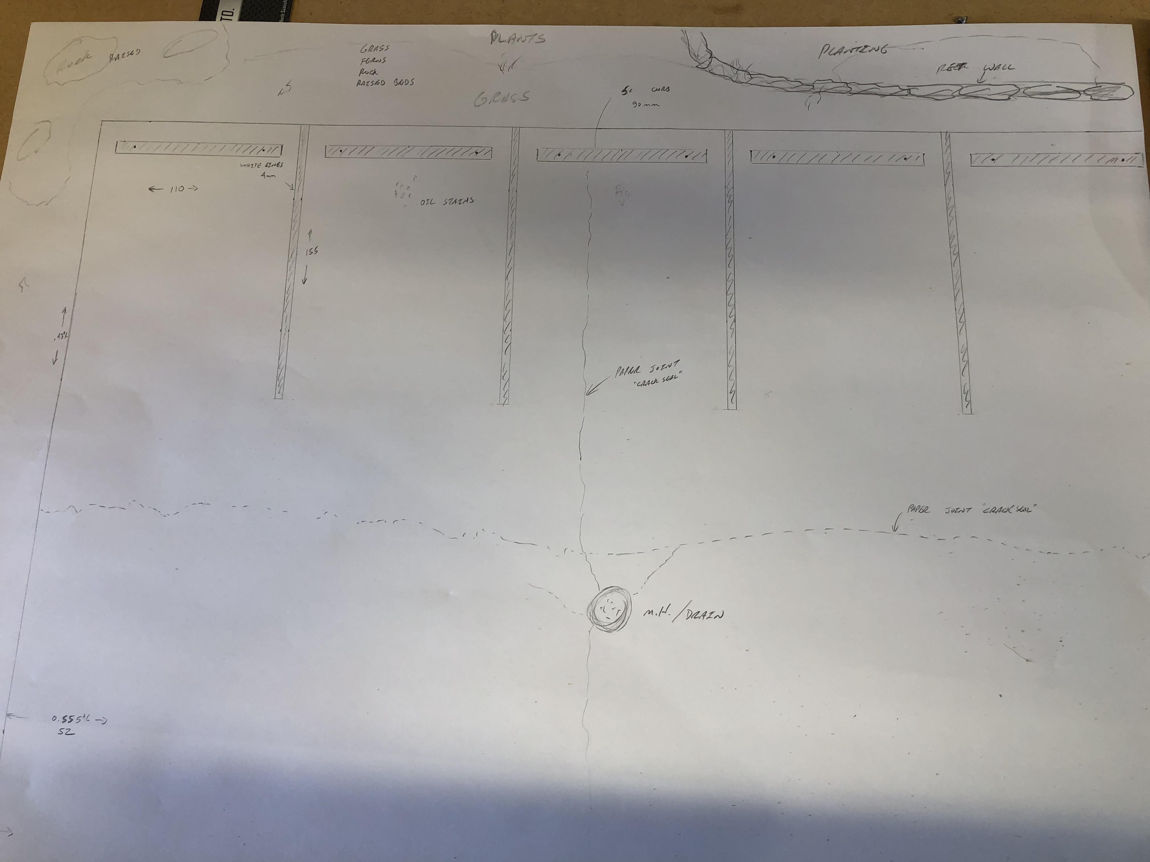

I started with a quick, close to scale, and slightly crude sketch. I love drafting and always like to have a visual reference.

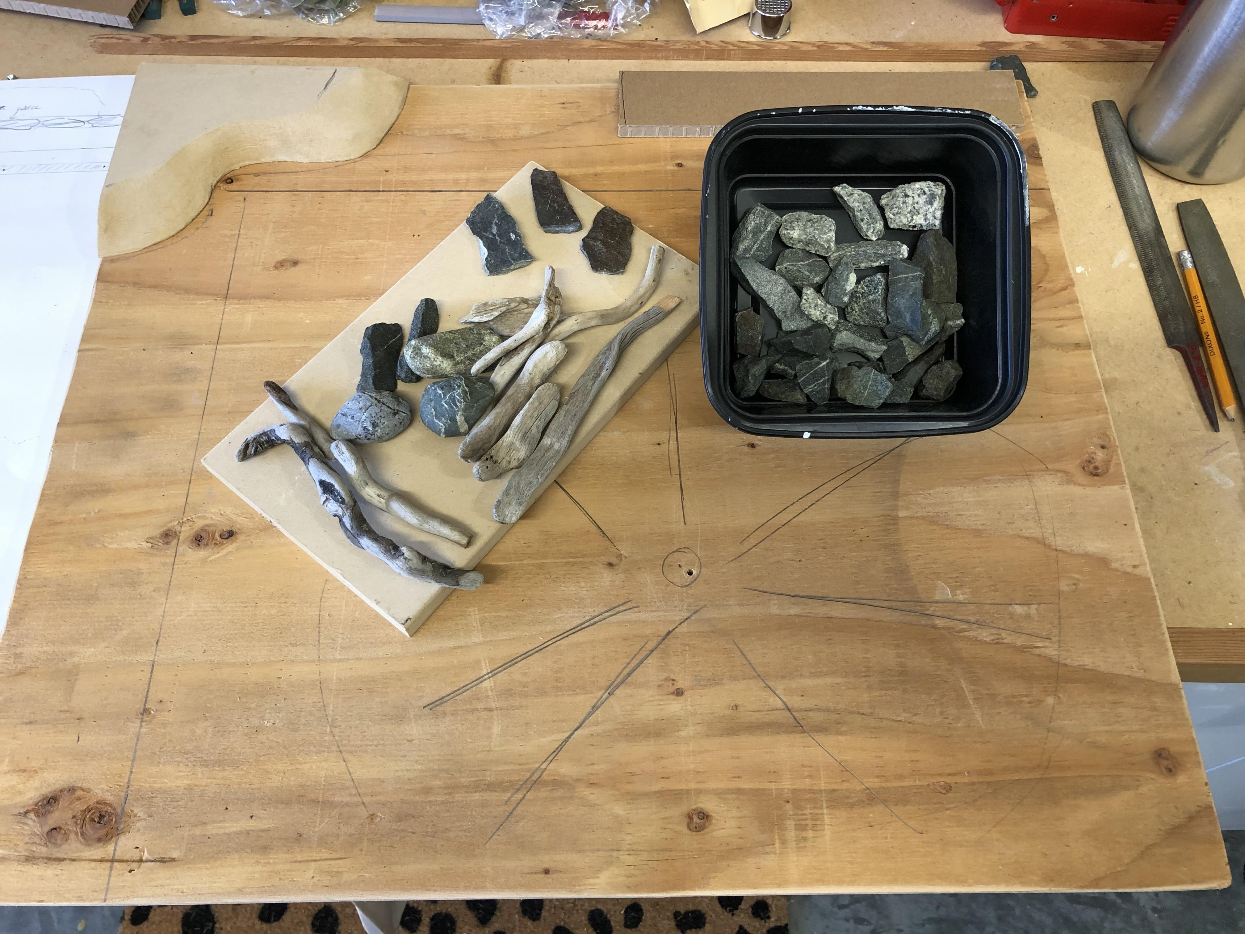

A walk around the yard to appropriate some supplies. The small driftwood twigs were from a local beach collected years ago for use on birdhouses.

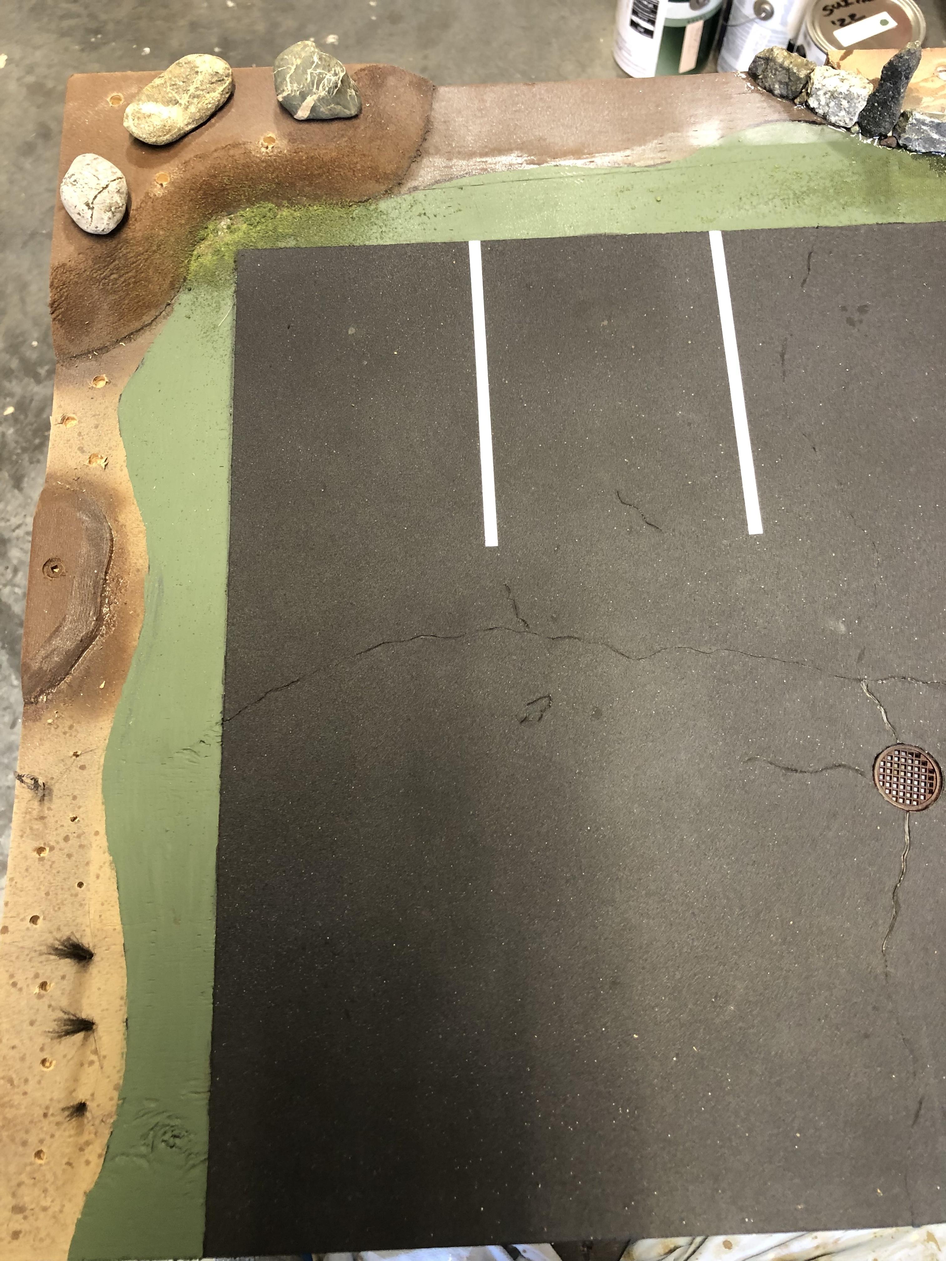

The base is 1/2” plywood which is 19” by 24”, the hole in it will make sense later…

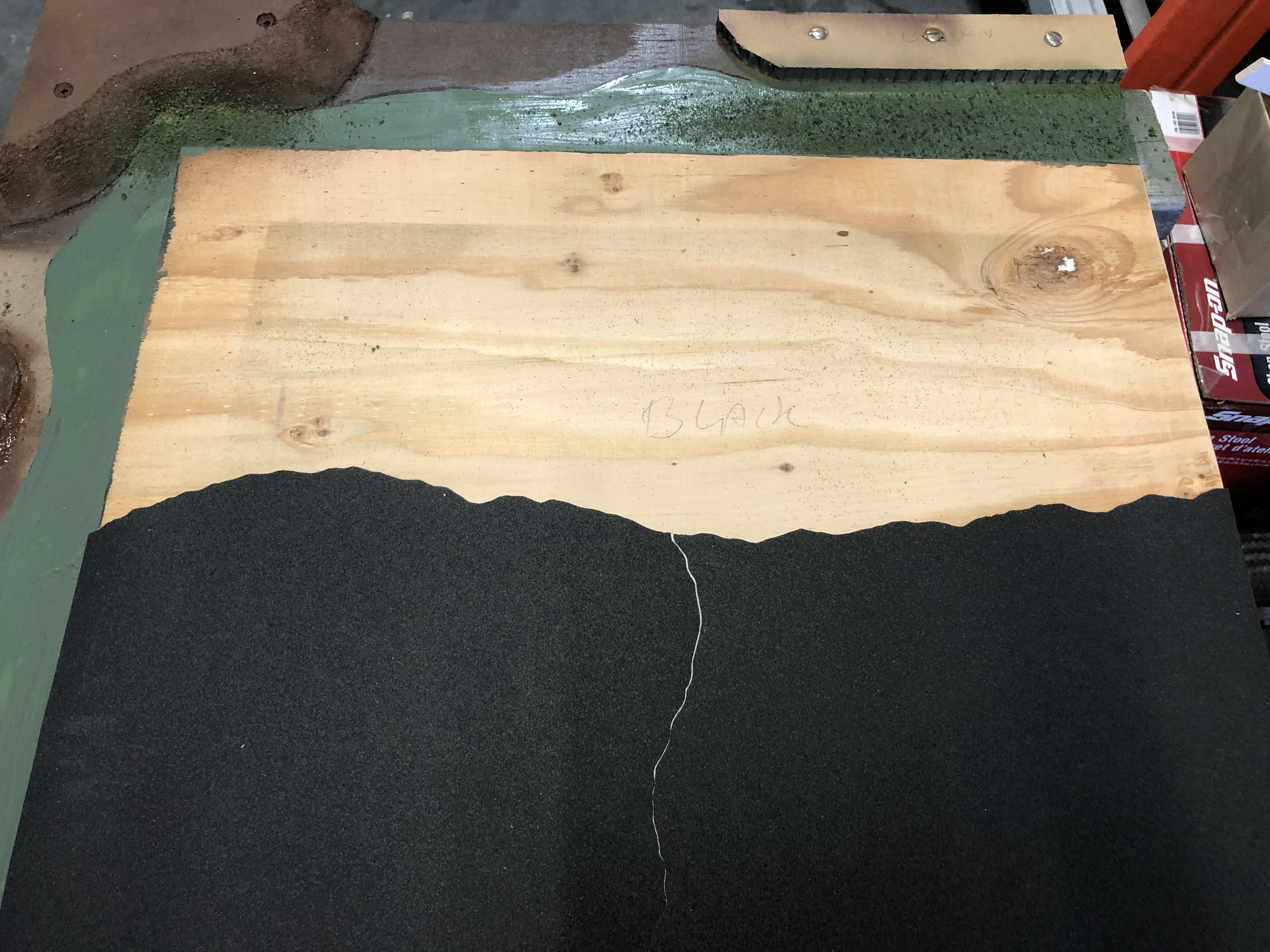

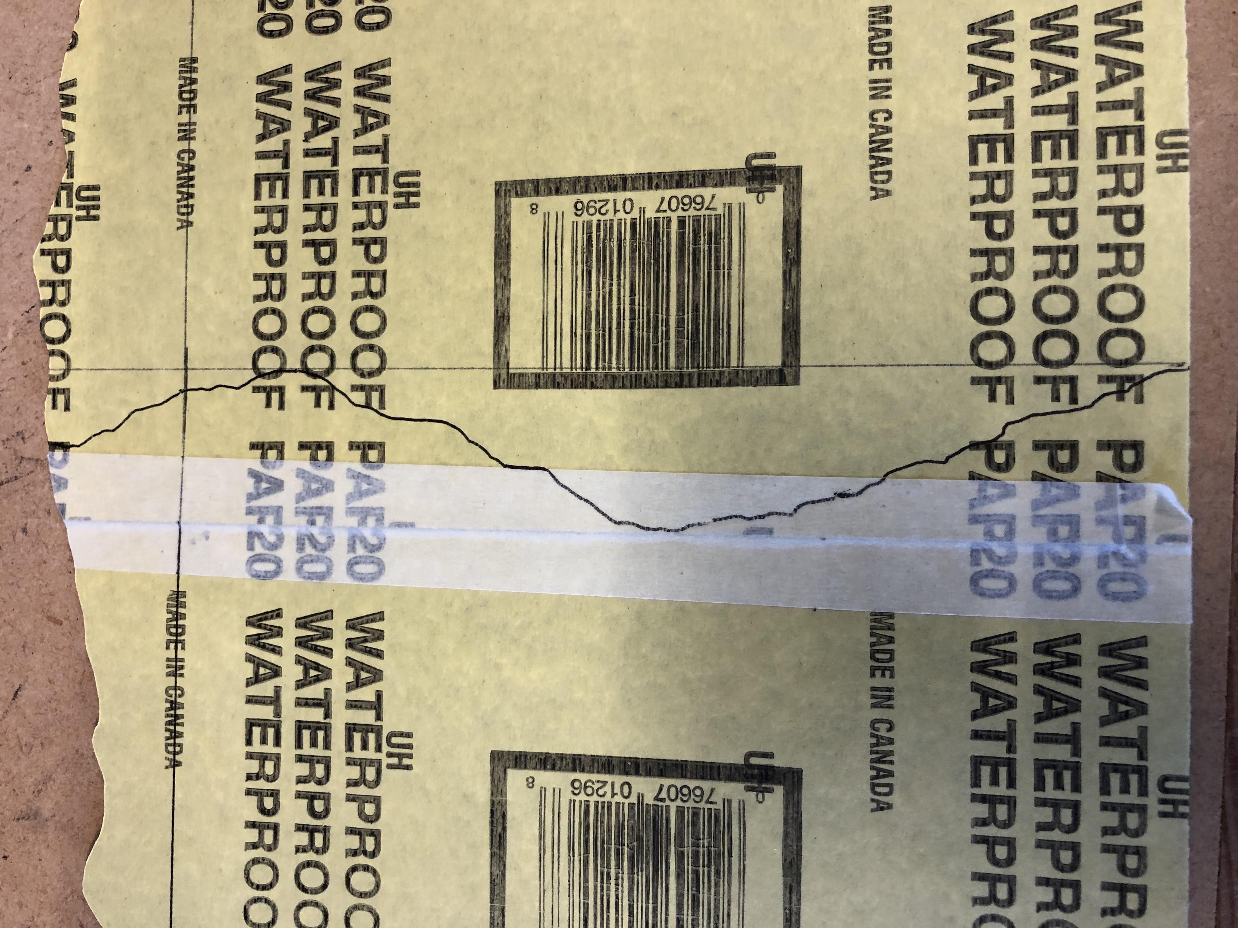

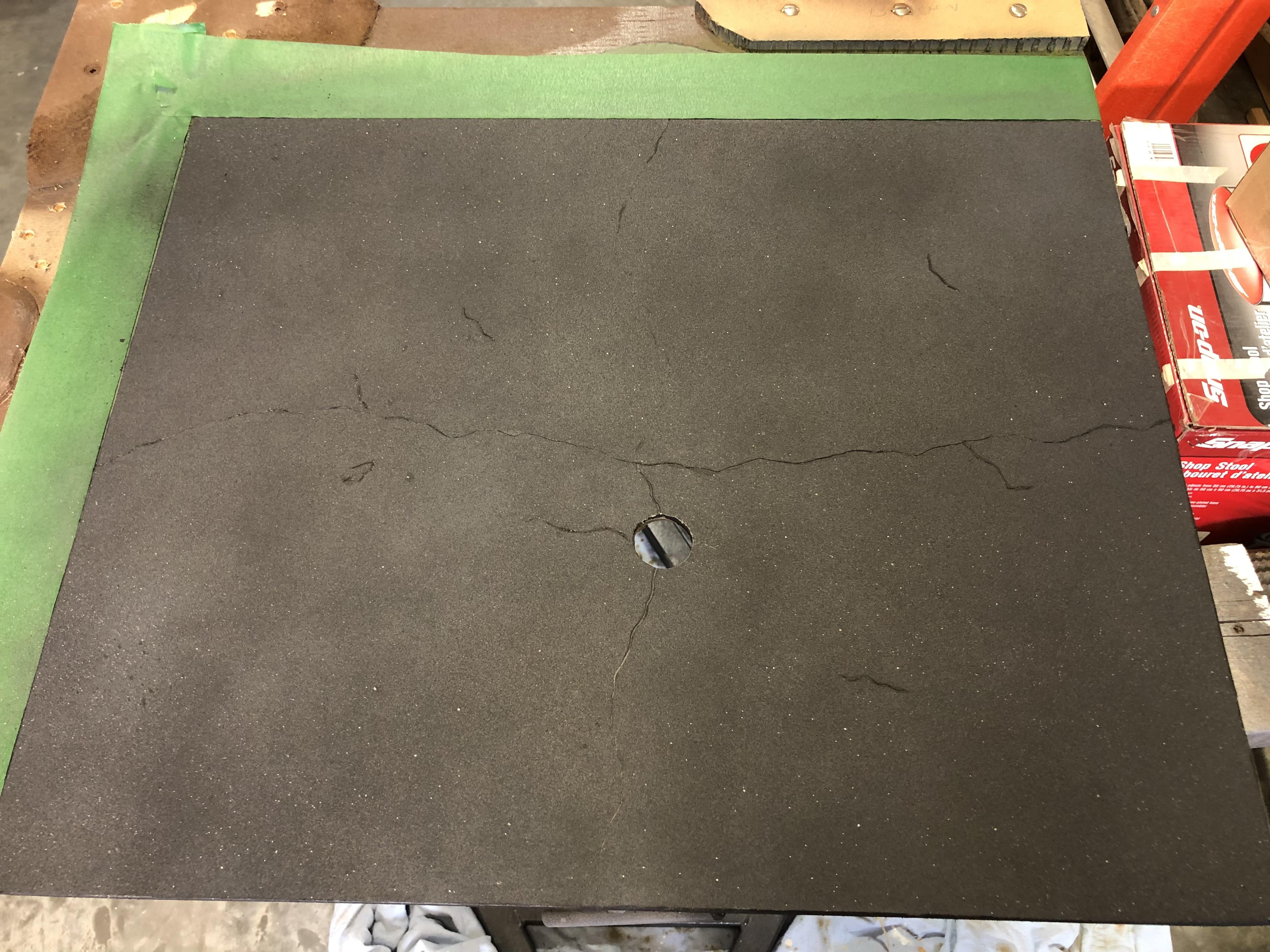

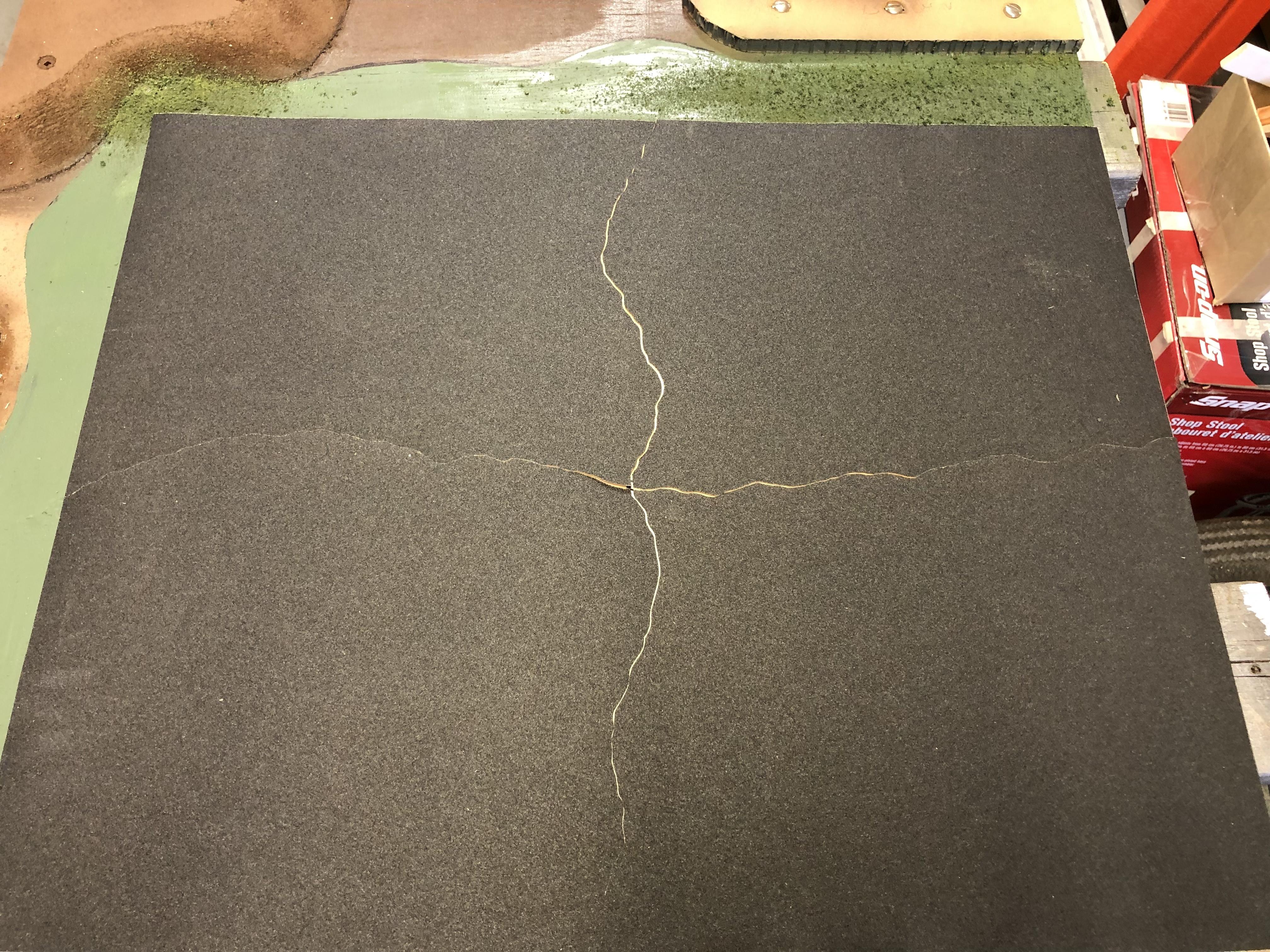

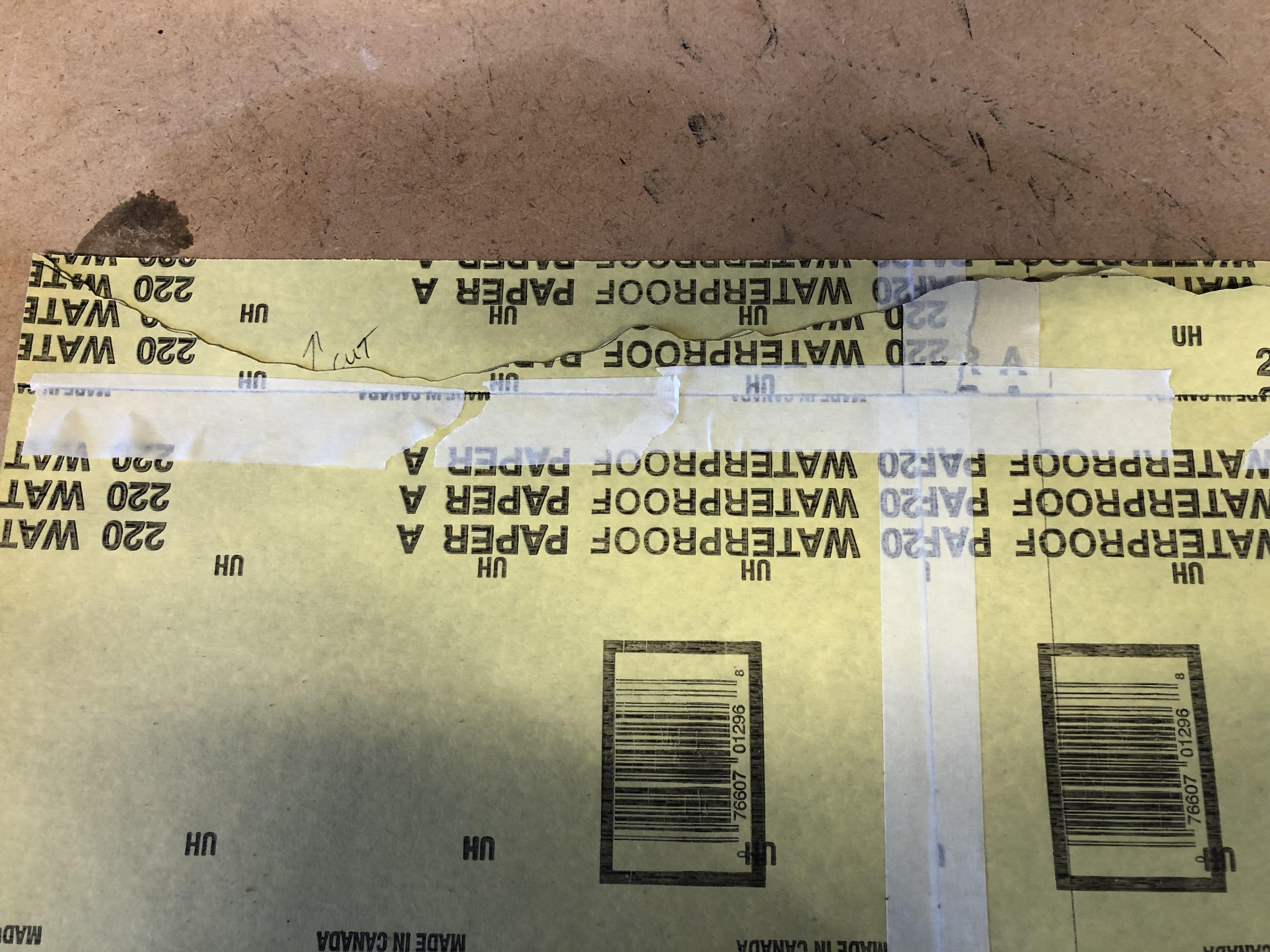

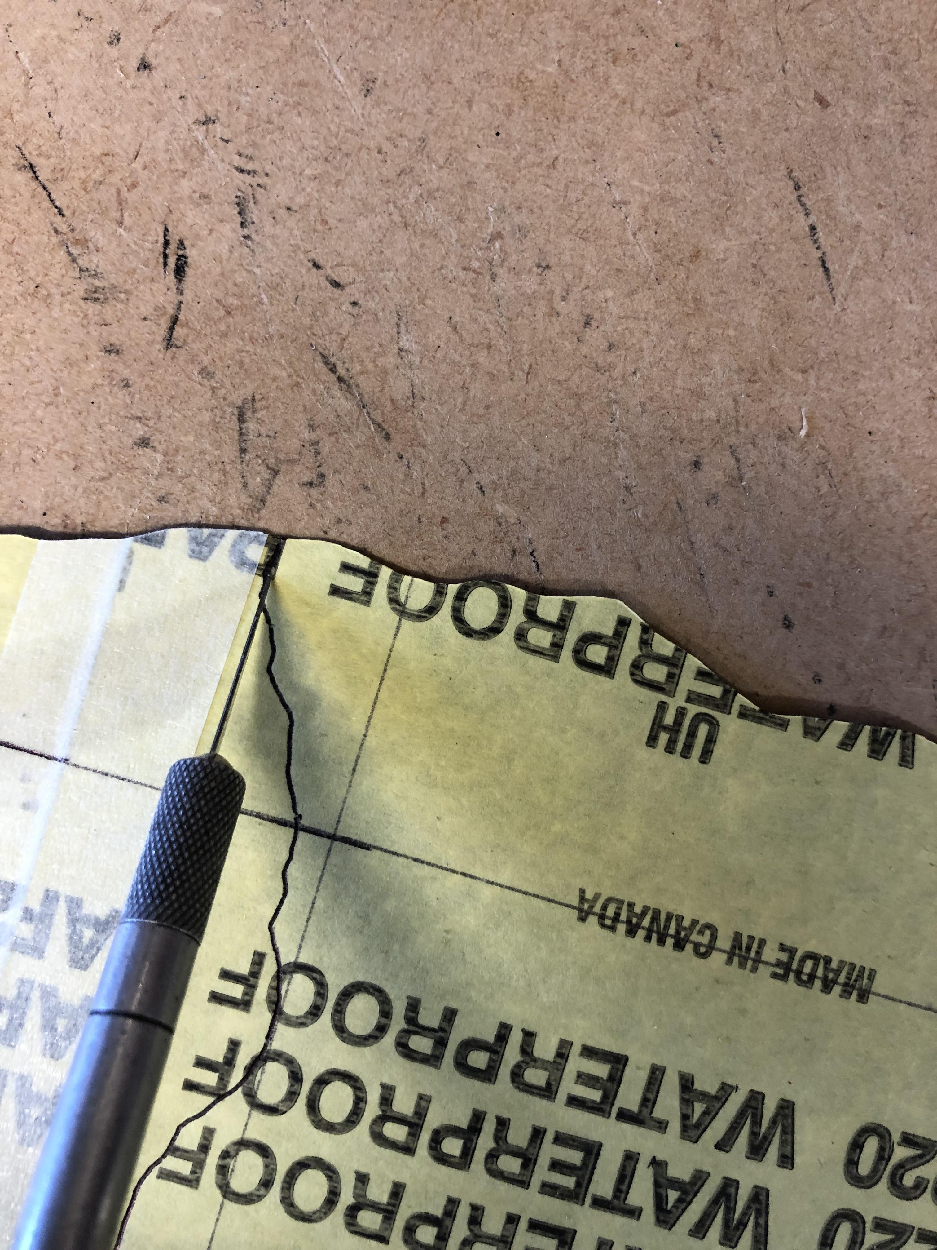

For the “asphalt” I chose 220 sandpaper. Parking lots and driveways typically use a smaller aggregate in the mix compared to roads and highways, which would typically be a coarser aggregate, for a highway 120 would probably be a better choice. Instead of gluing the sandpaper down with square edge’s butted together, I had the idea of creating “cracks” in the pavement as would likely occur naturally over time. So I overlapped the paper and cut a random edge.
The results after cutting…

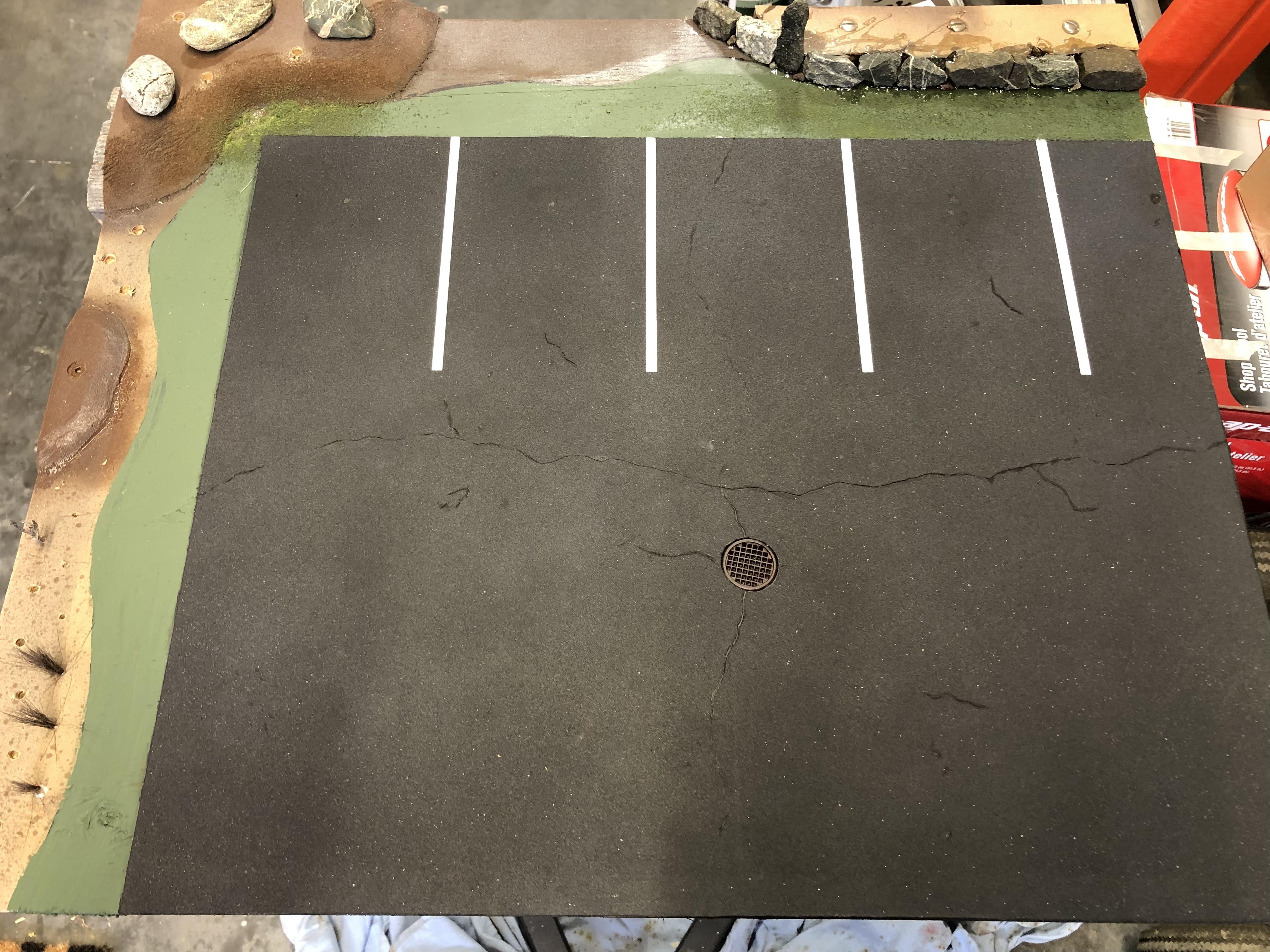

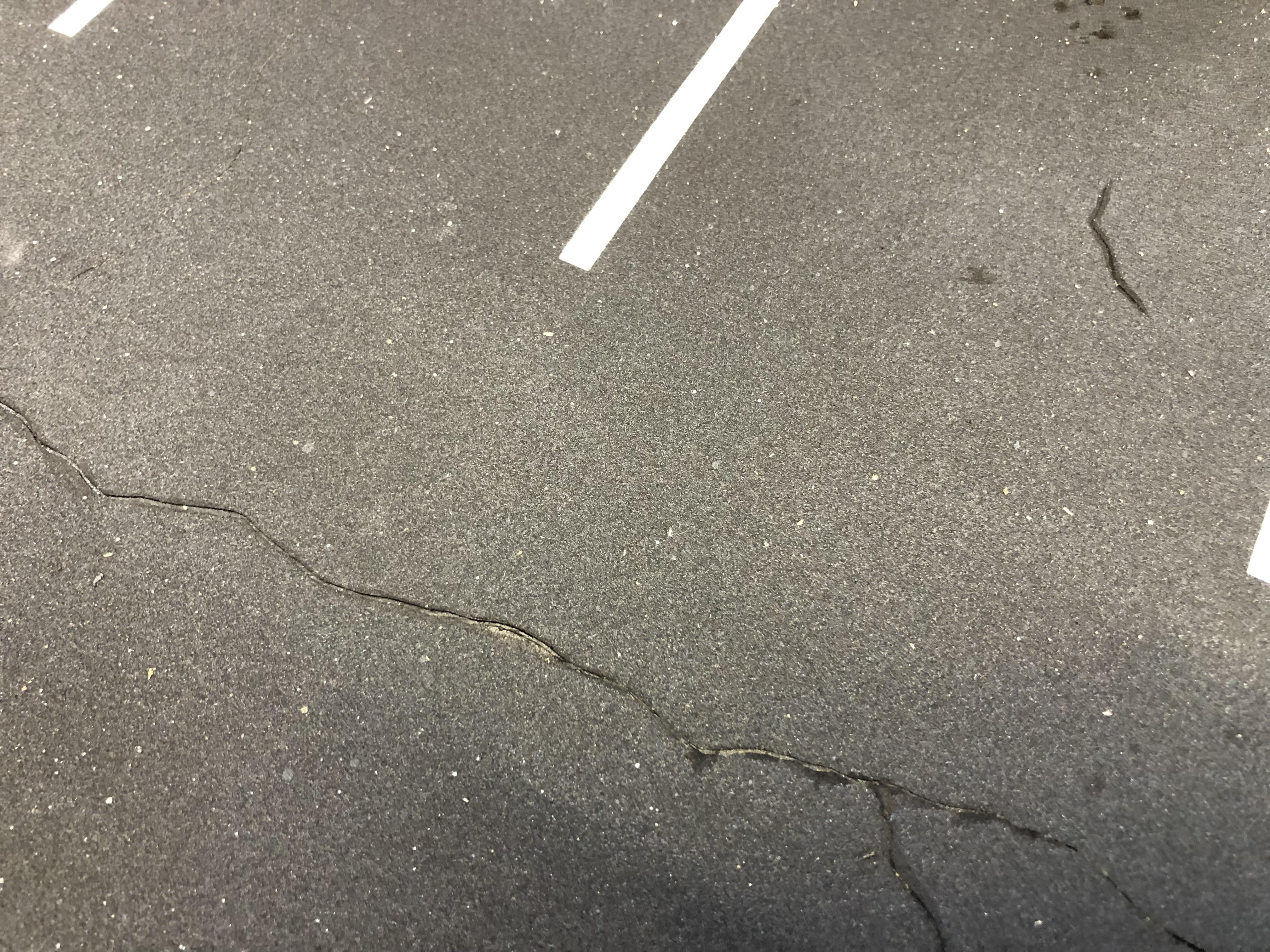

After gluing these in place, I added a few more random “cracks” with the back side of an old #11 blade. I intensionally had the joints “not perfect” to try and help the realism of cracking. These joints got various treatments of white glue, and semi gloss acrylic house paint left over from painting the house trim last year. The intent being that some of the cracks look like they had crack sealer applied. The sandpaper was misted with several different shades of grey, flat black, tan, and white. Pavement isn’t usually black! In my area the aggregate has lots of granite in it, thus the white flecks. I know some areas the roads are almost brown, areas in Washington State the roads are quite green. All this depends on the stone in the mix. So after some paint it looks like this…

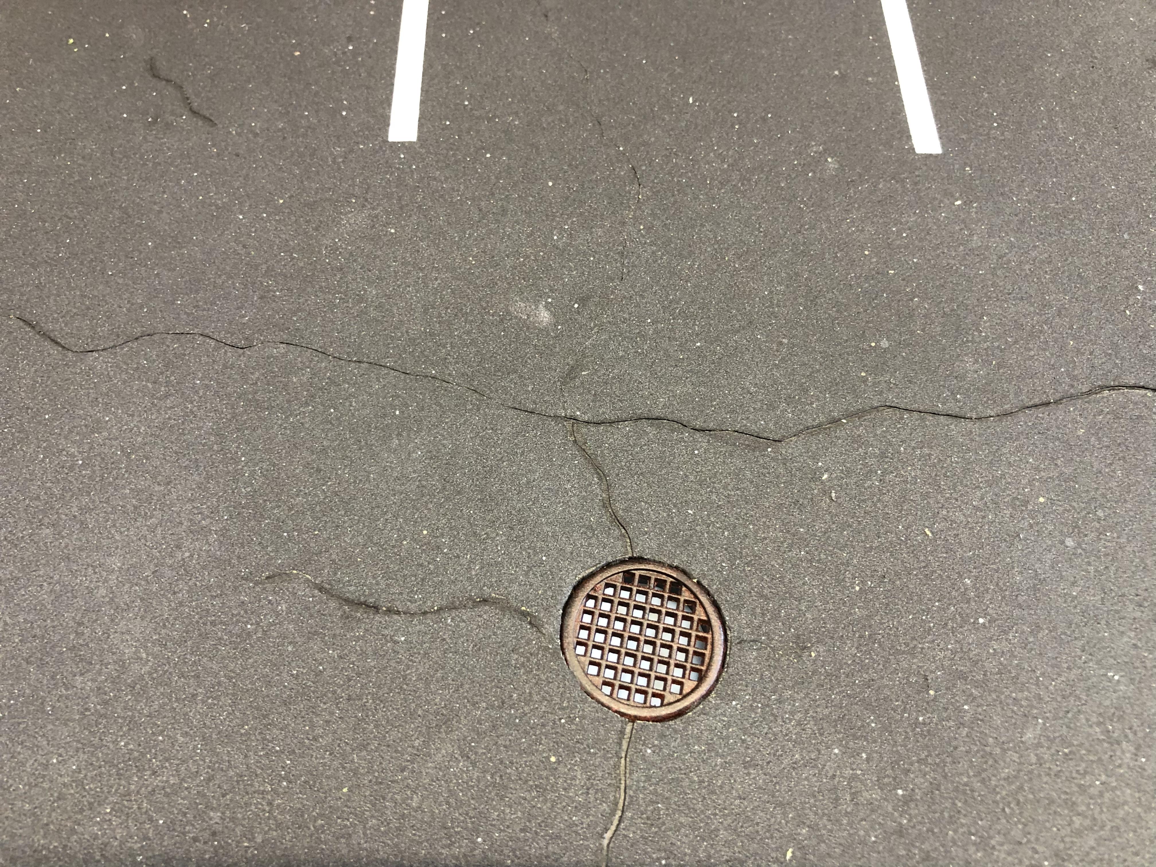

Now about that hole… All parking lots need proper drainage! So when I prepared the plywood base, I actually took some time with my palm sander to create a “slope” to the hole. The drain cover is part of an old garlic press painted with some red oxide primer and flat black.
I still have some “finessing” to do on the cracks, but overall I’m pleased with it so far. In the background you will notice I have started some landscaping, including raised beds and a boulder stack wall. More on those once I progress a bit further. Oh ya, the white lines were simply masked off and painted with white primer, 4mm wide which is scale for a typical 4” road marking.

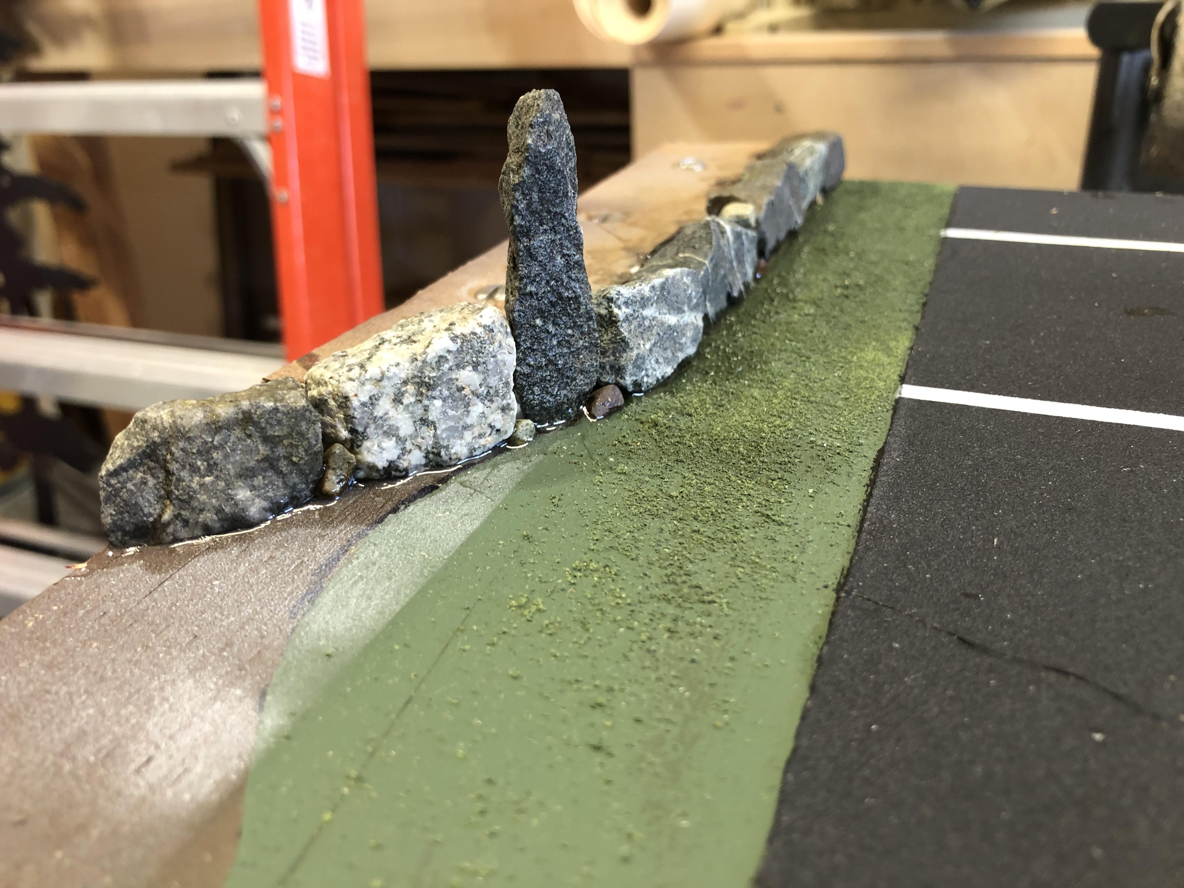

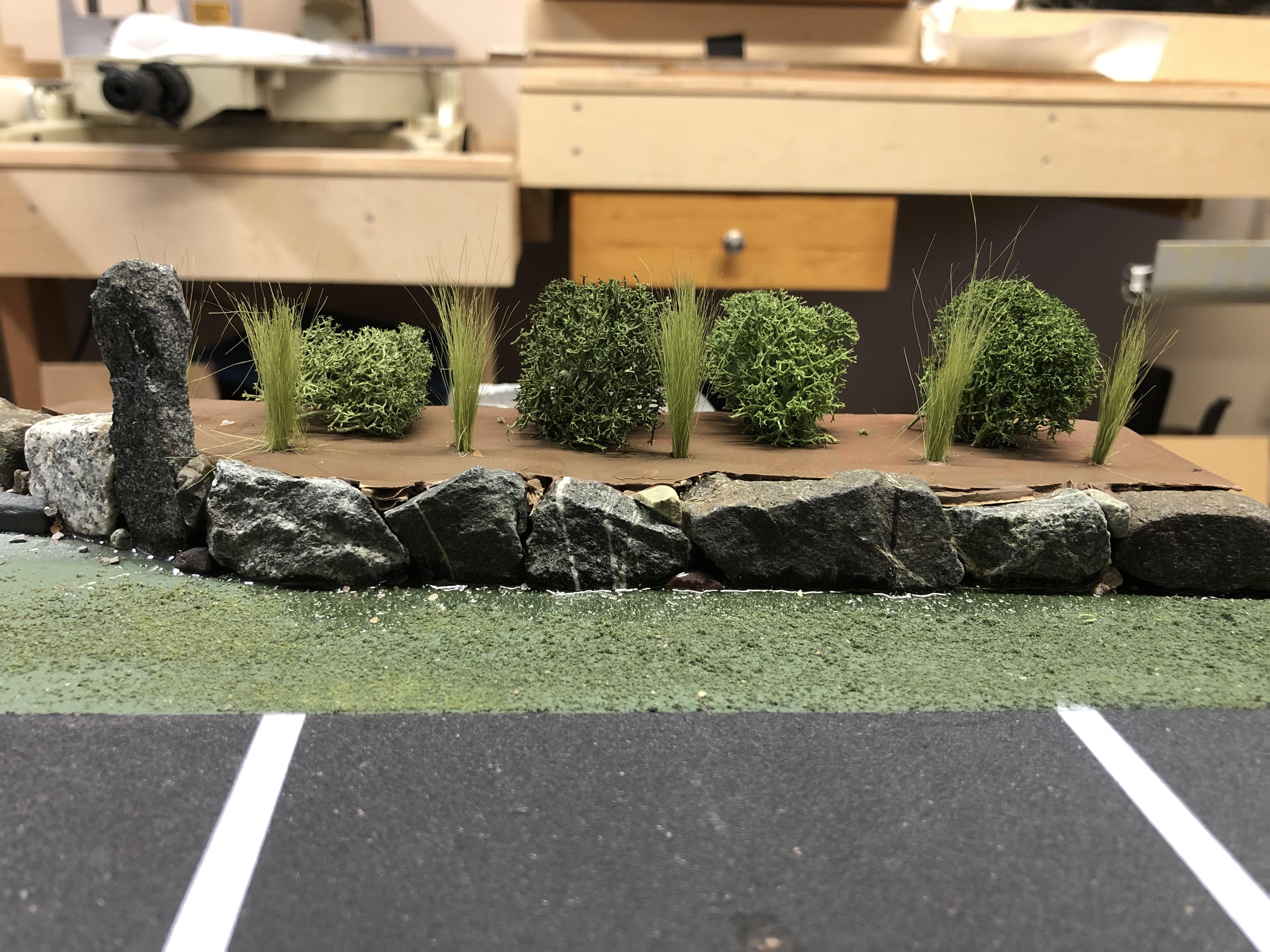

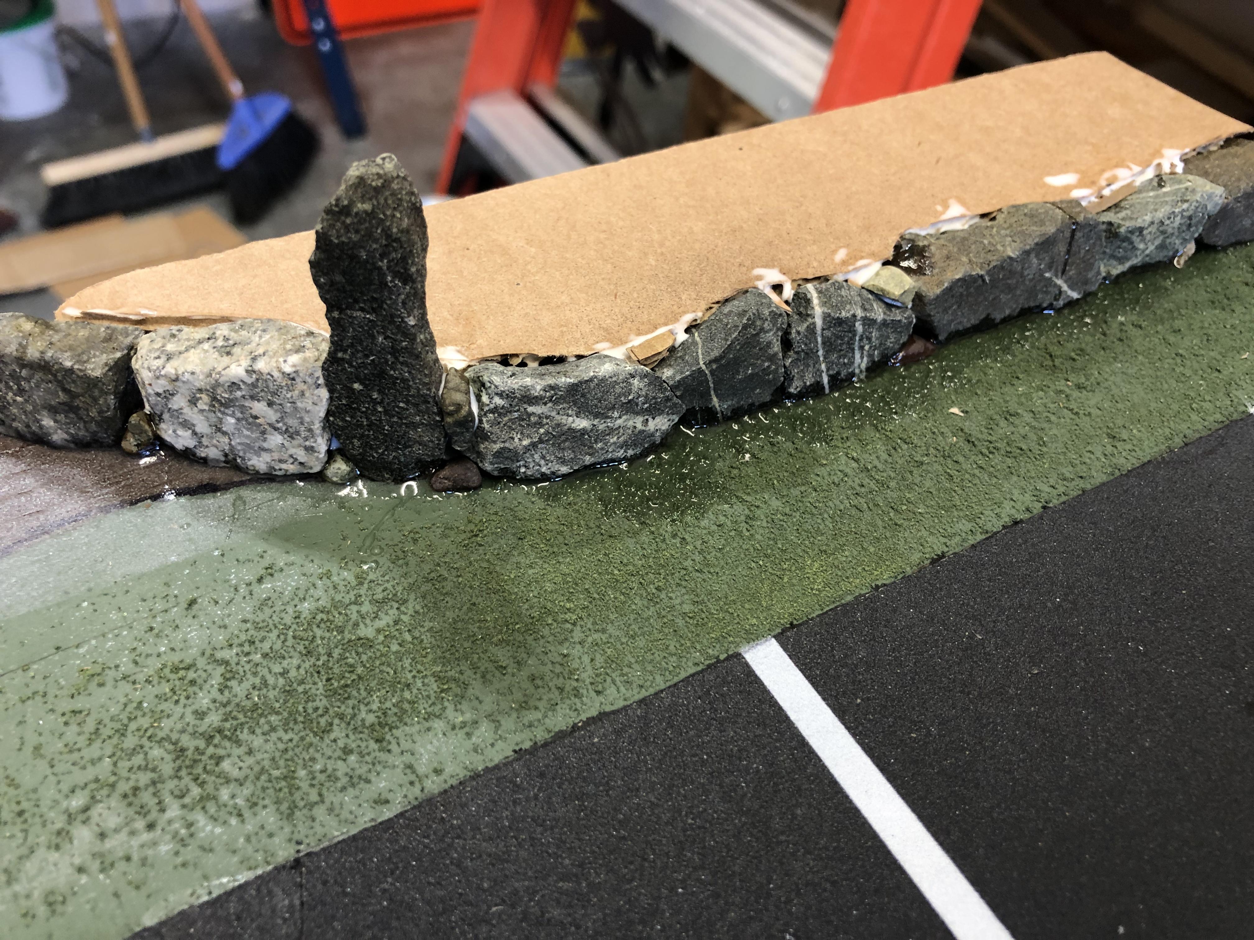

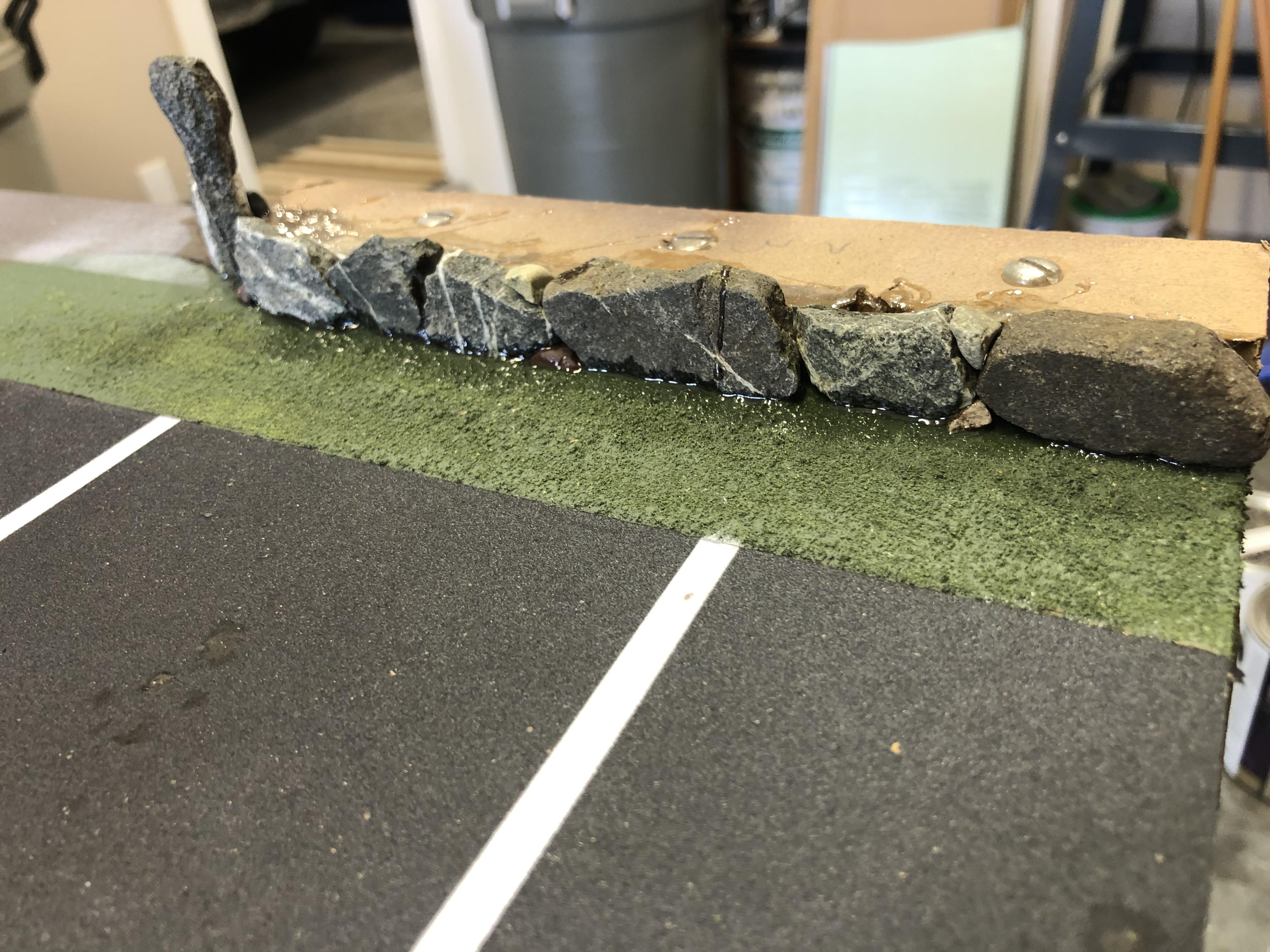

The boulder wall is complete. I have had the pleasure of working with a fantastic machine operator over the years who builds amazing 1:1 boulder walls. He and I (mostly him) have built some really nice walls together. The “boulders” scale as roughly 18”-30” in size.
The shiny resin will be covered by grass. The “boulders are 1” stones from my property, tried to find some interesting stones with some character. Still haven’t made final decision on ground cover above wall.
Raised beds are MDF shaped with drum sander.

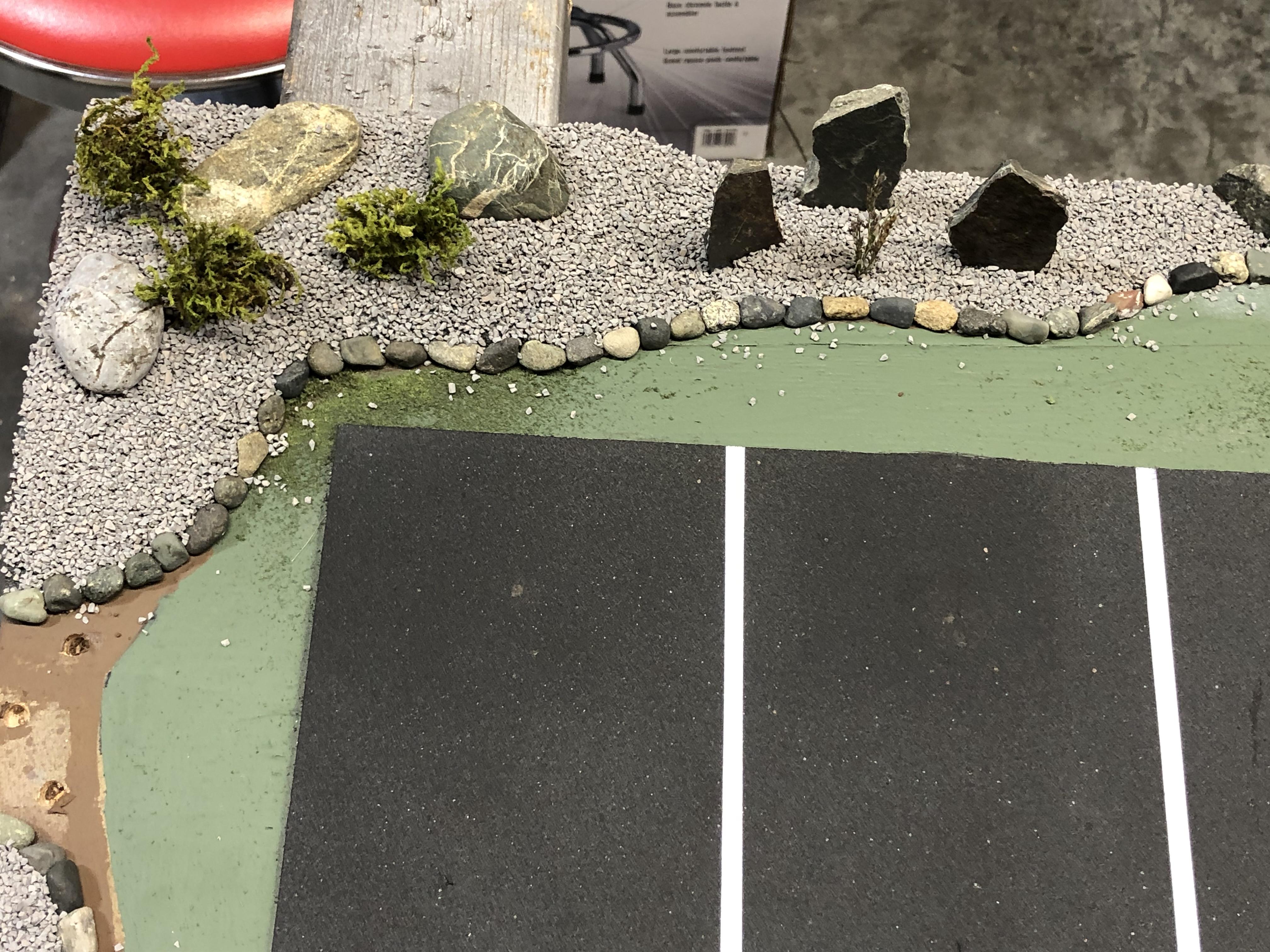

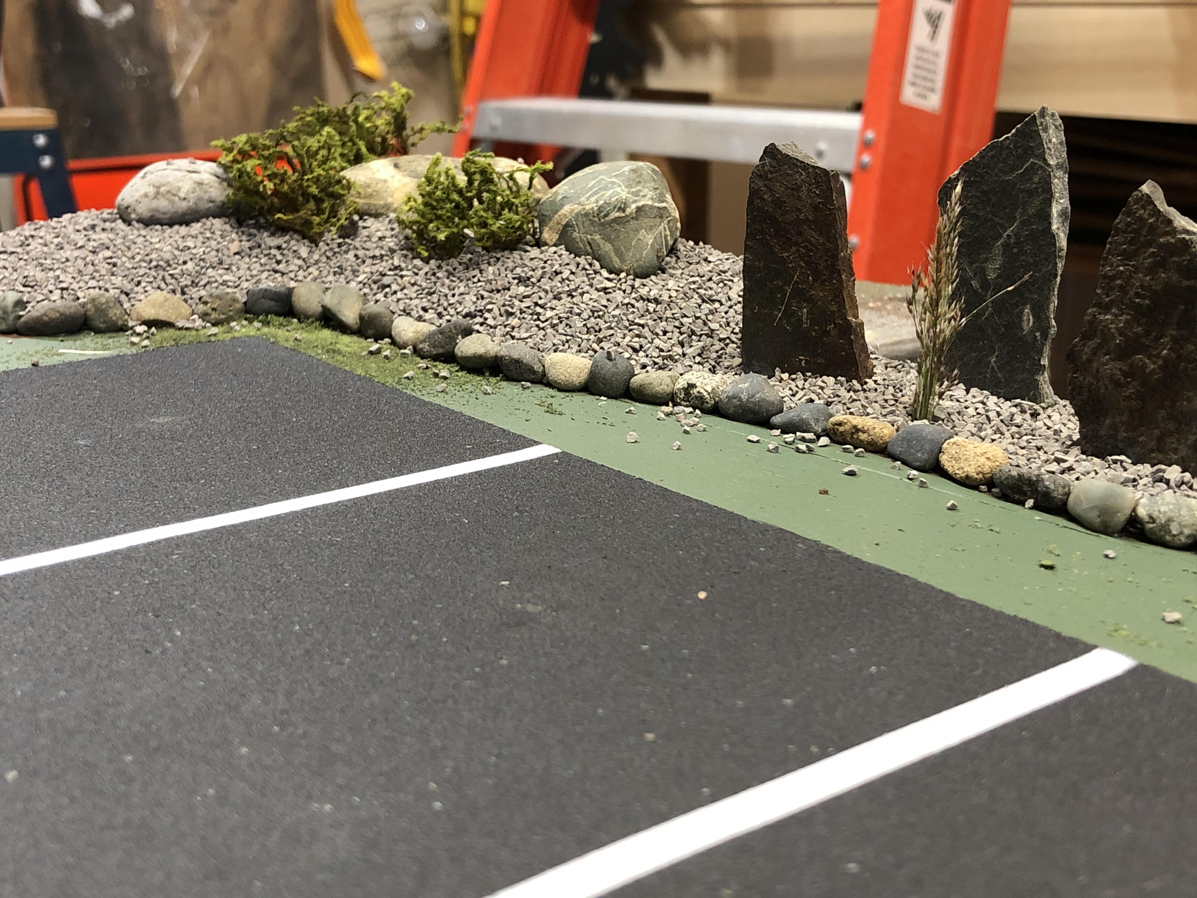

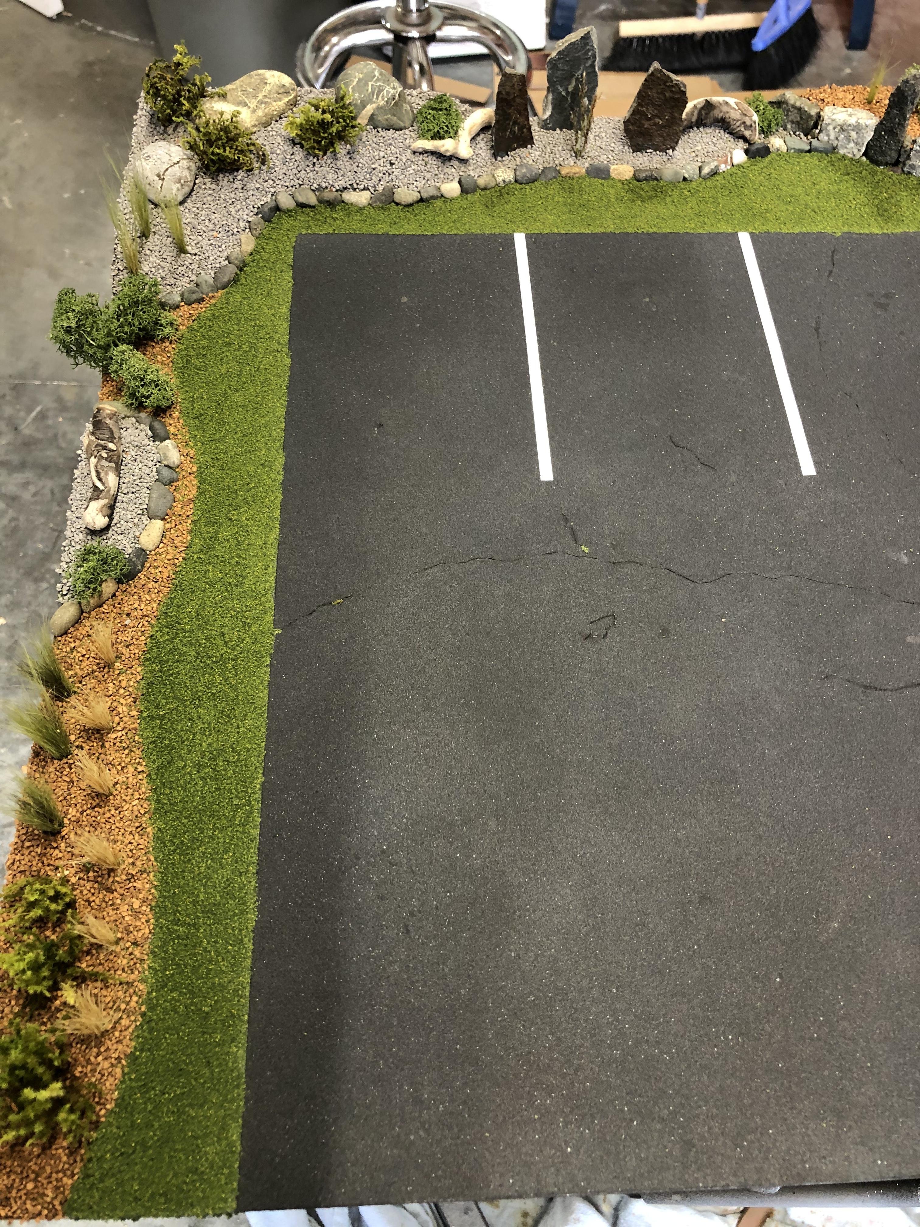

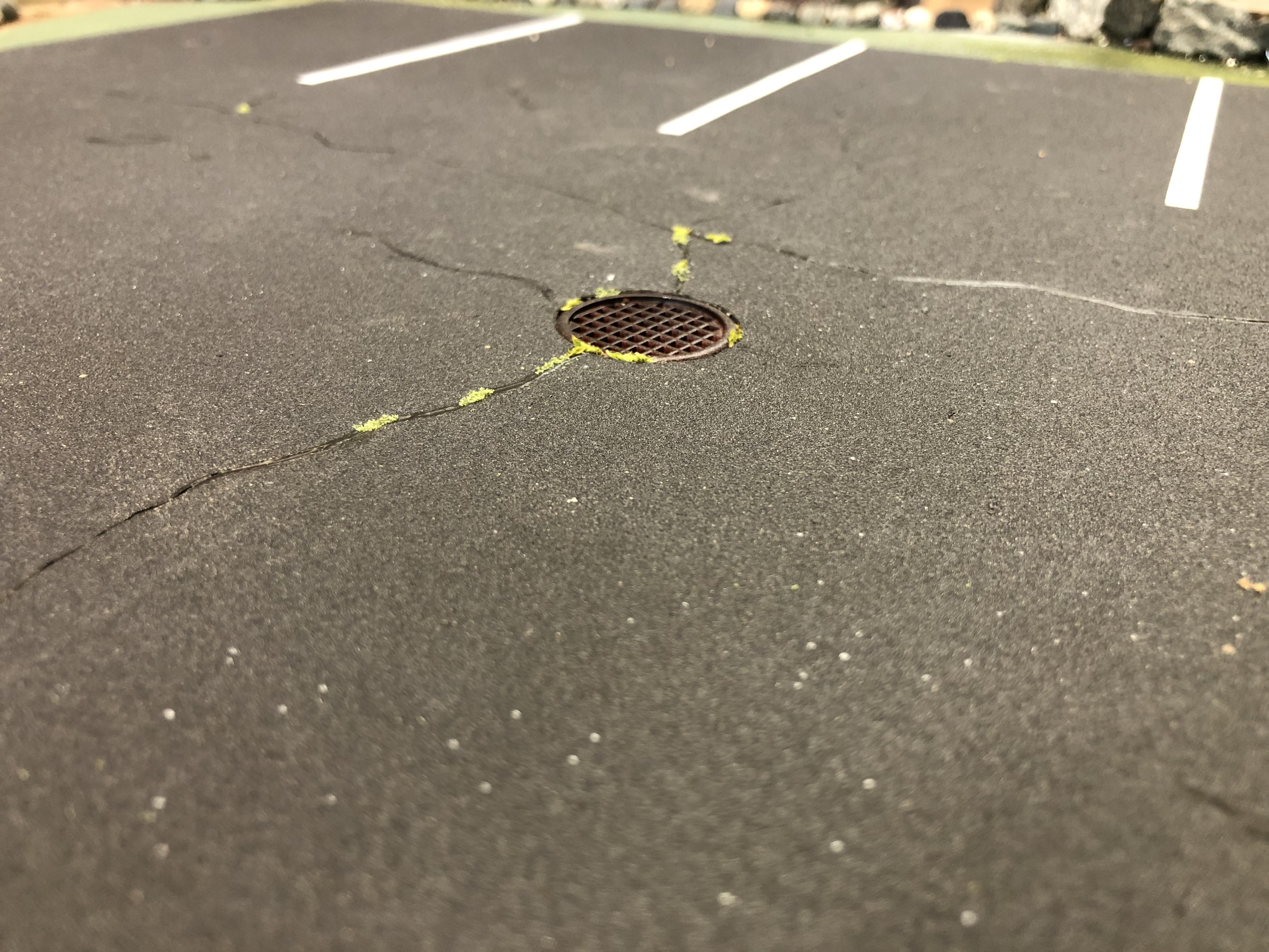

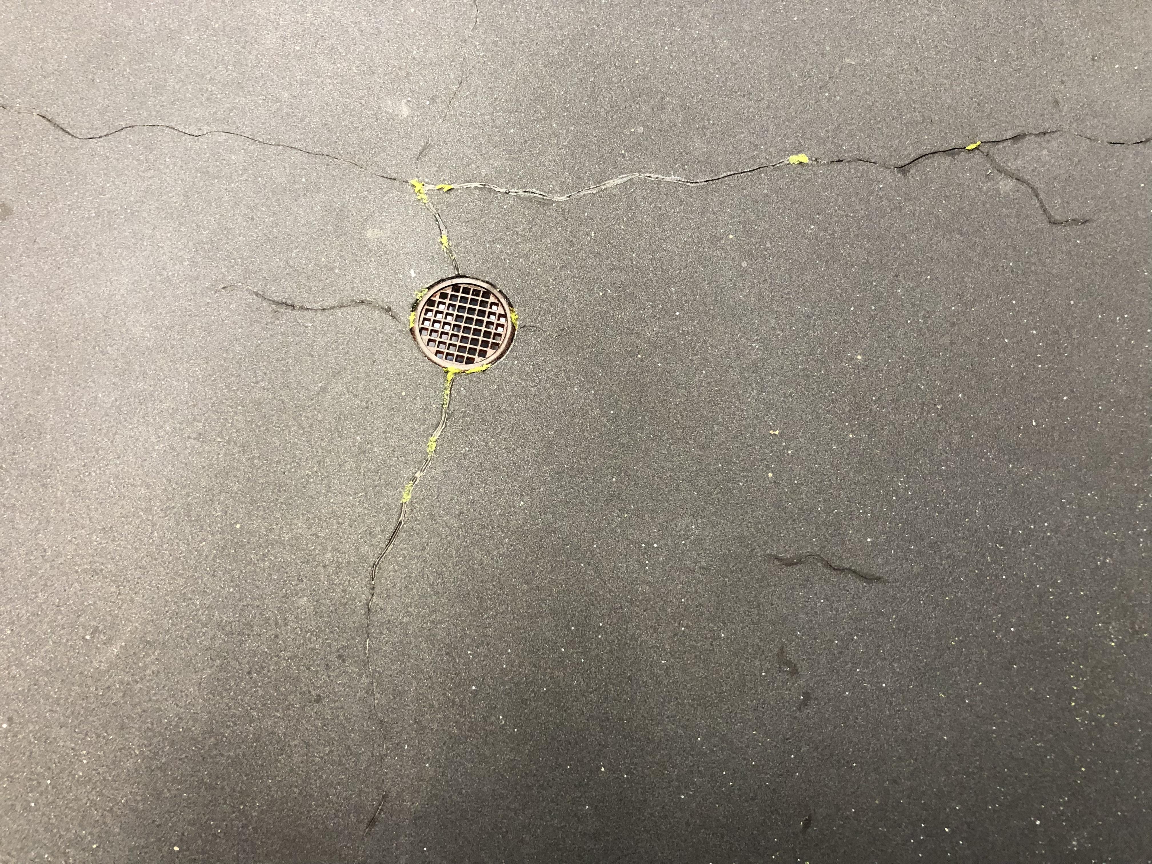

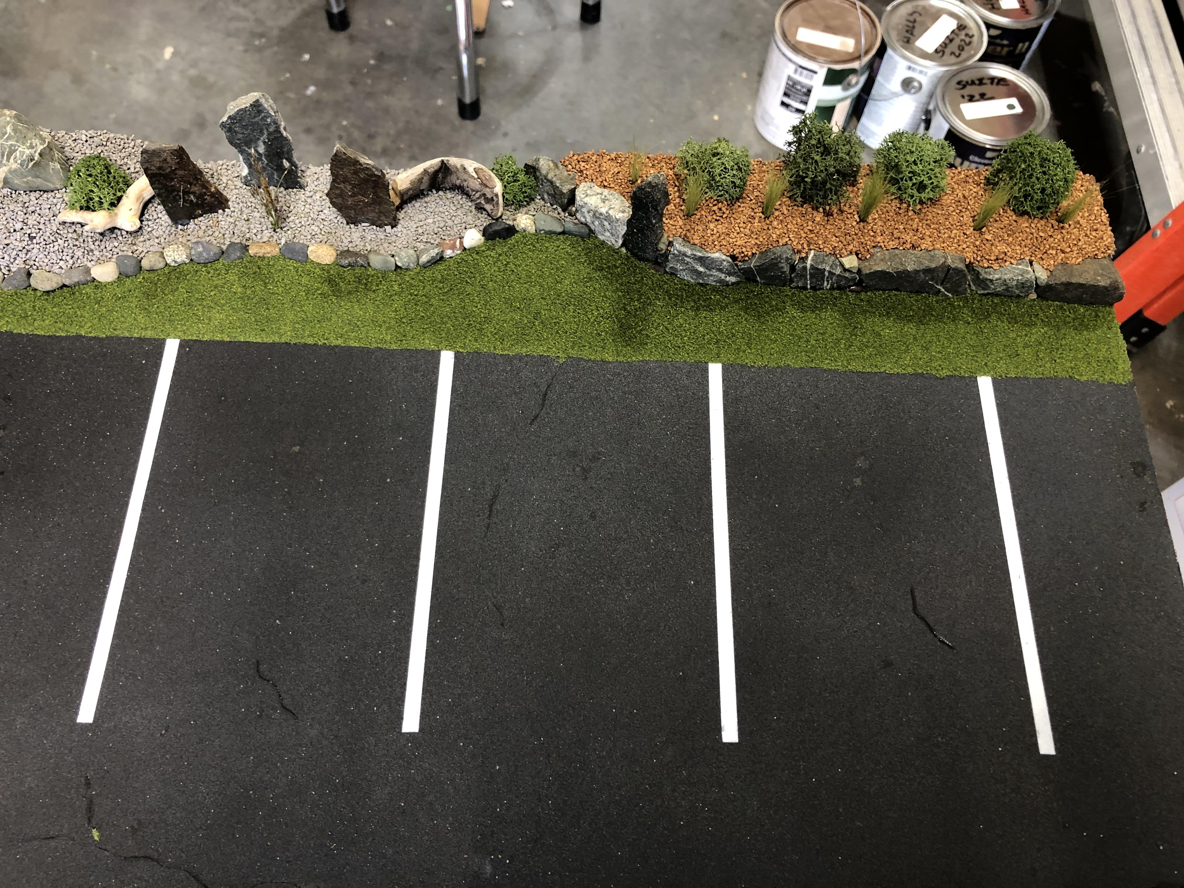

Got a bit more done  on the landscaping. After playing with some grass in the pavement cracks, I liked it and applied it in a few areas. I may add a bit more, but I don’t want to overdo it. It’s a combination of some moss from my yard, and some scale grass from the LHS.
Ground cover is scale railway ballast, the “river rock” border is pea gravel from my yard. The bushes are moss.
Lots of cleanup and fine tuning to do yet.
Above the boulder wall, I “planted” some grasses and some synthetic shrubs from the LHS. Next up will be finishing the rest of the ground cover, then planting some grass.
More soon!

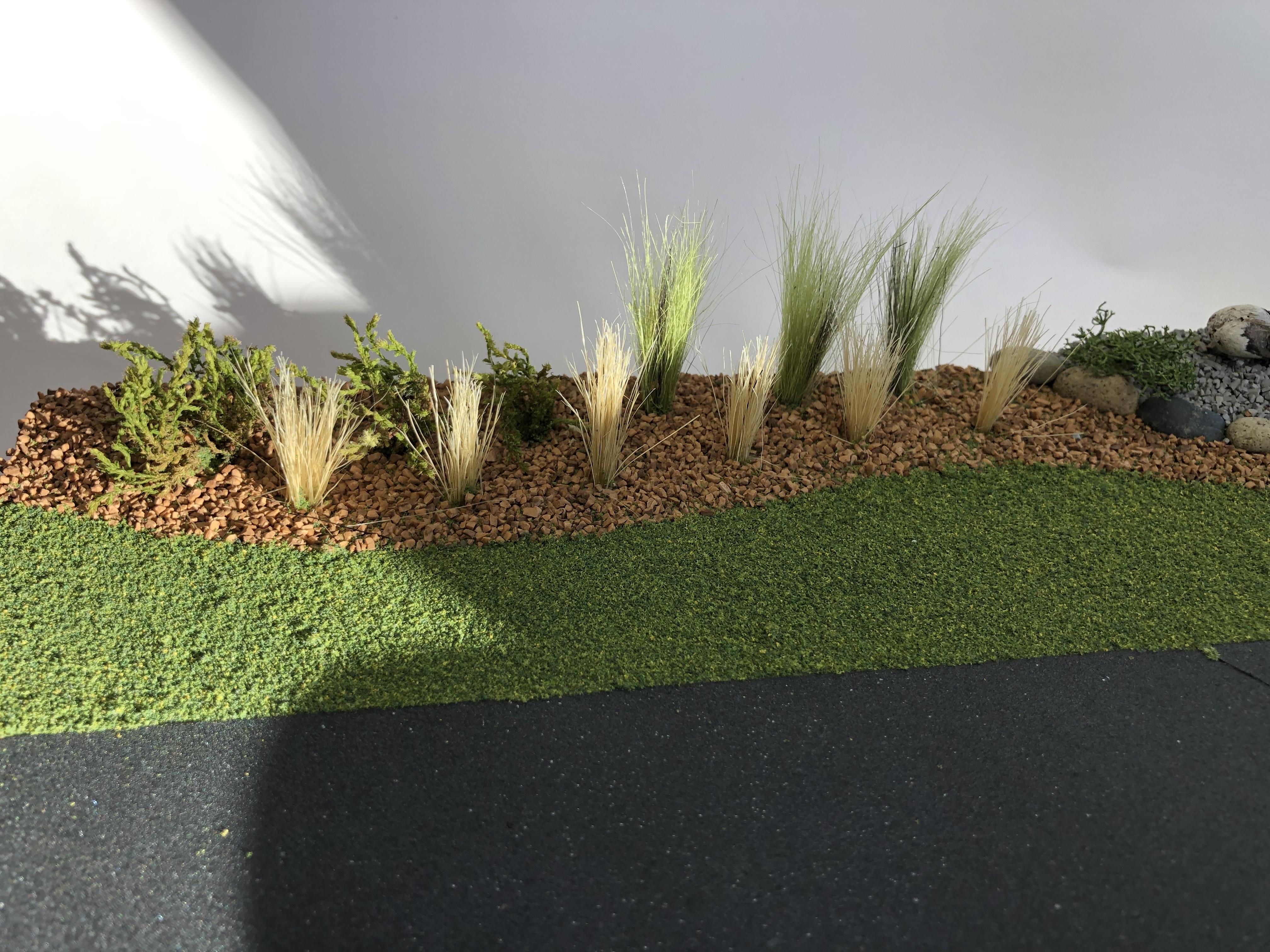

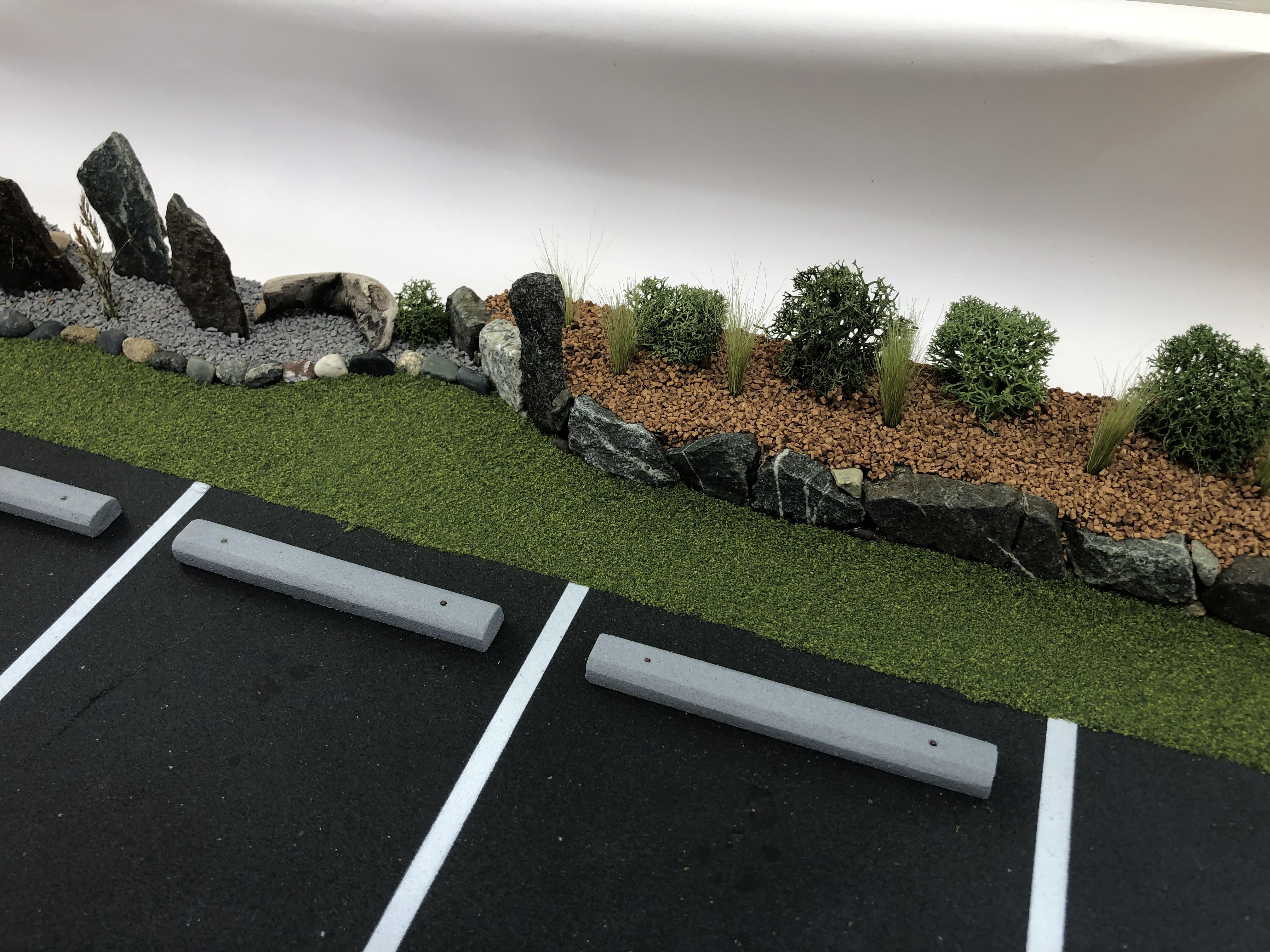

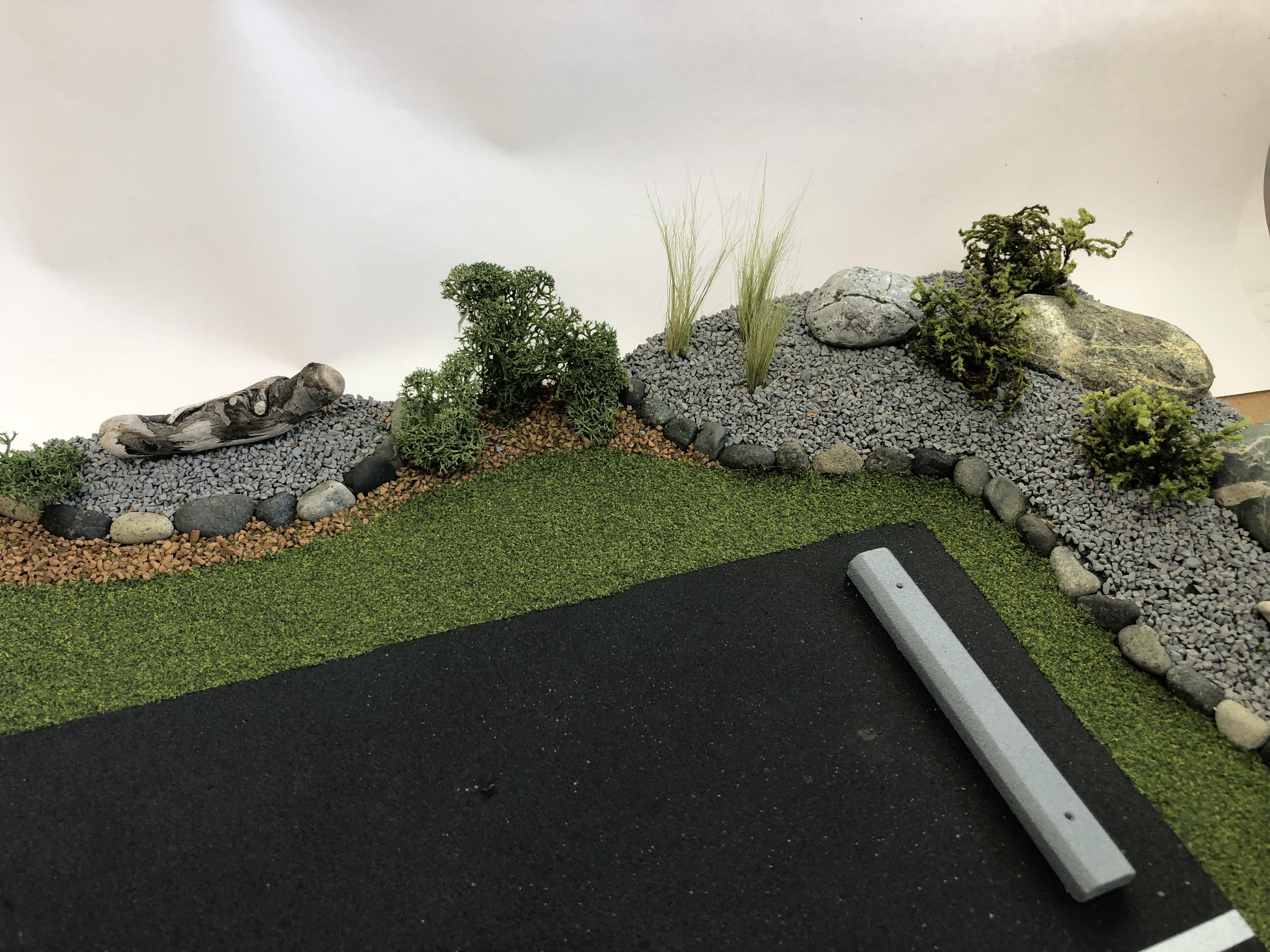

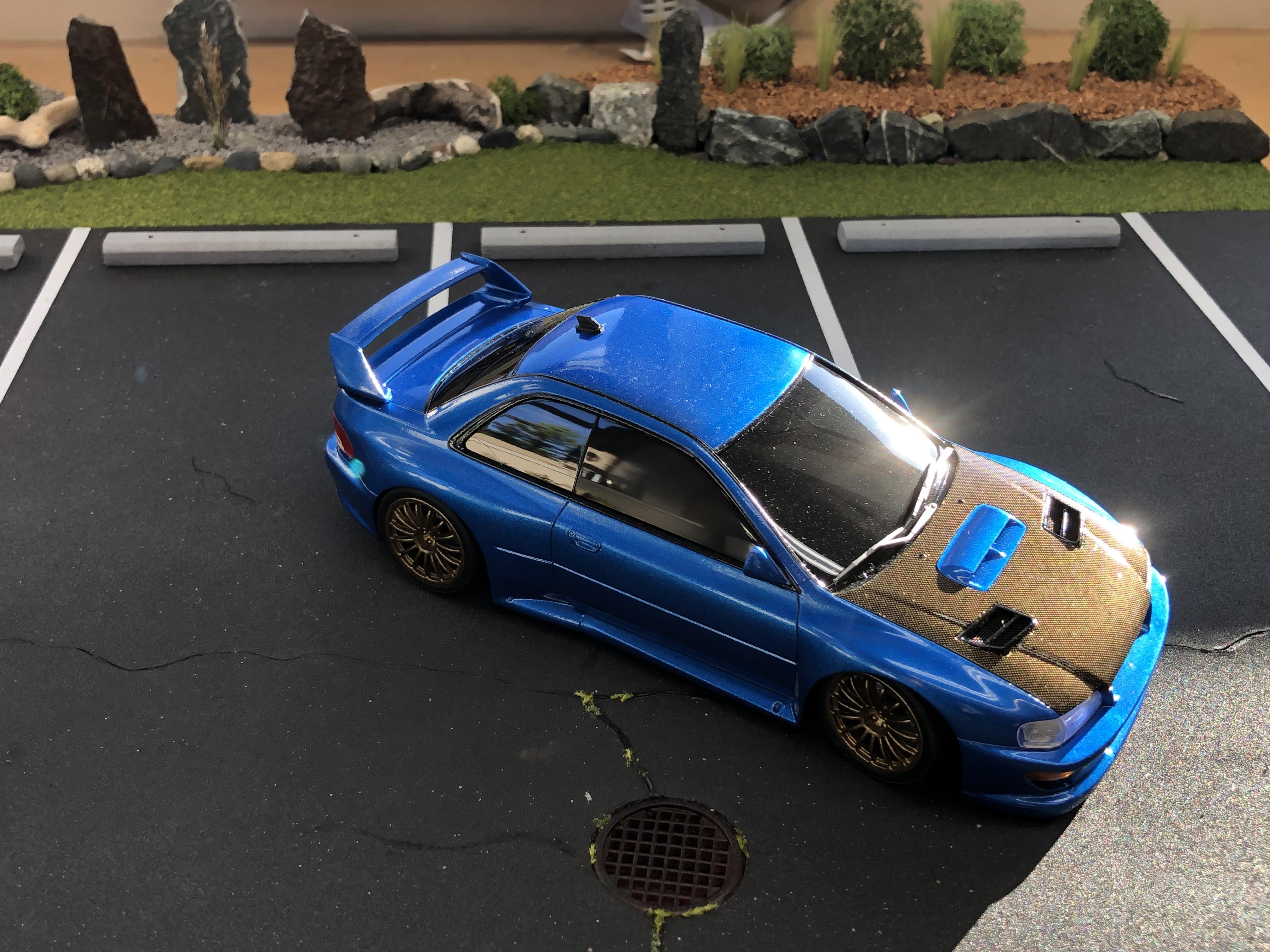

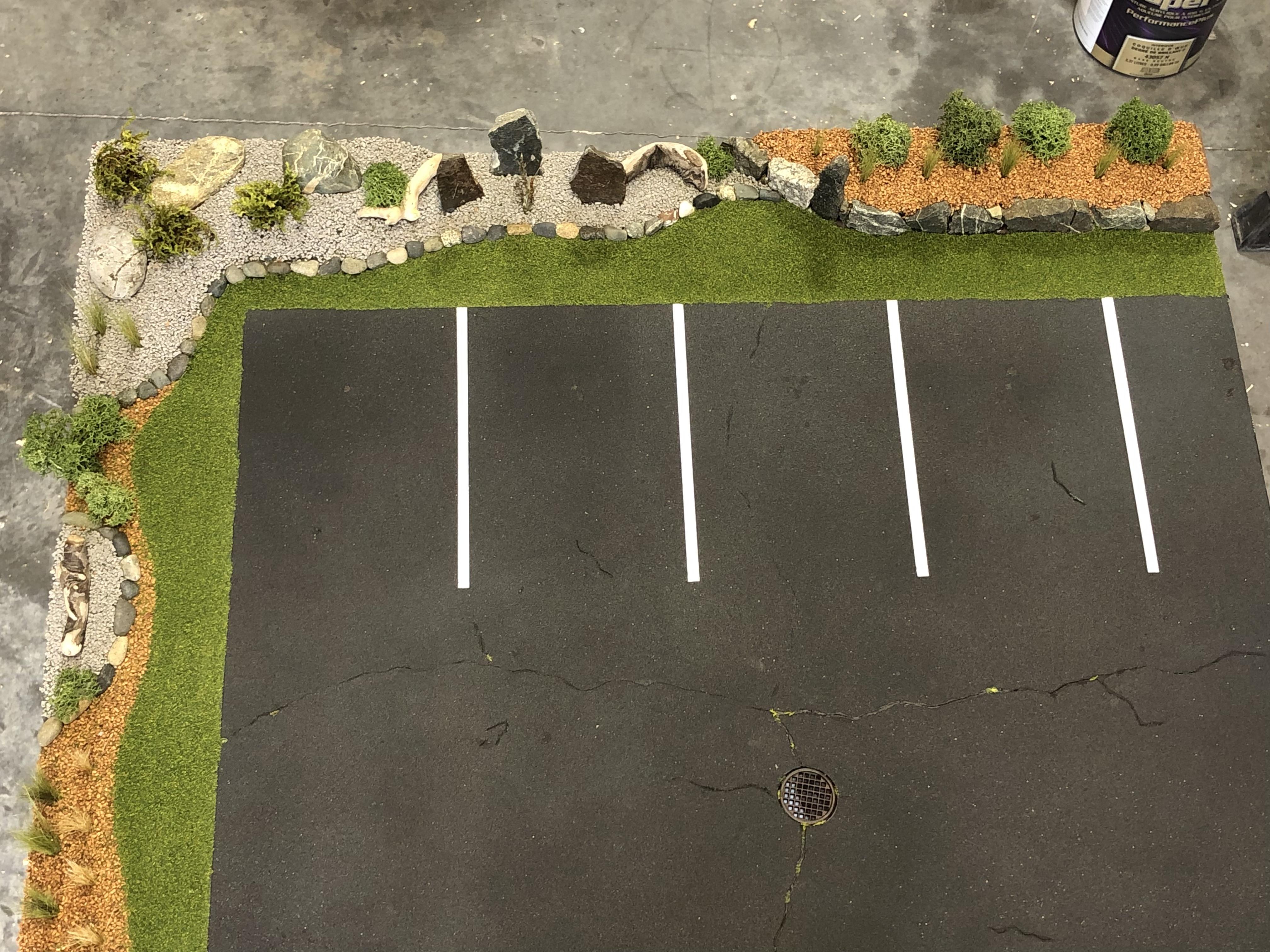

Ok, on the home stretch here.
I wanted some variation in the landscape, but tried also to keep it from looking TOO hodge podge.

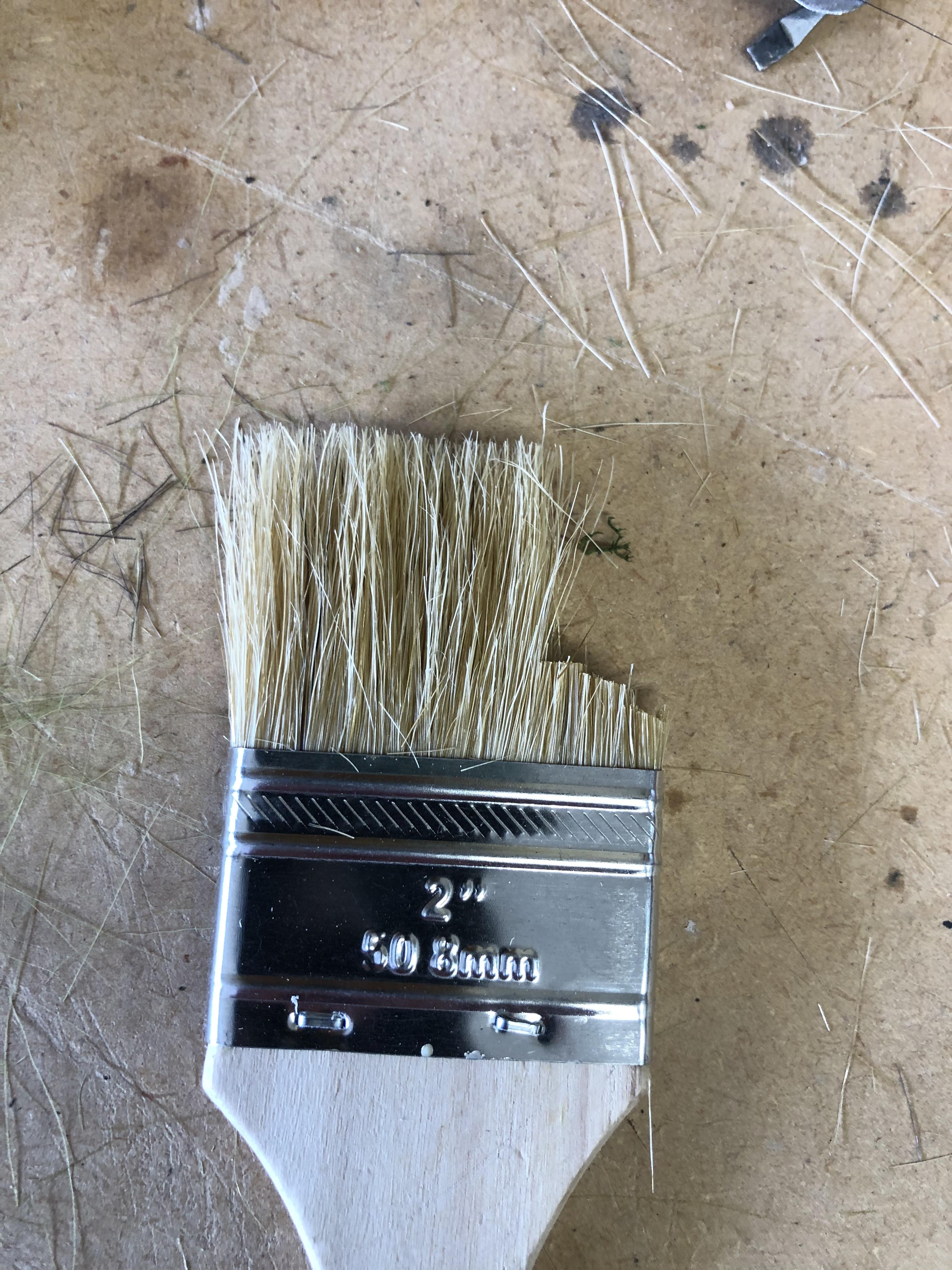

Here I have added the driftwood and grass. For some added texture and colour I cut up a disposable paint brush for ornamental grass.
98D1DF51-B694-43A4-B46B-C48815200C4F.thumb.jpeg.a4af3e19d09c81dc0fcae5fb9fcca1a0.jpeg6A60CCCC-45FE-42B2-ABCE-4A7ADEC2D3C3.thumb.jpeg.4e3b806aeb5d9d8759d4a86bab545643.jpeg

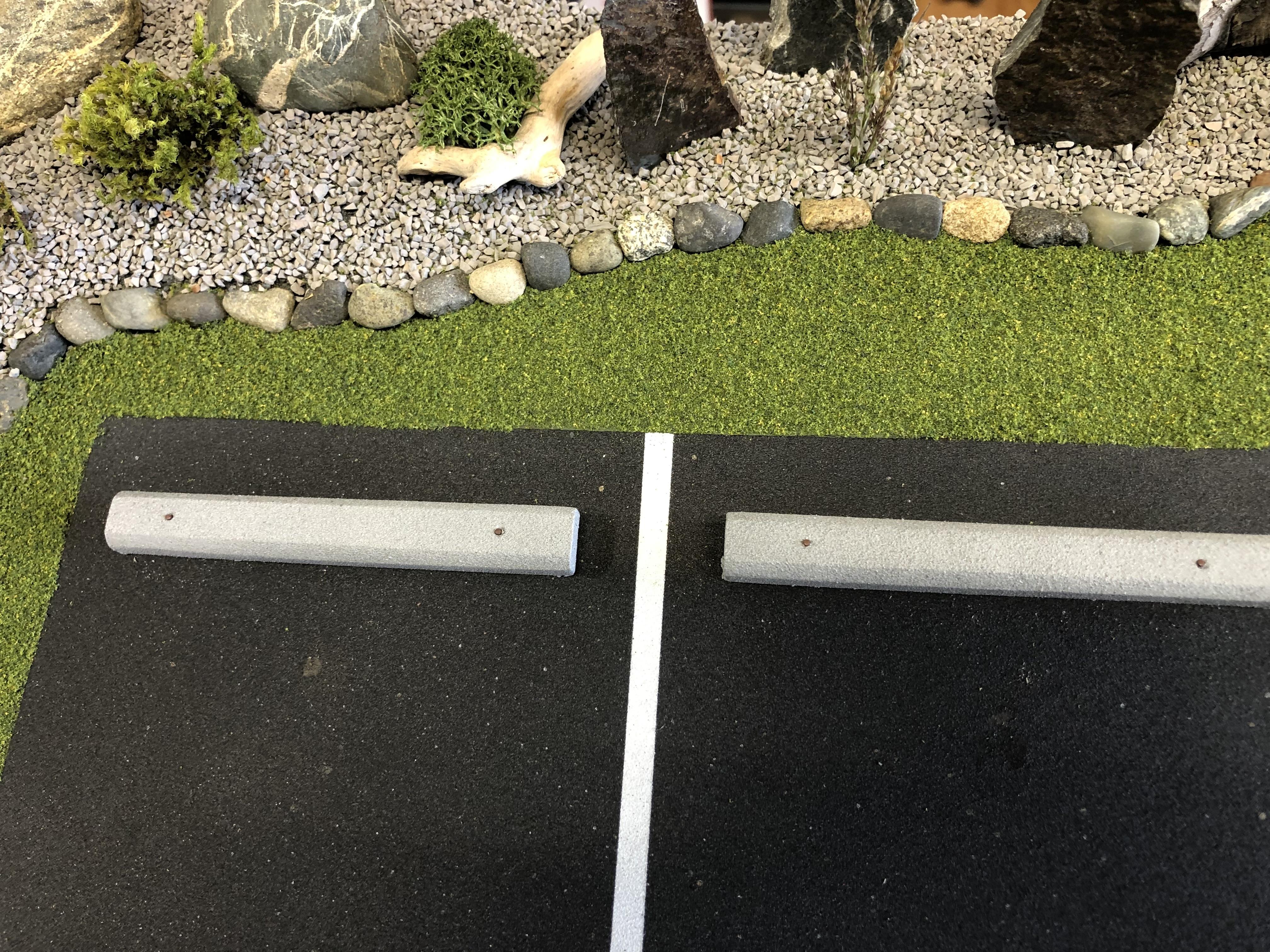

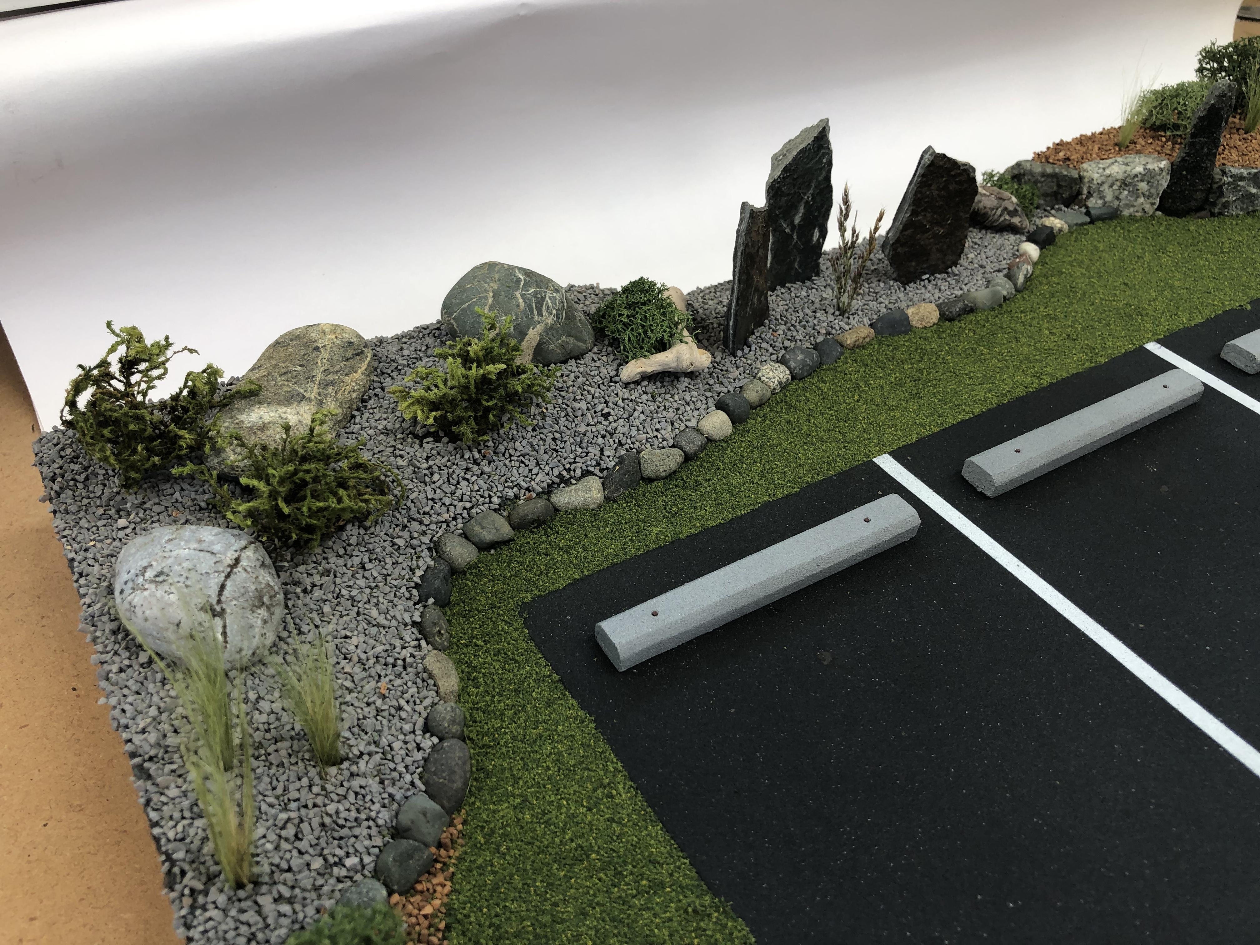

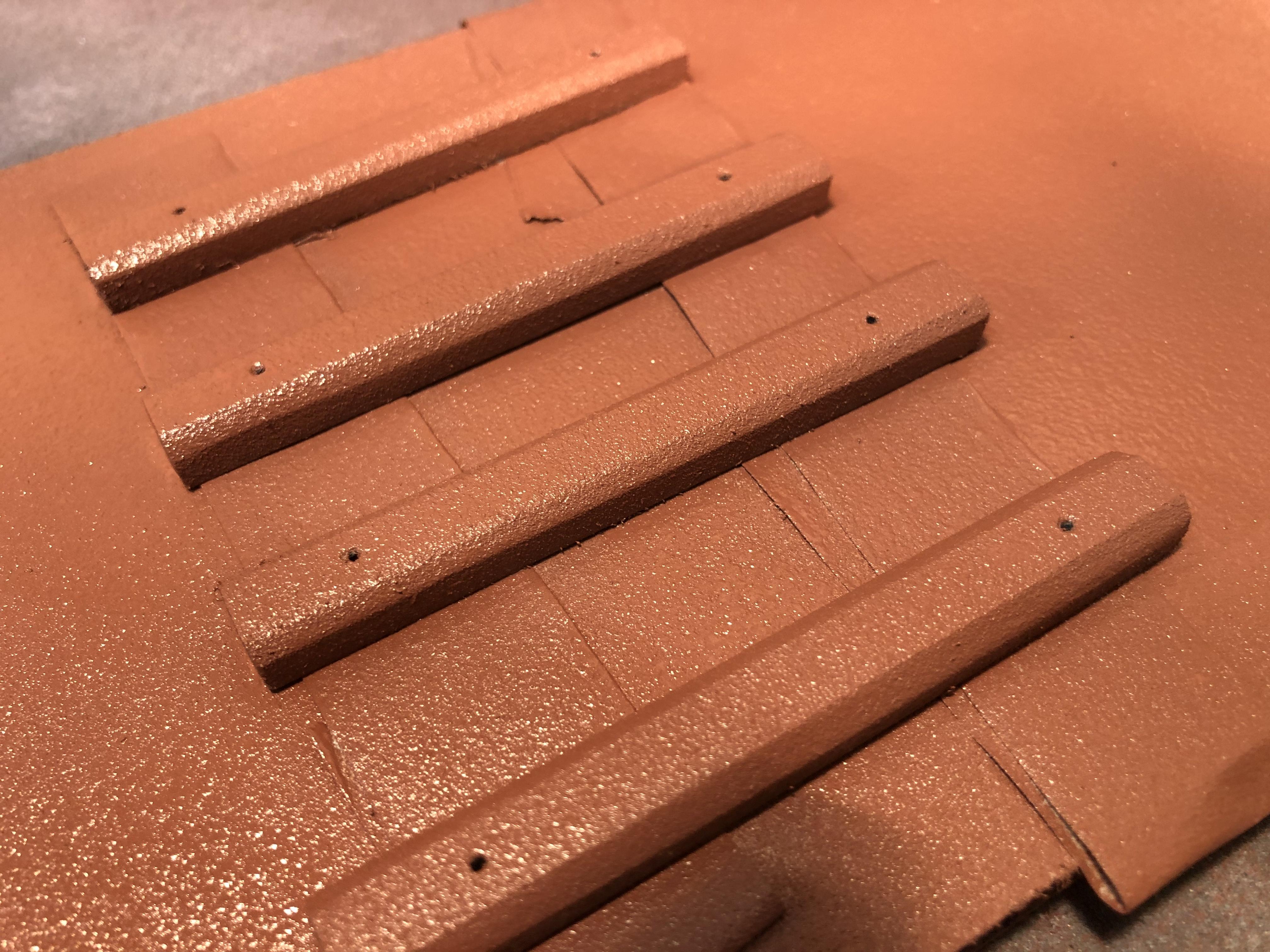

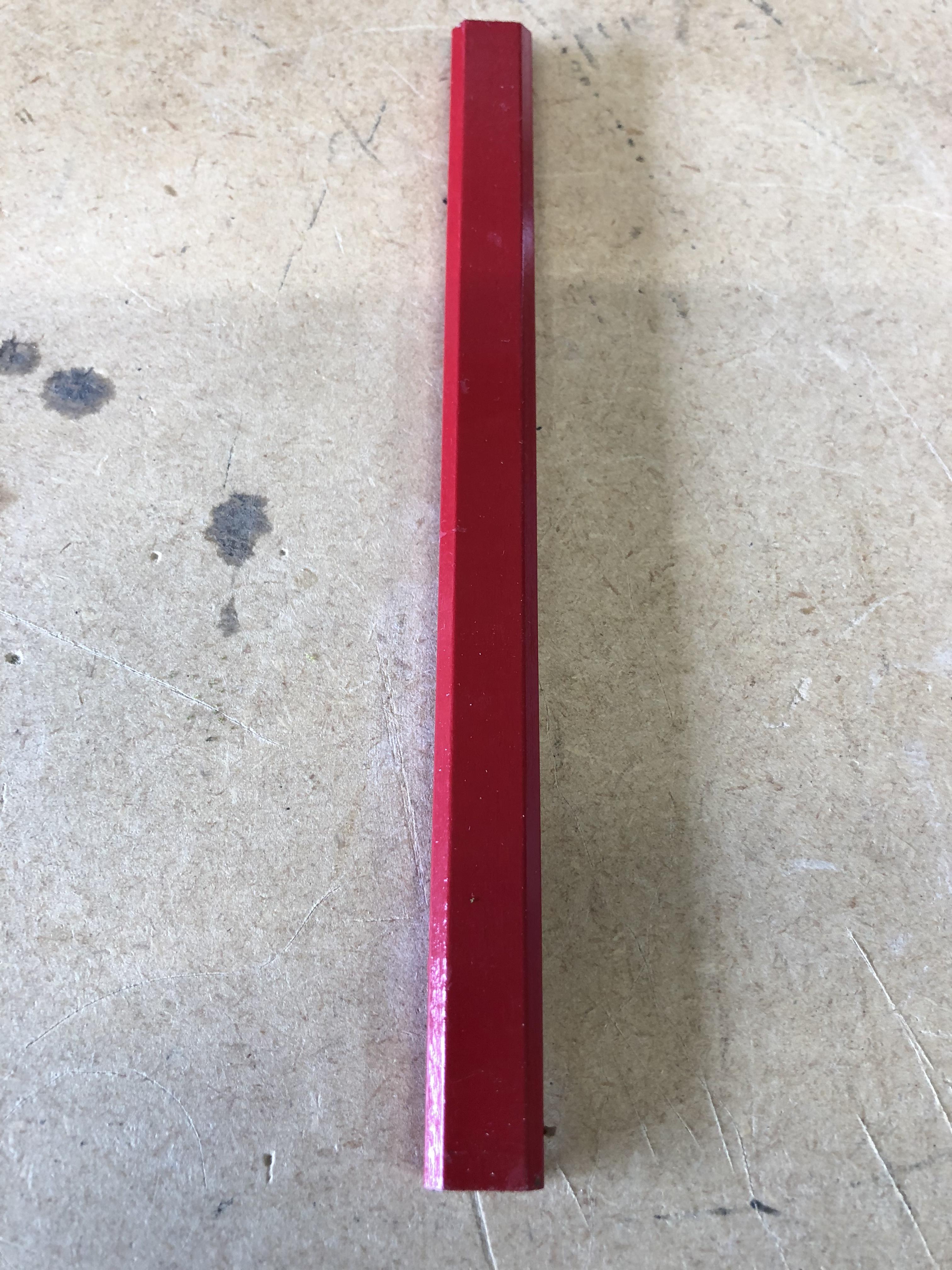

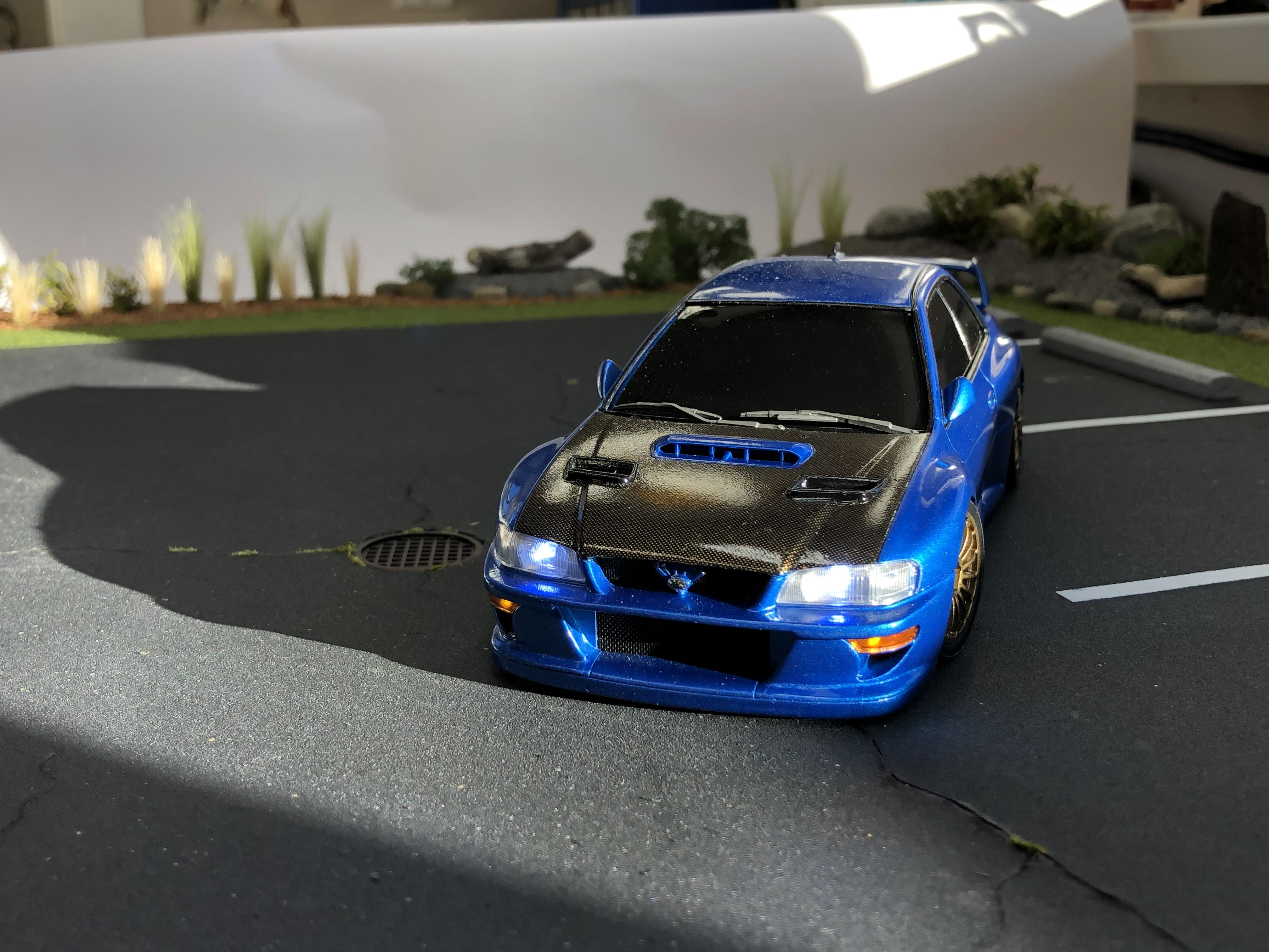

Next up, the curb stops in the parking spaces. As Greg mentioned above, without these people tend to drive in the grass, or bump into whatever landscape there is. So I decided to modify a couple of carpenters pencils. They were slimmed down in height and width and reshaped. I then shot them with some textured paint, then a few shades of grey to resemble concrete. Holes were drilled to receive the “rebar” pins to hold them in place. “Rebar” is short pieces cut from a paper clip, then painted a rust colour.

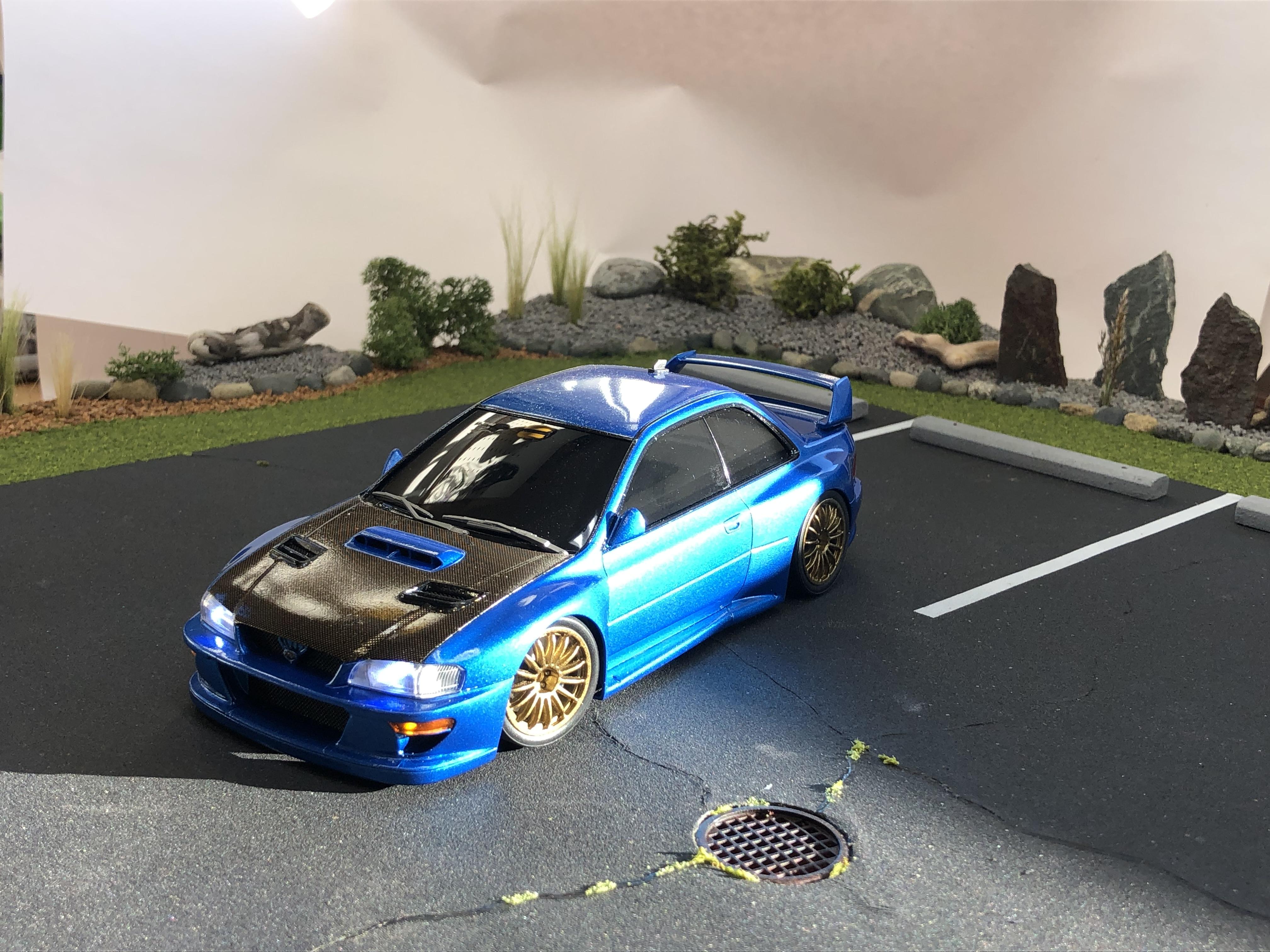

I was hoping to get this outside this afternoon to get some better photos, but it’s yet another windy day here and I didn’t want any bushes to blow away! So hopefully tomorrow I will get some decent outdoor pics and get it under glass. Looking forward to parking a few cars on it!
Thanks for following along and taking the time to contribute your comments, much appreciated.
Cheers, Steve
