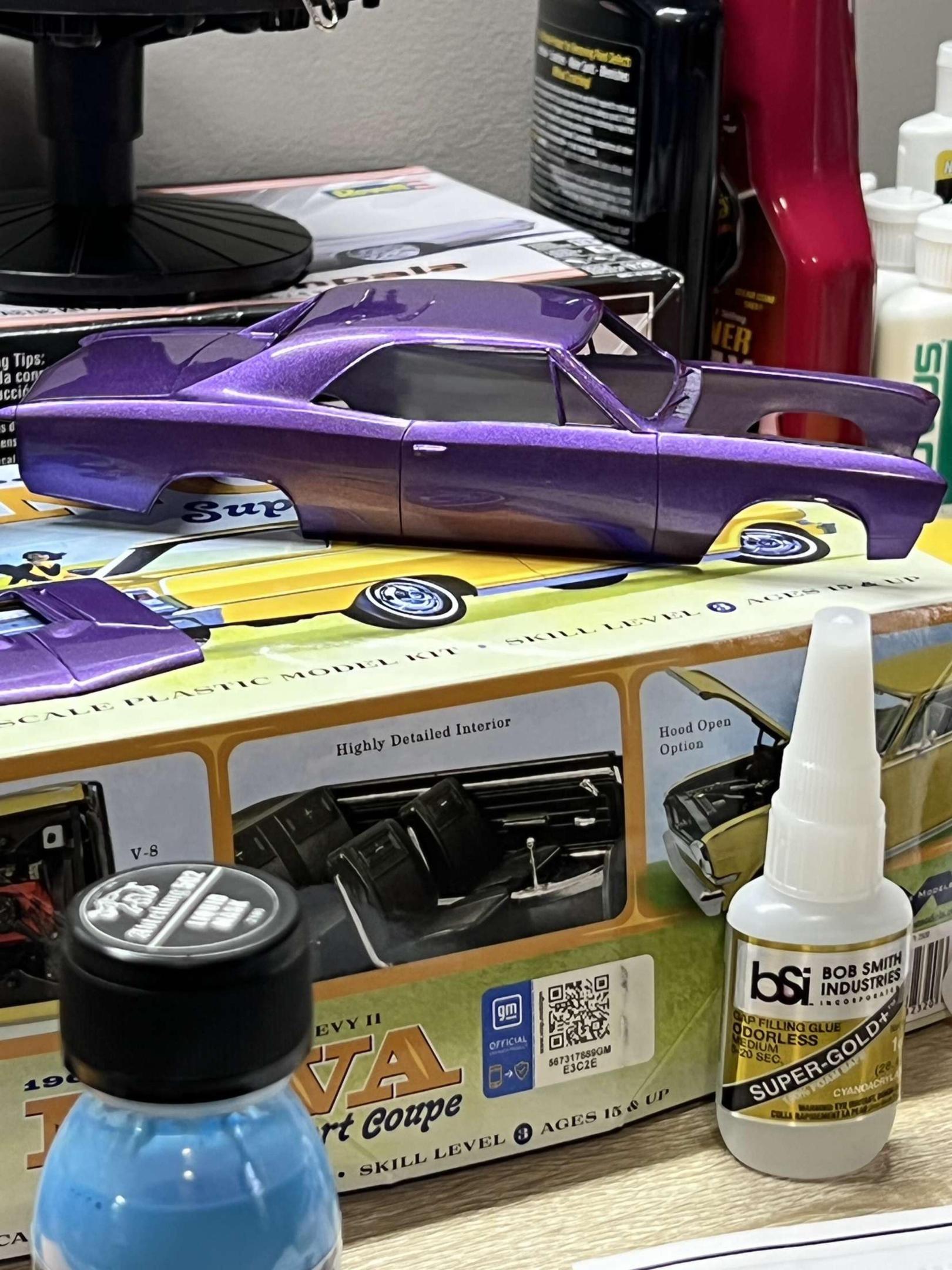

Dpate Posted June 8, 2022 Posted June 8, 2022 I used vallejos black wash for dark vehicles on this body. This kit im working on is a test kit using everything. 3
