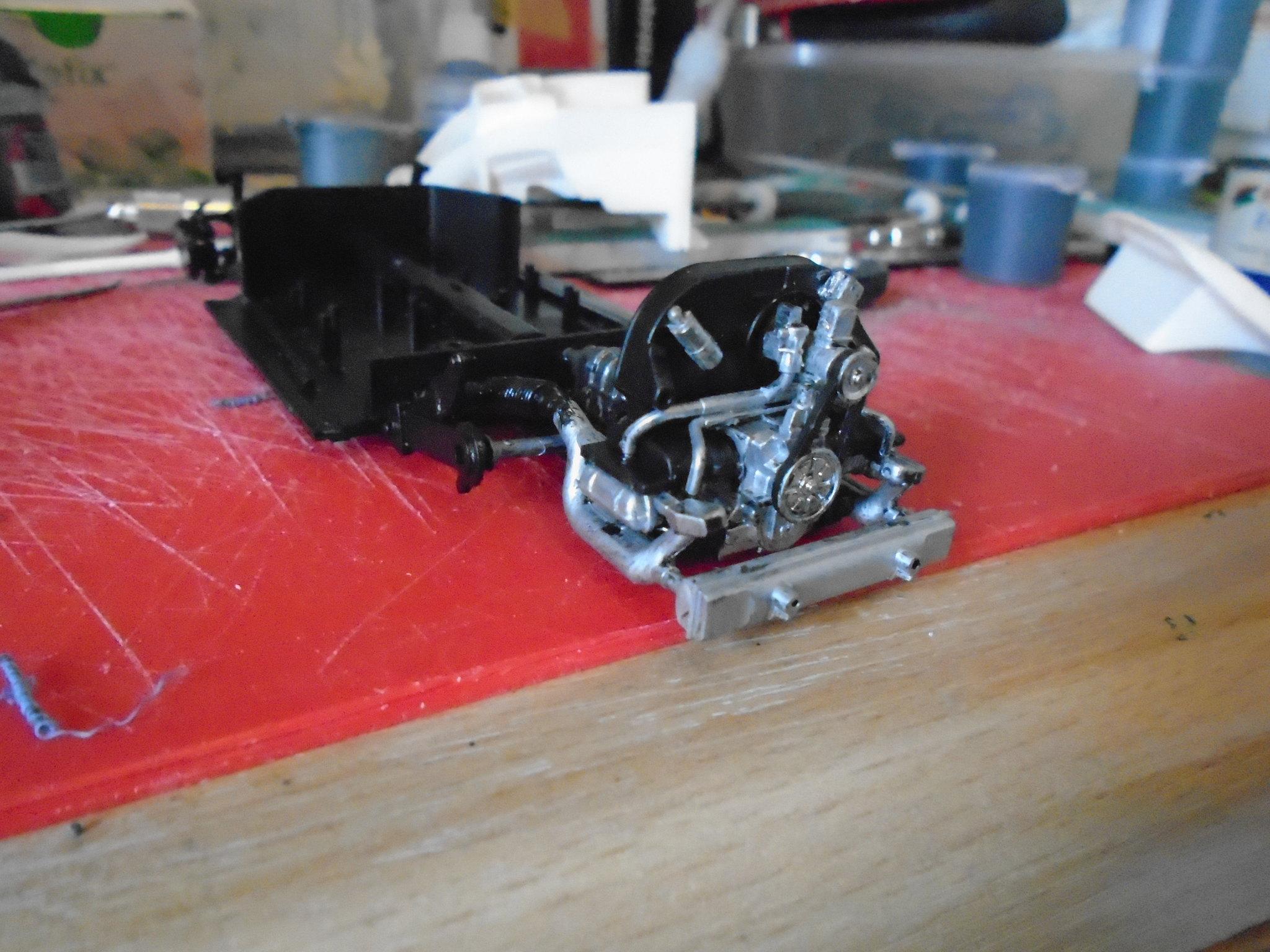

stitchdup Posted June 21, 2022 Posted June 21, 2022 The tamiya beetle kit is th only one i know of with a correct type floor pan and has by far the bast detailed engine. The others have the rear arches molded into the pan. heres some pics of th tamiya pan. On these it has been slammed and the front axle narrowed

stitchdup Posted June 21, 2022 Posted June 21, 2022 the wheelbase on the tamiya bug is 100mm and its 60mm wide with the option to narrow a little more by trimming off the part under the running boards. The height of the engine once its fitted might be problem though since the rear of the body looks kinda low on your pic. Unfortunatelly I dont have any that I can measure that height on without taking a build apart. I'm going to guess it would be about 30mm from the ground on stock suspension and maybe 20mm from the frame.

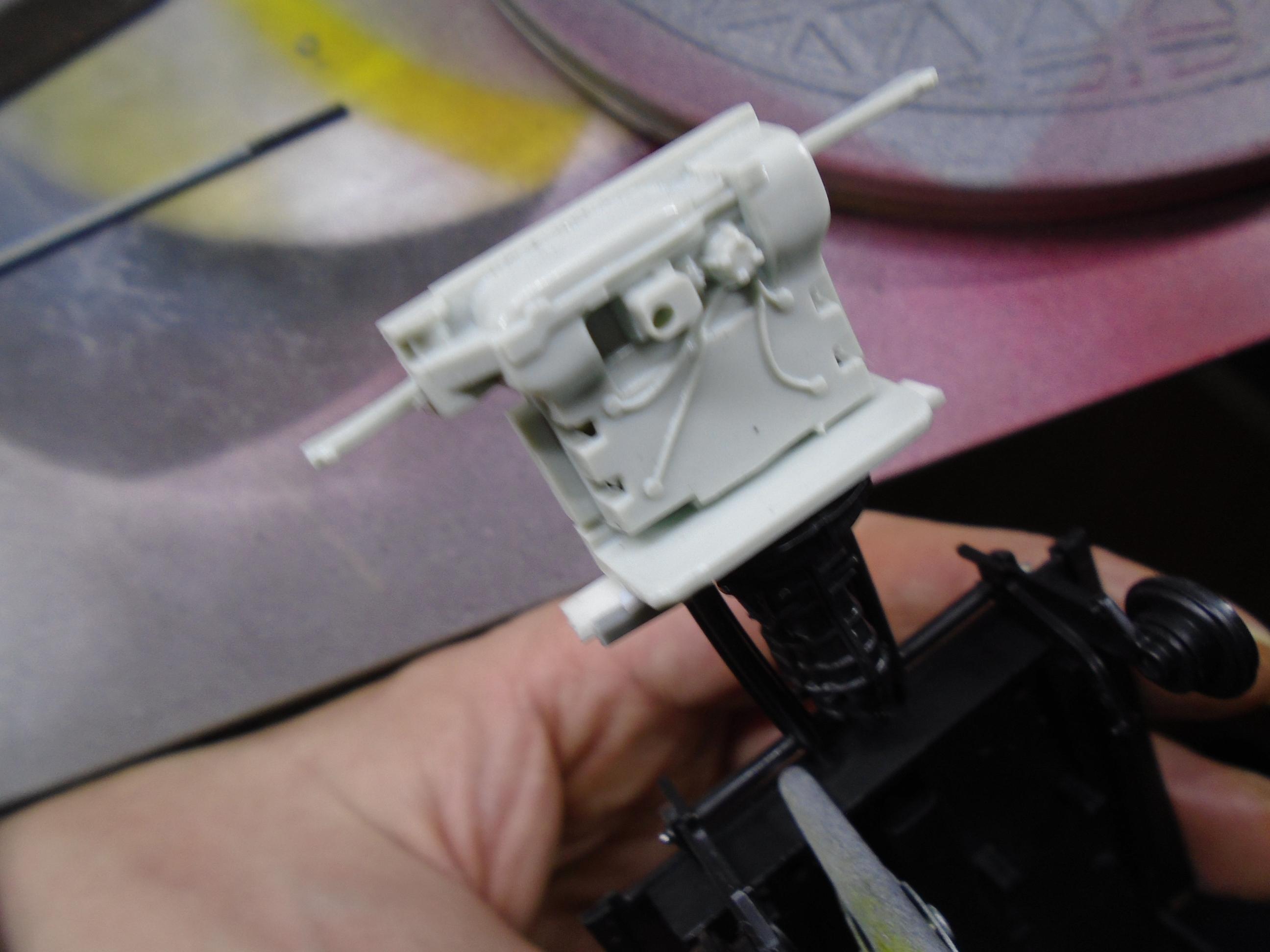

stitchdup Posted June 21, 2022 Posted June 21, 2022 4 minutes ago, Ace-Garageguy said: The engine in the Revell 914 is a blobular six nee 911. Most 914s came with the VW 411/412 engine (which was also in the Porsche 912E). It has a low profile cooling system like the earlier VW squareback and fastback 1600 engines...which is one big reason it was used in the TV Cotote. The engine in the T3 van might be a water-boxer...but I've never had that kit so I don't know fer sure. this is the t3 engine on a bug pan. its for a bug van so i had to use it instead of the earlier engine for the lower profile.
