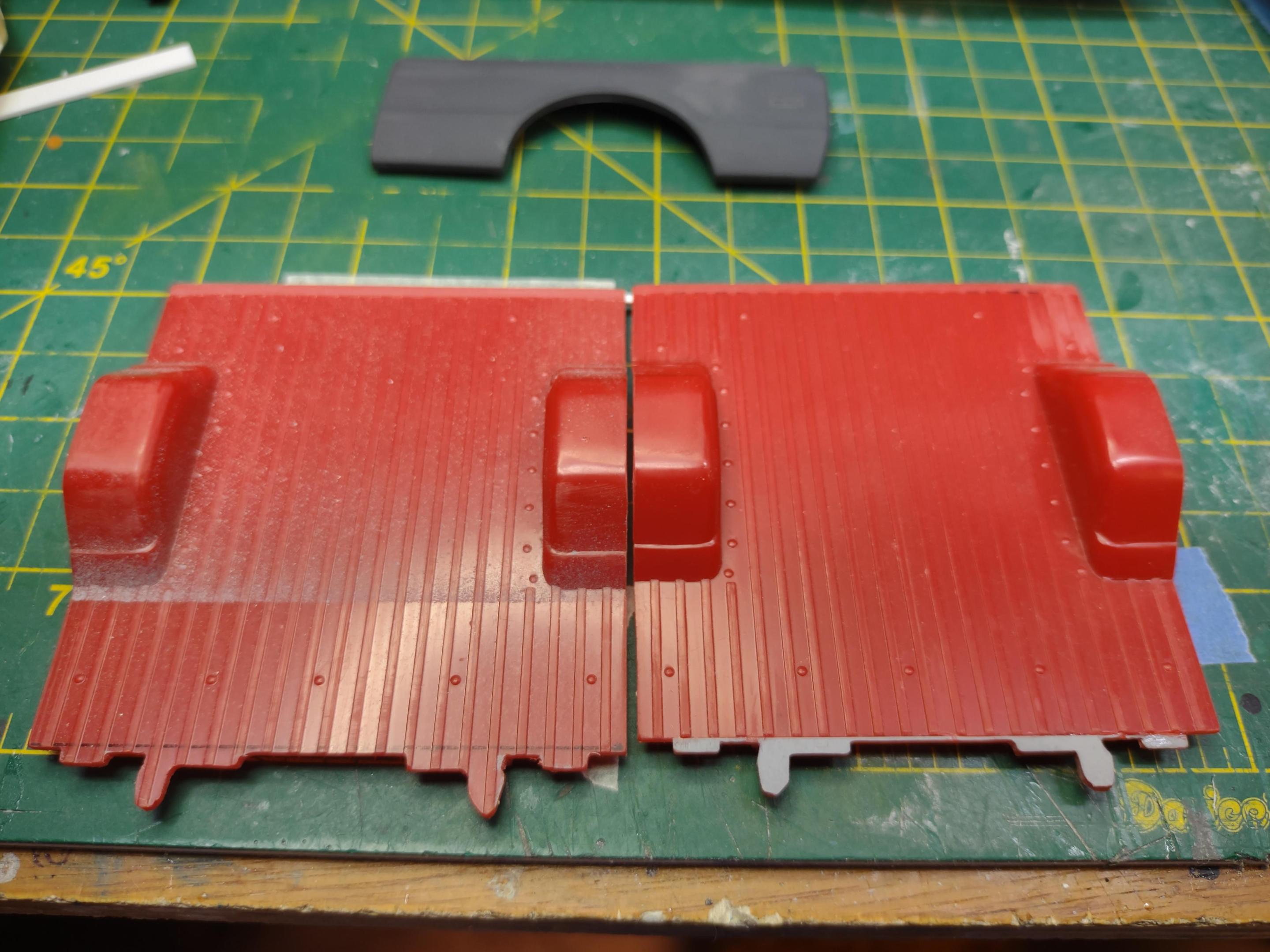

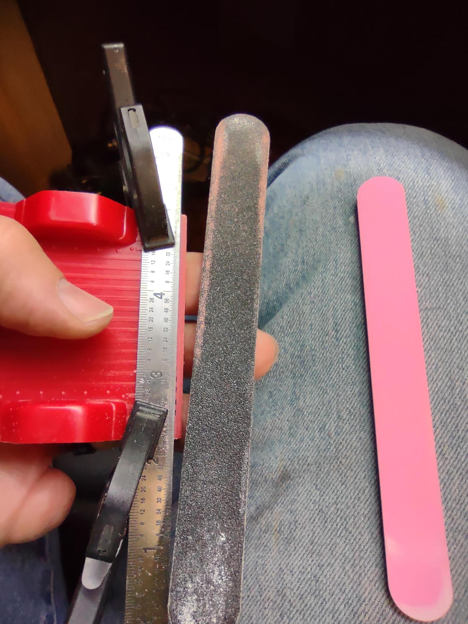

64SS350 Posted June 27, 2022 Posted June 27, 2022 (edited) On the bedside,I chose to remove the front section from the front edge and rebuild the perpendicular parts that connect with the front panel. The rear section I removed right behind the wheel opening. This option created one less body line to putty smooth. The floor I tried two methods, the first one I cut the front,patterned from another floor. The second I cut thin and reattached to the main floor. The rear I cut to length and sanded smooth to create the edge for the tailgate. Hope this helps! Edited June 27, 2022 by 64SS350 1
goosedude Posted June 27, 2022 Author Posted June 27, 2022 Thank you! This helps out a lot. Your pictures of the bed really help. I hate to cut up these expensive kits, but I've always wanted to do a custom truck. -Frank
stavanzer Posted August 11, 2022 Posted August 11, 2022 Thanks, for sharing. These photos do help to show what needs to be done.
