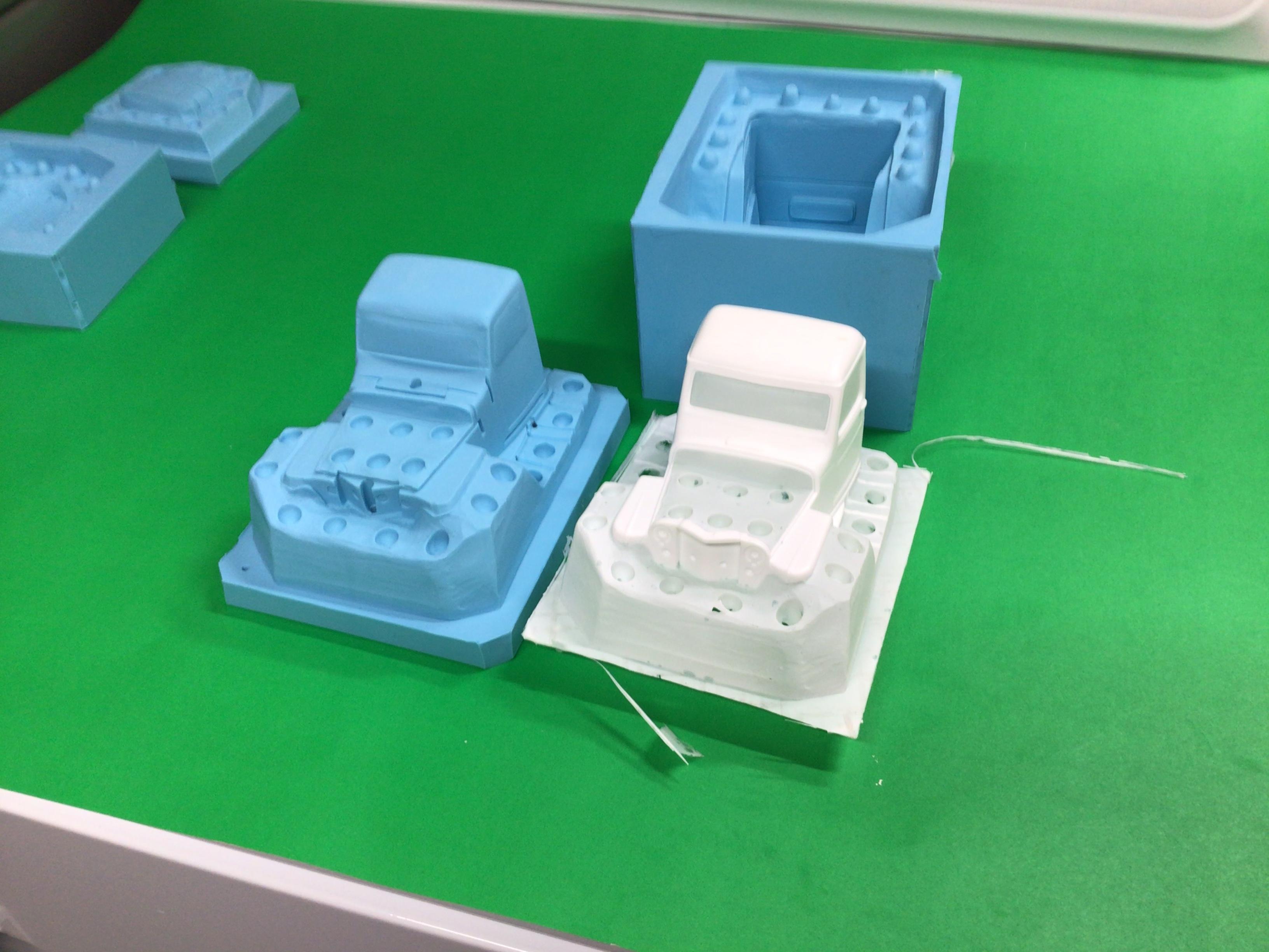

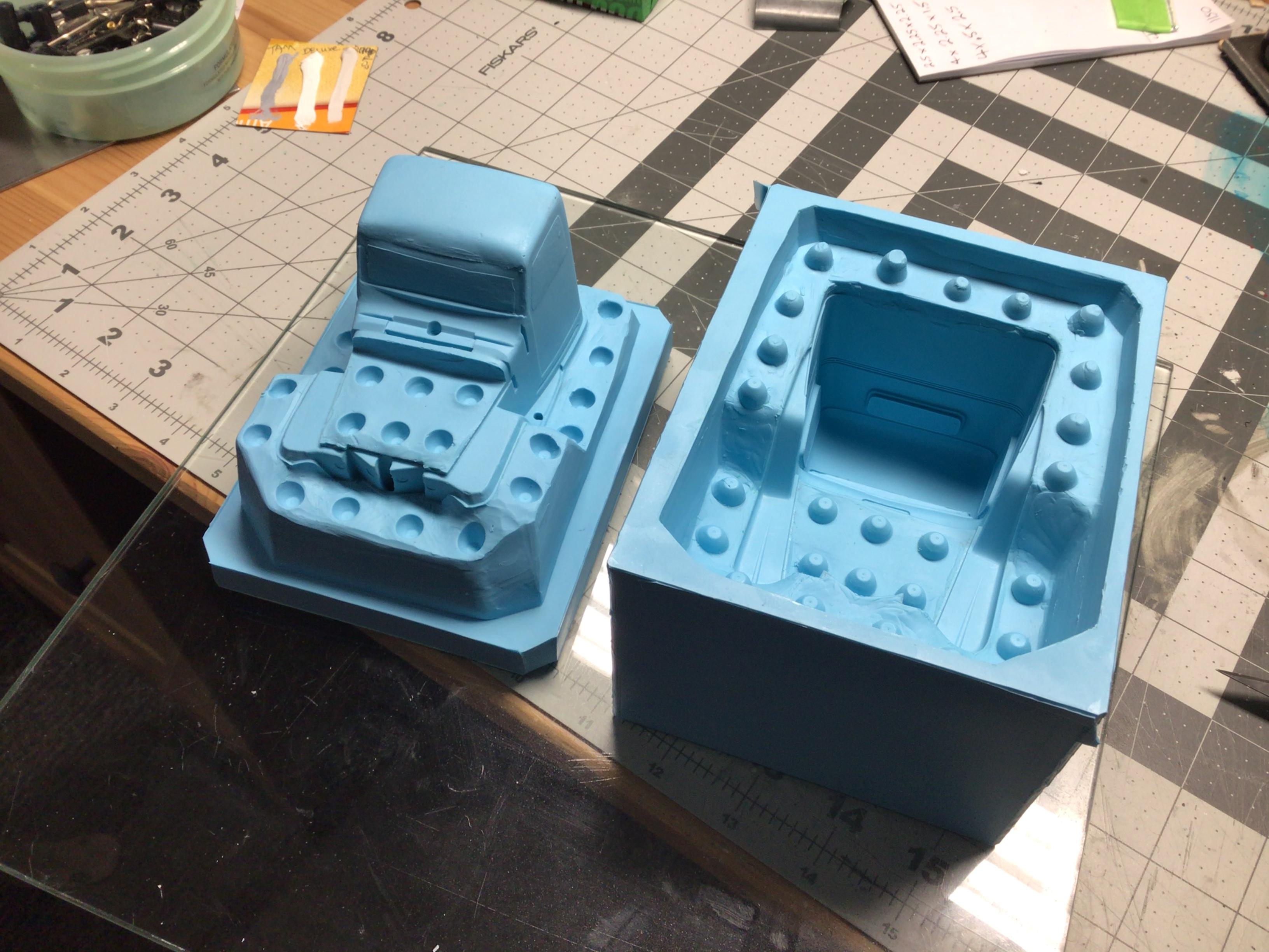

Ditto; thank you for the links. I'd seen the second one before, but the smooth-on video is much appreciated as well.

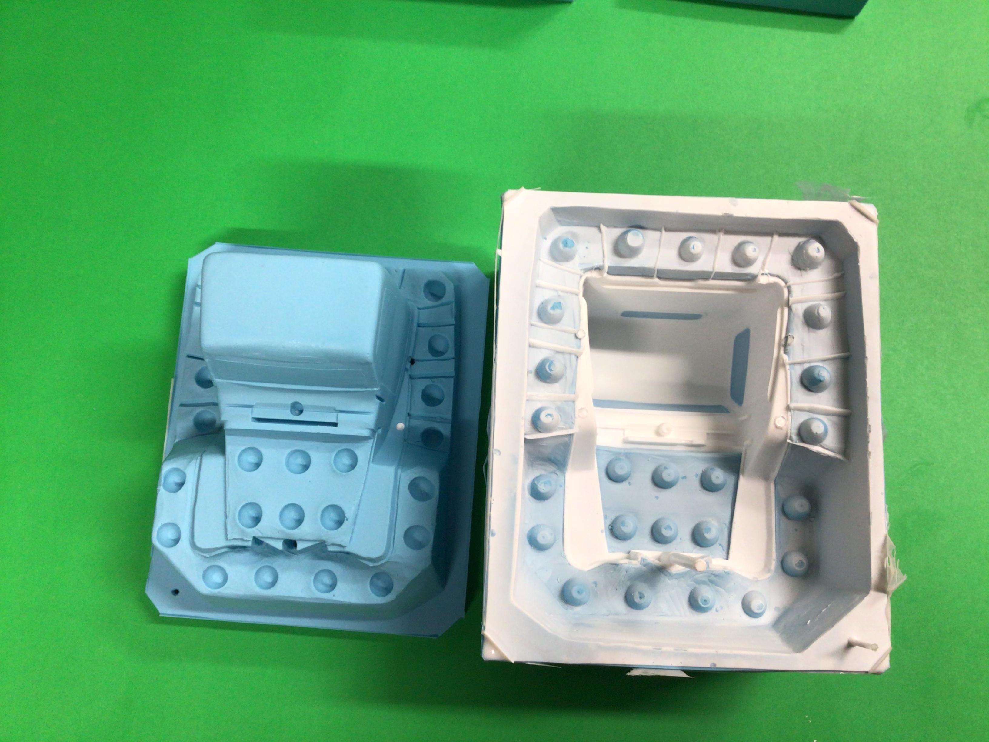

Those are excellent videos! I watched both of them and a few others too. They helped me get a pretty decent mold on my first try. I do get some air pockets that I have been able to fill.

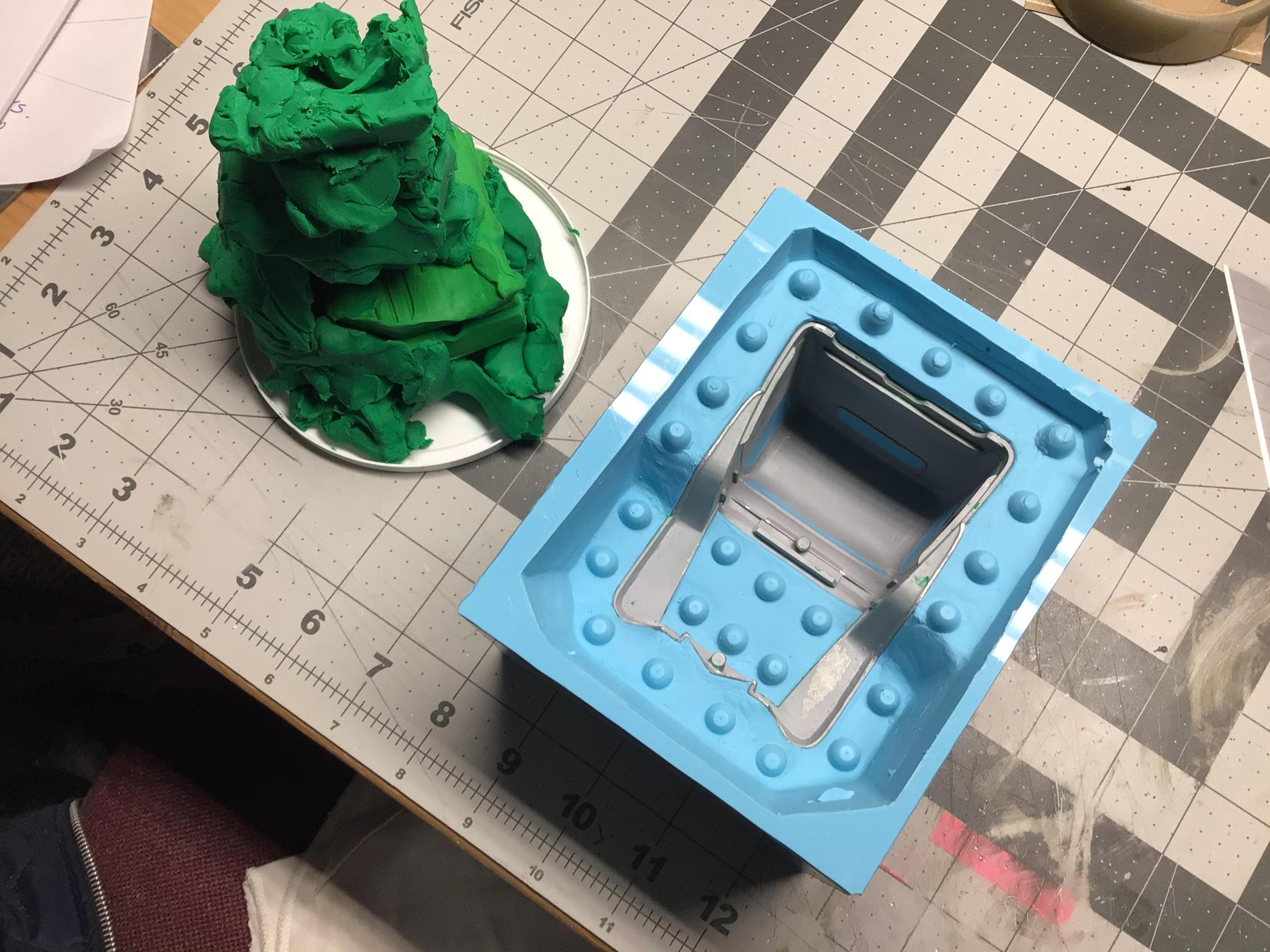

A very good video but it fails to mention using sulfur free modeling clay. Also  not to use latex gloves. Both sulfur and some nitrile gloves will inhibit the rubber. If using gloves, stick with vinyl. If not using any gloves be sure to wash your hands. Greasy hands from a pizza or cheeseburger can also create havoc ?
