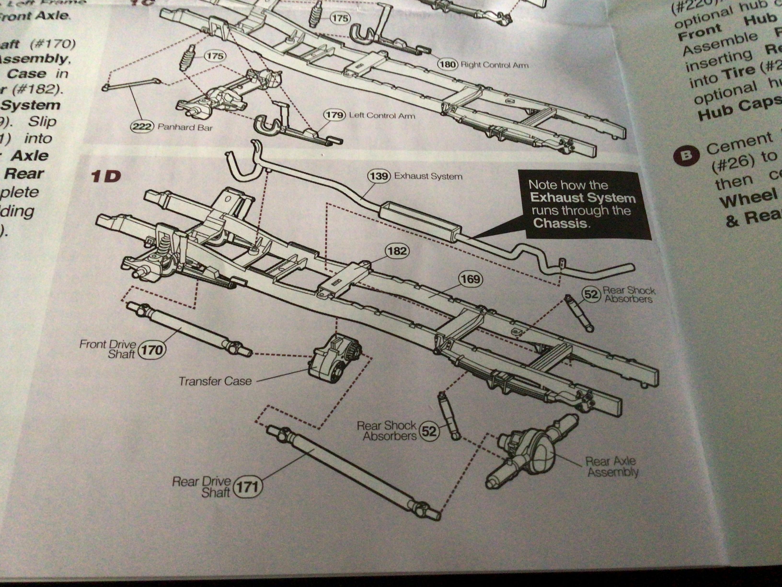

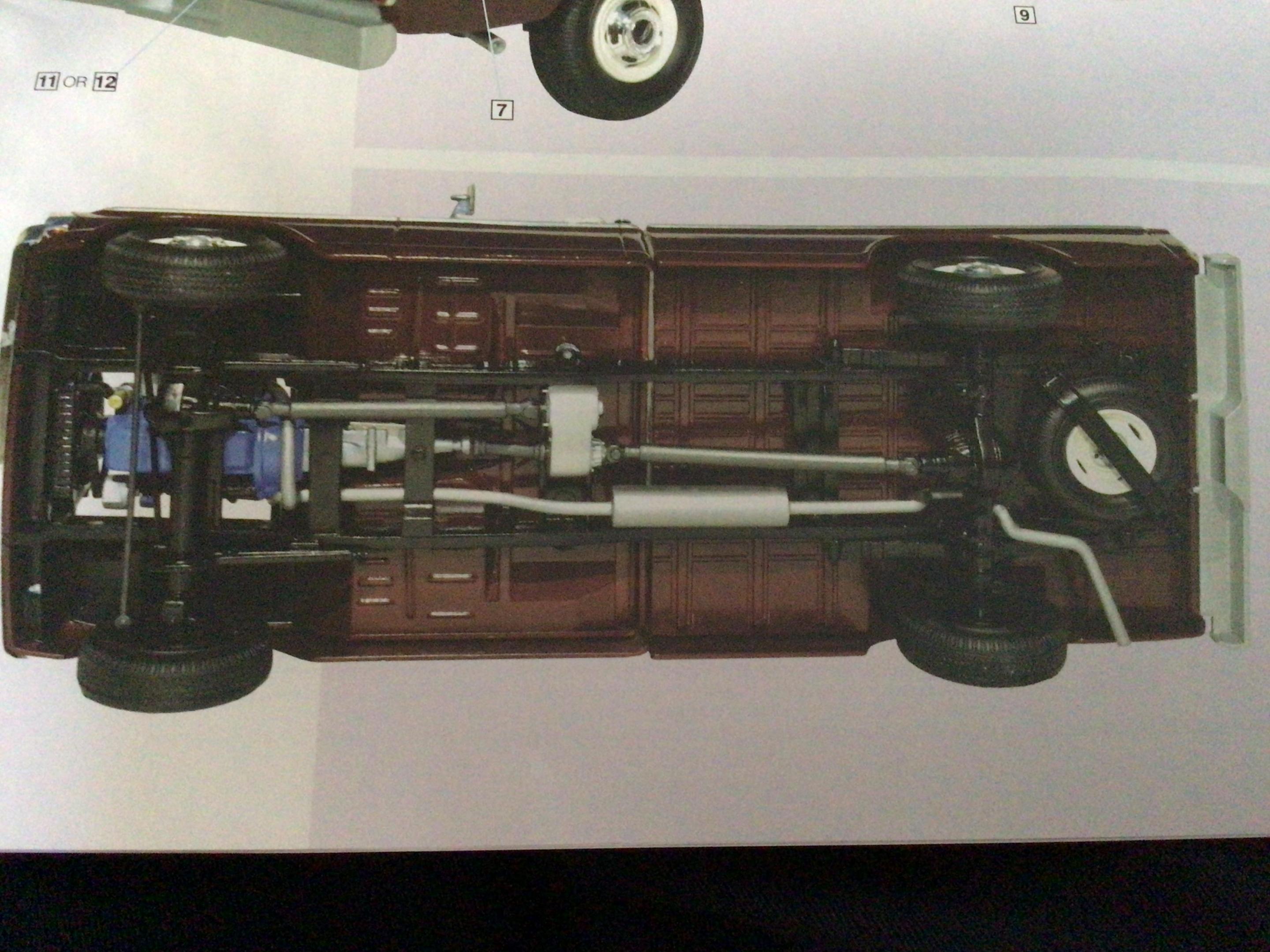

NOBLNG Posted July 1, 2022 Posted July 1, 2022 An atlas would be desirable because of the optional gear ranges available. The only drawback of the NP205 is it’s 1.96:1 low range. It is however pretty much bullet proof and will stand up to the power of a big block. The Mobius 1970 F-100 has the appropriate divorced 205 t/c. I’m not too familiar with Fords so I don’t know what years it would span.
