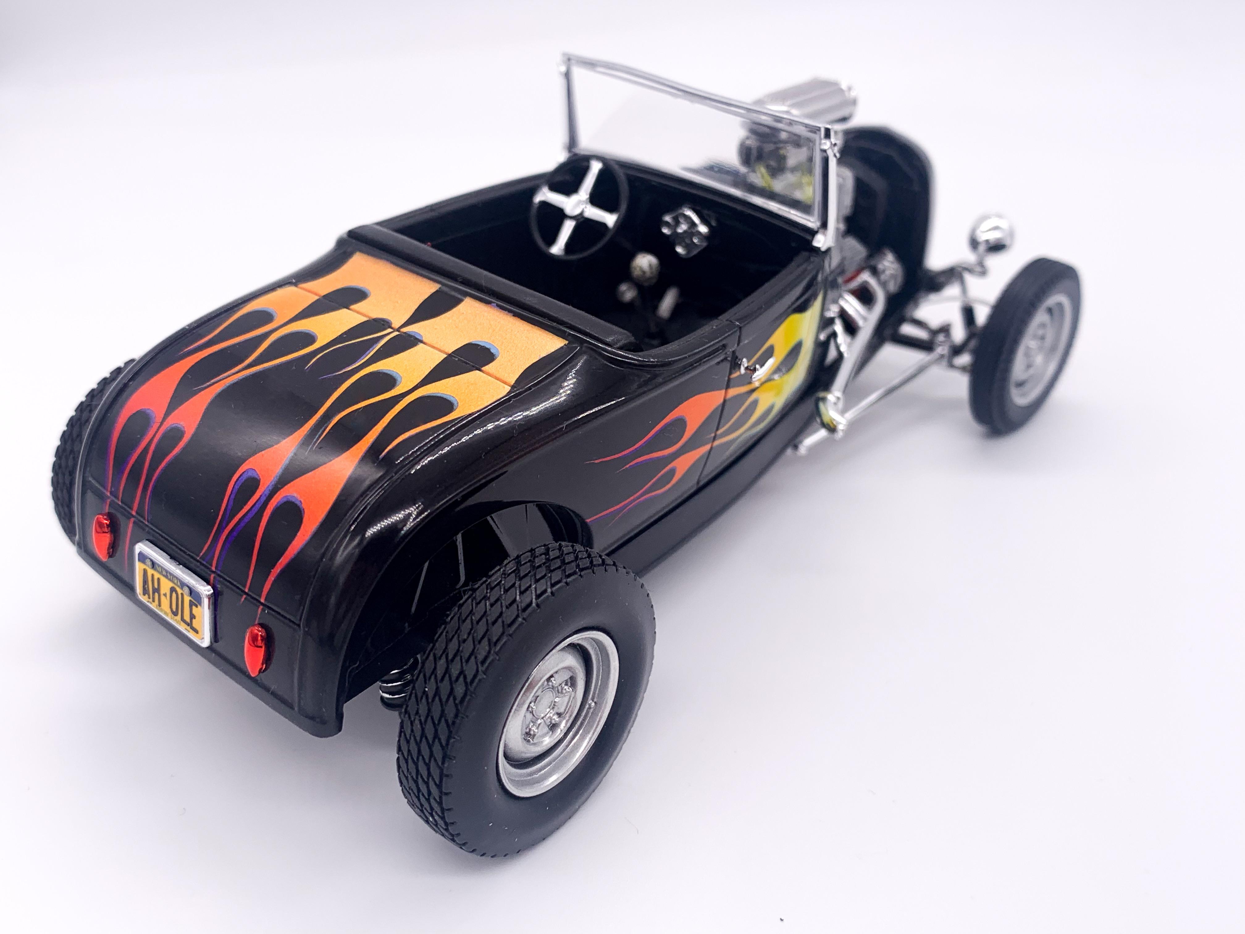

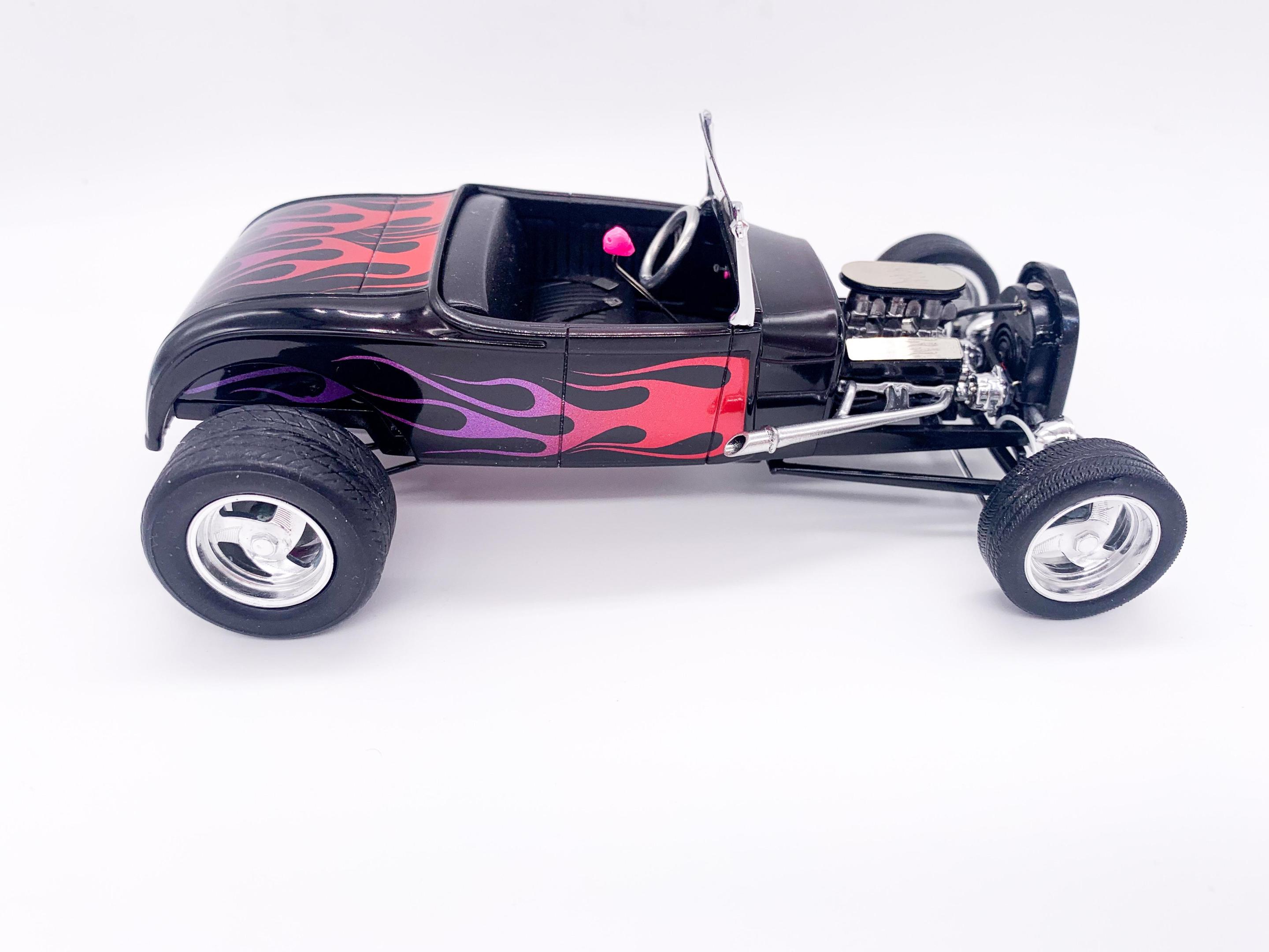

OldNYJim Posted July 6, 2022 Posted July 6, 2022 2 hours ago, TransAmMike said: Yeah Jim, seems I actually thoight I sent one post and it didn't show that it sent so sent it again worded a little differently. So you're saying you use it as a topcoat?? I normally clear over about everything, so I’ll use it often as a main color coat yeah! It’s my go-to black for that…here’s a a couple showing how it looks with some clear over top: Lays down super smooth and nice, and you can lower the pressure on the airbrush to get it either completely matte or a semi-gloss if you prefer for fabrics and rubbers and underbody stuff - really versatile and easy to work with. I love the stuff…just not as a primer or sealer. Even the $2 Walmart primer is WAY better for THAT task, when shooting over Styrene. As usual, your mileage may vary… 1
