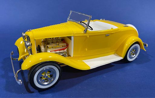

I have been planning this project in various forms for about 18 years now. It started out as my attempt to clone an LD because at the time I didn't have the money for a true LD kit. So I was going to scrounge the LD specific parts and throw them at a Revell 32 Roadster kit. It has evolved through several forms over the years, the biggest step being overcome when I mastered the correct LeMans wheels and Drag City Casting offered them in their product line. What finally pushed it onto the bench was all the fun I've been having the last 18 months with building models featuring polished plastic as opposed to painting. I had an 80's issue of the Monogram 32 Ford roadster (saw tooling as the LD, but has been modified into a street rod configuration over the years) that is molded in yellow. I thought this would fit the bill perfectly for my little Big Deuce. And so it began in earnest.
1657192407274

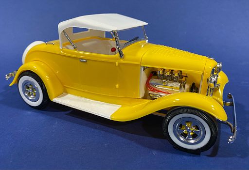

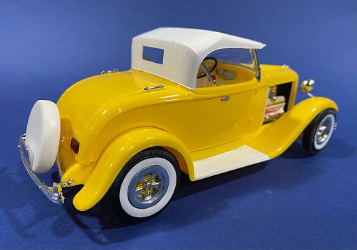

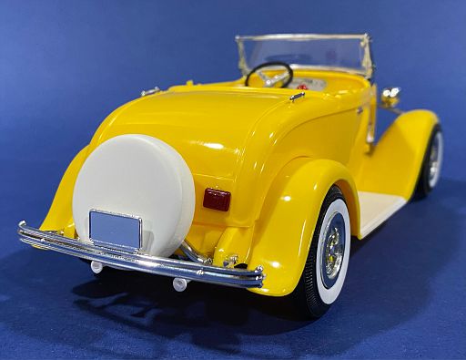

The body and fender unit itself is untouched other than getting polished with The Treatment polish. I deleted the wing windows from the windshield, added bumper brackets from a Revell deuce and hit them with Molotow to match the items in the BD. I used a set of copies of the LD taillights that were cast in clear red resin by Replicas and Miniatures of Md, a horn from a Blue Beetle and other LD specific parts from my stash of LD glue bombs. To match the optional part in the BD I took the covered spare tire and bracket from an AMT 32 Ford Vicky and painted it white to make it look like it was molded plastic.

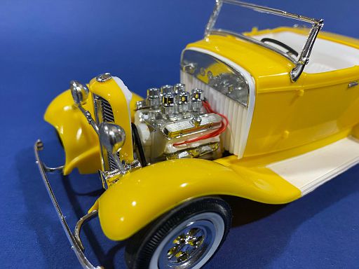

Moving on to the engine, I used an original issue LD Pontiac block, valve covers, fan belt, exhaust manifolds and intake. I hit the exhaust manifolds with Molotow to match the BD. I took the air cleaners from the Revell 29 Ford Model A kits because they are an exact match for the BD items, mounted to carbs from an AMT 40 Ford kit. Since the Big Deuce offered engine wiring when it was released i took a little artistic license and installed a Morgan Automotive Details wired magneto to finish things off (I know, I need to add the radiator hoses)
I also improved the firewall, partially out of necessity. I didn't have any viable LD firewalls to use, so I traced the shape onto Evergreen sheet, clipped off the upper portion with the molded in gages and then used Evergreen 1/2 round to add the pleats to the lower portion. I then wrapped the piece with .020 strip to simulate the prototypical flange on the 1:1 part. I kept the insert as a separate piece so I could apply Molotow and reinstall later, matching the BD feature.

The frame features a few subtle changes that may not be readily apparent. The big change is the swapping in of the Quick Change rear end as opposed to the stock item in the LD to match the BD. This required removing a portion of the gas tank to accommodate the QC, and swapping in a different rear crossmember. Since this was a "no-paint" project I had to get creative with the rear crossmember but cutting it from a molded in yellow 29 Ford pickup and grafting it into the LD chassis so it it wouldn't be noticeable. To finish off the rear I added arms from a Revell 37 Ford pickup and a scratchbuilt torque tube from Evergreen.
The front suspension was left mostly box stock, and I added a brake reservoir from a Revell 40 Ford since the LD didn't offer one. I did replace the molded in mufflers with Evergreen tube since the molded in items had huge recesses molded into them.
