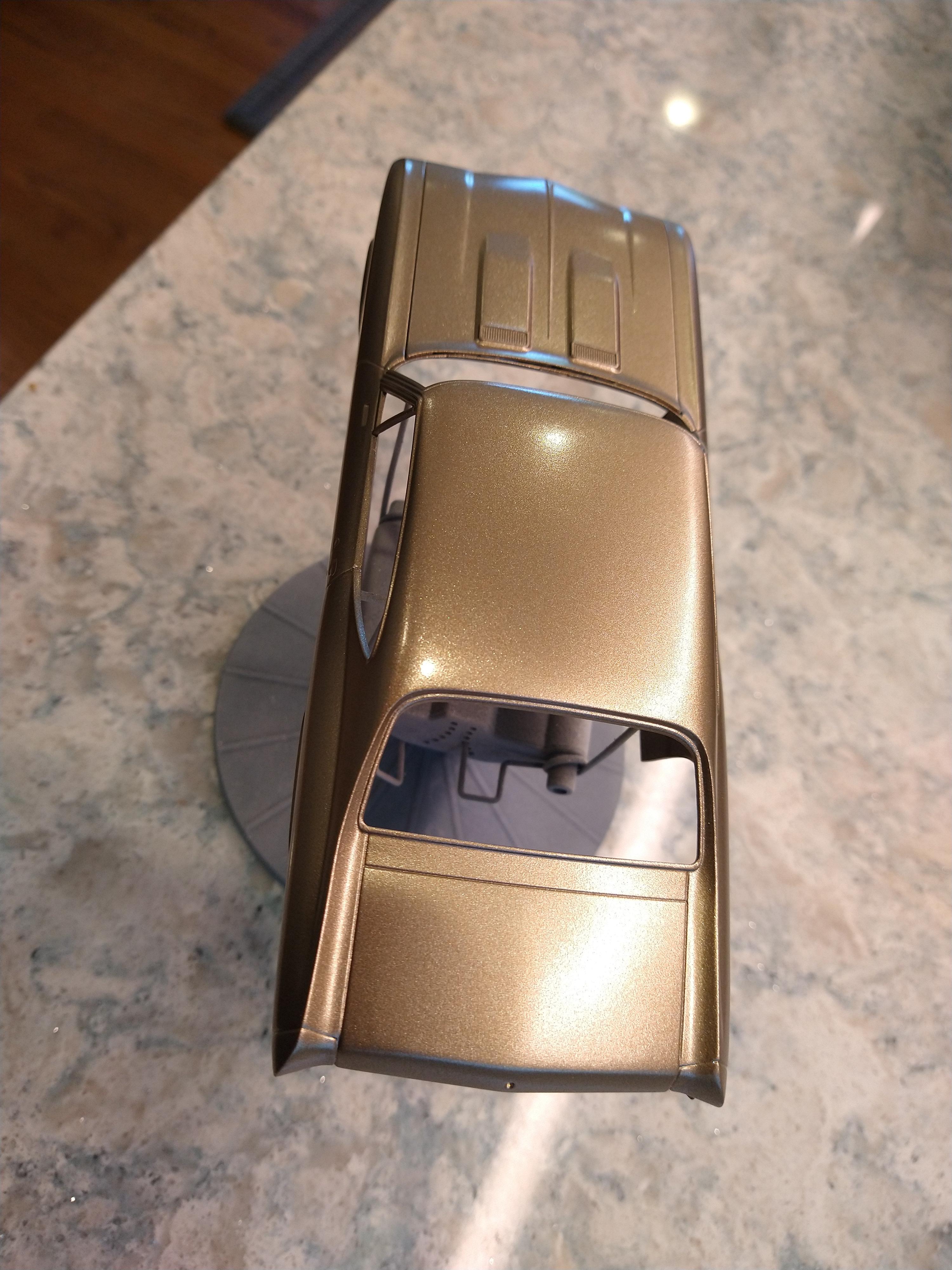

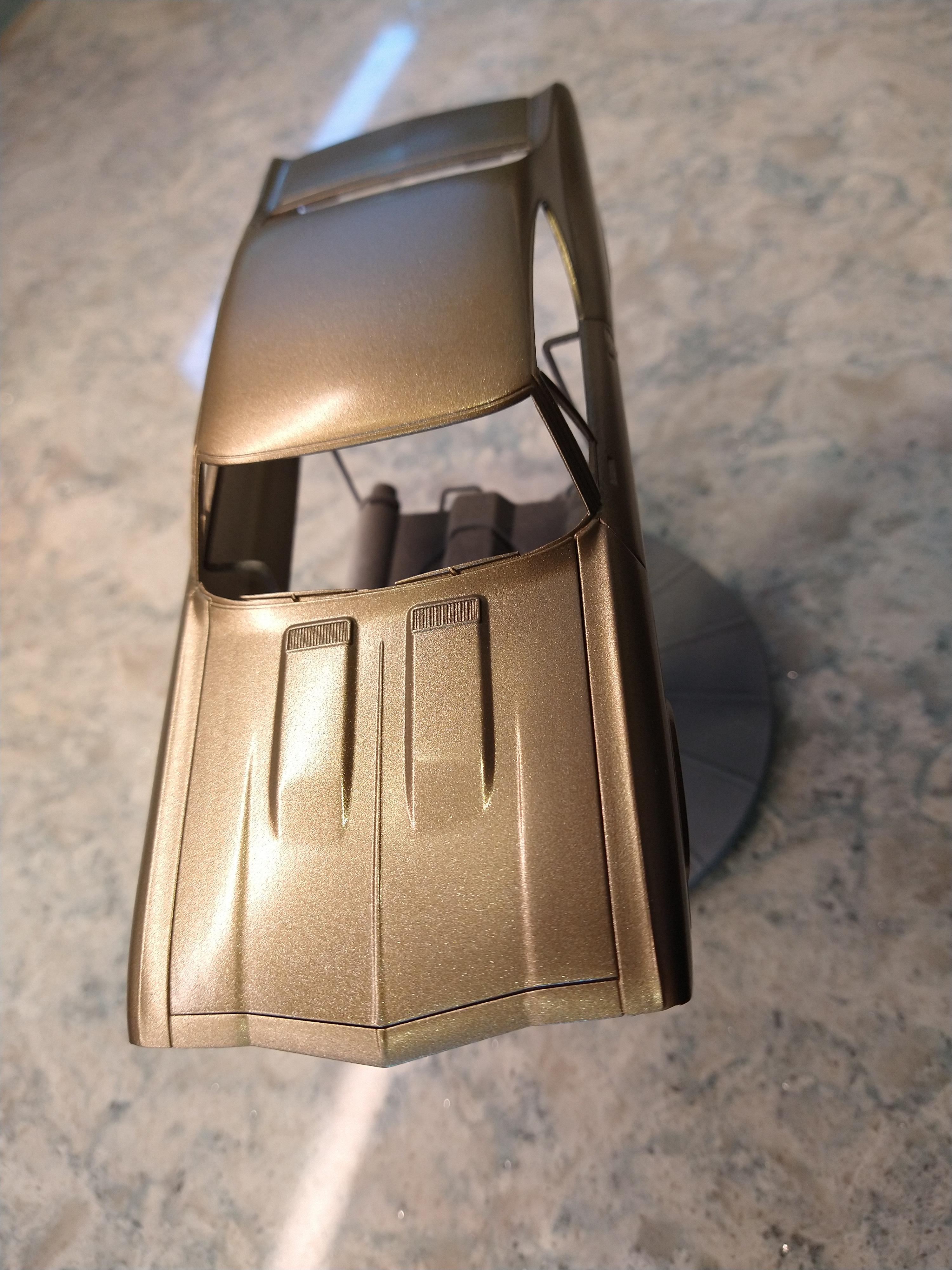

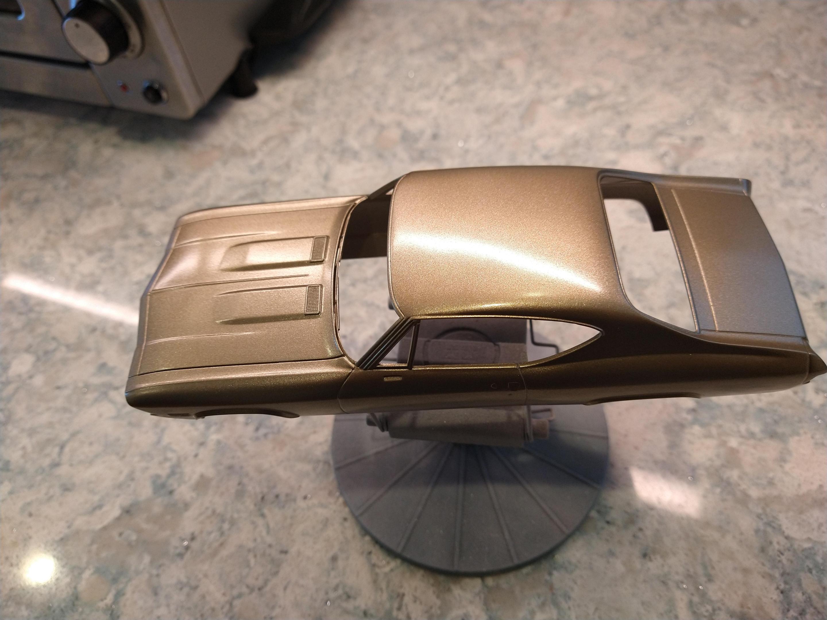

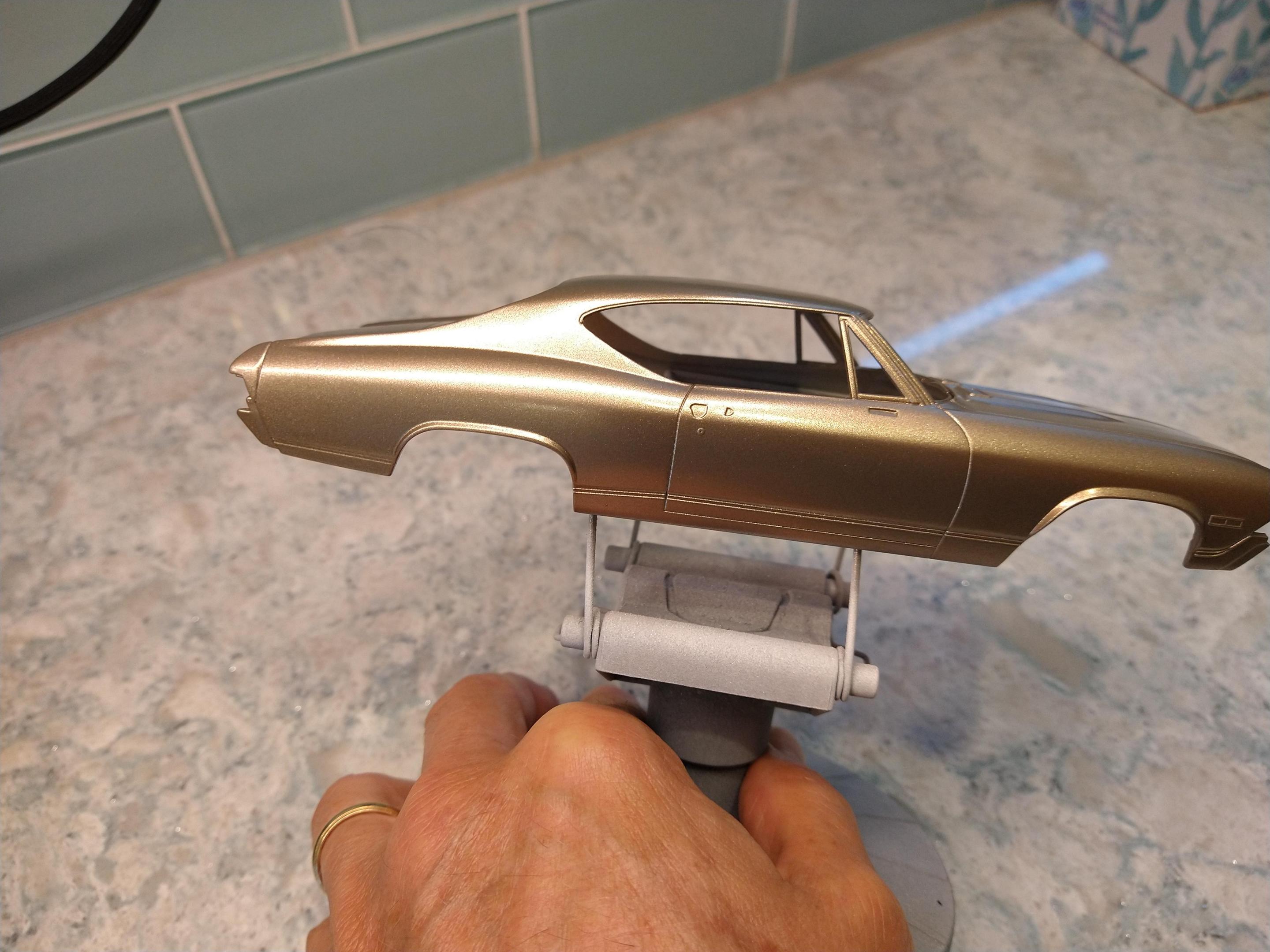

stevez Posted August 3, 2022 Author Posted August 3, 2022 Does this need a clear coat over the base?, Tamiya light sand metallic. Was lightly wet sanded between coats, about 4 or 5.
Bainford Posted August 3, 2022 Posted August 3, 2022 Very nice looking paint, but there is a slight texture, probably inherent in the paint. I don't clear everything, but I think a clear would finish off that paint job very nicely. A couple coats of clear and some light, fine colour sanding or an application of cream polish and that paint will look like a million bucks.
Dpate Posted August 6, 2022 Posted August 6, 2022 On 8/3/2022 at 2:51 PM, Bainford said: Very nice looking paint, but there is a slight texture, probably inherent in the paint. I don't clear everything, but I think a clear would finish off that paint job very nicely. A couple coats of clear and some light, fine colour sanding or an application of cream polish and that paint will look like a million bucks. +1 to clear coat
