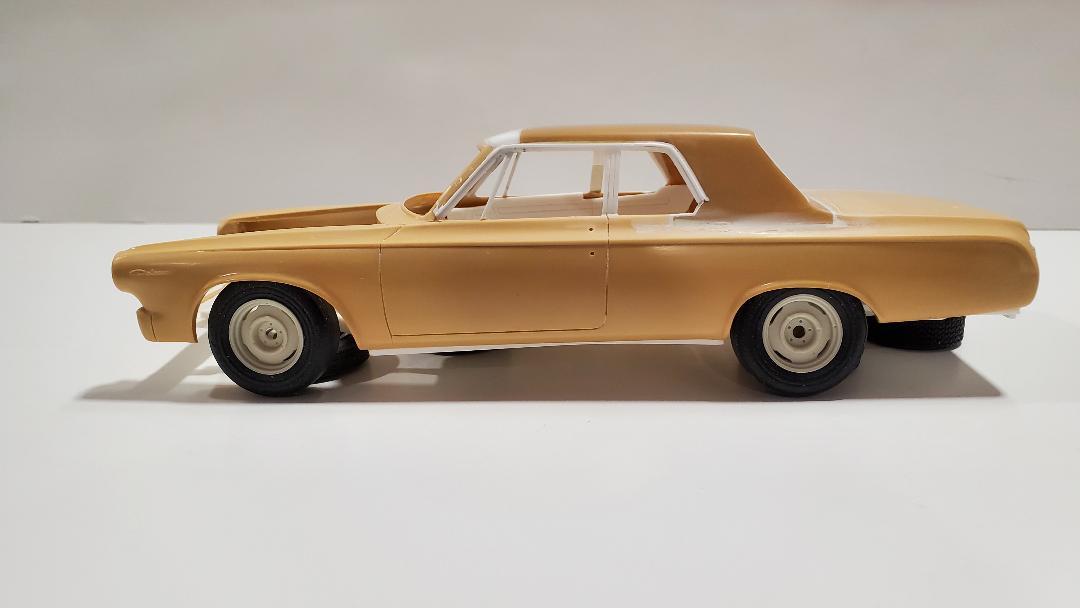

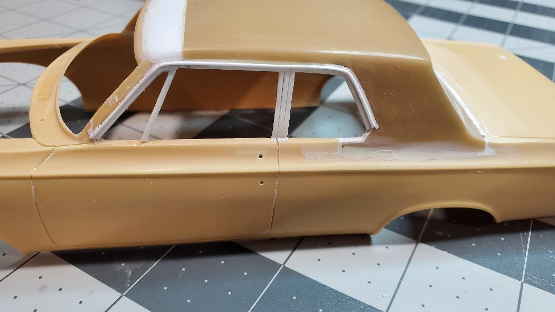

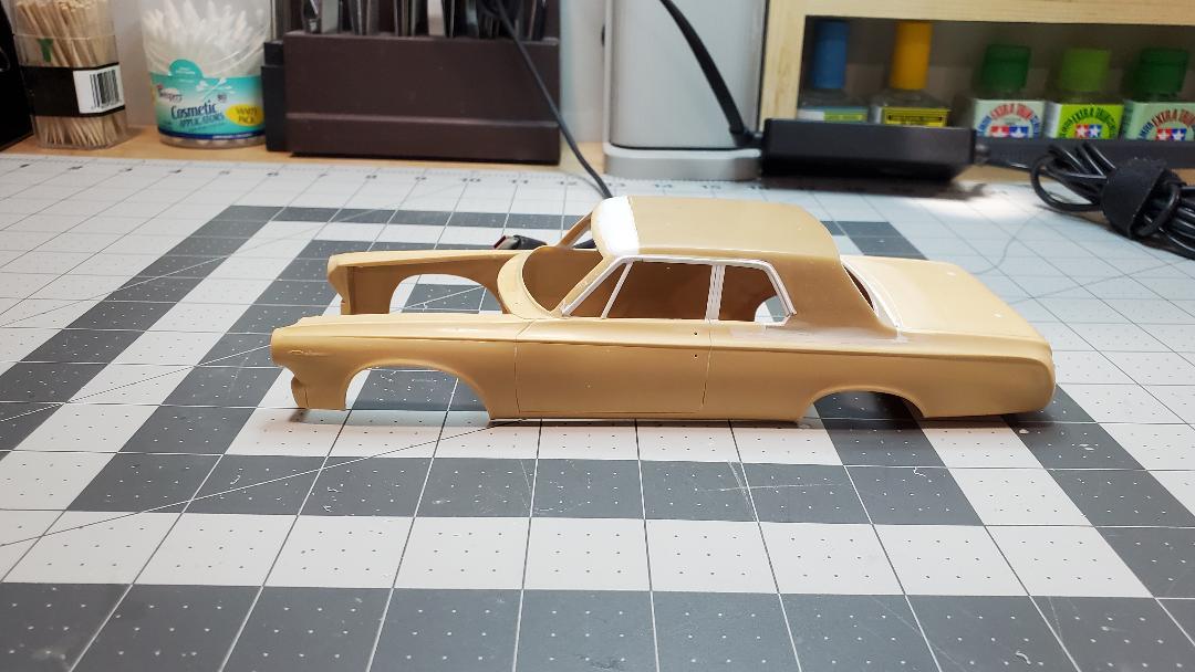

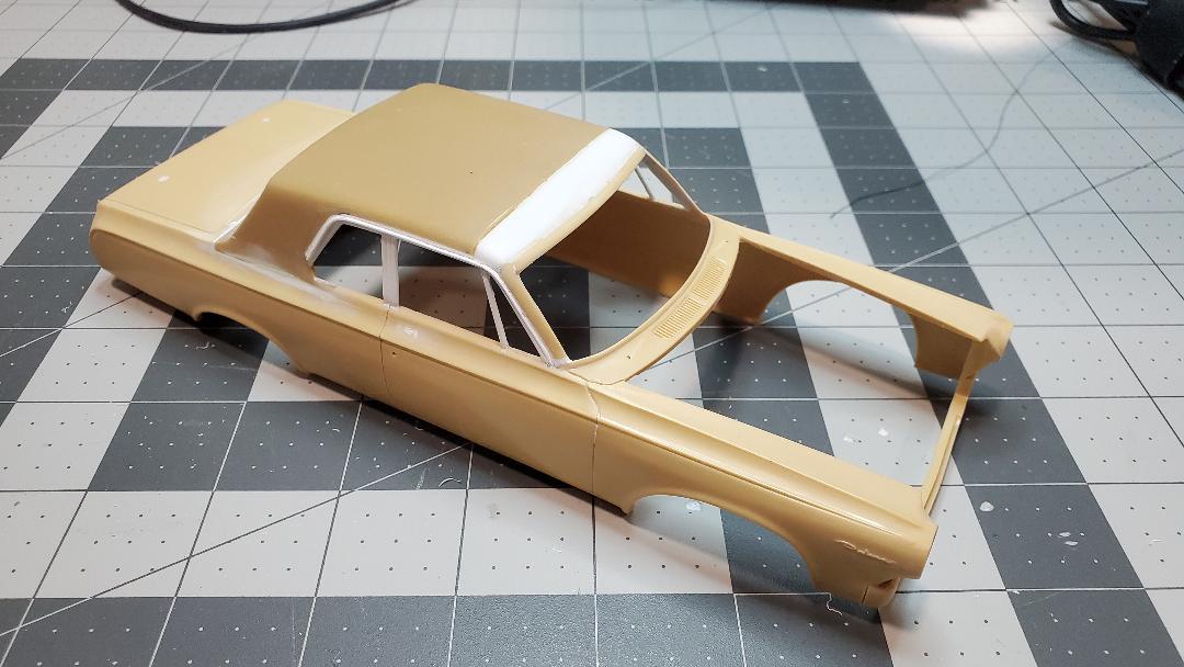

BobbyG Posted July 24, 2022 Posted July 24, 2022 (edited) Started a new project to add to my early Mopars. I had a 63 Polara convertible with a broken windshield and an old Plymouth body's hardtop, so its was a perfect project to create a detailed 63 Ramcharger Dodge, the missing Mopar in my projects. The body has been dechromed, new body panels scribed, headlights buckets added and modified the rear taillight panel for the base model, needing more refinement. I will be using a Lindberg kit for the chassis and engine components. New door panel are next and the dashboard modified. I don't have a 3D printer so I am looking for someone who had one to help with the speaker grille and will help my other 62-63 Mopars. I am missing a hood and front grille/bumper. Hope you like this one. Edited August 5, 2022 by BobbyG 2
EngineerBob Posted July 24, 2022 Posted July 24, 2022 Top notch work integrating that roof onto the convertible body.
espo Posted July 24, 2022 Posted July 24, 2022 I agree with Engineer Bob on the body work. I like the low line two door vibe in 1:1 cars as well.
BobbyG Posted July 24, 2022 Author Posted July 24, 2022 1 hour ago, EngineerBob said: Top notch work integrating that roof onto the convertible body. Thanks

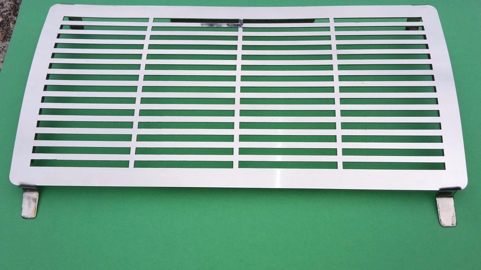

bisc63 Posted July 25, 2022 Posted July 25, 2022 Isn't that grille in one of the AMT parts packs, like "bumpers and grilles" or some such?
BobbyG Posted July 26, 2022 Author Posted July 26, 2022 On 7/24/2022 at 9:30 PM, bisc63 said: Isn't that grille in one of the AMT parts packs, like "bumpers and grilles" or some such? I think that grille in the parts pack is for a 62 Dodge. Very different. Thanks 1
dino246gt Posted July 26, 2022 Posted July 26, 2022 Nice conversion! Should be a real cool model when finished! I love the low trim level cars for performance machines! 1

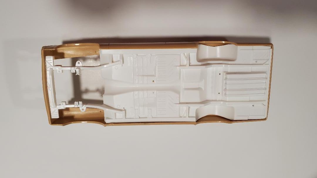

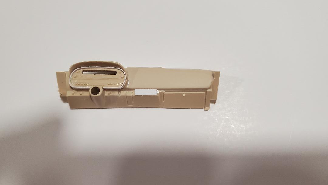

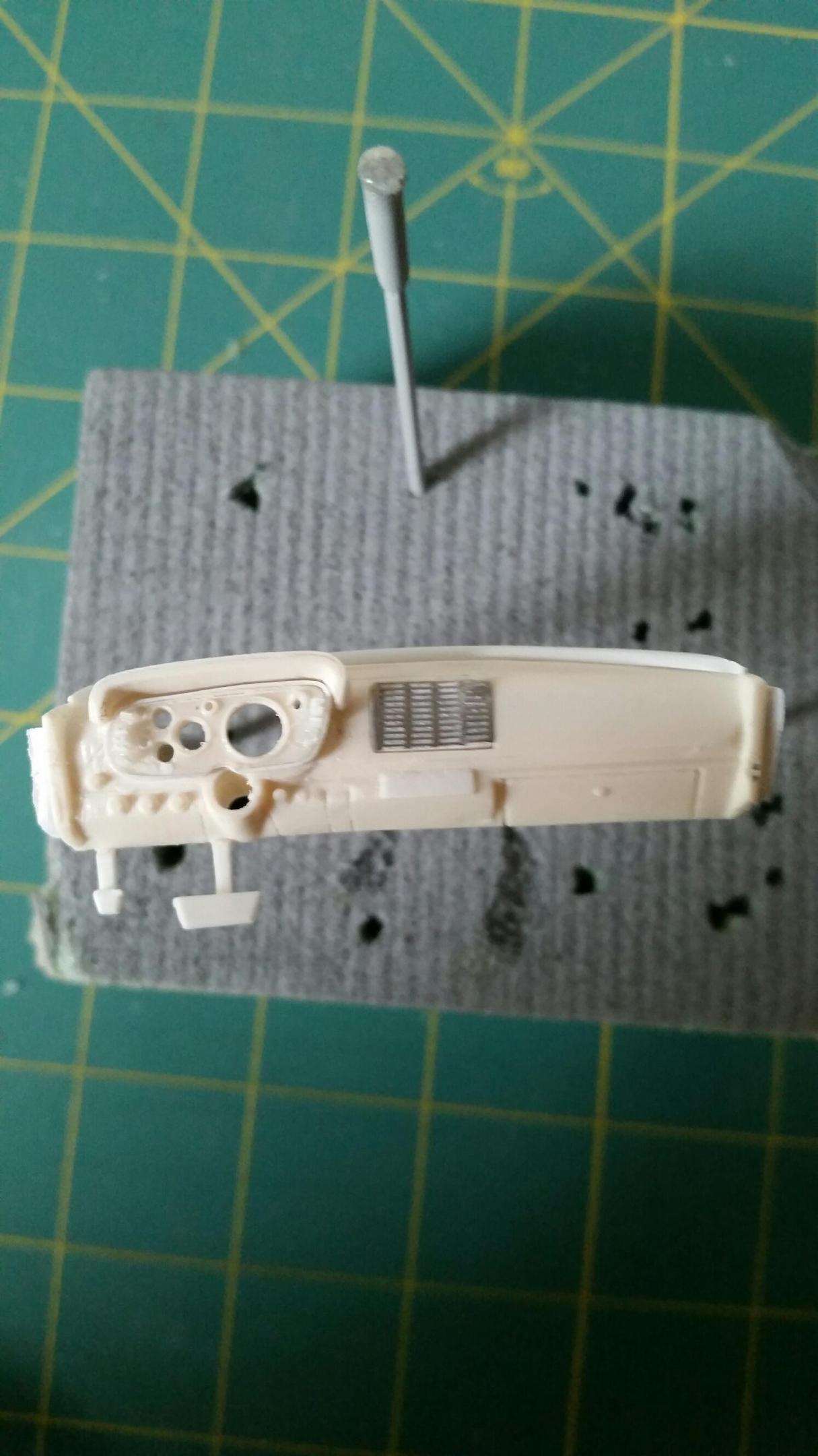

BobbyG Posted July 30, 2022 Author Posted July 30, 2022 Here's an update on my 63 Dodge. I have modified the dashboard to the base model and some detail. Fitted the Lindberg chassis with no issues, just 1/16"trimmed off the front edge, finished the headlight buckets. I added some bits of plastic at the edge of the body to support the chassis. Here's a mock up with Fireball Model Work's Mopar wheel kit, but that will may change later on. Thanks

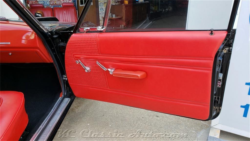

BobbyG Posted August 5, 2022 Author Posted August 5, 2022 Here is the first attempt for the door panels, this one will be red on red.
David G. Posted August 9, 2022 Posted August 9, 2022 You got a lucky break having such simple door panels to replicate. It should be easy to make them look great. David G.
BobbyG Posted August 9, 2022 Author Posted August 9, 2022 36 minutes ago, David G. said: You got a lucky break having such simple door panels to replicate. It should be easy to make them look great. David G. Yeah what you don't see in the picture is the checked embossing that doesn't show well, once I prime them then it will show better. This is the first pass at making them so I may redo them as the checked parts are not that easy to replicate. My 63 Plymouth door panels were a bit more challenging.
