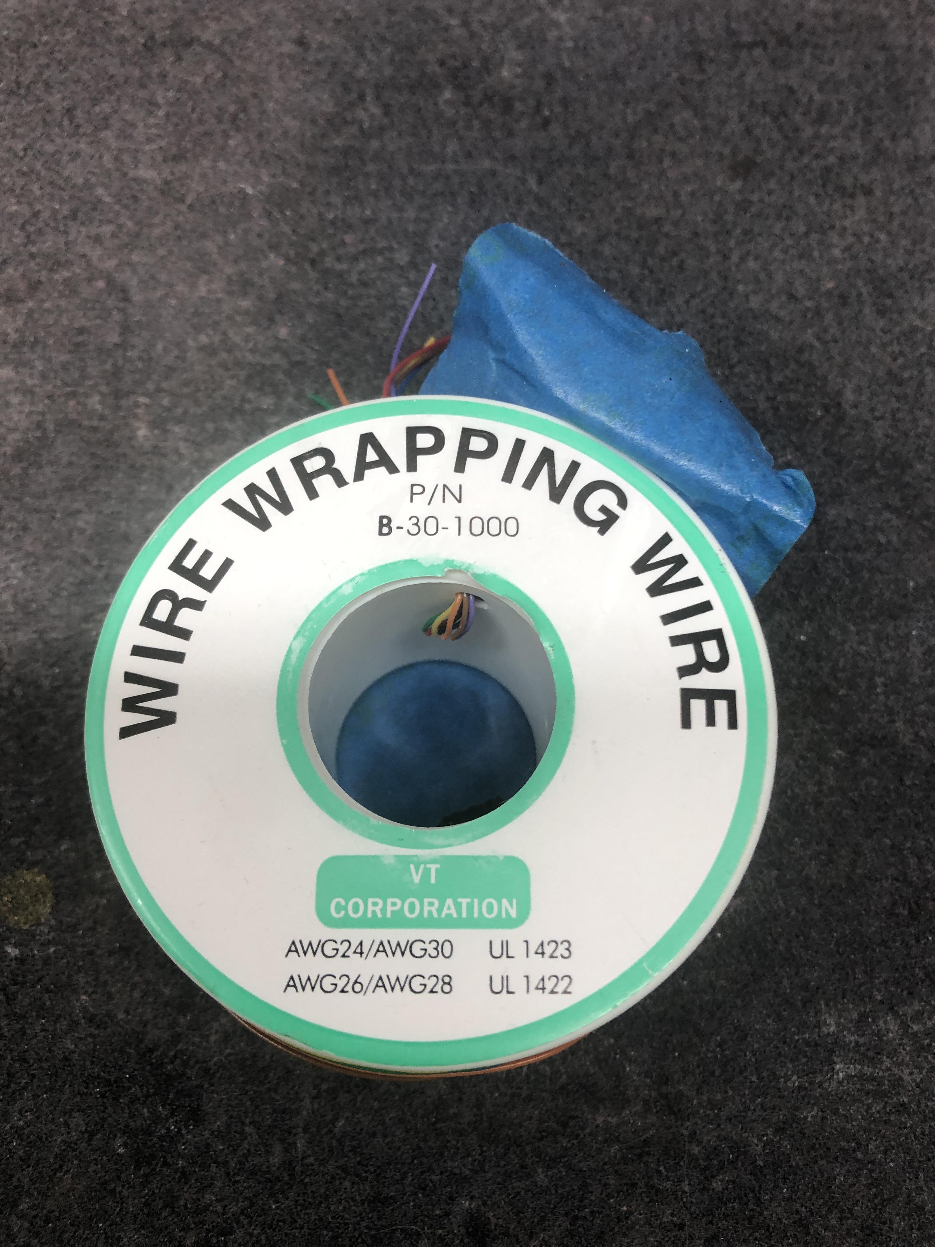

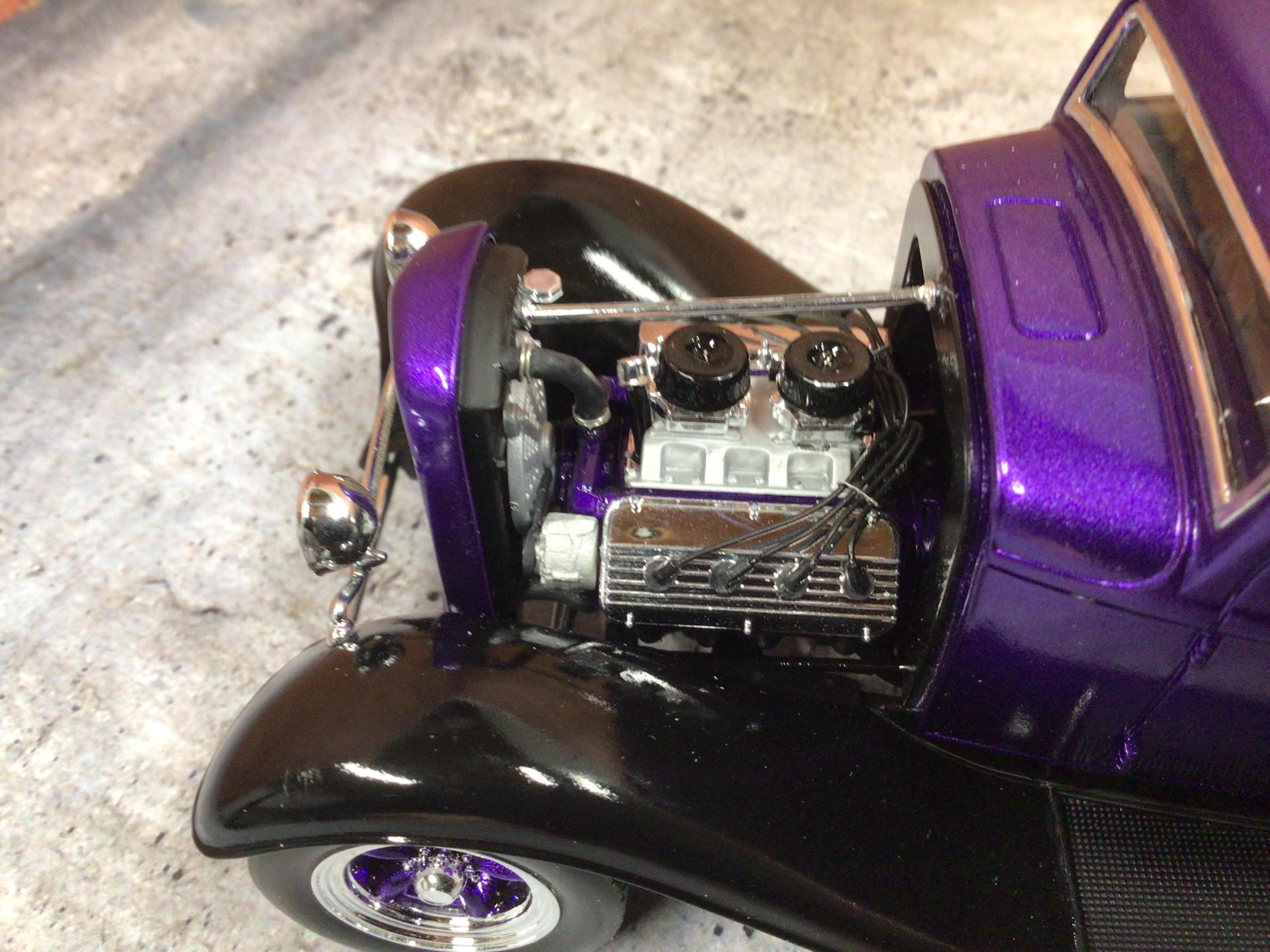

NOBLNG Posted August 2, 2022 Posted August 2, 2022 This is what I use. It measures .020” which is 1/2” in scale. It looks right and that’s what counts. I see a lot of builds that look like they’ve used heater hose for plug wires. 1

NOBLNG Posted August 3, 2022 Posted August 3, 2022 6 hours ago, Force said: But to be fair 0.020 = 0,5" is quite larger than ignition wires are on most cars as 0.5" is 12.7 mm, the MSD ignition wires om my Ford 390 based 445 stroker engine I just built and put in my 1963½ Galaxie are 8.5 mm wich equals 0.33" (0.014 in 1/24th scale), but some things looks better slightly overscale so it really doesn't matter...as long as it looks right by the eye it works. Your math is correct. The difference in 1/25 scale between my 1/2” wire and your proper 8.5mm wire is 0.0068” which is pretty much undetectable by the naked eye. Like you said…if it looks right, it works. Anything much larger looks cartoonish in my mind. 2

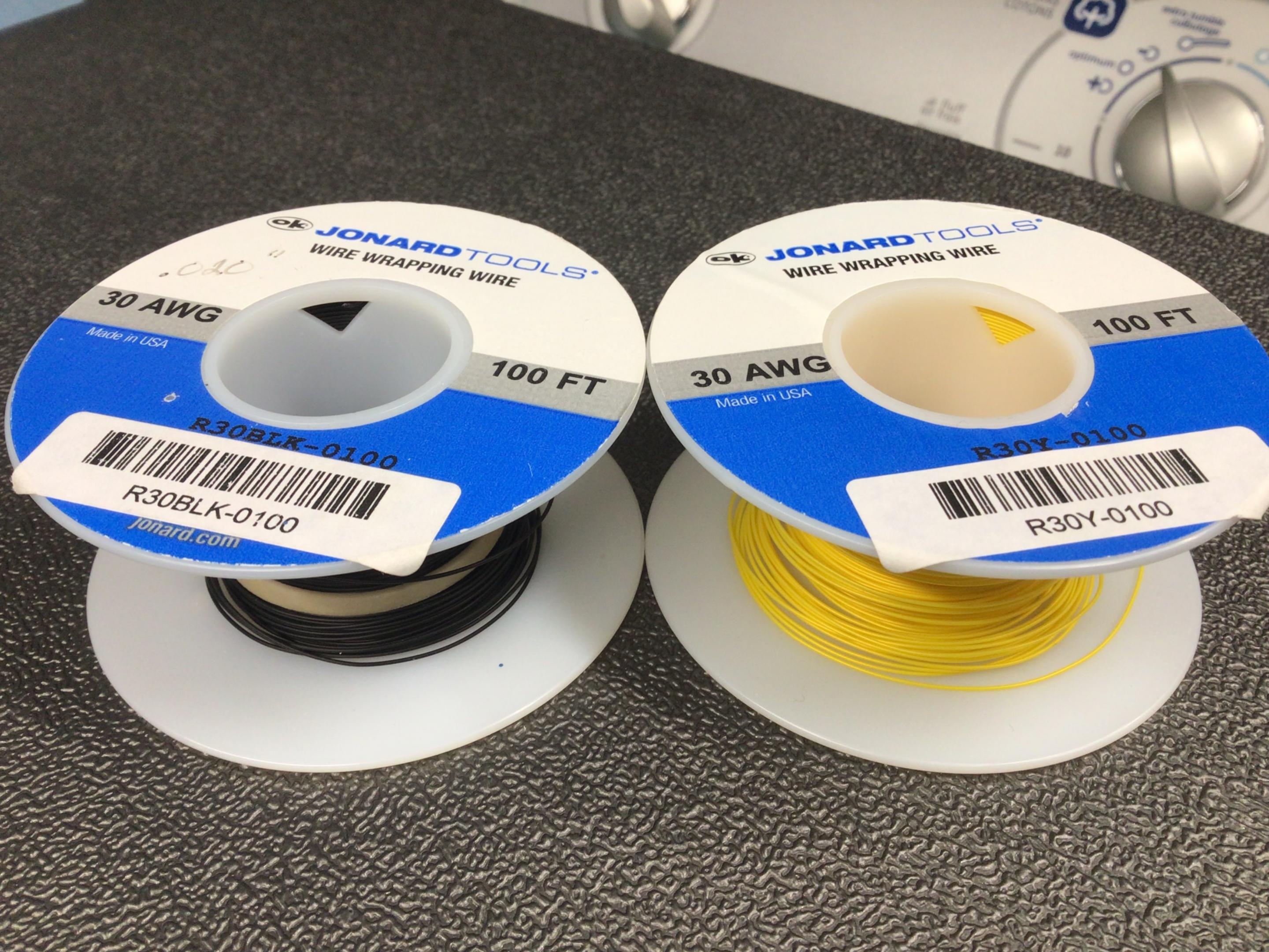

Jantrix Posted August 4, 2022 Posted August 4, 2022 On 8/2/2022 at 3:21 PM, NOBLNG said: This is what I use. It measures .020” which is 1/2” in scale. It looks right and that’s what counts. I see a lot of builds that look like they’ve used heater hose for plug wires. I use 30 AWG wrapping wire also. It looks right to me. 1
Jack L Posted August 4, 2022 Posted August 4, 2022 I use Radio Shack 30awg wrapping wire it is .016 O.D. sum times you can find it on the bay . I bought 5 rolls there. life time supply

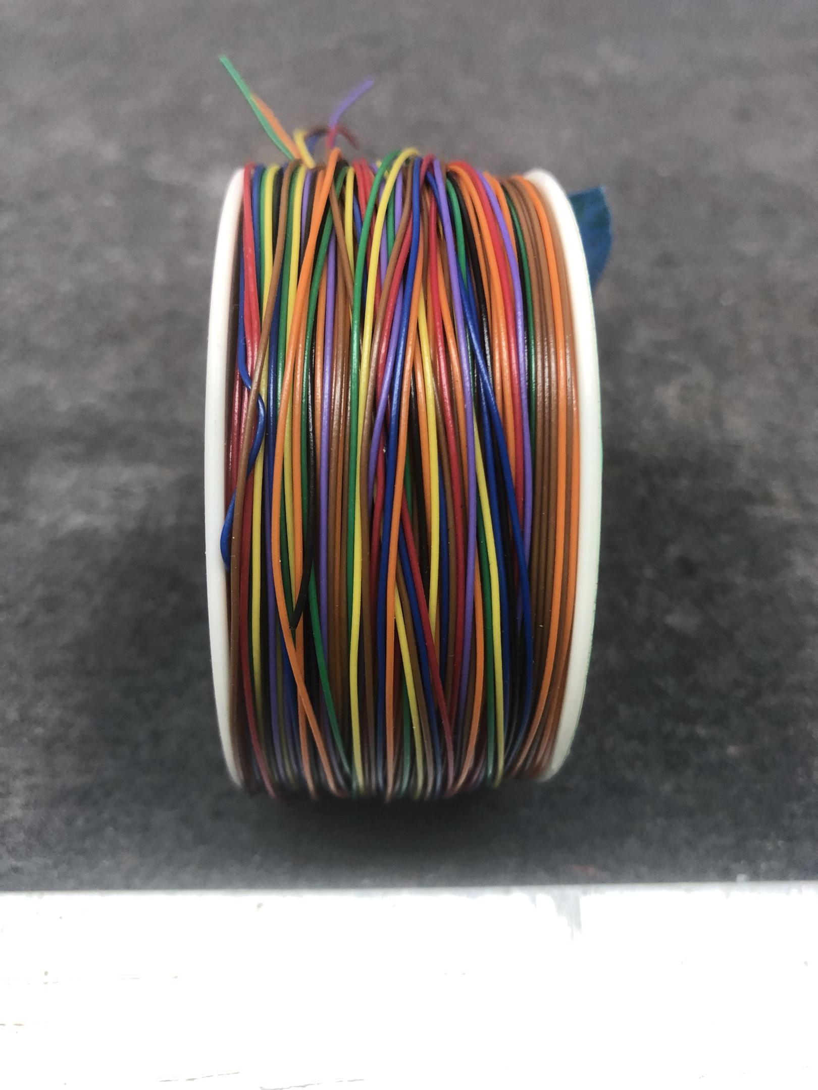

FoMoCo66 Posted May 24, 2024 Posted May 24, 2024 I use 30 awg off of Amazon. You get rolls of 5 colors for $13 Here's a link 1

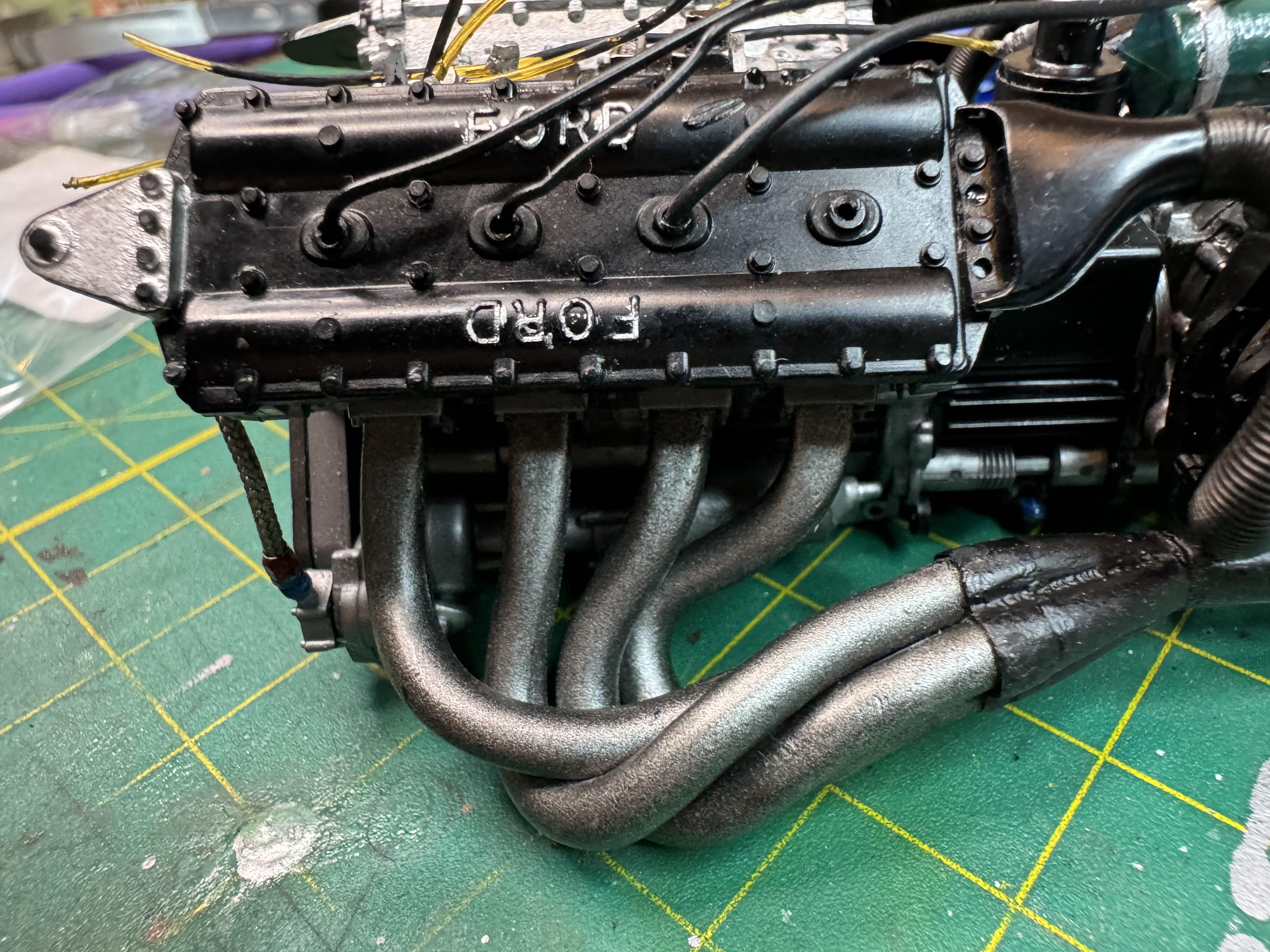

Bainford Posted May 24, 2024 Posted May 24, 2024 13 hours ago, 4knflyin said: This is excellent info... thanks. I did a google search and this is where I landed (no surprise there). I was searching on the right size for "1:12 scale race cars." I'm about to install the plug wires on the Lotus JPS. The kit came with 0.8 mm wire 45 years ago, and I think that's still pretty typical. It always looked clunky to me, so when Tamiya started offering 0.65, I bought some. I'm afraid I'm Baby Bear on this one, the 0.8 looks to big, and the 0.65 to small. Now that I know racing wires are in excess of a centimeter, I satisfied that 0.8 will suffice, even it by your writeup it's a bit small! Here's a pic I took to see it it would help. The other wire is 1.0. One thing for sure is that the 1 mm wire looks like real plug wire in that it's got a rubbery, matt appearance. The others are too glossy. Additional important question: best way to remove the paint on the Ford logo? I believe it's Humbrol silver enamel from 45 years ago. I have a hard time getting it off without leaving a trace. Ideas? (I painted it with a brush in an "I don't care" mood when I was very frustrated... bad idea. My reference to race engines was generally for modern NASCAR, drag racing, etc, where wires can measure 10 mm or larger (in the case of Top Fuel cars, much larger). I don't know what size wires F1 cars were using in the 70s, but I would think wires on engines such as the DFV would be about 8 mm (someone please correct this if they know otherwise). If so, the proper scale wire size for a 1/12 engine would be 0.67 mm (plenty close to 0.65 mm). If the size was indeed 10 mm, the scale size would be 0.83 mm. The proper scale sizes may look small. Many builders seem to find a slightly larger wire looks better. Nothing wrong with that, though personally I find 'in scale' always looks best. The 1 mm in your photo clearly looks too large. You bring up an excellent point regarding the surface finish on the wire. The vast majority of small wire sold today has a PVC or Teflon (PTFE) insulation which has a shiny surface and does not look right at all. The colours also often look somewhat translucent, and sometimes have a pearlescent effect to them which just looks wrong. The colours should be solid, with a slightly matt finish. Furthermore, this PVC or Teflon insulation is stiffer then the conventional vinyl insulation, which prevents it from draping in a natural way when installed. Lately, I have been finding it very difficult to find proper size wire (for 1/24 scale) in an acceptable colour and finish, and suitably supple. As for removing the paint from the FORD letters; is the cam cover painted black or just molded black plastic? If just black plastic, you may have some luck with the local application of a stripper (Castrol Super Clean, Easy-Off HD oven cleaner, or Easy Lift Off) with a small brush or cotton swab, though that sounds like a recipe for a mess. Silver is also one of the more difficult paints to remove. You might get better results painting over it with black. You can then re-do the letters in silver if you wish. Others may have better advice.

bobss396 Posted May 25, 2024 Posted May 25, 2024 22 hours ago, FoMoCo66 said: I use 30 awg off of Amazon. You get rolls of 5 colors for $13 Here's a link What does it measure up as?

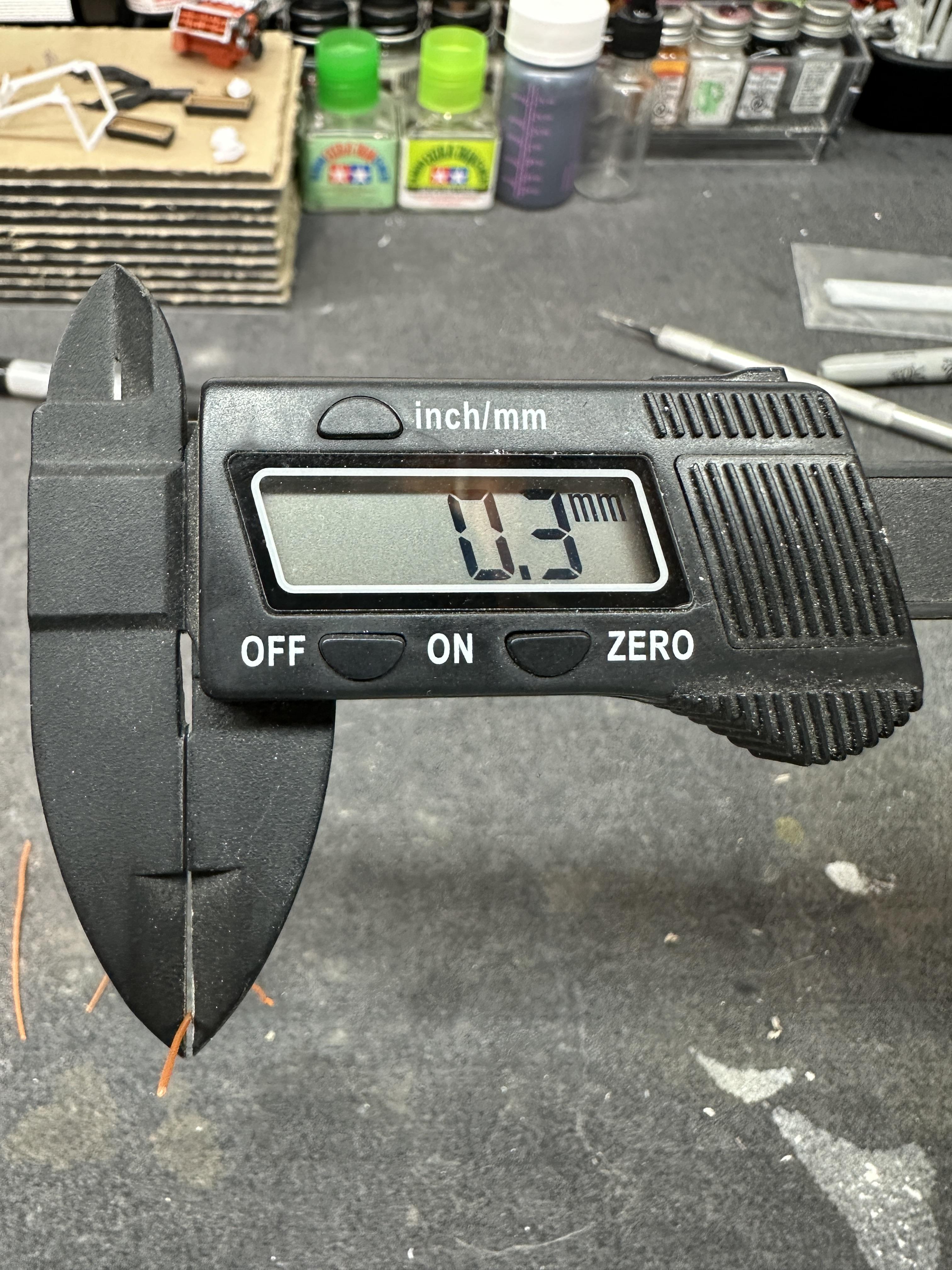

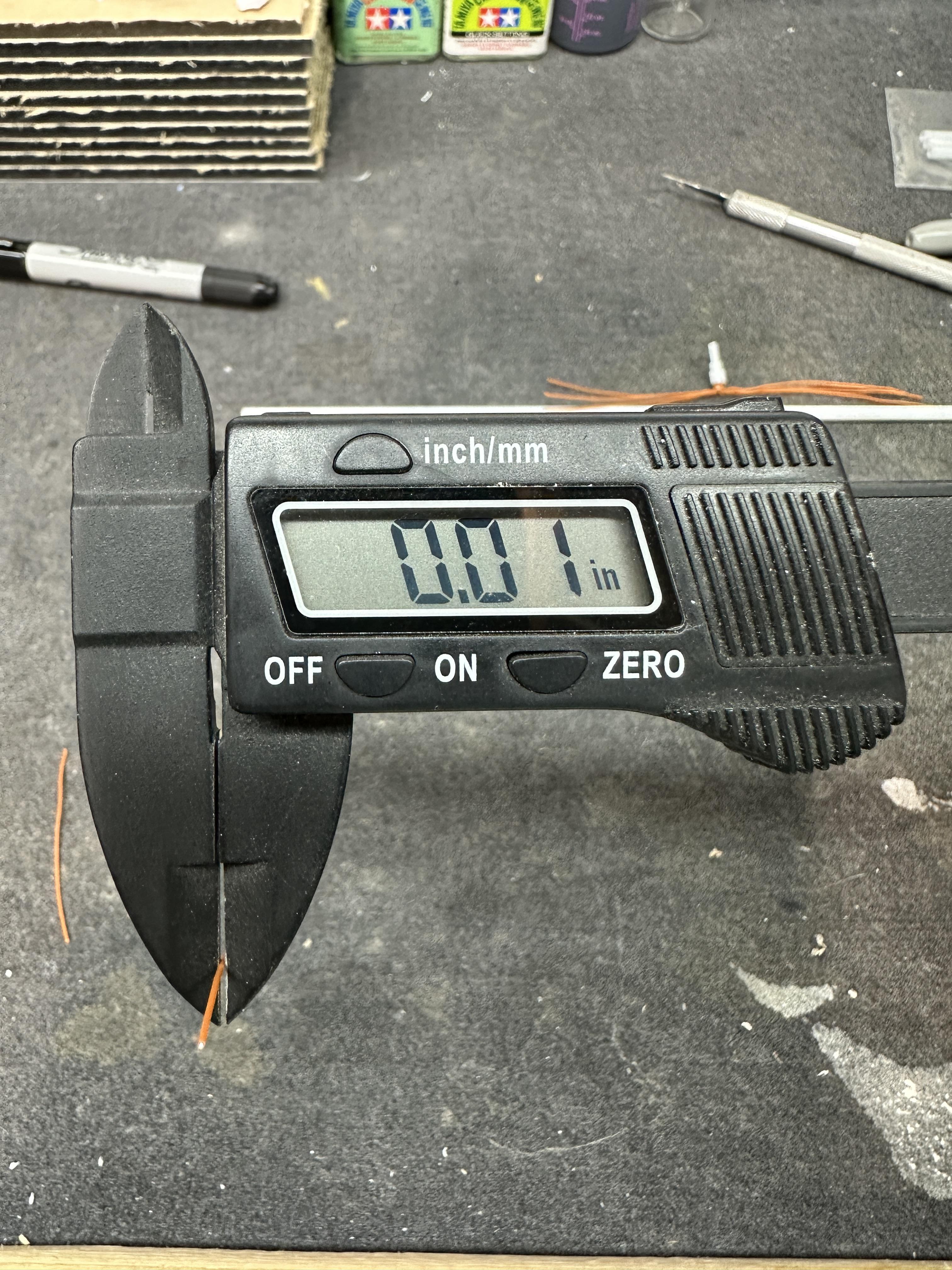

Jiml0001 Posted May 28, 2024 Posted May 28, 2024 (edited) Here is wire on EBay I use for standard plug wire. It has an outside diameter of .28 mm which is almost exactly a quarter inch in 1/24 scale...Five dollars for 10 meters and many different colors available ALMOST GONE 10 meter 7/0.05 ultra slim Dia. 0.28mm 0.011" super thin cable Wire orange/amber New $4.99 + $2.49 shipping 59 sold ALMOST GONE 10 meters 7/0.05 ultra slim Dia. 0.28mm 0.011" thin cable Wires Yellow New $4.99 + $2.49 shipping 117 sold ALMOST GONE 10 meter 7/0.05 ultra slim Dia. 0.28mm 0.011" super thin cable Wire Black New $4.99 + $2.49 shipping 428 sold Edited May 28, 2024 by Jiml0001
