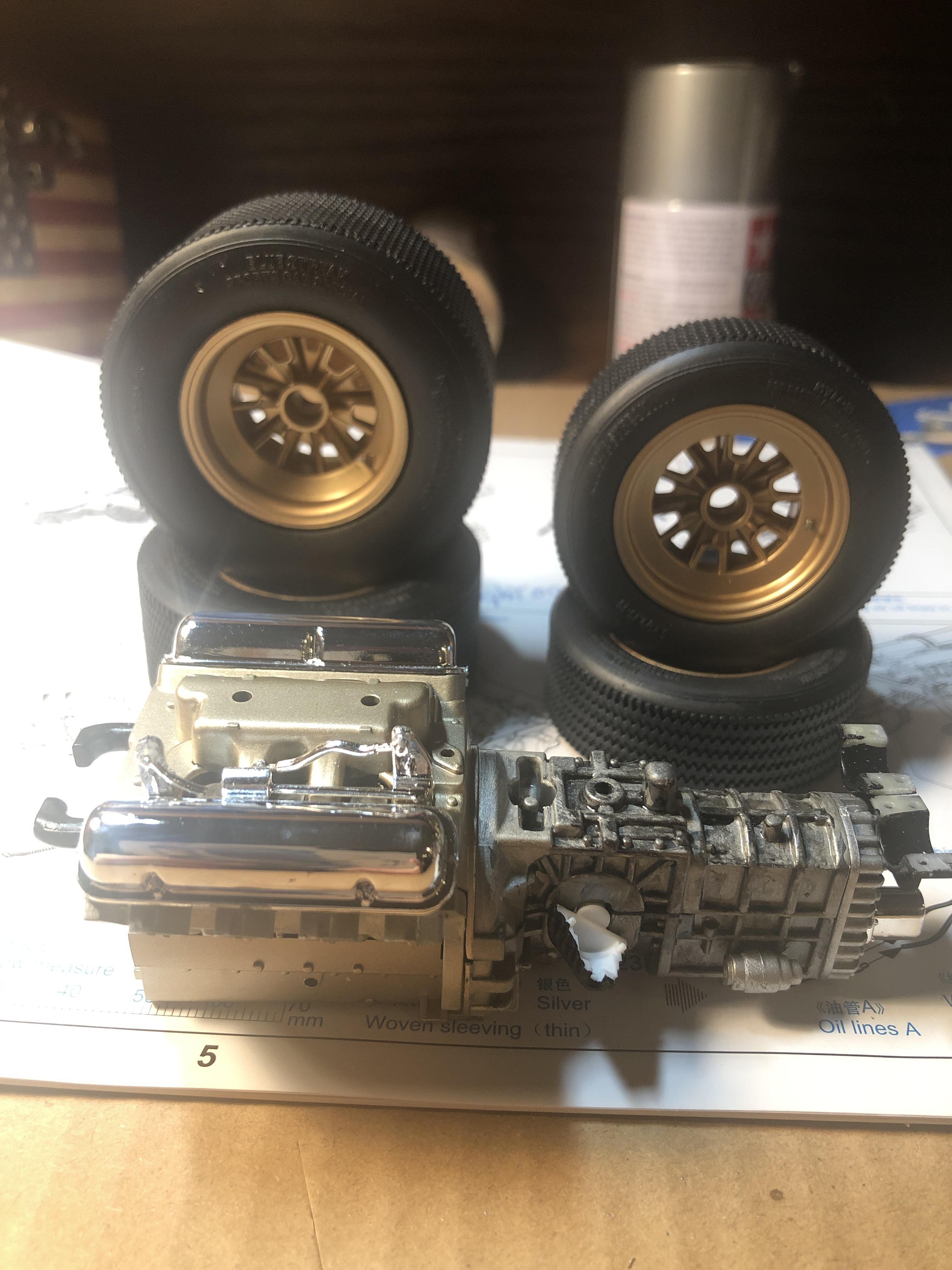

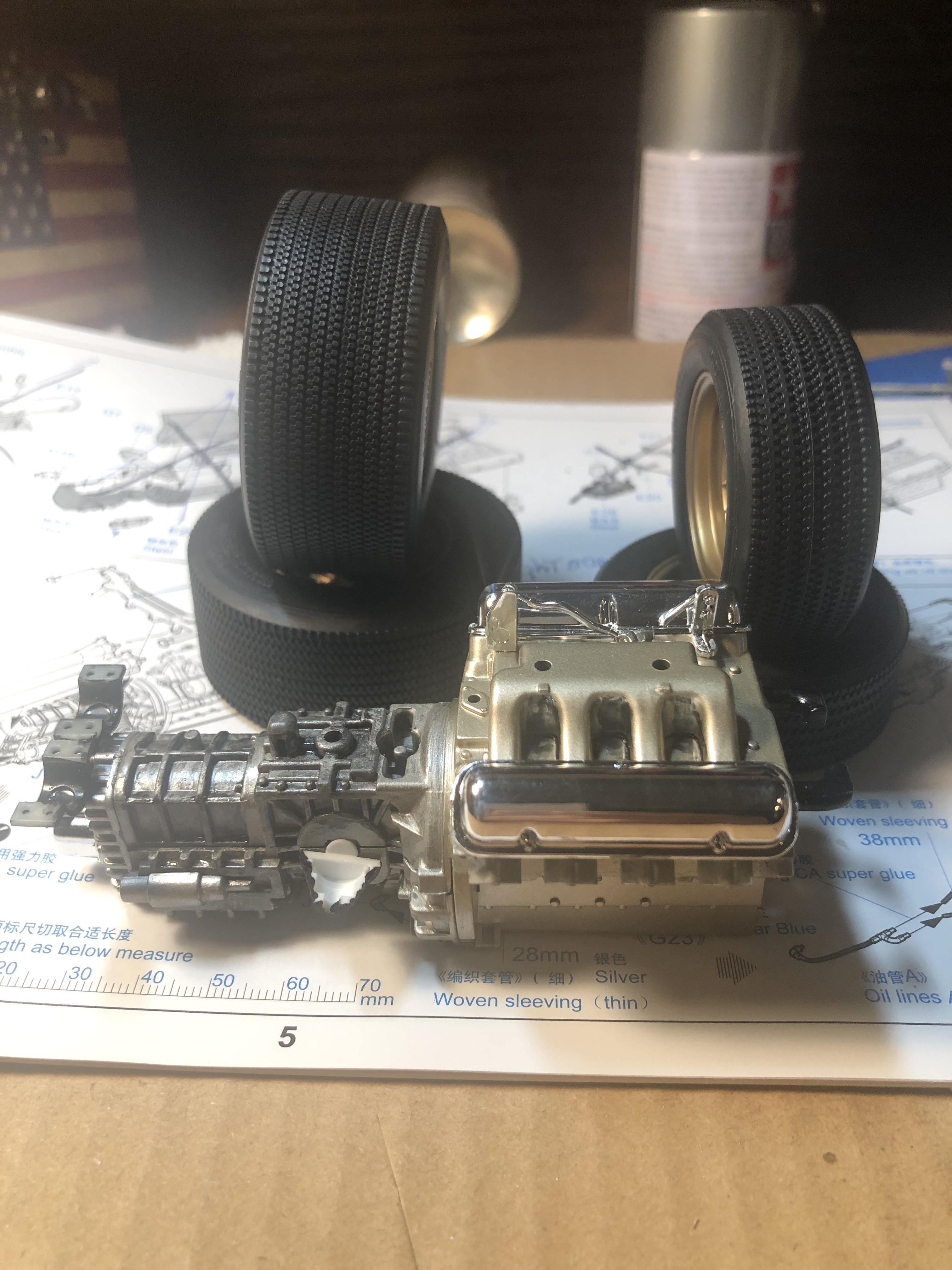

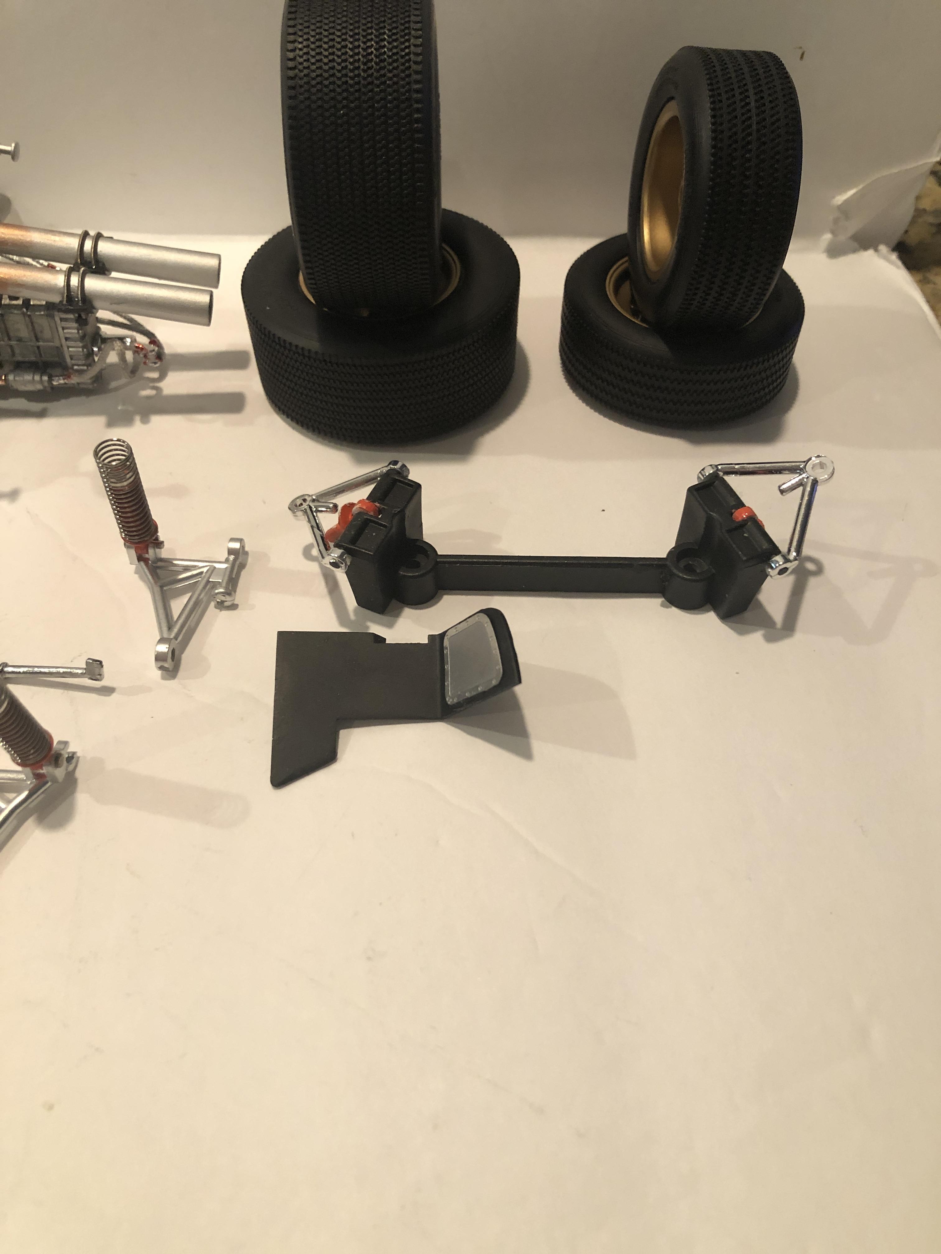

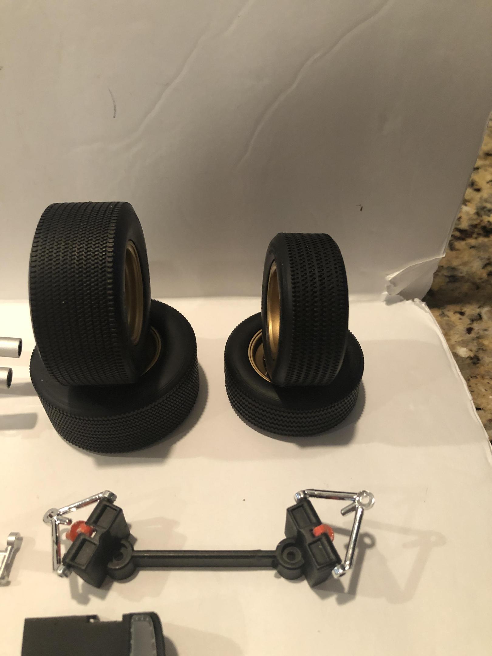

cobraman Posted August 8, 2022 Author Posted August 8, 2022 Got a little done today . Tires and wheels done . Left the wheels as they come in the kit . Trying to follow the color call outs in the instructions but don’t believe they are correct . It says the exhaust is to be blazing . Was not sure what that was so after some research I found it was a shade of Orange . That can’t be right . Photos I have and have seen show them to be a dull silver or a polished aluminum shade and even a copper color . Flip a coin ??
Force Posted August 8, 2022 Posted August 8, 2022 (edited) I believe the wheels had a treatment with a product called DOW7 often used on magnesium wheels and other parts made of magnesium to prevent them from oxidation, this treatment gave the magnesium parts a goldish look. If you polish magnesium it gets a shine much like polished aluminum and all did not use the DOW7 treatment and polished the wheels instead...but magnesium oxidize easy and fast so if you want shiny magnesium wheels you have to polish them often, and if you don't it gets a dull grey look from the oxidation. Edited August 8, 2022 by Force

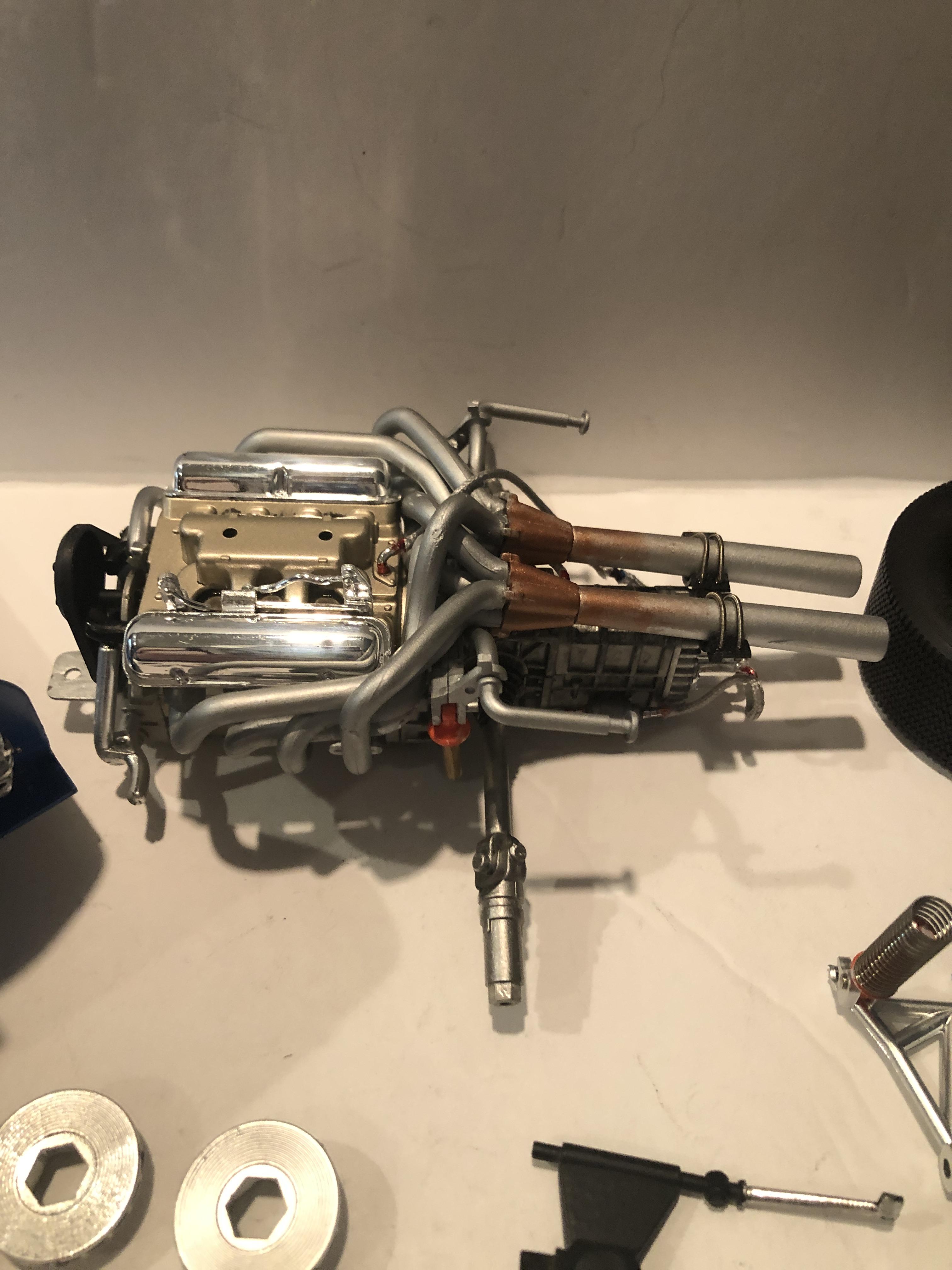

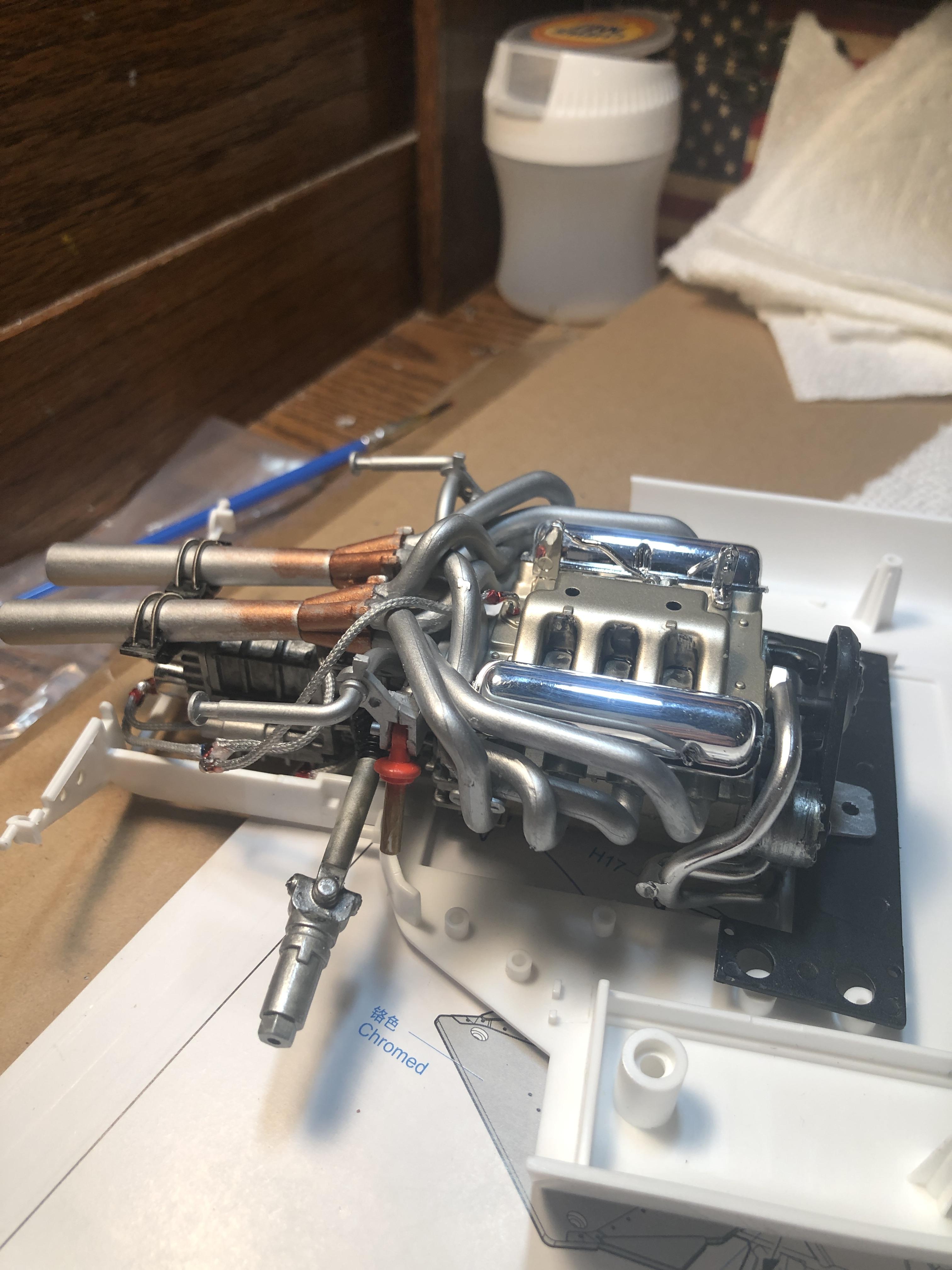

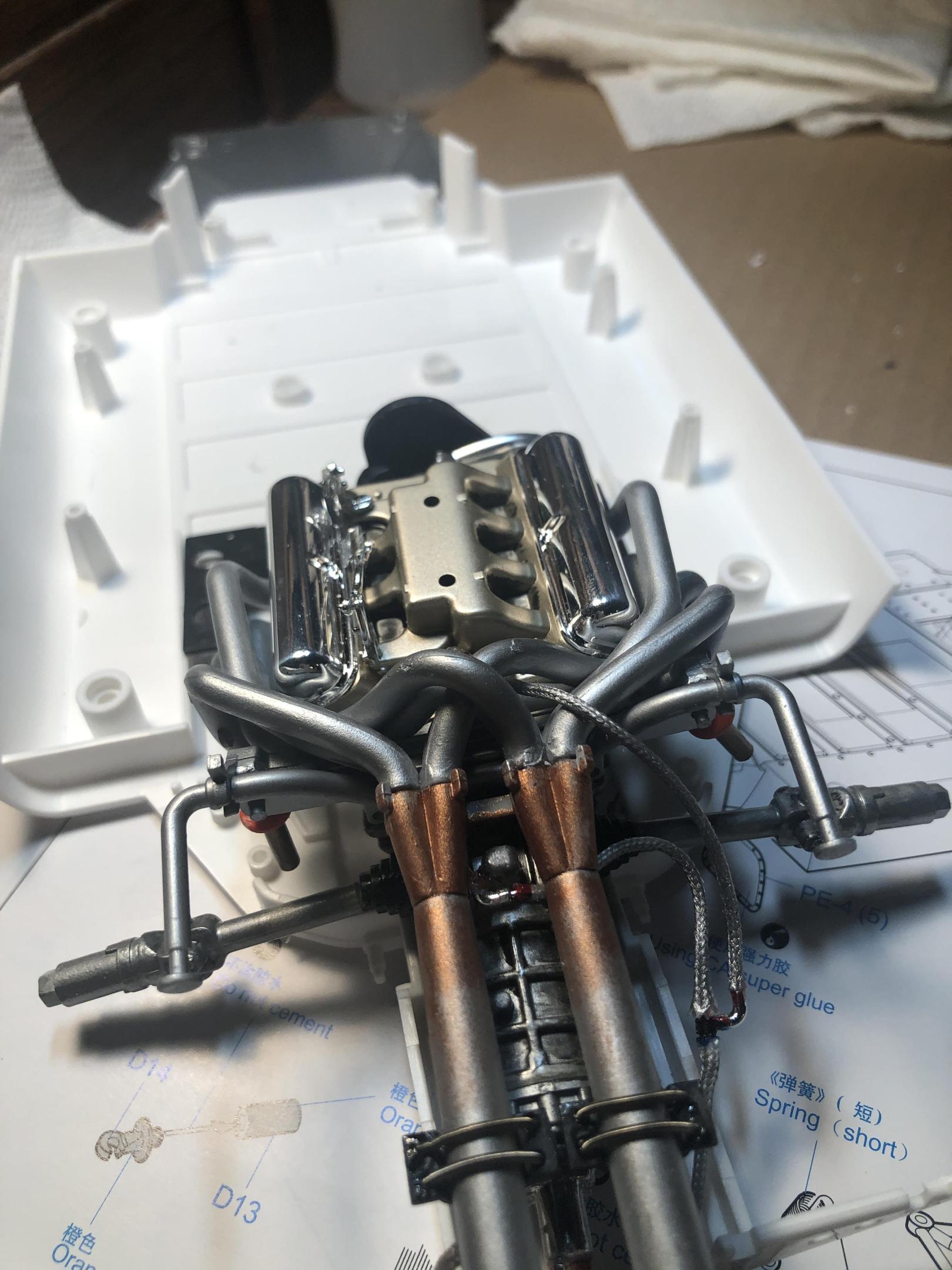

cobraman Posted August 14, 2022 Author Posted August 14, 2022 Made a little more progress on this kit . As I said before I know I will not get all the colors right but will try to be mostly close . I thought the exhaust snake pit would be a problem but it was actually pretty simple . They put a bit of detail in this kit like the real small springs over the exhaust tips but why no distributer ? Seems odd to me . The hoses may need more attention and rerouting , it was not clear to me on the instructions so I am sure I have at least some wrong . I will be happy if I can end up with a decent looking shelf model . 1

Force Posted August 21, 2022 Posted August 21, 2022 (edited) On 8/14/2022 at 8:52 PM, cobraman said: Made a little more progress on this kit . As I said before I know I will not get all the colors right but will try to be mostly close . I thought the exhaust snake pit would be a problem but it was actually pretty simple . They put a bit of detail in this kit like the real small springs over the exhaust tips but why no distributer ? Seems odd to me . The hoses may need more attention and rerouting , it was not clear to me on the instructions so I am sure I have at least some wrong . I will be happy if I can end up with a decent looking shelf model . I see you have followed the instructions but I don't think they have it right (I looked at both the Trumpeter and Magnifier instructions). Why would one route a line from the oil pump at the back cover on the transaxle to the back end of the gear selector housing wich is the hump on the right side of the gearbox, there is a shaft coming out from there when shifting gears, and why would one route an oil line from the rear of the intake manifold to the gearbox, that place on the intake manifold is used for crank case ventilation on older FE engines and it's nothing under there except for the lifter gallery...naah that can't be right. I would imagine that a couple of the lines from the Kar Kraft T-44 transaxle would go to an oil cooler, the GT40 has one on each side, and the one on the left side is for the engine so the one on the right side must be for the transaxle. I do have some knowledge of the Ford FE engines as I just built one for my 1963½ Galaxie. Here is how the dry sump oil system on a Mk II GT40 works. Edited August 21, 2022 by Force
cobraman Posted August 21, 2022 Author Posted August 21, 2022 Thanks. I think I mentioned that I didn't think it was right but did not know enough to know what was wrong. Yes, I did just follow the instructions and I want to correct it but am hesitant that in doing that I may just make a mess. Some things are best left alone. Worth considering in this case ?
Ian McLaren Posted August 23, 2022 Posted August 23, 2022 Everything looks very believable and has a correct look. I like what you are doing and if a couple of hoses are not routed correct it does not take away from the model from an esthetics point of view.

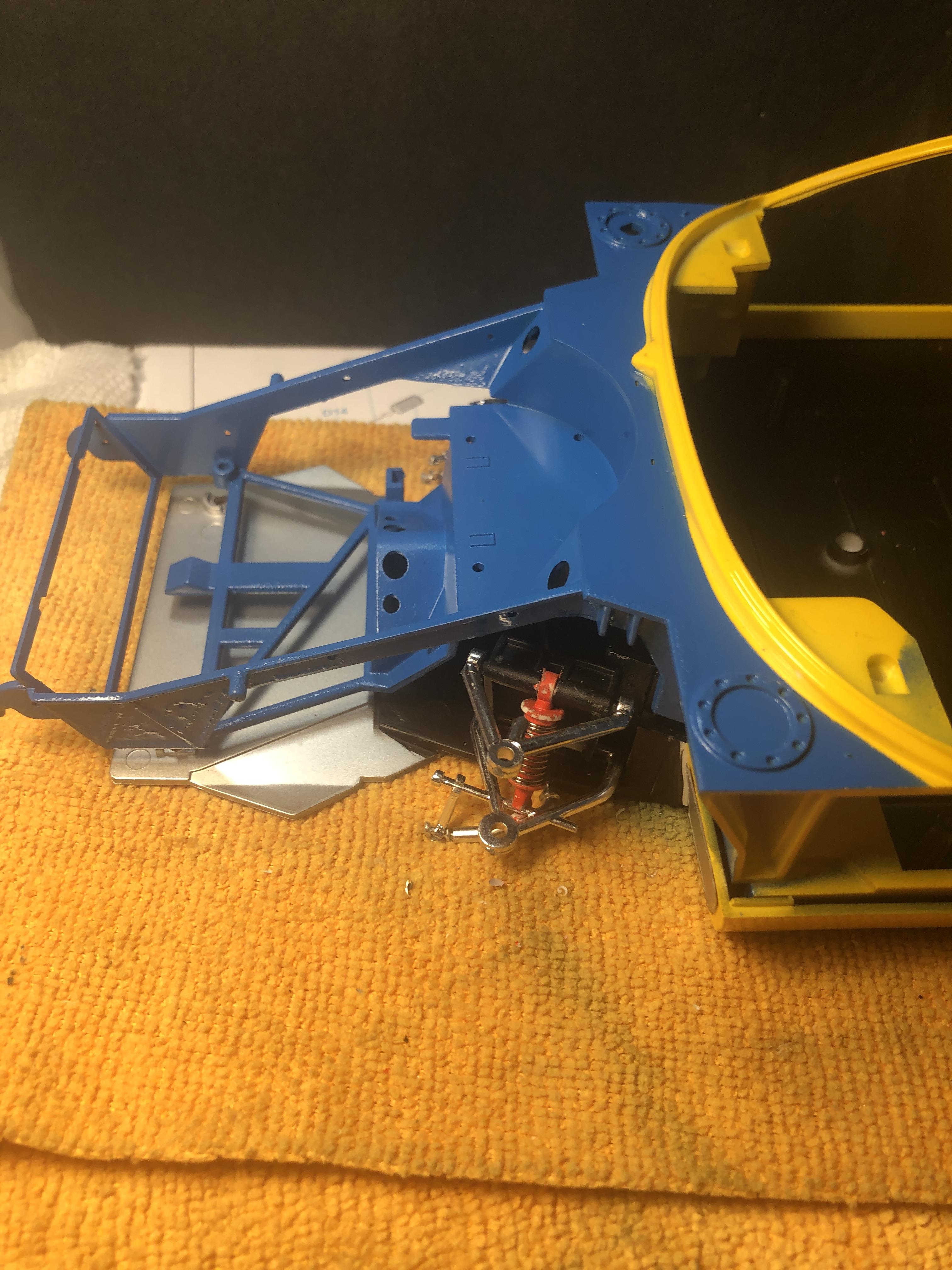

cobraman Posted August 26, 2022 Author Posted August 26, 2022 Thank you Atin ! Got some color on it yesterday.
Force Posted August 27, 2022 Posted August 27, 2022 (edited) On 8/21/2022 at 3:57 PM, cobraman said: Thanks. I think I mentioned that I didn't think it was right but did not know enough to know what was wrong. Yes, I did just follow the instructions and I want to correct it but am hesitant that in doing that I may just make a mess. Some things are best left alone. Worth considering in this case ? Yes I noticed and your hunch was right. I just meant Trumpeter/Magnifier got it wrong...and the Meng kit is unfortunately not that much better as some of their hose and wire routing is questionable too...and Meng even brags that their kit is the most accurate GT40 kit out there...yeah right.? I will follow your progress with interest as I really like the GT40's. Edited August 27, 2022 by Force 1

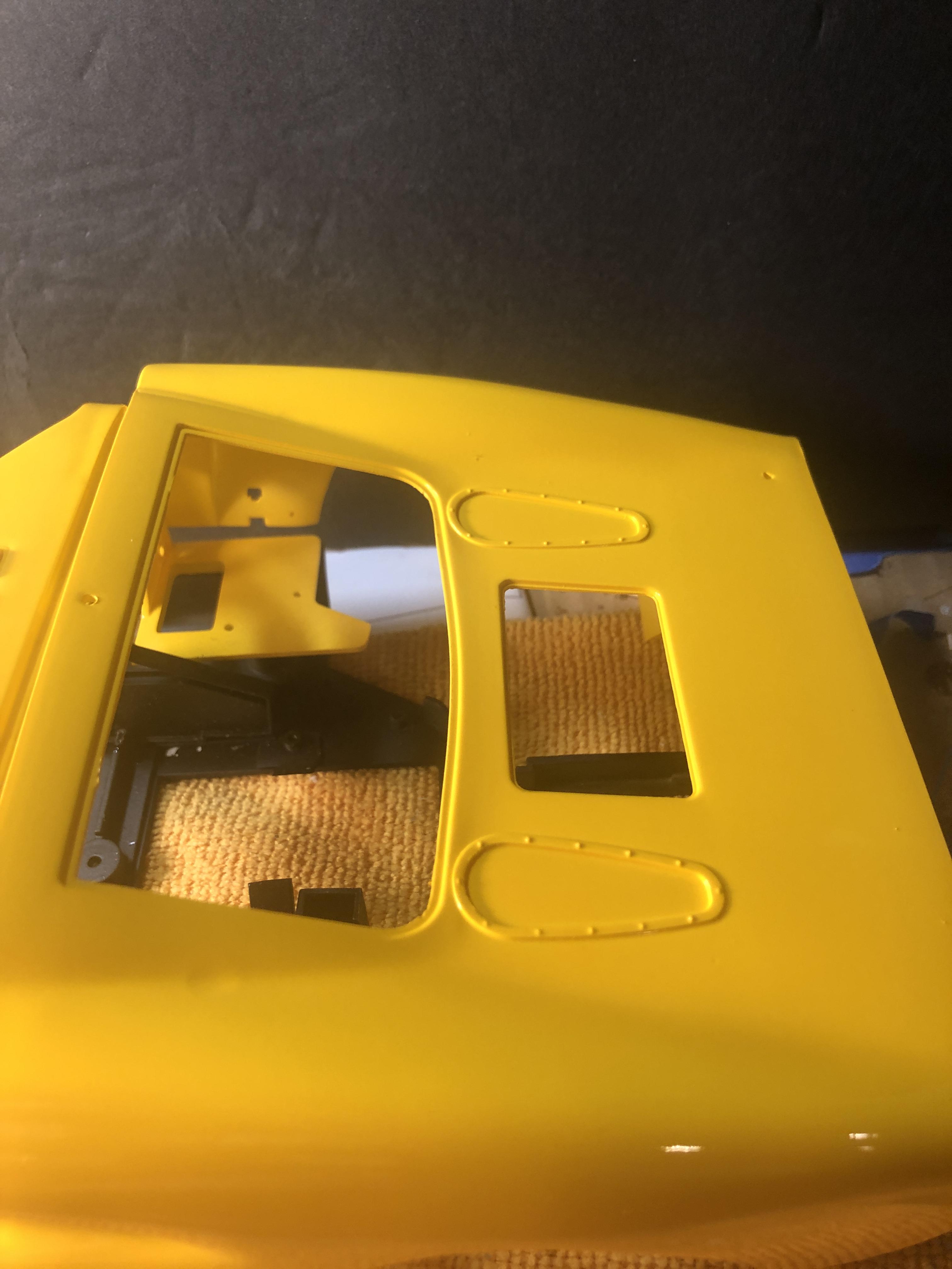

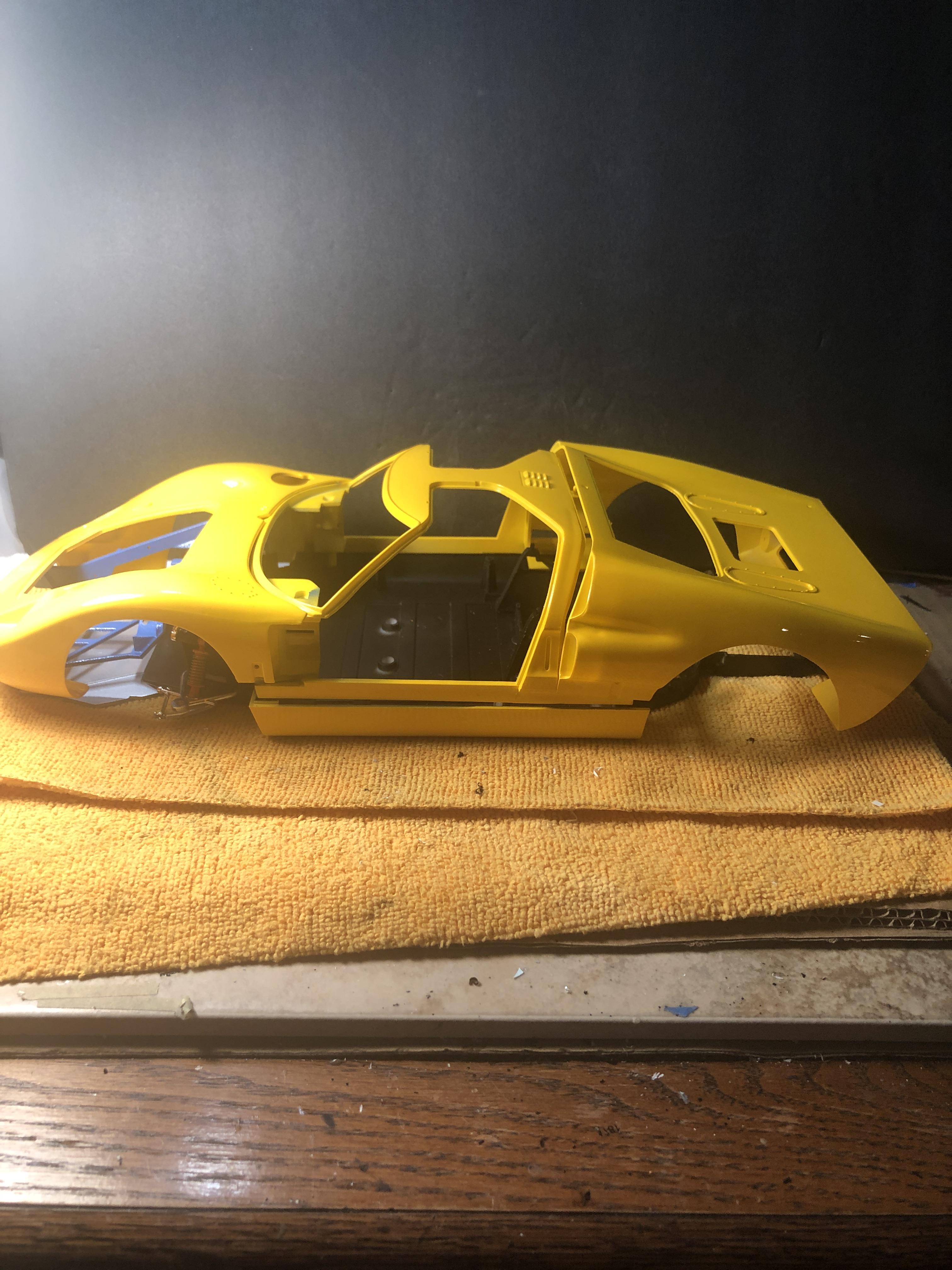

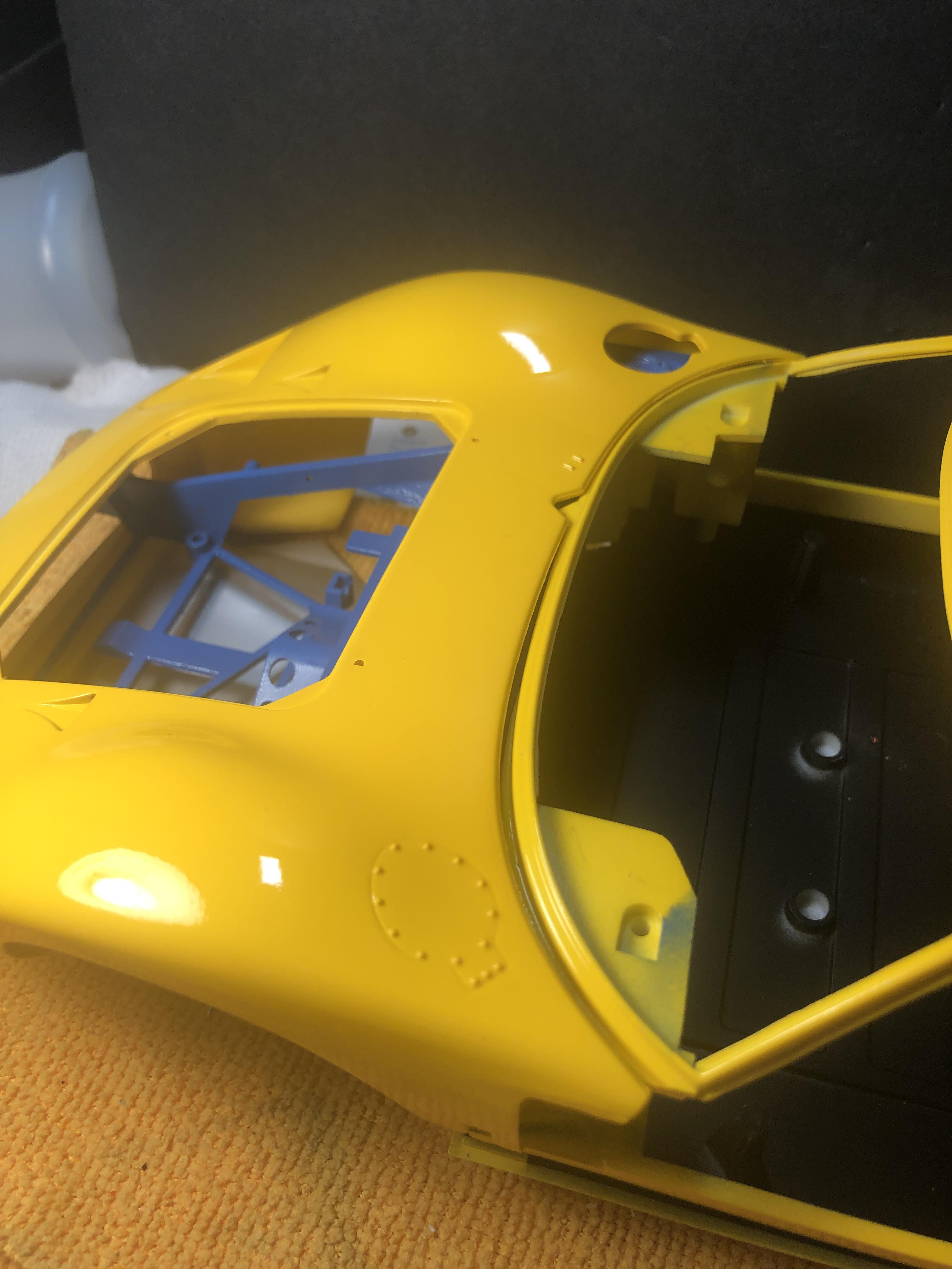

cobraman Posted August 30, 2022 Author Posted August 30, 2022 We have paint ! Tamiya yellow with Duplicolor 1k clear . 2
