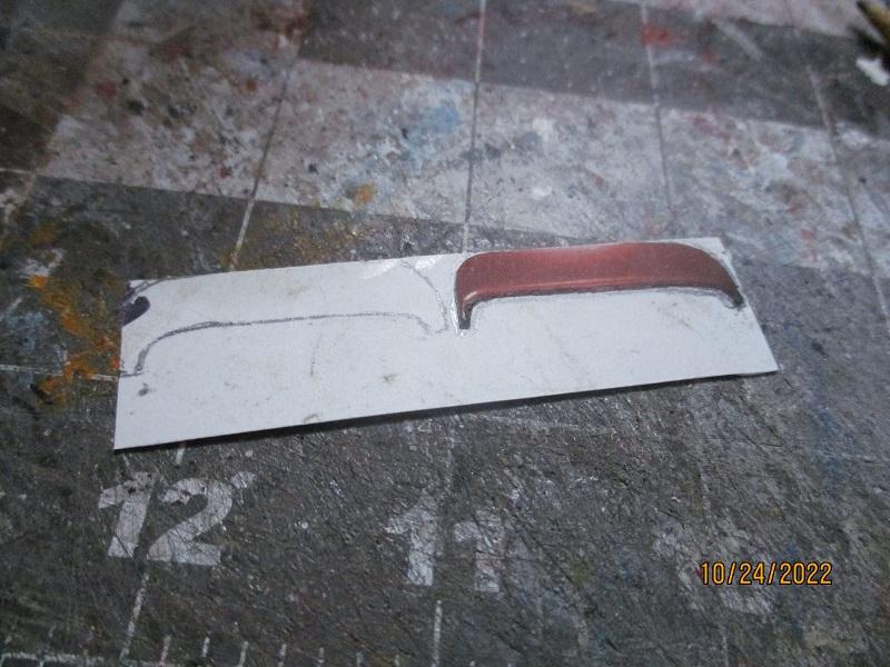

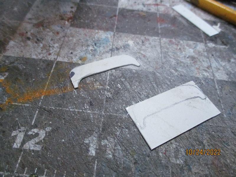

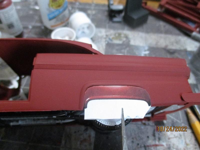

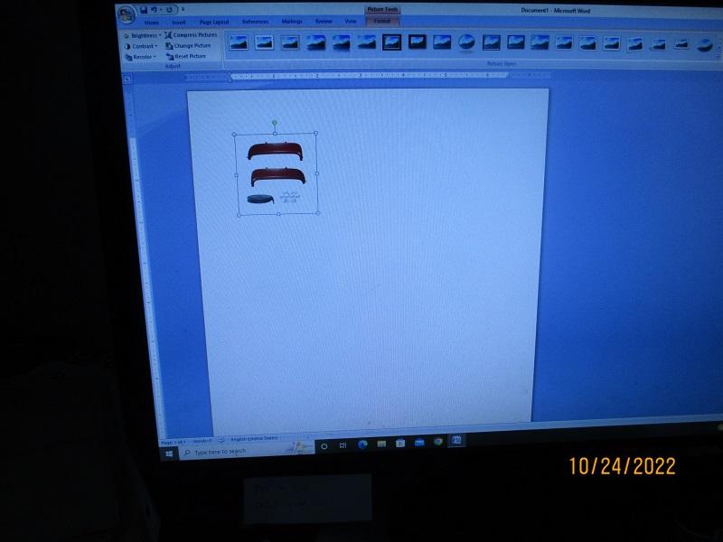

landman Posted October 25, 2022 Author Posted October 25, 2022 Fabbed up fender skirts using the following method. Took a picture from the net, reduced it to size using Microsoft word, printed it and used it as a pattern. Used half round for the bead. 3

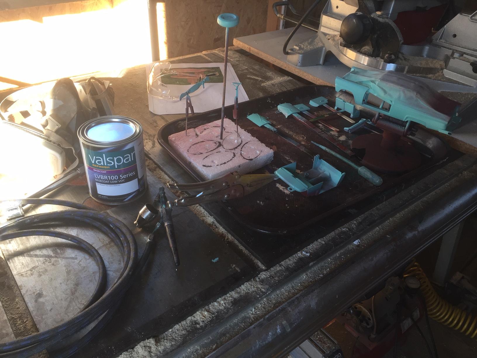

landman Posted November 2, 2022 Author Posted November 2, 2022 Masked the car and shot the green....outside as this is real car paint complete with isocyanates. so shop coat, gloves and respirator. Looks OK to me. 2

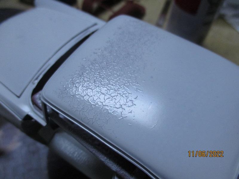

landman Posted November 7, 2022 Author Posted November 7, 2022 No comment. They might get me barred, chastised and ejected. 2
Kah puts Posted November 7, 2022 Posted November 7, 2022 Under the circumstances I think they'll forgive you. 1
Bobjernigan3 Posted November 7, 2022 Posted November 7, 2022 That is usually caused by something under the paint that doesn't mix... it's eating it... seal it with sealer before painting... not primer.. 1
Big John Posted November 8, 2022 Posted November 8, 2022 You mean they through you out for Bad Paint!? Man, I hate it when it does that. 1

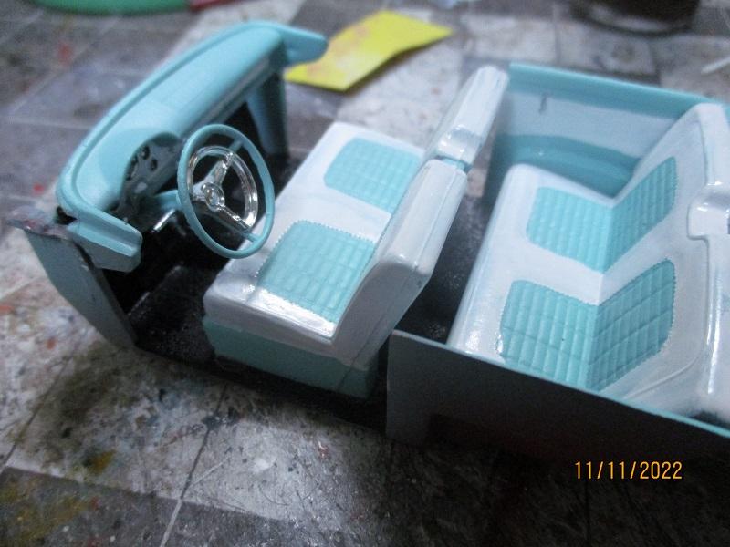

landman Posted November 12, 2022 Author Posted November 12, 2022 The interior is different from the 1:1 I am trying to replicate. Maybe the kit is a compromise between different models of Ford. 1
