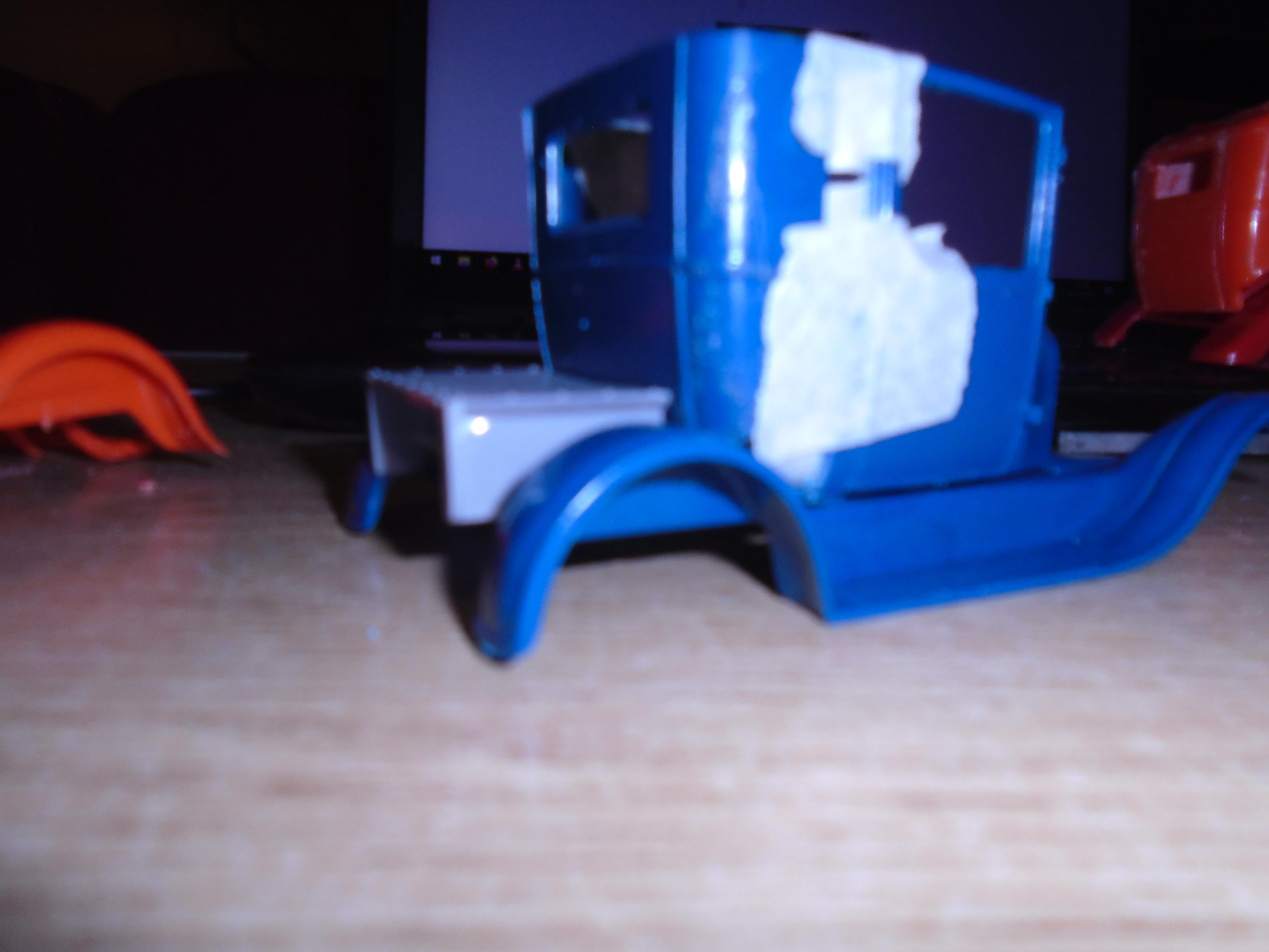

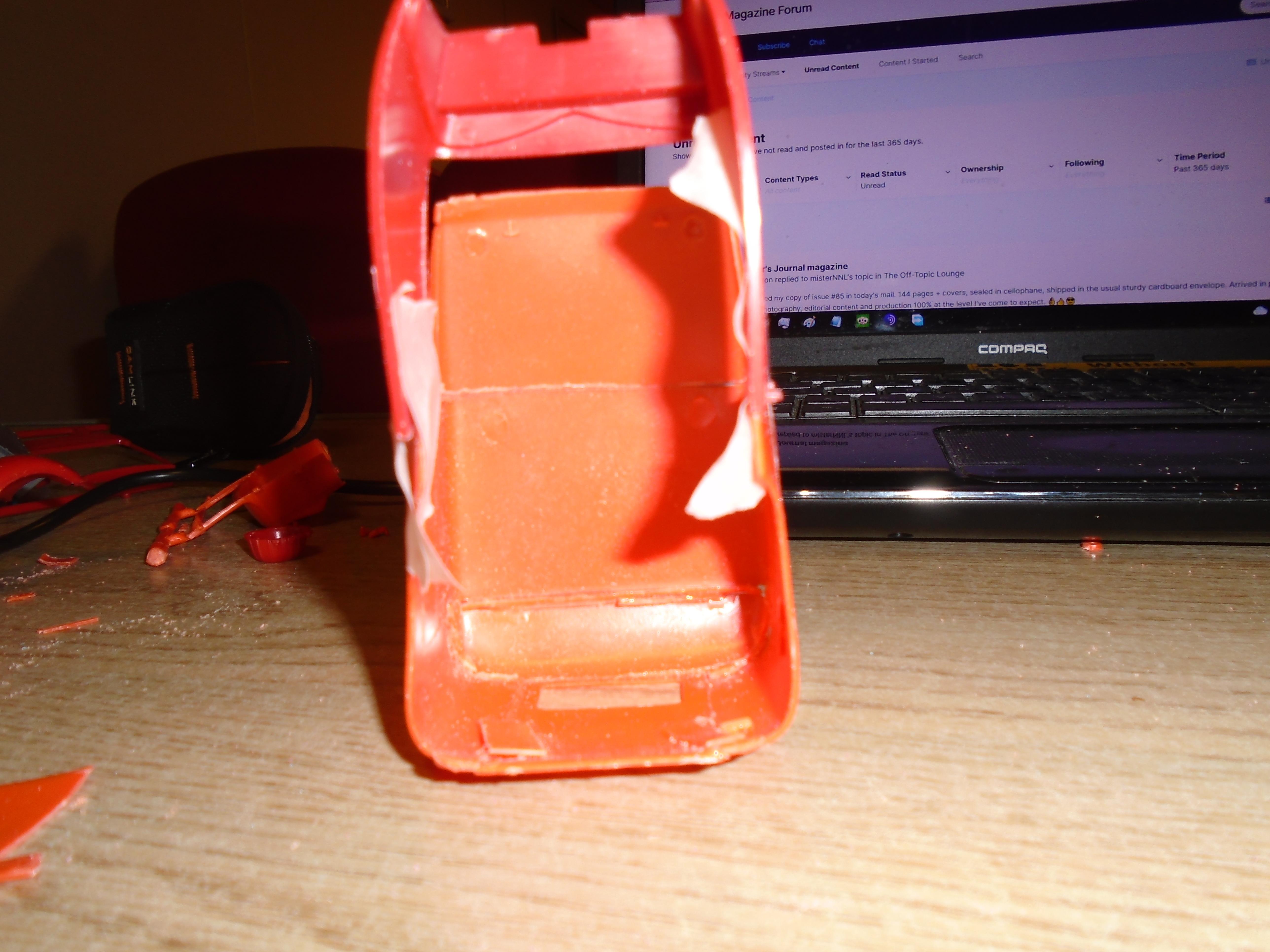

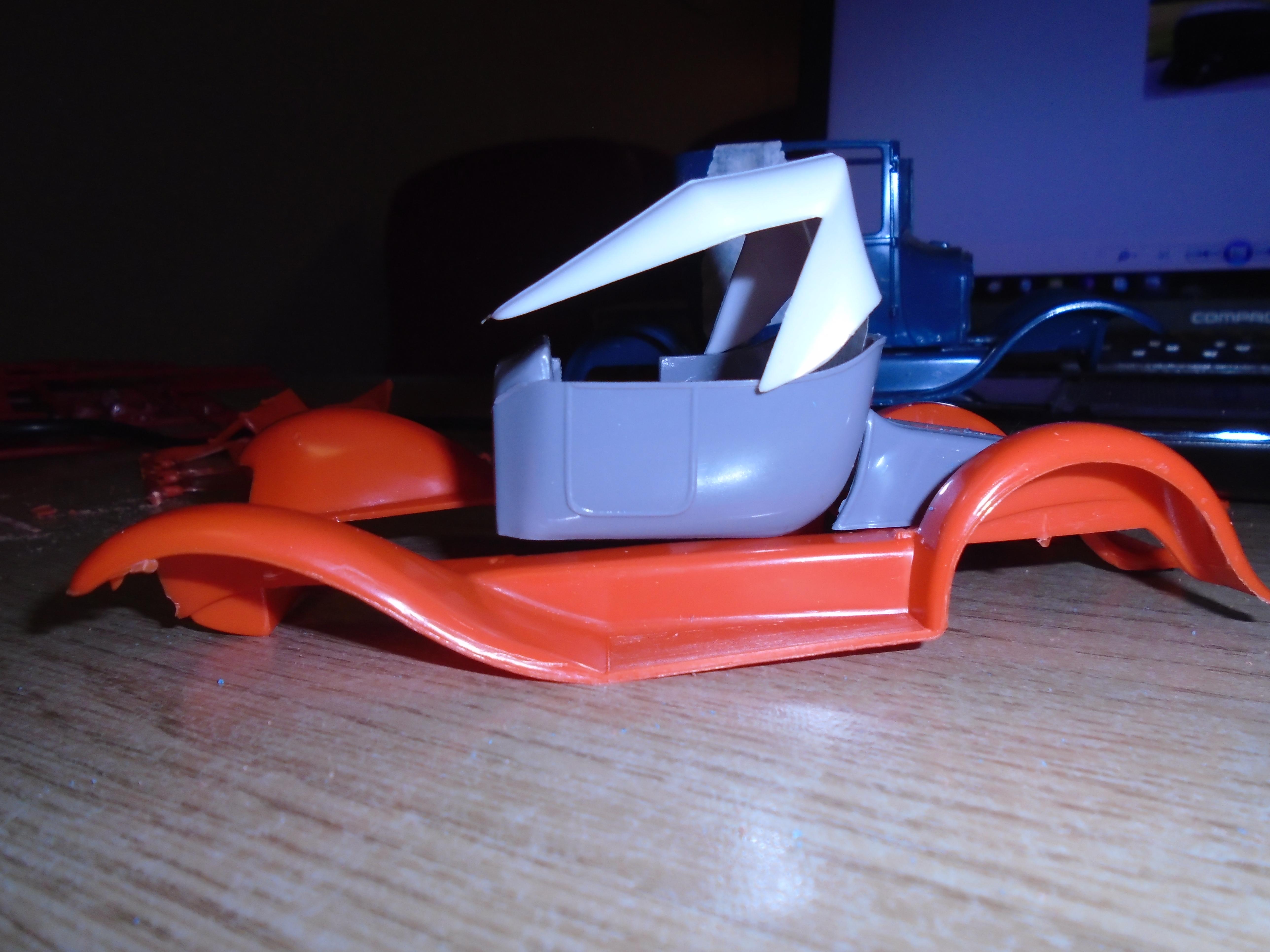

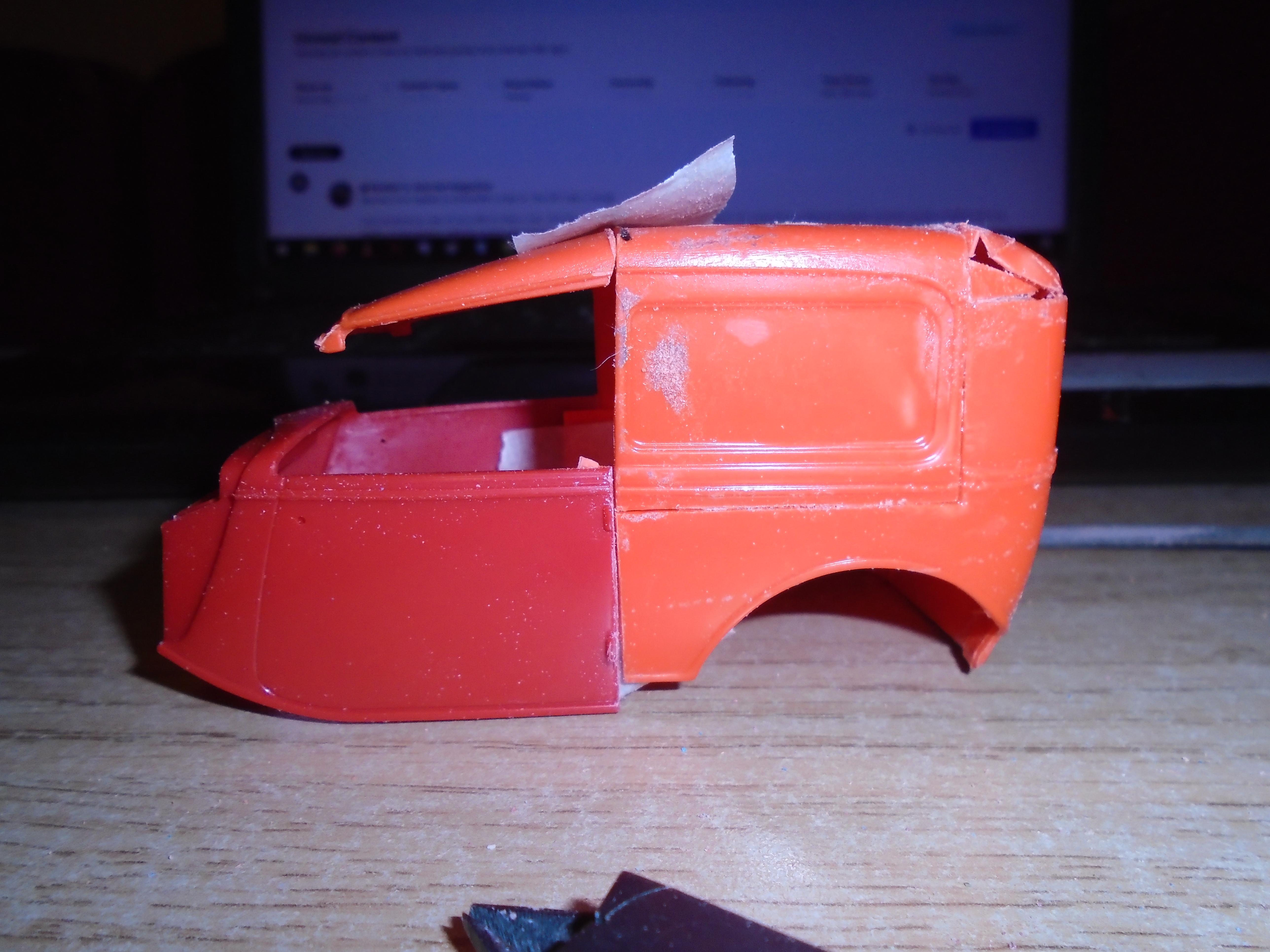

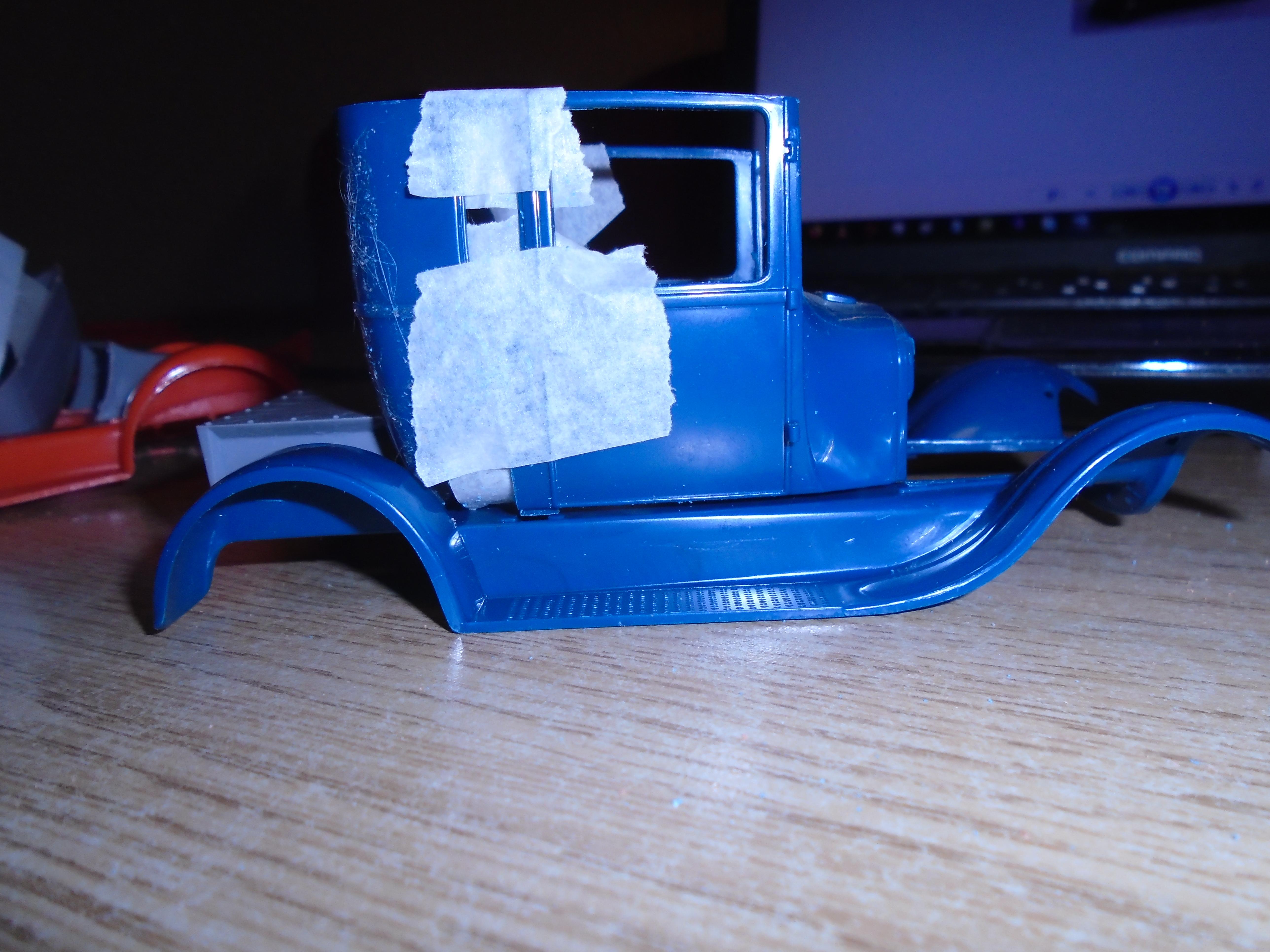

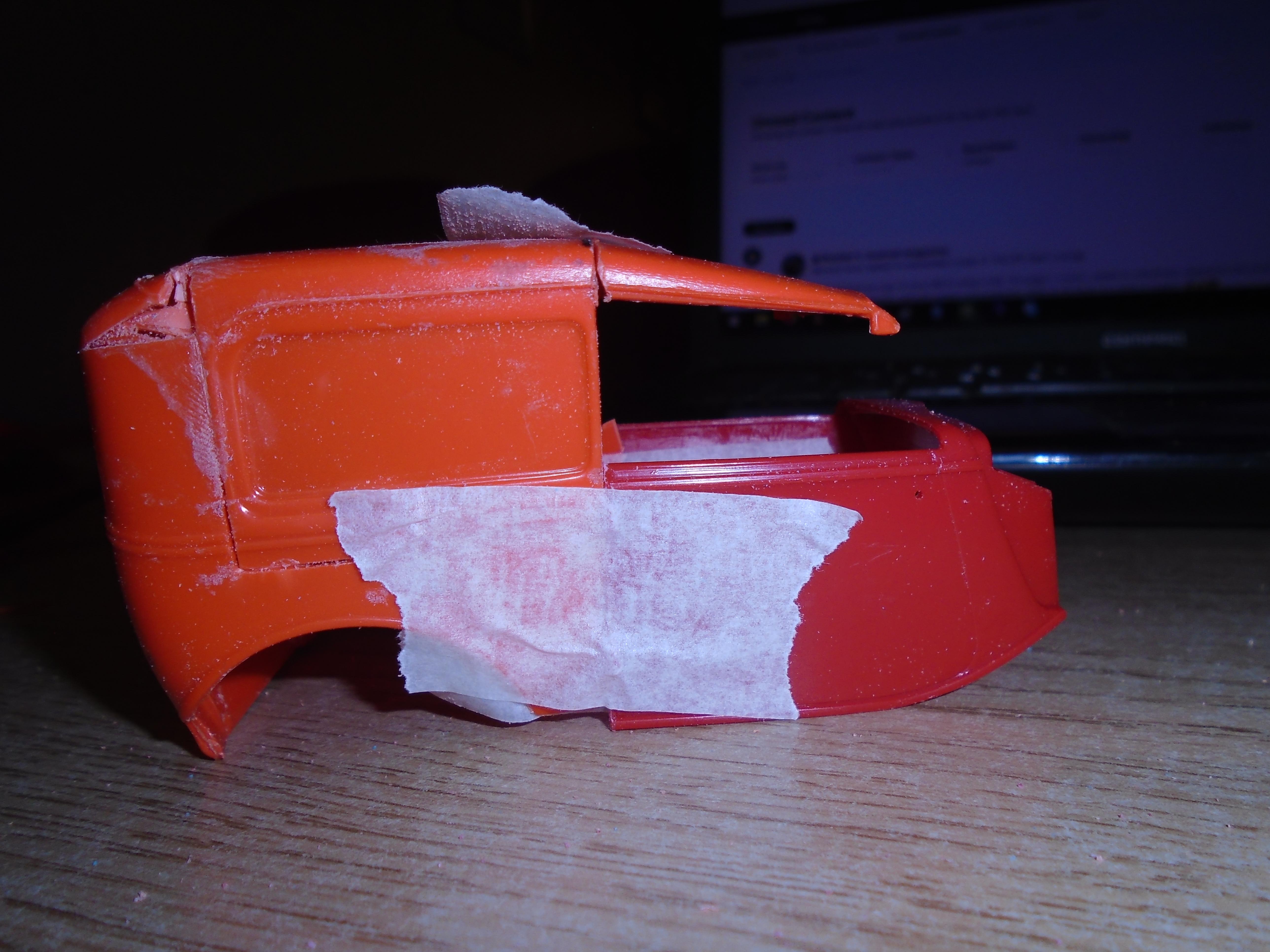

Got the body to a very rough shape so far tonight. I think this is going to work. I might use a roof line inspired by the baby austins instead of the model y roofline. I glued the rear door onto the body before i cut and my first cuts were to move the side window area back on the delivery body. I then cur the top corner from the body and fitted it back at a different angle as the y has much softer curvers here than the a but i think i can leave the sides. I'm going to have to add plenty bracing to the inside of the body to get the side to line up but the plastic is thinso some strips inside should do it. I'll have to reshape the rear window and redo all the trim and i have to make some doortops for the windows. It looks a bit too long just now but I'm sure once the dorrtops are made and fitted it will look better.DSC07809.thumb.JPG.3935d42928f5838a4b029c4a64cba664.JPGDSC07810.thumb.JPG.bb8512cb2f76c9b831527af2426dfb44.JPG I also had a bit of a play with the other kits from the set and now have a club cab t pick up and t roadster on a fenders. the fenders are pretty warped on the roadster but i hope to make them workDSC07806.thumb.JPG.78e20ae65eb83506b25b4348aec08813.JPGDSC07807.thumb.JPG.a51fe7b8d04a2c03176f3f5b94e80ba4.JPG

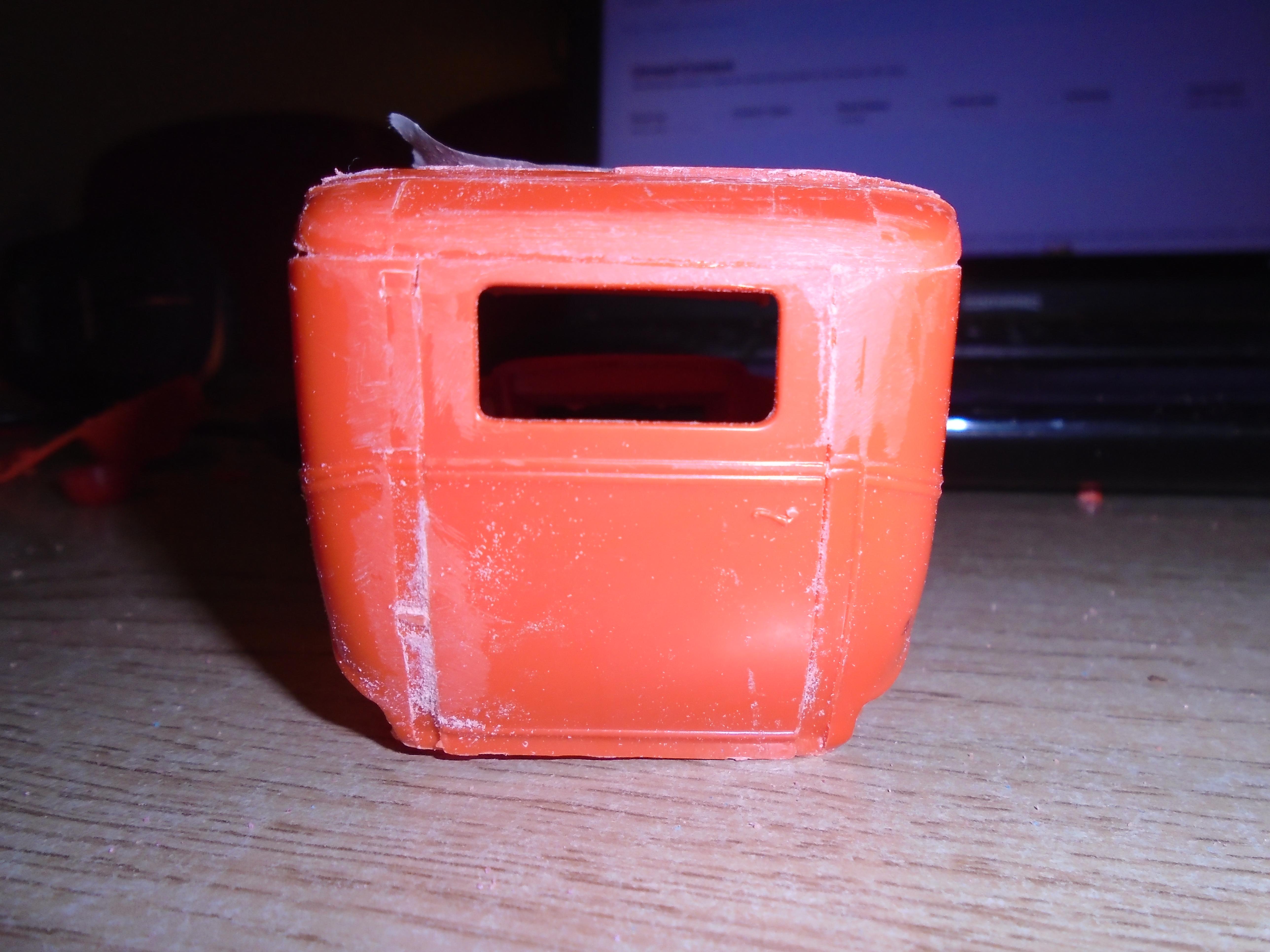

I think I've goofed on my cut lines. The door edge should be much closer to the rear fender, and I think my rear windows are too long. You can see where its out in the pic of a stocker below. I could cut a thin strip out of the rear but that would take the front too far back. Since I have to add some plastic to the rear of the window to reshape it, I'll also add some to the front pillar to move it back. This will save me cutting the roof again and since i have to build front screen pillars I can make them a little thicker to move the door shuts back a little. I think I also have to chop it a little as it seems too tall but I think I'll see how it looks after the windows are shaped and open. This might end up as more of a project than originally planned as I have a nice jag irs and 3d printed rover v8 but they wont fit the fenders. I wont decide yet as the fenders are useful for holding the body in shape

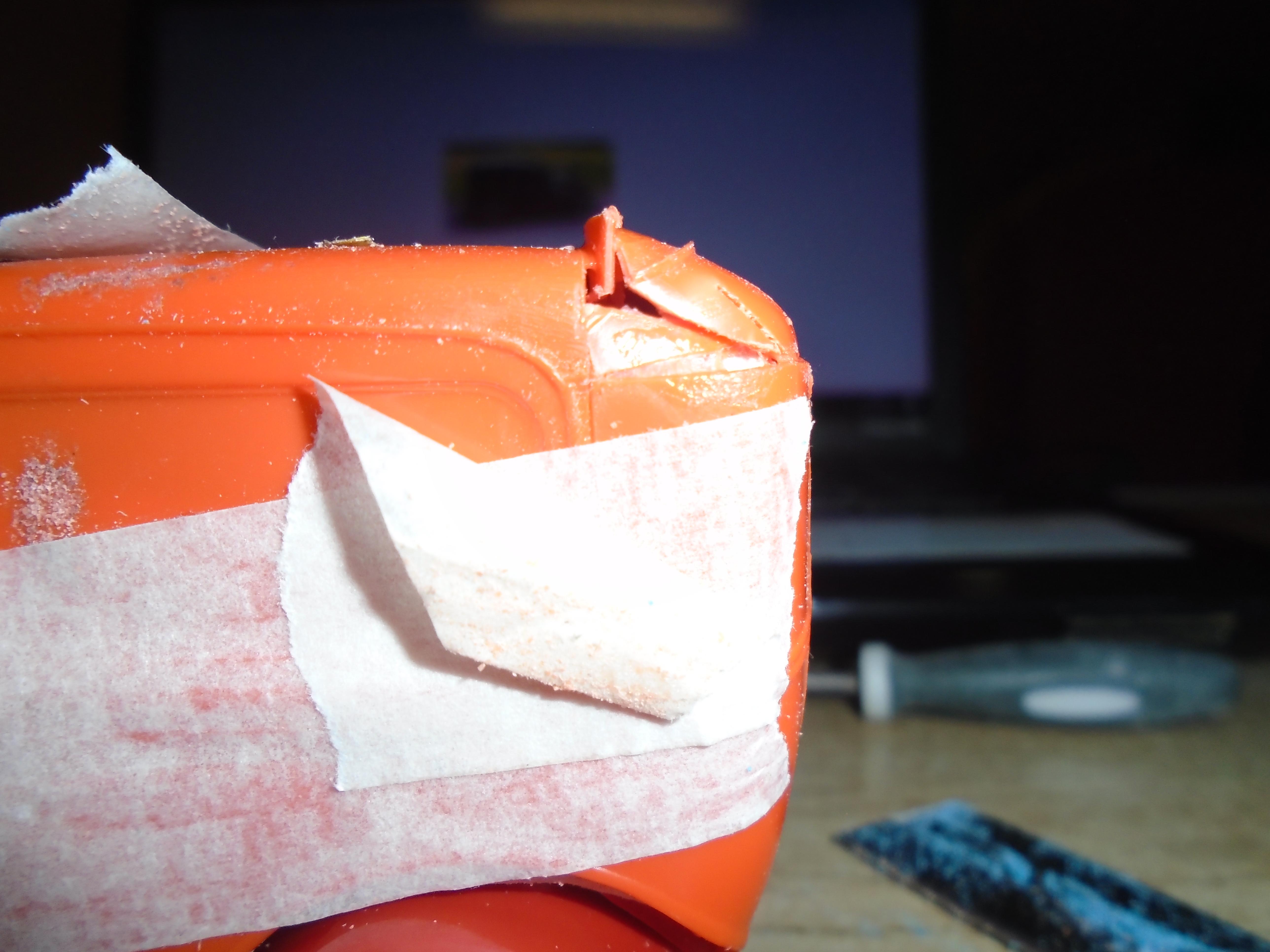

Got the roof line completed tonight. I'm using finger nail acrylic filler to reinforce the joins, and to add some thickness where I'm reshaping the body. The plastic on the kit is about half the thickness of a 1/25 kit so doing this allows me to file it down without worrying about going through the plastic. It sets as hard acrylic so its a little tougher to work with but it is very strong. You notice the body isn't all the way down on the fenders in the pics, this is because I haven't sorted the arches yet as I'll be doing them once the front of the body is connected. I would have it fitted tonight but i ran out of the nail filler and i have nothing to space the body apart with either.

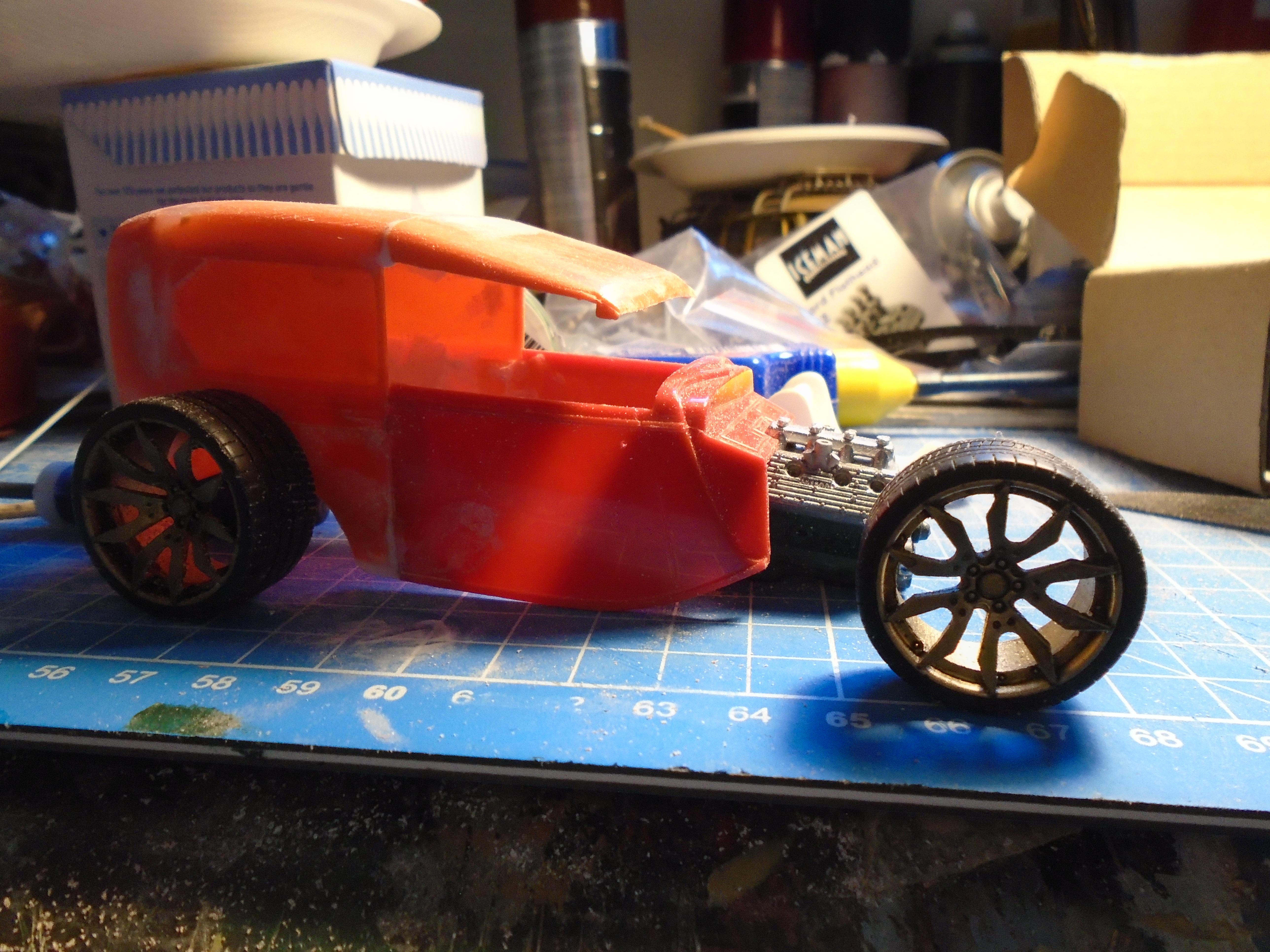

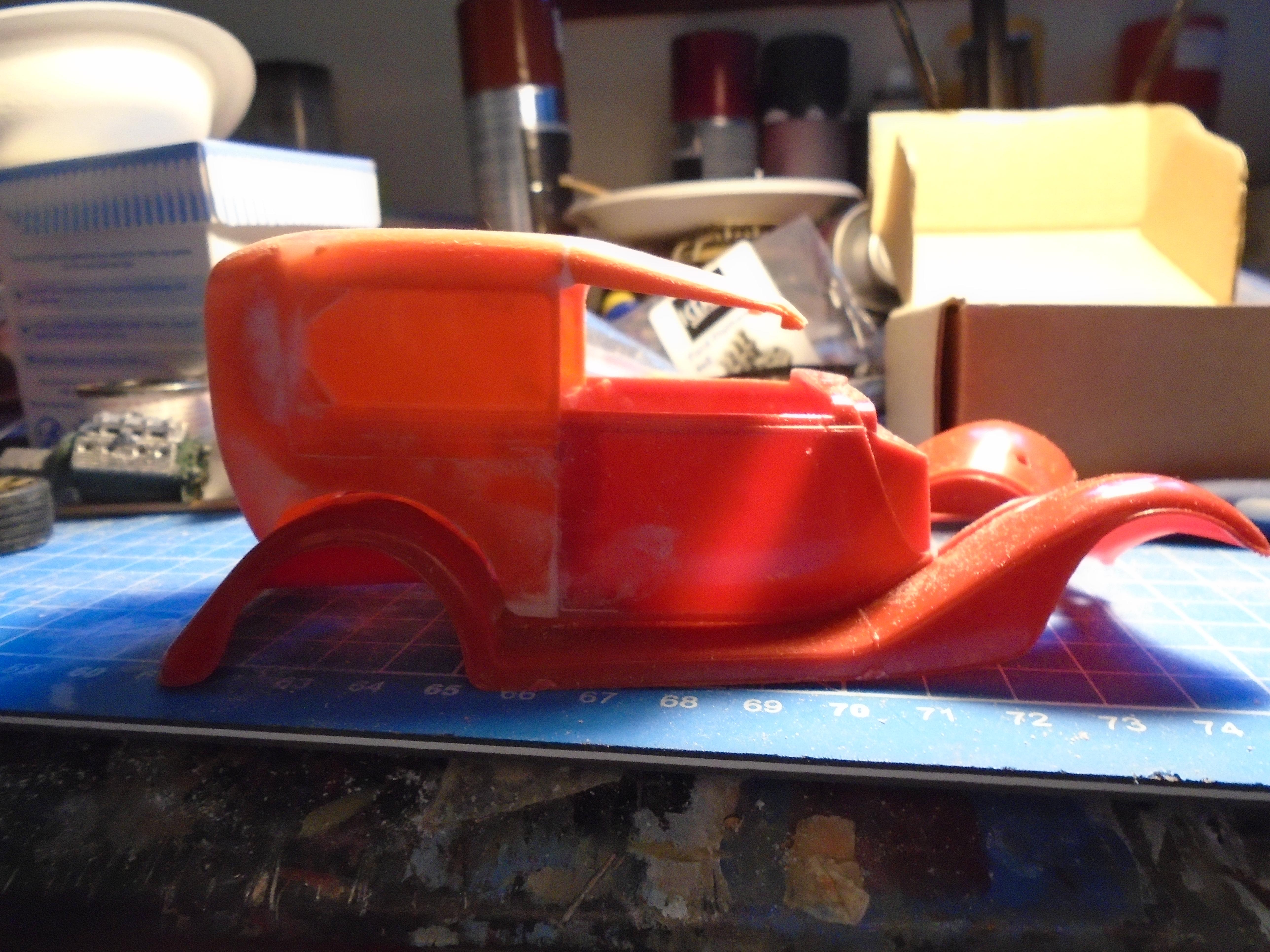

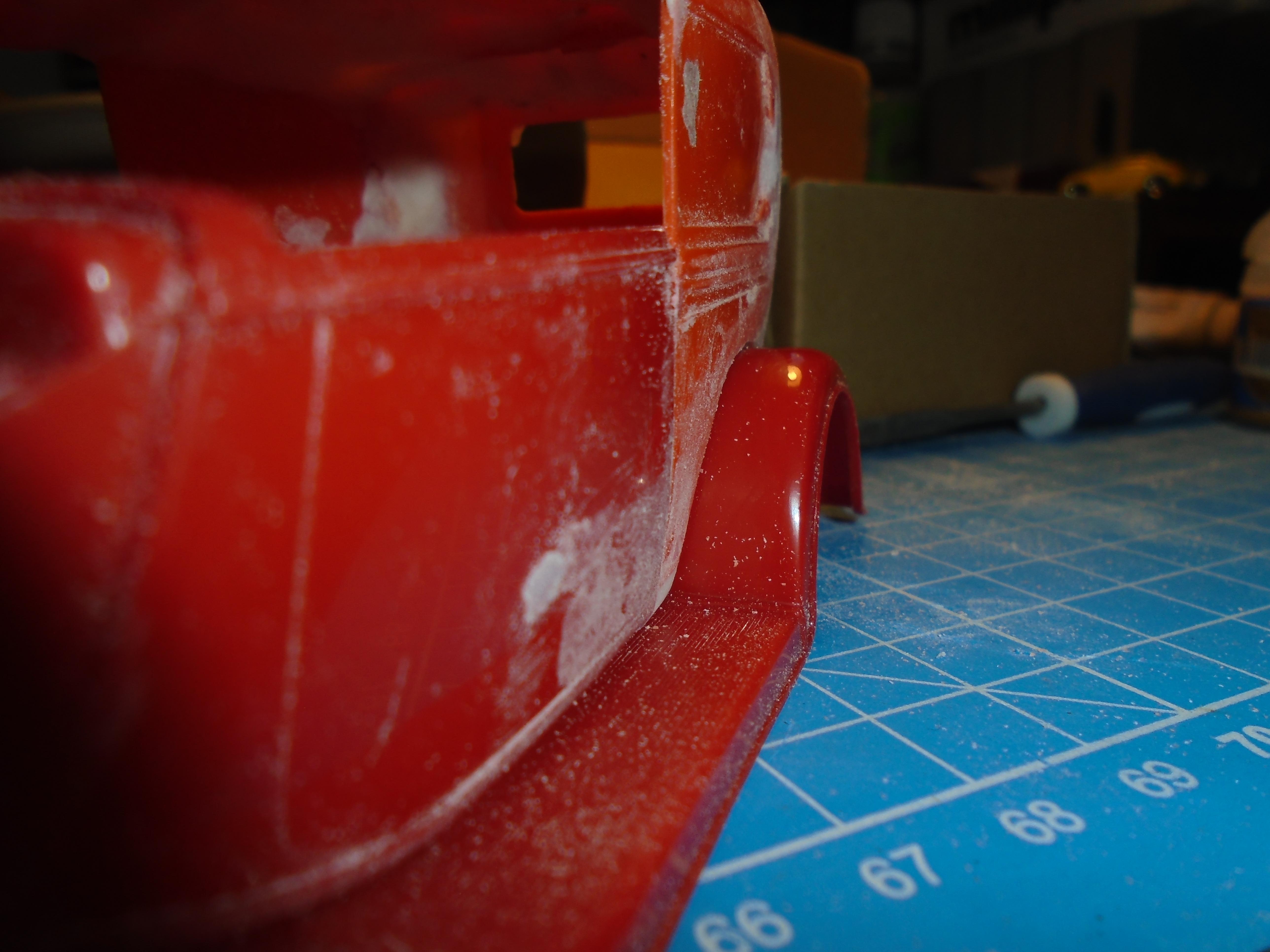

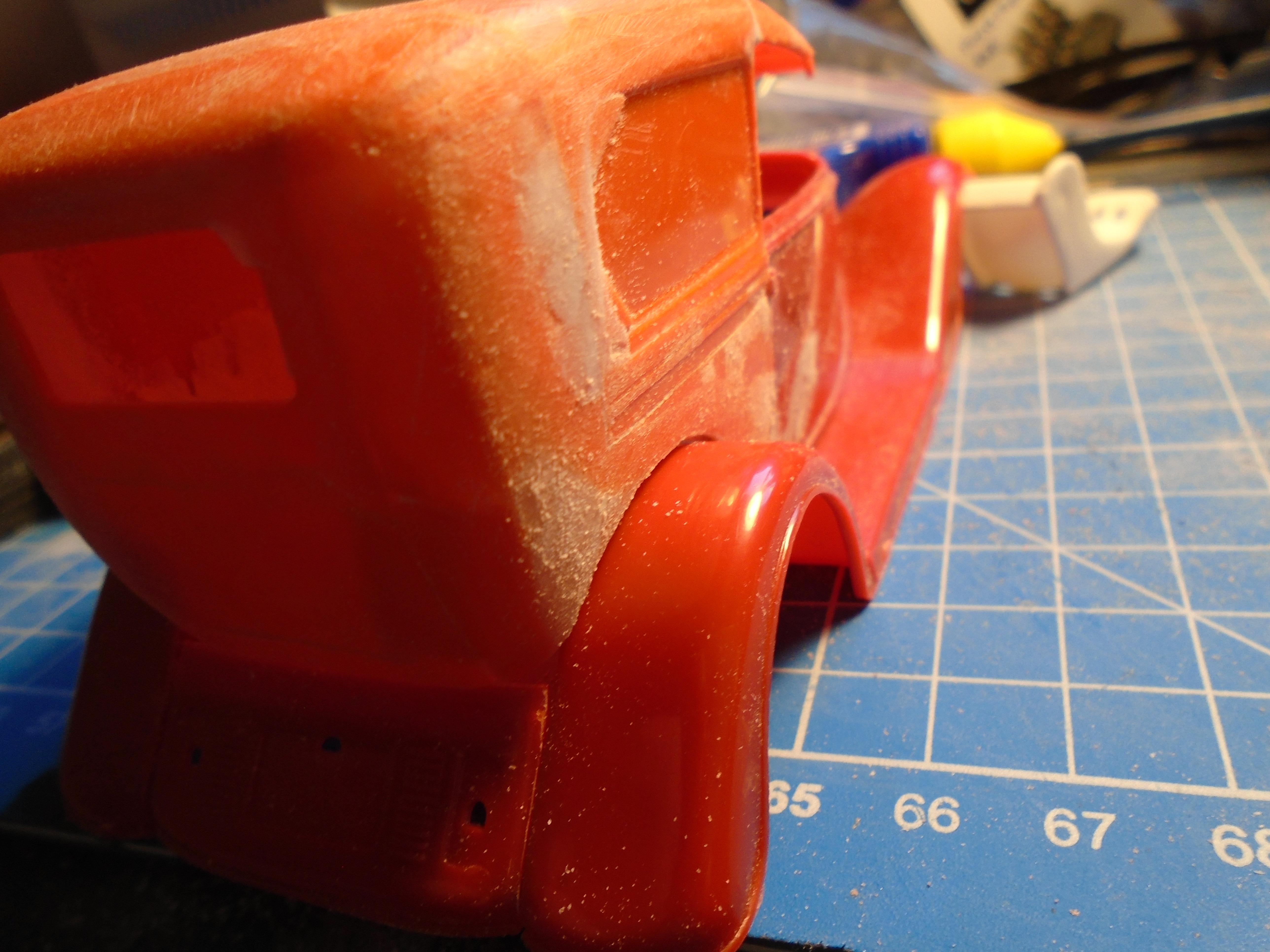

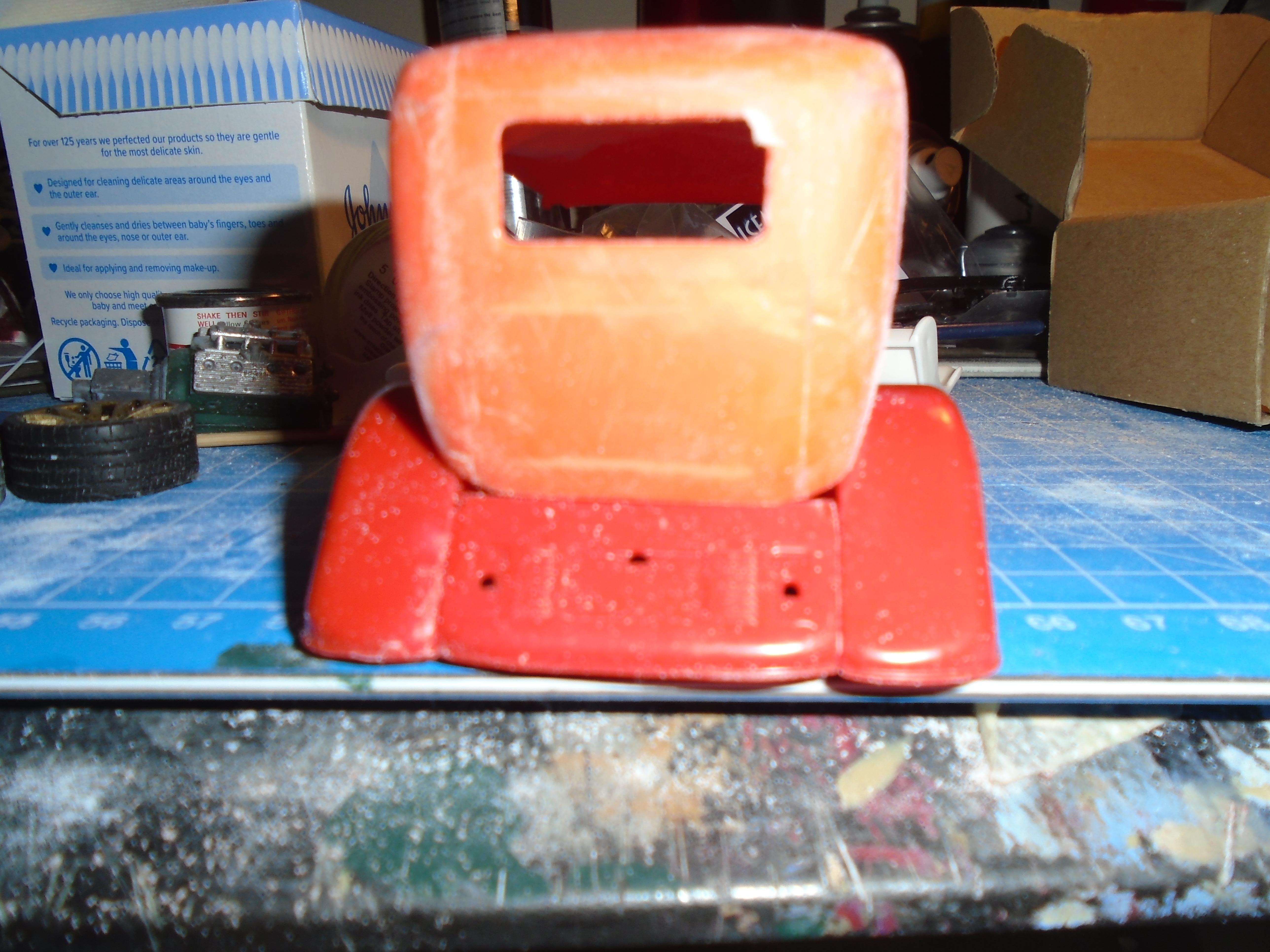

Not sure how i managed it but i deleted the pics i was going to post. Heres some more recent ones after some more work. The front is now fittd and I've started reshaping the sides to be more rounded. All the parts that aren't orange or red are the acrylic nail filler. The fenderless version might be what I end up building
