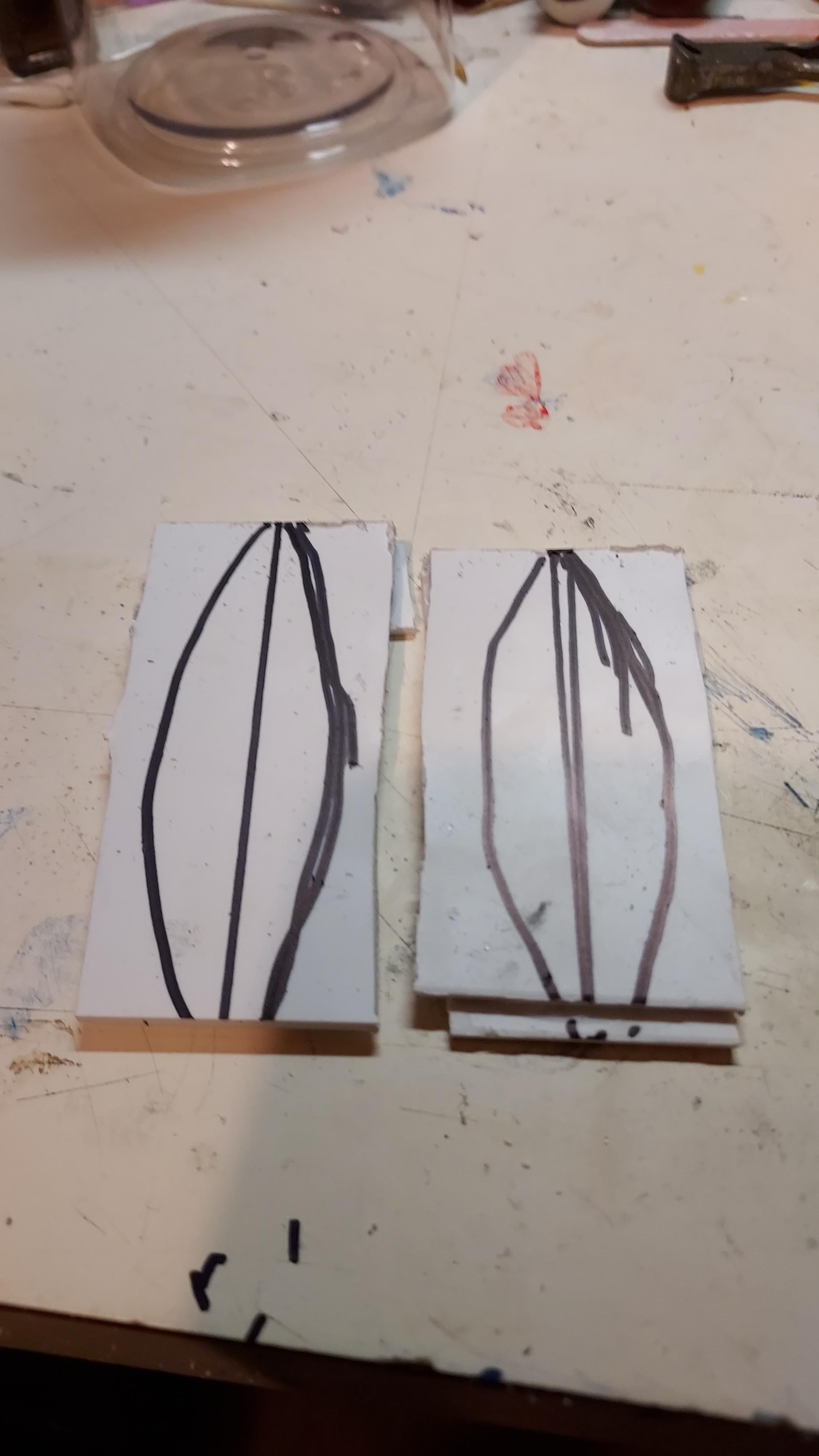

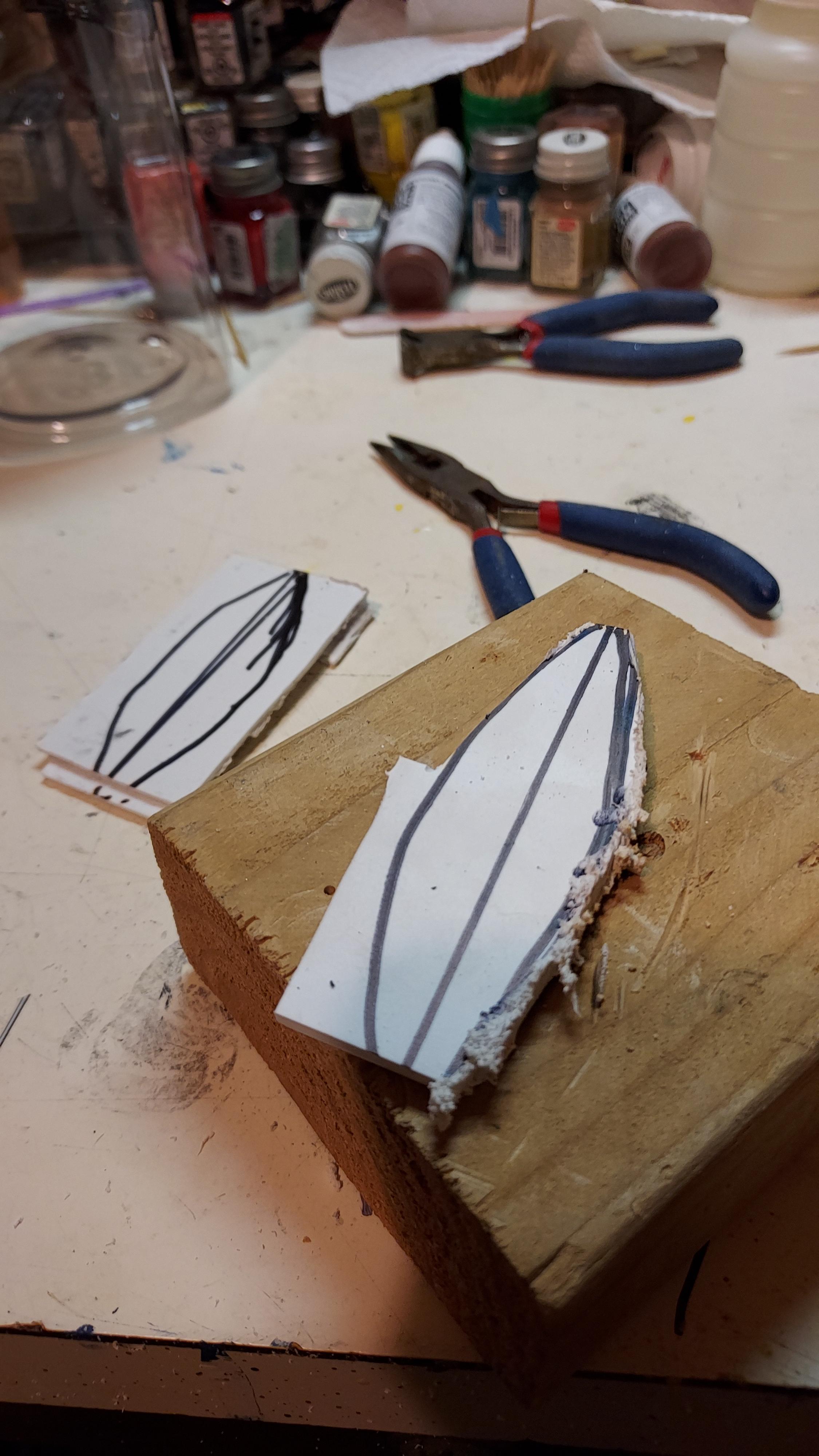

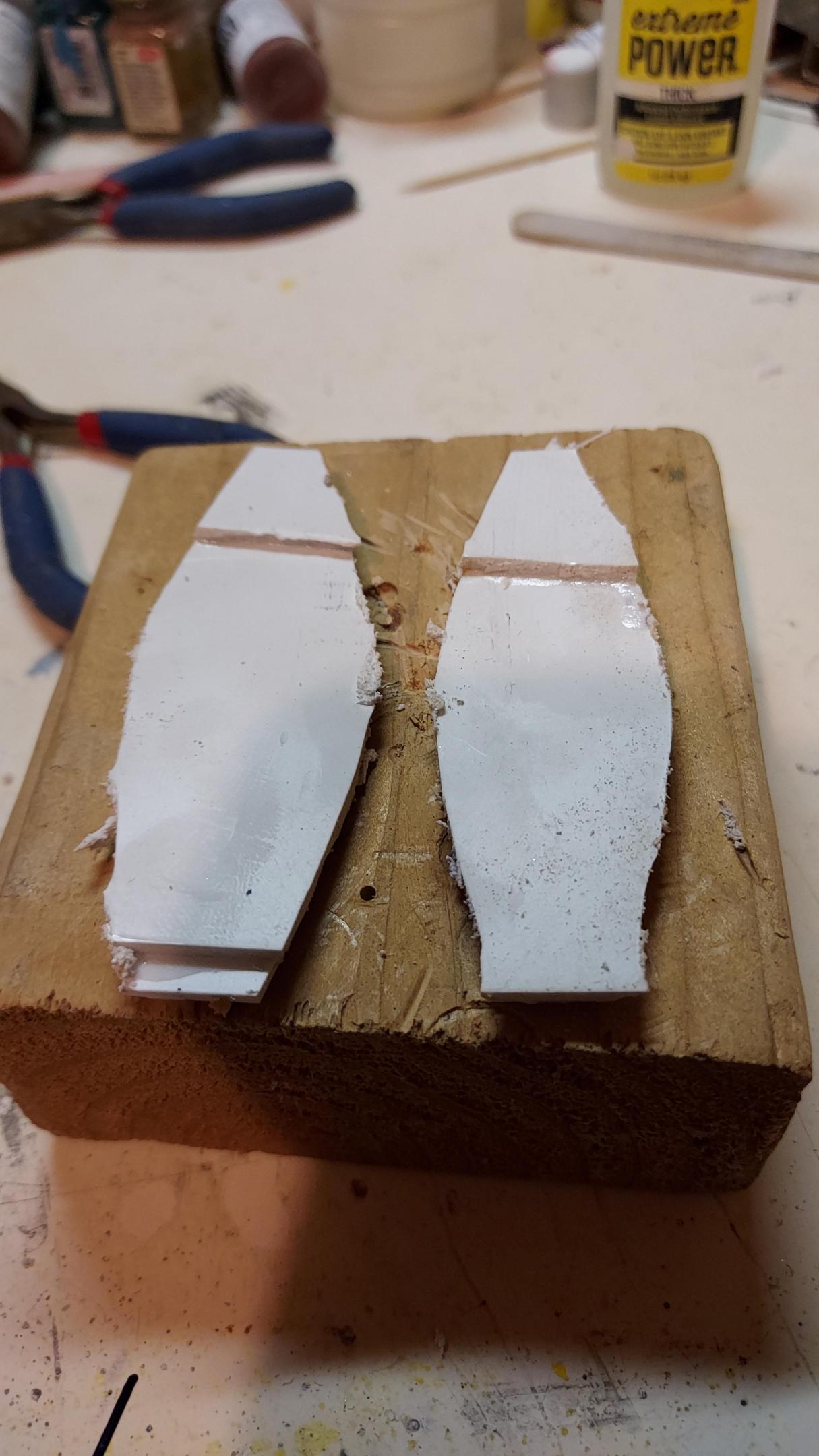

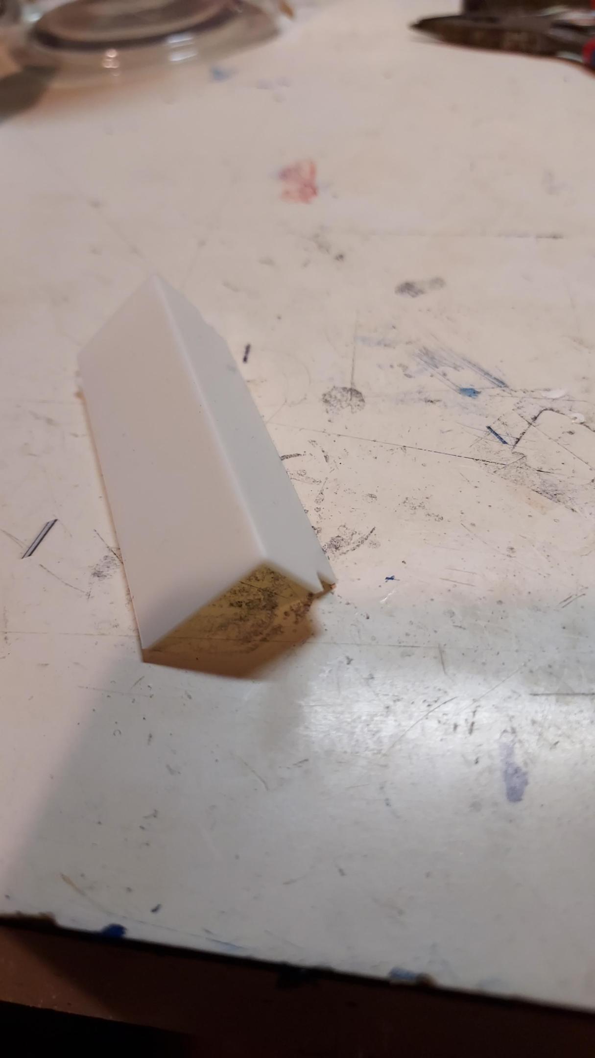

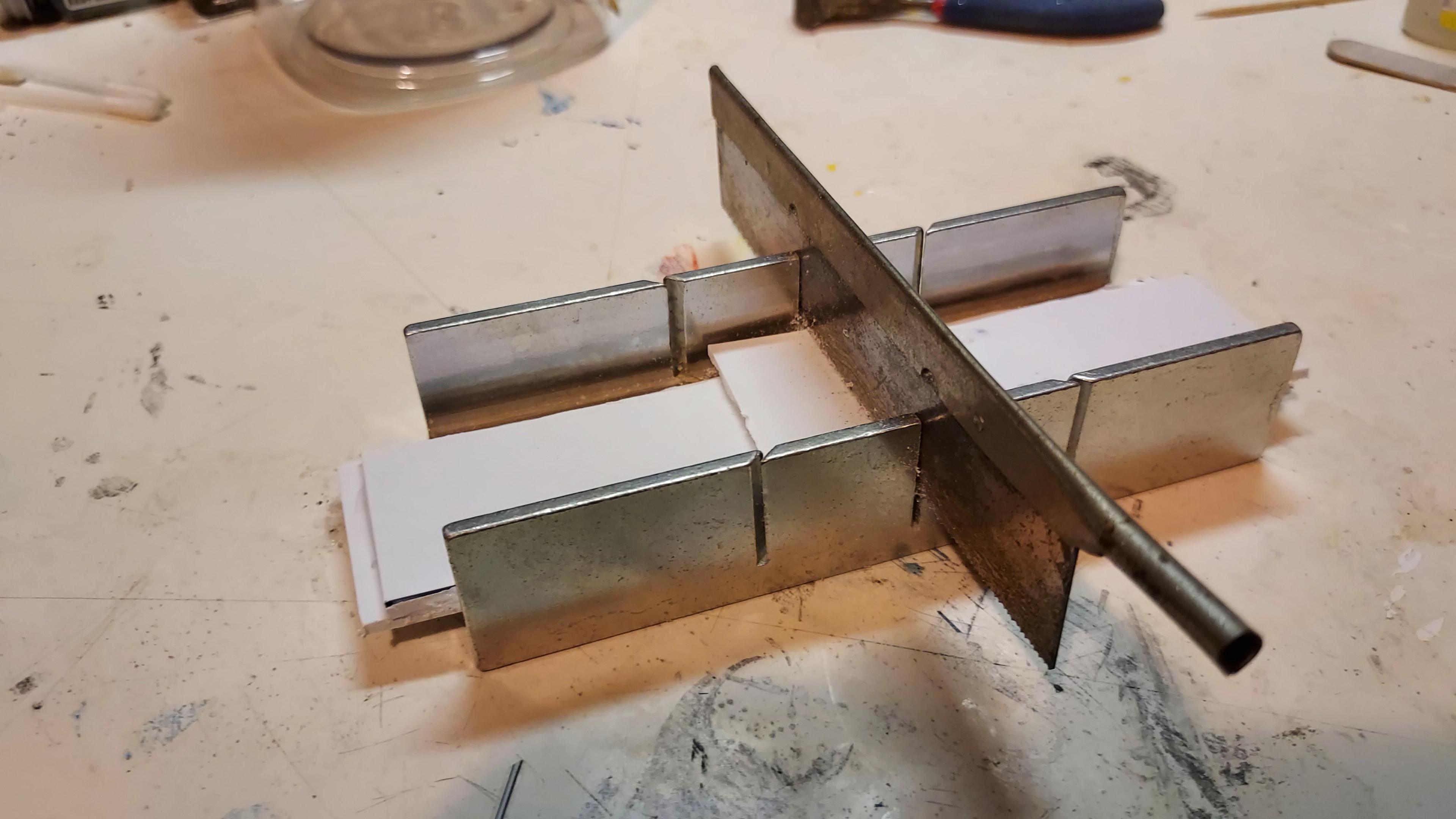

Mike C. Posted September 9, 2022 Author Posted September 9, 2022 I started by gluing together 3 pieces of sheet styrene and letting it set up overnight. Their I used my mitre box to cut that fir the 2 halfs. I took a cutting disk on the Dremel to cut out the rough shapes. Then the fun part began. Sanding and sanding and more Dremel this time with the cylindrical bit. I finally got the rough shape. A need a bit of a brake. Now I think I'll start with the plain sand paper. Not looking forward to the fins. 2

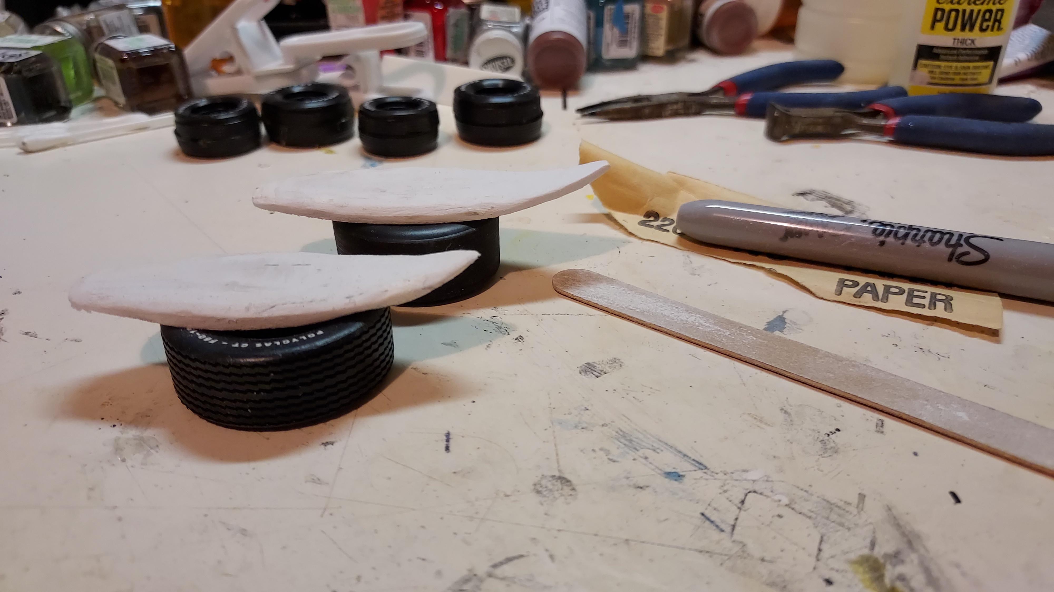

Mike C. Posted September 10, 2022 Author Posted September 10, 2022 Back to the shaping bay. Halfway through the heavy lifting. I think I'm finished with the power tools. Now downto emory boards and sand paper. I just put some filler on. I'll let that dry a while. The bottoms are a little chard because i had to heat them up with a flame to get the right rocker for both boards. Here is the thinner styrene I plan to use for the fins. It's that weird piece from the back of the Deserter pickup.

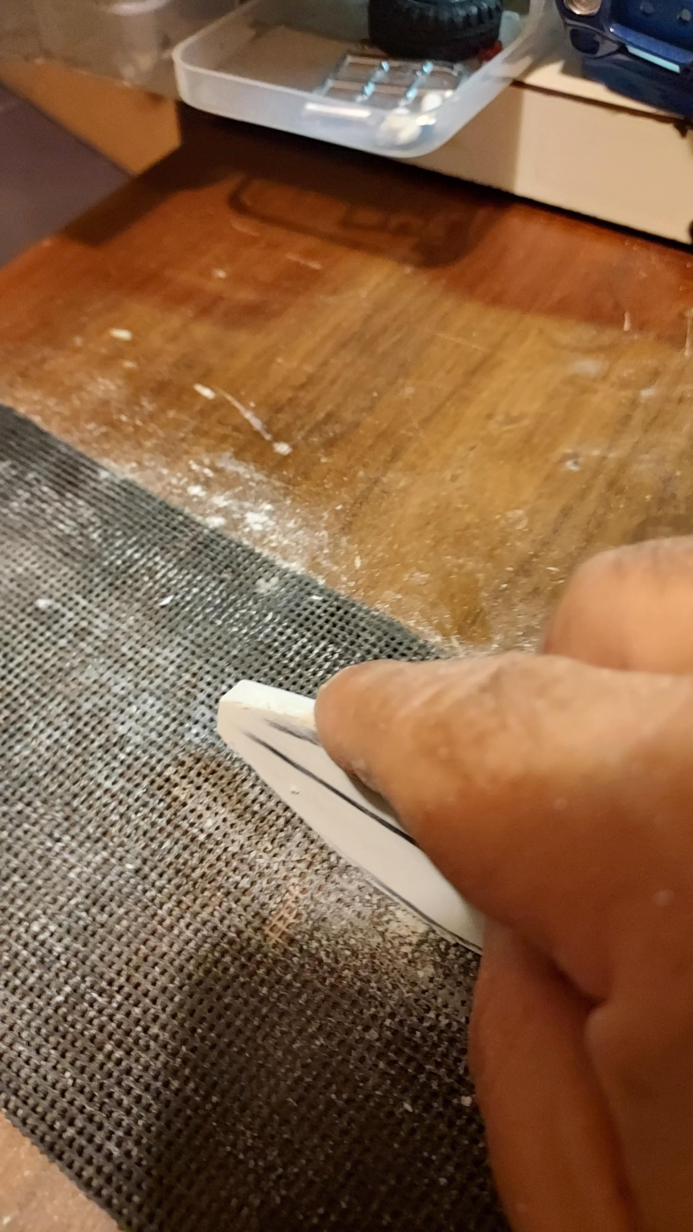

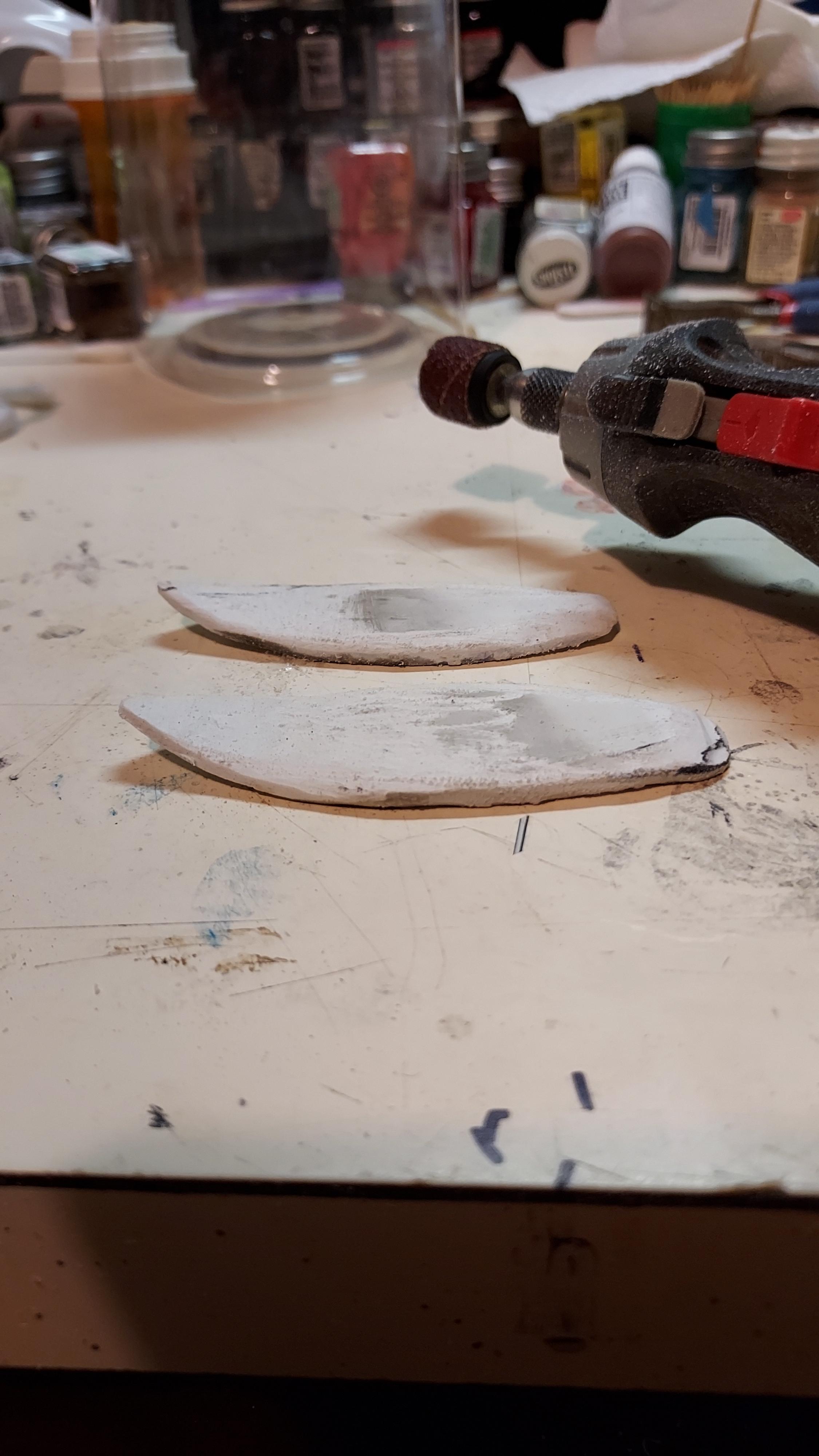

Mike C. Posted September 10, 2022 Author Posted September 10, 2022 Been tediously sanding away with an emery board. I used some sandpaper around a pen to get the nose conture. Slowly getting to the desired shape. Haven't started on the fins yet. 1

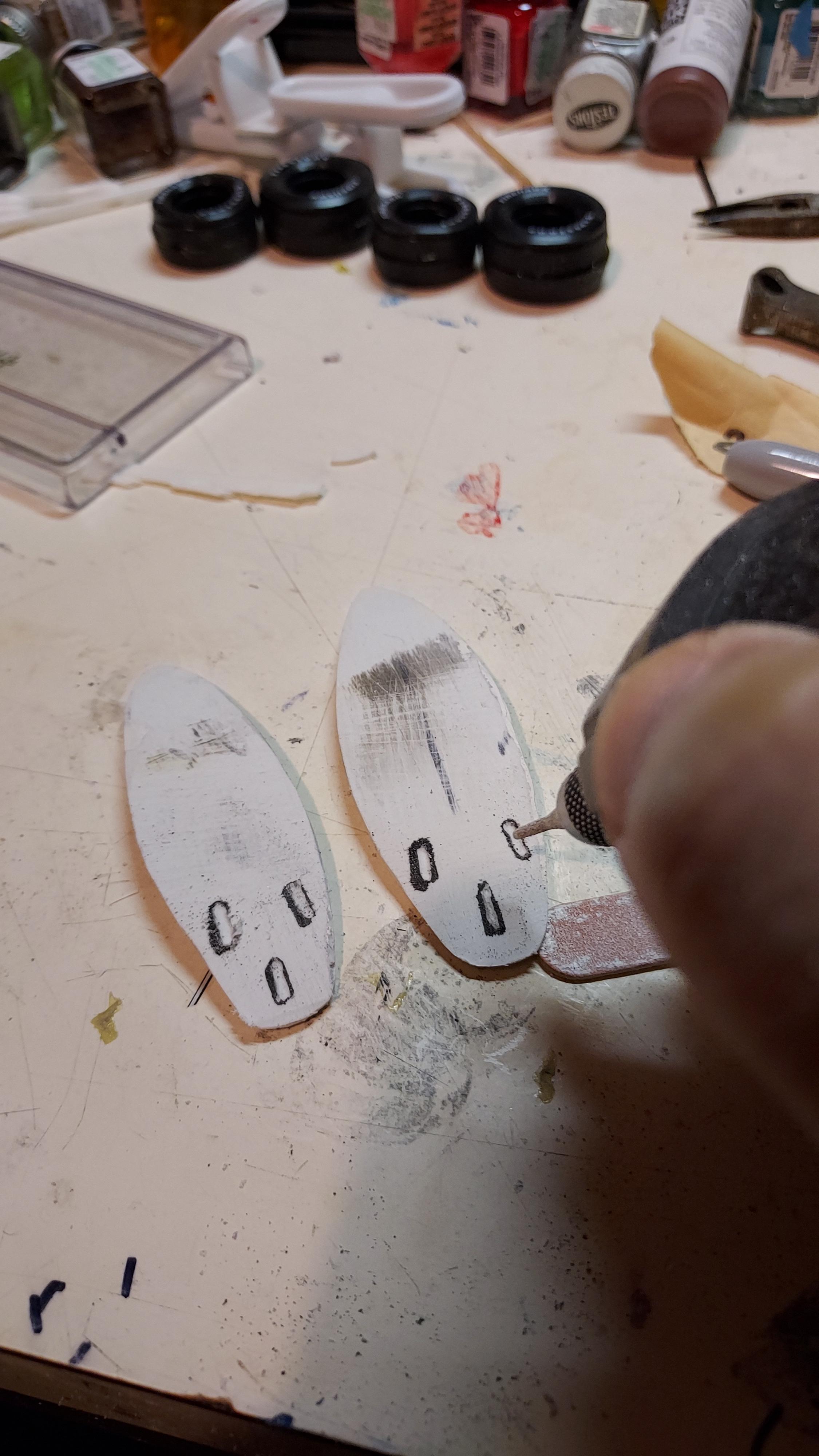

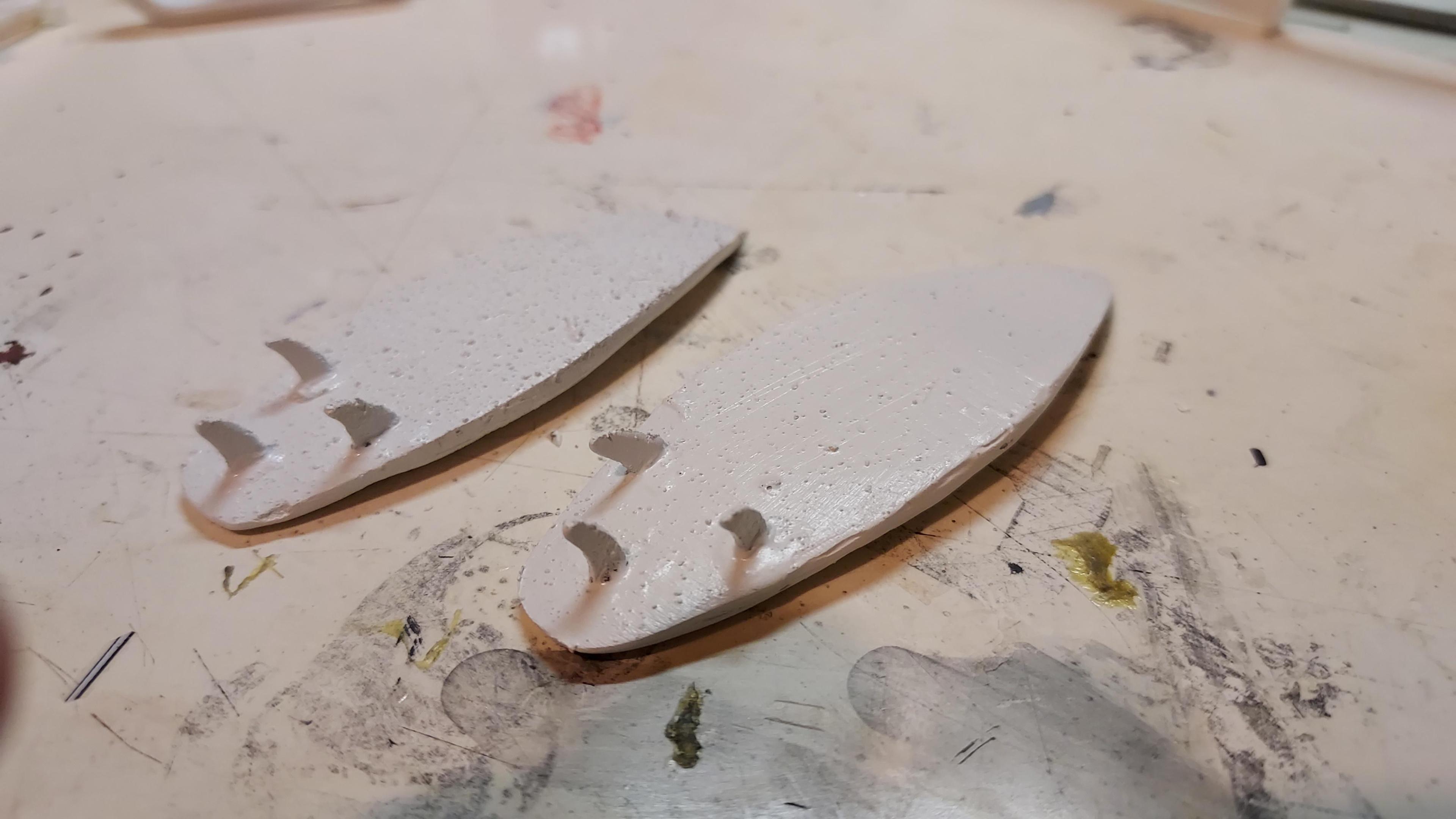

Mike C. Posted September 10, 2022 Author Posted September 10, 2022 I marked out the proposed fin locations and used a tiny Dremel bit to make some pockets for the fins to seat into. Only made one test fin so far. One down, five to go. 2

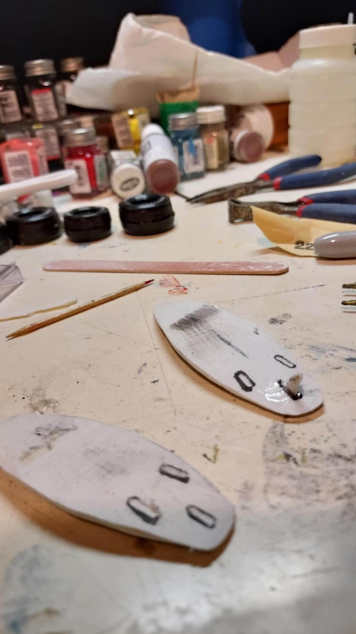

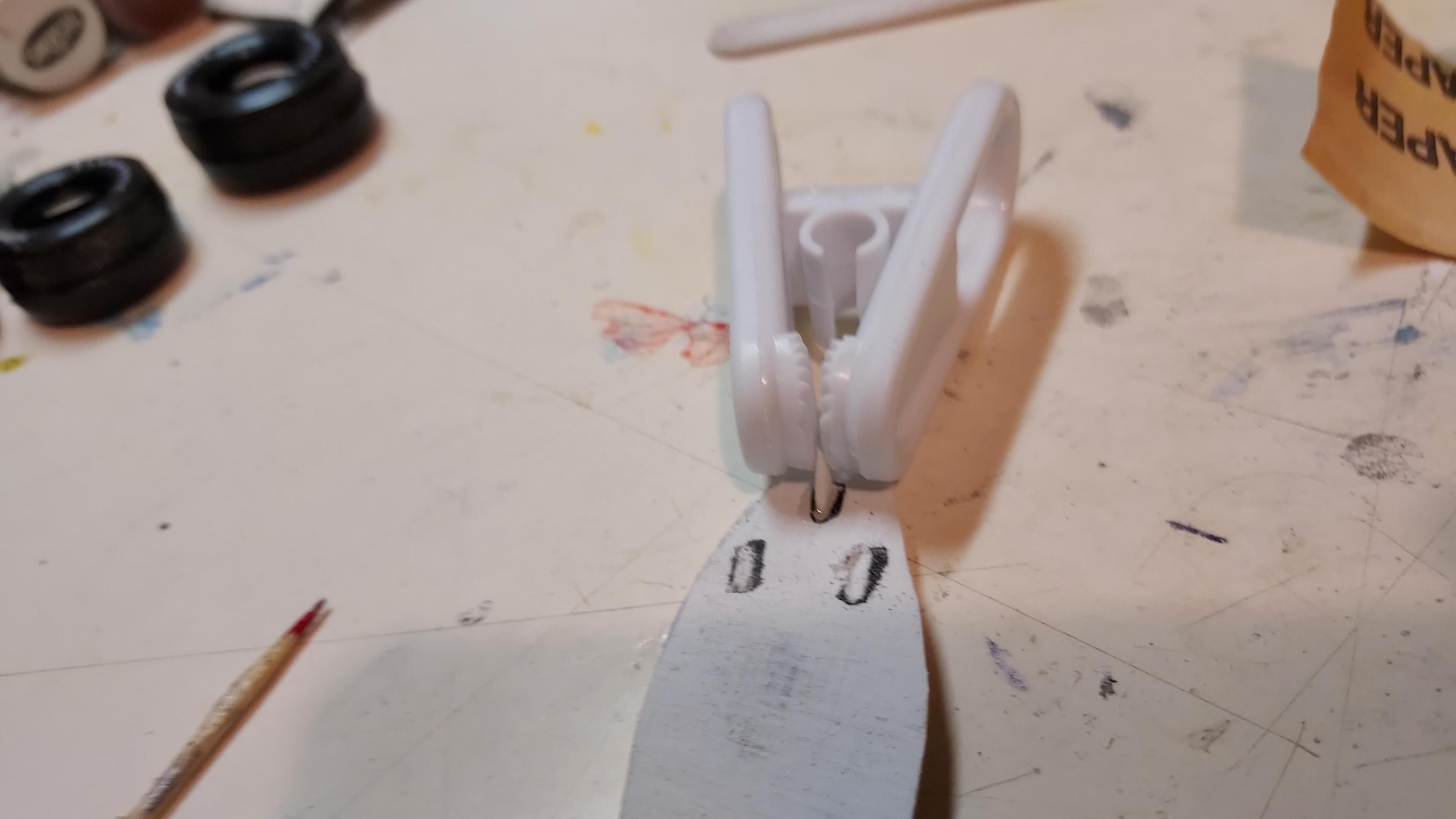

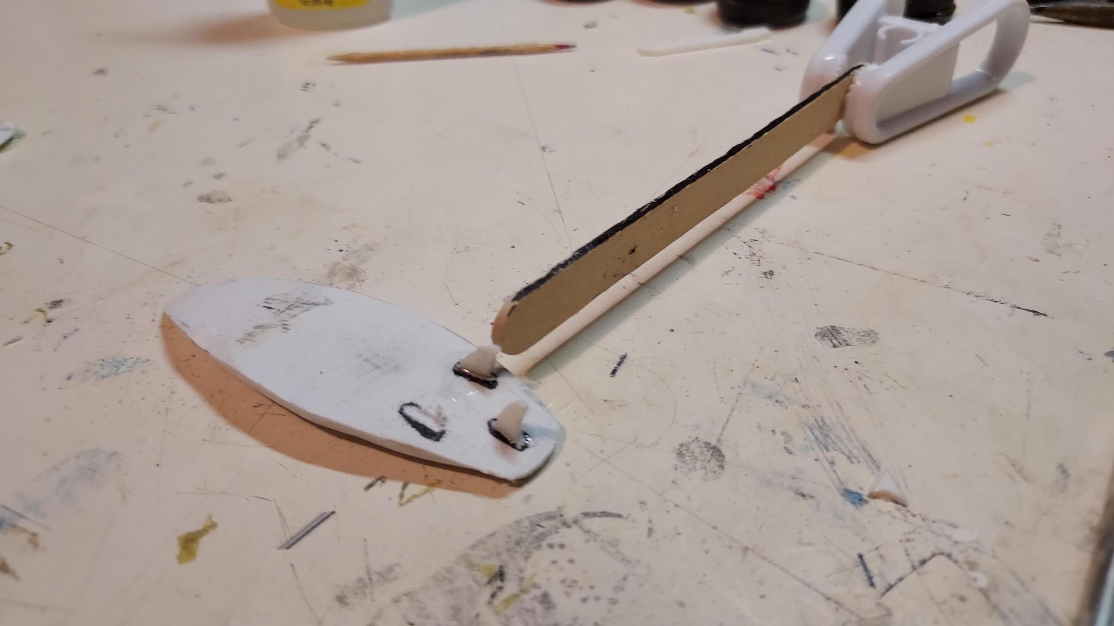

Mike C. Posted September 11, 2022 Author Posted September 11, 2022 Nice shaping Les! If I had to do it again, I might choose a softer material like the 1:1s. Foam. I had to sit there and hold that first trailing fin for what felt like forever waiting for the glue to set up, so I came up with a sort of jig to hold it in place this time. The side fins have to tilt out slightly so I will have to come up with something else.

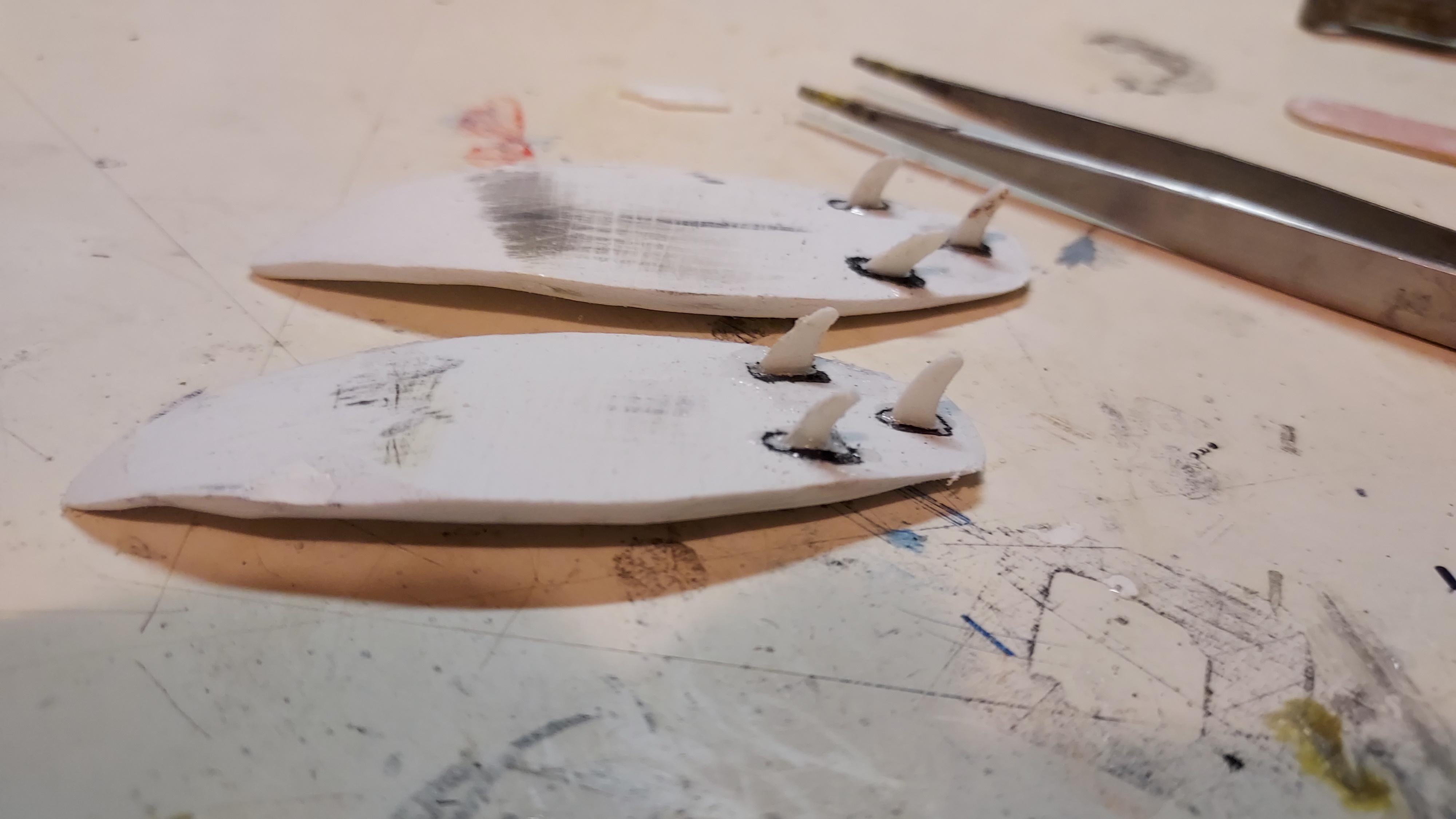

Mike C. Posted September 11, 2022 Author Posted September 11, 2022 For the side fins, I was able to use the clothes pin again. This time I used a popsicle stick to get the tilt I needed. 3 fins down, 3 to go! 1
Mike C. Posted September 11, 2022 Author Posted September 11, 2022 There you go. A pair of thrusters in 1/25. Off to paint next! 2

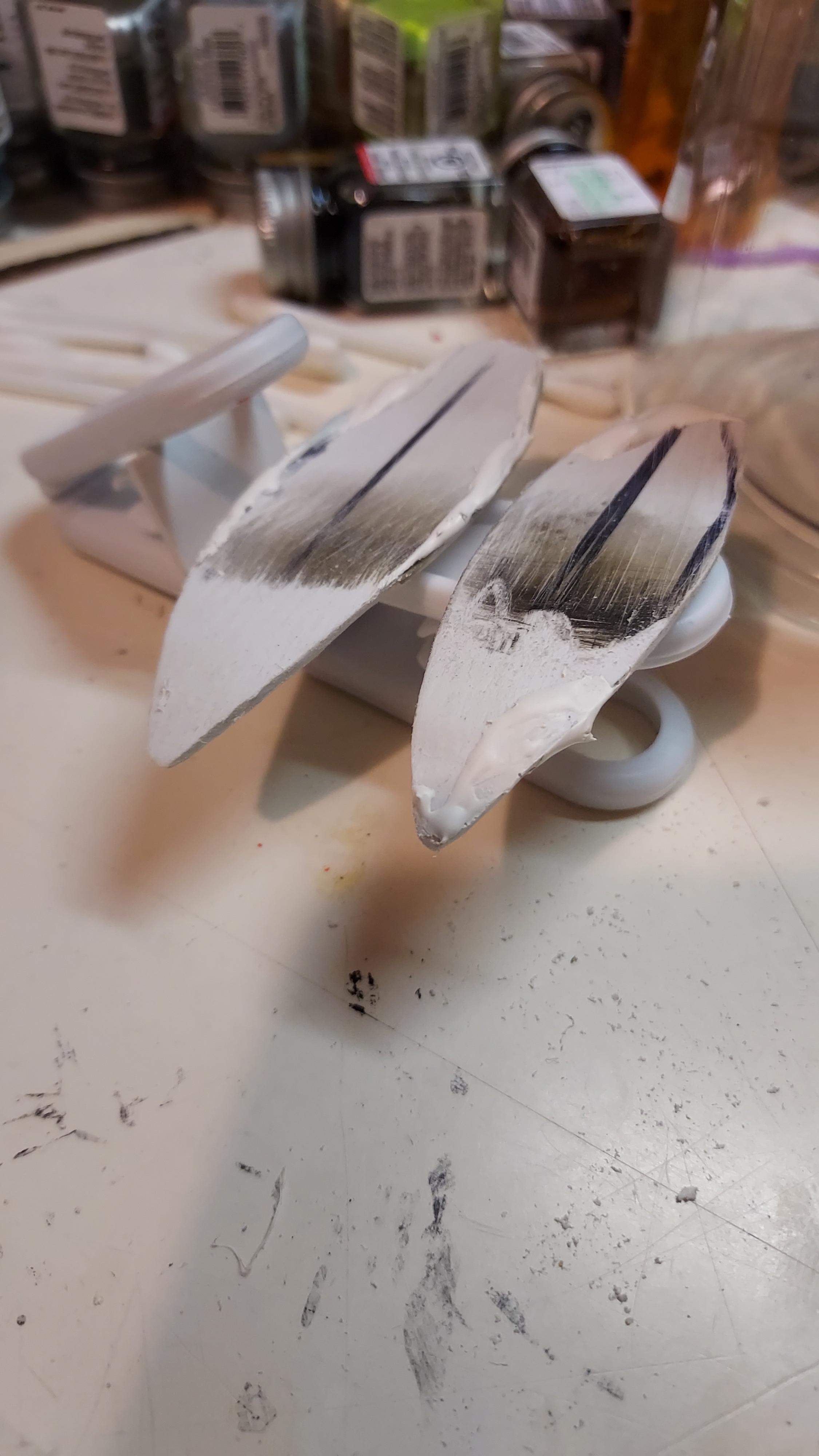

Mike C. Posted September 12, 2022 Author Posted September 12, 2022 Got a coat of white primer. Some sanding then a little color tomorrow. 2
