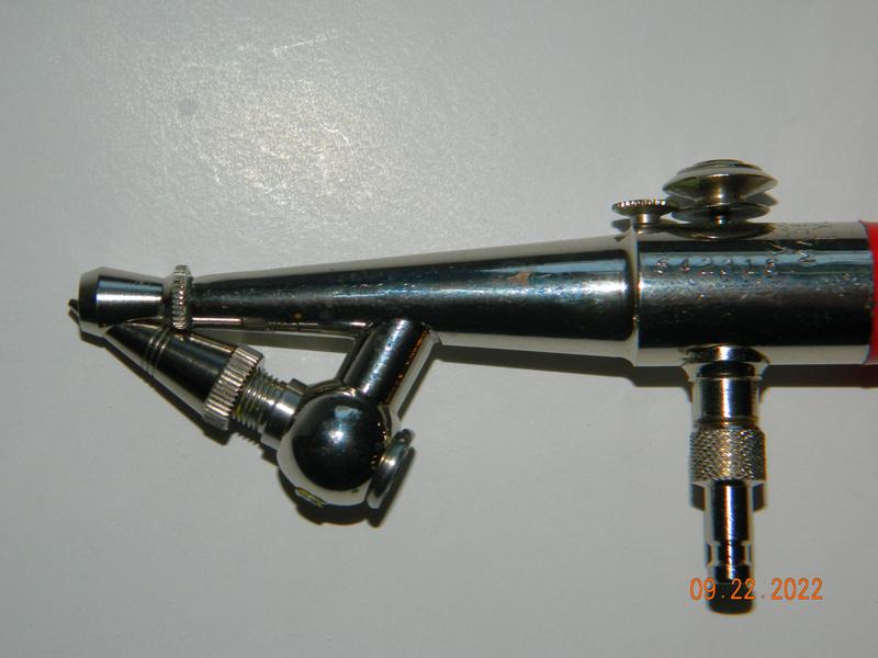

DPNM Posted September 21, 2022 Posted September 21, 2022 11 hours ago, bluestringer said: So I bought a new Iwata Neo from Hobby Lobby, it works great. That's nice but it doesn't solve the issue you are having with the H. Can you post a pic of the H? From the nozzle back just past the trigger would be good.

bluestringer Posted September 22, 2022 Author Posted September 22, 2022 On 9/20/2022 at 8:43 PM, DPNM said: That's nice but it doesn't solve the issue you are having with the H. Can you post a pic of the H? From the nozzle back just past the trigger would be good. I just got tired of messing with it. Cleaned it about 15 or 20 times, checking over and over again and can't find anything wrong with it. It shoots air fine, but it's not suctioning the paint. I've checked all over looking for a crack or something but can't find anything. I wish I could get it working because the Iwata is nice for small parts but the H does a better job with large parts like bodies, frames, etc.

bluestringer Posted September 22, 2022 Author Posted September 22, 2022 2 hours ago, Dave G. said: Have you taken the tip/needle nozzle assembly off and unscrewed the nozzle from the needle and checked all those passages.You keep talking about the body and bottles but I've heard no mention of this thus far. IE take the needle assembly off the body, you have to loosen the set screw on the bottom to get it out. The body is fine, no paint goes through the body and you're getting air. It's a simple device it's got to be a very simple answer as well. 9 out of 10 times these issues come down to cleaning. Yes, as I've said I have cleaned it several times. When I clean it I take it completely apart. I shined a light into all the passages, all is clear. I have taken the packing out and checked it, looks good. I have ran cleaning brushes in all the passages. Yes, it is a simple device that is what's got me baffled, I see nothing that would stop it from working. The only thing I can think of is a crack causing it not to be able to suction. But I can not see any cracks. I have also cleaned the bottles and passages in them several times, all clear. I like the H and would like to get it working, if I can't I will probably just get a new unit.
Rich Chernosky Posted September 22, 2022 Posted September 22, 2022 James...I notice in the picture you have the tip all the way open. It won't spray that far up in the airstream. It only takes a few turns from closed to spray. Are you using the correct tip with the correct needle. The medium (or H) tip and nozzle are the ones I use the most. Also the heavy for thicker paints. The fine tip is the worst as it clogs almost instantly so I never use it. Soaking parts will not clean any residue off by the way. I t will loosen any dried paint but to get the residue off you have to physically clean it with something.

bluestringer Posted September 22, 2022 Author Posted September 22, 2022 2 hours ago, Rich Chernosky said: James...I notice in the picture you have the tip all the way open. It won't spray that far up in the airstream. It only takes a few turns from closed to spray. Are you using the correct tip with the correct needle. The medium (or H) tip and nozzle are the ones I use the most. Also the heavy for thicker paints. The fine tip is the worst as it clogs almost instantly so I never use it. Soaking parts will not clean any residue off by the way. I t will loosen any dried paint but to get the residue off you have to physically clean it with something. I have tried it from closed to fully open, no difference.
