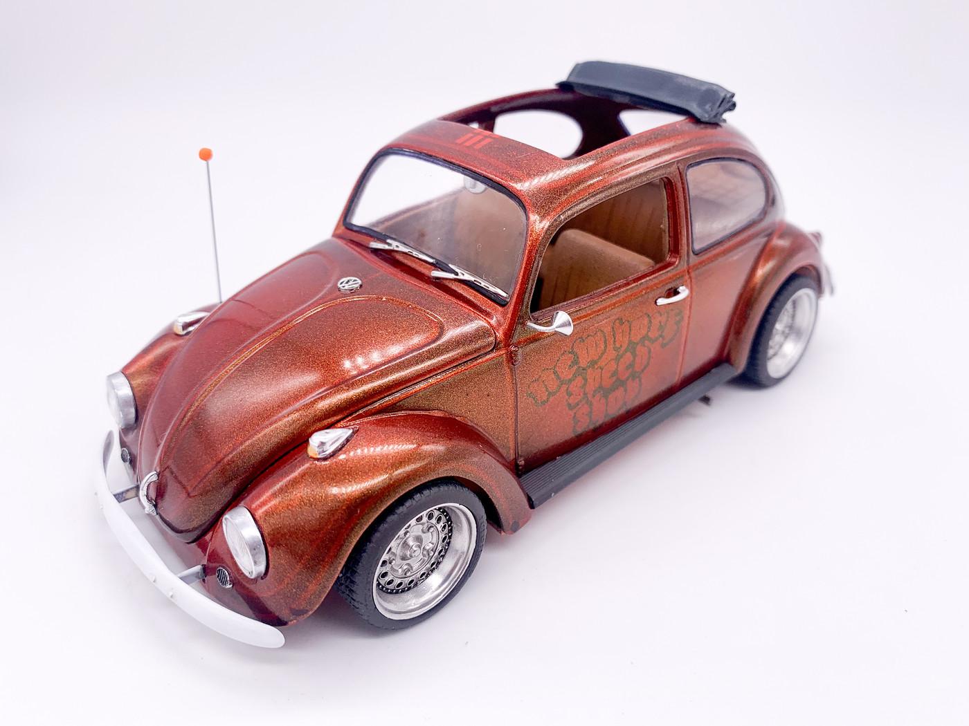

OldNYJim Posted September 28, 2022 Posted September 28, 2022 I like to start at 3200, unless it's REALLY rough, for some reason (or has a bunch of graphics underneath causing stepped edges, etc), get the whole thing to a consistent sheen with no high or low spots or visible orange peel and then work through 3600, 4000, 6000, 8000 and 12000 before polishing with Meguiar's Scratch X, then Novus #1 polish followed by Meguiar's Ultimate compound before wax. I like to use a dehydrator to bake my lacquer for 24 hours after the final couple of coats, and then let it sit for another 24 before polishing. If I'm not using the dehydrator, I'd normally allow at LEAST 7 days, or more if I can still smell the paint gassing out. Some examples below, because who knows if people's advice is good on the internet or not without seeing their work ? 1

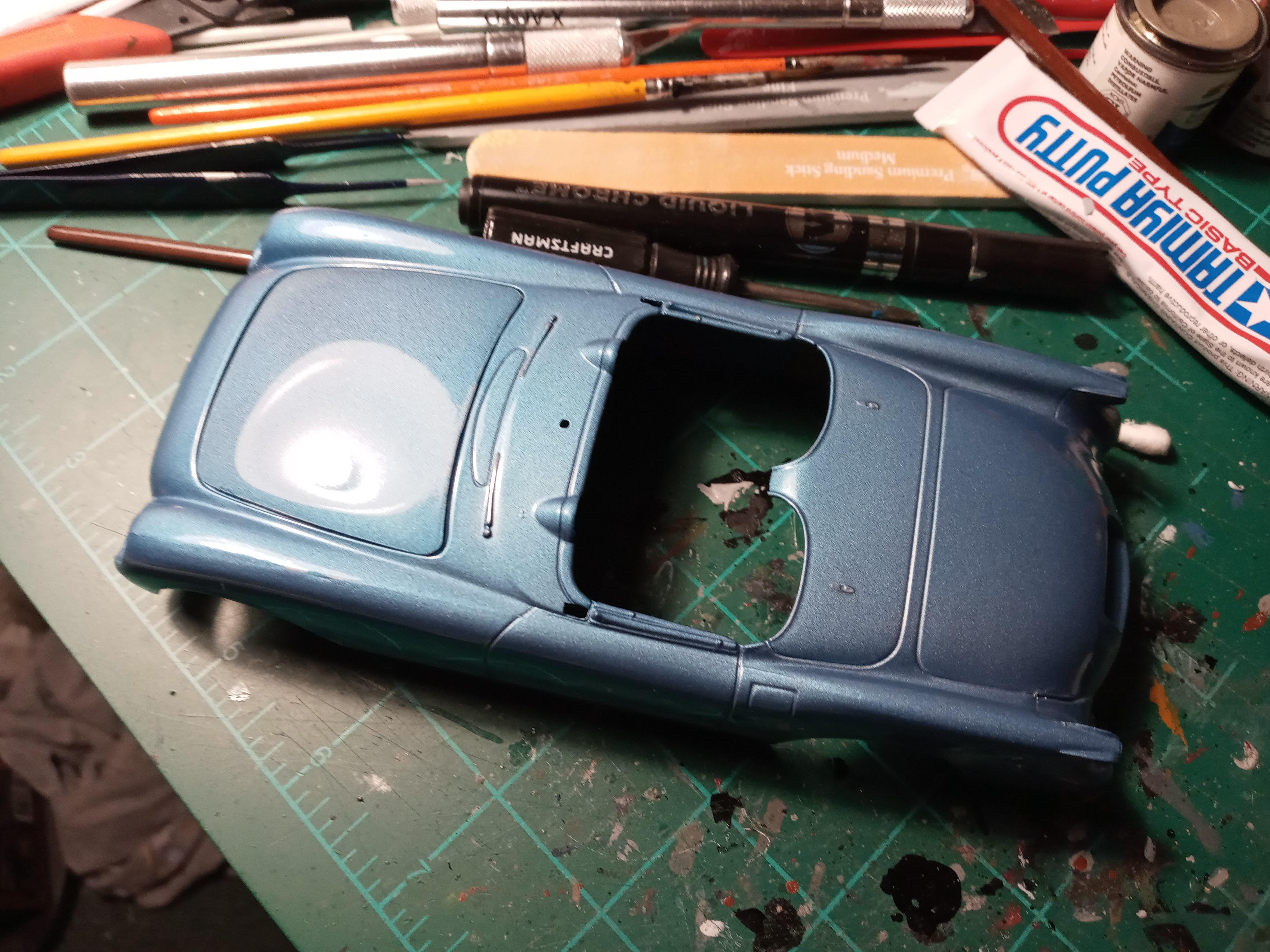

RSchnell Posted September 28, 2022 Posted September 28, 2022 I use primarily Tamiya TS-13 clear as it lays down nice. My usual schedule is: Let it dry for a few days before sanding. I'll start with 2000 then finish with 3000 or 5000 sanding wet with a drop of dish soap to keep the paper clean. (I've used this same process when color sanding 1:1 autos for years). I use 3M Trizact paper almost exclusively when color sanding. You can get it from any good automotive paint supply store or Amazon. I then polish with 3M hand glaze. It is a very very mild compound. You don't want anything aggressive since you sanded all the way to 5000. I prefer the 3M brand as it has no silicone or wax and I can foil and detail right over it. After foiling, etc I use a good carnauba wax. Here's a couple examples of the results using the process above. 7

OldNYJim Posted September 28, 2022 Posted September 28, 2022 10 minutes ago, TransAmMike said: And what clear lacquer do u use Jim? Mostly the Rustoleum stuff with the black chair on the can, but the same process works for me with the old Testors lacquer clear too, plus whatever clear enamel I can actually source that week. That said, @RSchnell's process looks simpler and his results speak for themselves so maybe I should pick up the materials to try that!

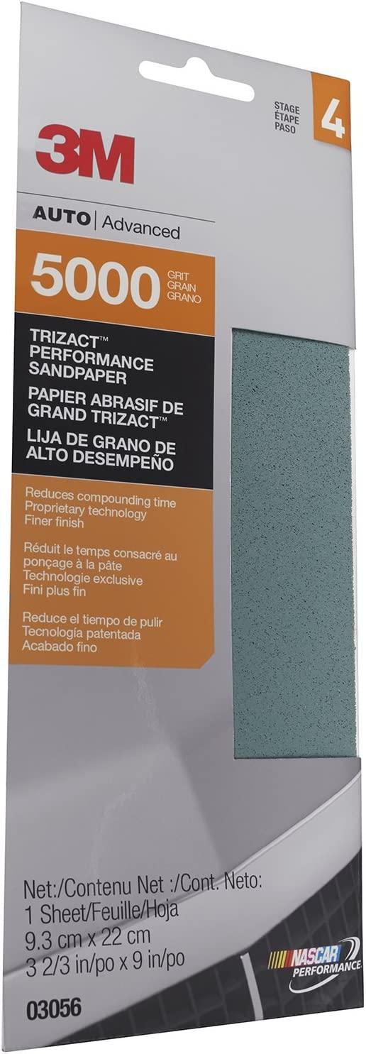

Dpate Posted October 4, 2022 Posted October 4, 2022 I just got through compounding earlier, but still got to polish. 2k was ready to go after 4 hours @ 120F in the dehydrator. No need for 24 hours or weeks. Depending on the situation I'll use 2K grit, 3K grit, 5K grit all from 3M, and than i compound, polish, wax(wax is always last because BMF, etc). I use these with a mini dremel @ 2K rpms. Trying to compound and polish 2K you'll be there for days trying to cut with a a cloth n finger. I use orange(Medium cut) for compound, black(light cut) for polish, and yellow(No cut) for wax. These are SO much better than using polishing wheels. 1
