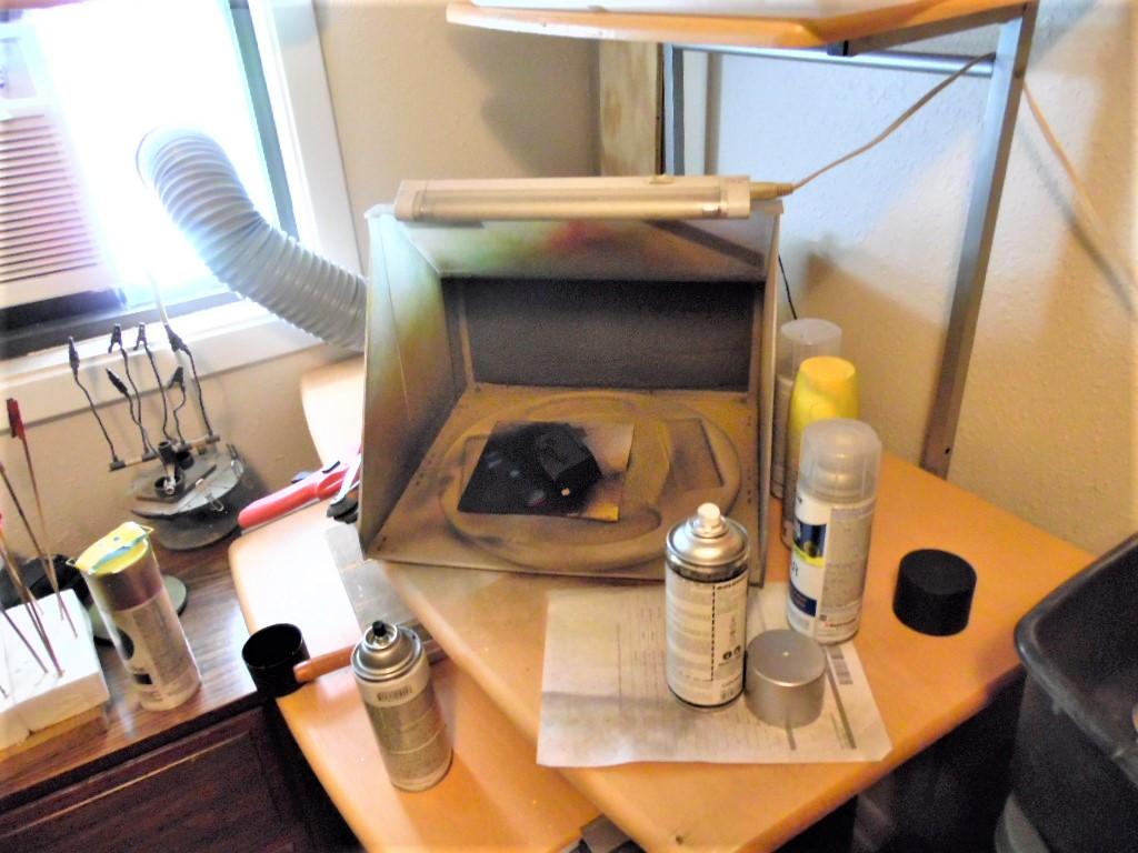

yh70 Posted October 3, 2022 Posted October 3, 2022 mine is vented out the window year round. i just took a piece of plexiglass cut a hole in it, got me a dryer vent ..(one that has the flapper that will close it off when not in use..keeps the critters out)..and screed & silicone it in place. i just keep the vacuum close by to clean out the filters. and that is a must to keep the fums out of your home..

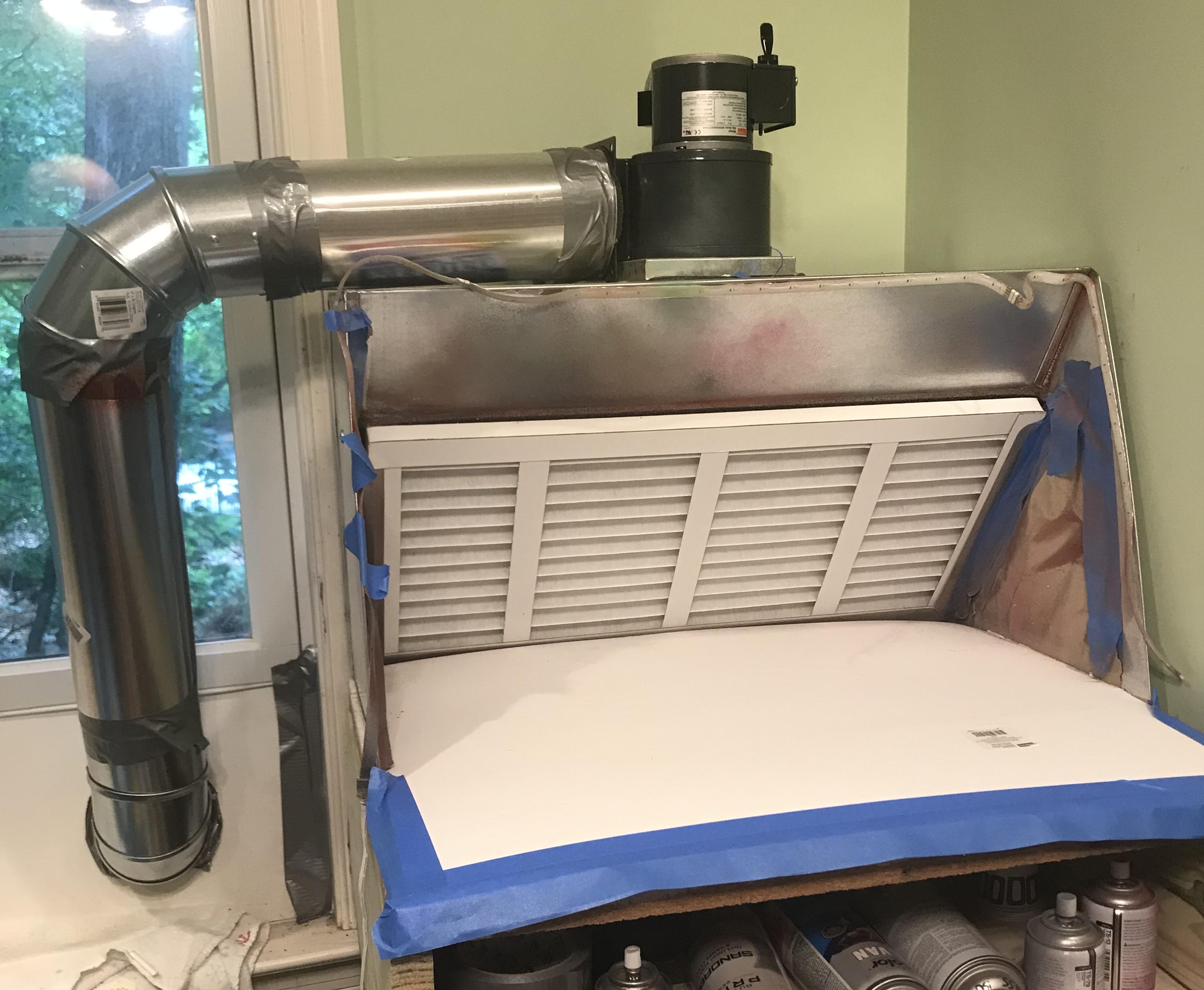

Tom Geiger Posted October 3, 2022 Posted October 3, 2022 Here’s mine. All rigid metal exhaust, through panel to outside.
