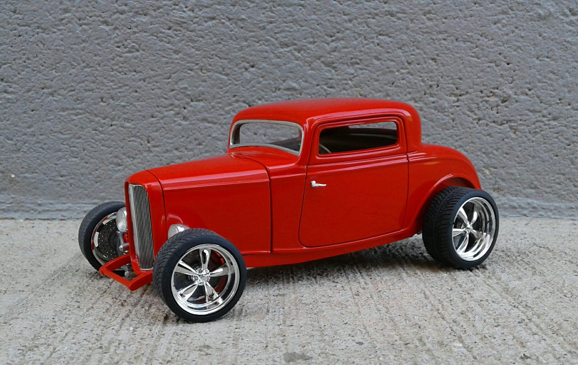

Plowboy Posted October 2, 2022 Posted October 2, 2022 This is Tamiya Bright Red. Don't know if it's the brightest or not. This is Dupli Color Bright Red. Not quite as bright as the Tamiya. 1

Kenmojr Posted October 3, 2022 Posted October 3, 2022 21 hours ago, Plowboy said: This is Tamiya Bright Red. Don't know if it's the brightest or not. This is Dupli Color Bright Red. Not quite as bright as the Tamiya. Wow, beautiful rod, especially the 1936 Ford... 1
