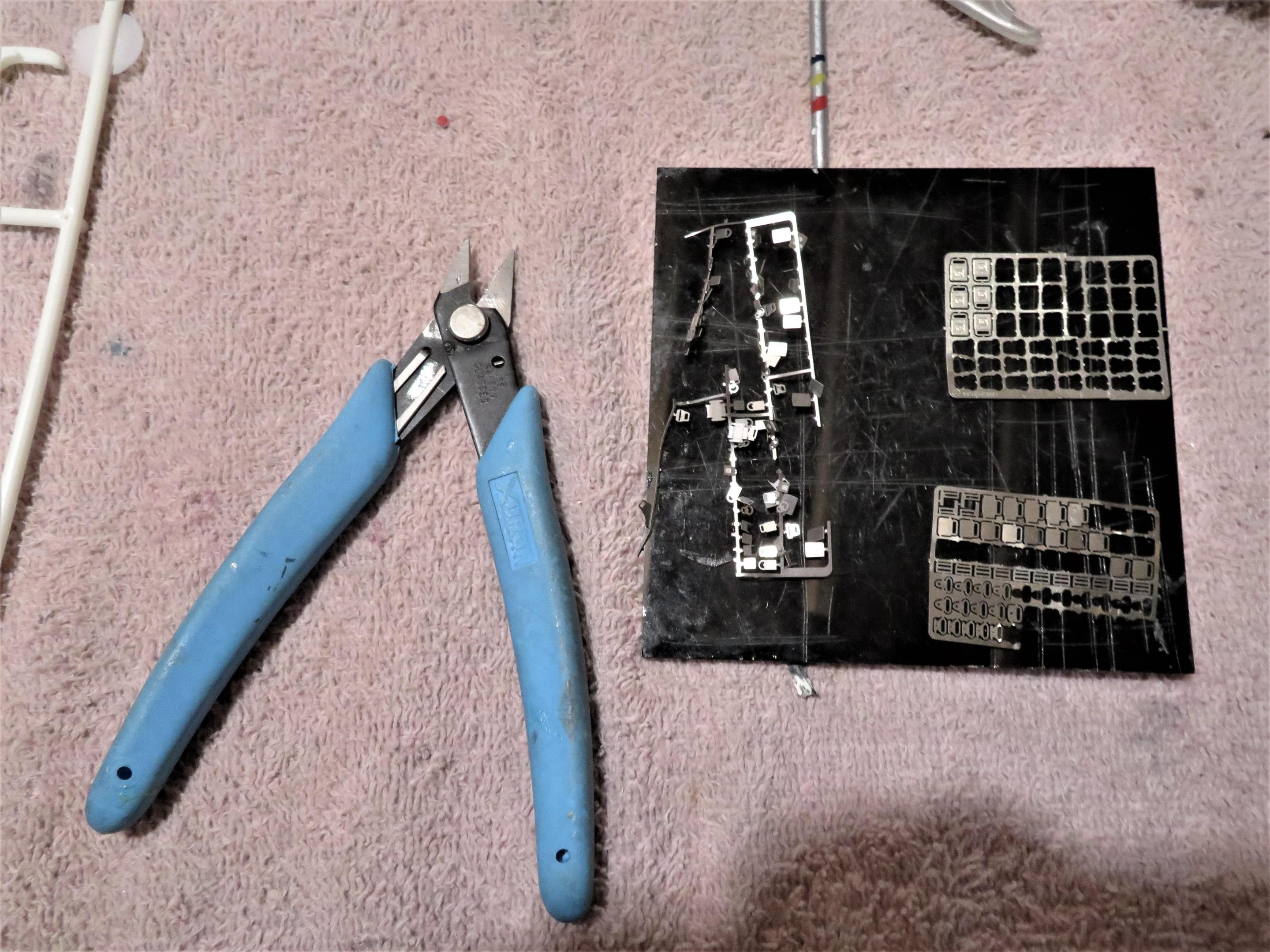

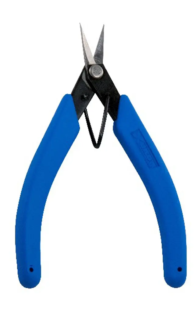

Dpate Posted October 21, 2022 Posted October 21, 2022 What are you cutting the photoetch on? Fresh blade should easily pop a photoetch part loose doesn't take that much force. I use a small glass cutting mat that i got from hobby lobby to cut photoetch parts off, and than photoetch scissors to trim the rest, and than tamiya photoetch file if needed. Depending on the photoetch I'll use just the scissors to cut the part off cause they fit properly. Don't cut decals or try and cut photoetch parts off on a self healing mat or any mat. The cut on the decals wont be as smooth, and you could damage the photoetch parts as well.
slusher Posted October 21, 2022 Posted October 21, 2022 I have always used finger nail clippers and fie off the bur I may look into a set of photoetch scissors...

Dpate Posted October 24, 2022 Posted October 24, 2022 On 10/22/2022 at 7:58 PM, TransAmMike said: So since the Thread is just entitled "photo etched parts" how about we get off the cutting topic and discuss gluing the parts. I have photo etch emblems to install onto the body of my current project. What say you? I use this along with other glue products.
