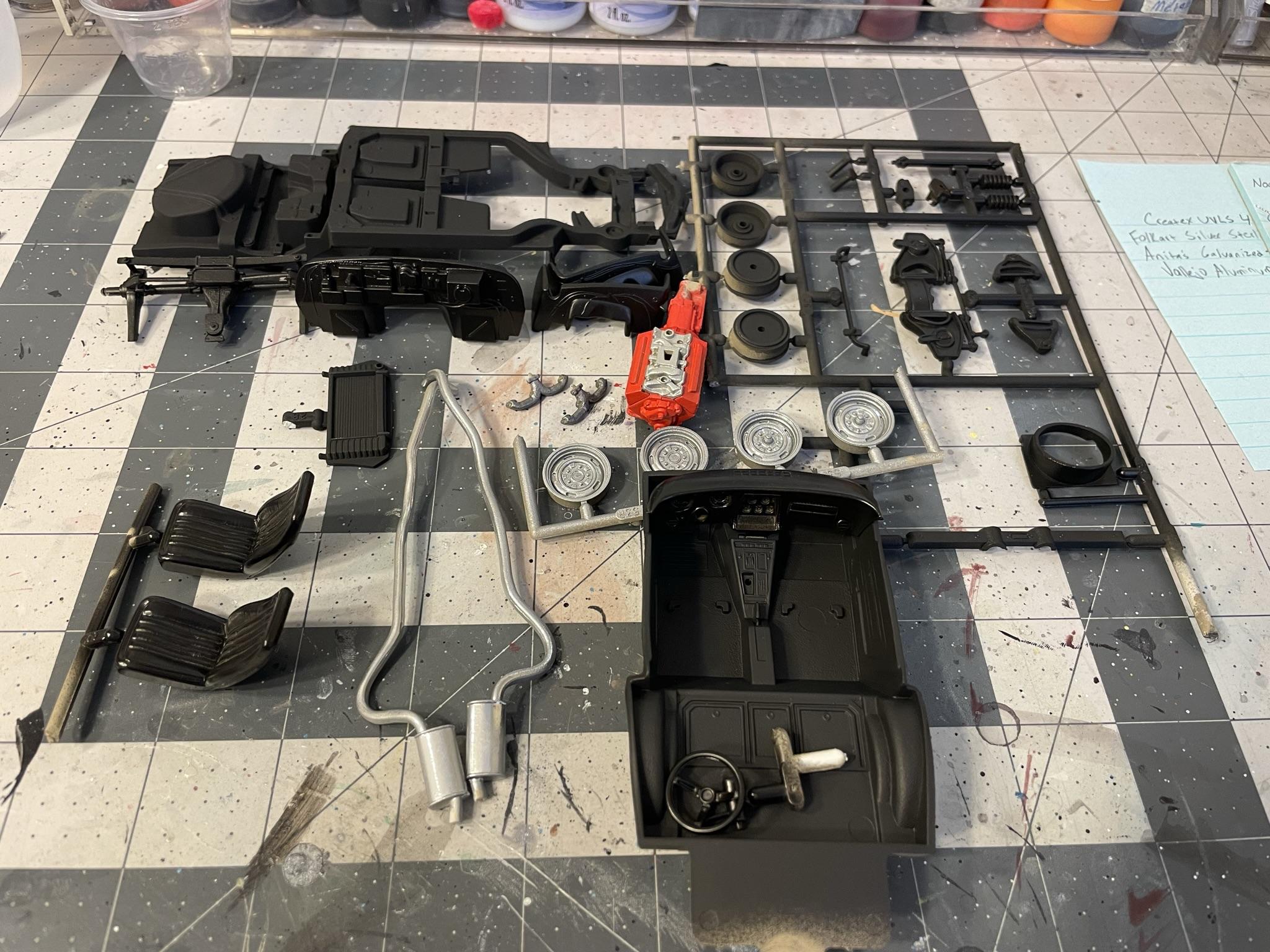

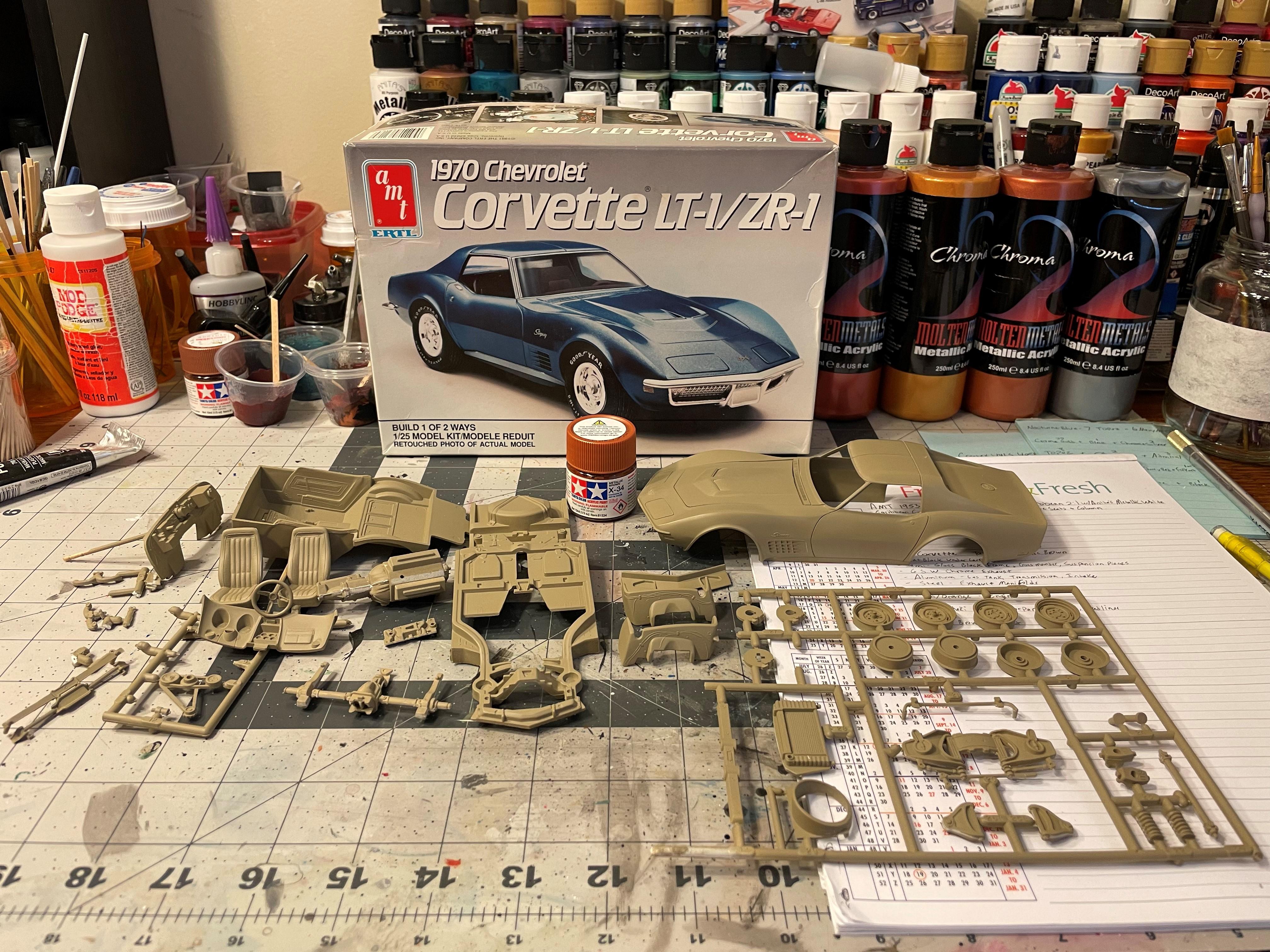

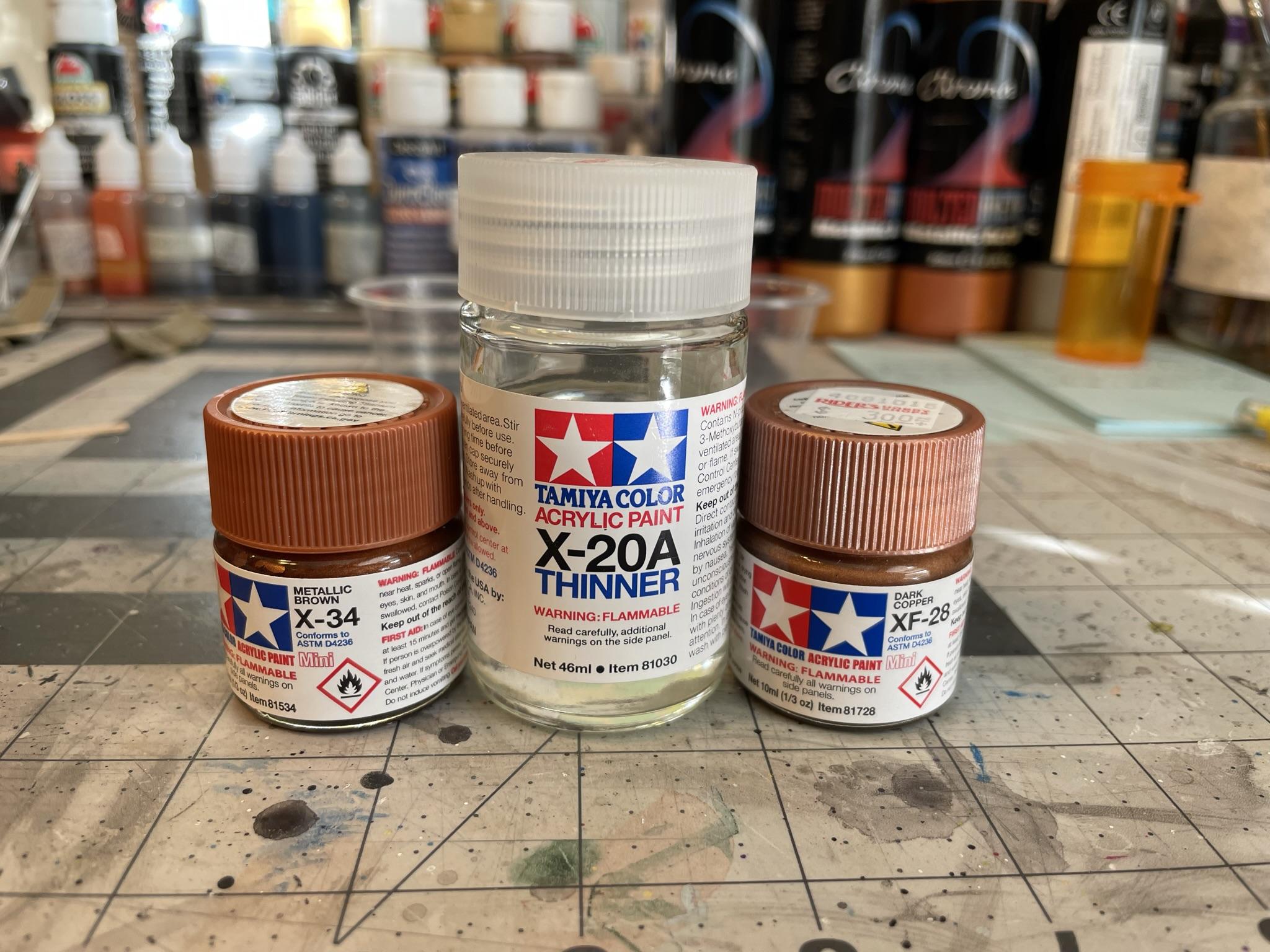

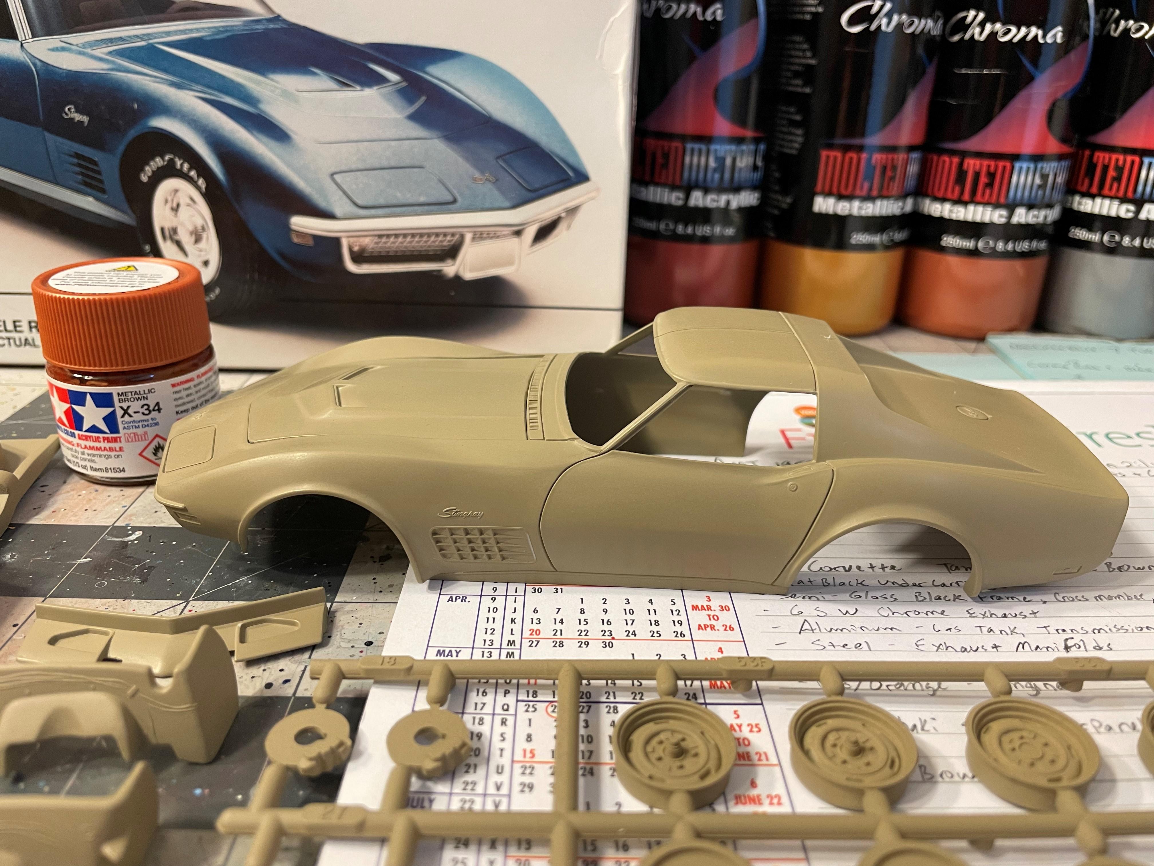

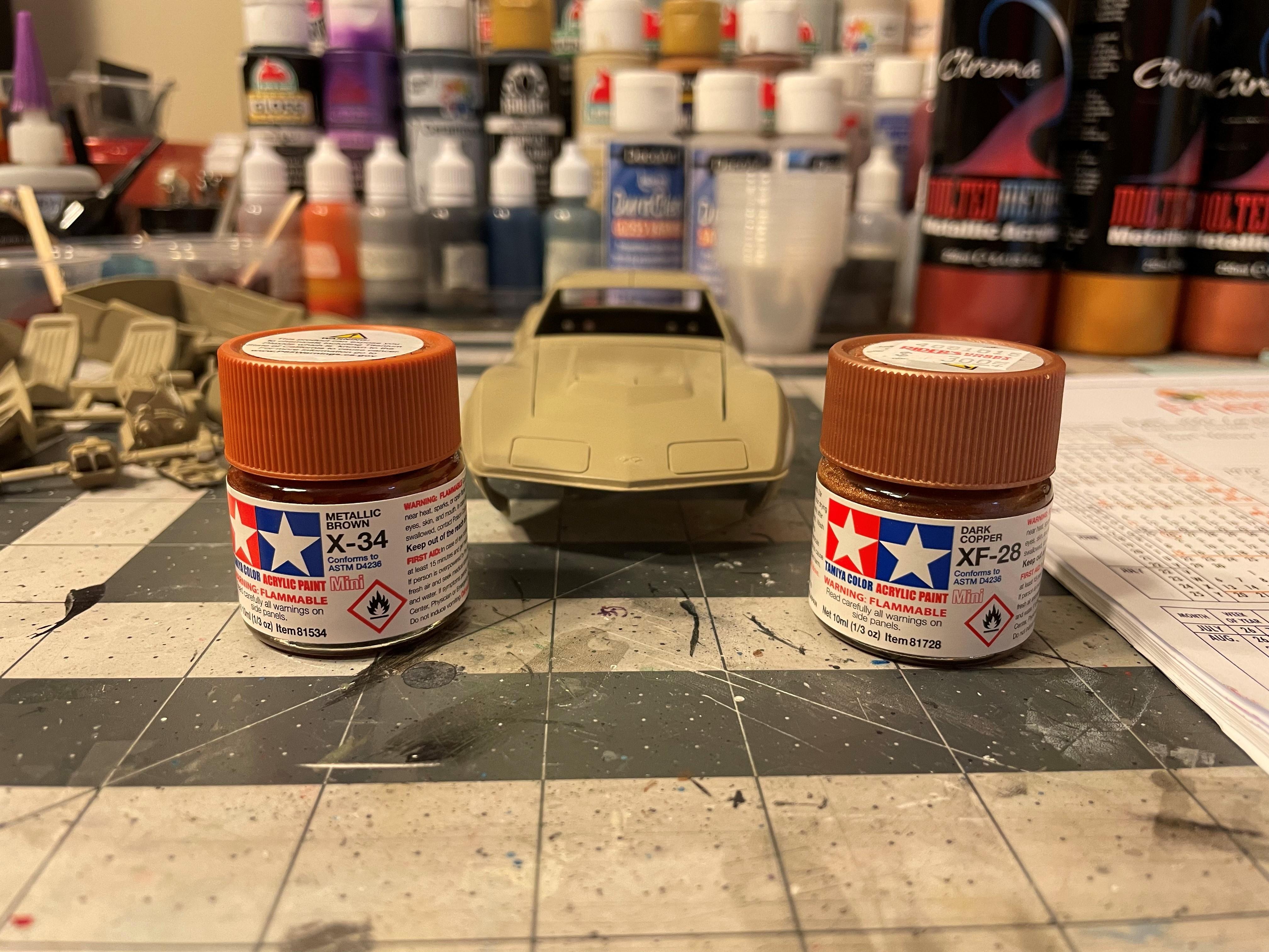

Dragonhawk1066 Posted October 26, 2022 Posted October 26, 2022 (edited) Up next will be the AMT 1970 Chevy Corvette LT-1. I had already done the prep work and washed the parts back in August. Then in September I primed everything using Rustoleum Camouflage Flat Tan. After about 2 weeks, I pulled out the body and gave it a wet-sand to smooth it out for paint, then put it back in the box until it's number was called. Today I put the engine halves together and added the water pump, heads, and oil pan to be painted together. I also put the rear end together as well as the seats. I then squeezed some Vallejo Putty on to fill the seams. The plan is to airbrush the Tamiya TS-34 Metallic Brown on, but I need to to a color comparison first because the more I look at the brown and the XF-28 Dark Copper, the more I wonder if they got mis-labeled. So I'm going to spray a silver and a gunmetal-ish basecoat on a couple of spare hoods, then spray the Brown and Copper on each one to see which is closest to what I'm looking for. Edited October 29, 2022 by Dragonhawk1066 color change. 1
khier Posted October 27, 2022 Posted October 27, 2022 I have never been happy with Tamiya acrylics for exterior. To me, the clear never get hard enough for proper polishing. They wouldn't accept solvent based clear on top either. Perhaps if it it is done very, very carefully.
Dragonhawk1066 Posted October 27, 2022 Author Posted October 27, 2022 11 hours ago, khier said: I have never been happy with Tamiya acrylics for exterior. To me, the clear never get hard enough for proper polishing. They wouldn't accept solvent based clear on top either. Perhaps if it it is done very, very carefully. This will be my first experience using them as an exterior color, I've only ever paint brushed them on smaller parts before. I plan on using Createx UVLS 4050 Gloss Clear, so hopefully I get the same results I have been getting with that clear.

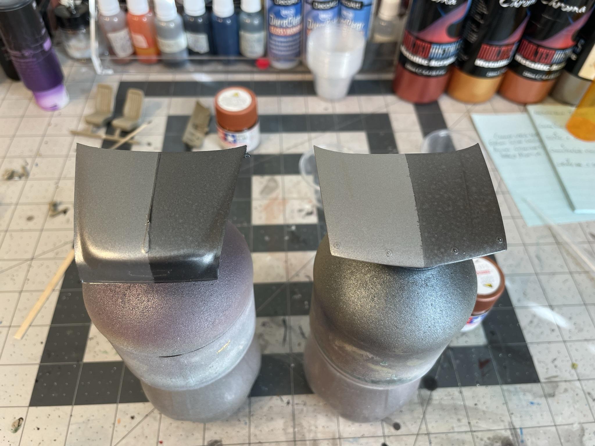

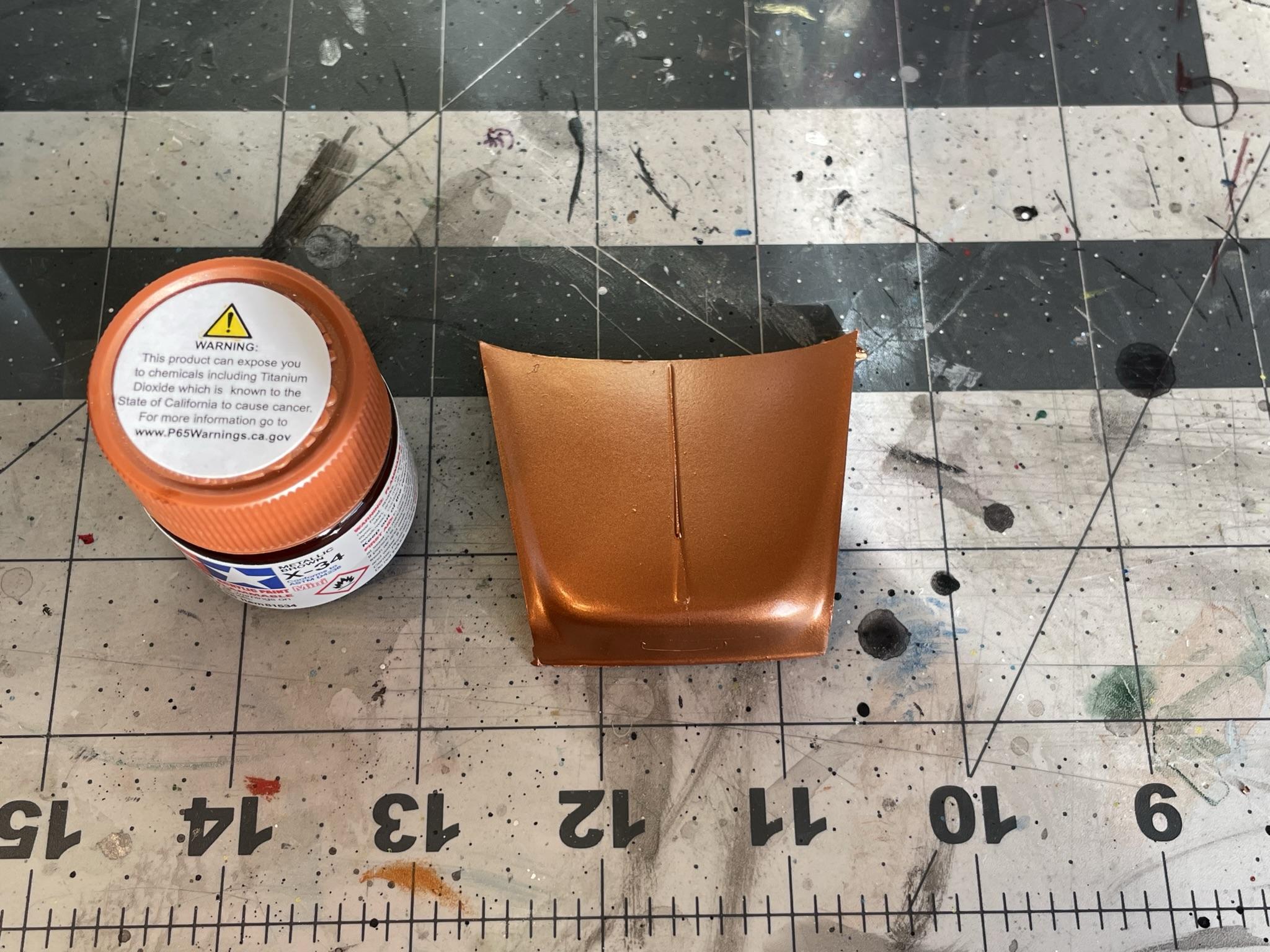

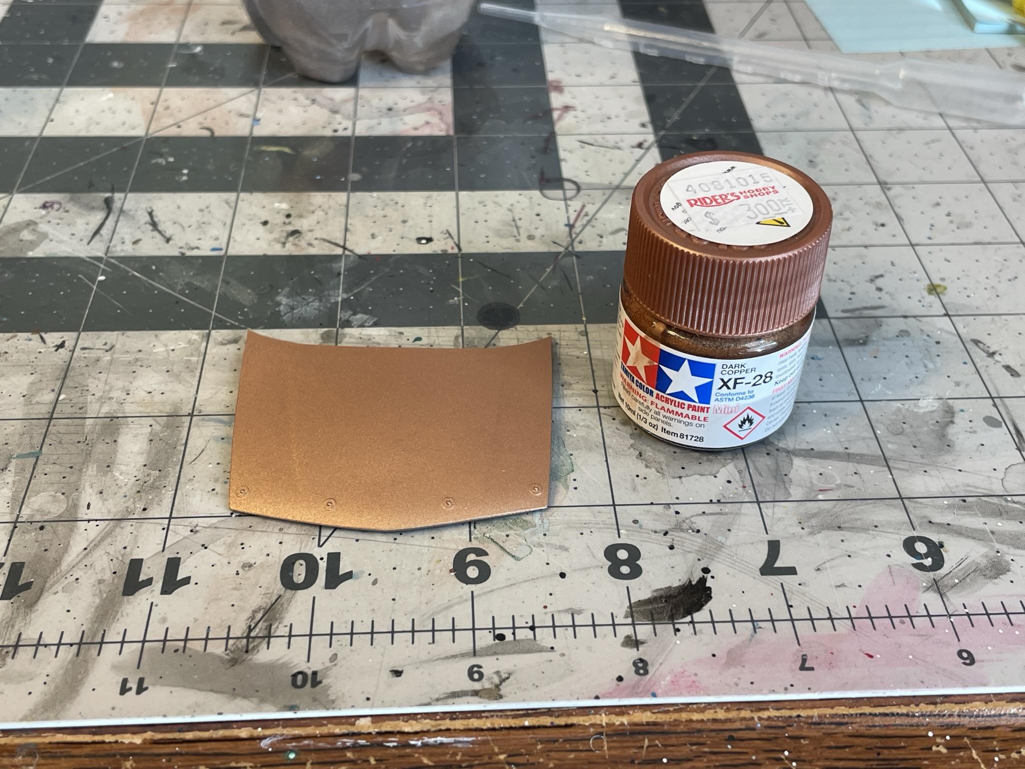

Dragonhawk1066 Posted October 27, 2022 Author Posted October 27, 2022 I did the paint comparison today. I started by spraying two hoods 1/2 and 1/2 with a silver and a charcoal gray. I then mixed each color 50/50 with Tamiya X-20A acrylic thinner. I sprayed the XF-28 Dark Copper first using 4 light-medium coats. It could've used a couple more coats, but I didn't mix enough. I was surprised to see no difference between the lighter and darker basecoats, as Tamiya metallics in the spray cans really changed with basecoat color. On to the X-34 Metallic Brown, which I did mix a little more of. I started the same, 4 light-medium coats, then sprayed on 2 more medium-heavy coats to add more depth. This color showed a very small difference in depth from light to dark basecoat, but not enough to really make a difference. This is pretty much the color I'm after, although I may add a drop or two of black to darken it just a tad. The last pic is the actual car I'm trying to replicate. 4

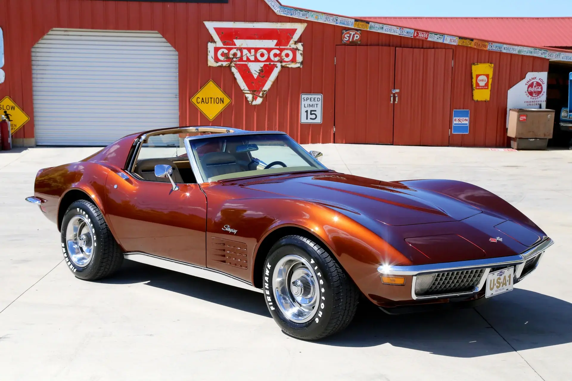

TransAmMike Posted October 28, 2022 Posted October 28, 2022 Well Craig, sure hope you can get the exact color. I would think you could only tell how close it is to that real C3 with clearing. That is one beautiful example of the '71 you are replicating, Good luck!!

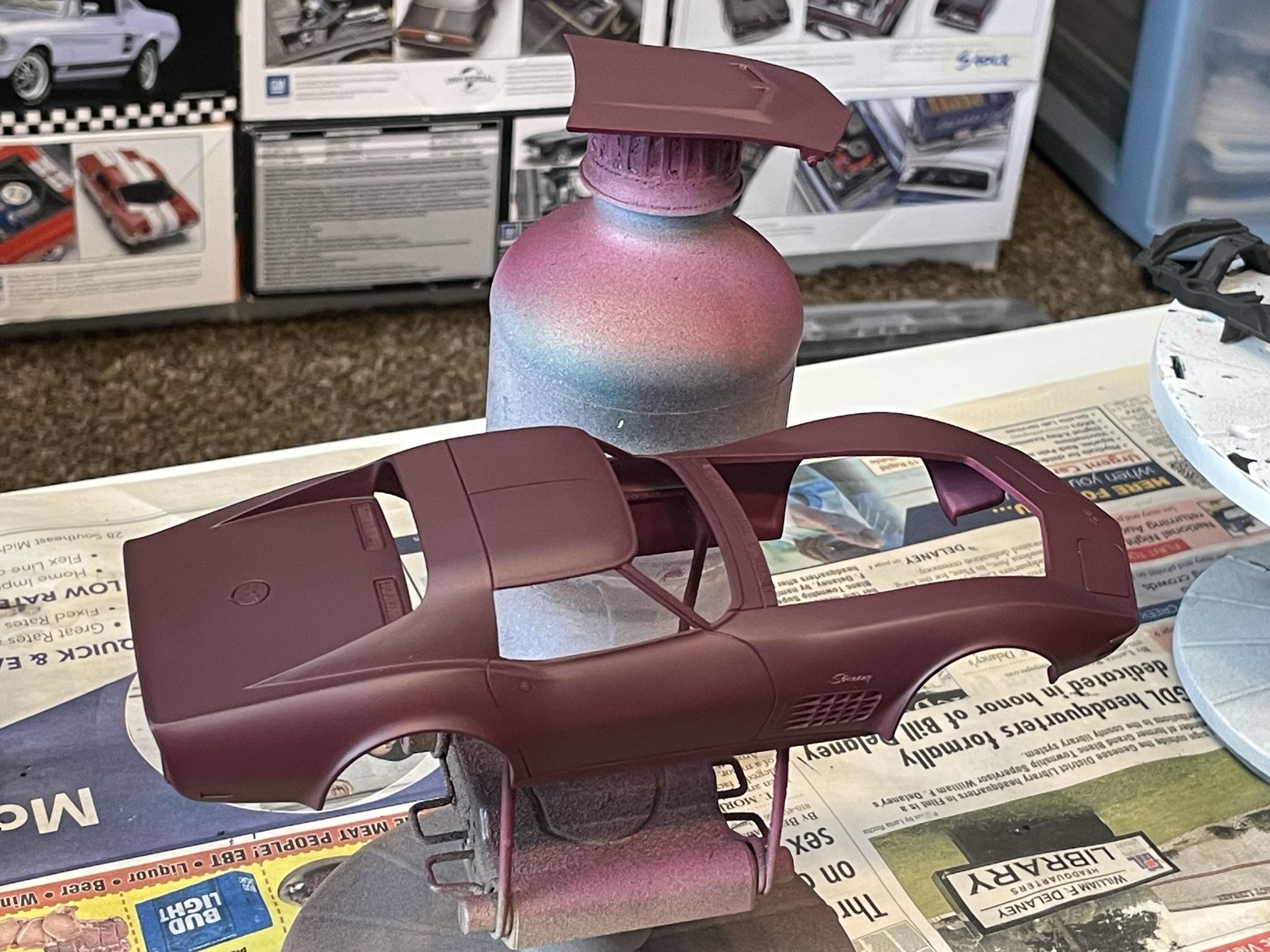

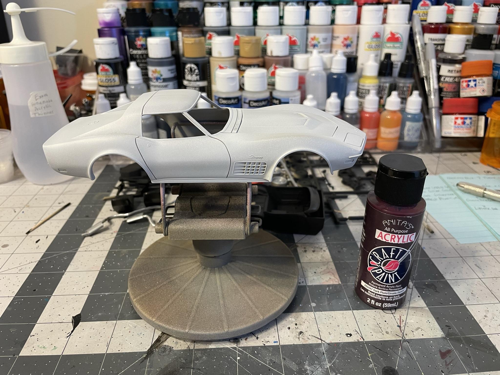

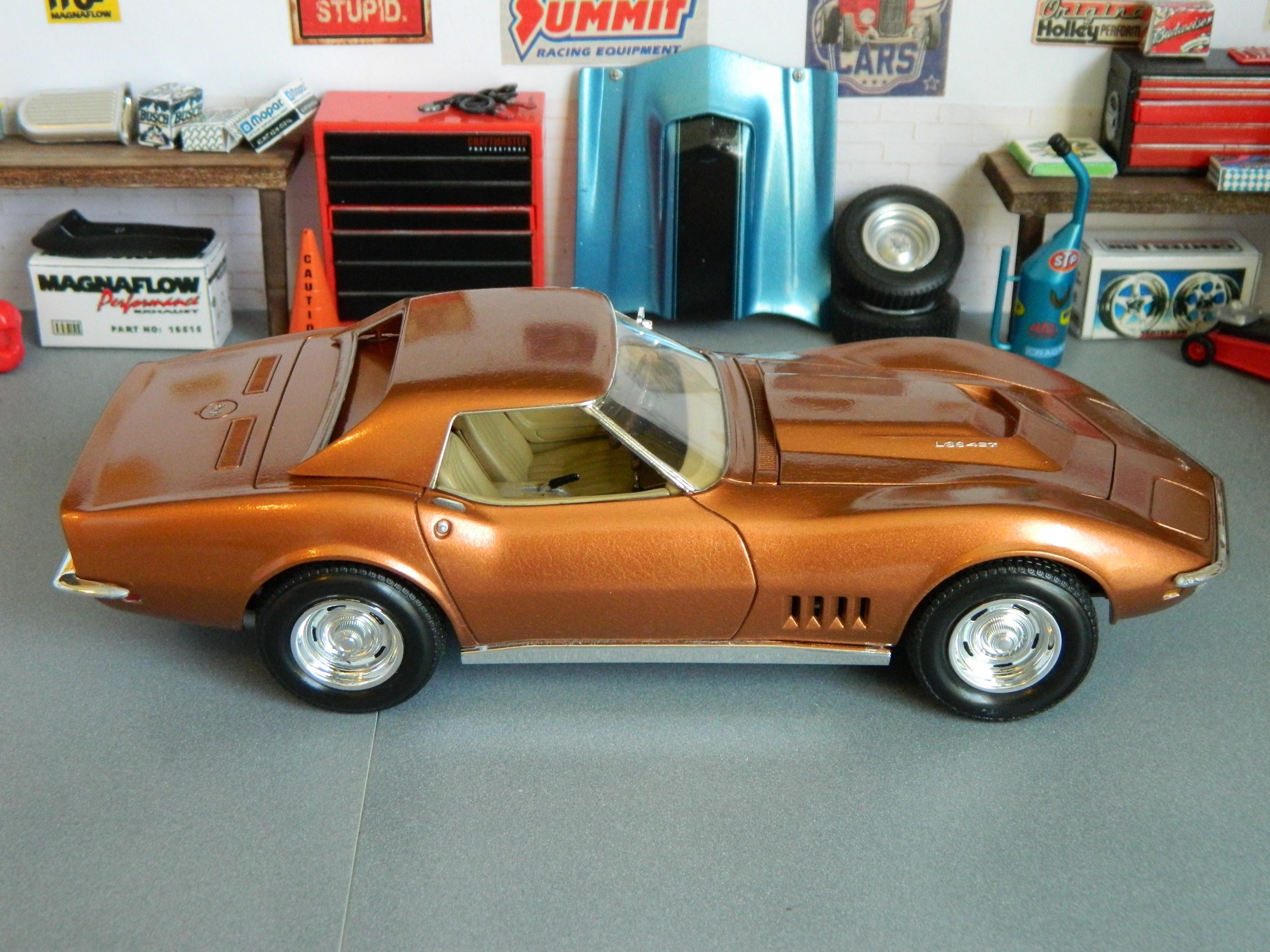

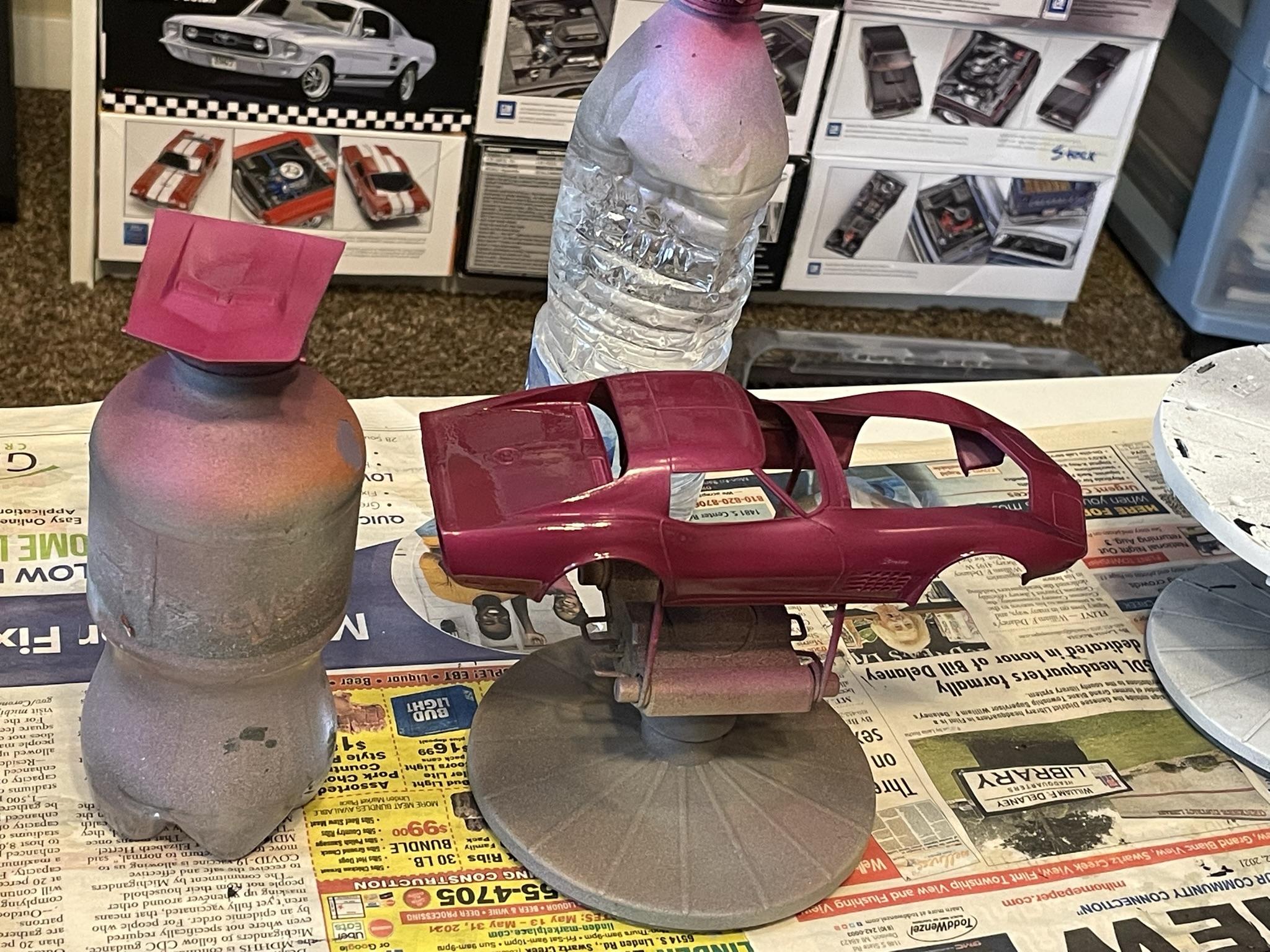

Dragonhawk1066 Posted October 28, 2022 Author Posted October 28, 2022 (edited) While I really wanted to replicate the brown Vette, I realize that it will just look too similar to the '68 I built in November of 2019 (first pic), even though I will be re-doing that one in a different color due to the clear cracking. That's why my plan was to go ahead and paint this one Brown, but after seeing the paint comparison results I decided that I needed to come up with a different color. My first instinct was the Silver that I planned to use as a basecoat. Red and Maroon were serious color possibilities as well with a Dark Plum color as a dark horse candidate. My wife was really drawn to the Dark Plum, so I sprayed a spare hood to see how it would look, and really liked the result. I ended up spraying a couple of light coats of Stynylrez white primer over the previous tan primer on the body to stay consistent with my test spray. I'm glad I hadn't sprayed the interior in the Khaki and brown yet, so the flat black and semi-gloss black were sprayed over the tan primer. Body color pics tomorrow, hopefully. Edited October 28, 2022 by Dragonhawk1066 2

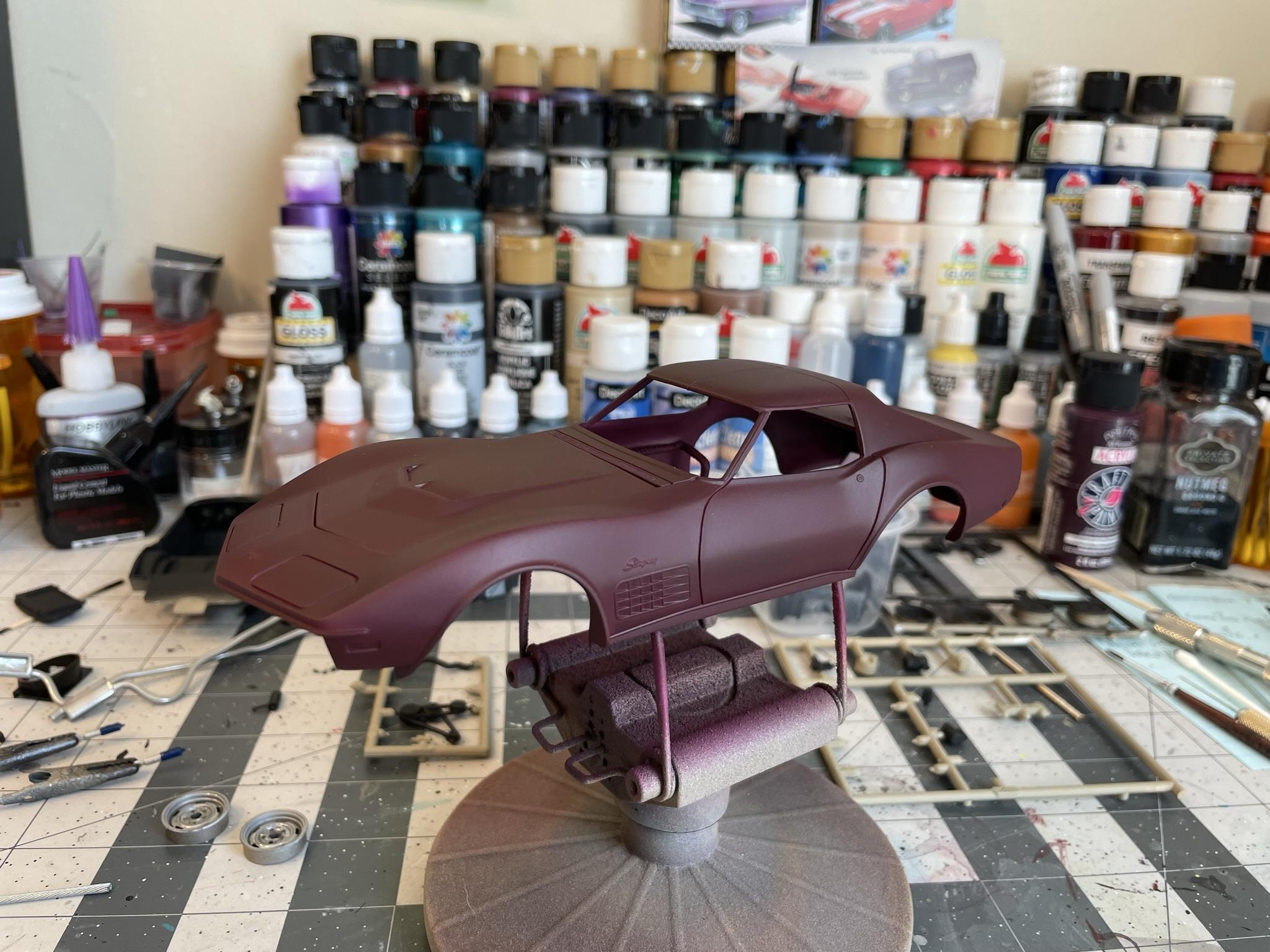

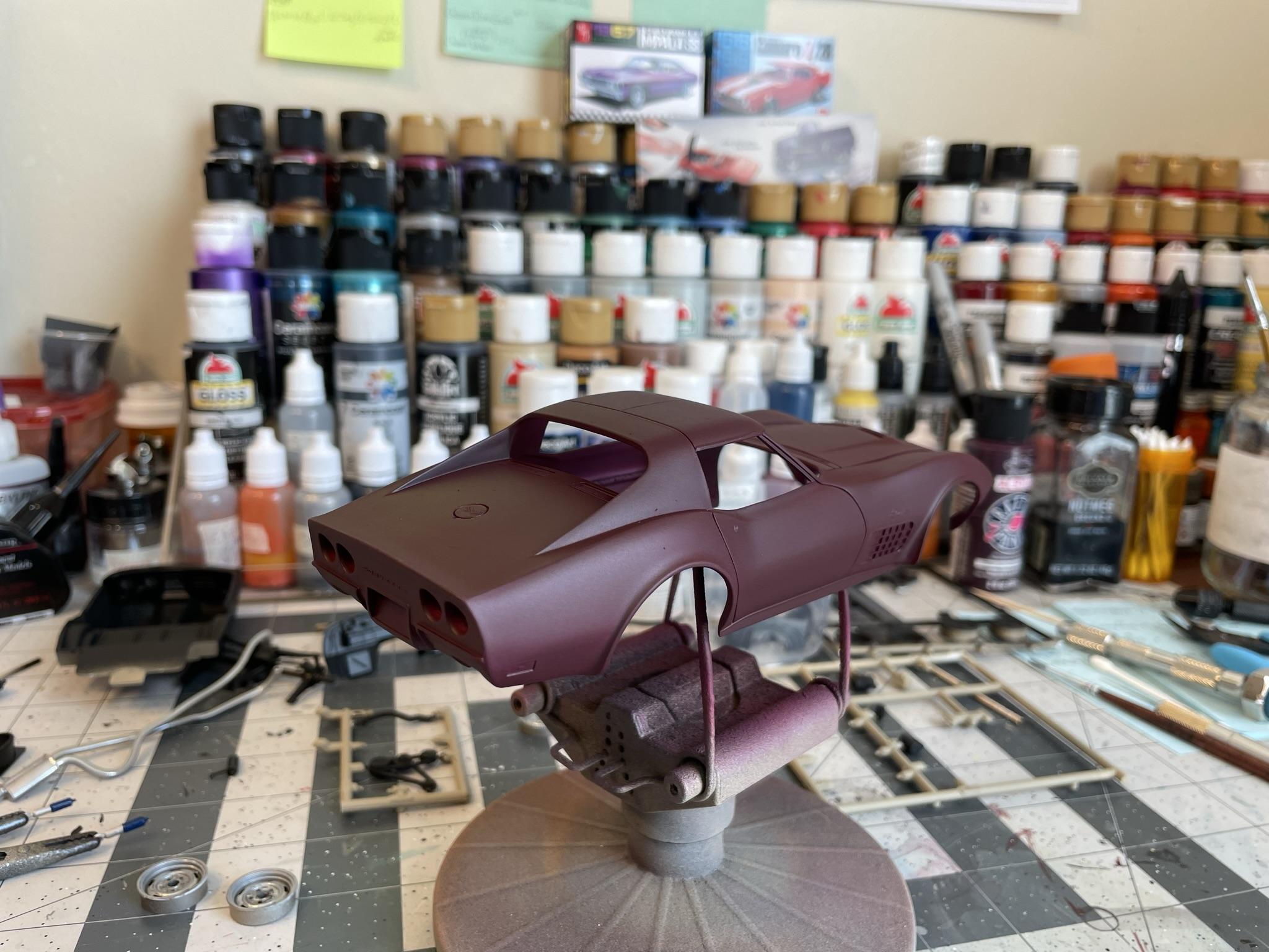

Dragonhawk1066 Posted October 29, 2022 Author Posted October 29, 2022 I got the paint sprayed on this morning. I used Anita's Dark Plum, thinned and sprayed through my airbrush. It took a total of 2 light, 4 medium, and 2 heavy coats to get even coverage and the tone I wanted. It surprised me how tricky it was to get the even coverage with how dark the color is. First pic is after 2 light coats, second after 2 light and 2 medium, and then the final color. It'll sit the rest of today and tomorrow before I get the Createx UVLS 4050 Gloss Clear sprayed on hopefully Monday. I'm kind of excited to see the kind of depth the clear will give it. 6
kelson Posted October 29, 2022 Posted October 29, 2022 After your final color coat, it looks alot like Marlboro Maroon.? 2
Dragonhawk1066 Posted October 30, 2022 Author Posted October 30, 2022 23 hours ago, kelson said: After your final color coat, it looks alot like Marlboro Maroon.? Yeah, I was hoping for that deep burgundy/purplish look.
LL3 Model Worx Posted October 30, 2022 Posted October 30, 2022 On 10/27/2022 at 7:39 PM, Dragonhawk1066 said: Is that picture from Smoky mountain traders? If so that's right down the road from my house ?
Dragonhawk1066 Posted October 31, 2022 Author Posted October 31, 2022 23 hours ago, LL3 Model Worx said: Is that picture from Smoky mountain traders? If so that's right down the road from my house ? Yes it is. I'd probably drive by that place every day if I lived that close, LOL
