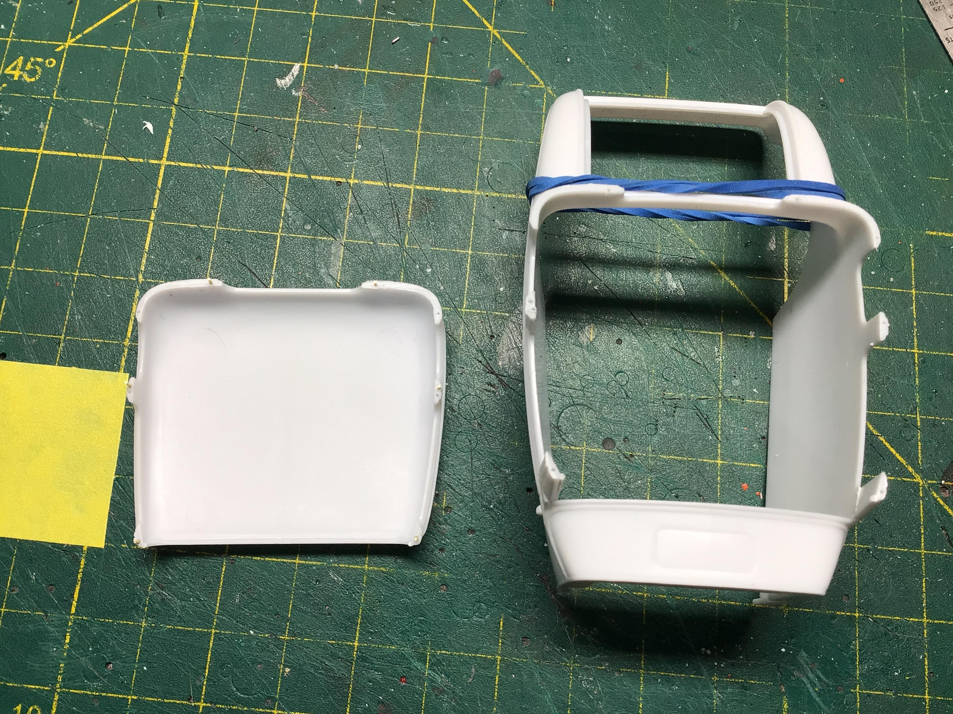

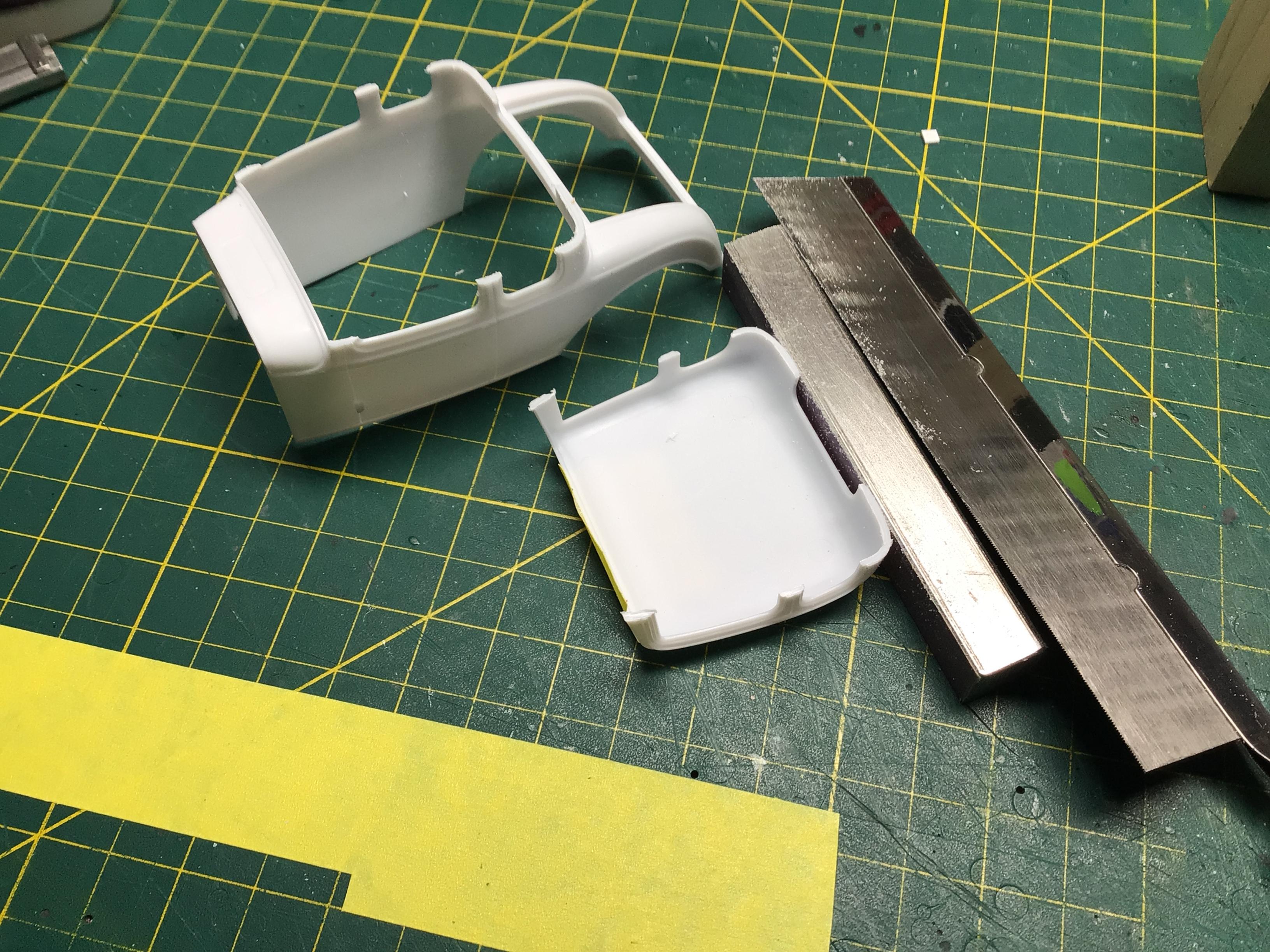

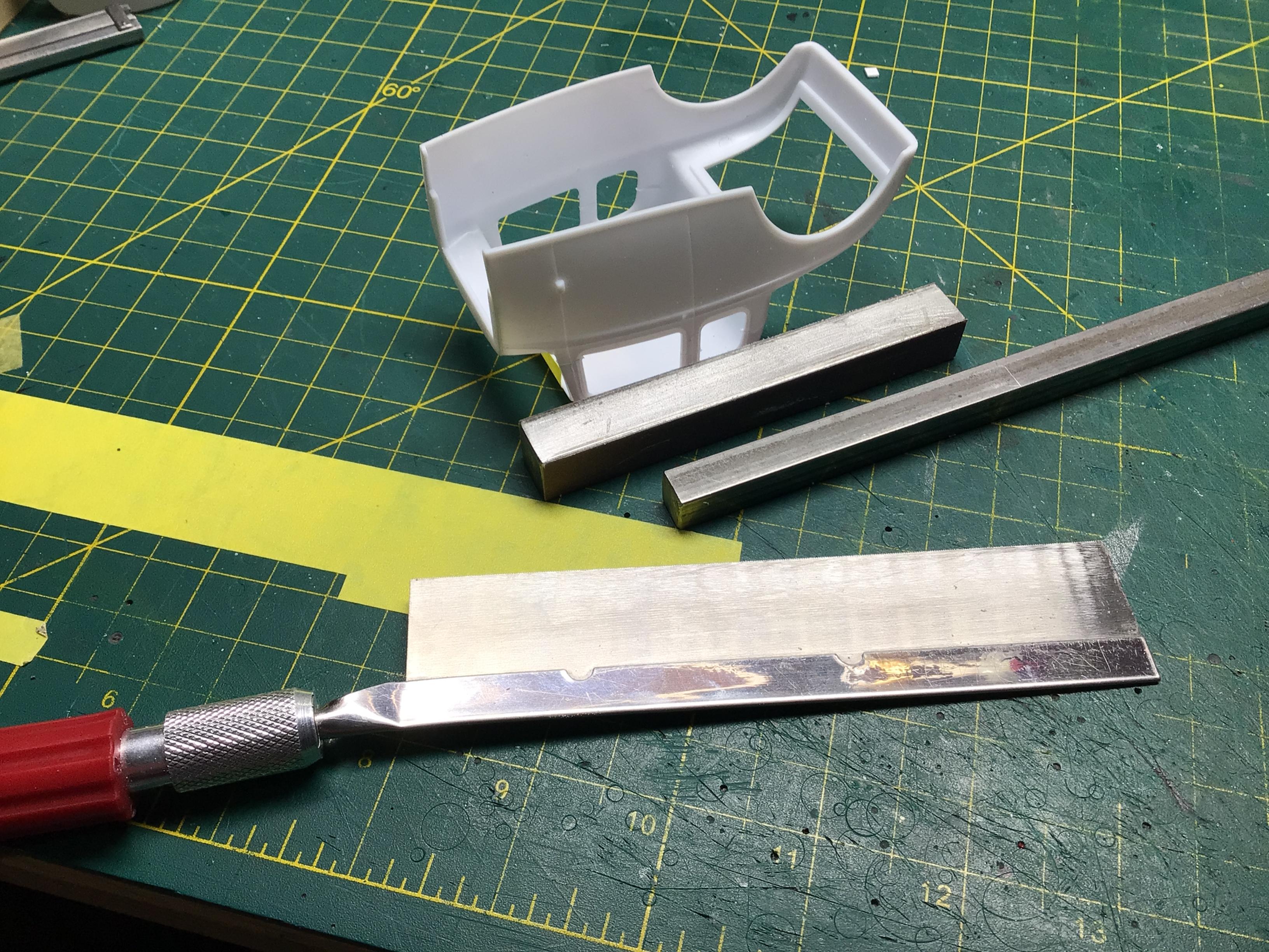

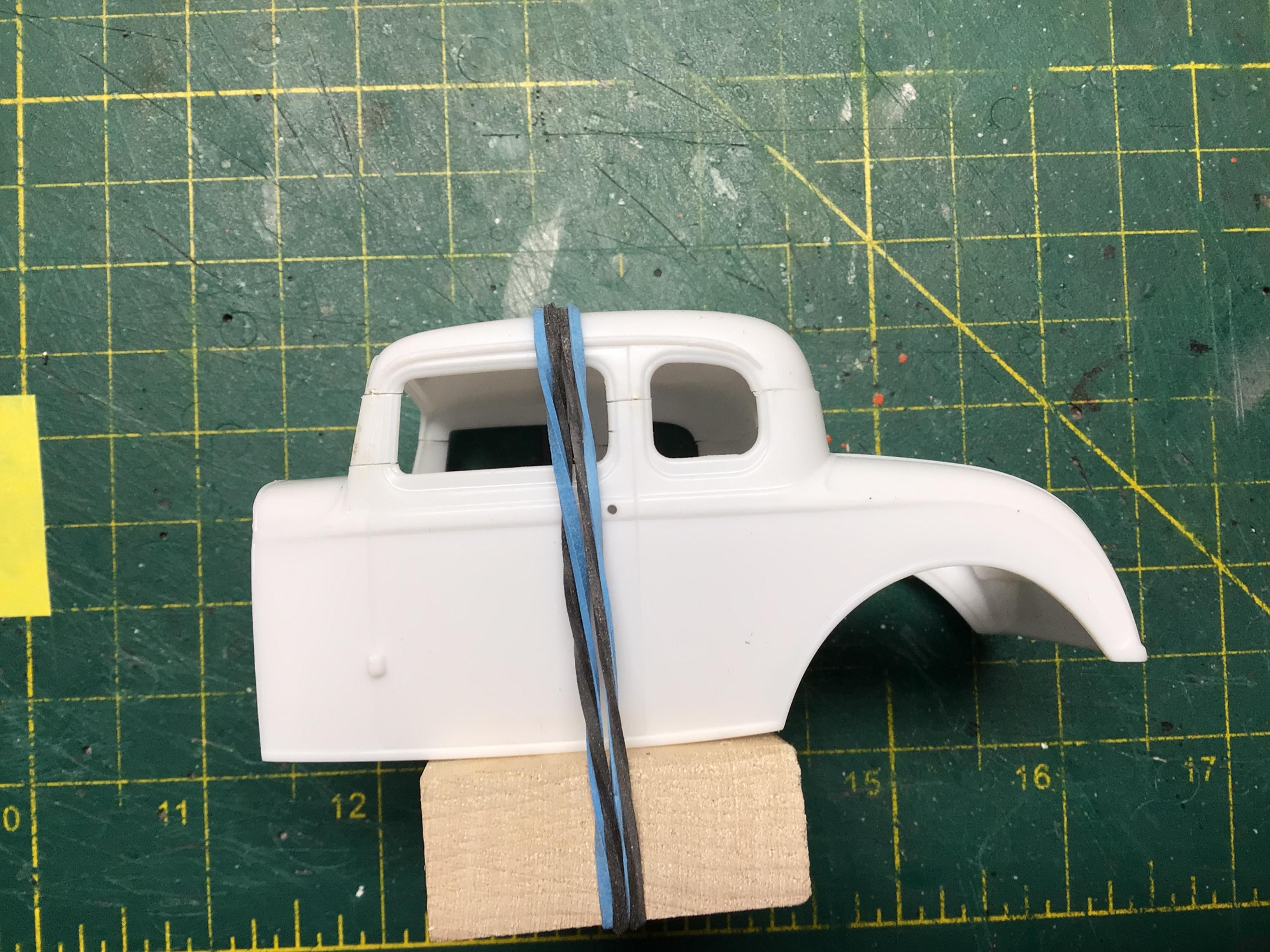

NOBLNG Posted October 29, 2022 Posted October 29, 2022 (edited) I’m not entirely sure yet what all I want to do to this one. I am chopping it and tubbing it for sure. I don’t know if I am going with or without fenders yet. I had fun chopping my last one, but I broke the A pillars while fiddling with it, so this time I pinned everything. I also cut out the entire A pillar and shortened it to fit the after-chop gap. I aligned the B pillar this time so I won’t need all the “sprue glue” that I used last time. A bit of shaping and a touch of putty should clean it up. Thanks for watching, and all comments welcomed as always.? Edited November 14, 2022 by NOBLNG 7
Zippi Posted October 29, 2022 Posted October 29, 2022 That little Hot Rod is looking pretty sharp so far Greg.

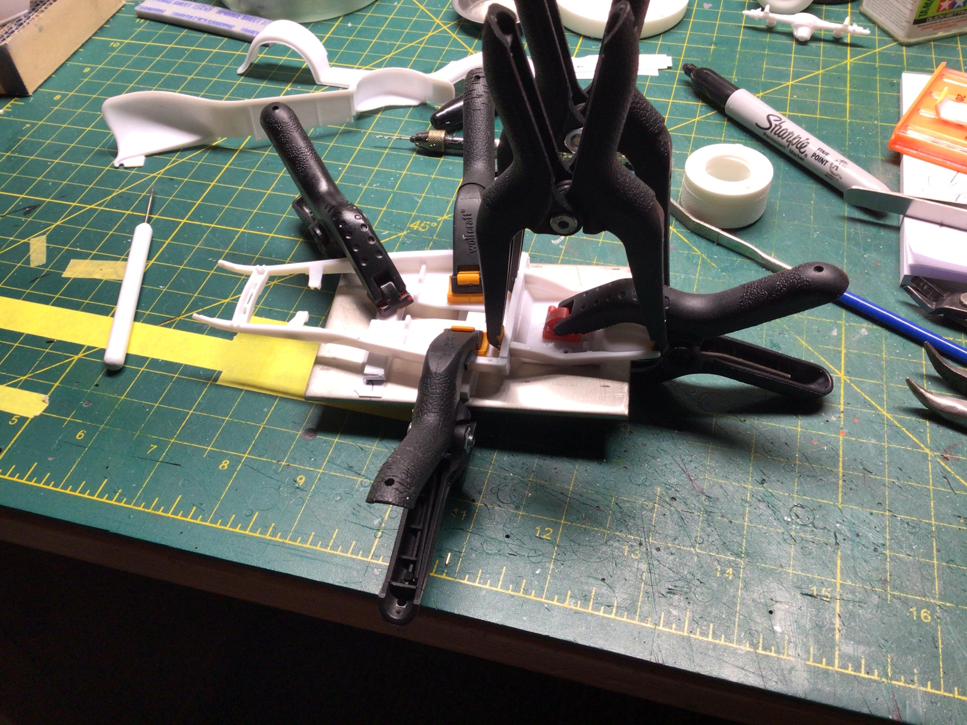

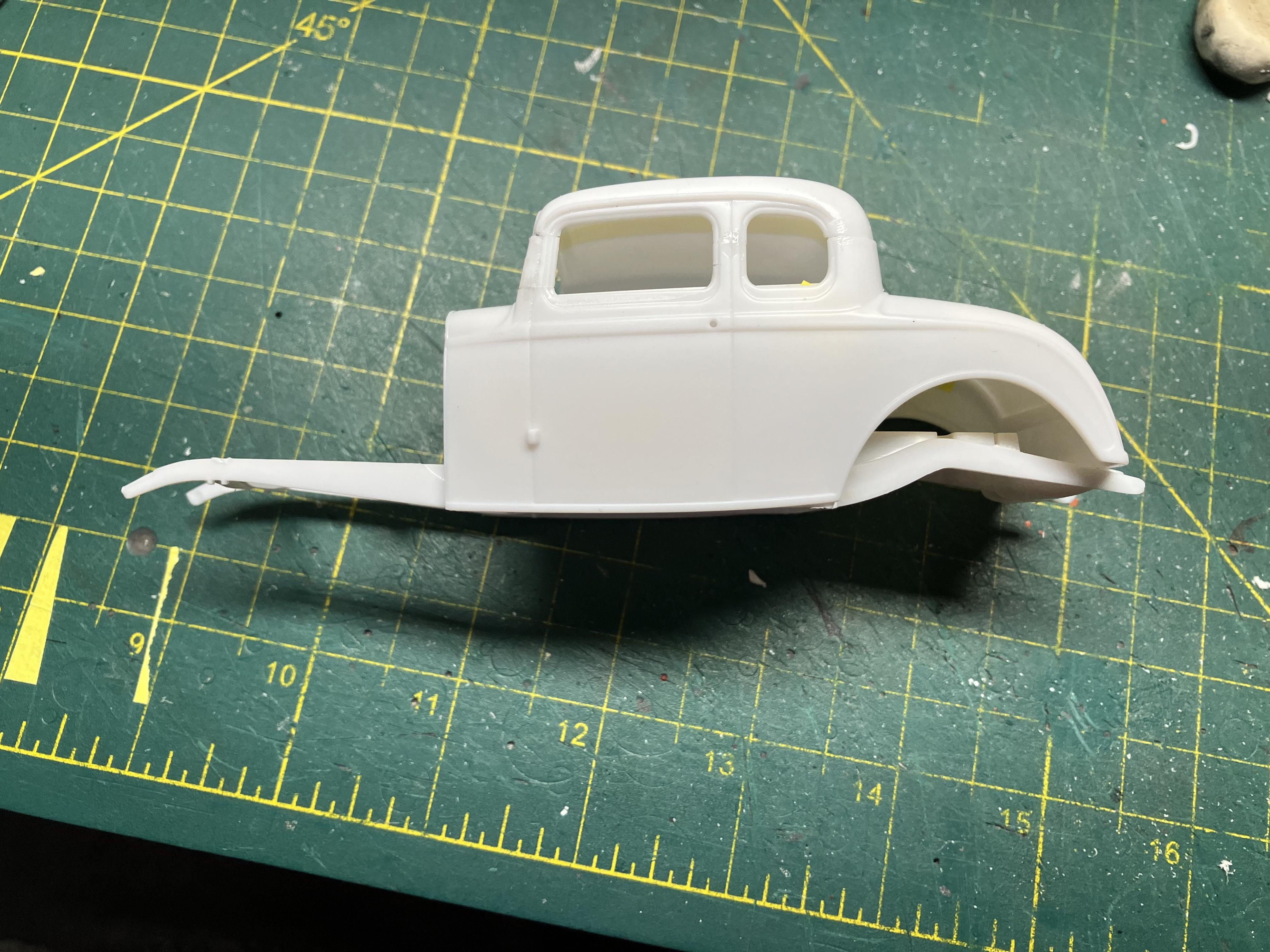

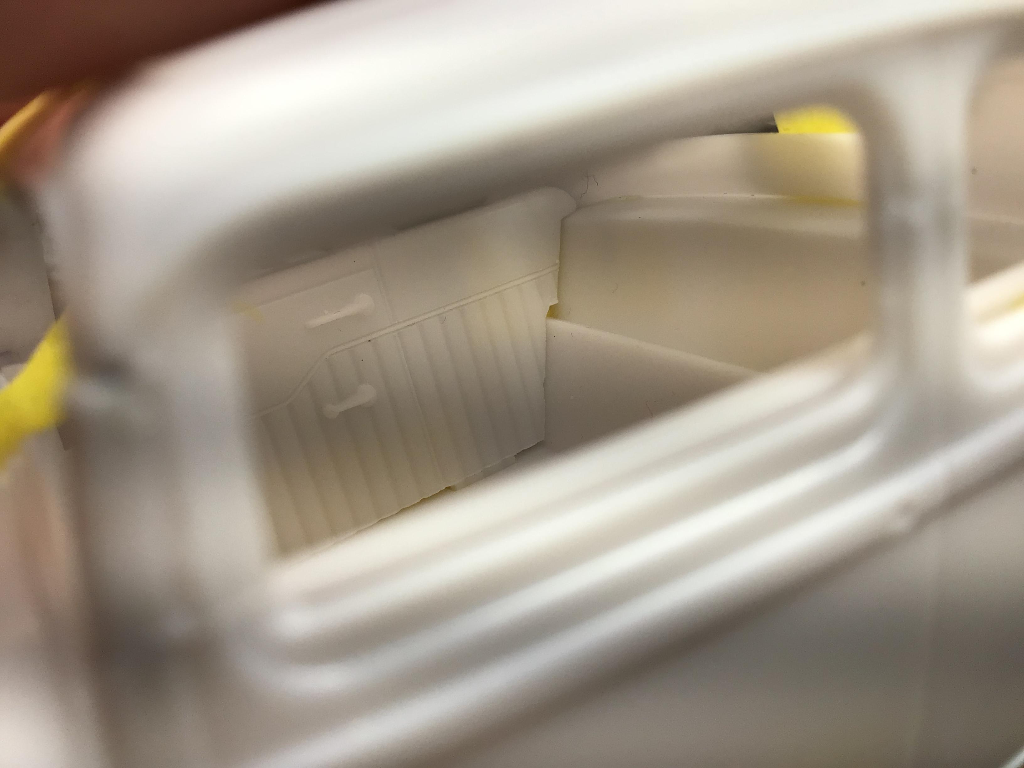

NOBLNG Posted October 29, 2022 Author Posted October 29, 2022 Decided to channel it slightly while I’m at it. 6

John06 Posted October 30, 2022 Posted October 30, 2022 6 hours ago, NOBLNG said: Decided to channel it slightly while I’m at it. What does channeling mean?
NOBLNG Posted October 30, 2022 Author Posted October 30, 2022 (edited) 6 hours ago, Ace-Garageguy said: I expected to see one going through the wood chipper. I was sure tempted to do that with the Skip’s ‘55 chevy I was working on.? 1 hour ago, John06 said: What does channeling mean? Channeling is basically raising the floor and dropping the body down over the frame in order to get a lower stance. It seems pretty simple, but this is my first attempt at it so I hope I don’t run into issues. Edited October 30, 2022 by NOBLNG 1

ea0863 Posted October 30, 2022 Posted October 30, 2022 Greg, your chopped roof looks like the way it should have come from the factory to begin with. Perfectly done IMHO - - - not too much, not too little!

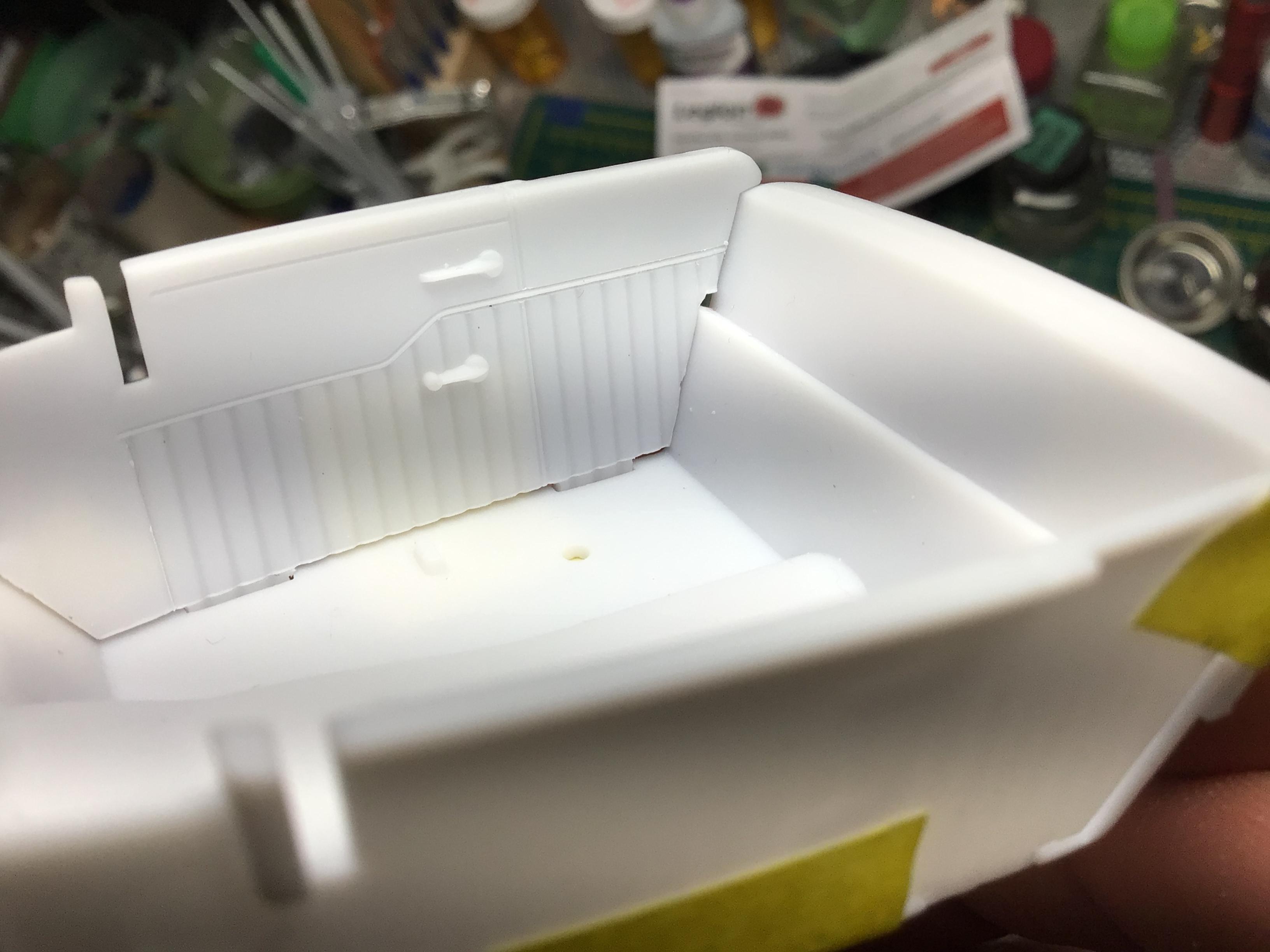

Mr. Metallic Posted October 31, 2022 Posted October 31, 2022 You're off to a good start. The proportion of the chop looks right on! Nice job sectioning the interior too. Retaining the portion of the side panels as a tab on the bottom is a smart move, one that I have used as well. Critical for keeping the side panels in the right spot. 2
customline Posted November 1, 2022 Posted November 1, 2022 I like what you did with the A pillar. Makes for a smoother transition. Breaking them didn't hurt you at all. I wish I'd thought of it! Nice work, Greg. It'll be a "good one" (there's "good ones" and then there's "not so good ones" in my house.) Looks well thought out and and masterfully butchered ?
Bullybeef Posted November 1, 2022 Posted November 1, 2022 I’ve found that on the ones that I have channelled, attaching the interior side panels to the body and not the floor will let you slide the body down without having to cut the panels try it out with some masking tape first to make sure it will work for you. 1
NOBLNG Posted November 1, 2022 Author Posted November 1, 2022 8 hours ago, customline said: I like what you did with the A pillar. Makes for a smoother transition. Breaking them didn't hurt you at all. I wish I'd thought of it! Nice work, Greg. It'll be a "good one" (there's "good ones" and then there's "not so good ones" in my house.) Looks well thought out and and masterfully butchered ? Thanks Jim. Yes, cutting the entire A pillar out this time (two cuts) worked much better than taking a chunk out and leaning the stubs forward and backwards (three cuts).

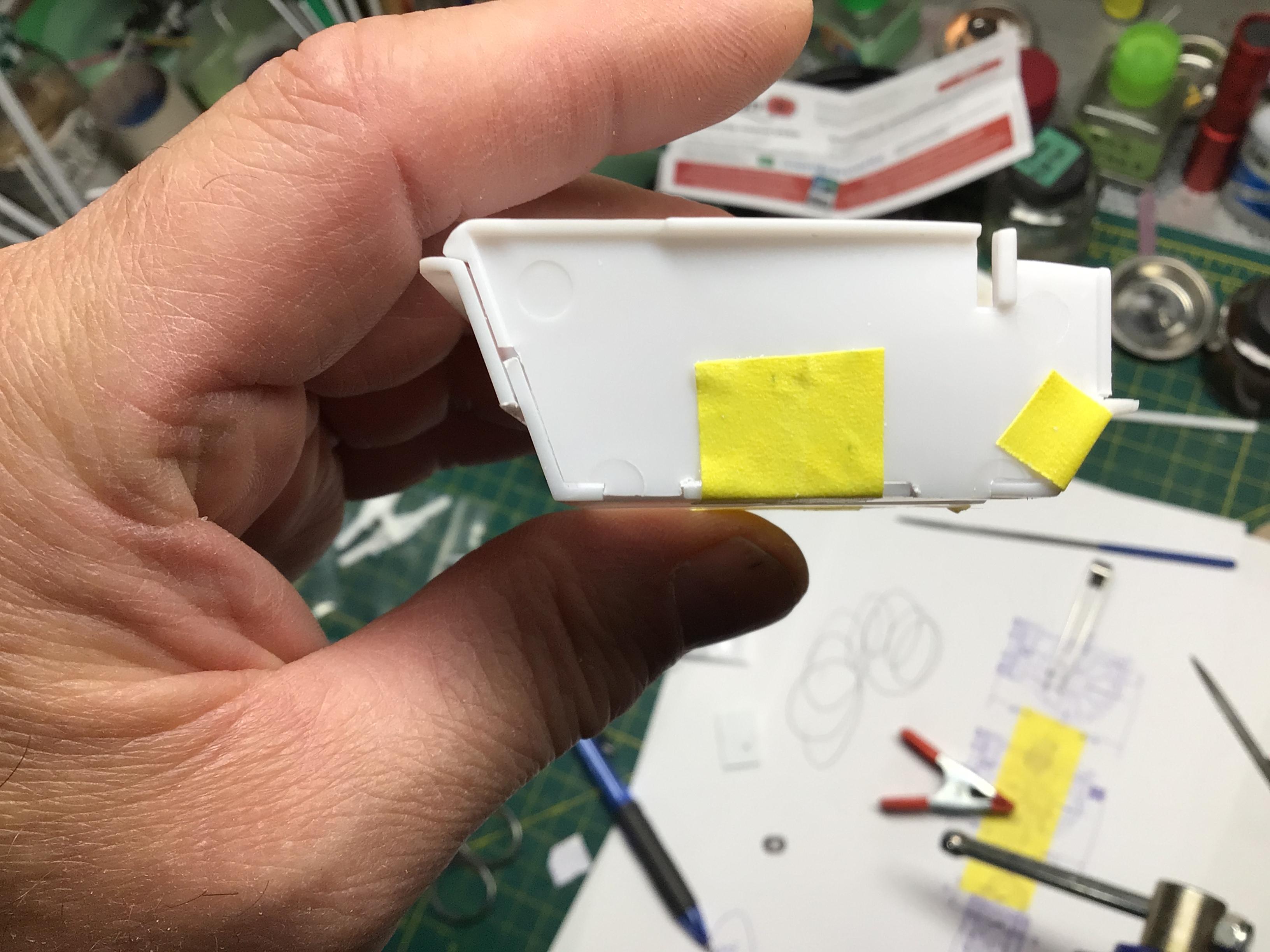

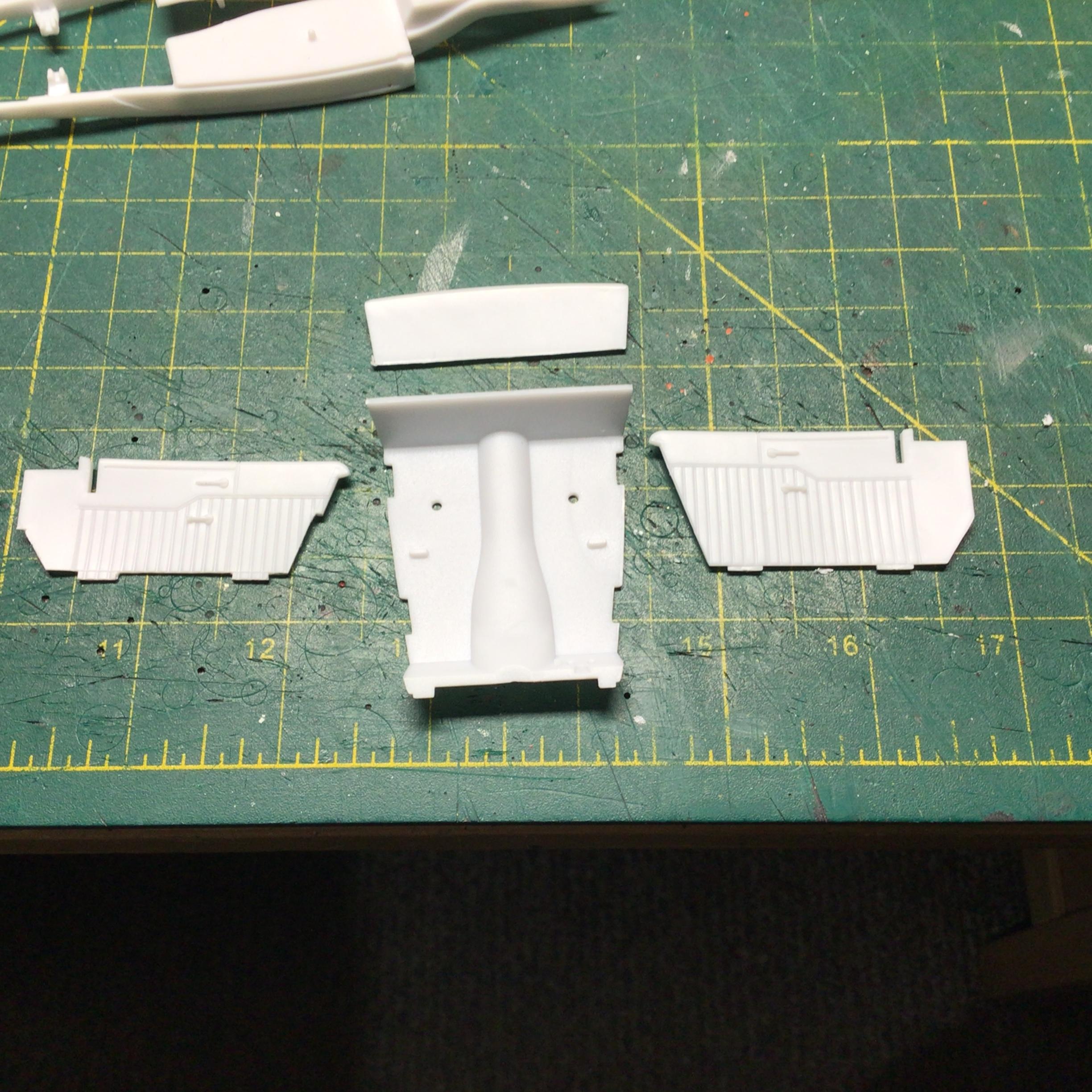

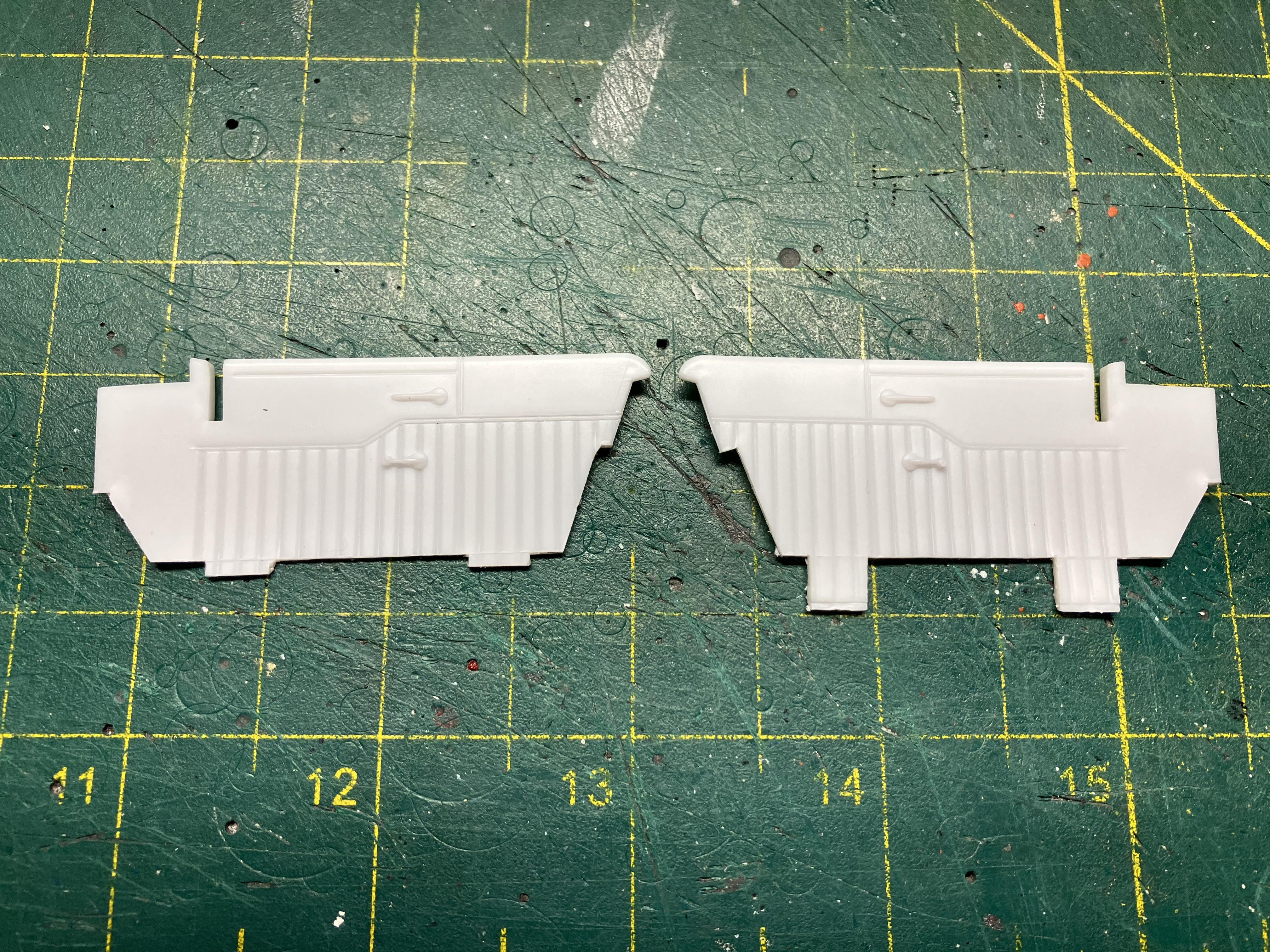

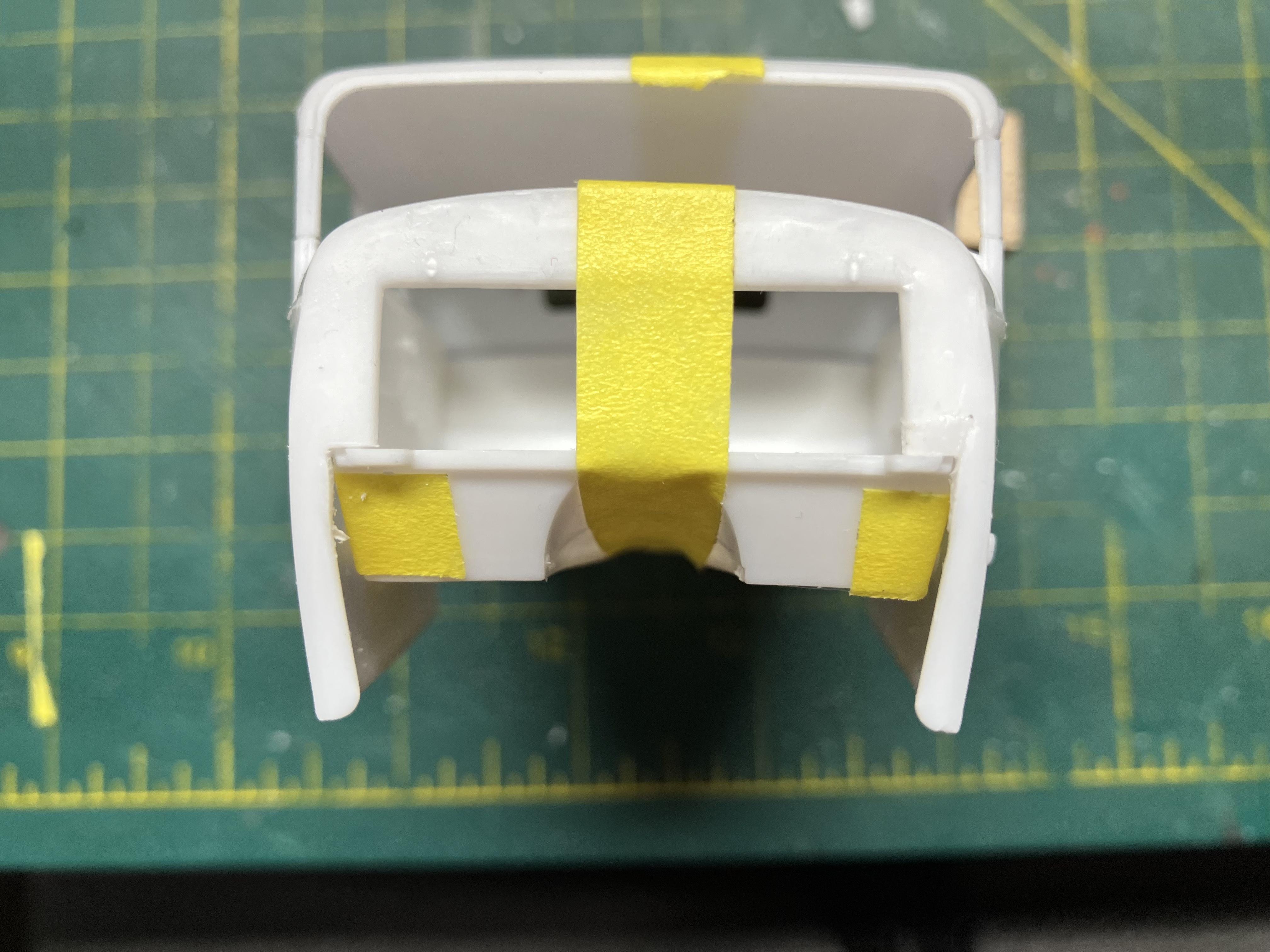

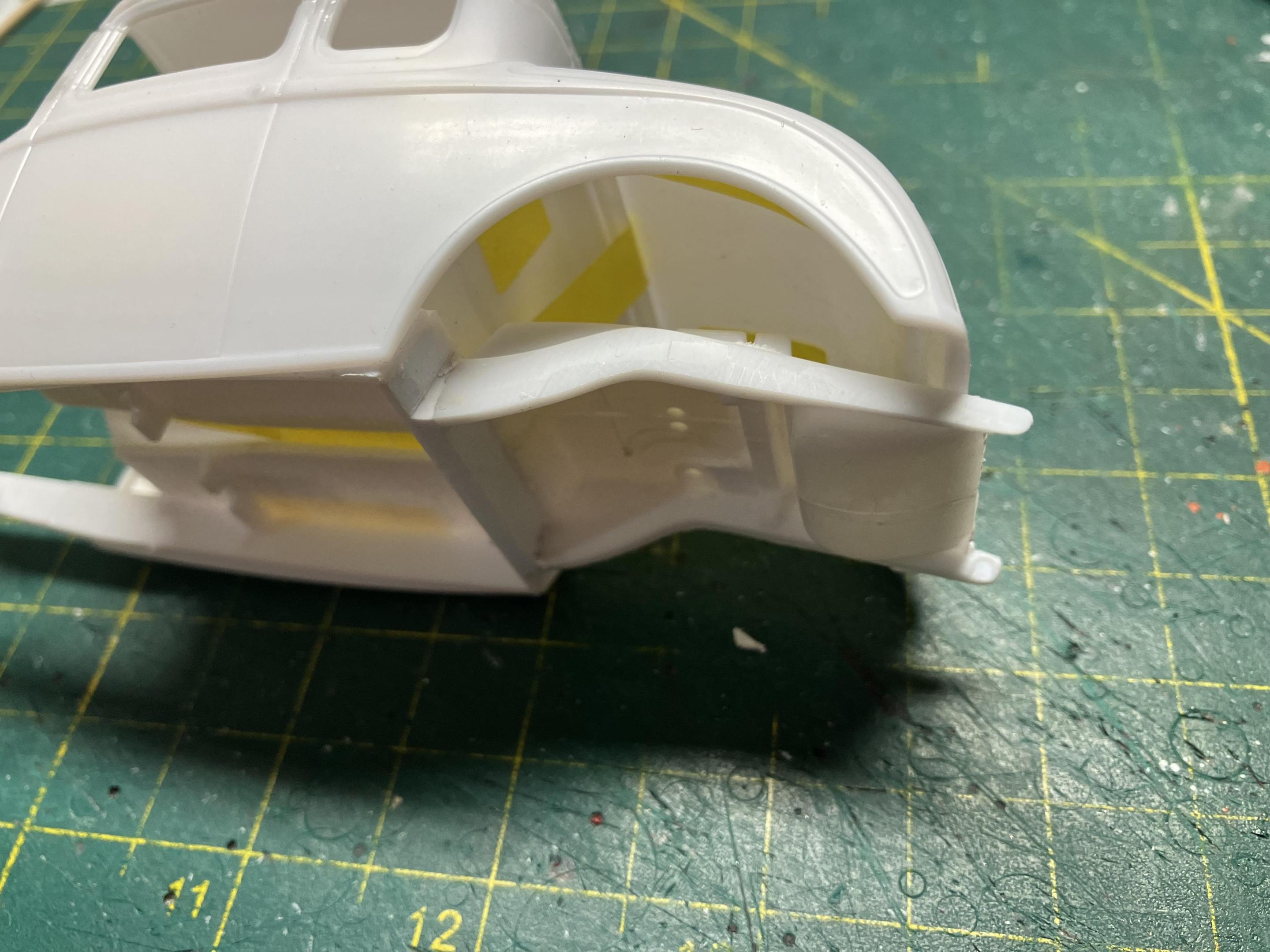

NOBLNG Posted November 1, 2022 Author Posted November 1, 2022 (edited) 21 hours ago, Mr. Metallic said: You're off to a good start. The proportion of the chop looks right on! Nice job sectioning the interior too. Retaining the portion of the side panels as a tab on the bottom is a smart move, one that I have used as well. Critical for keeping the side panels in the right spot. This is my first attempt at channeling and I think I lucked out on it. The tabs do help! I raised the floor approximately 1/4” and it just works out that the rear panel can be split in the middle and lapped. The bottom section moves up with the floor, and the top moves down with the door panels. The door panels need to be re-notched to fit inside the floor pan, but the floor can be set on the new tabs and used as a template for the notches. Edited November 1, 2022 by NOBLNG 1
NOBLNG Posted November 1, 2022 Author Posted November 1, 2022 7 hours ago, Bullybeef said: I’ve found that on the ones that I have channelled, attaching the interior side panels to the body and not the floor will let you slide the body down without having to cut the panels try it out with some masking tape first to make sure it will work for you. Thanks for the tip Bil. I’ll investigate that method on my next one.?
