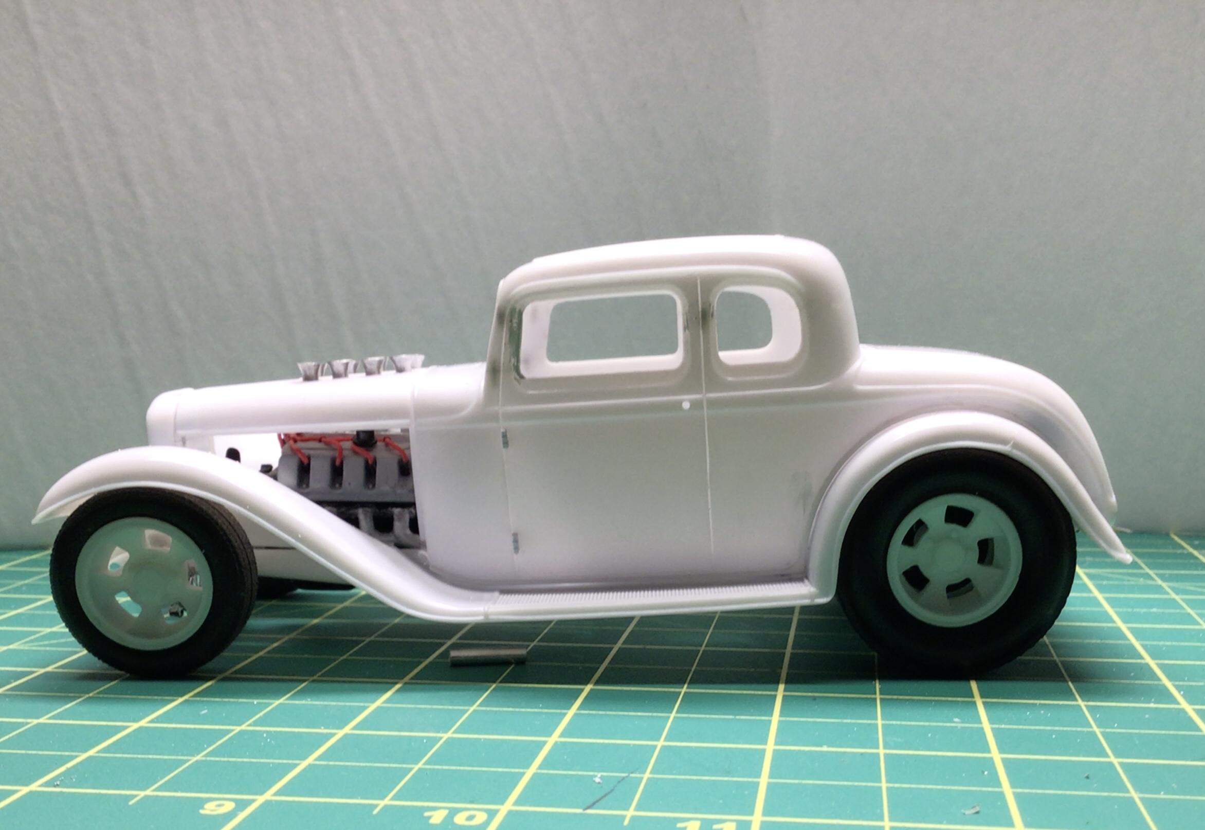

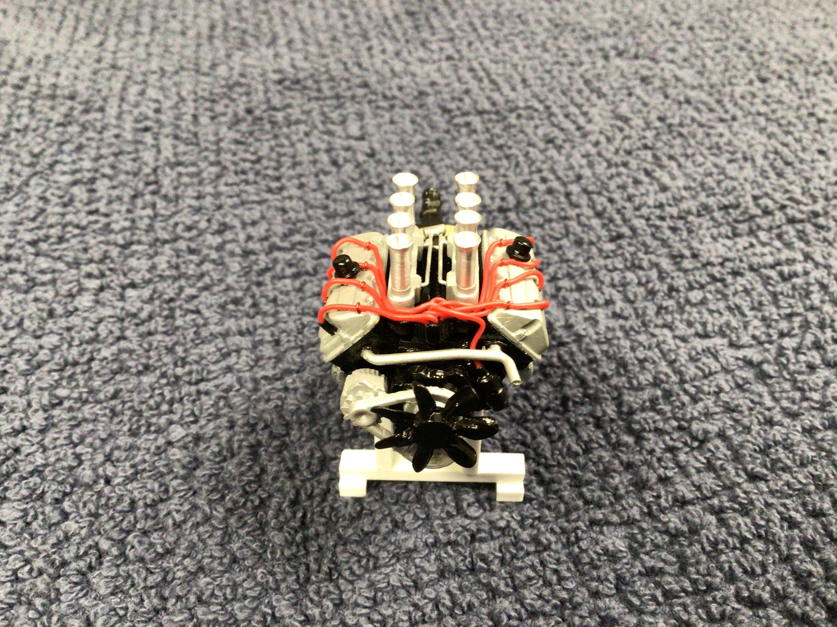

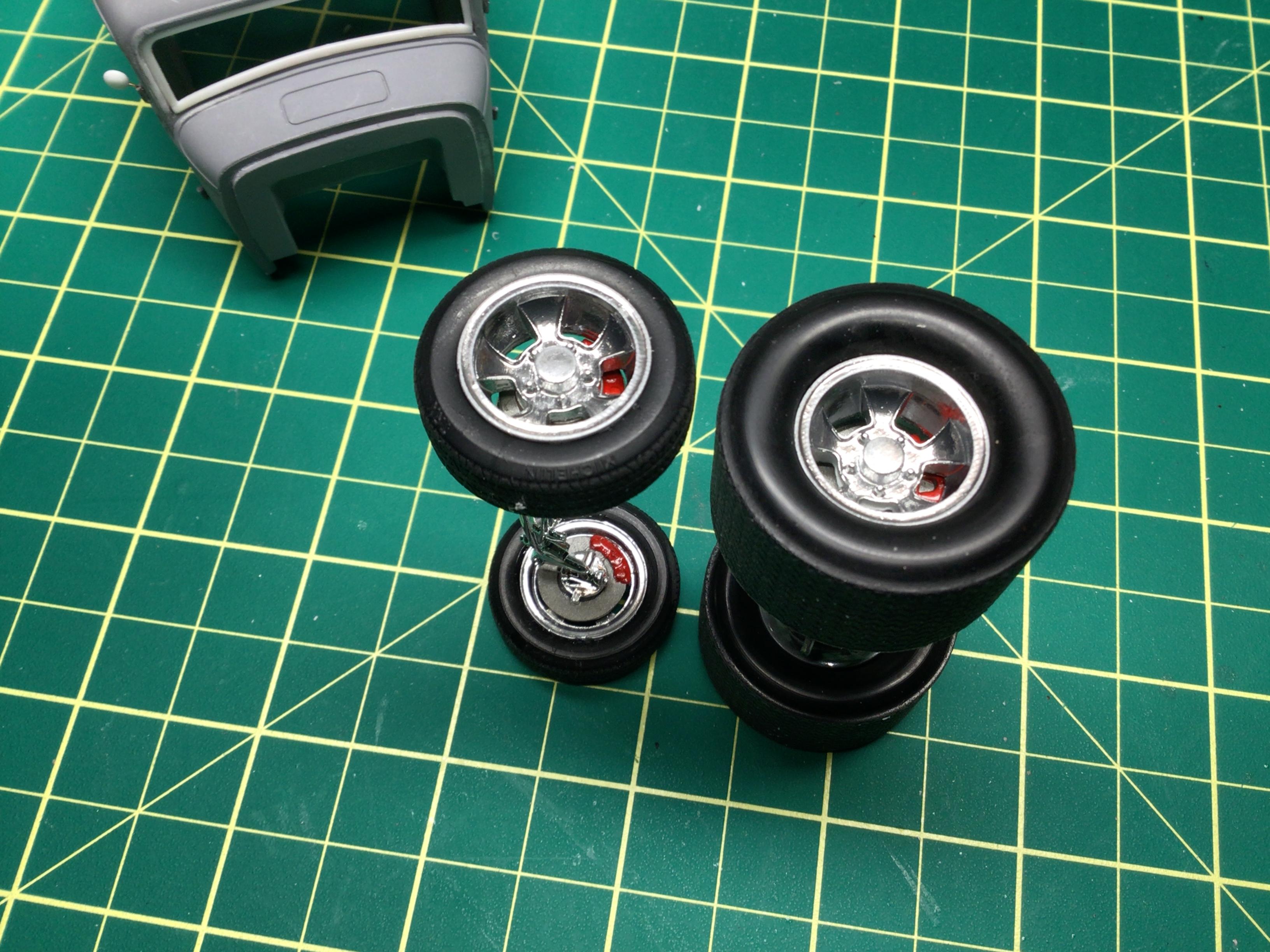

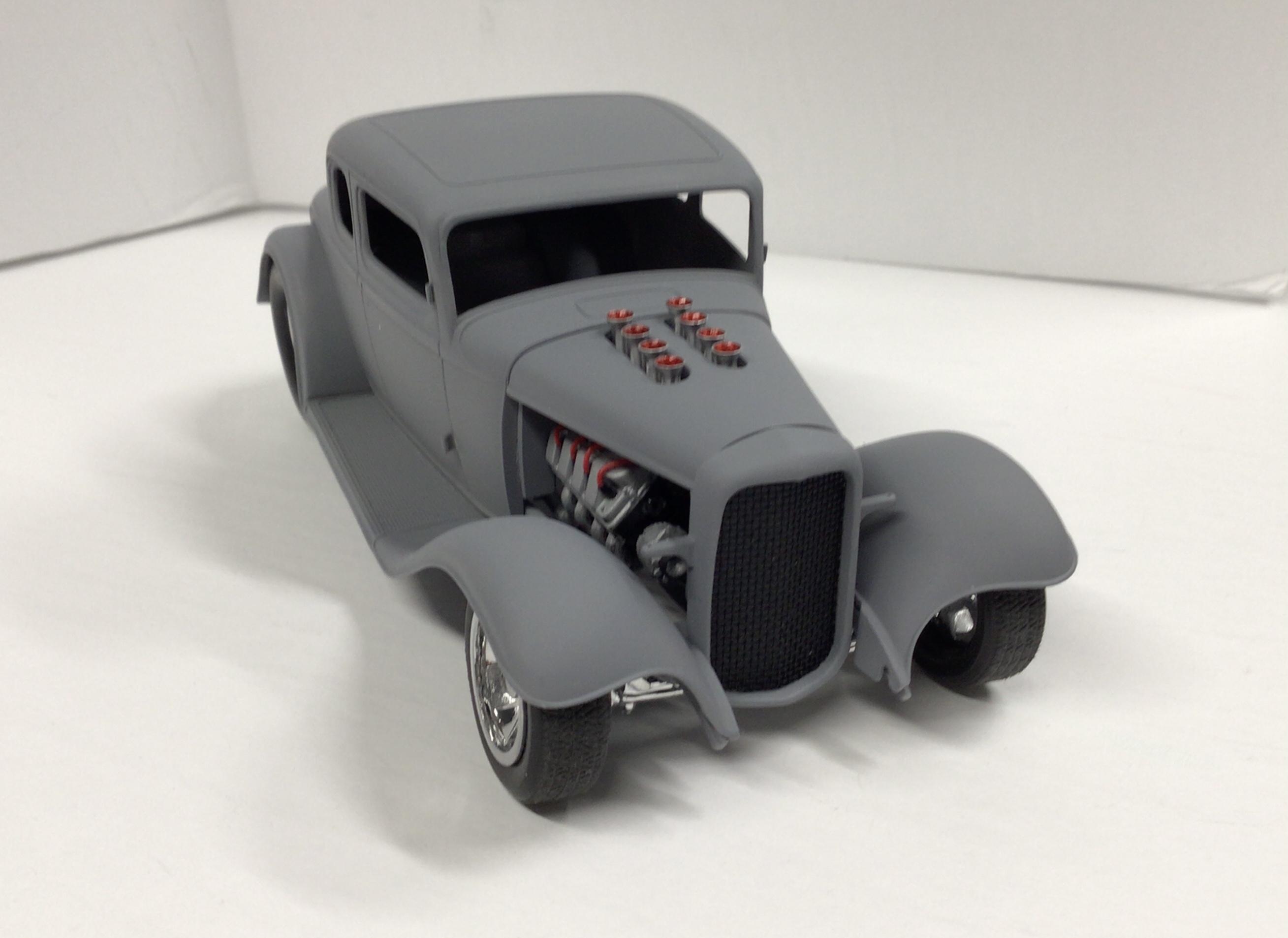

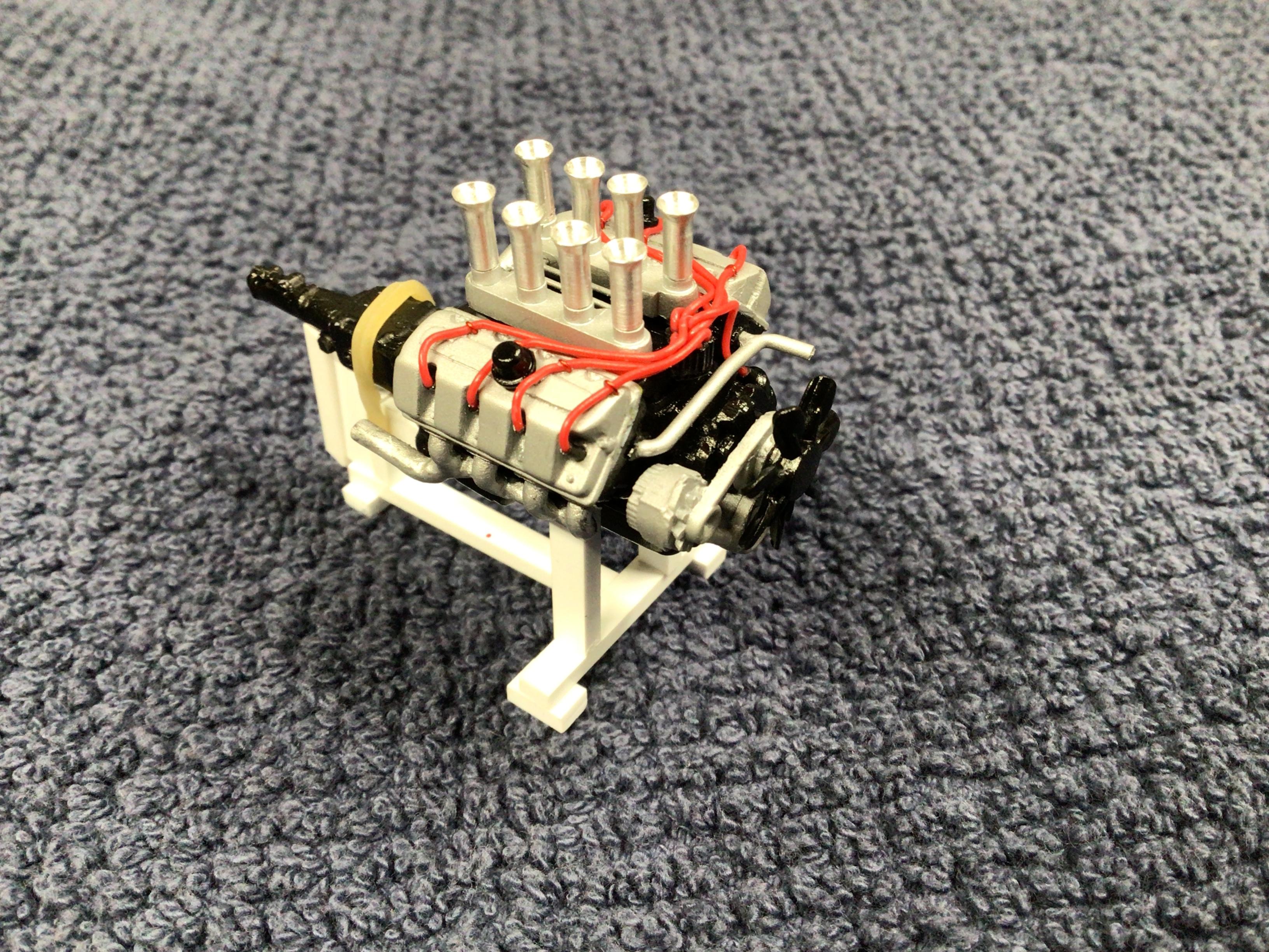

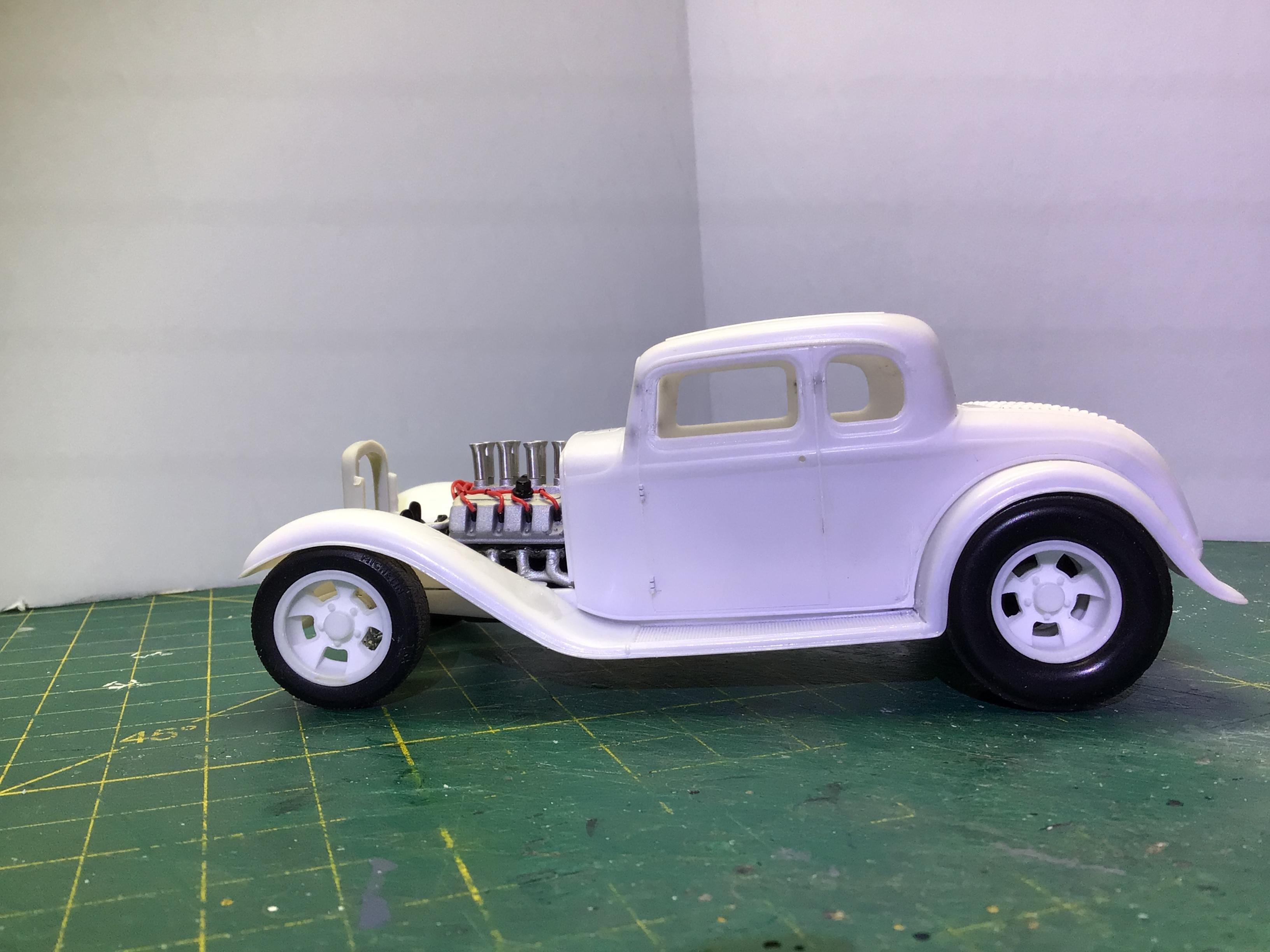

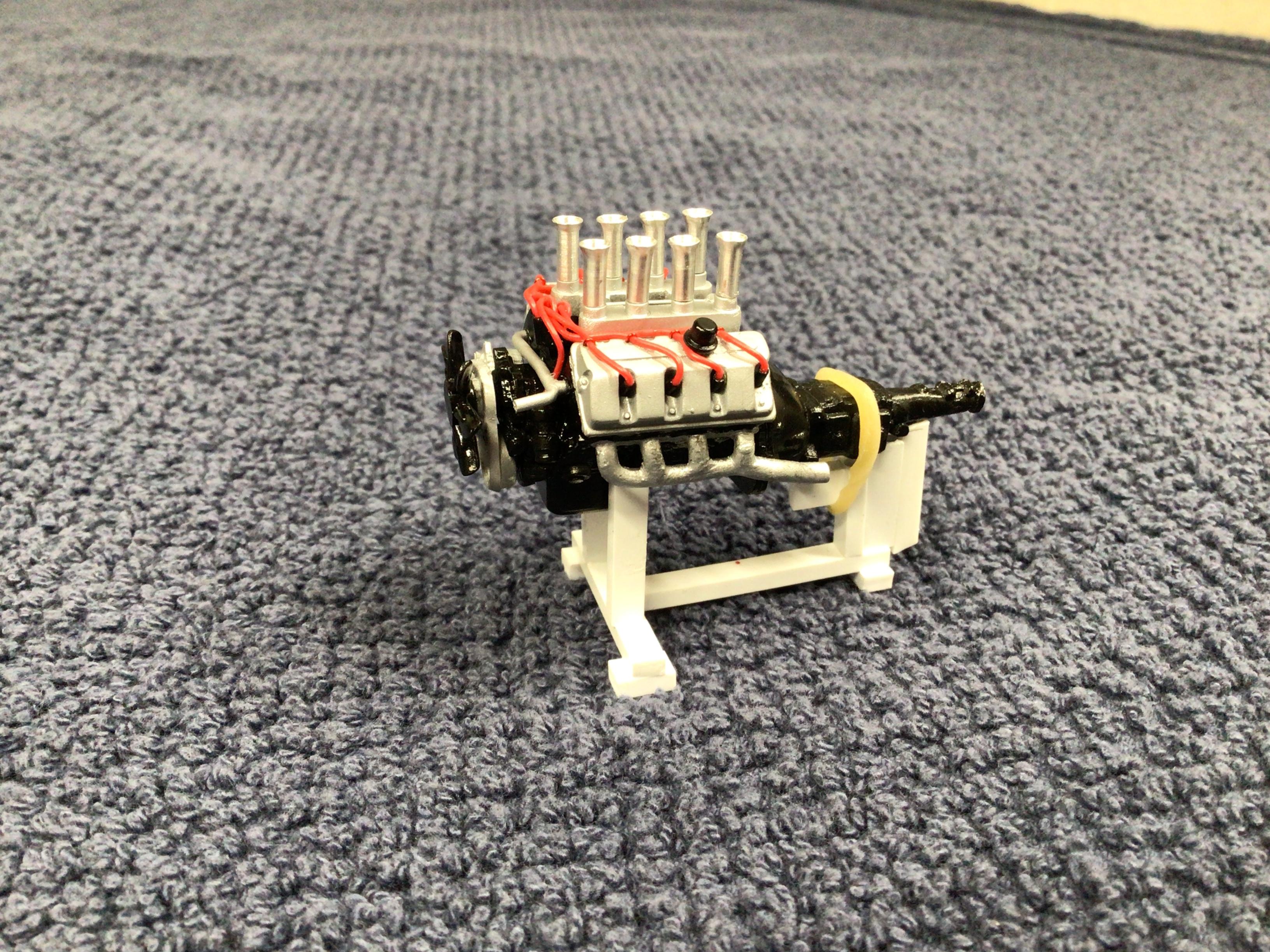

NOBLNG Posted June 21, 2024 Author Posted June 21, 2024 (edited) Well a couple of other kits have me stymied so I’ve been trying to get some issues ironed out with this one. I’ve finally cobbled together some inner and outer rims that will work with the tires that I want to use (second pic). I also nixed the Hemi and am going with a Boss 429. It’s from the Polar Lights Torino and isn’t really a great version. So I rebuilt it. I used the Chrysler Hemi exhaust manifolds, but corrected the outlet spacing and modified them to link up with my already installed exhaust system. I detailed the valve covers a bit and scratch built a new oil pan. I was debating putting a blower on it, but decided on a custom injection system instead. I was going to use the Weber carbs from an AMT Corvette, but after a short search on here, I realized AMT pulled a fast one and gave us side draft carbs instead of downdraft?…so custom fi system it is!? Edited June 21, 2024 by NOBLNG Change pics 7
deuces wild Posted June 22, 2024 Posted June 22, 2024 Looks awesome!... Where did the injector tubes come from if you don't mind me asking????....? 1
NOBLNG Posted June 22, 2024 Author Posted June 22, 2024 (edited) 3 hours ago, deuces wild said: Looks awesome!... Where did the injector tubes come from if you don't mind me asking????....? Thanks! I made them from 3/32” aluminum tubing. Here’s a link to the thread where I got the idea. https://www.modelcarsmag.com/forums/topic/145256-diy-injection-stacks/#comment-2887962 Edited June 22, 2024 by NOBLNG 1

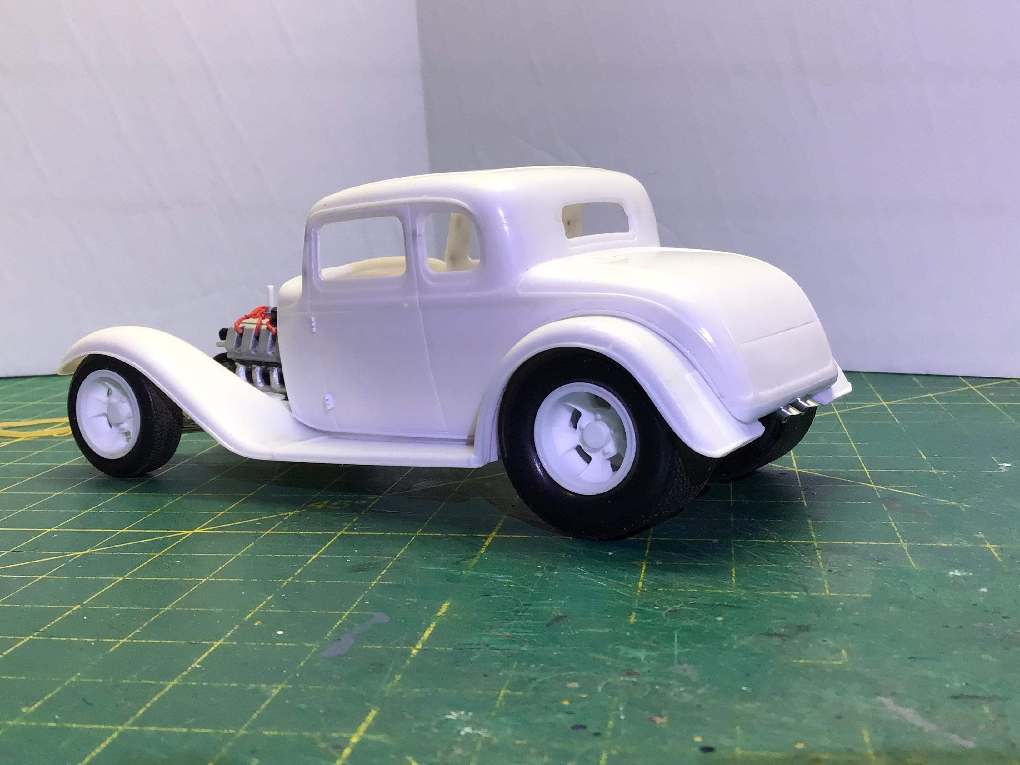

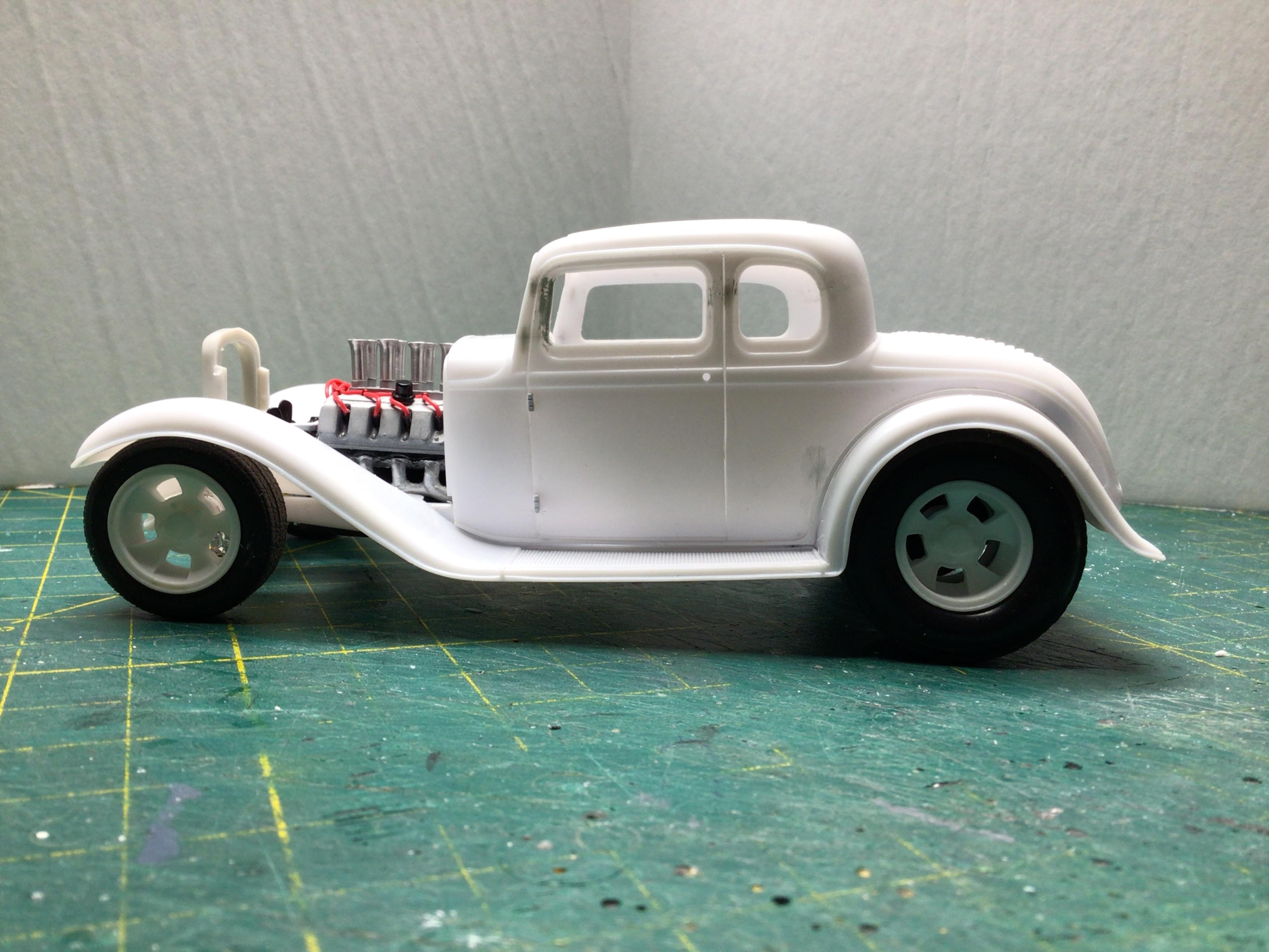

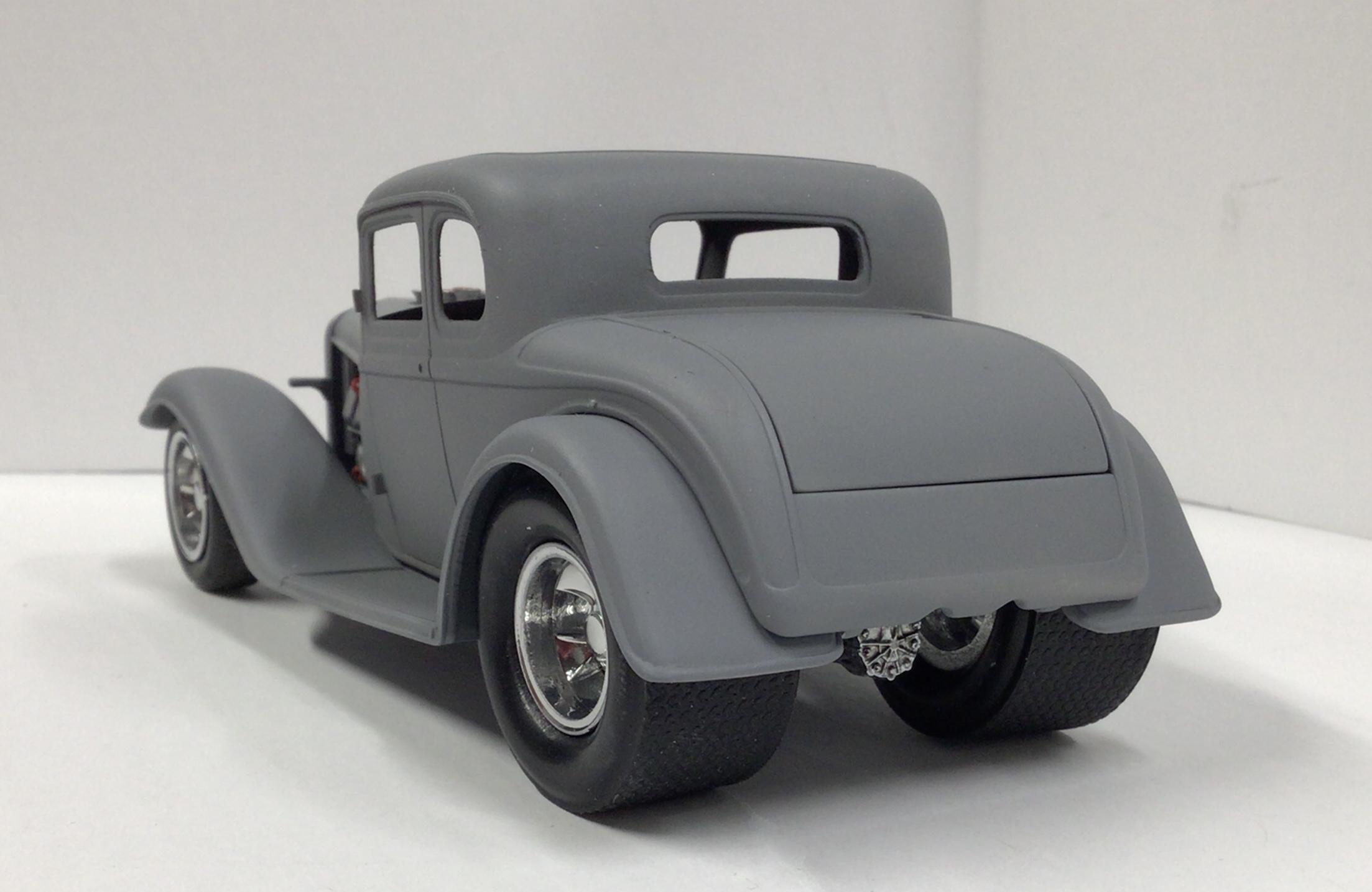

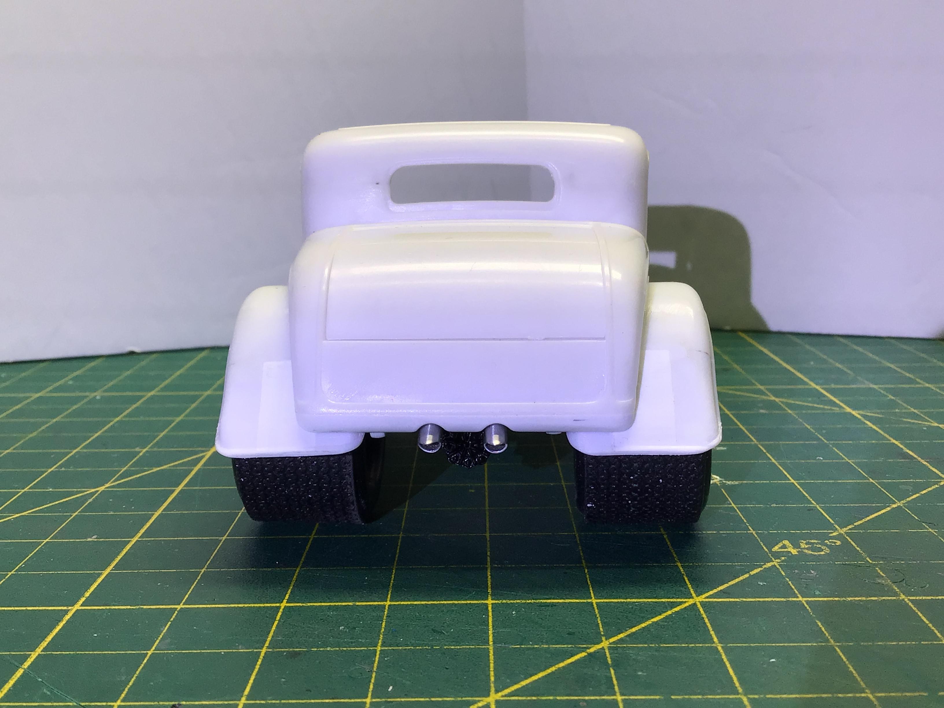

NOBLNG Posted June 22, 2024 Author Posted June 22, 2024 I managed to get the rear fenders bobbed this morning. 6

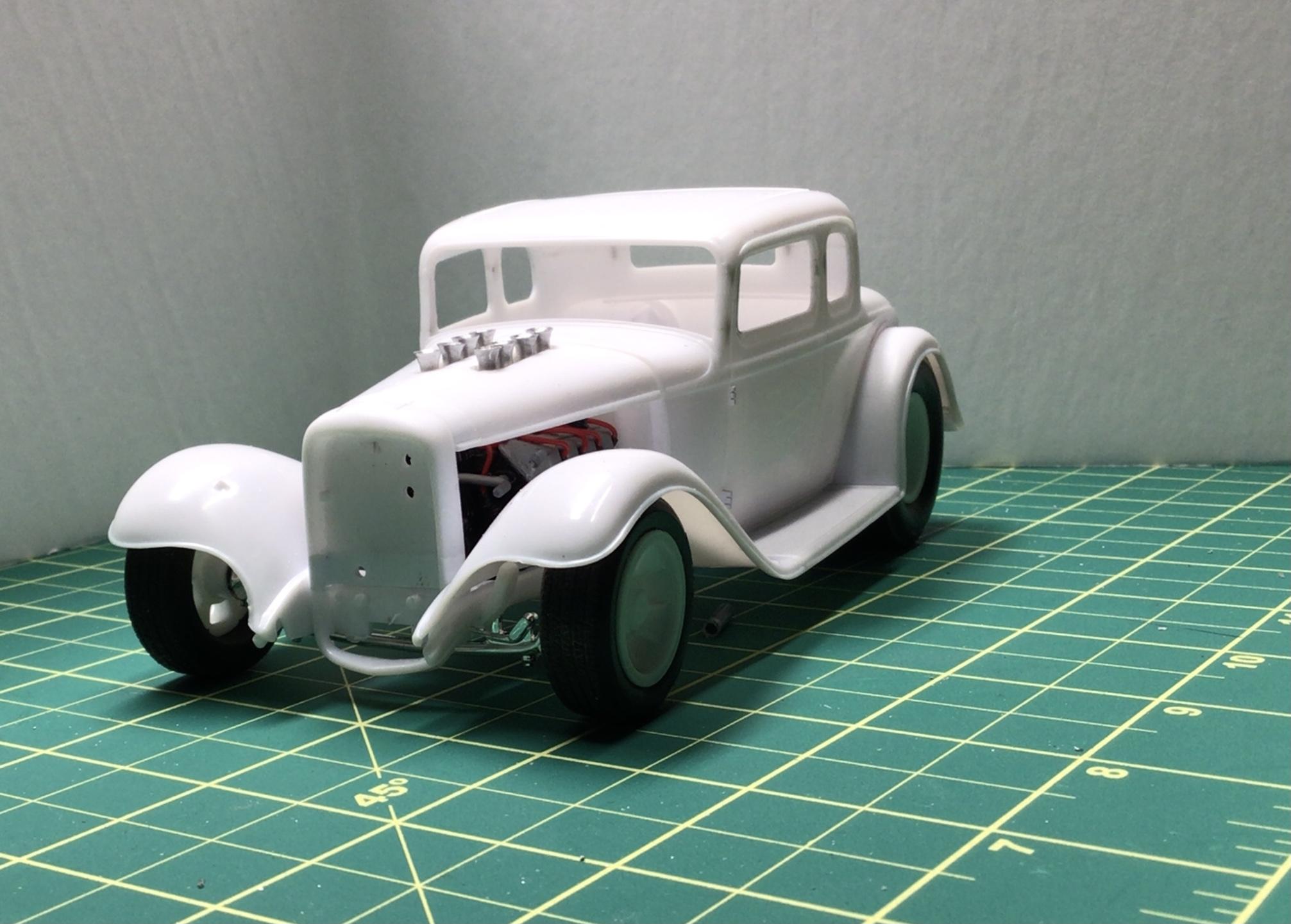

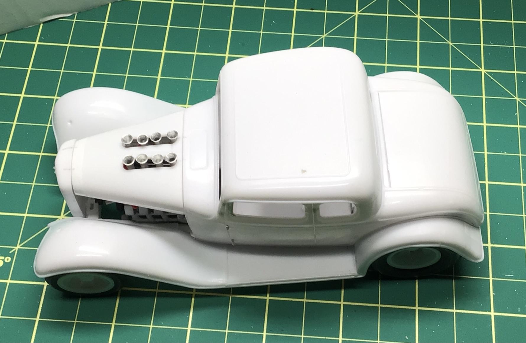

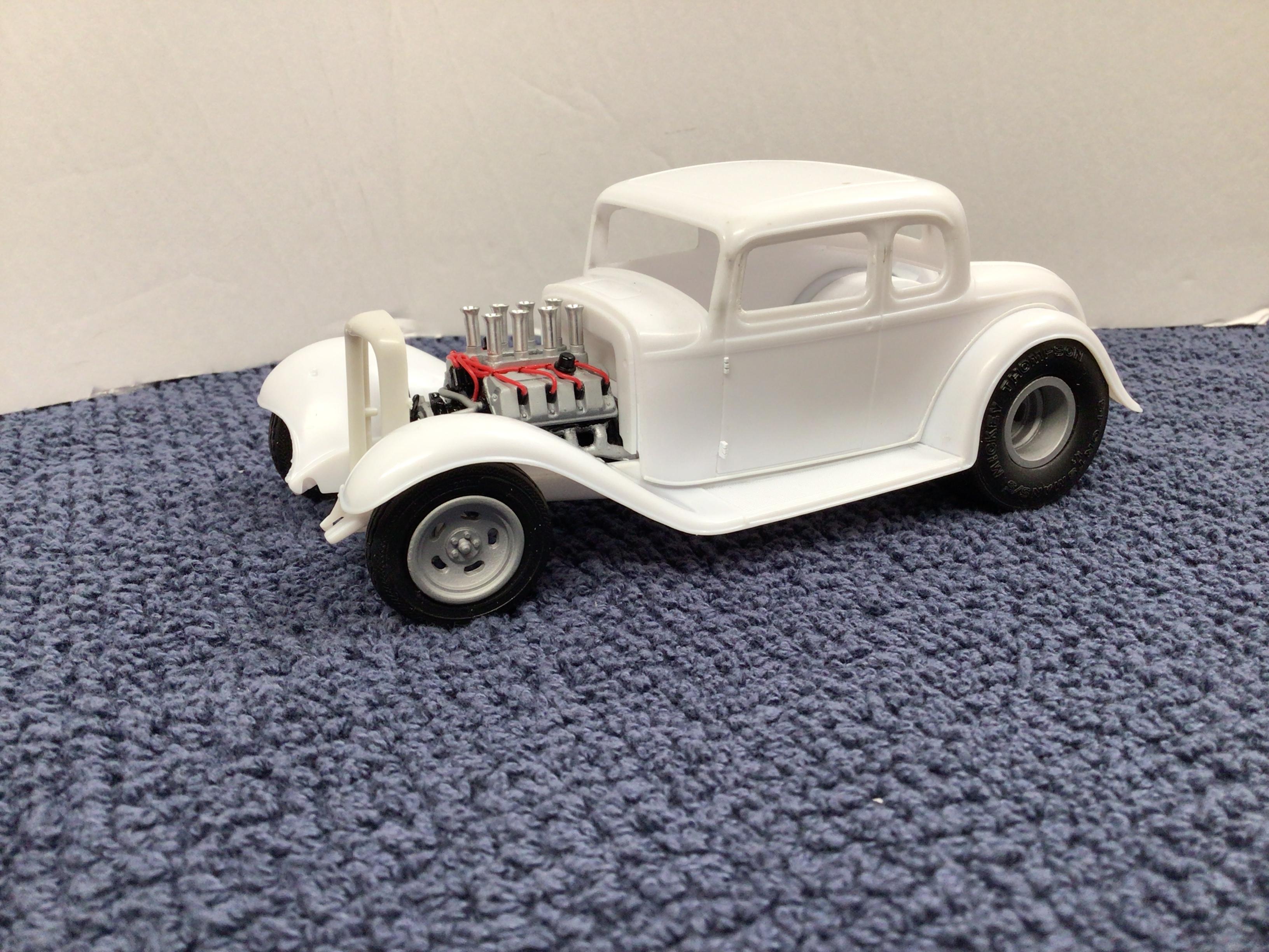

NOBLNG Posted June 24, 2024 Author Posted June 24, 2024 (edited) I’ve been playing around with the front end now. I lengthened the grill shell back to stockish height since I need to move it out in front of the crossmember and lower it anyways and added some mounting pegs. That meant I either had to eliminate the hood or lengthen it…so I lengthened it. Now the hood hid the injector stacks too much, so I made some longer ones and cut some slots in the hood for clearance. Thanks for lookin’.? Edited June 25, 2024 by NOBLNG 6

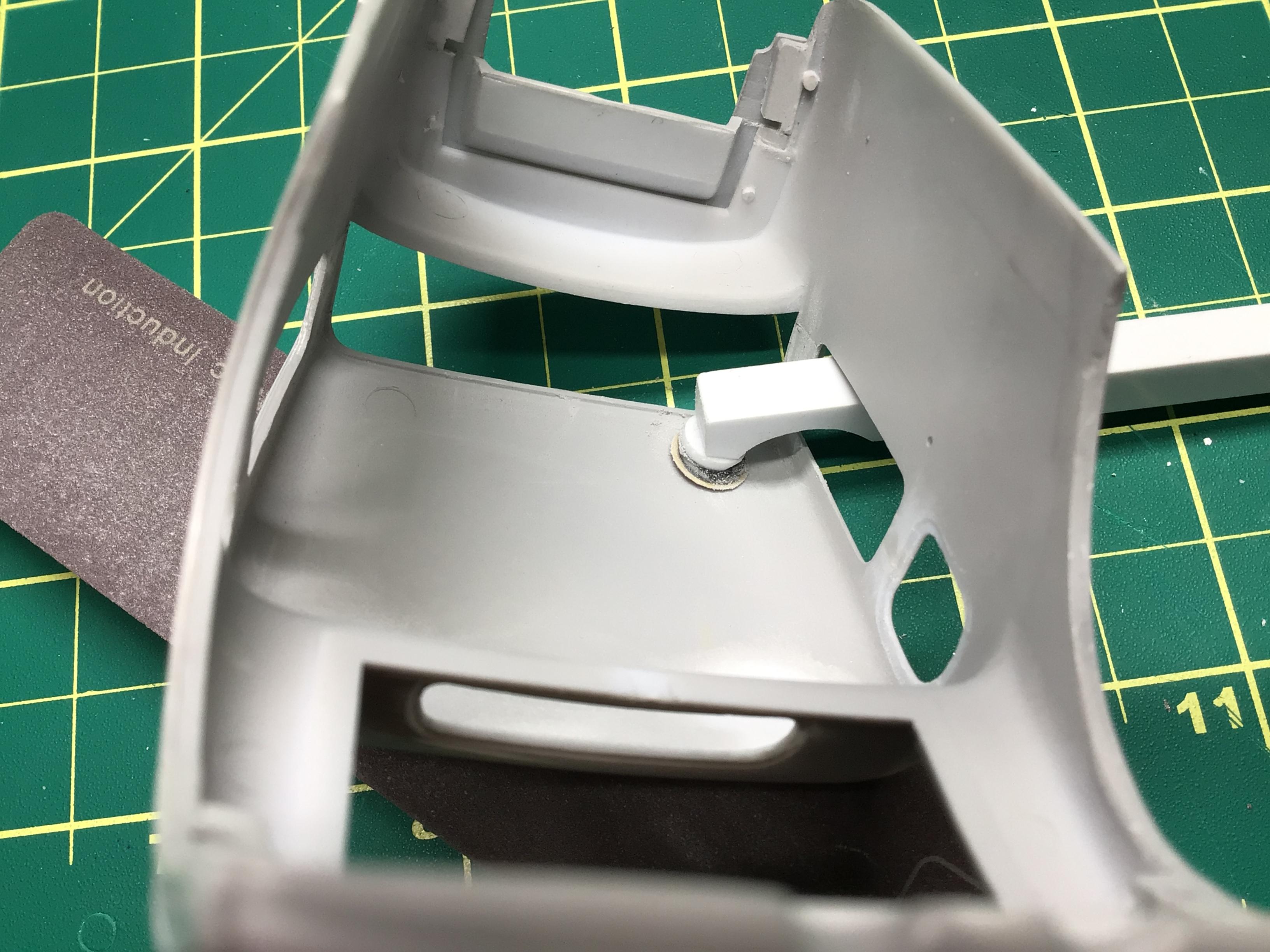

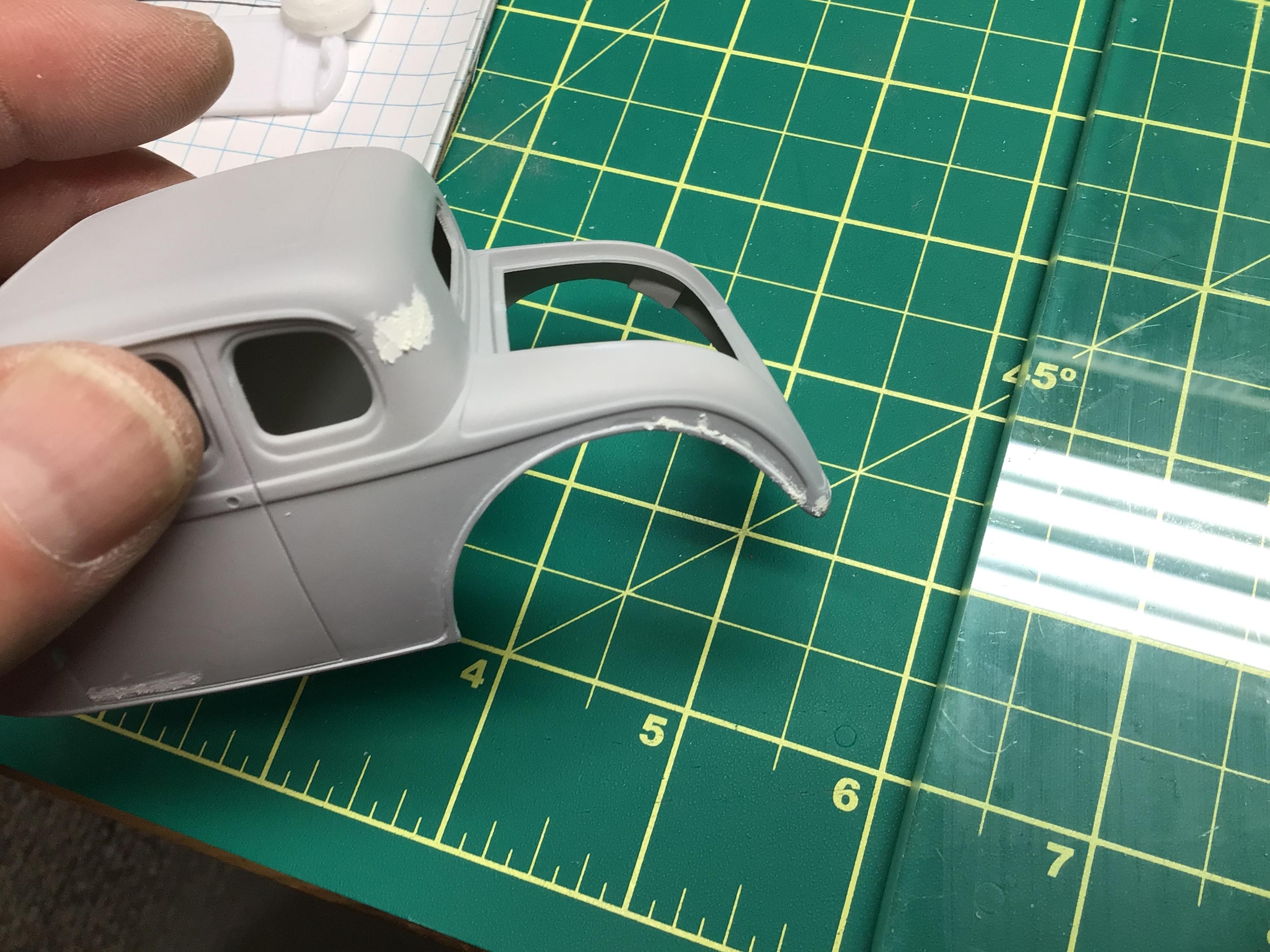

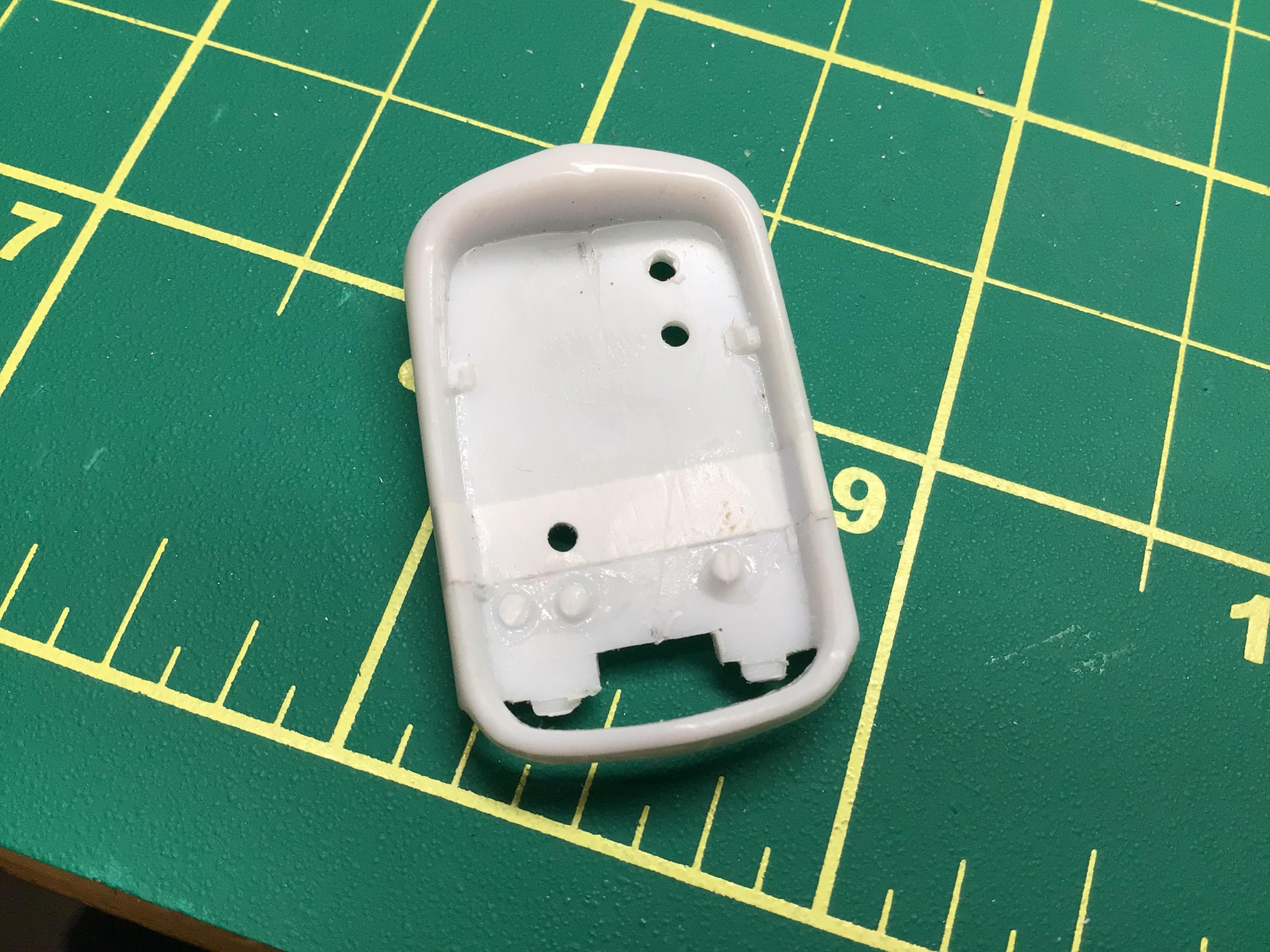

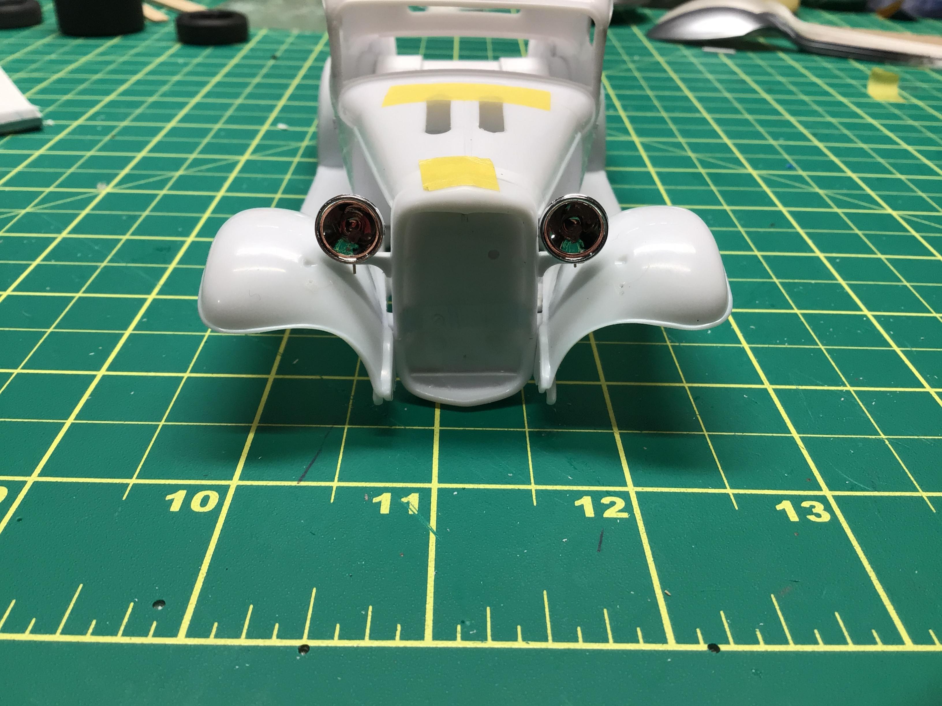

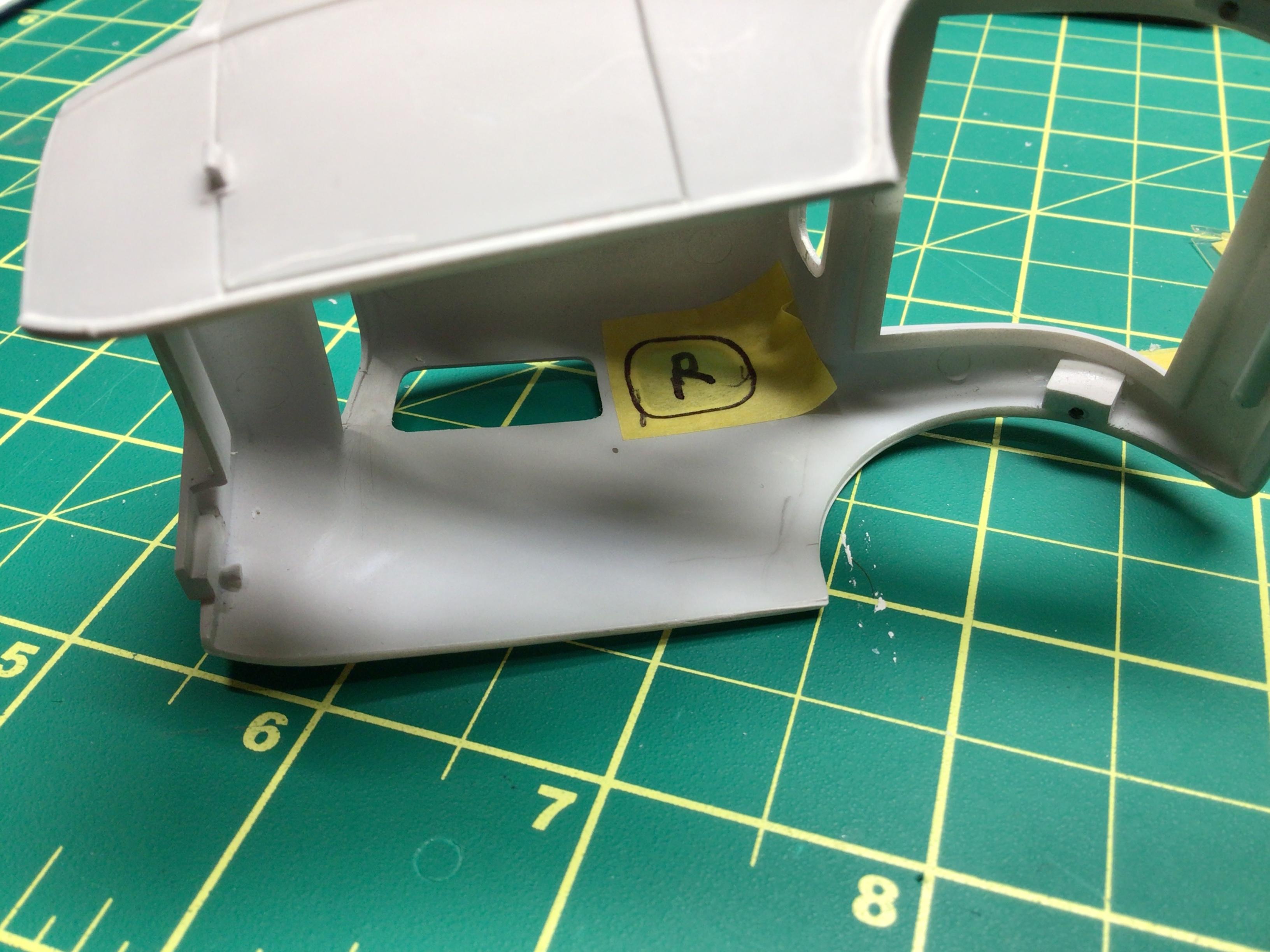

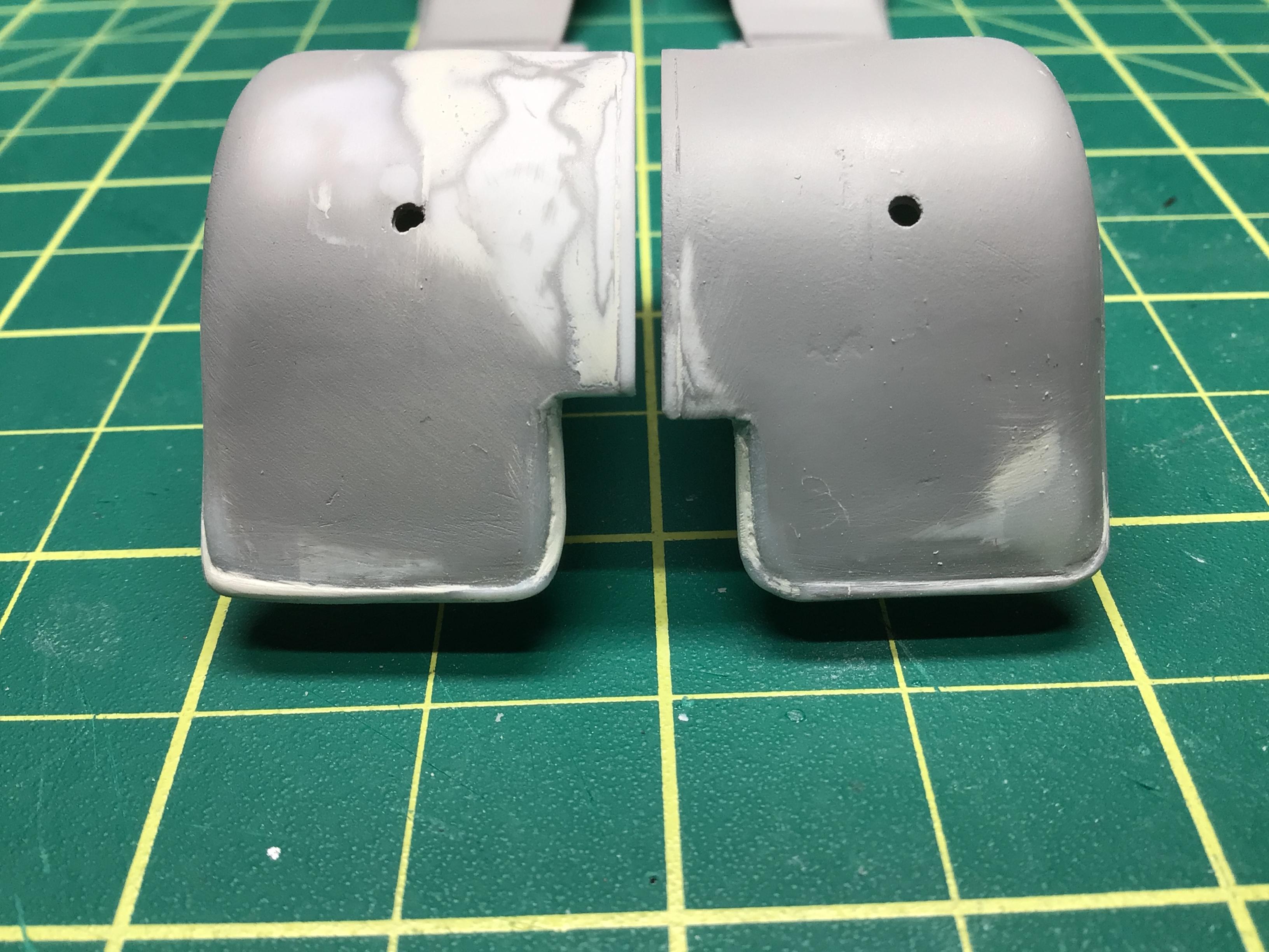

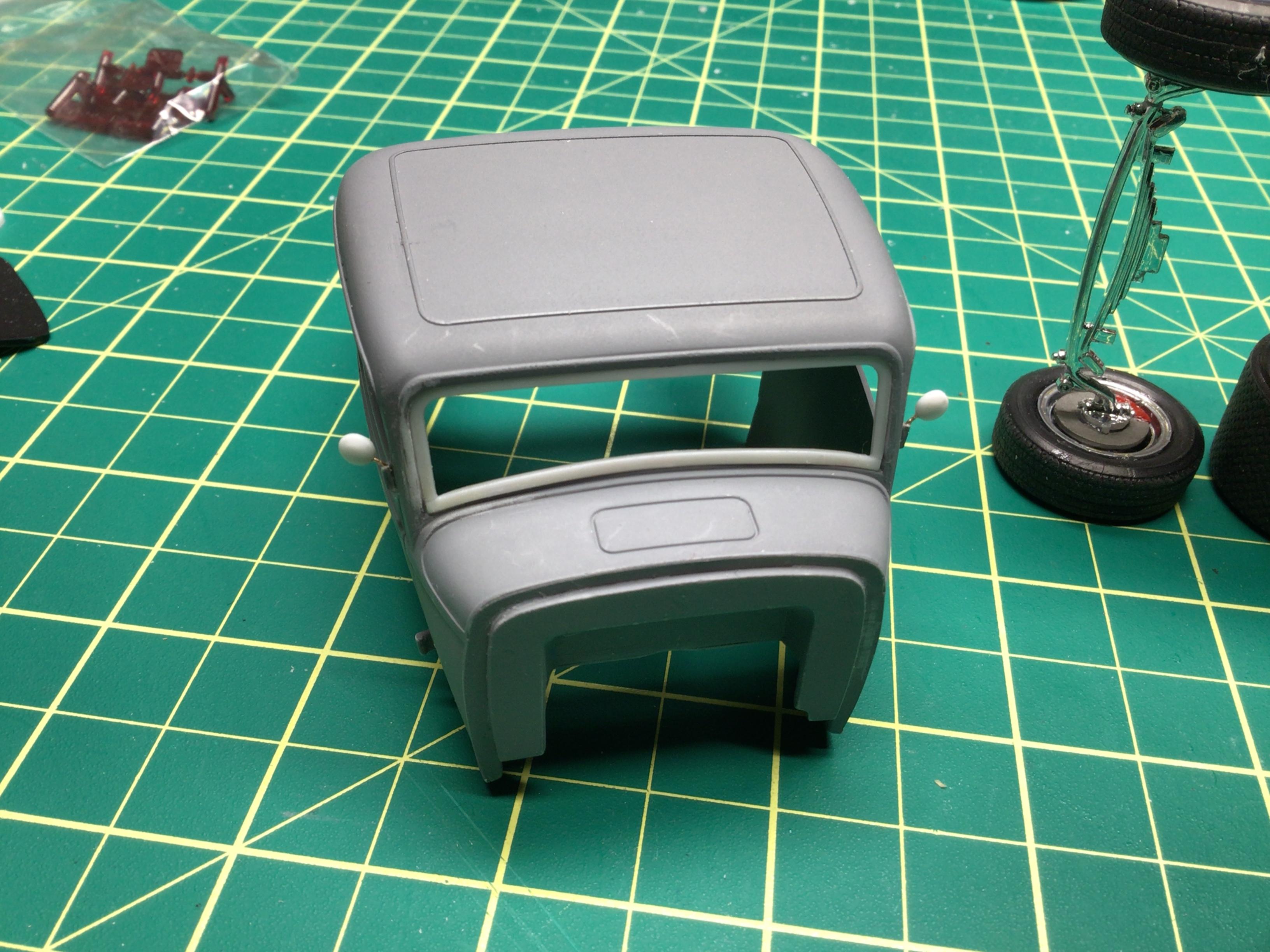

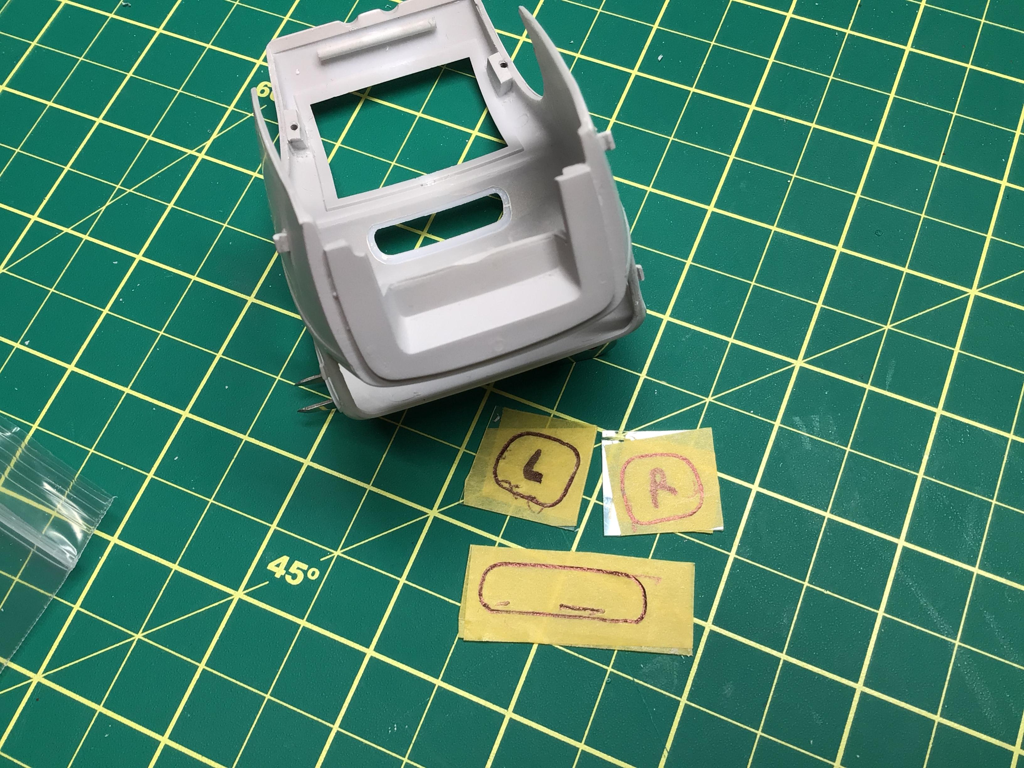

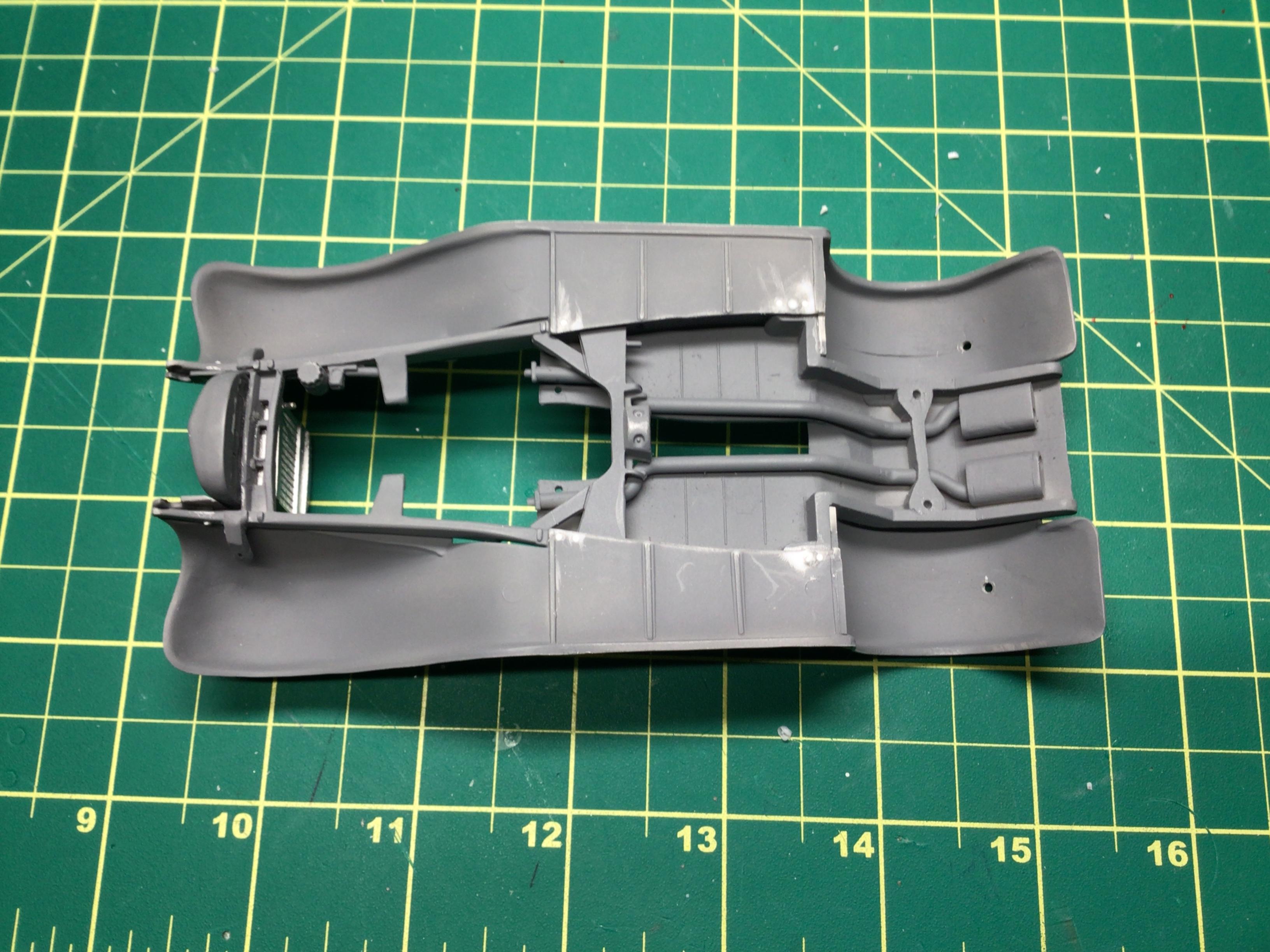

NOBLNG Posted July 3, 2024 Author Posted July 3, 2024 (edited) I’ve been trying to get the body work done. I moved the headlight mounting bar ahead of the grill, but decided to mount them to the radiator shell instead. mixed up a few tiny batches of Milliput to fill gouges and blend the new trim to look more like a stamped in molding than something that was glued or welded on. Also carved in some reliefs for window glass and made patterns for them from tape and applied them to some .010” clear sheet. I’ll trim them to size later. Sanded out the ejection pin marks on the headliner, even though it really can’t be seen.? And I’ve been filling and sanding and filling and sanding the tubbed fenders to get them looking presentable. Jeez…I thought they looked good until I saw this photo.? Oh well, time for some more sanding and primer.? Edited July 4, 2024 by NOBLNG 4

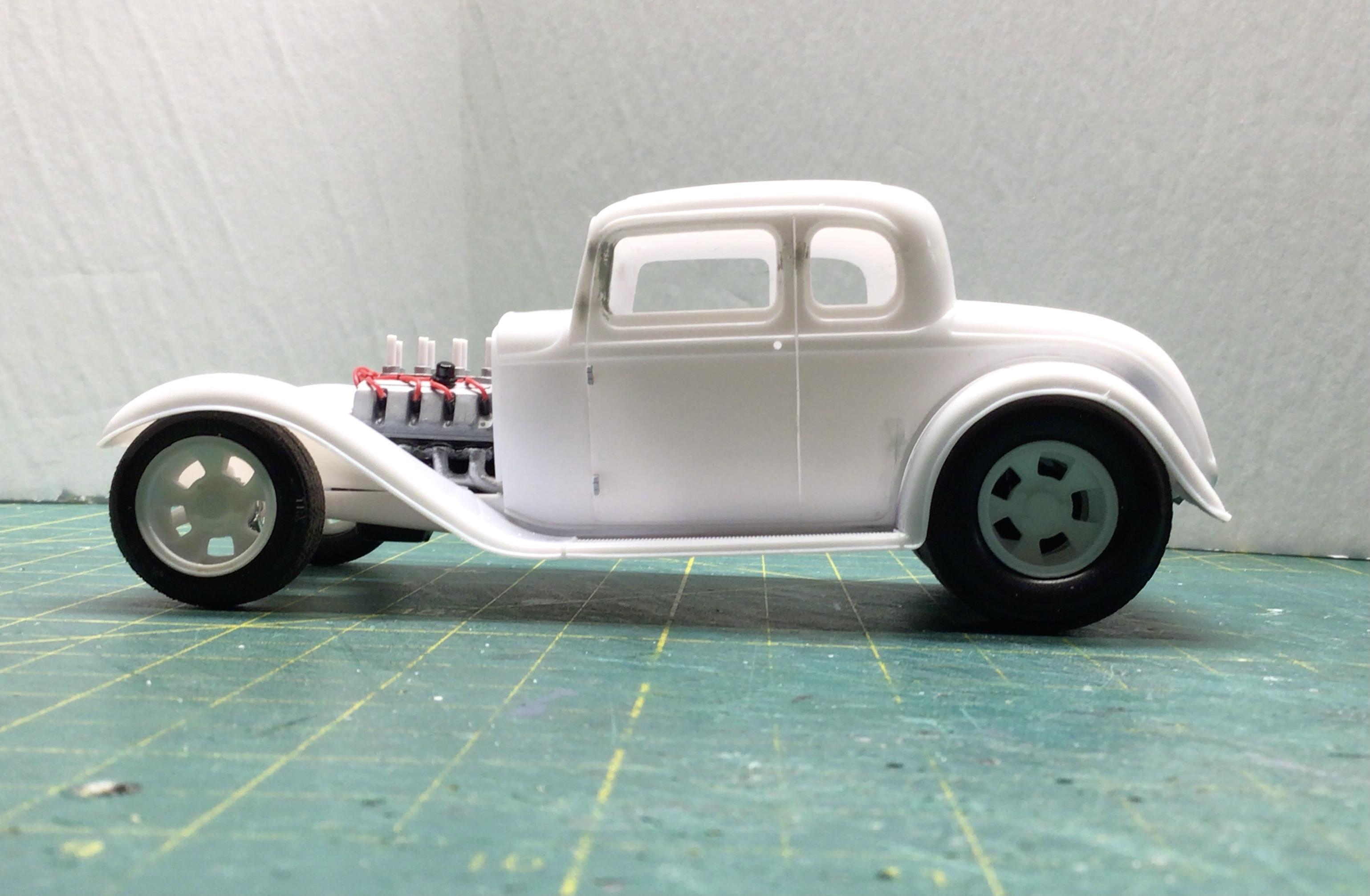

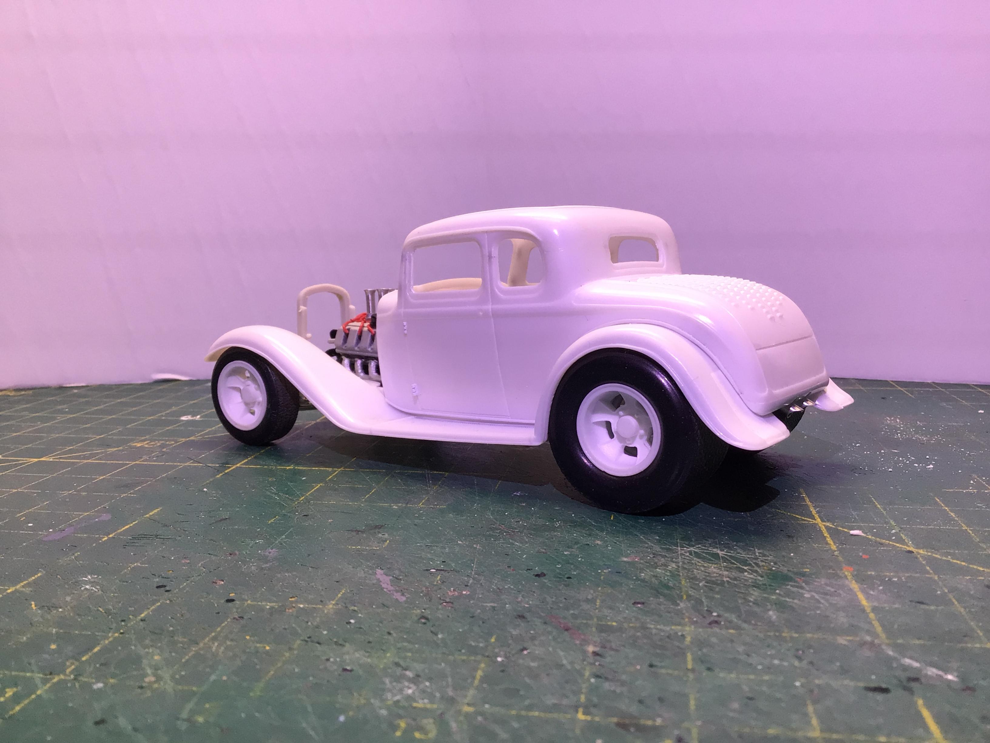

NOBLNG Posted July 3, 2024 Author Posted July 3, 2024 Thanks Guys!? Here’s a couple of mockup pics. 11 minutes ago, Mr. Metallic said: Well, the original designers for the 65 roadster made those Webers to be side draft because it was a different intake setup, similar to the Grand Sport Vettes. But when they redesigned the kit the repurposed the now incorrect side draft Webers into the downdraft intake By the way, your build is freaking RAD! 10 minutes ago, Butter 1 said: Nice work. I like the motor, the overall proportions of the body, headlight mounts, and the rear rolled pan and exhaust, just to name a few things. 5

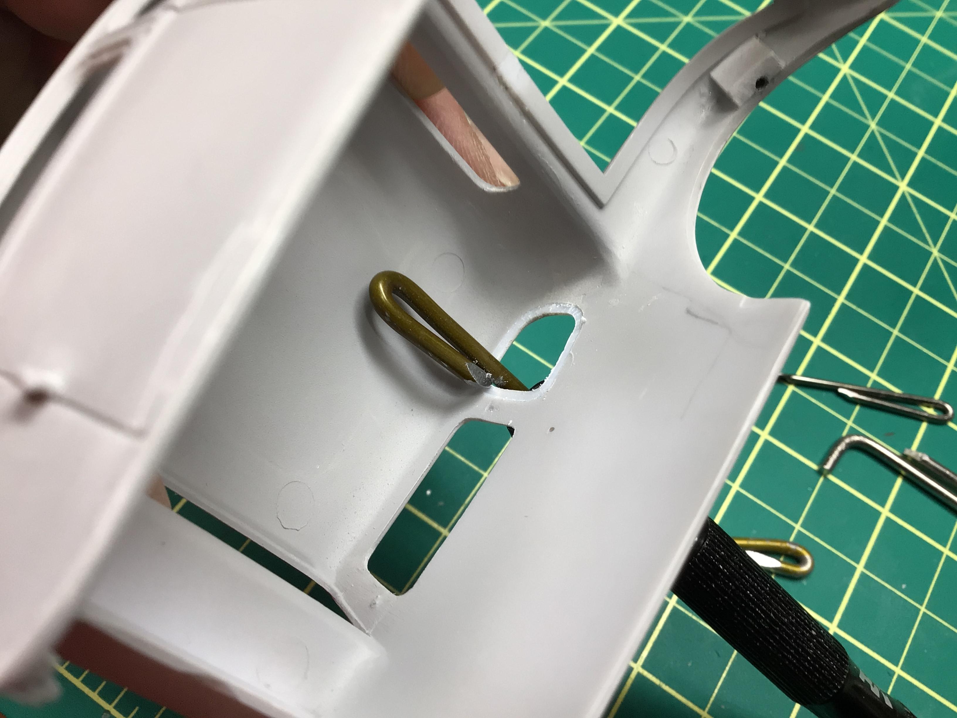

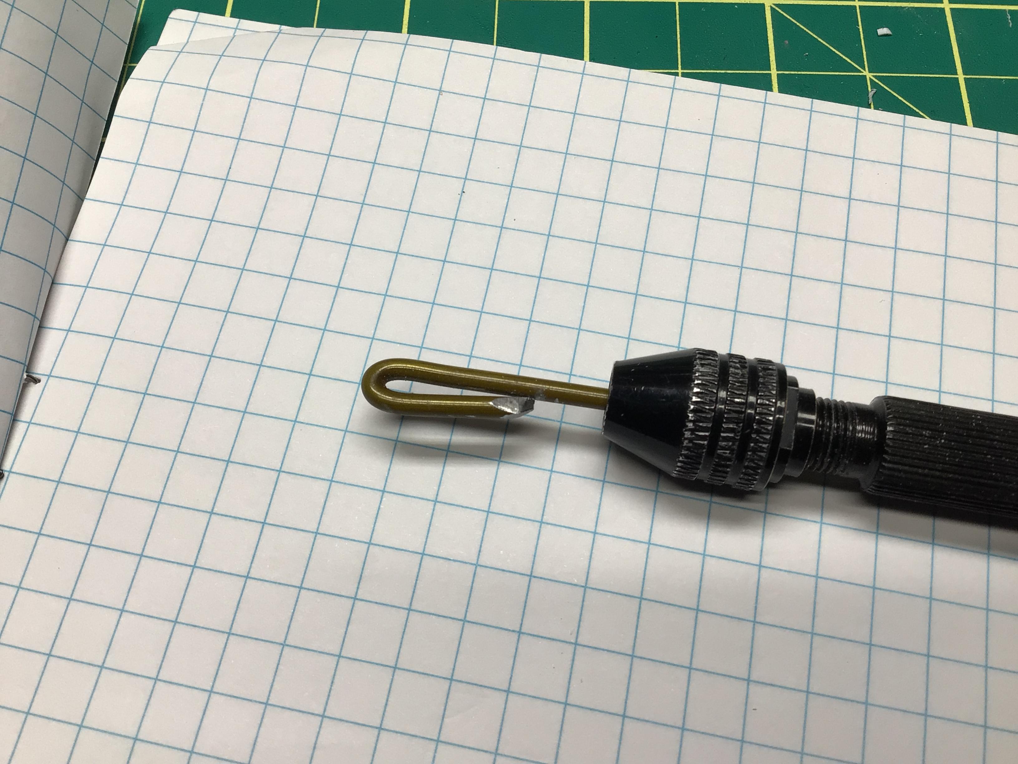

LAone Posted July 4, 2024 Posted July 4, 2024 awesome build you have going. but, them tools are pretty sweet as well. the carving tool peaked my interest. 1
NOBLNG Posted July 5, 2024 Author Posted July 5, 2024 On 7/3/2024 at 9:42 PM, LAone said: awesome build you have going. but, them tools are pretty sweet as well. the carving tool peaked my interest. Thanks. It’s a piece of coat hanger sharpened to a chisel point, bent and chucked in my pin vise. 4

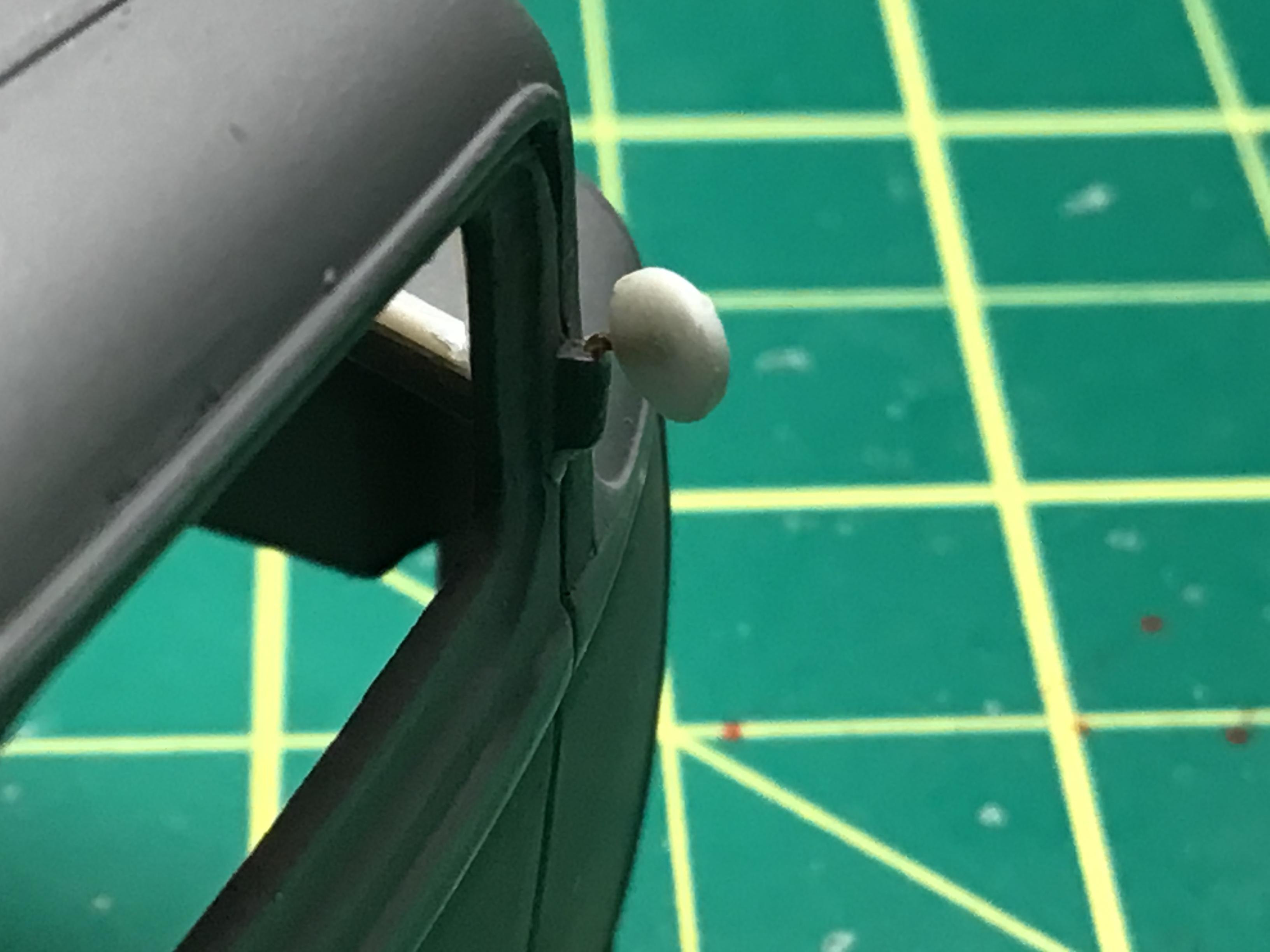

NOBLNG Posted July 5, 2024 Author Posted July 5, 2024 I got the disc brakes mounted to the wheels, and the wheels mounted to the axles. I re-made the door hinges and drilled them for side mirrors. Then made a couple of mirrors from sprue and .015” wire. I’ve been busy trying to tidy up the body and chassis in preparation for paint. Got rid of the screws that were temporarily holding things together and replaced them with permanent plugs. I pity anyone who gets one of my models and tries to disassemble it.? 5

LAone Posted July 6, 2024 Posted July 6, 2024 8 hours ago, NOBLNG said: Thanks. It’s a piece of coat hanger sharpened to a chisel point, bent and chucked in my pin vise. nice! I thought it would be a rod of some sort, or a nail. never thought of making one like that till now tho.. 1

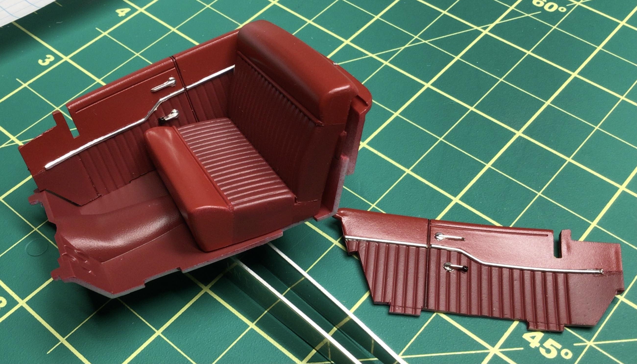

NOBLNG Posted July 6, 2024 Author Posted July 6, 2024 (edited) Got some color on the interior. Now I have to paint the outside of the tunnel and floorboard before I can assemble it. I was hoping to get some color on the body too…but every time I look at it I find more flaws.? Edited July 6, 2024 by NOBLNG 2
Speedpro Posted July 7, 2024 Posted July 7, 2024 Nice work so far! You have some great ideas. That exhaust is perfect. It's cool how mounting the mirrors to the door hinge gave the hinge some purpose opposed to just being there. Nice touch. 1
