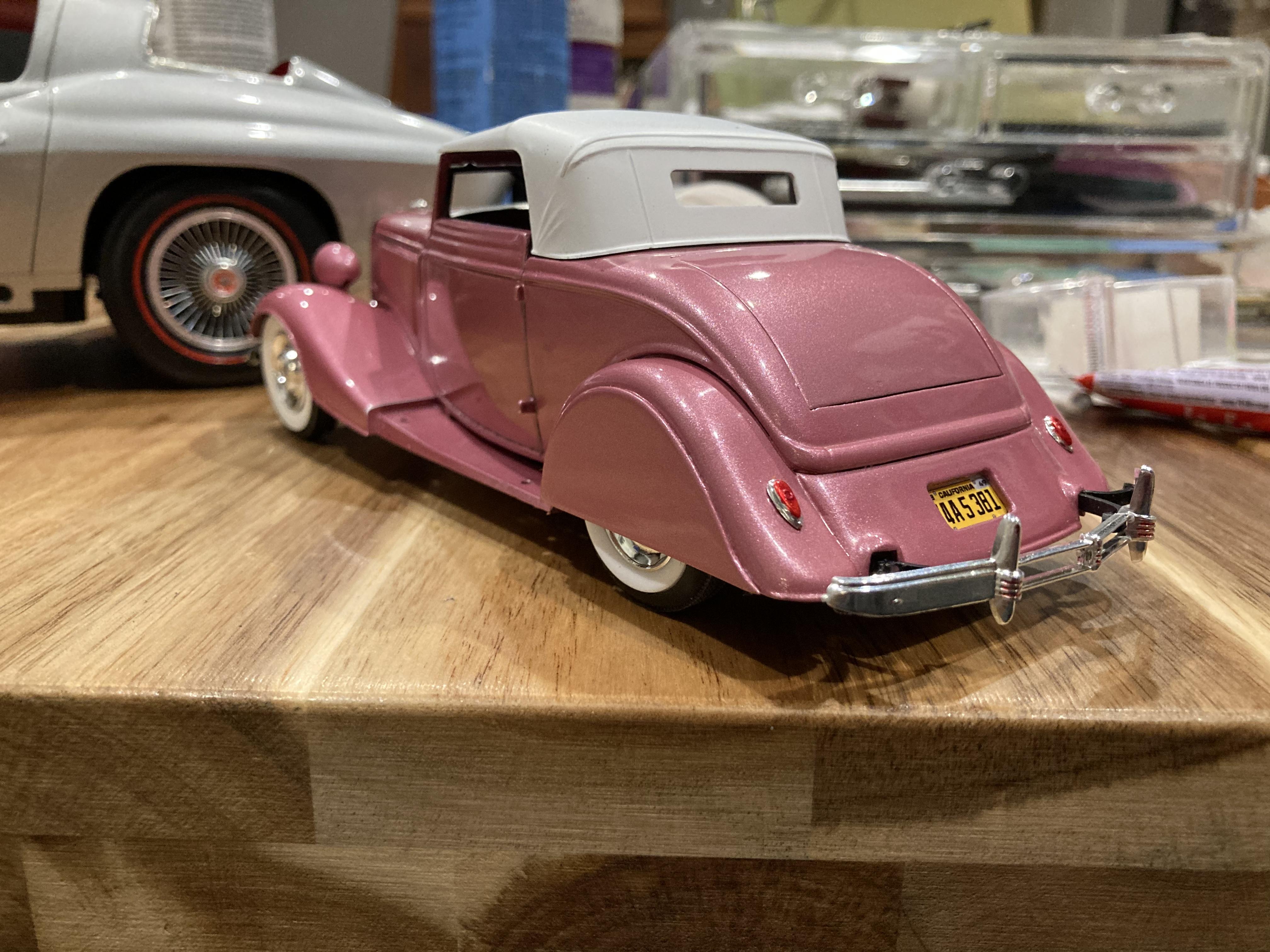

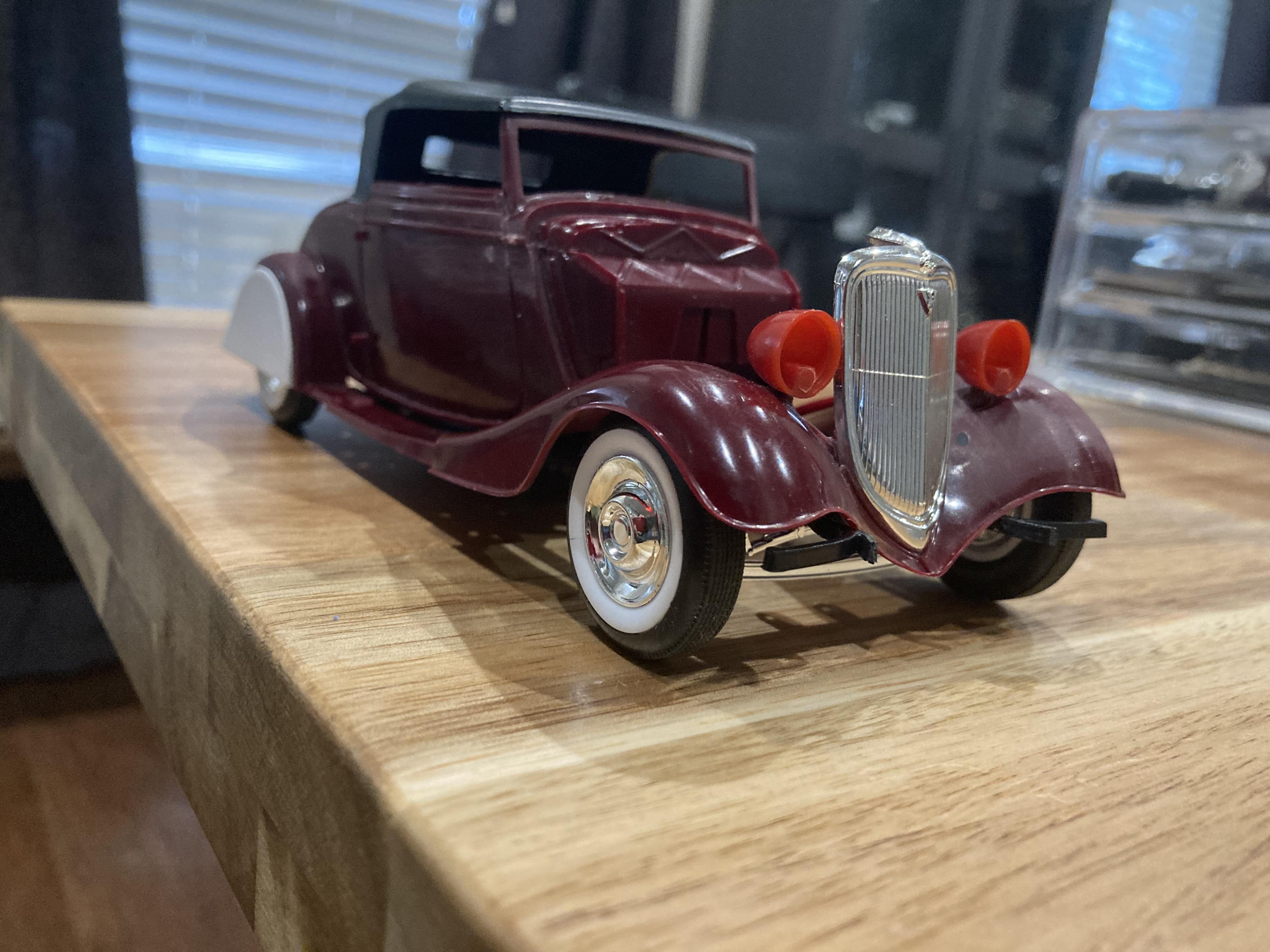

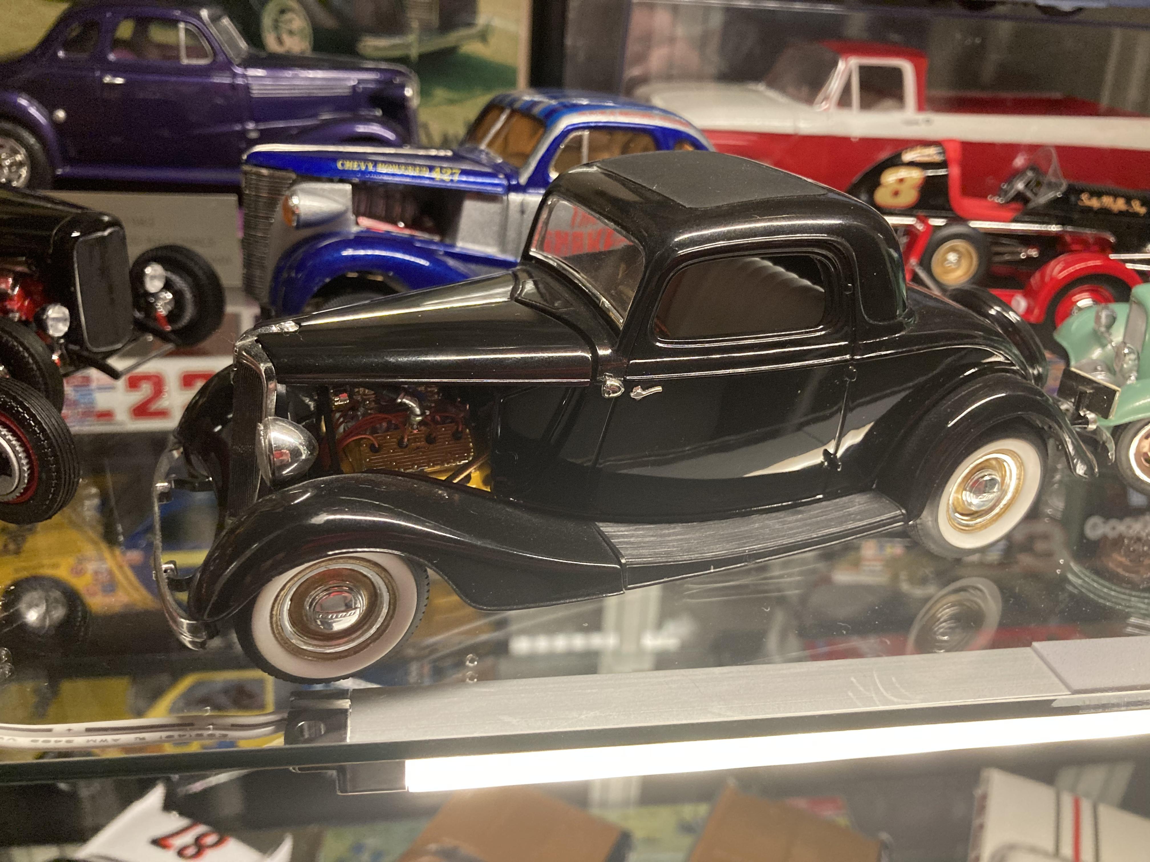

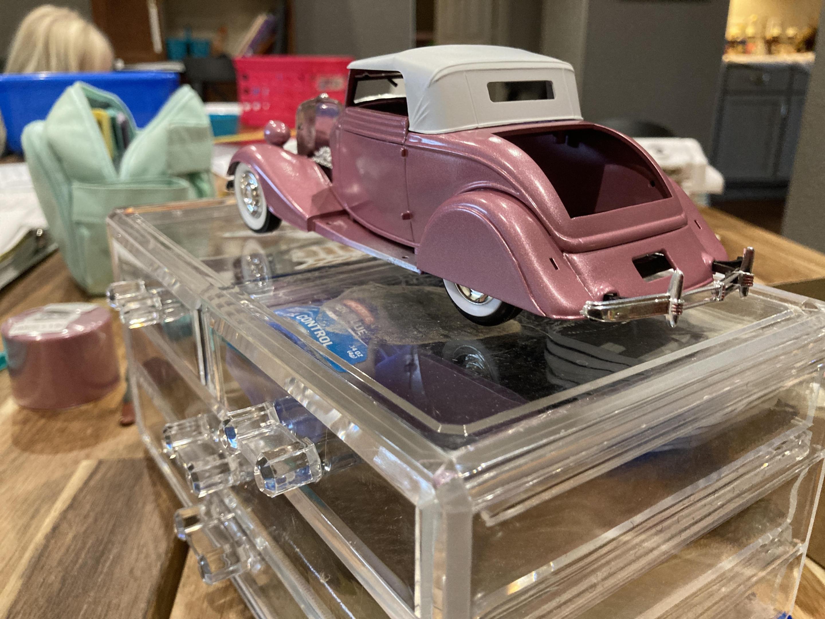

Dan Hay Posted November 6, 2022 Posted November 6, 2022 I love the Wes Collins Roadster tribute a guy on the hamb is building. It was also featured in bare metal in the most recent Rodder’s Journal. This is a 34 cabriolet not a roadster, but it will be heavily inspired by the Collins car. I’ve already made the skirts, mildly chopped the top, installed 36 headlights, and rounded up 41 Lincoln bumpers. I also have Caddy sombreros for it. The kit is a 1962 issue of the Monogram 34 Ford 3 window/Cabriolet kit. It has killer box art. I’m not sure what I’m going to do about a power plant or color. It will be something period correct. It will have a full hood so I might just use the Pontiac mill and 6 deuces that came with the kit, but that engine is a little new I think. This car is a very early Kustom, Wes started showing it in 1950. Anyway, here’s more information on the Wes Collins car, and Mark Skipper’s recreation. https://kustomrama.com/wiki/Wes_Collins'_1934_Ford I have built this kit before, I have included a pic of a 3w version I built about 20 years ago. 4

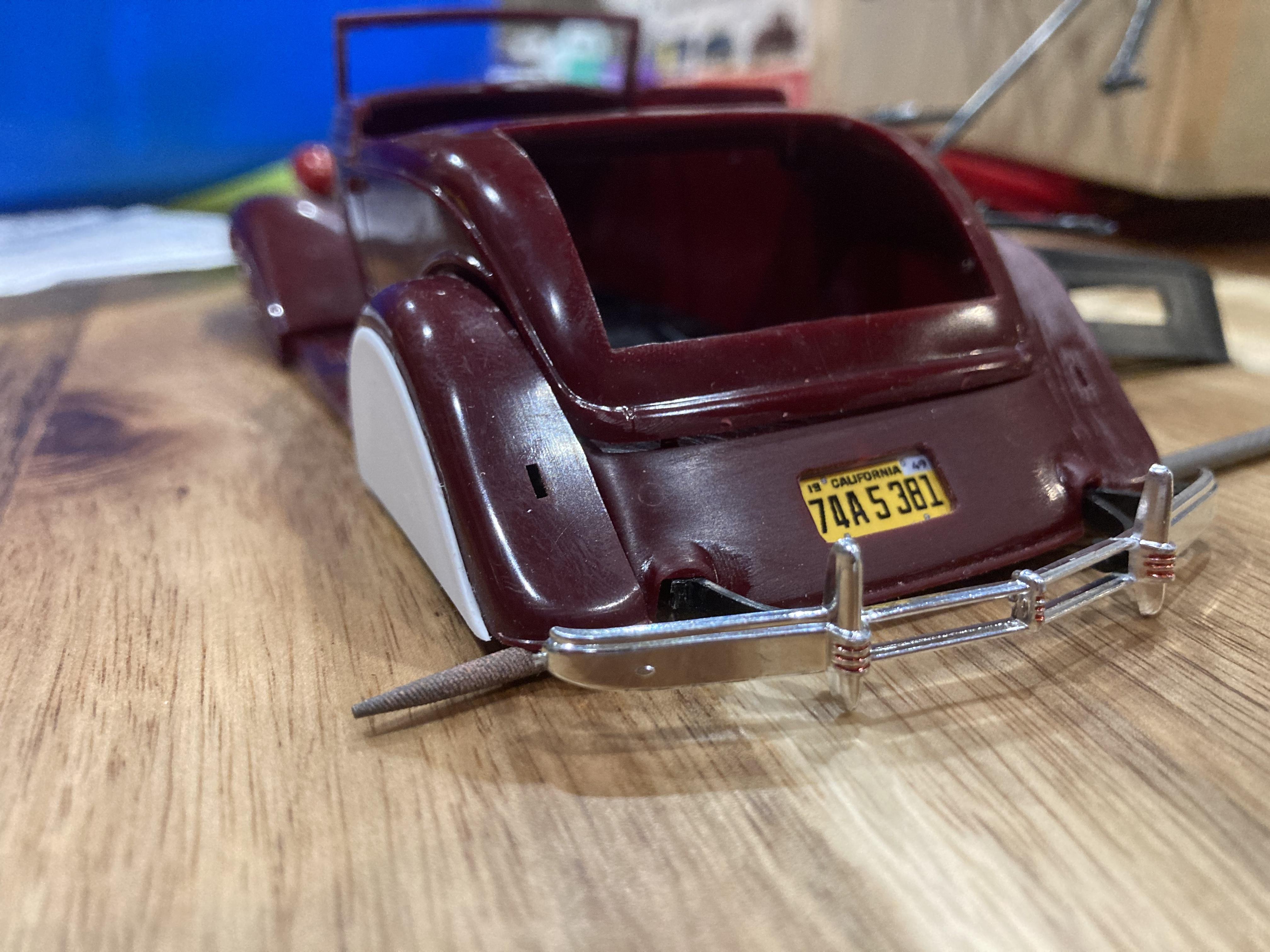

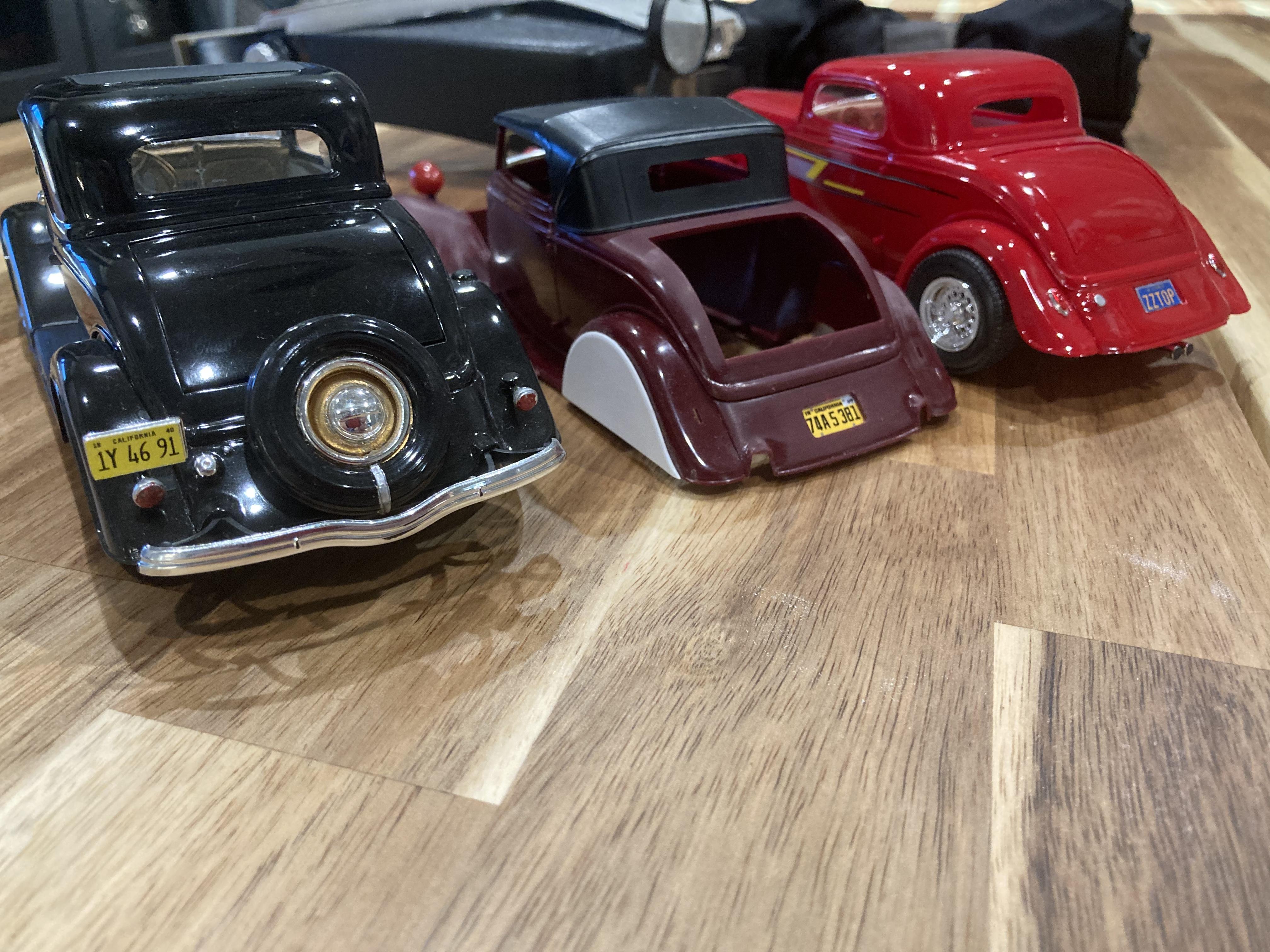

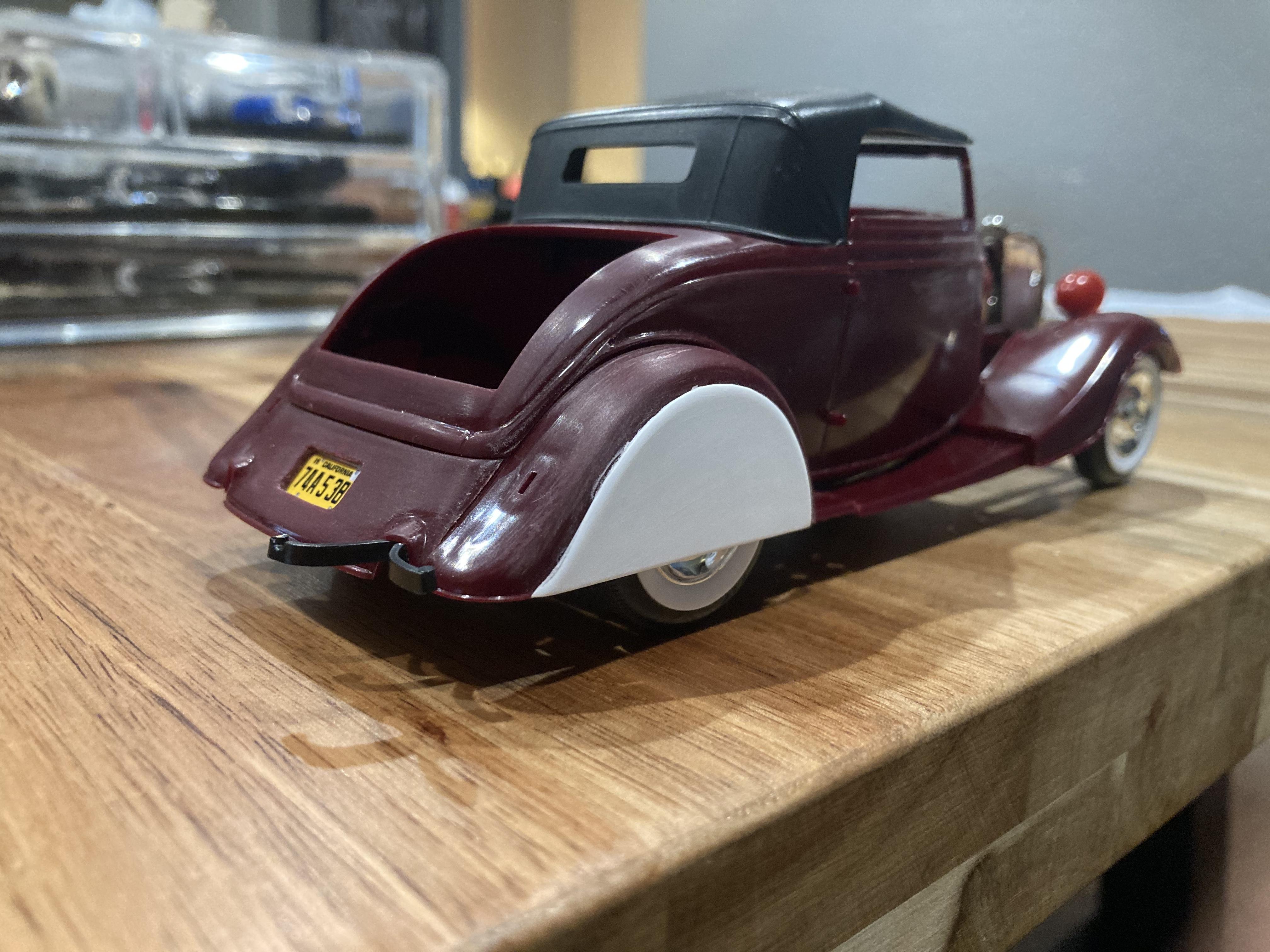

Dan Hay Posted November 12, 2022 Author Posted November 12, 2022 Little bit of work on the rear, smoothed the gas tank cover and cut a hole for the license plate. 1

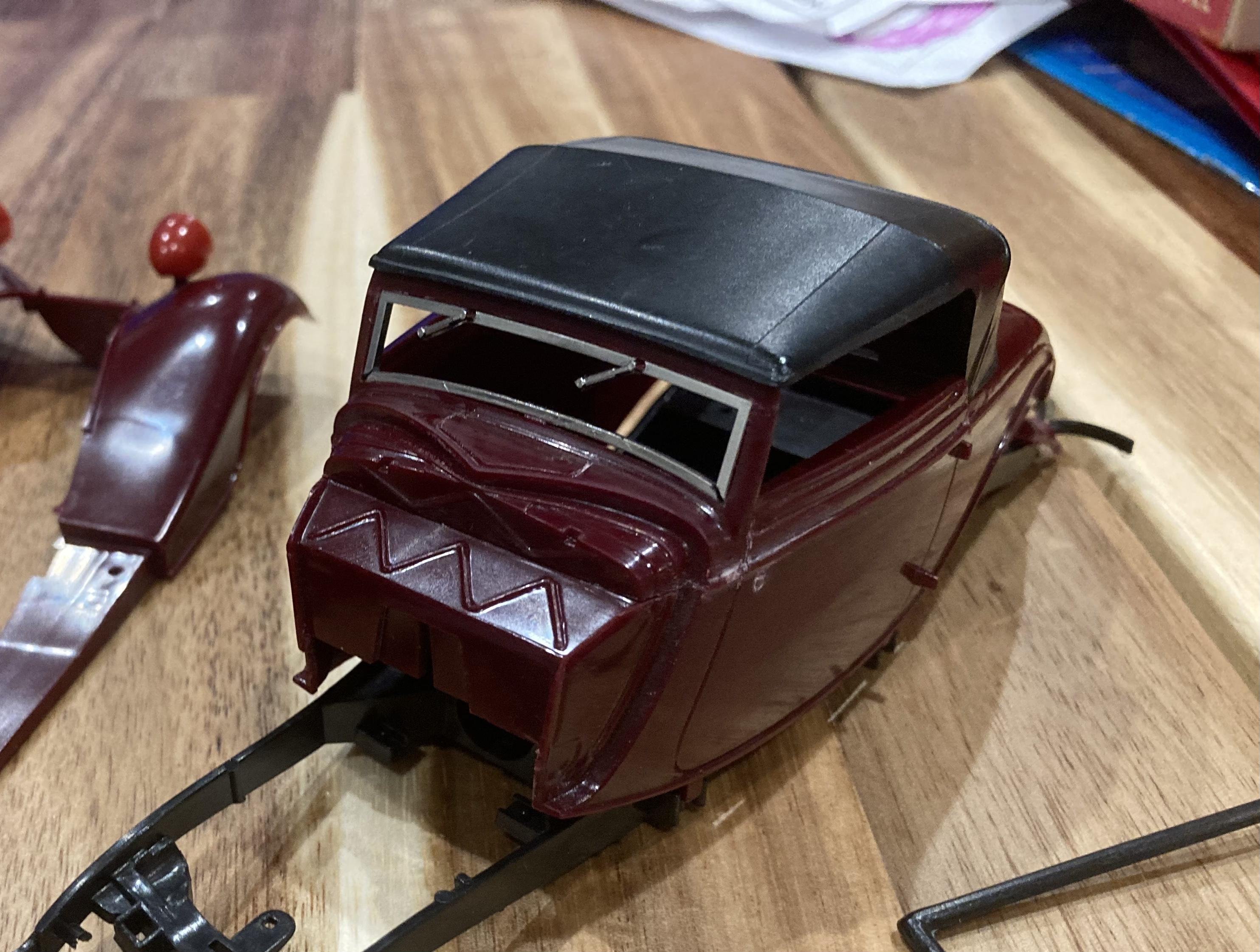

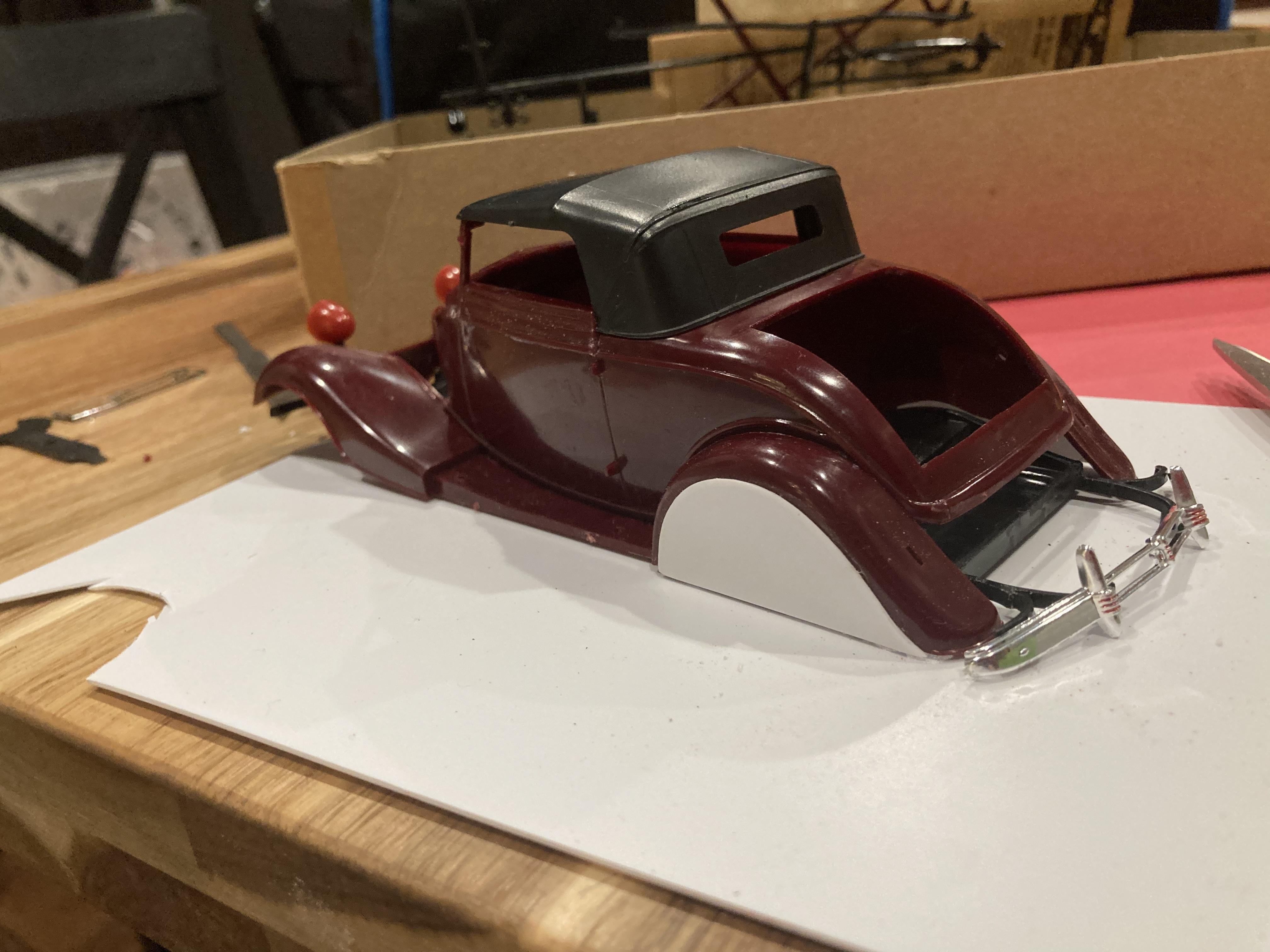

Dan Hay Posted November 12, 2022 Author Posted November 12, 2022 (edited) Chopped the windshield frame, shortened the wipers. Then, finish sanded the windshield posts, fitted the top Edited November 12, 2022 by Dan Hay 1

Dan Hay Posted November 12, 2022 Author Posted November 12, 2022 Pro tip when building a Monogram based 34 kit, which includes the ZZ Top Eliminator… The rear fenders and gas tank cover have fitment issues to the body, so I detach the rear fenders from the running boards and front fender unit and fit them to the body prior to paint. That way you’re not trying to fit them up with fresh paint. I learned that one the hard way years ago. Even if you fix the fitment issues, gluing the rear fenders to the body after paint can get tricky. Kinda hard to explain but if you’ve built this kit you probably smell what I’m steppin’ in… 2 1

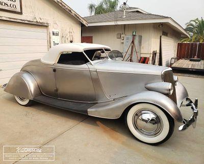

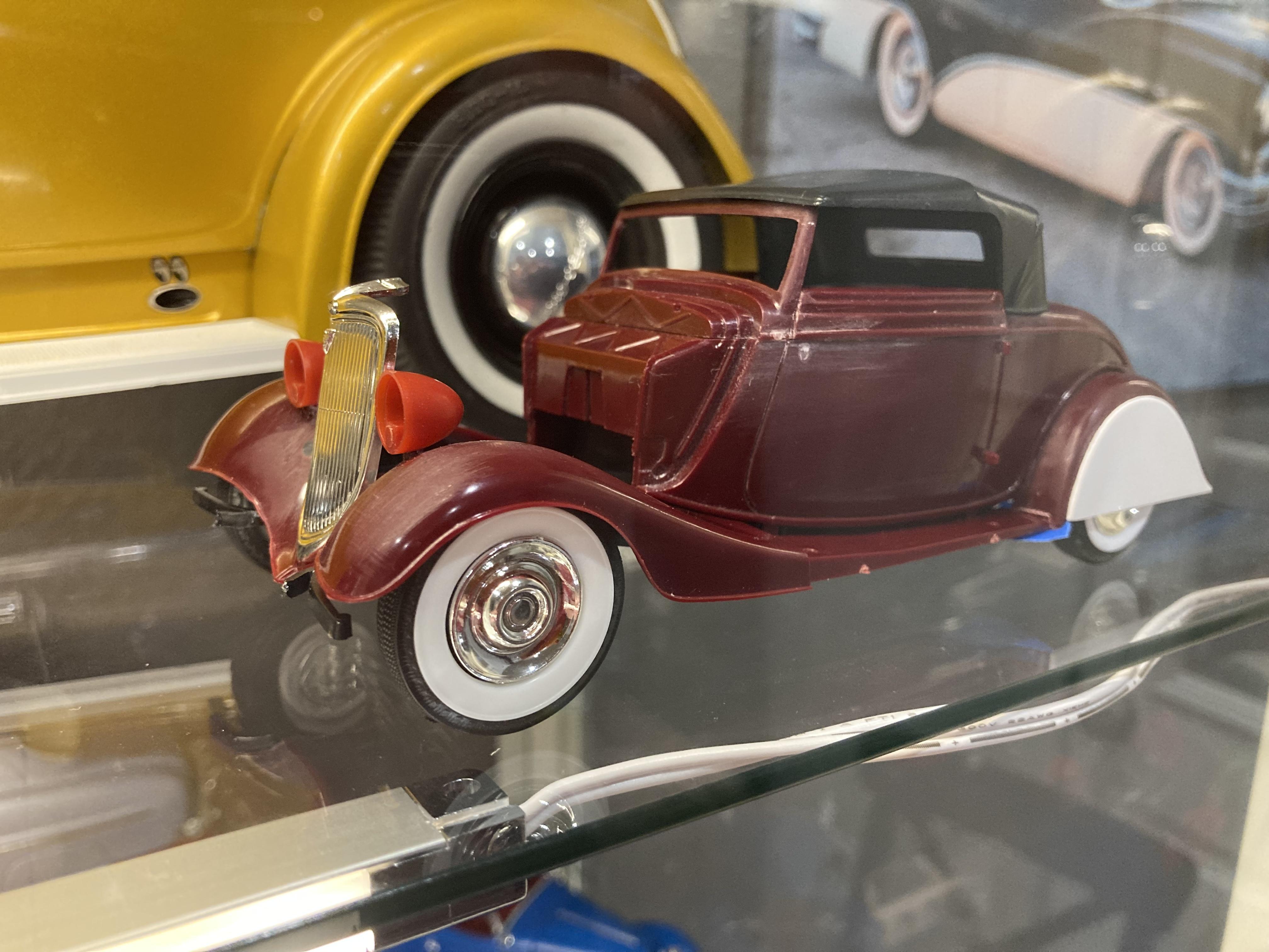

Dan Hay Posted November 15, 2022 Author Posted November 15, 2022 Working on the stance… when I’m building real cars or models I spend a lot of time dialing in the stance. It sets the attitude of the car. The 34 is not as low as I normally go for, it felt weird not grinding the front spring or crossmember for once. I can’t go any lower in the rear without a Z or a C in the frame, and I’m not interested in doing that. I think the stance is authentic late 40’s which is what I’m going for. Mark Skipper’s car for reference. Front axle is from the Revell 30 Ford Sedan kit, wheels/tires are Caddy sombreros from the Revell 50 Merc kit. 2

Dan Hay Posted November 18, 2022 Author Posted November 18, 2022 I kept staring at this thing because something was wrong but I couldn’t figure it out. It dawned on me the front tires were too small and didn’t fit the wheel opening very well. If I lowered it more in the front to help with how the tire fit the opening it would no longer have that speedboat stance but would sit level or a little nose down. Lowering it more in the rear to compensate is not an option without major surgery. So I tried a larger tire from the Revell 40 Ford coupe kit and that did the trick. It’s taller and has a wider white wall so it fills up the opening better and raised it up a little to give it more speedboat stance. Scroll up to my previous post to see a before. 1

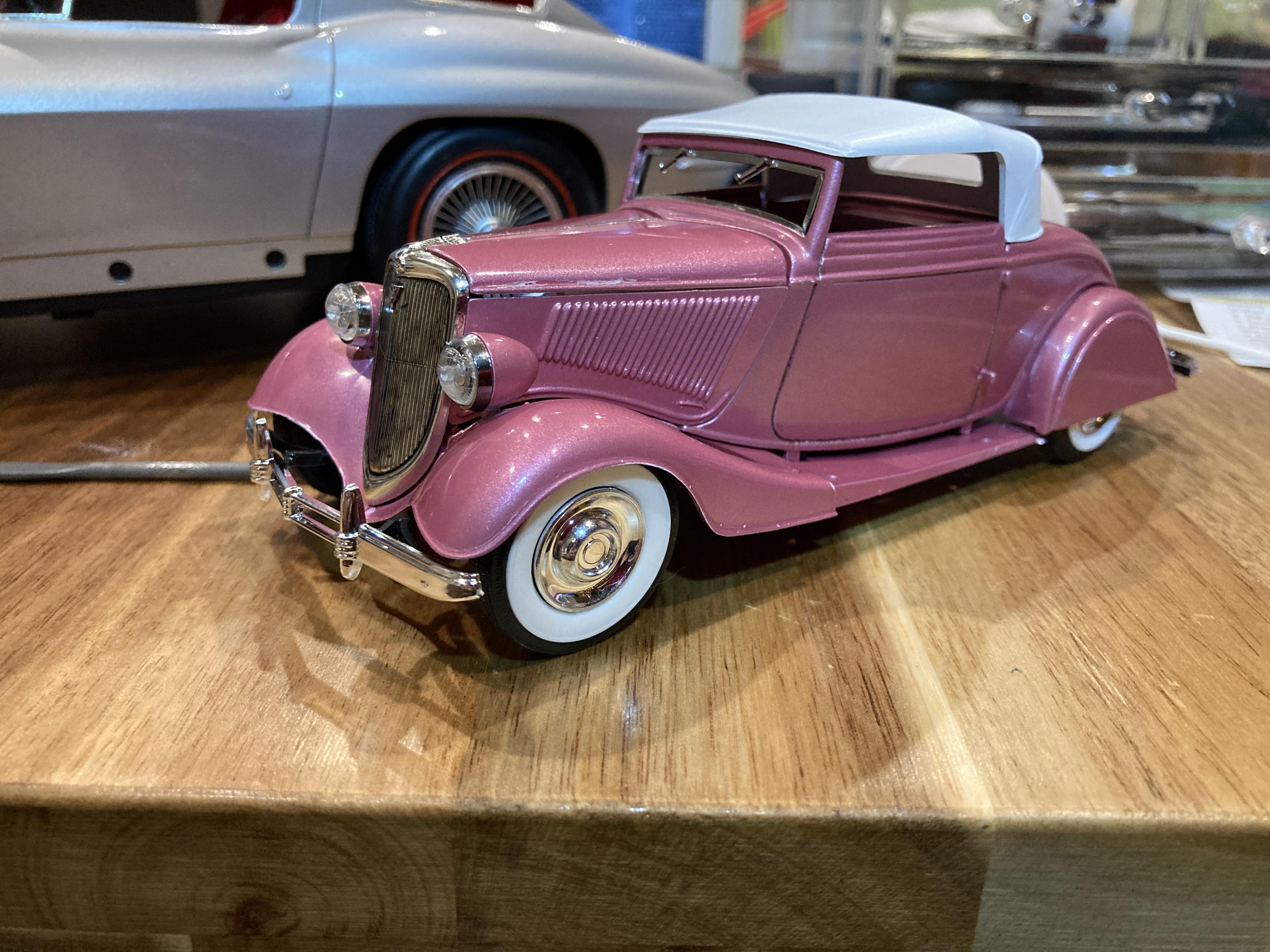

Dan Hay Posted December 8, 2022 Author Posted December 8, 2022 Got some paint on this thing, Tamiya light red. Will clear it and polish. 3

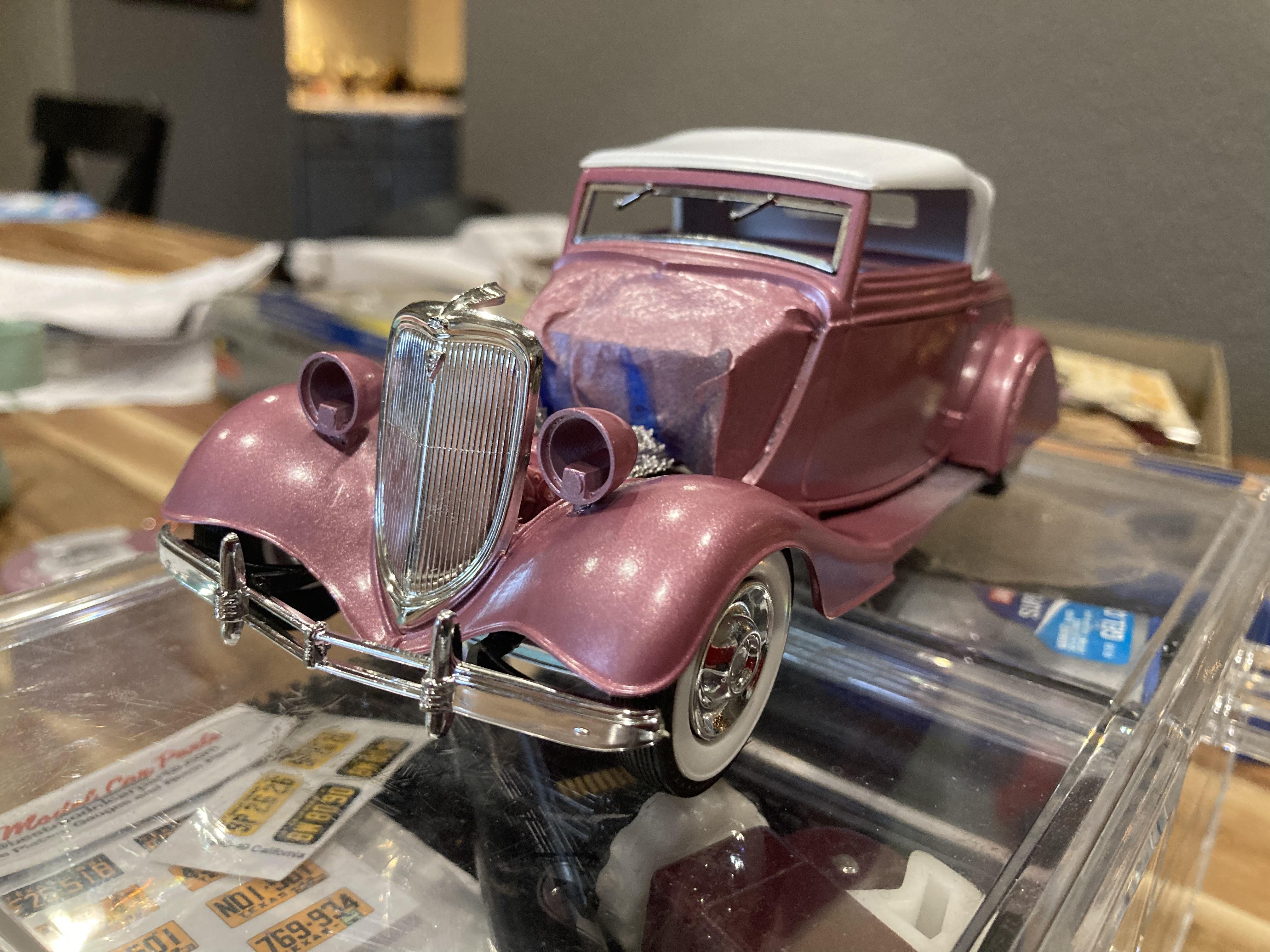

Dan Hay Posted December 20, 2022 Author Posted December 20, 2022 I’ve got the paint done but have done nothing on the engine or interior. Here’s a teaser. 3
