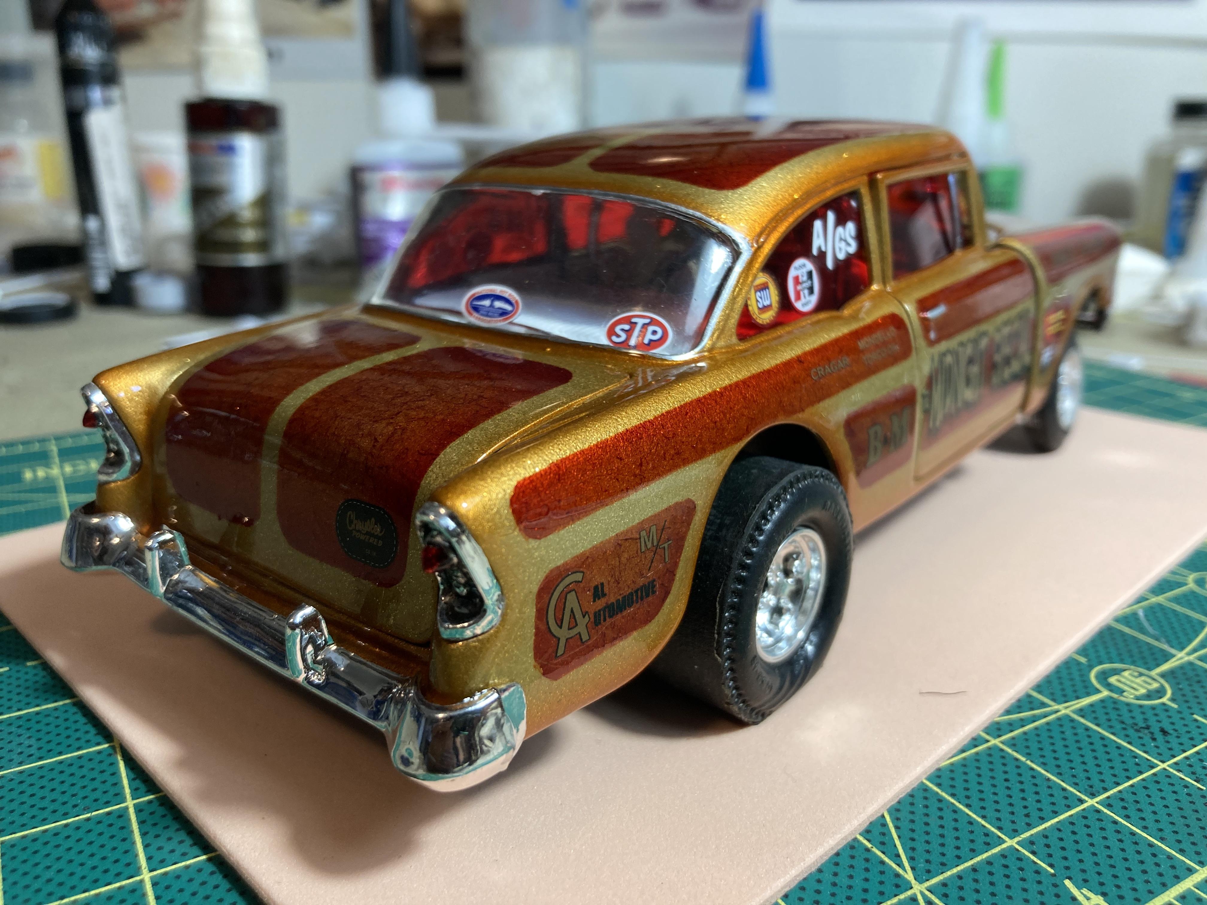

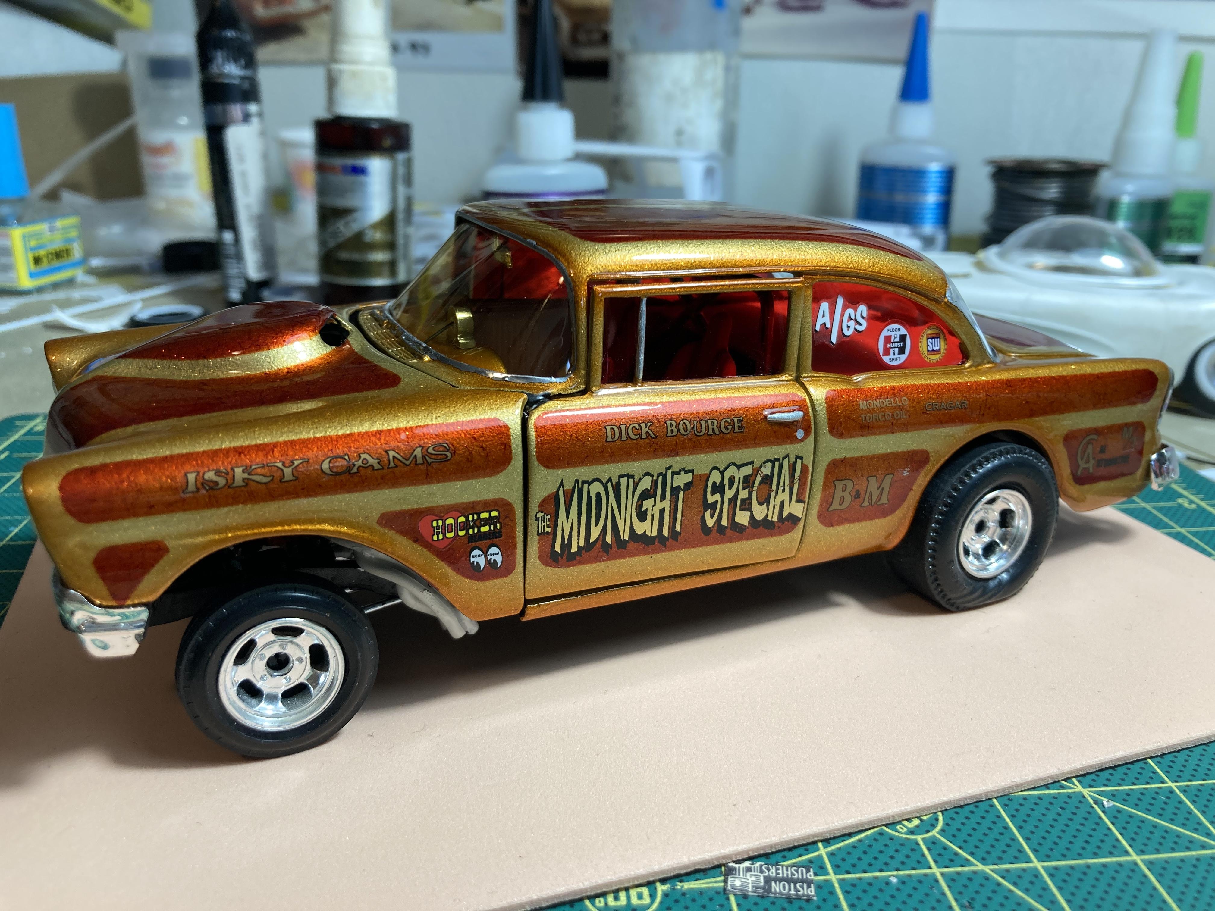

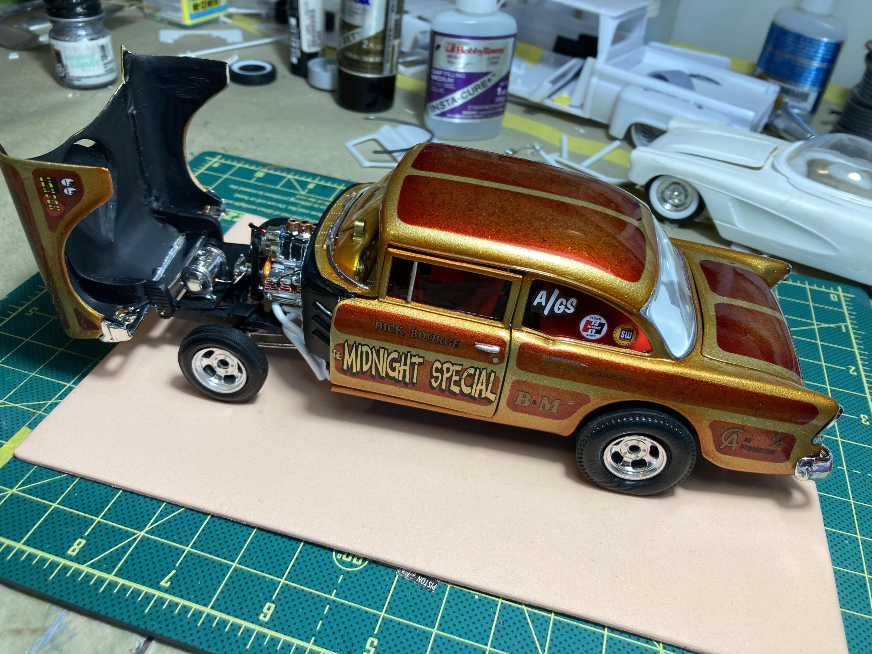

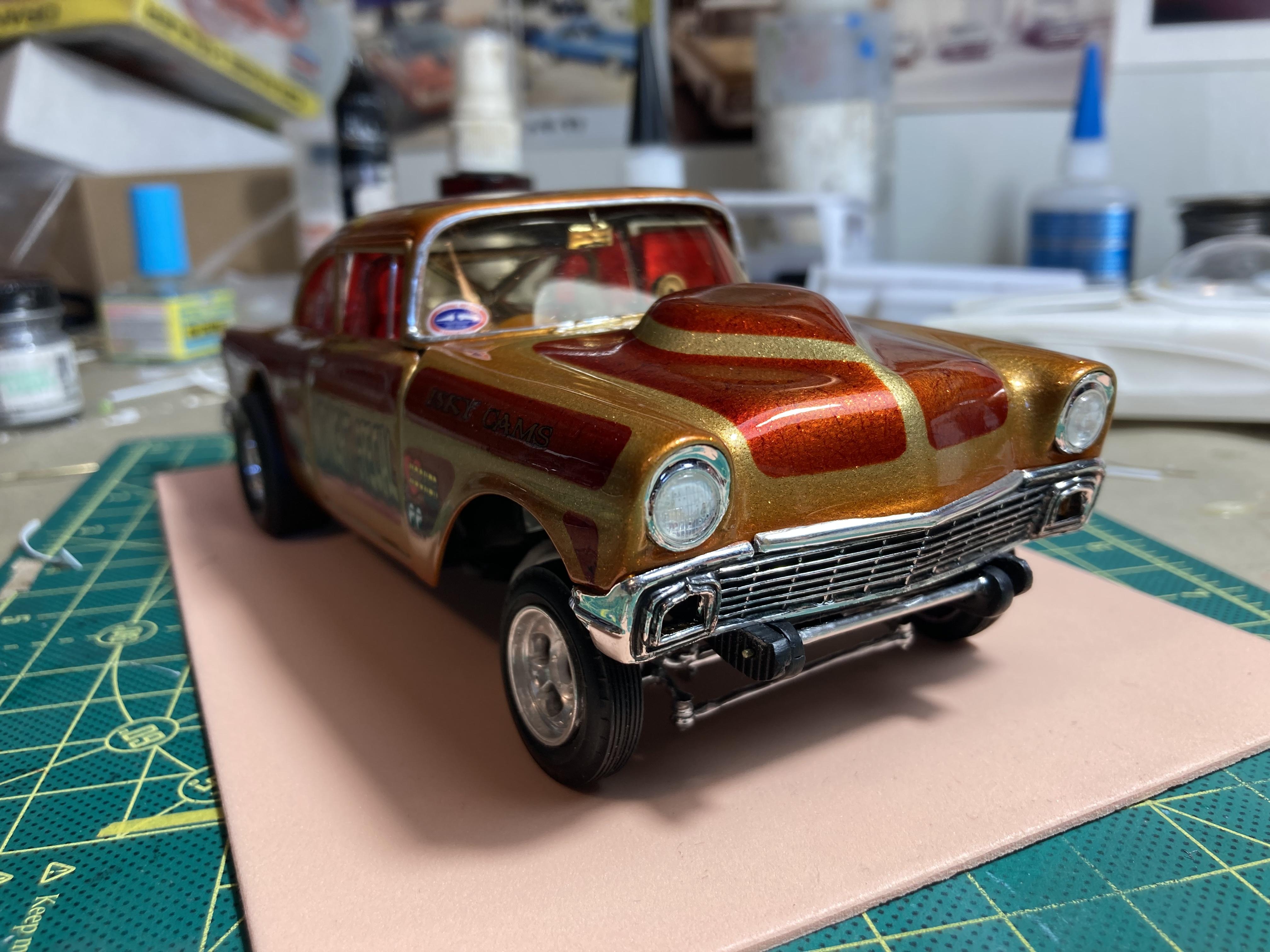

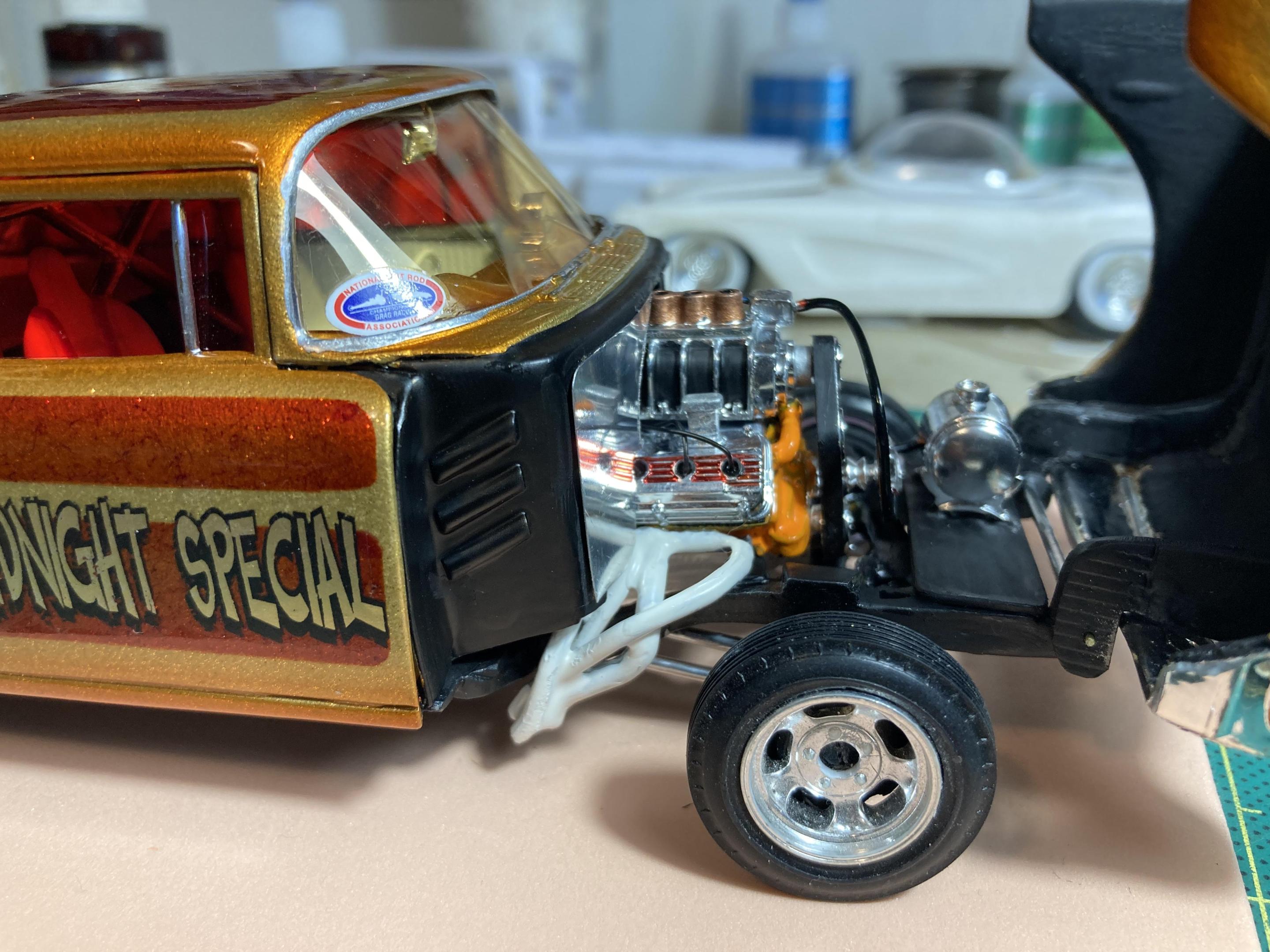

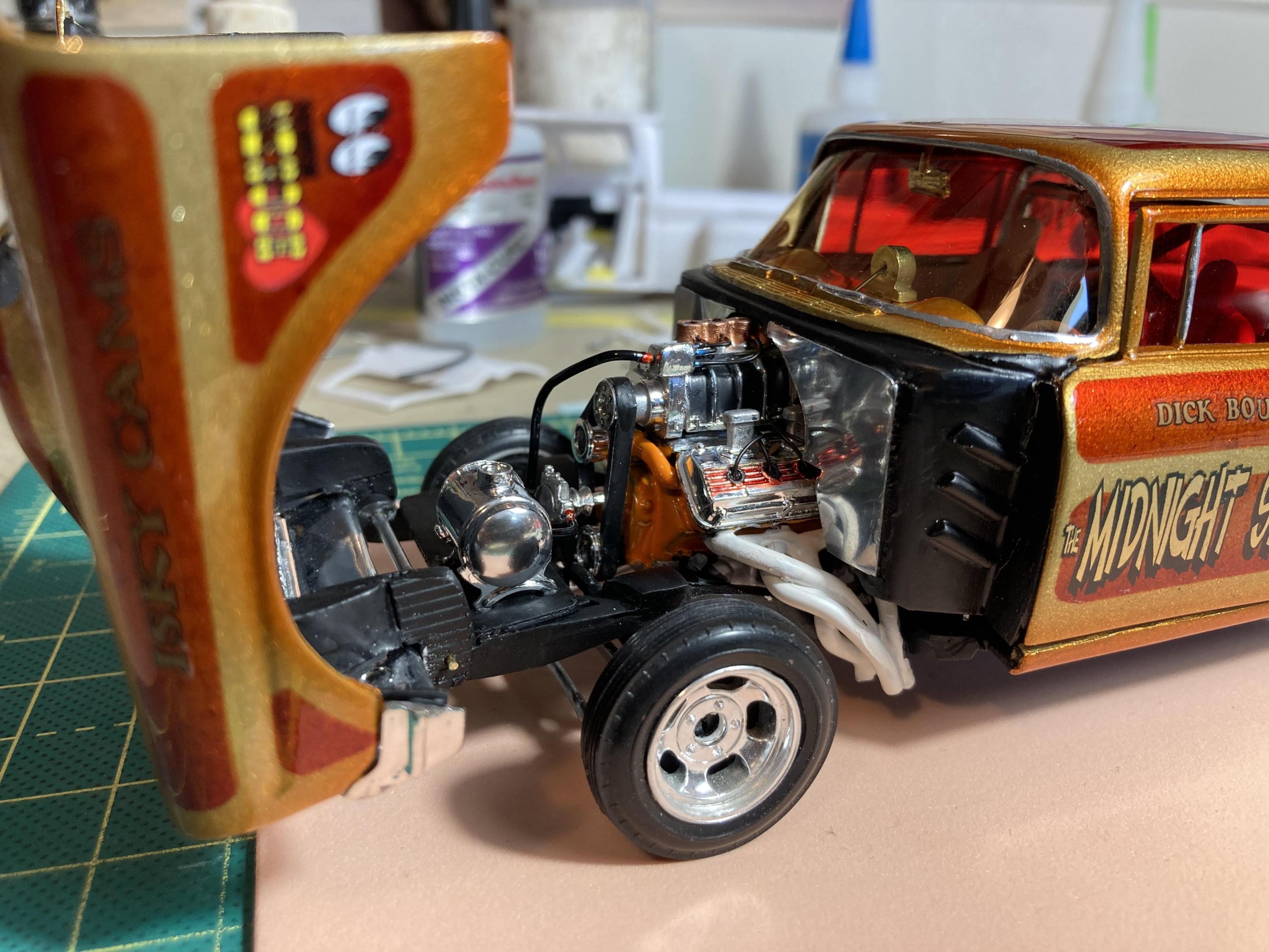

gseeds Posted November 12, 2022 Posted November 12, 2022 (edited) Hey guys , it’s been a few months since I’ve posted up any new models, this time around it’s a 1956 Chevy Revell kit a buddy of mine gave me about a year ago, This is the 1973 issue, kit wasn’t complete so I thought I would build a 60’s style gasser with a flip nose, metal flake gold base, candy red and tangerine panels with a lacquer candy burgundy cob web paint job, topped off with a 2K clear . originally I placed a small block Chevy motor in the engine bay but it looked so tiny in there that I replaced it with a much bigger blown Hemi Motor set back in the fire wall , And a 4 speed transmission, Slicks are a resin wrinkle walls, fronts tires are from the parts box as are the wheels and straight axle, build time about 2 weeks, really like having it in my display case, hope you like !! Thanks ! Edited November 16, 2022 by gseeds 7
rrb124@sbcglobal.net Posted November 12, 2022 Posted November 12, 2022 Crazy great headers! Very cool machine ? 1
Zippi Posted November 12, 2022 Posted November 12, 2022 Just a good looking build of an old school 56 Chevy Gasser. Love the paint job man and those resin wrinkle walls look pretty kewl. 1
Dutzie Posted November 12, 2022 Posted November 12, 2022 Great paint work and details. Excellent work. 1

TransAmMike Posted November 12, 2022 Posted November 12, 2022 Great looking '56, beautiful paint work Gary? 1
espo Posted November 12, 2022 Posted November 12, 2022 Great job on the paint work. You really captured the Gasser look. 1
carrucha Posted November 13, 2022 Posted November 13, 2022 Sweet gasser. I really dig the paint job. 1
donb Posted November 13, 2022 Posted November 13, 2022 Awesome work Gary. Nailed the theme you wanted. Love the paint work as well. 1
Tedly Posted November 13, 2022 Posted November 13, 2022 Beautiful job! If I might ask, how did you do the cob webbing in scale? 1
NYLIBUD Posted November 13, 2022 Posted November 13, 2022 Oh man,what a great job.The paint job is incredible, 1
larman Posted November 13, 2022 Posted November 13, 2022 Excellent model! Love the panel paint! Maybe the best build I have seen of this difficult kit! 1
M W Elky Posted November 13, 2022 Posted November 13, 2022 I really dig your choice of colors , and a fantastic job masking off those panels. These revell tri. Fives can be real fussy to build. Again great build thanks for sharing 1
gseeds Posted November 13, 2022 Author Posted November 13, 2022 (edited) Teddy , The cob web is done with a acrylic lacquer, I just so happened to have a Qt of unopened 40 year old candy burgundy in my stash, the trick is to “ Under “ thin the lacquer and shoot from your airbrush till the paint sprays out in a “ Hair “ that will be you cob web , it’s that easy !! Thanks for asking ! Edited November 13, 2022 by gseeds
gseeds Posted November 13, 2022 Author Posted November 13, 2022 (edited) 10 hours ago, Tedly said: Beautiful job! If I might ask, how did you do the cob webbing in scale? The cob web is done with a acrylic lacquer, I just so happened to have a Qt of unopened 40 year old candy burgundy in my stash, the trick is to “ Under “ thin the lacquer and shoot from your airbrush till the paint sprays out in a “ Hair “ that will be you cob web , it’s that easy !! Thanks for asking ! Edited November 13, 2022 by gseeds
Hmann68 Posted November 14, 2022 Posted November 14, 2022 Very cool! I love the paint scheme and colors! 1
Tedly Posted November 15, 2022 Posted November 15, 2022 On 11/14/2022 at 2:52 AM, gseeds said: Teddy , The cob web is done with a acrylic lacquer, I just so happened to have a Qt of unopened 40 year old candy burgundy in my stash, the trick is to “ Under “ thin the lacquer and shoot from your airbrush till the paint sprays out in a “ Hair “ that will be you cob web , it’s that easy !! Thanks for asking ! OK, thanks, I remember the technique in full size car painting with a siphon spray gun, but wasn't sure if it would work with an airbrush. I'll have to give it a try. 1
